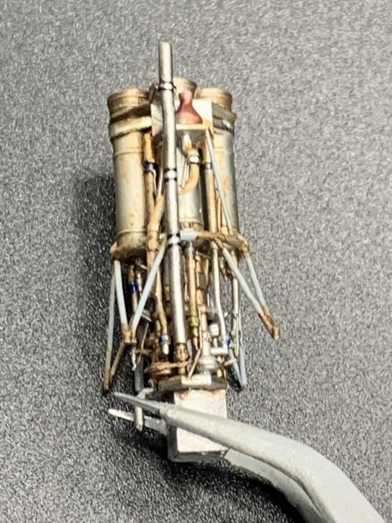

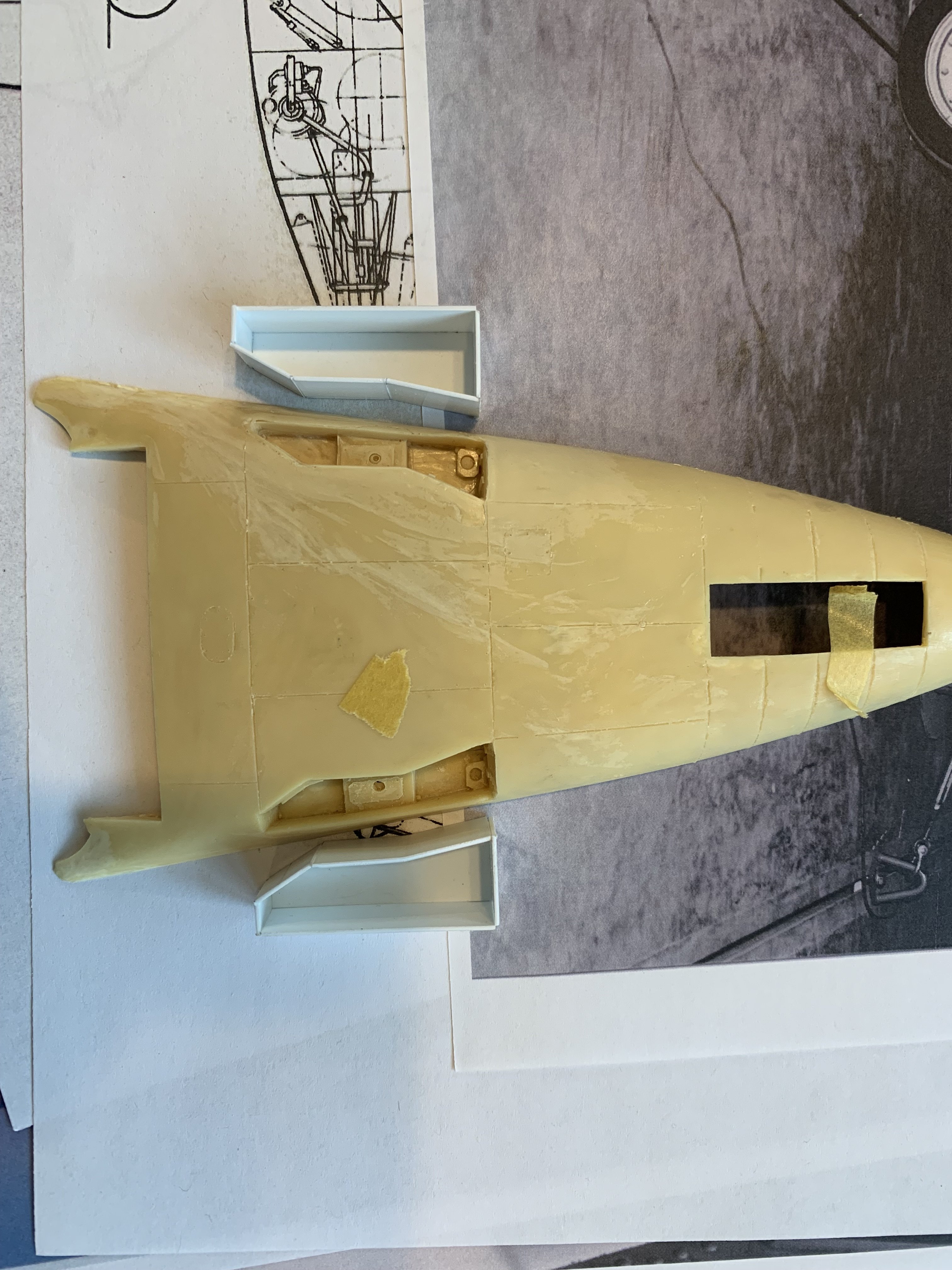

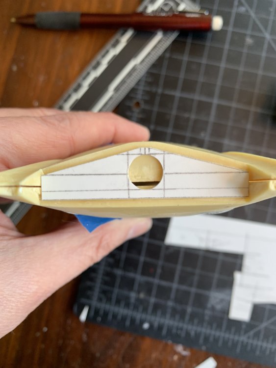

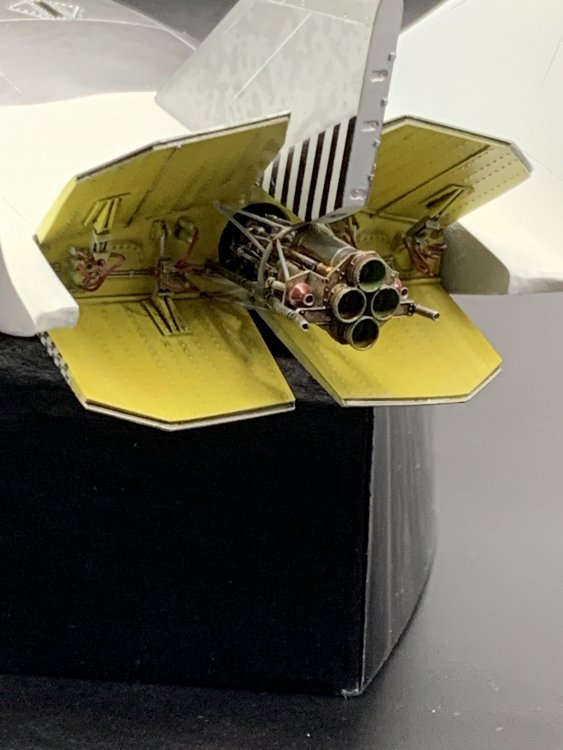

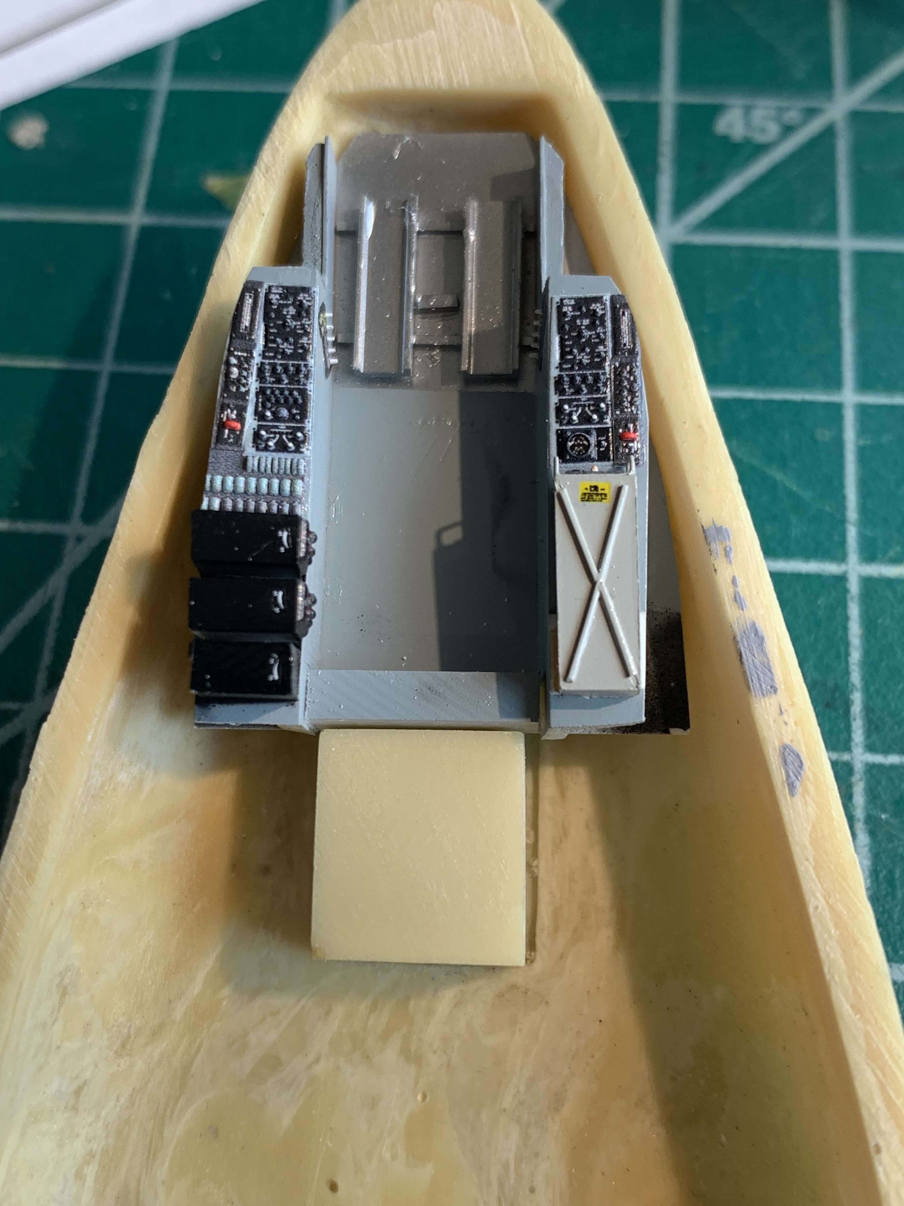

swimmer25k Posted May 5, 2024 Share Posted May 5, 2024 This kit is a bit of a turd. Only the canopy, fuselage halves, MLG doors, and vertical stabs are being used. Everything else is either scratchbuilt, printed, stolen from another kit with heavy modifications. Quote Link to post Share on other sites
RichB63 Posted May 6, 2024 Share Posted May 6, 2024 (edited) Ooo, that’s nice! A subject you don’t see everyday, from a manufacturer long defunct. I love all of the improvements. The 3D printed motors are most impressive. Well done! Rich Edited May 6, 2024 by RichB63 Quote Link to post Share on other sites
Major Walt Posted May 7, 2024 Share Posted May 7, 2024 I love this! Quote Link to post Share on other sites
Dutch Posted May 7, 2024 Share Posted May 7, 2024 I have to agree, simply outstanding work on the cockpit, wheel wells and rocket motors and piping. Truly a work of art! Quote Link to post Share on other sites
cruiz Posted May 9, 2024 Share Posted May 9, 2024 Marvelous! You are doing a great job sculpting a masterpiece from that resin chunk. The engine fooled me as a pic of the real one. Quote Link to post Share on other sites

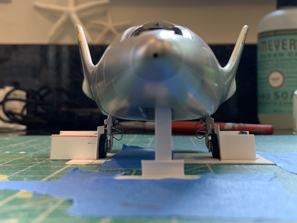

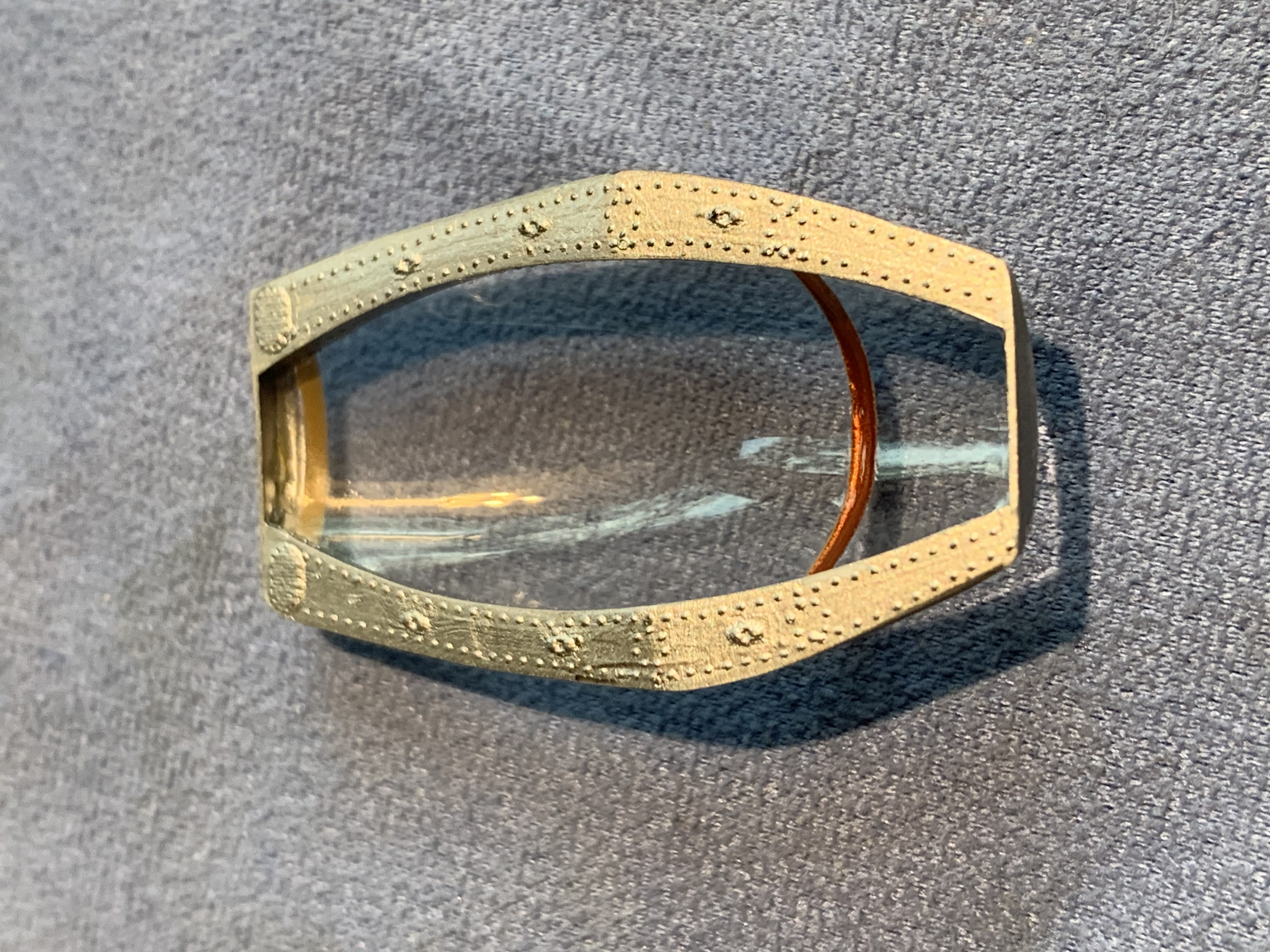

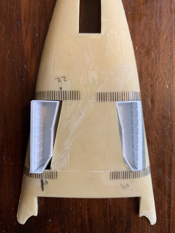

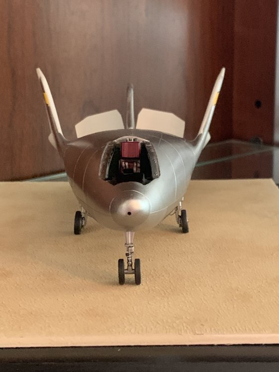

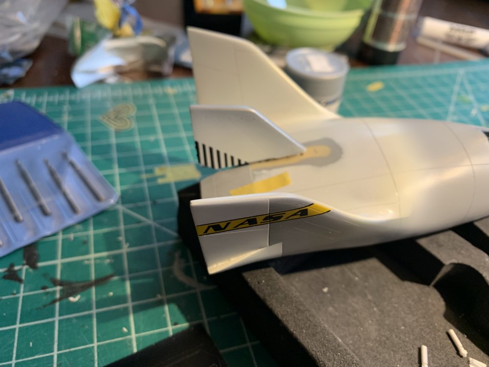

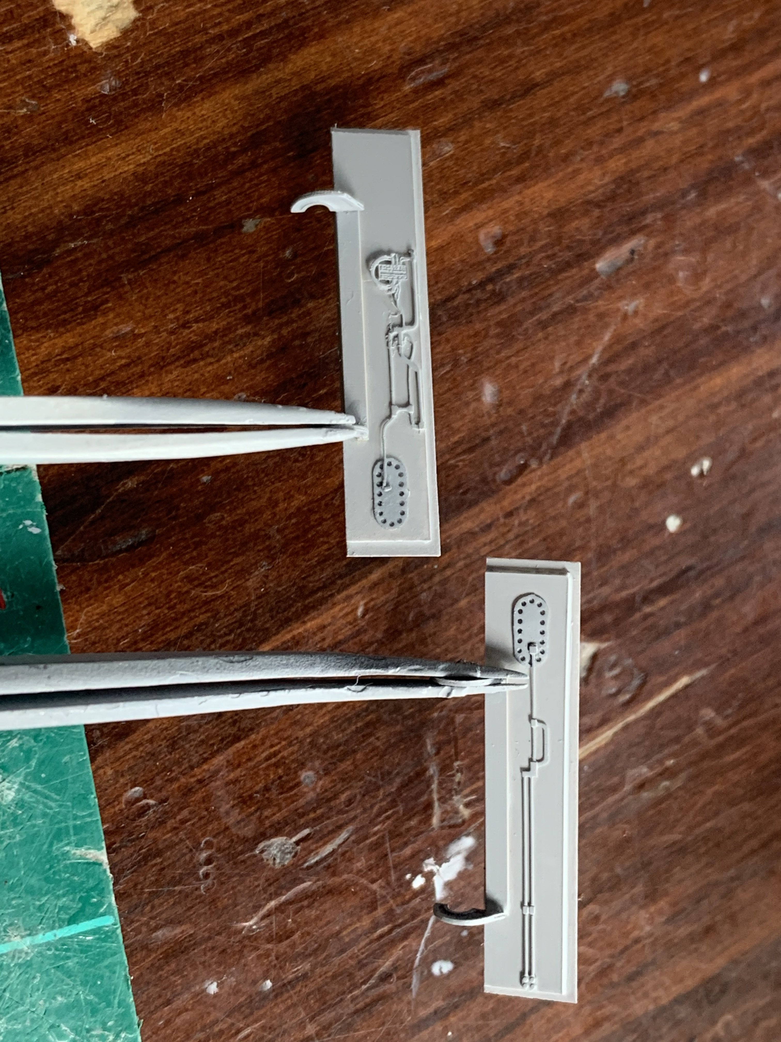

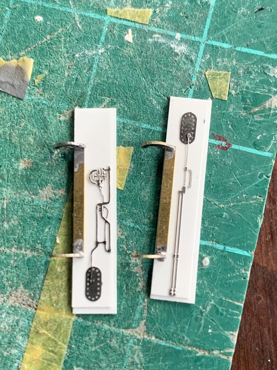

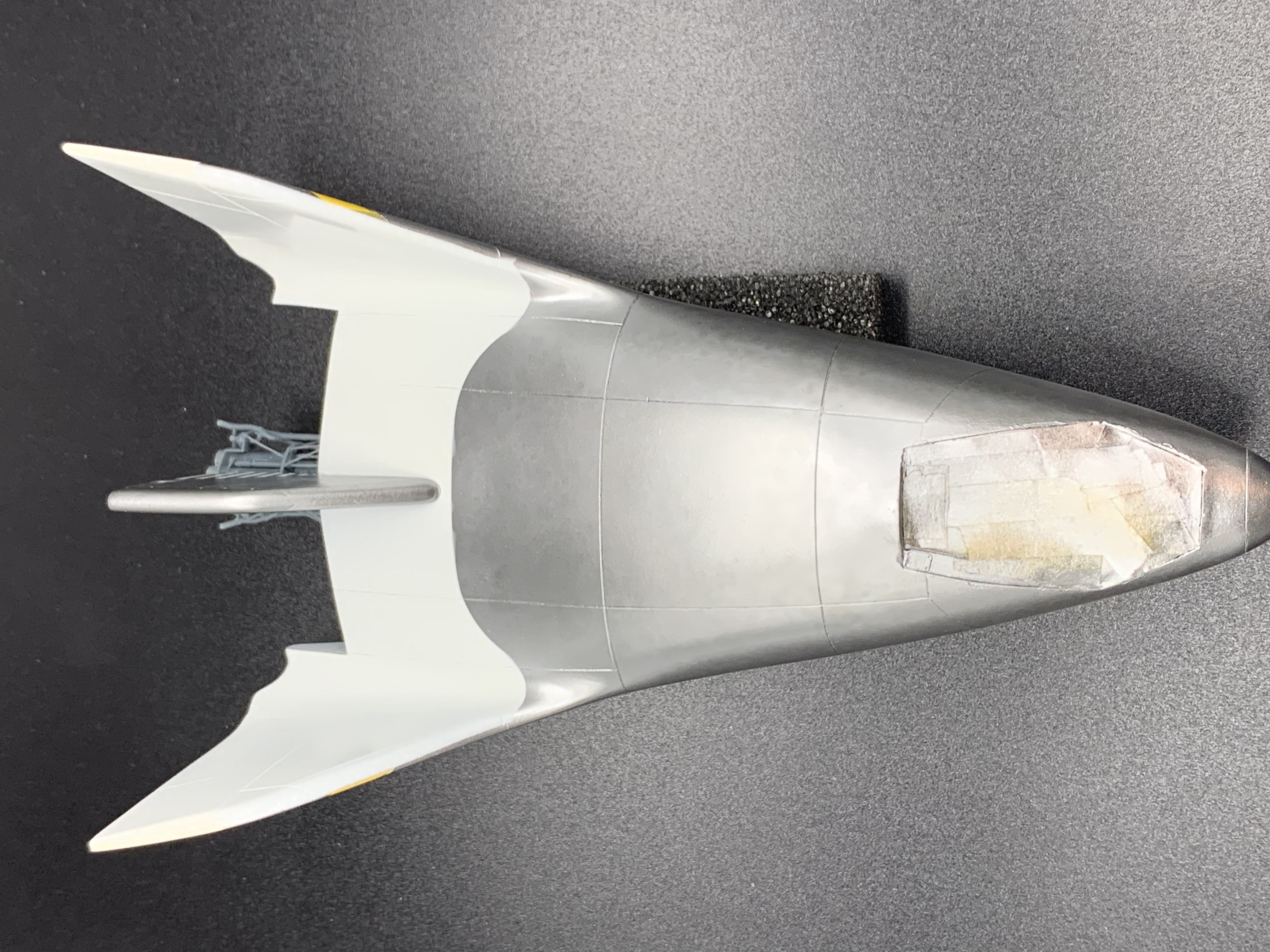

swimmer25k Posted May 27, 2024 Author Share Posted May 27, 2024 Moving along with this thing and almost ready for decals. The canopy and gear are done, with the nose gear still to attach. I scratchbuilt the front gear doors and skinning the mains with styrene to clean up the roughness of the kit parts. The seat is from an Aires F-106. The wheels hit the deck at a -5 degree camber, so I made a jig to correctly align them. Quote Link to post Share on other sites

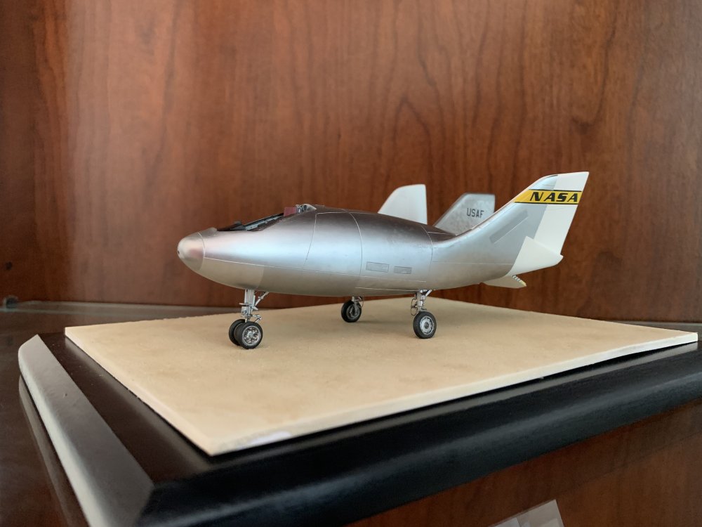

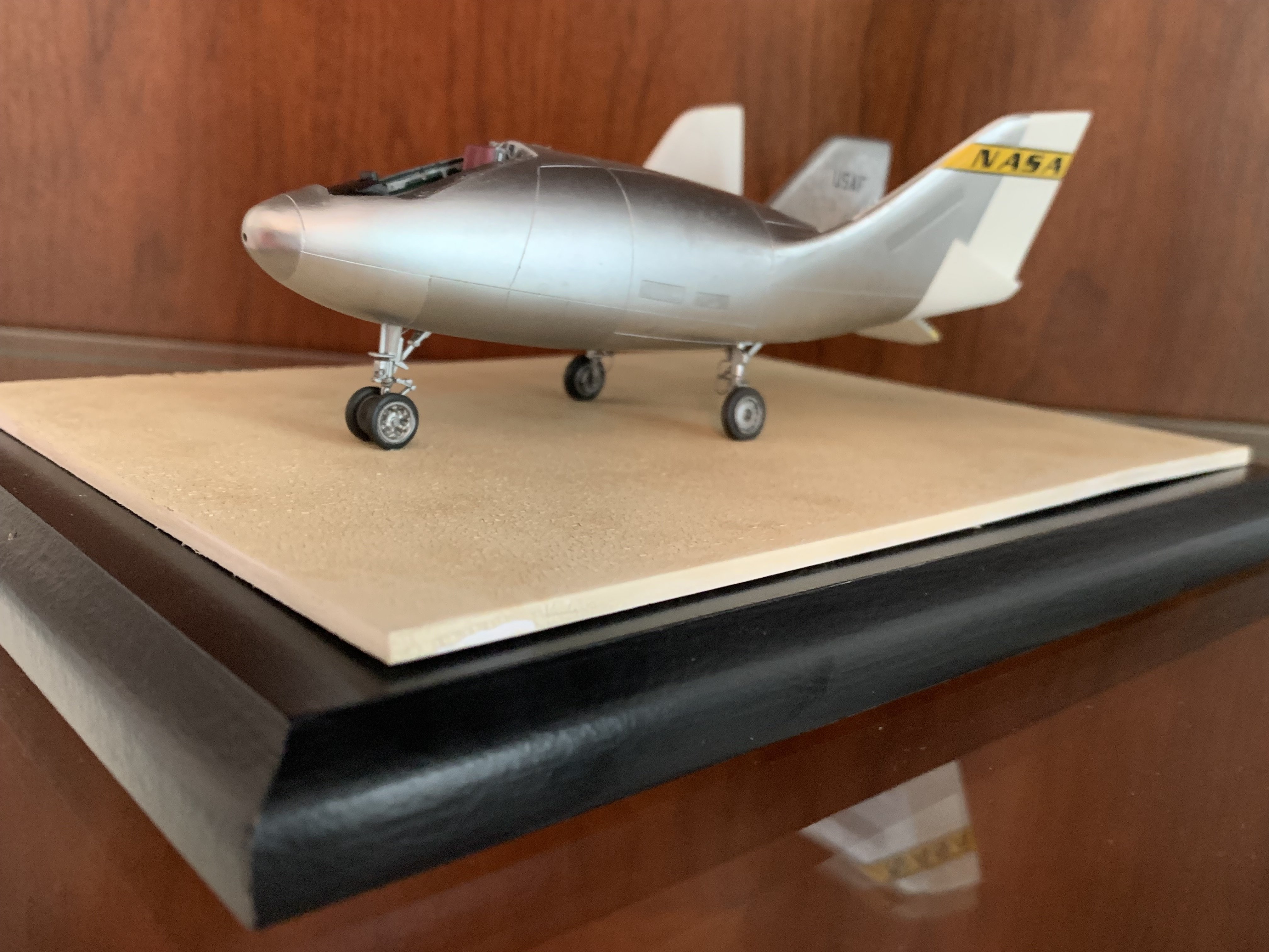

swimmer25k Posted June 3, 2024 Author Share Posted June 3, 2024 She’s on her legs now. And made part of the base. Quote Link to post Share on other sites

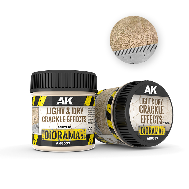

Robb5986 Posted June 5, 2024 Share Posted June 5, 2024 Hi Chris, old Texas IPMS colleague Mark Robbins here; I wonder how/where you made that incredible Edwards dry lake base! I had just built the Special Hobby 1/48 D-558-1 and had to settle for a dyed plaster "sand"; having worked at Edwards your base is amazing. Please let me know your technique-- Mark Quote Link to post Share on other sites
swimmer25k Posted June 5, 2024 Author Share Posted June 5, 2024 6 minutes ago, Robb5986 said: Hi Chris, old Texas IPMS colleague Mark Robbins here; I wonder how/where you made that incredible Edwards dry lake base! I had just built the Special Hobby 1/48 D-558-1 and had to settle for a dyed plaster "sand"; having worked at Edwards your base is amazing. Please let me know your technique-- Mark Mark, I use a base if 1/8” PVC sheet sprayed with a Gunze dark earth. On top of that is a layer of AK light/dry crackle effects. This was my third attempt at it. Too thin and not much will happen and too thick you’ll get deeper crevices. Once applied I put it outside to dry in the natural heat. Quote Link to post Share on other sites
Robb5986 Posted June 7, 2024 Share Posted June 7, 2024 Thanks so much, Chris. Beautiful effect. Am going to get some supplies tomorrow and experiment with this technique. I've stood on the real stuff, and you've nailed the dry lake detail better than I've ever seen. Cheers, buddy. Quote Link to post Share on other sites
