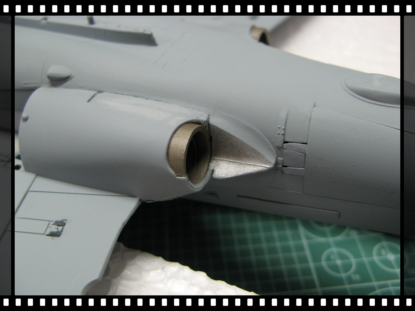

ExchefAndy Posted May 6, 2024 Share Posted May 6, 2024 Just had a look at mine, mat black with some grey or white pastel streaks...artistic licence? That was just a guess, and I'm sure someone more knowledgeable will be along soon! Andy Quote Link to post Share on other sites
A-10 LOADER Posted May 6, 2024 Share Posted May 6, 2024 I used Model Master enamel "Jet Exhaust" on mine.You can dirty up the insides if you'd like but, you're not really gonna see to much. Steve Quote Link to post Share on other sites

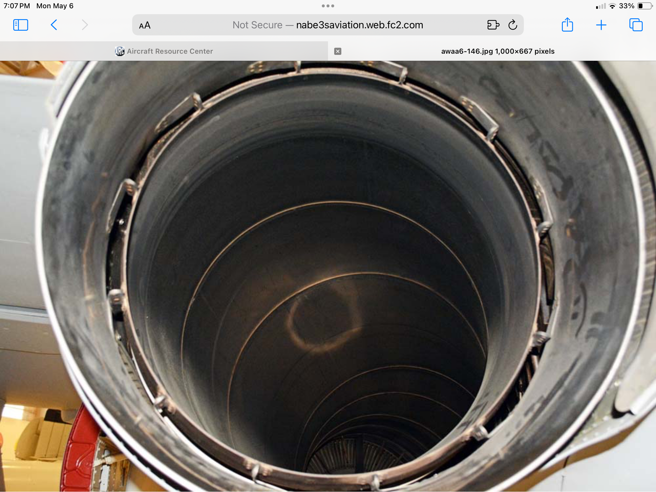

BillS Posted May 7, 2024 Share Posted May 7, 2024 Actually, military jet exhaust ducting is more of a grayish tan metallic color, especially non-after burning engines. The Navy used JP-5 which has a higher flash point the JP-4/8. I think it was compatible with ships boilers. You might search some walk around galleries Quote Link to post Share on other sites
BillS Posted May 7, 2024 Share Posted May 7, 2024 I found this. You can get an idea of the color toward the exit where light is hitting it. You can clearly see the T-wheel is a tannish color as well Quote Link to post Share on other sites
