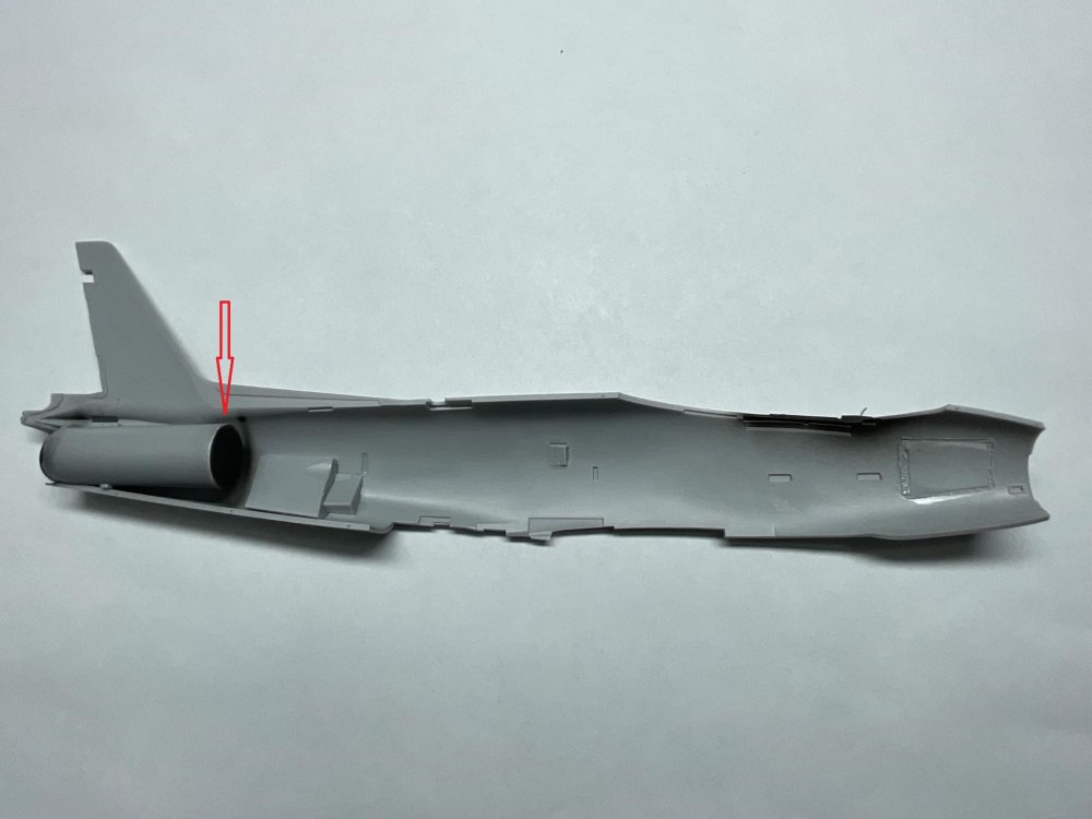

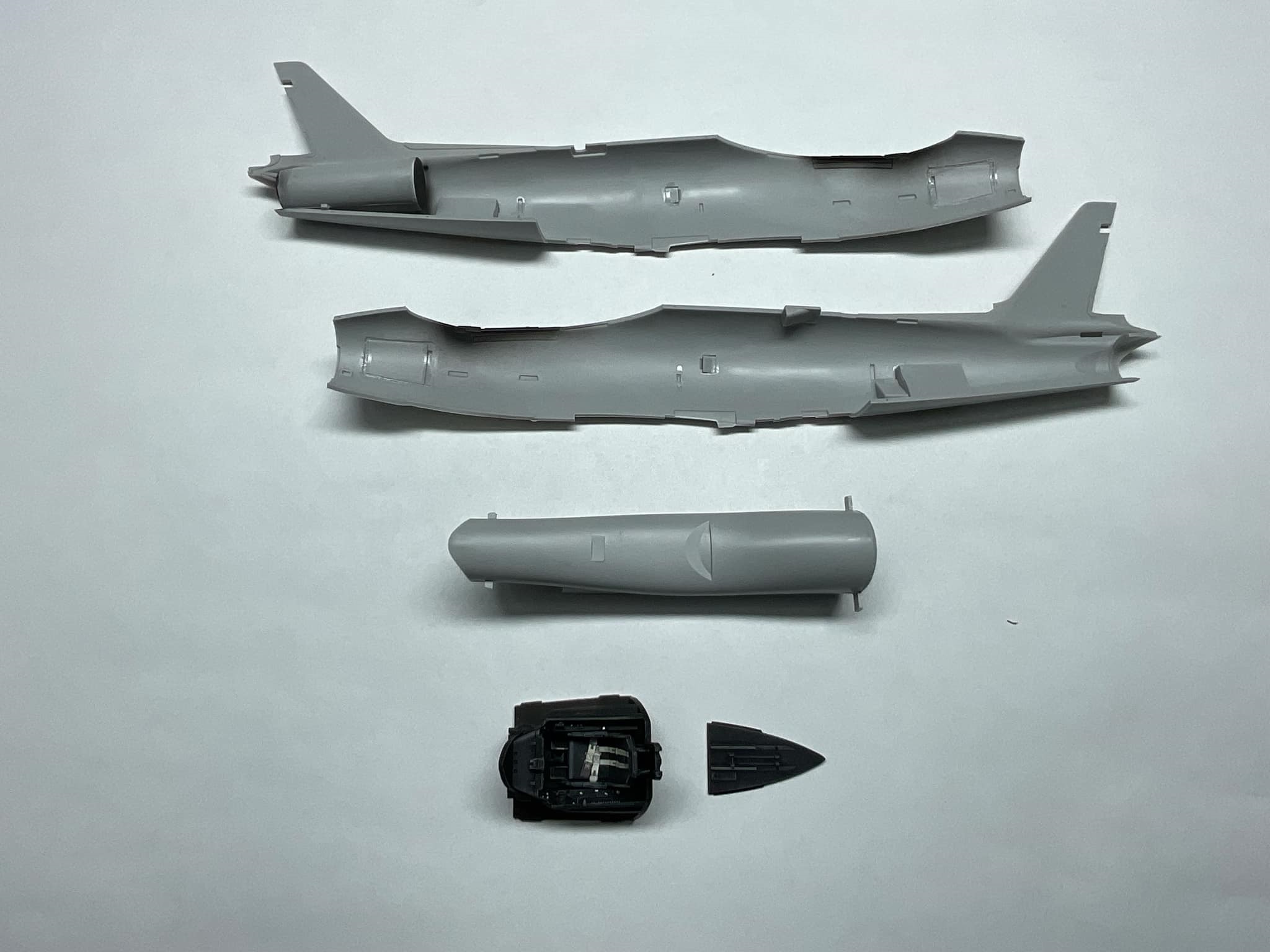

dai phan Posted November 16, 2024 Author Share Posted November 16, 2024 (edited) Hello friends, Continue with the build. The engine tube is oversized making closing of the halves impossible unless some serious trimming is done. I ended up cutting in half. Even if the tube is of correct size you really cannot see the turbine blades that far down anyway. My method allows the halves to close without work and less nose weight is noted. Oddly the kit's IP decals have the yellow dials rather than white. Dai Edited November 17, 2024 by dai phan Quote Link to post Share on other sites

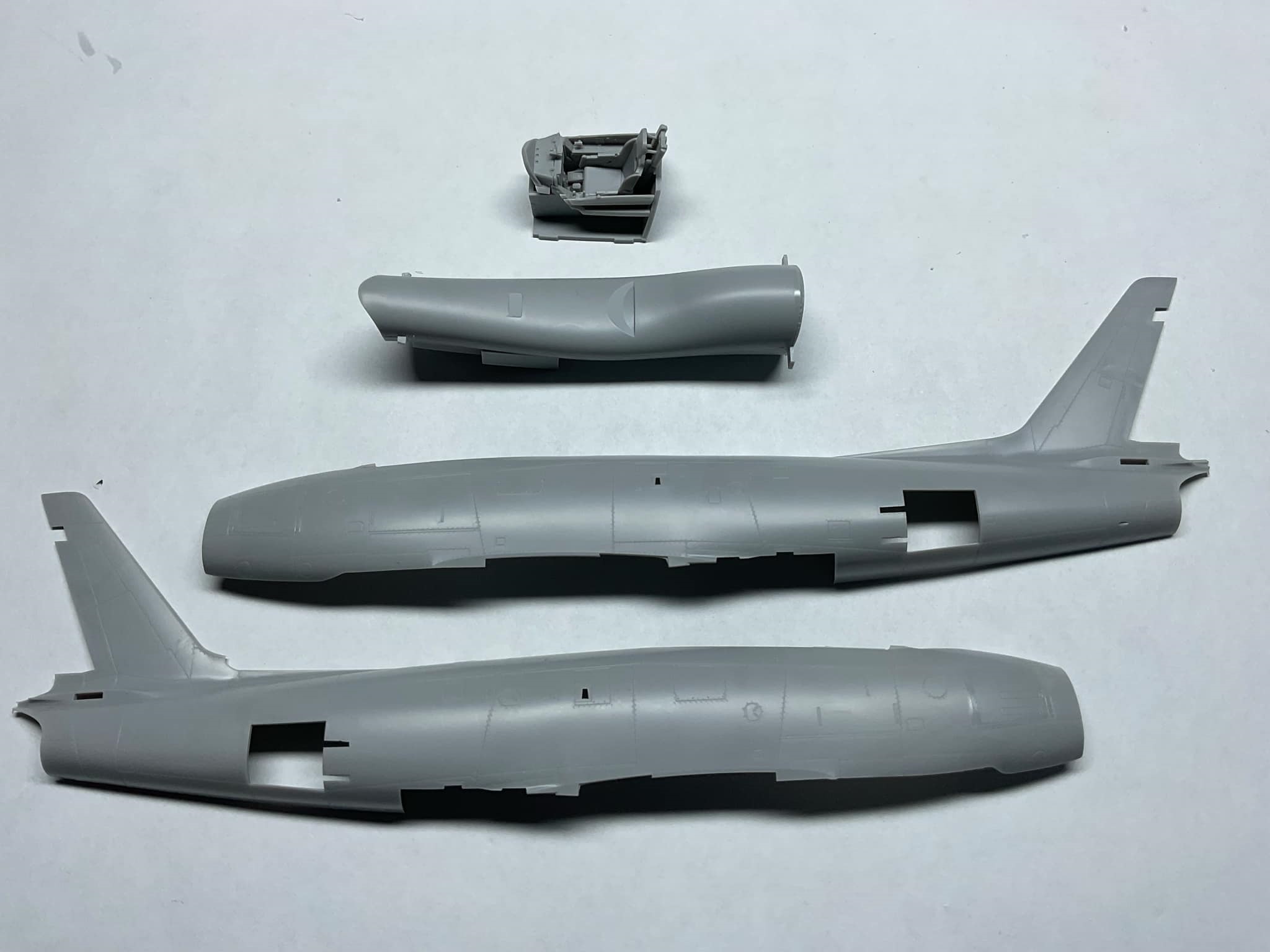

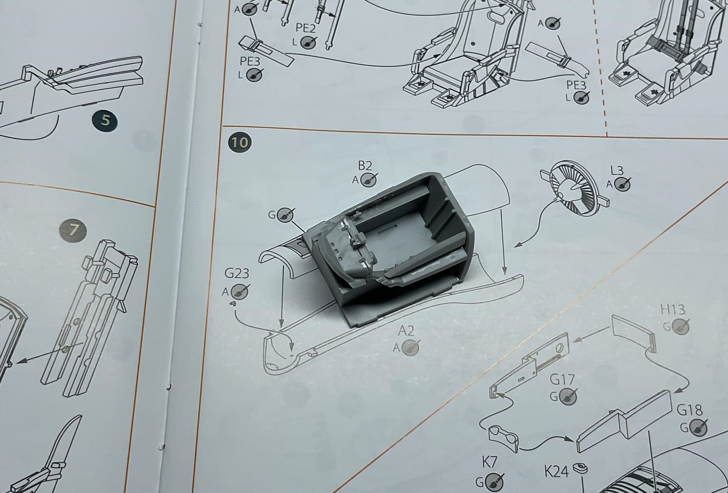

dai phan Posted November 17, 2024 Author Share Posted November 17, 2024 Greetings, Dry fit everything together and so far good fit is noted. Rather than glueing the cockpit tub to the intake trunk then to the fuse per instruction, do the following. Glue the tub to one halve first making sure the tabs are locked in place. Then glue the intake trunk onto the halves making sure you have positive lock. There are 8 tabs total and if you glue the tub to the trunk then to the fuse, you may not get them all to line up properly. Also if you do the closed gun ports version, forget the backing plates on steps 14/15. They interfere with the outside panels fit and even if they do not, you cannot see them after the fuse is closed anyway. Dai Quote Link to post Share on other sites

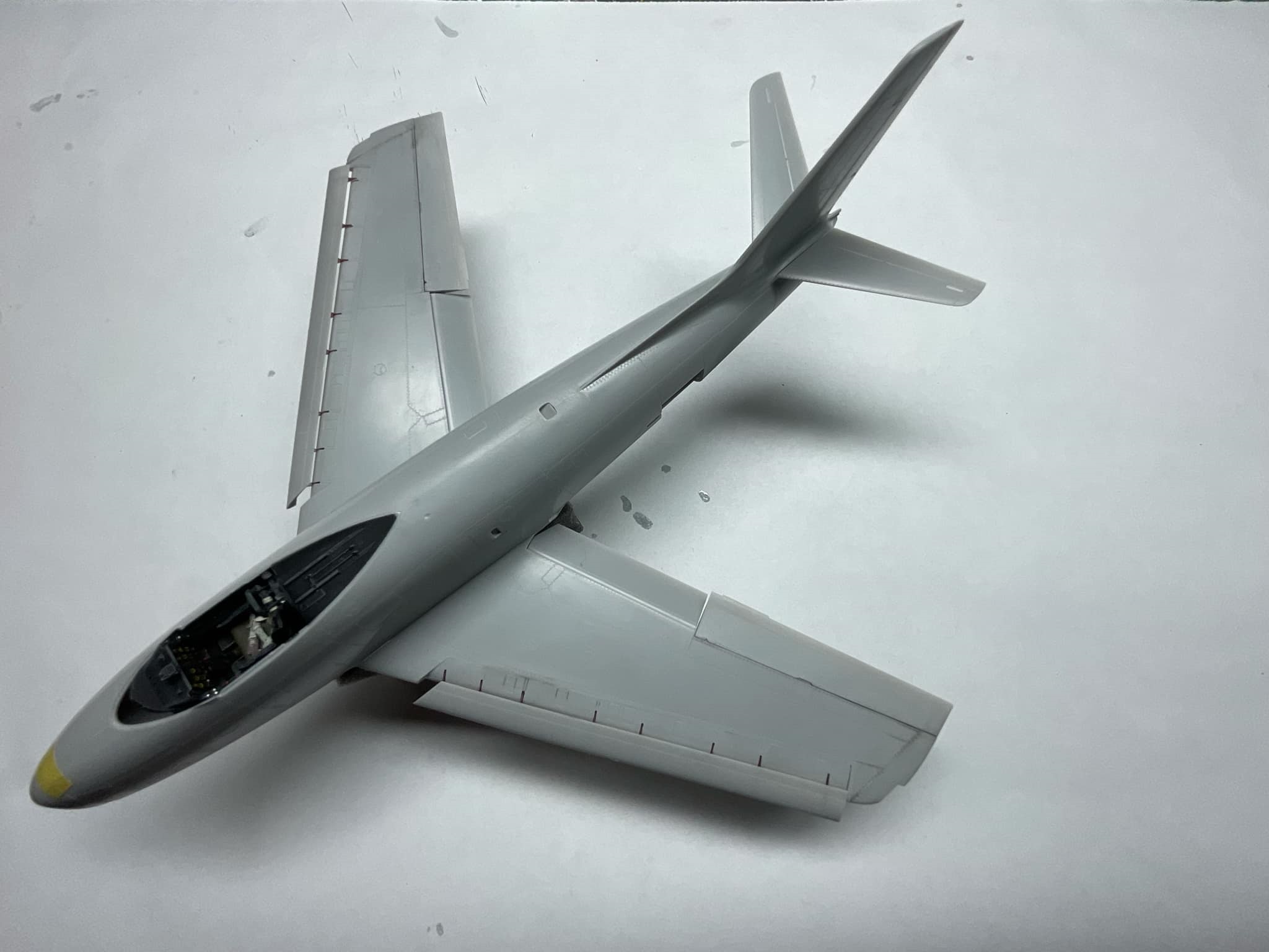

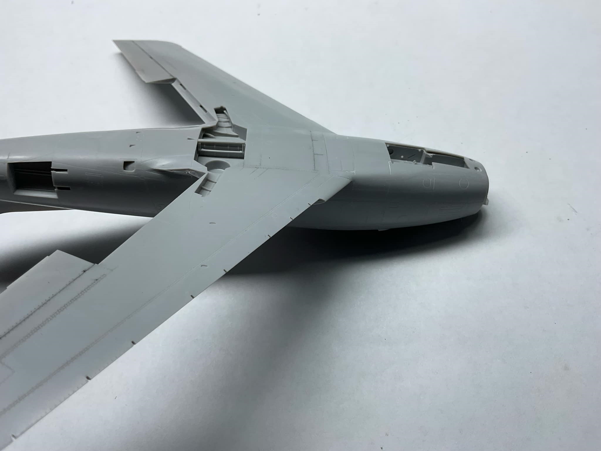

dai phan Posted November 18, 2024 Author Share Posted November 18, 2024 (edited) Howdy again, Continue on. The foward belly pan does not fit well. I had to sand the front gear tub in order for me to get the panel down. The panel was pivoting on it. The rear belly panel barely faired a little better. I had to use thin CA with accelerator to force things into place. The engineering on this kit really defies conventional and logical thinking. If you come across after market flaps, ailerons, rudder get them and do away with multi piece assembly that creates more work and does not add anything detail wise. One piece rudder, flaps makes way much more sense in my limited modelling skill. And for the love of God please do not end your seams on the SURFACE if you can please !!! This kit features the finest scale like surface details I have ever seen on a kit but sadly destroyed by unconventional engineering, I had to place back many rivets lost. Dai Edited November 18, 2024 by dai phan Quote Link to post Share on other sites

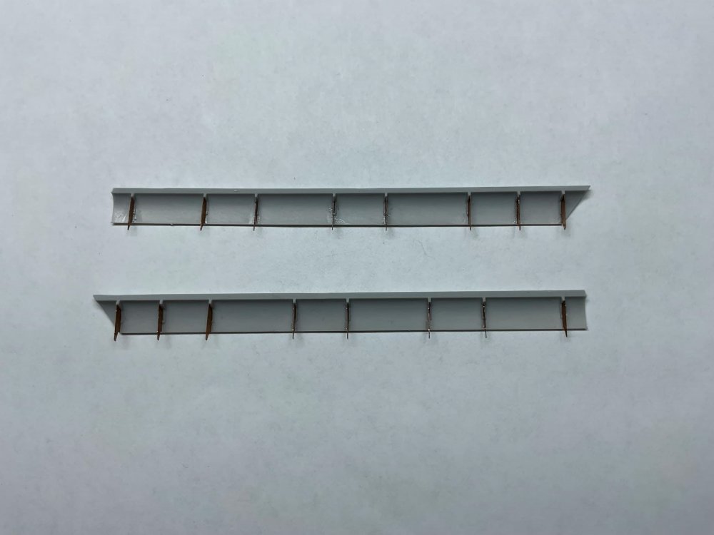

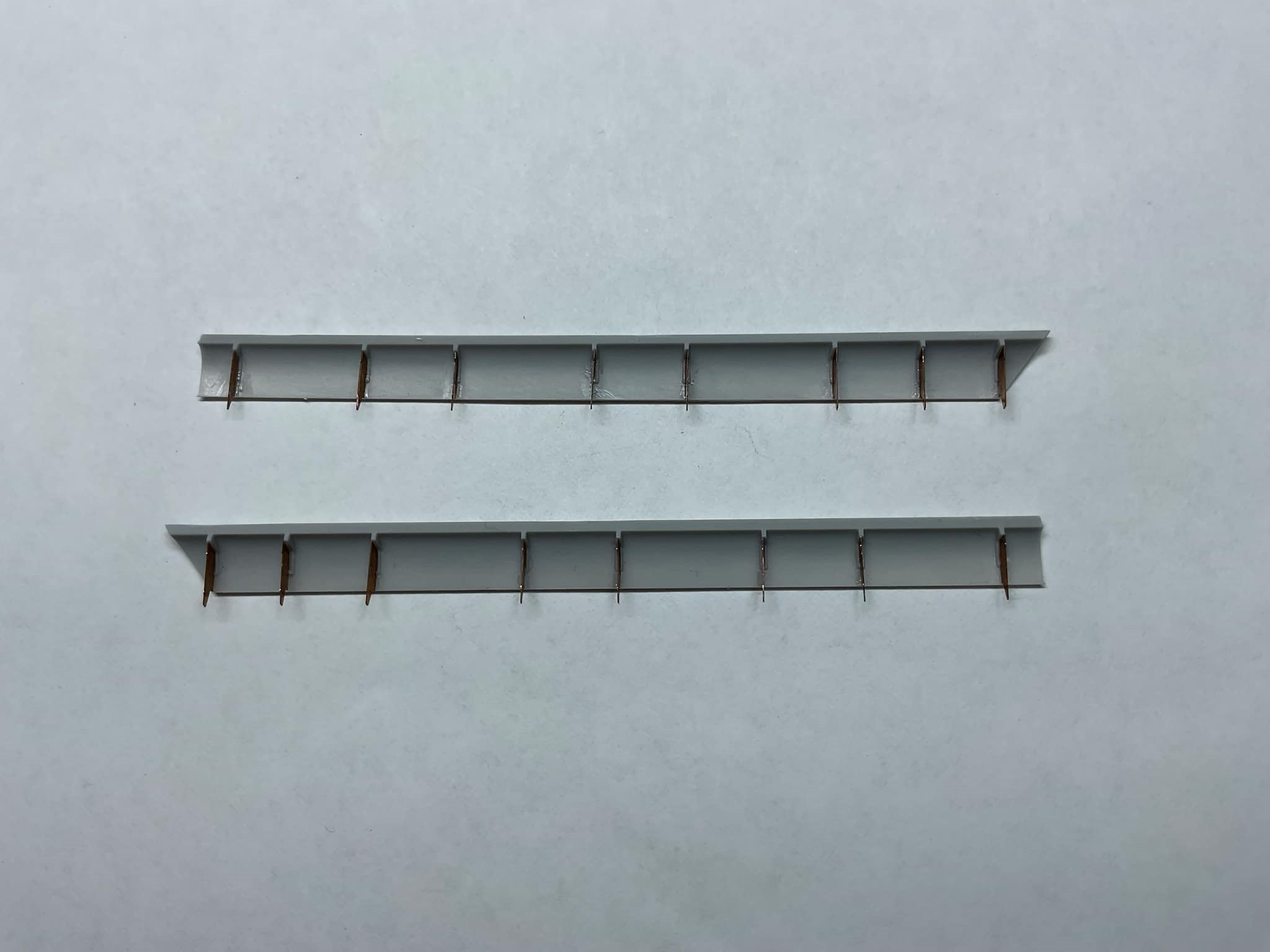

dai phan Posted November 19, 2024 Author Share Posted November 19, 2024 (edited) Yo all, I like the PE slat actuators. Will need to do some sandings around the PEs to remove excess CA before painting. I wonder if they are too thin for scale? Dai Edited November 19, 2024 by dai phan Quote Link to post Share on other sites

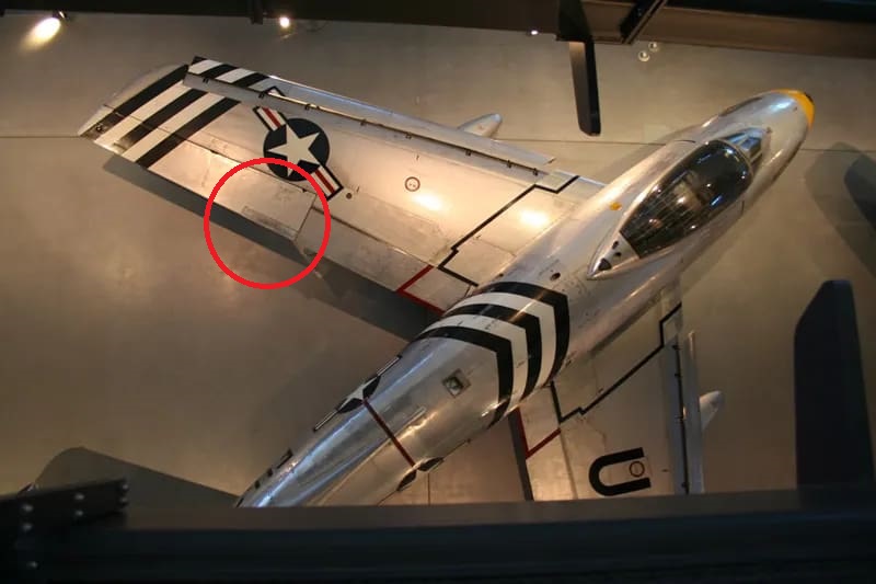

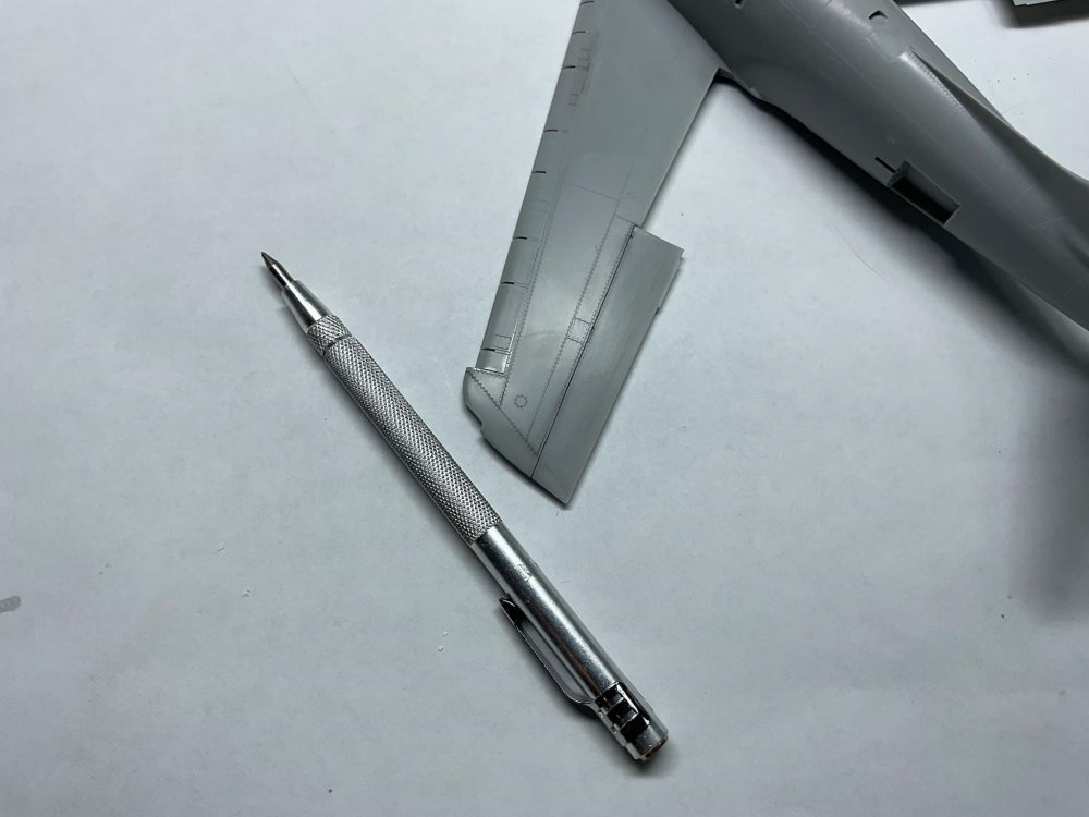

dai phan Posted November 20, 2024 Author Share Posted November 20, 2024 (edited) Hello all, Oddly the left aileron trim tab is missing on the kit. Perhaps the A5 version does not have one? Dai Edited November 20, 2024 by dai phan Quote Link to post Share on other sites

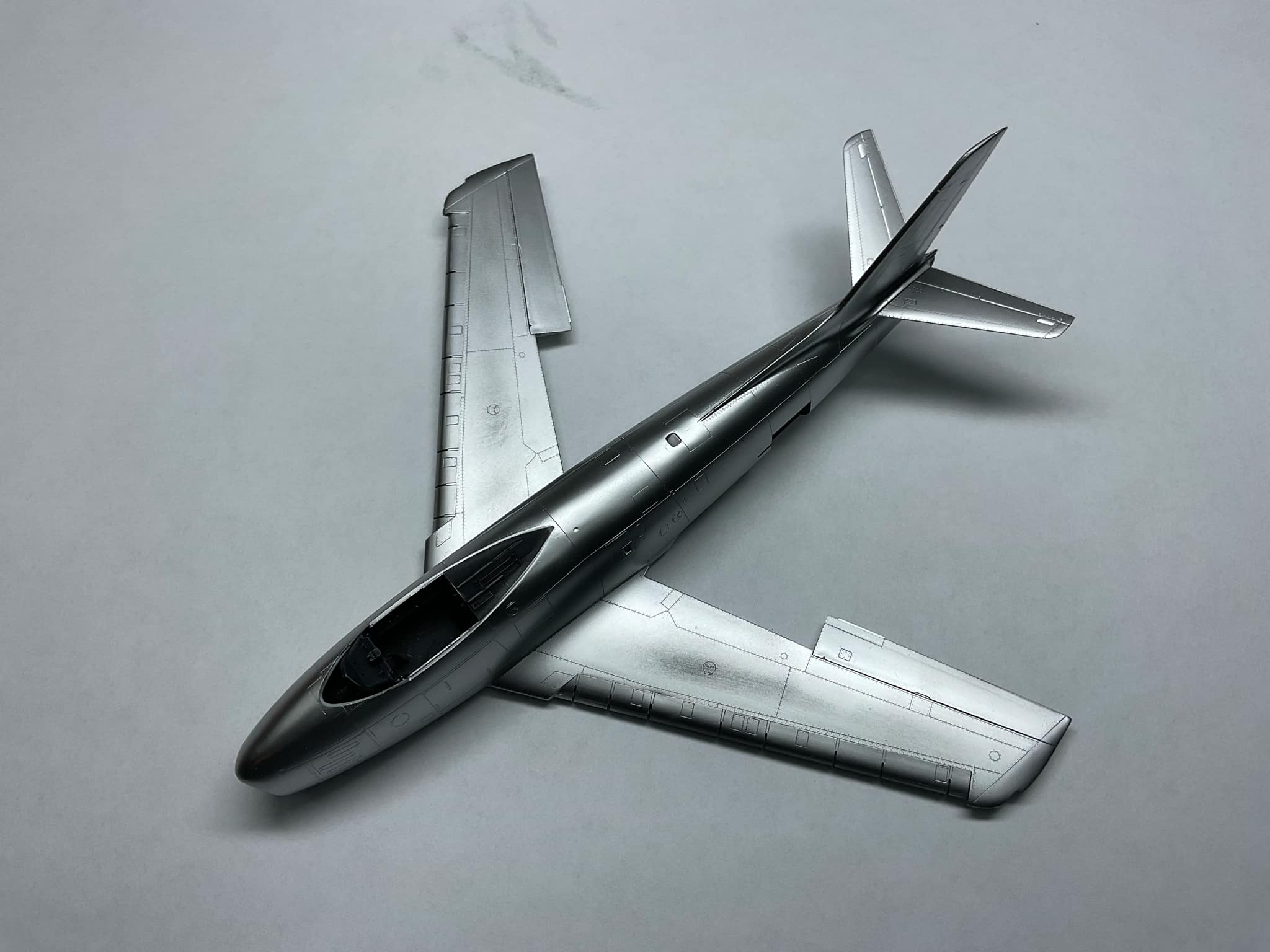

dai phan Posted November 20, 2024 Author Share Posted November 20, 2024 (edited) Some photos to depict tonal variations of the NMF. Dai Edited November 20, 2024 by dai phan Quote Link to post Share on other sites
dai phan Posted November 20, 2024 Author Share Posted November 20, 2024 (edited) Greetings, Someone also cut off the exhaust tube in order for the halves to come together like I did. I would cut off right before the speed brakes. He cuts too close to the exhaust and that will show the backing plate. On mine since it is so far down the fuse you cannot see any backing plate at all. The black circular thing is the backing plate painted back. Dai F-86A of the 94th FS - F-86 Sabre STGB - Britmodeller.com Edited November 20, 2024 by dai phan Quote Link to post Share on other sites

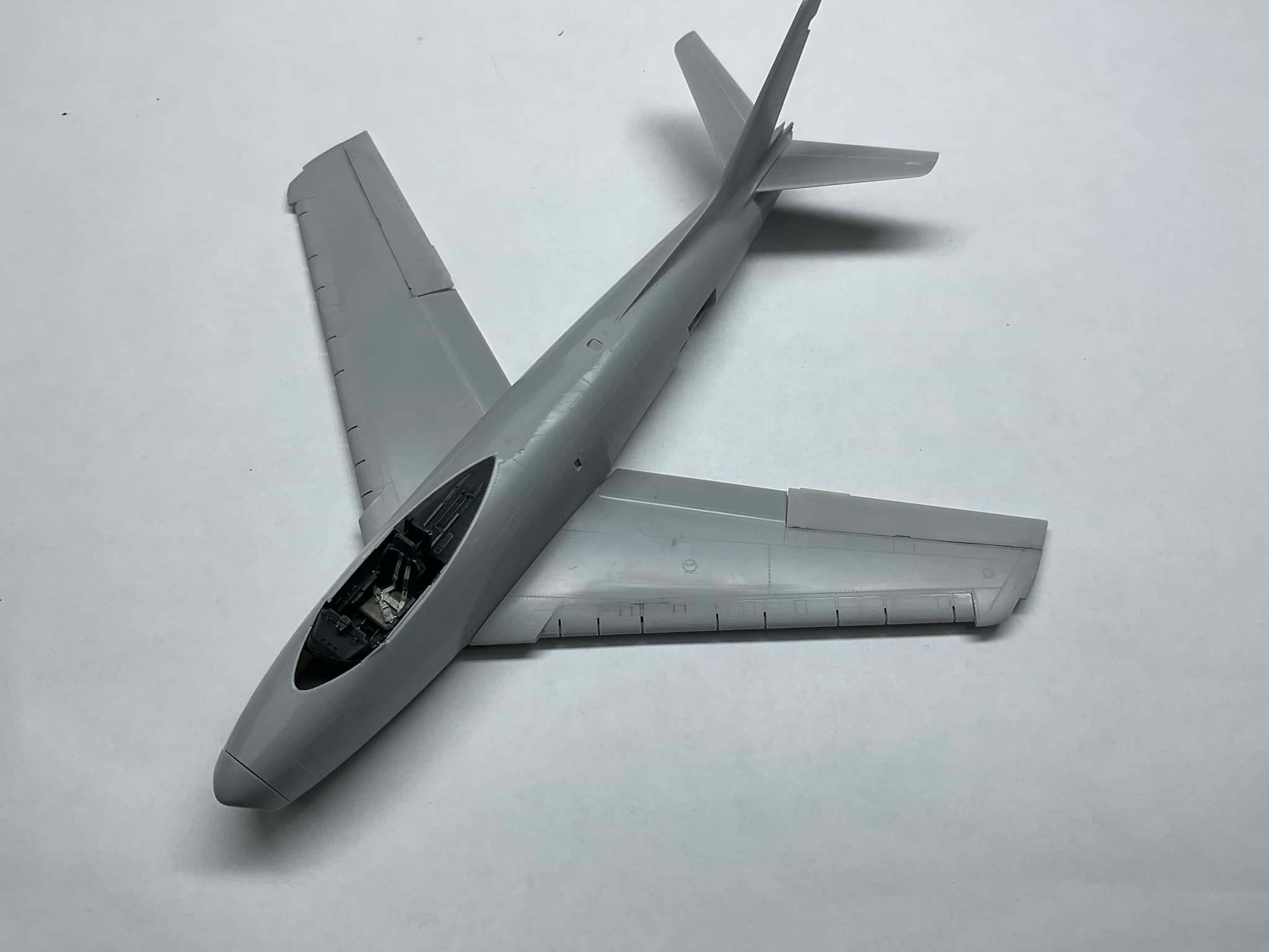

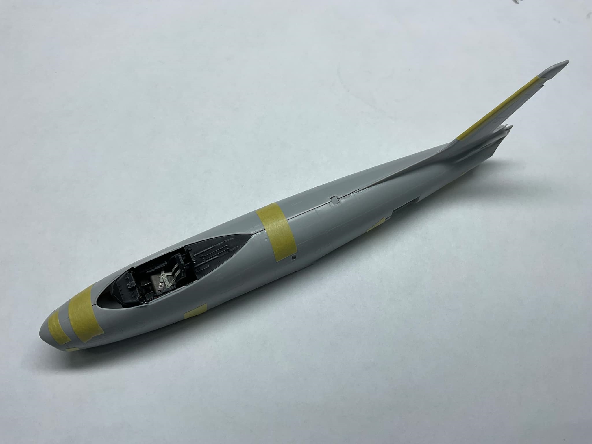

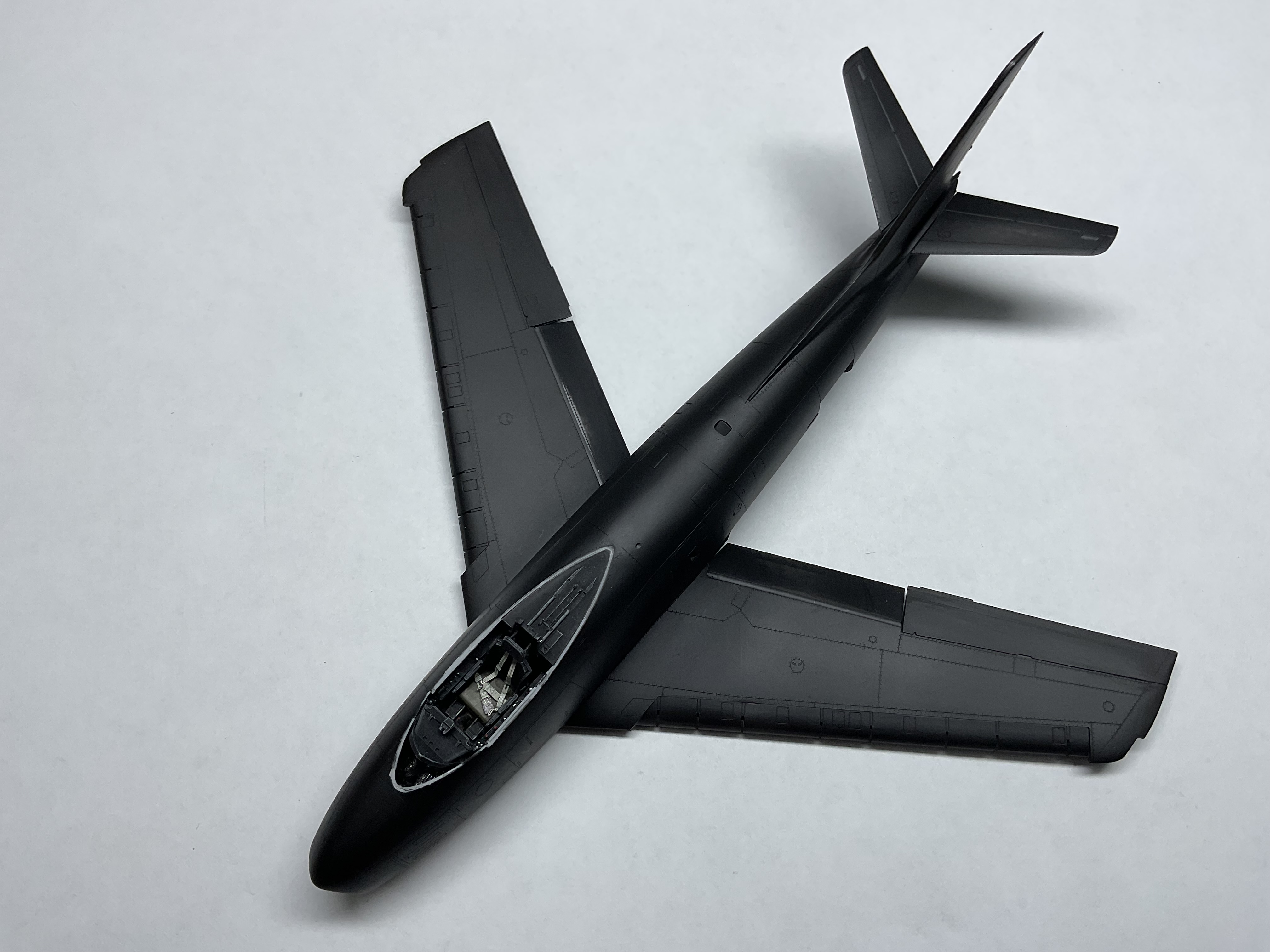

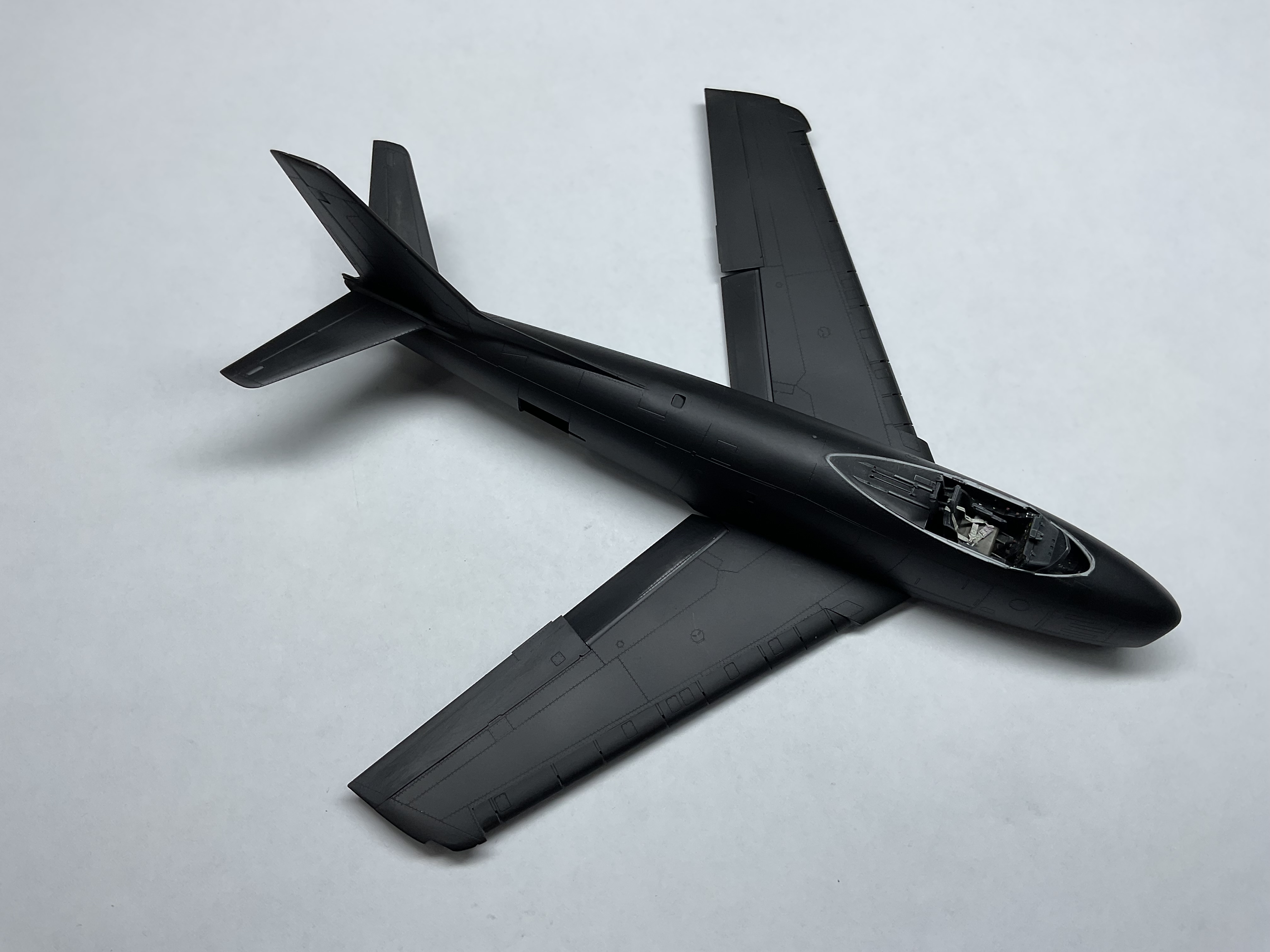

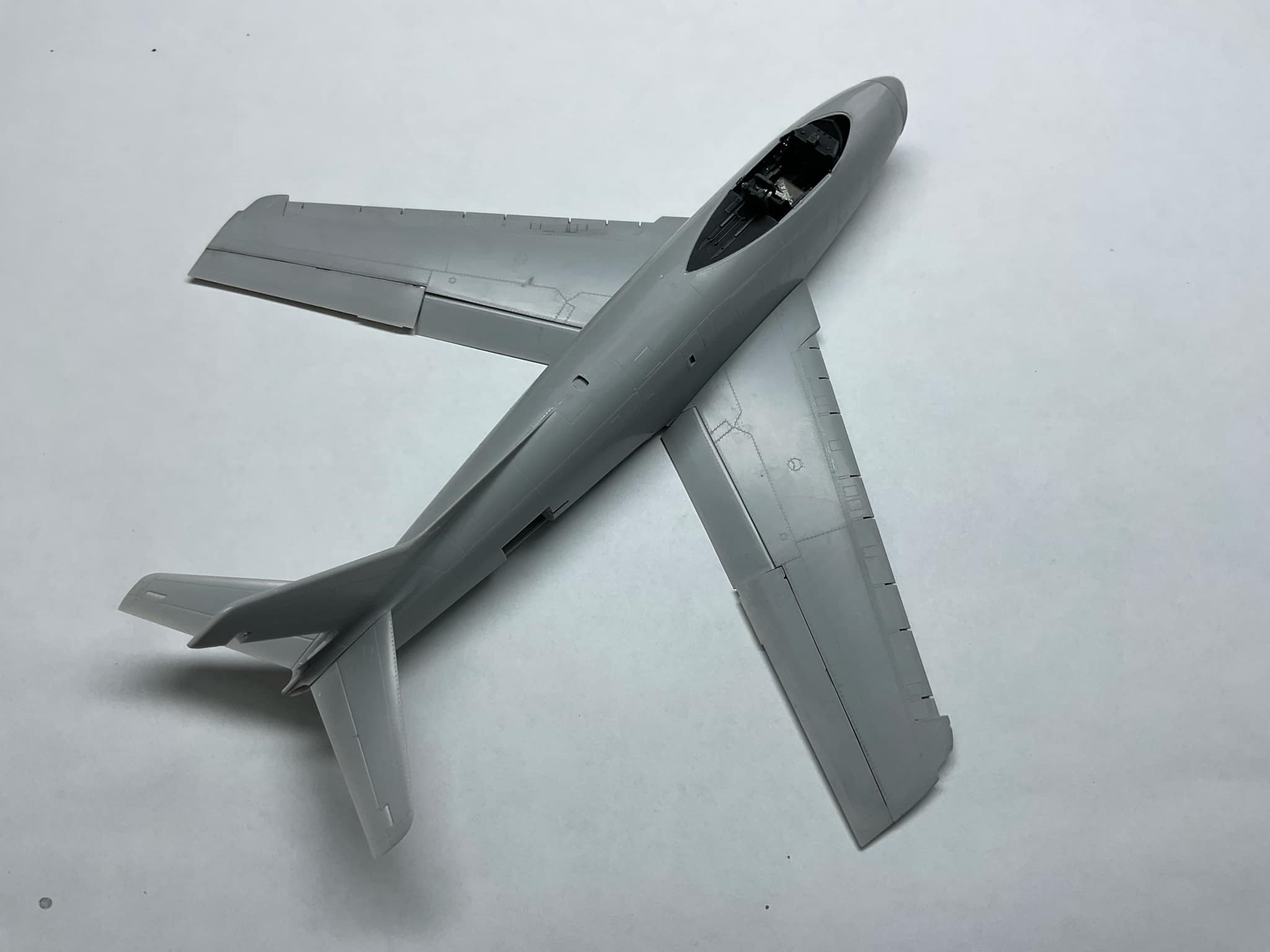

dai phan Posted November 21, 2024 Author Share Posted November 21, 2024 (edited) Hello all, Primed the model. Not much putty was used. Will need to rescribe some lost panel lines and replace missing rivets. Dai Edited November 21, 2024 by dai phan Quote Link to post Share on other sites
dai phan Posted November 29, 2024 Author Share Posted November 29, 2024 On 11/19/2024 at 9:34 PM, dai phan said: Hello all, Oddly the left aileron trim tab is missing on the kit. Perhaps the A5 version does not have one? Dai Hi all, My mistake. Make sure you install the aileron with the trim tab on the LEFT side! Dai Quote Link to post Share on other sites

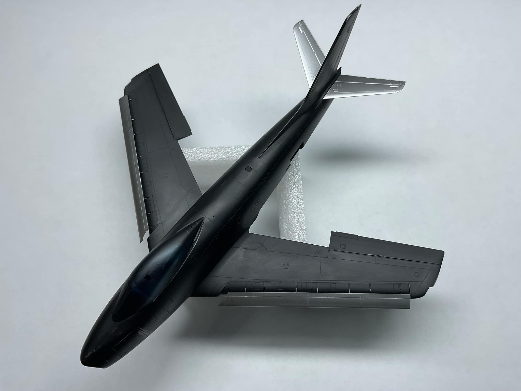

dai phan Posted November 29, 2024 Author Share Posted November 29, 2024 (edited) Happy Thanksgiving everyone... Started painting today. The PE slat actuators require extreme care when CA in place or you will end up with ugly cement joints. I had to go back (and will go back) with thin sanding sticks to smooth out all the joints. I think plastic actuators molded in the slats will do just fine. The MK6 has the resin actuators and I think they look better then the PE parts as I think the PEs are too thin for scale? Dai Edited November 29, 2024 by dai phan Quote Link to post Share on other sites

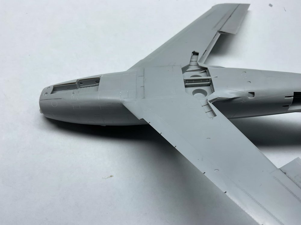

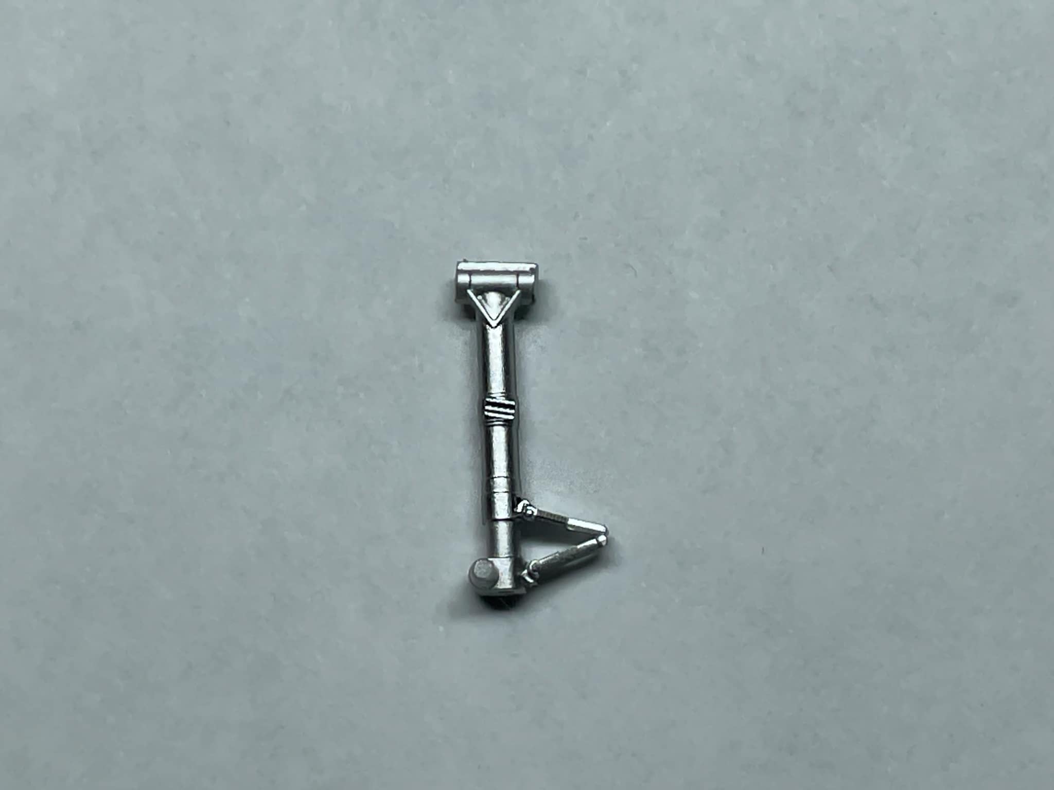

dai phan Posted November 29, 2024 Author Share Posted November 29, 2024 (edited) Greetings, I see the main landing gears have these large bars that is cemented into the wheel wells ( I had to trim in order to make them fit into the wells). With other areas being over engineered, I find it odd the main gears are under engineered. May be the A version landing gears have these "bar" features? Forgive me for my naieveness. Dai Edited November 29, 2024 by dai phan Quote Link to post Share on other sites

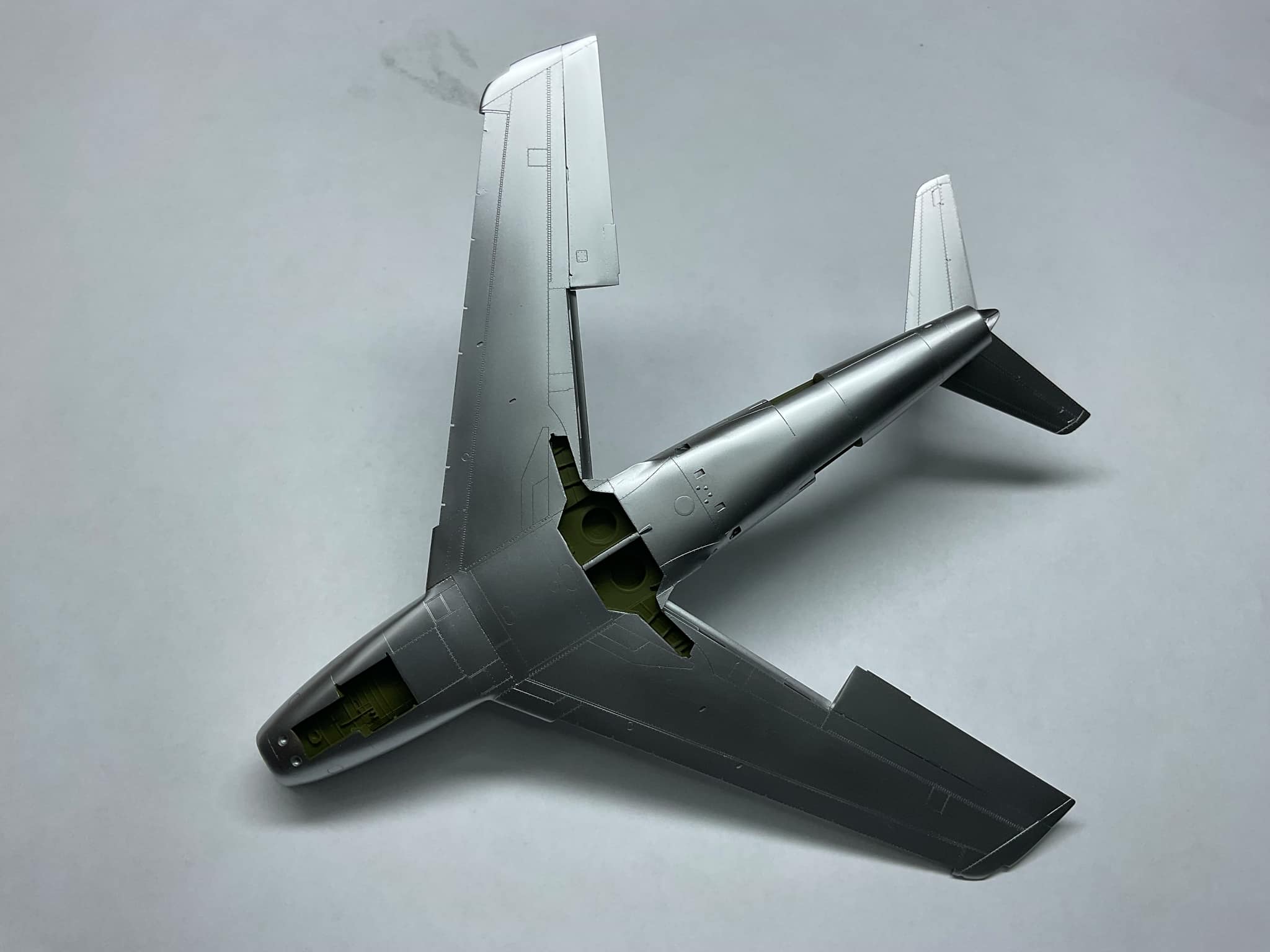

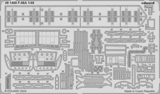

dai phan Posted December 2, 2024 Author Share Posted December 2, 2024 (edited) Greetings, Main color applied. I use Mr Color SM 201 with 70% thinner. Ordered Eduard PE set to add some additional details. Dai Edited December 2, 2024 by dai phan Quote Link to post Share on other sites
