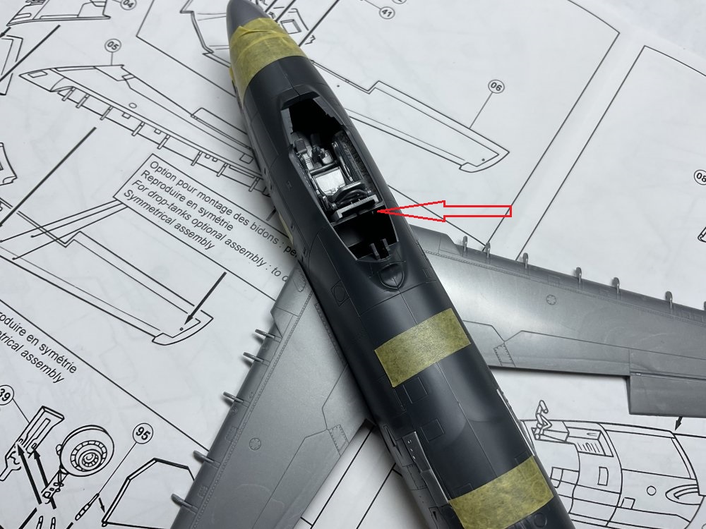

dai phan Posted July 14, 2024 Author Share Posted July 14, 2024 (edited) Greetings, You need to trim about .25 mm of the horizontal bar where it touches the seat to allow the cockpit tube to sit further back. The longer fuselage of the K version is evident in this photo. It should be noted the kit is the Monogram kit rather than the Revell kit. Maybe Monogram had a surplus of these kits and that is why they let MH use them? Dai Edited July 15, 2024 by dai phan Quote Link to post Share on other sites

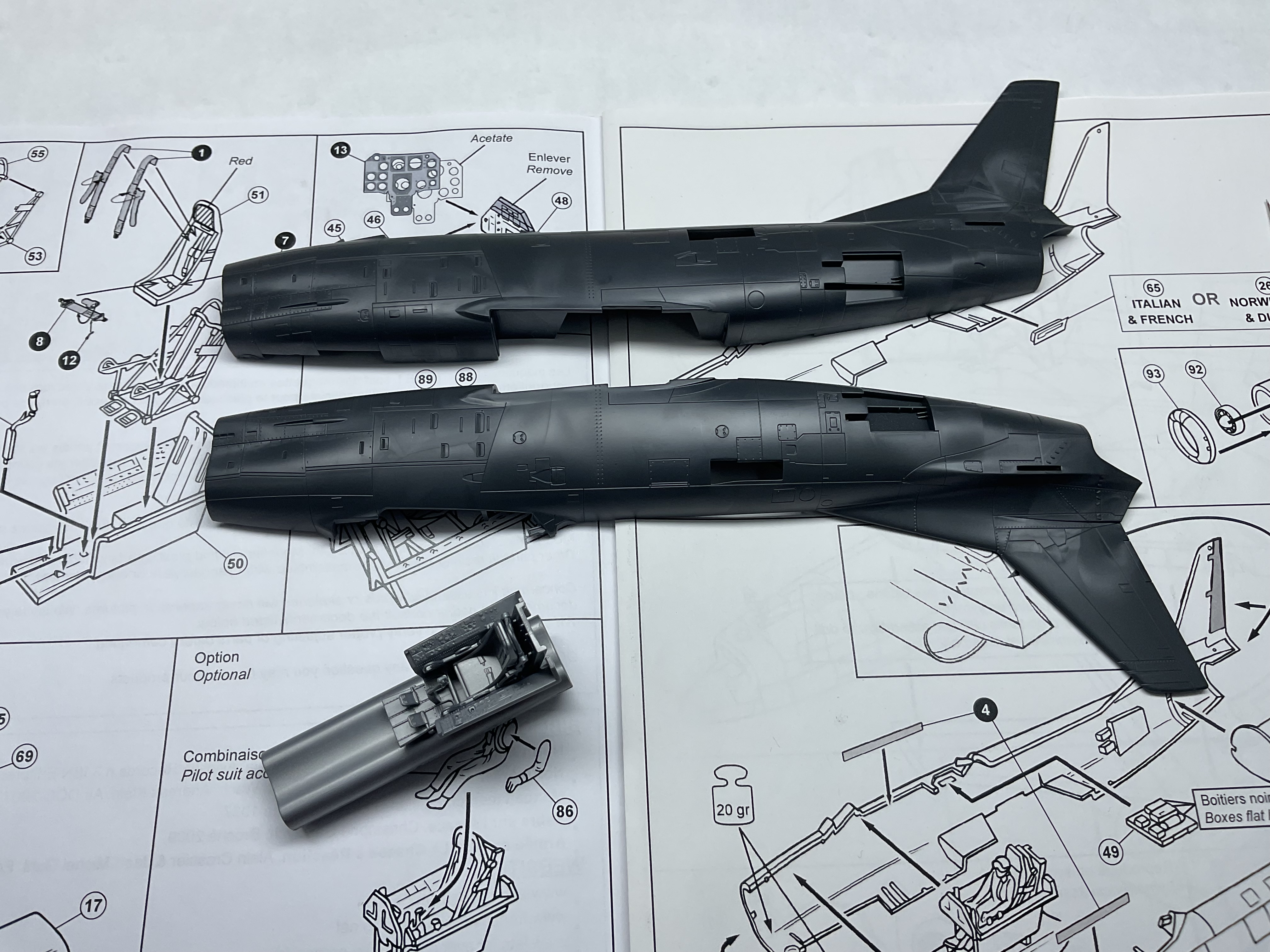

dai phan Posted July 15, 2024 Author Share Posted July 15, 2024 (edited) 1 hour ago, GeneK said: That's an excellent (and complete) conversion kit ... much better than the other conversions like the resin fuselage from Italian Kits, or the complete kit from Special Hobby. Thanks for the lead to finding the kits on HobbyLink Japan. Mine will sit alongside my original kit from 2012 (as dated on the decals). Are the fuselage halves molded in black or have you primed it? Looking forward to following your build! Gene K The color is dark green. Yes I will prime the whole model in black if I choose to do the NMF. Or I may do the Luftwaffe version to compliment with my F-86 MK 6. If I choose the latter, I will have to install the raised scoops. Nothing is glued in so I still have options. Just to let you know the later releases of the MH, the kit comes with German markings. Dai Edited July 15, 2024 by dai phan Quote Link to post Share on other sites
dai phan Posted July 16, 2024 Author Share Posted July 16, 2024 (edited) Hi all, Work a little bit on the cockpit tonight. Unlike the R/M kit, the fuselage does not have the tabs where the IP is glued to. Dai Edited July 16, 2024 by dai phan Quote Link to post Share on other sites

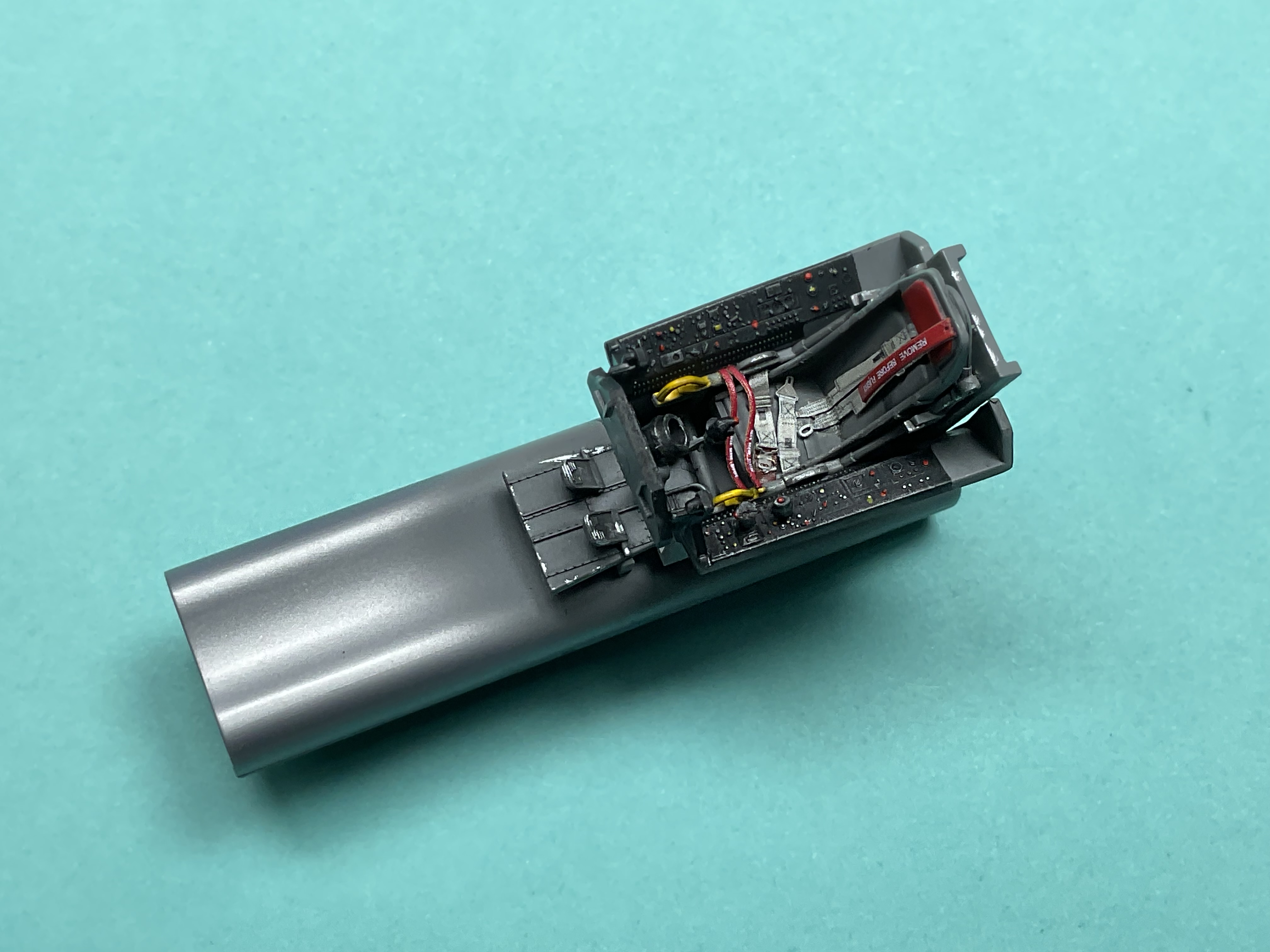

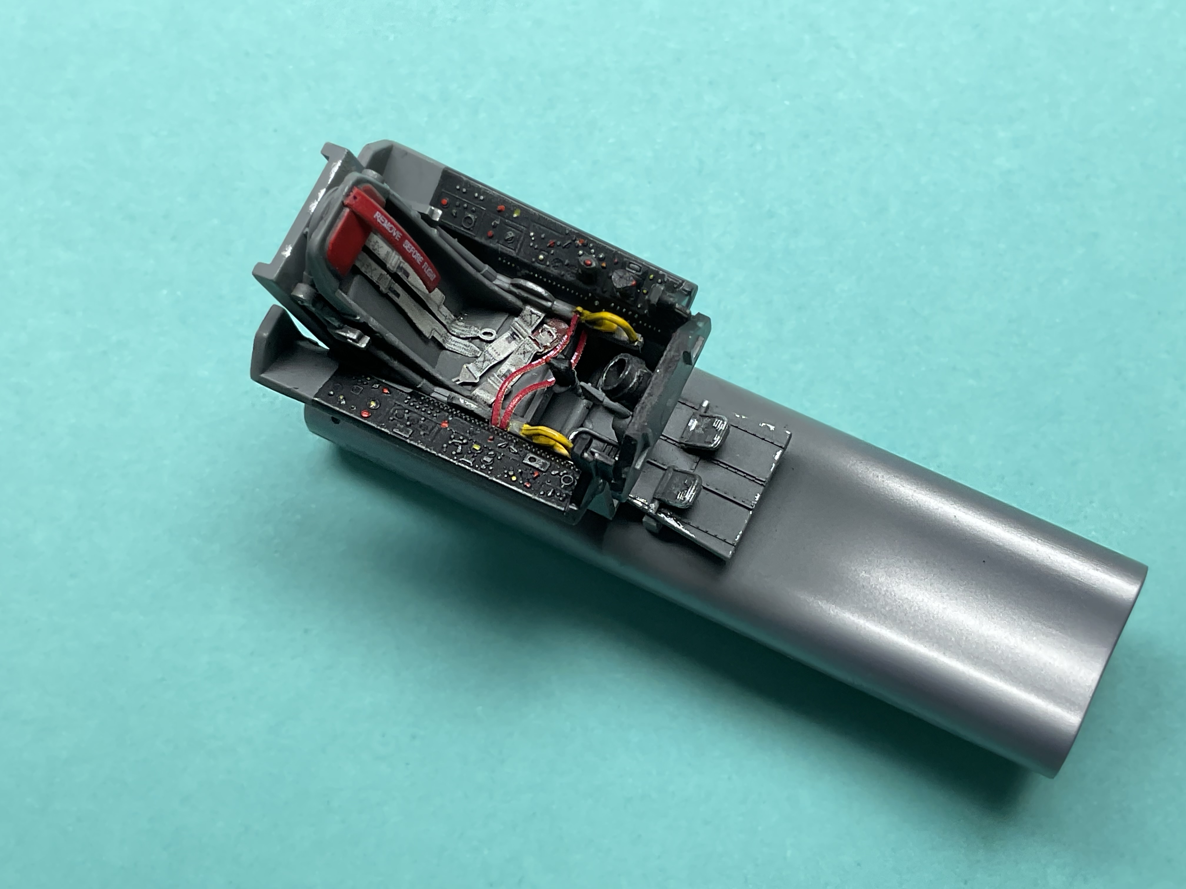

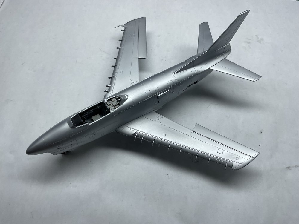

dai phan Posted July 19, 2024 Author Share Posted July 19, 2024 (edited) Hi all, Working on the cockpit today. Everything is OOB except for the seat belts and warning tags. I tried to take a photo of the IP but could not get clear shots. You need to trim .25 mm of the horizontal bar to allow the cockpit tub to sit in the proper position. Dai Edited July 24, 2024 by dai phan Quote Link to post Share on other sites
GeneK Posted July 19, 2024 Share Posted July 19, 2024 Looks great, Dai! What is "the horizontal bar"? Gene K Quote Link to post Share on other sites

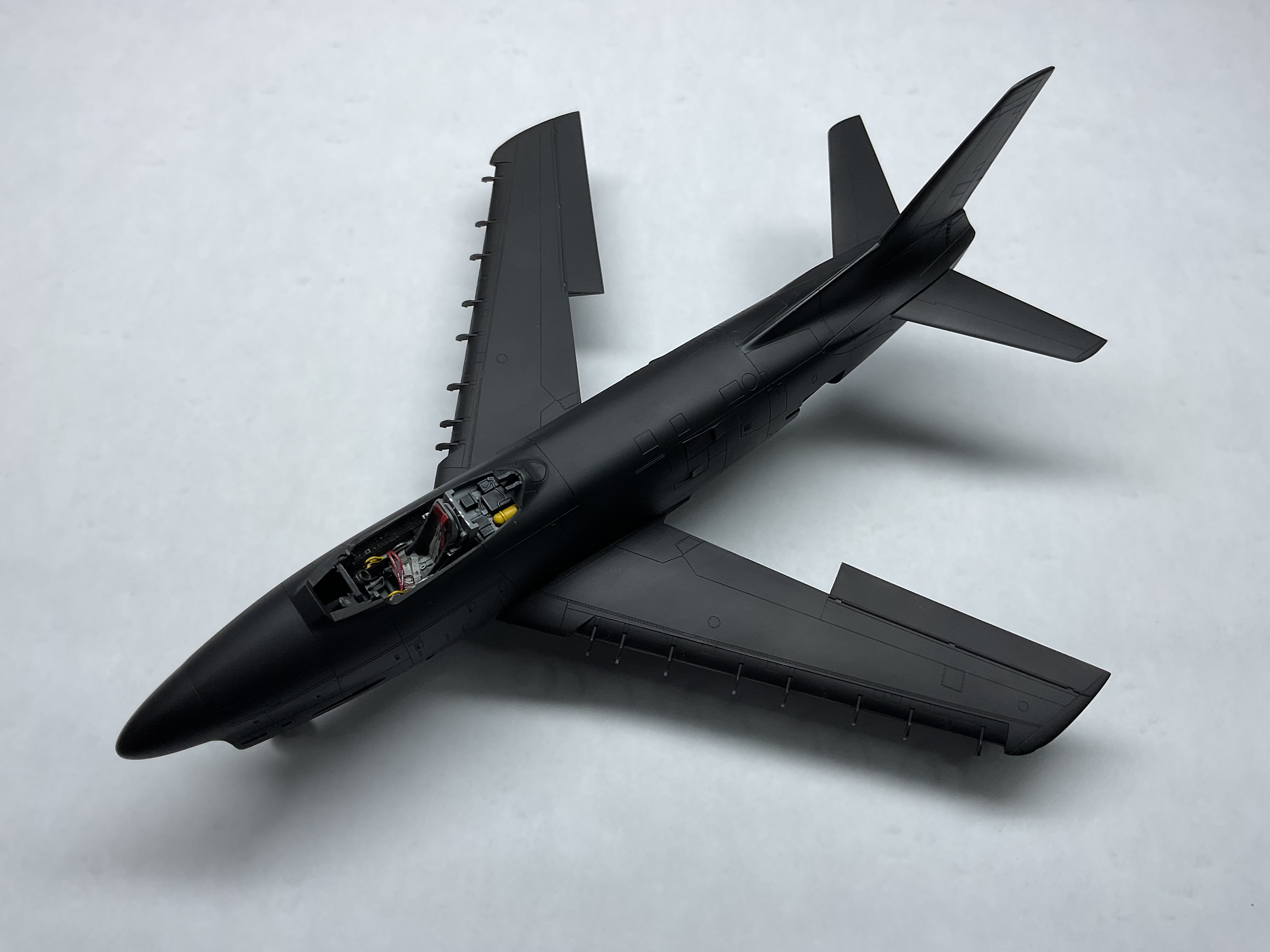

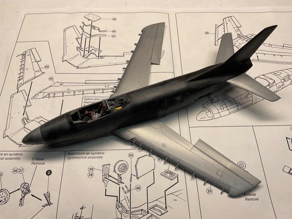

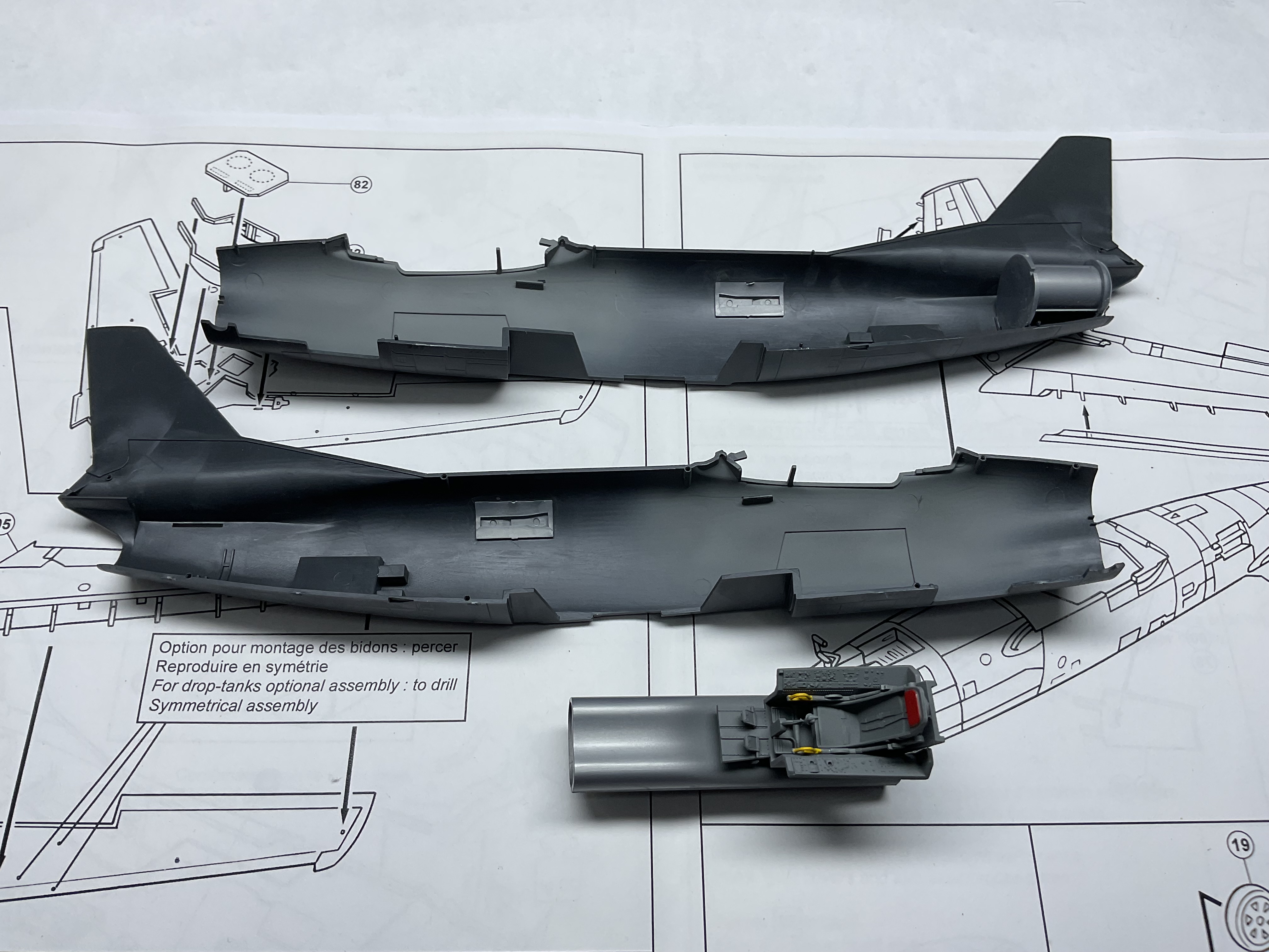

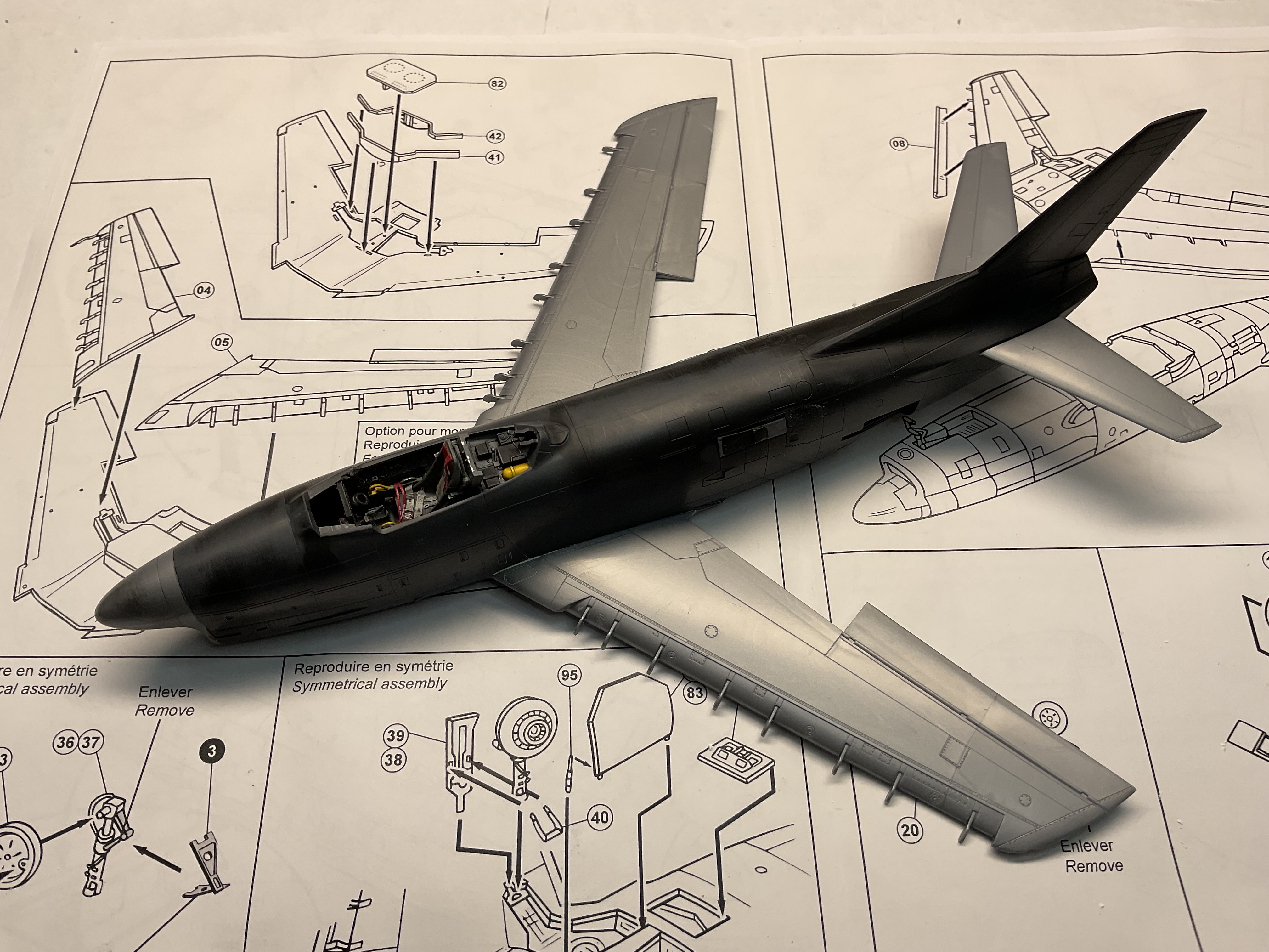

dai phan Posted July 20, 2024 Author Share Posted July 20, 2024 (edited) Howdy, The plane is coming together and the fit is not as good as the Monogram tooling. Some putty work is needed although minor. The gun channels should extend all the way to the intake lip rather ending at the intake panel line. MH should have modified the Monogram intake or make their own. Expert modelers should make this modification. I leave it alone because I know I will butcher if I try. The resin IP hood is way undersized so I will take the one from Revell kit and modify to account for the shortened IP. The side fuselage vents when installed should be flushed and smooth with the fuse outside so there should be a small gap from the inside. If you push all the way to make the parts touch the inner side of the fuse you will have the intakes stick way out like a sore thumb on the outside. Dai Edited July 20, 2024 by dai phan Quote Link to post Share on other sites
dai phan Posted July 20, 2024 Author Share Posted July 20, 2024 On 7/19/2024 at 6:24 PM, GeneK said: Looks great, Dai! What is "the horizontal bar"? Gene K The bar behind the seat. Trim .25 where it touches the seat to allow the cockpit to sit further back or the front wheel well will not line up the cut out. Dai Quote Link to post Share on other sites

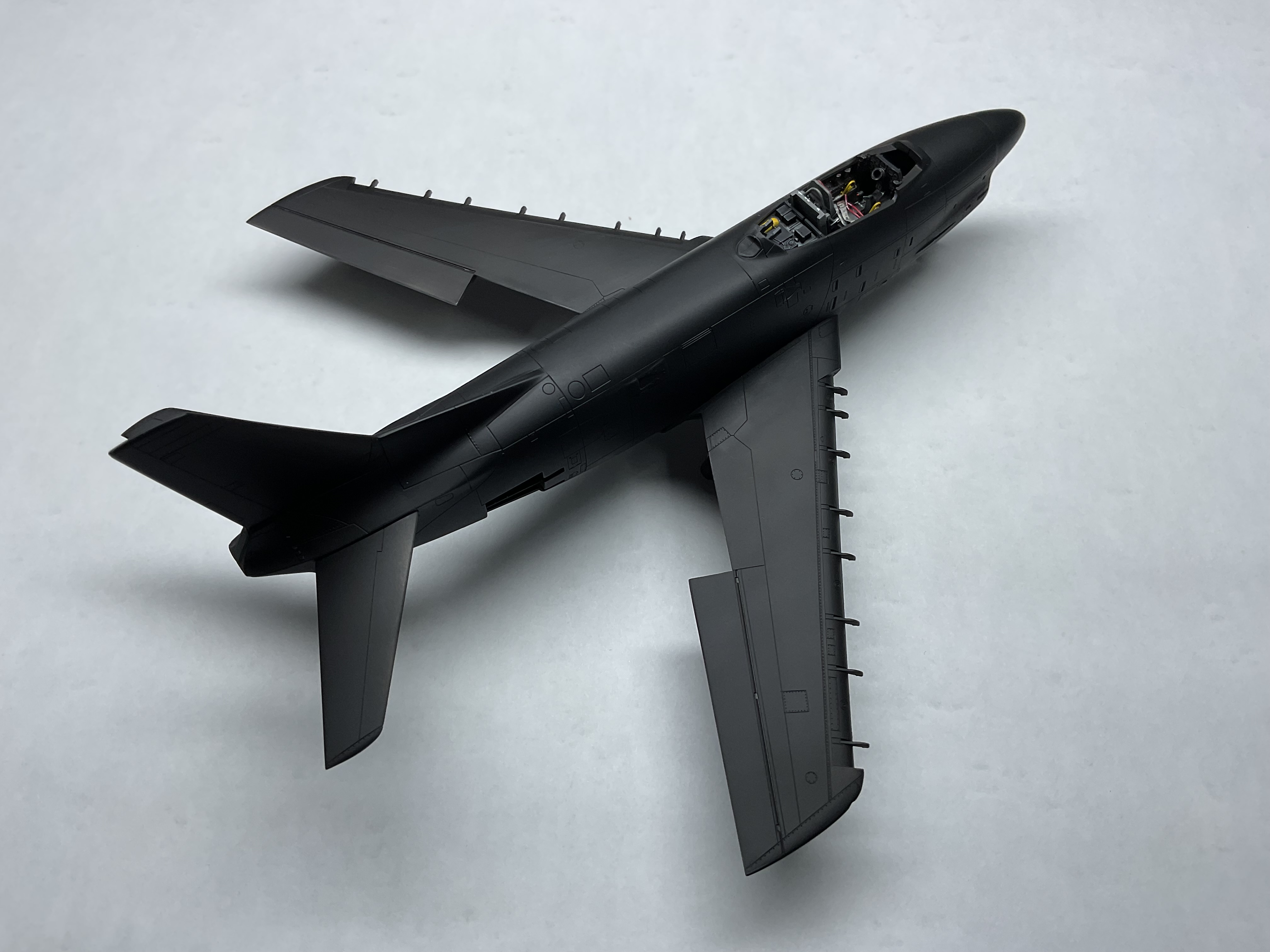

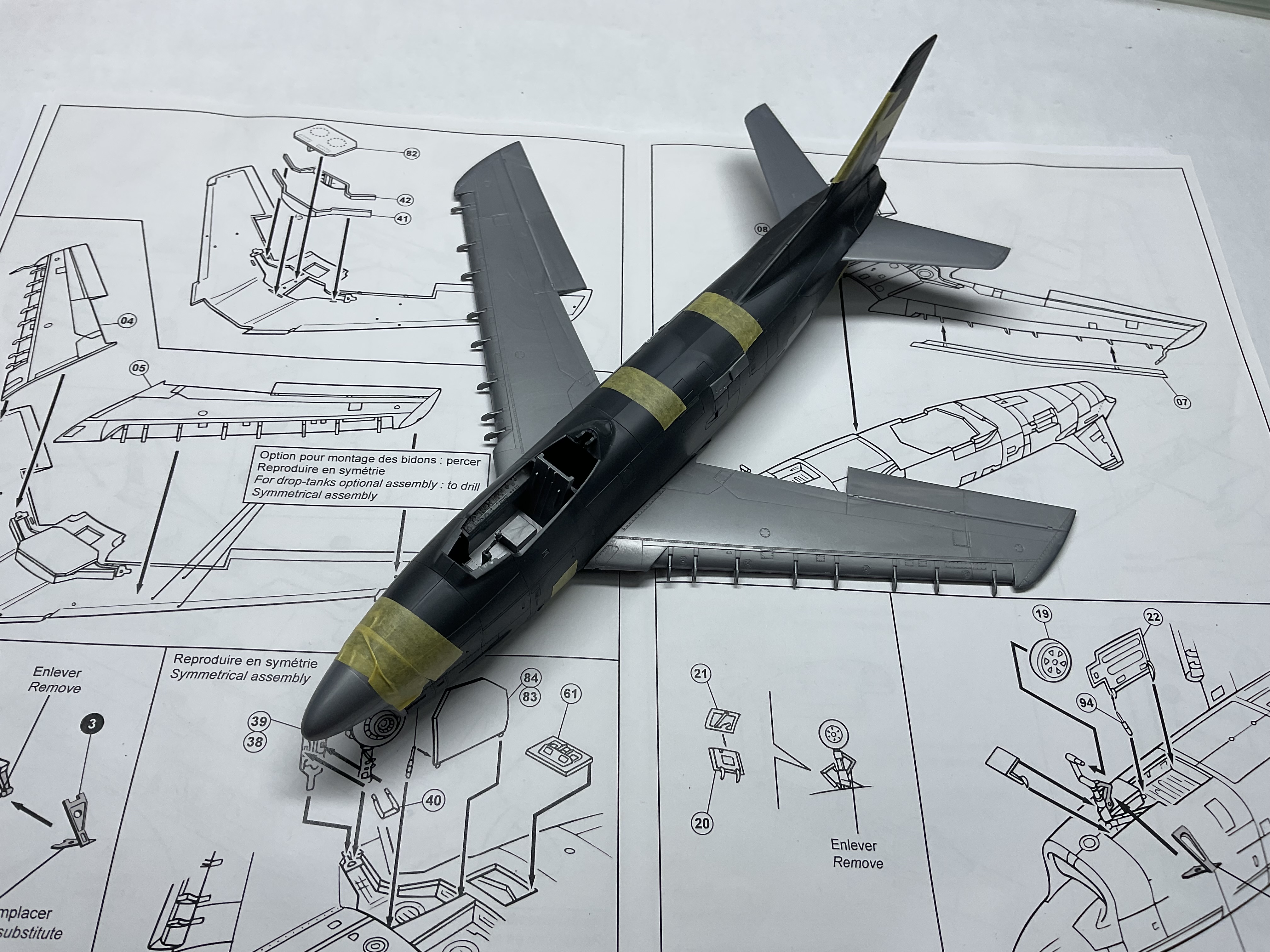

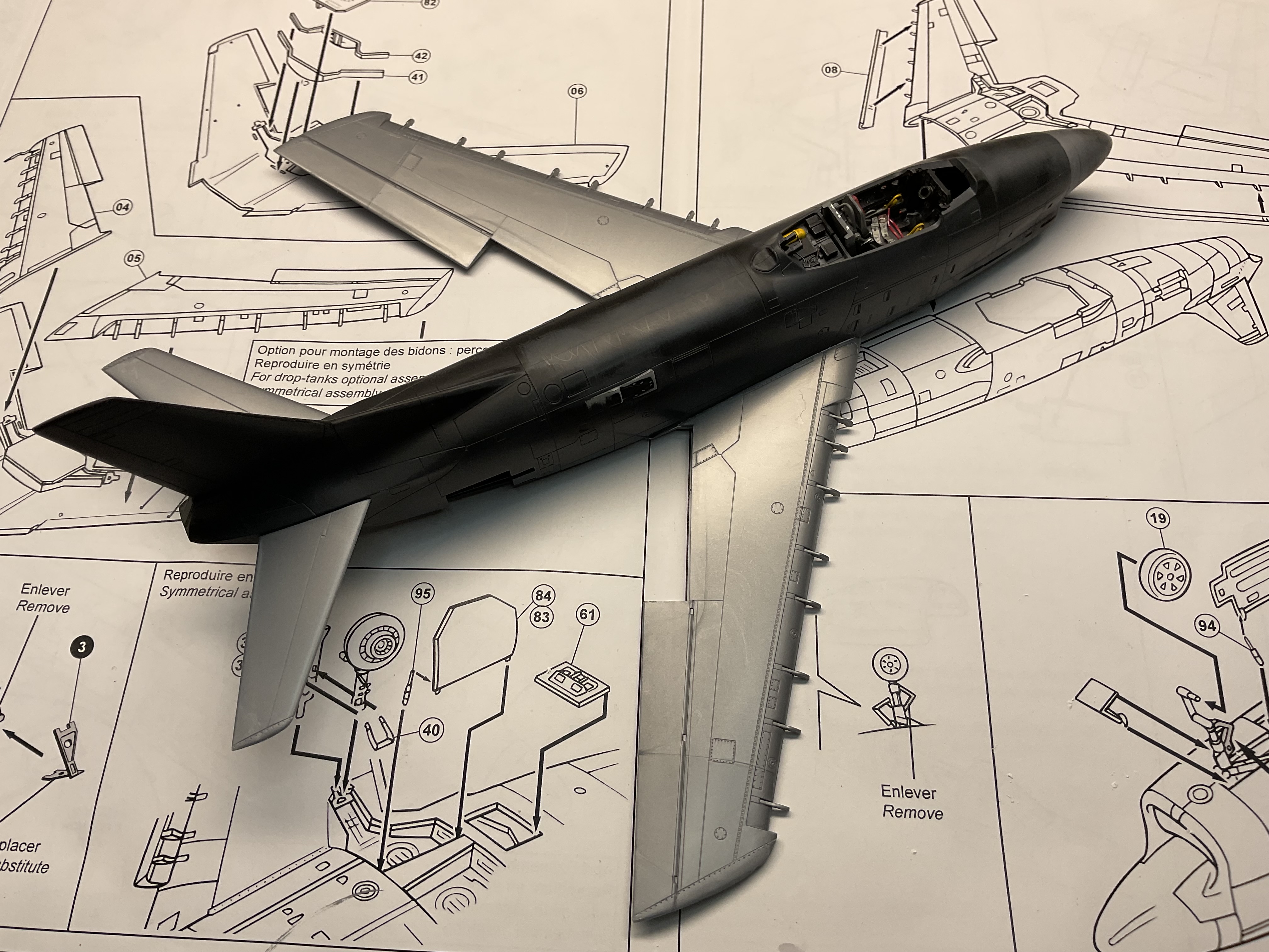

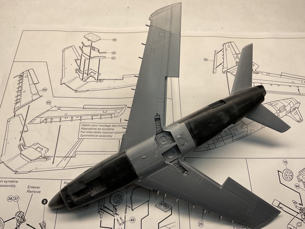

dai phan Posted July 21, 2024 Author Share Posted July 21, 2024 (edited) Hello all, The plane is primed with Mr Surfacer 1500 black. Much more correction work than the R/M offering. The nose does not fit welll to the fuse (slightly smaller in diameter) requiring putty and lots of clean up. The fuse width is wider in the the canopy area so if you plan to install the canopy closed, some filing is needed. To save the trouble keep it open. The cut outs for the speed brakes are slightly bigger than the brakes. To save the trouble, keep them open. Still this is way bettter than the Special Hobby kit or the old resin upgrade. Dai Edited August 20, 2024 by dai phan Quote Link to post Share on other sites
