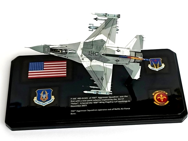

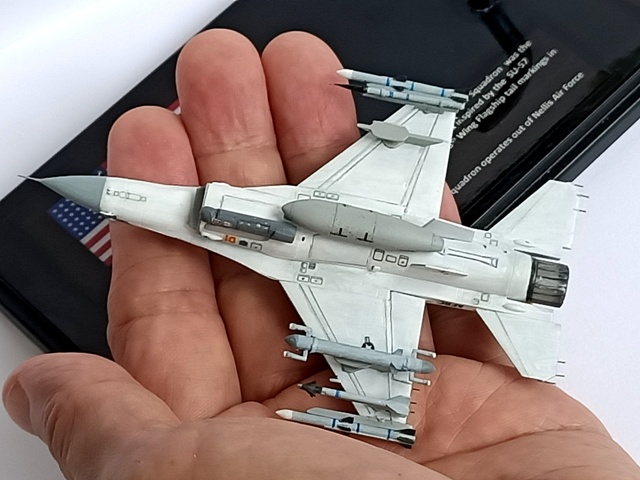

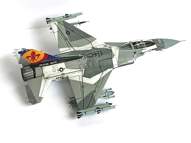

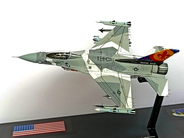

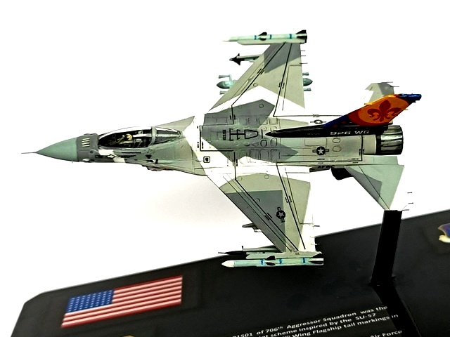

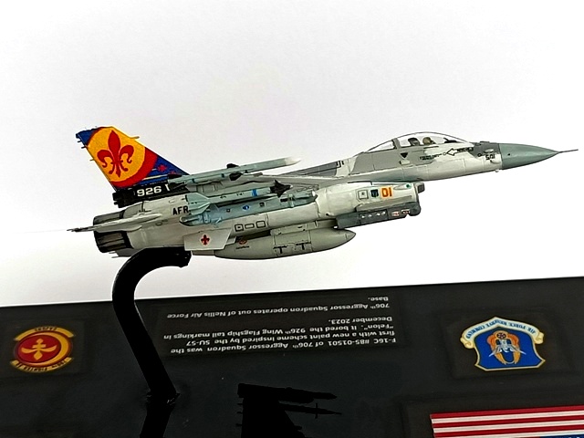

S K Loh Posted July 4, 2024 Share Posted July 4, 2024 This is a 1/144 Trumpeter F-16 A/C Block 15/30/31 kit. While the molding were crisps with good panel lines it suffers from the lack of weapon stores although pylons were provided saved for the two drop tanks. Also the NLG door was molded onto the fuselage that I had to remove and use plastic strip to fill in for in-flight build. Some amount of filling and sanding on the underside is necessary. As usual I added the pilot and some details to beef up the cockpit area. I was exploring a more current marking instead of the kit's decal which offered three older schemes. I remembered fellow ARCer Waco posted some info on a new scheme F-16C 706th Sqn Agressors some time ago. I did more search on this and I decided to try my hand at making my build based on the flagship 926th Wing Group #85-1501. The stores carried by this bird was the main draw in building it. I was able to find 2 x AIM 120, 1 x CATM Aim-9 scratch-builds from my spares box. However, I had to scratch-built 1x ACMI pod, 1x AN/ALQ-167 Angry Kitten ECM pod and 1 x AN/AAQ 14 targeting pod to make it as what I saw on photo of the 926WG bird. Then I added the bird slicer IFF antennas. Replaced the wingtip AIM-9 launcher 16S210 with scratchbuilt AIM120 LAU-129 launcher . Added the RWR on the leading edge of main wing. Added in the AOA and pitot as well as the static dischargers on the main wing and horizontal stabs ( only the tail rudder had them molded-on) The paint scheme is basically emulates that of the SU-57 Felon. It was when applying the decals that I realised that the fin fillet extension was a little too long. Has to trim off about 1.5mm of it. Overall was quite happy with the build and finished. Enjoy the photos. Incidentally Happy Independence Day to all fellow American ARCers! Best regards, S K Loh Quote Link to post Share on other sites
