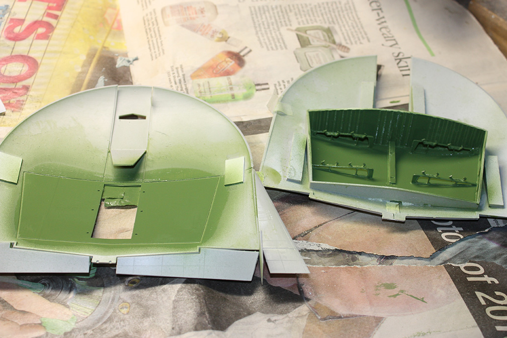

SpacecraftGuy Posted August 3, 2024 Author Share Posted August 3, 2024 (edited) Okay, however many mintues have passed since last post. Started by spraying the Mission straight from the bottle. Went on perfectly and evenly. Part of some modeller's problems with certain paint might be their airbrushes. I used my 40 year old Badger 200 to spray the bomb bays of AMP's North American L.R.V. (a pretty cool kit if you're into oddball spacecraft). I have Paasche and Iwata airbrushes, too, but my 200 would spray sand. Airbrushes were never designed to spray model paints. They were designed to spray artists paints and inks. Model paints are way closer to sand than ink. The better the airbrush, the more trouble it'll have with many model paints or broad coverage. I'm not an instant convert to Mission yet. First I have to figure out what the heck I can use to clean the airbrush. Whenever I use a new paint, I'm reminded of the Gahan Wilson cartoon of the boy on the corner selling lemonaide for 5 cents a cup, and the other boy around the corner selling the choking man the antidote for $5 a cup. Same with model paints. First you innocently buy the new paint. They they try to sell you all the thinners, cleaners, flow improvers, enhancers, etc. to make them work. Didn't bother to sand or dust the remains of the Vallejo from the parts below before I tested. I'll sand and dust before I paint them properly. Edited August 3, 2024 by SpacecraftGuy Quote Link to post Share on other sites
