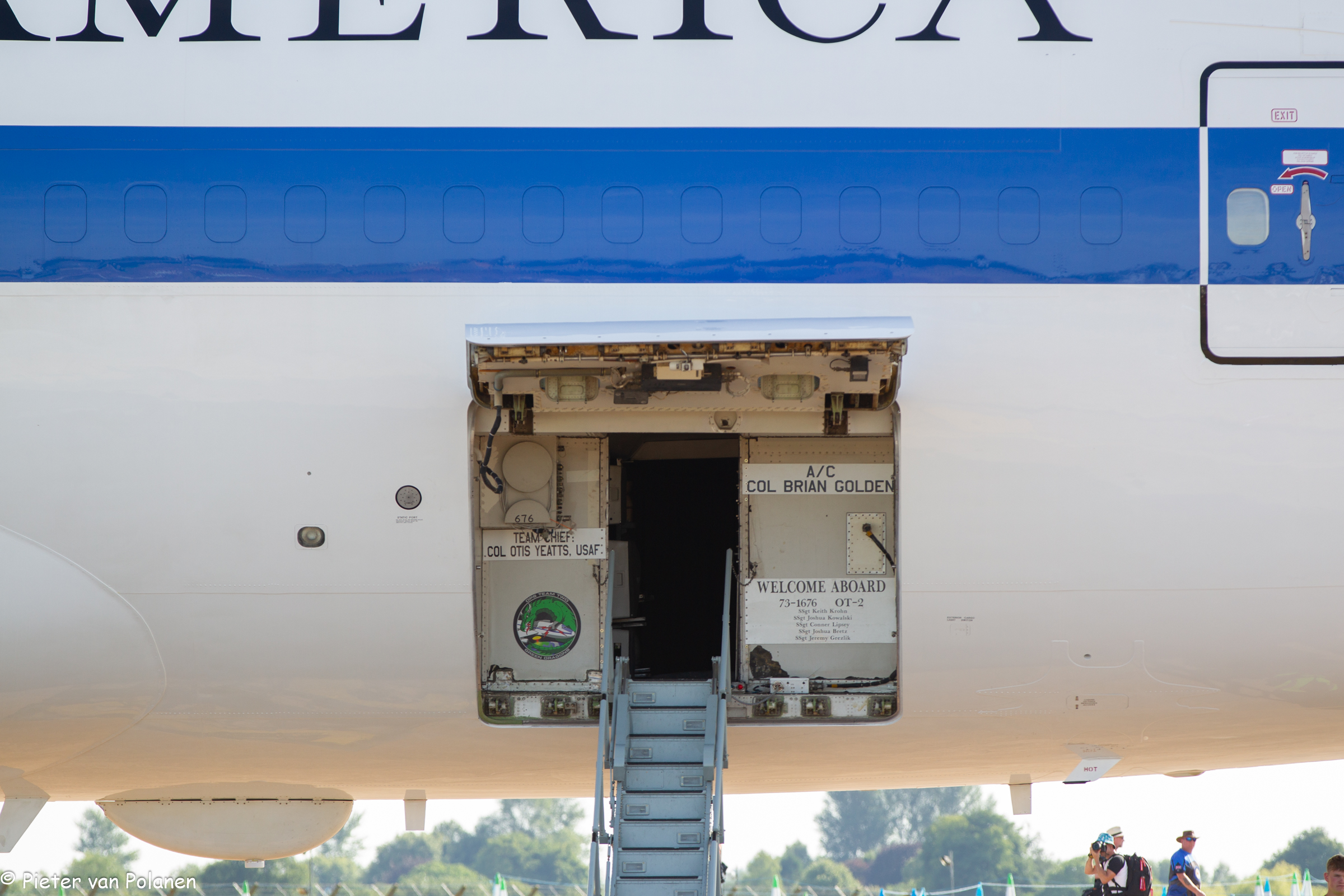

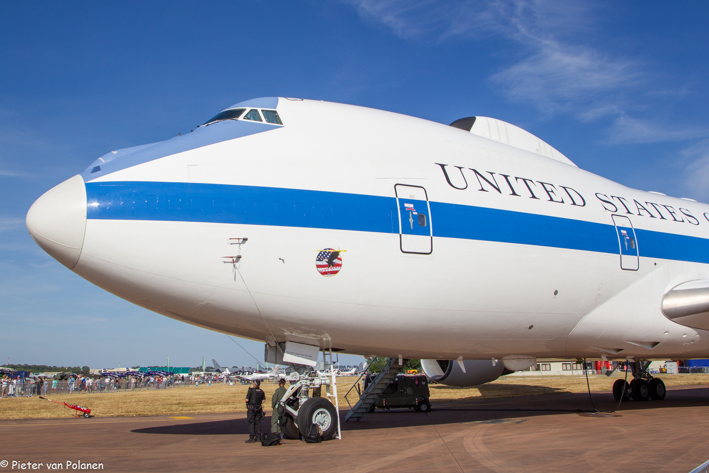

Pieter Posted August 9, 2024 Share Posted August 9, 2024 (edited) This E-4B s/n 73-1676 was in the static at RIAT 2022 I hope this pictures I took are useful Edited August 9, 2024 by Pieter Quote Link to post Share on other sites
