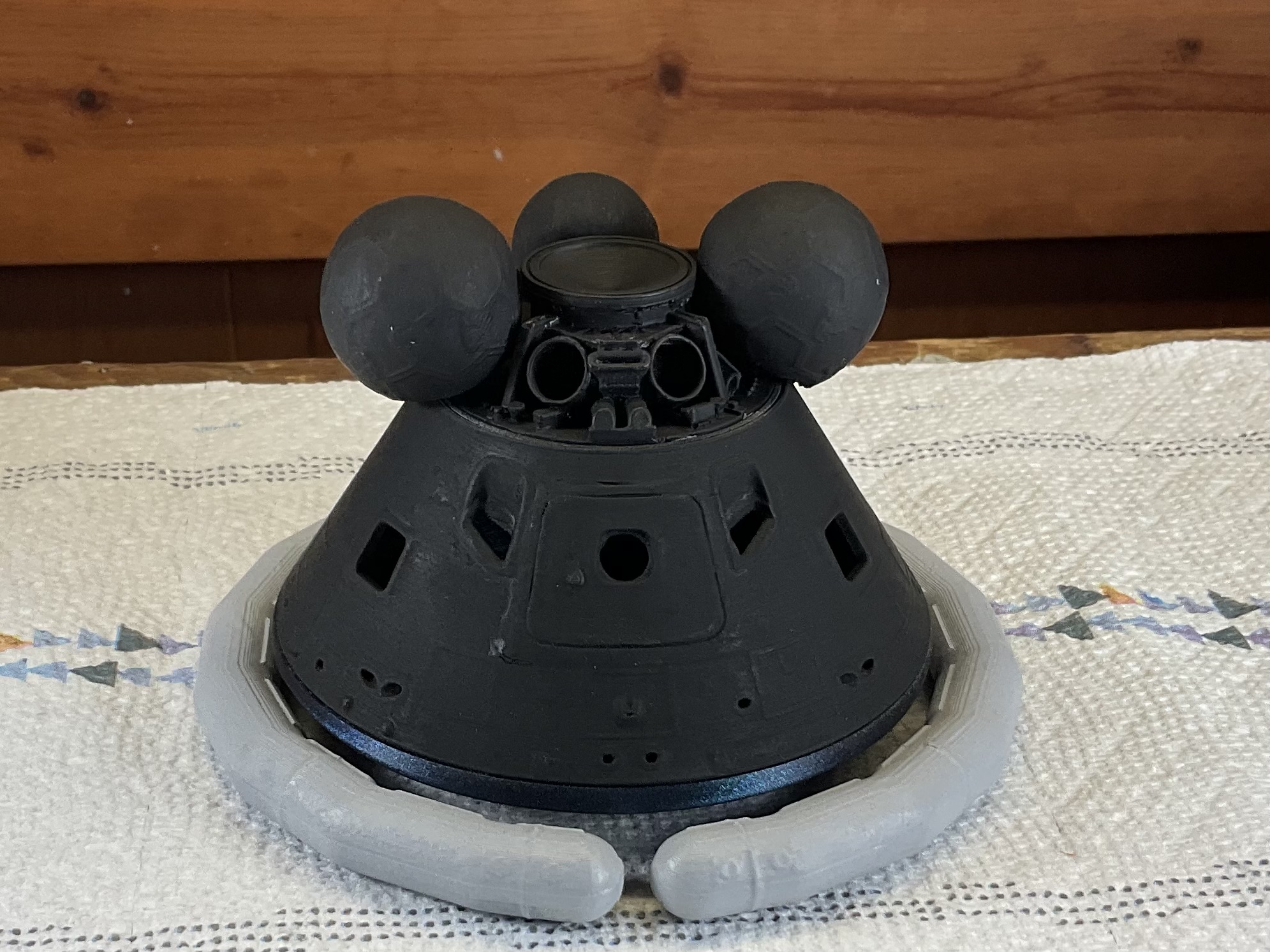

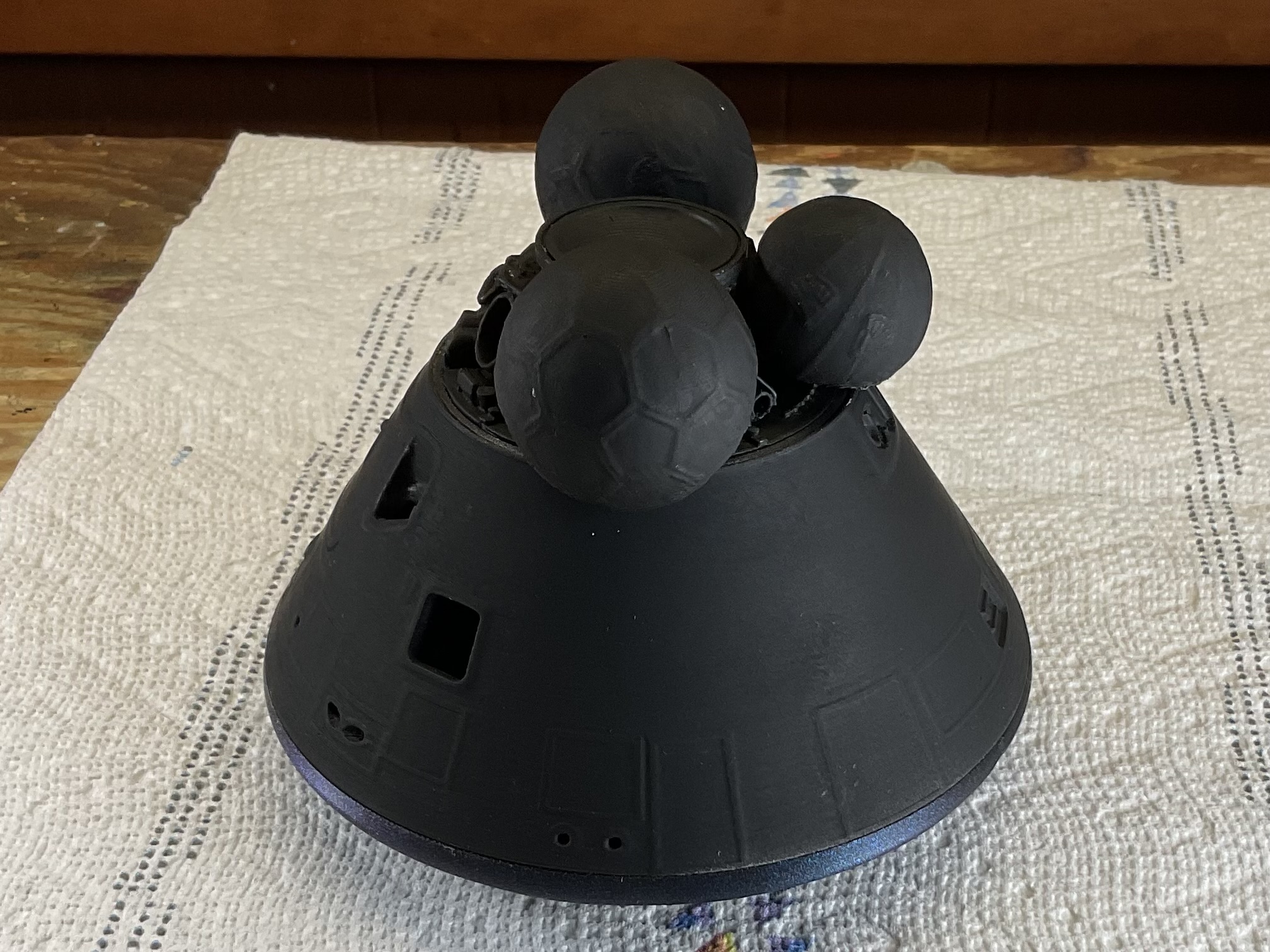

snichols Posted August 24, 2024 Share Posted August 24, 2024 (edited) With the recent demise of Shapeways it prompted me to venture into 3d printing so this will be my first build using my new filament printer . I have recently found some amazing footage provided by John Wolfram the UDT frogman who led the team on this recovery mission that I’d never seen up until this point. This was printed using Vincent Meens files available on cults3d and he recommends using a resin printer for his models so now that I’ve printed these parts with a filament printer I have to agree and I’ve ordered one of those too. The CM is pretty much smooth enough now to start covering but a bit more sanding is in order. Finding frogmen in this scale turned out to be difficult but I believe I’ve found a solution. Pre shading has started so it’s difficult to see any detail. Edited October 8, 2024 by snichols Quote Link to post Share on other sites

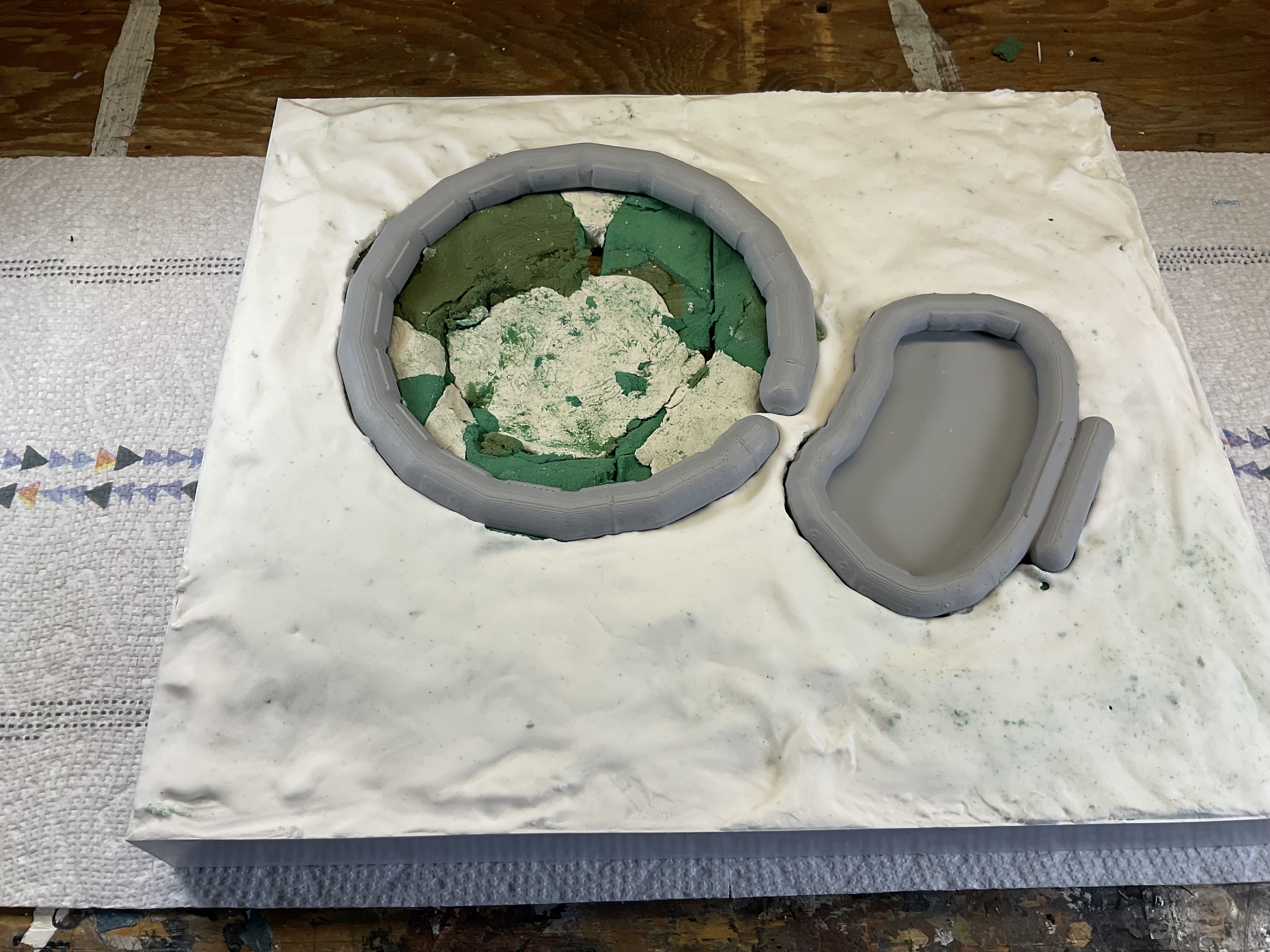

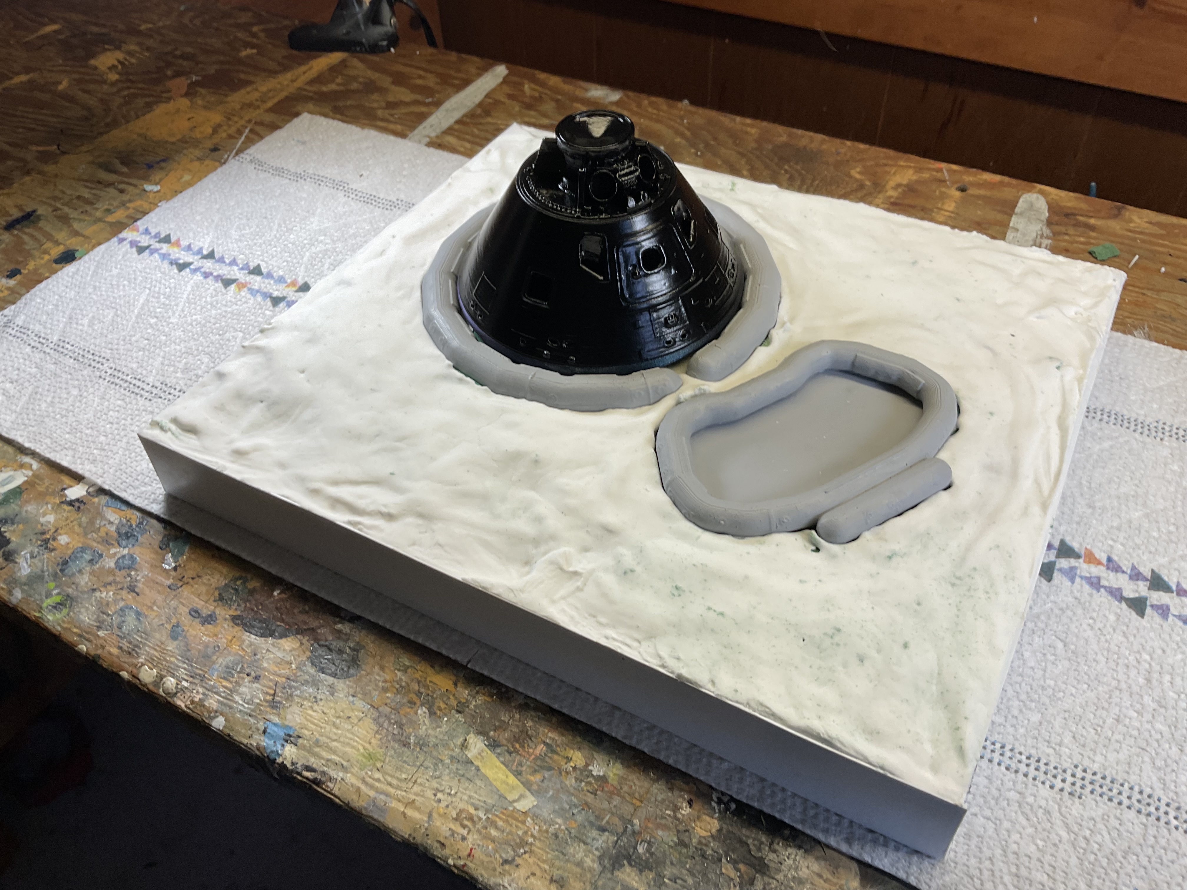

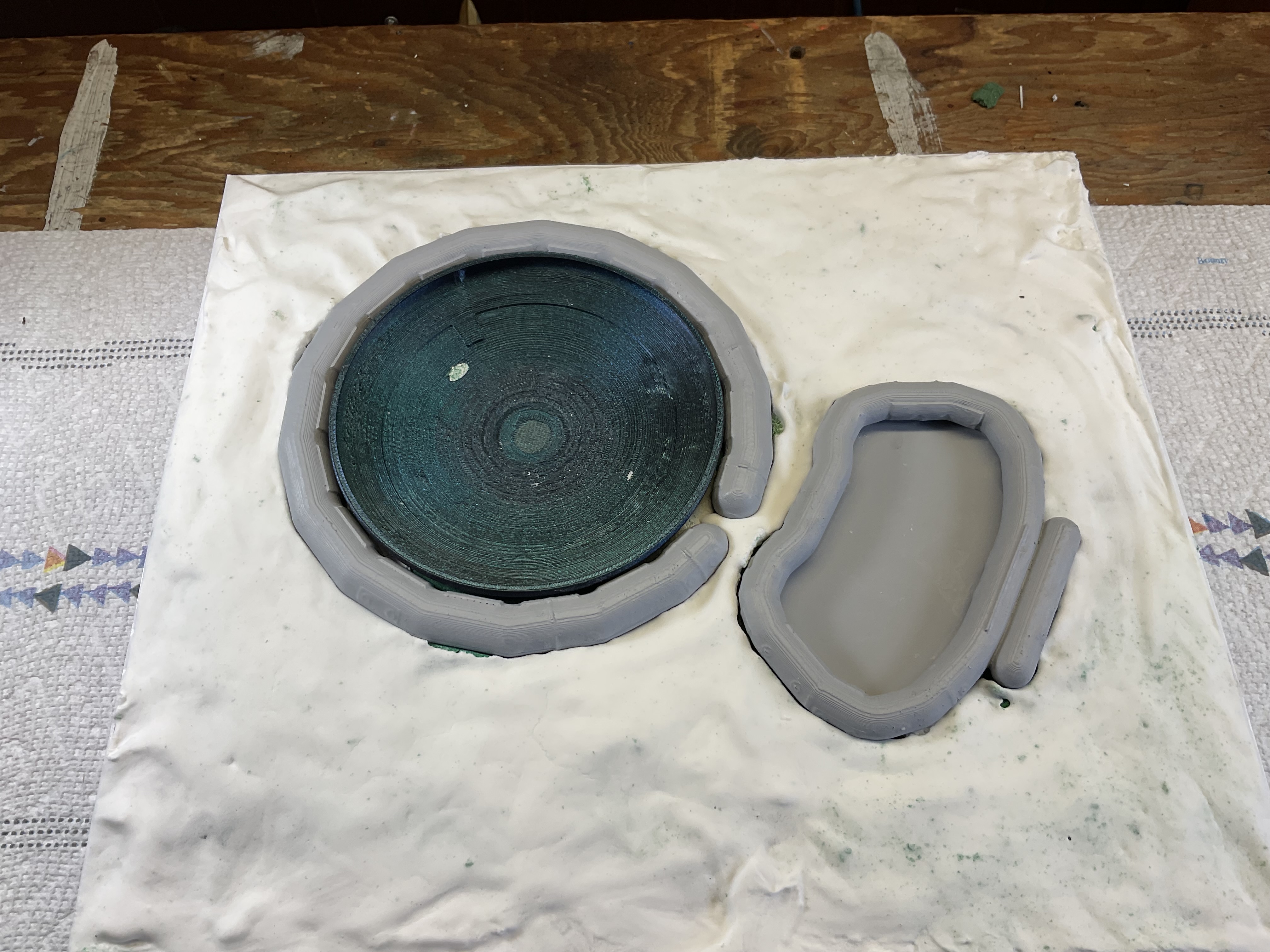

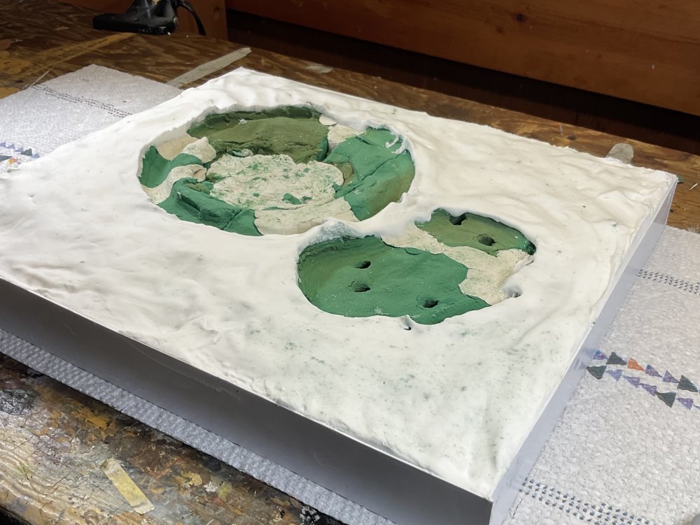

snichols Posted August 25, 2024 Author Share Posted August 25, 2024 (edited) On 8/24/2024 at 3:43 PM, aircommando130 said: That looks awesome! Thank you! Base construction is underway, I used sheet styrene filled with a mix of floral foam and air dry clay followed by an application of spackle. Edited August 25, 2024 by snichols Quote Link to post Share on other sites

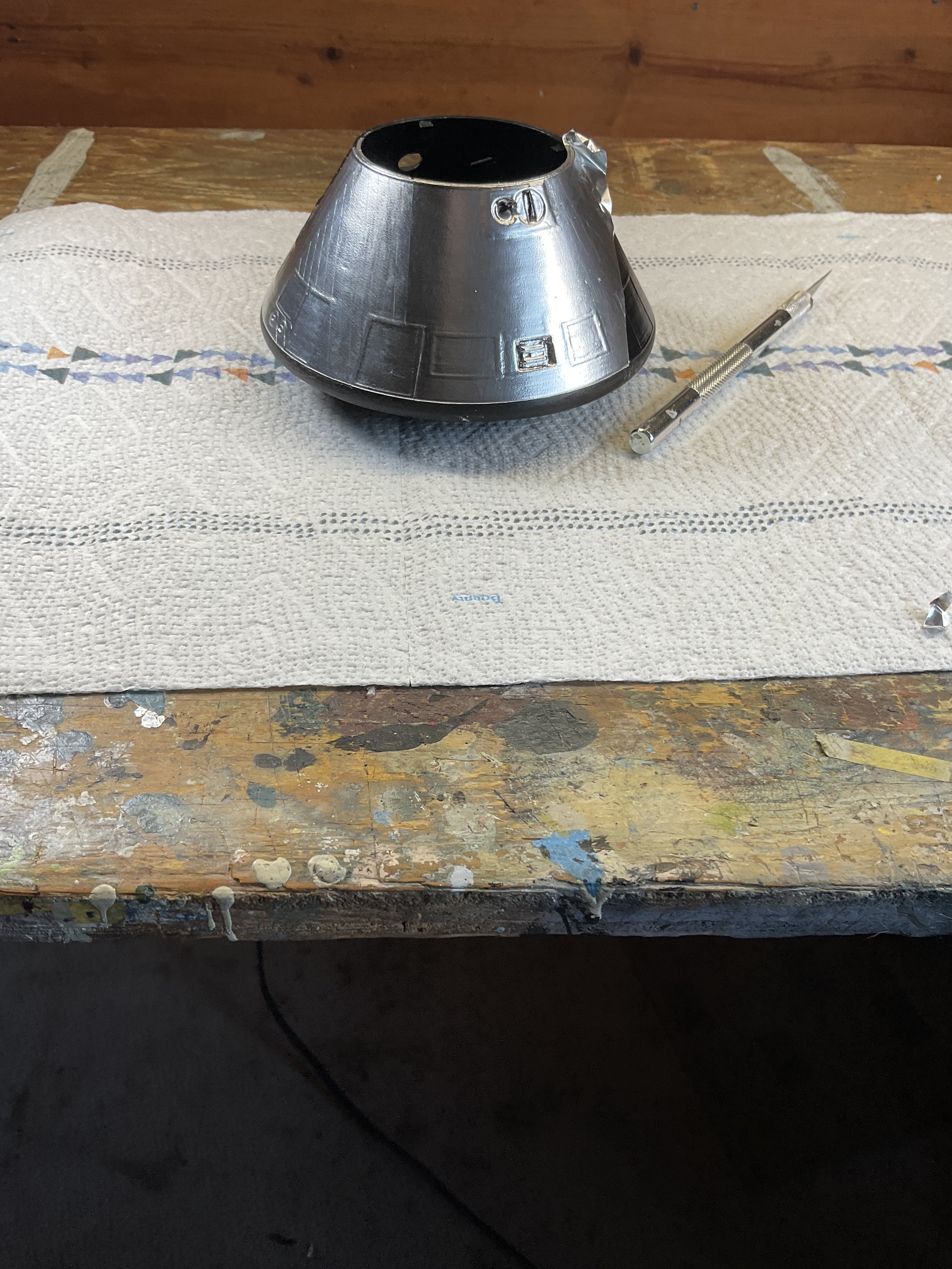

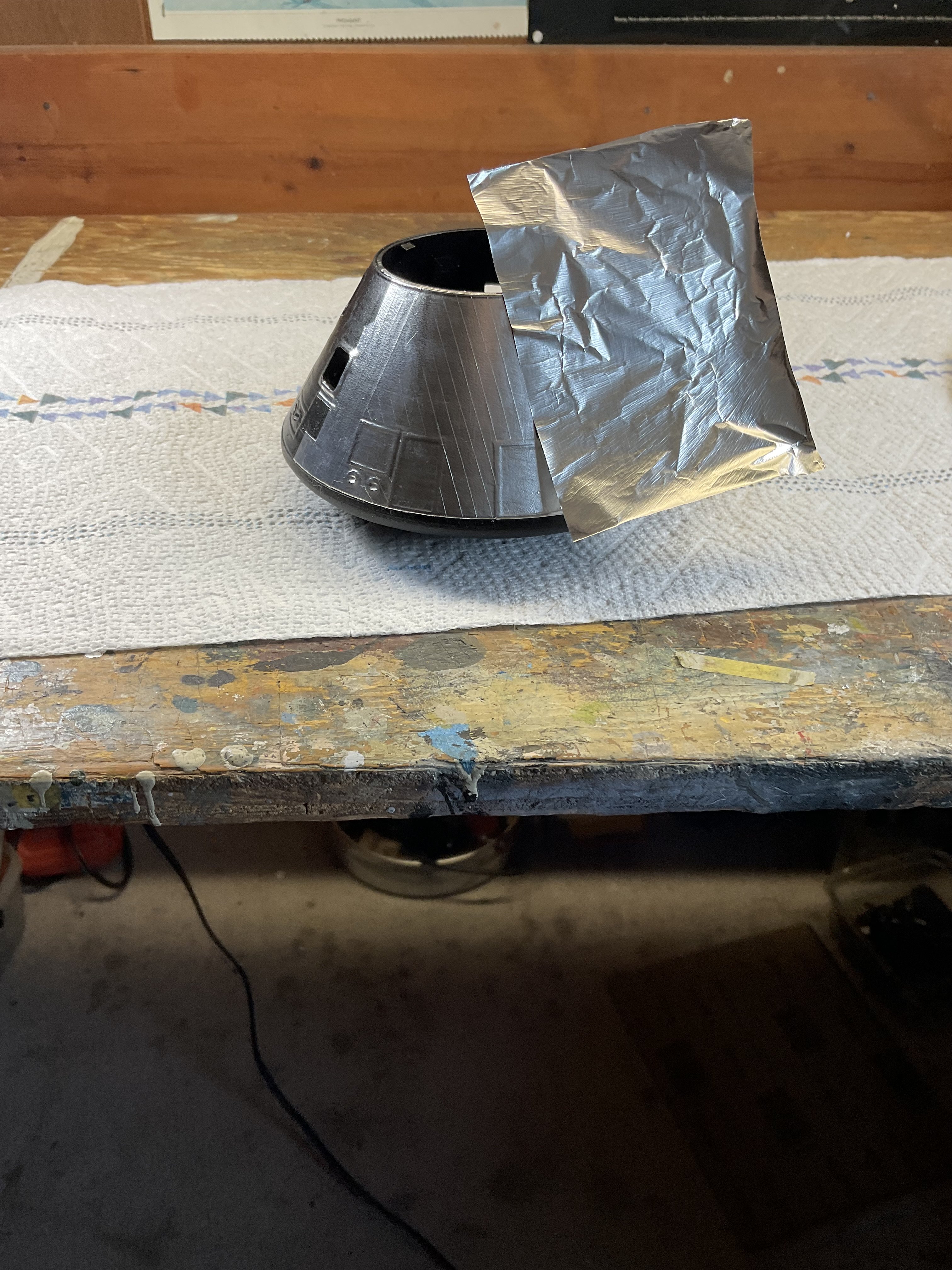

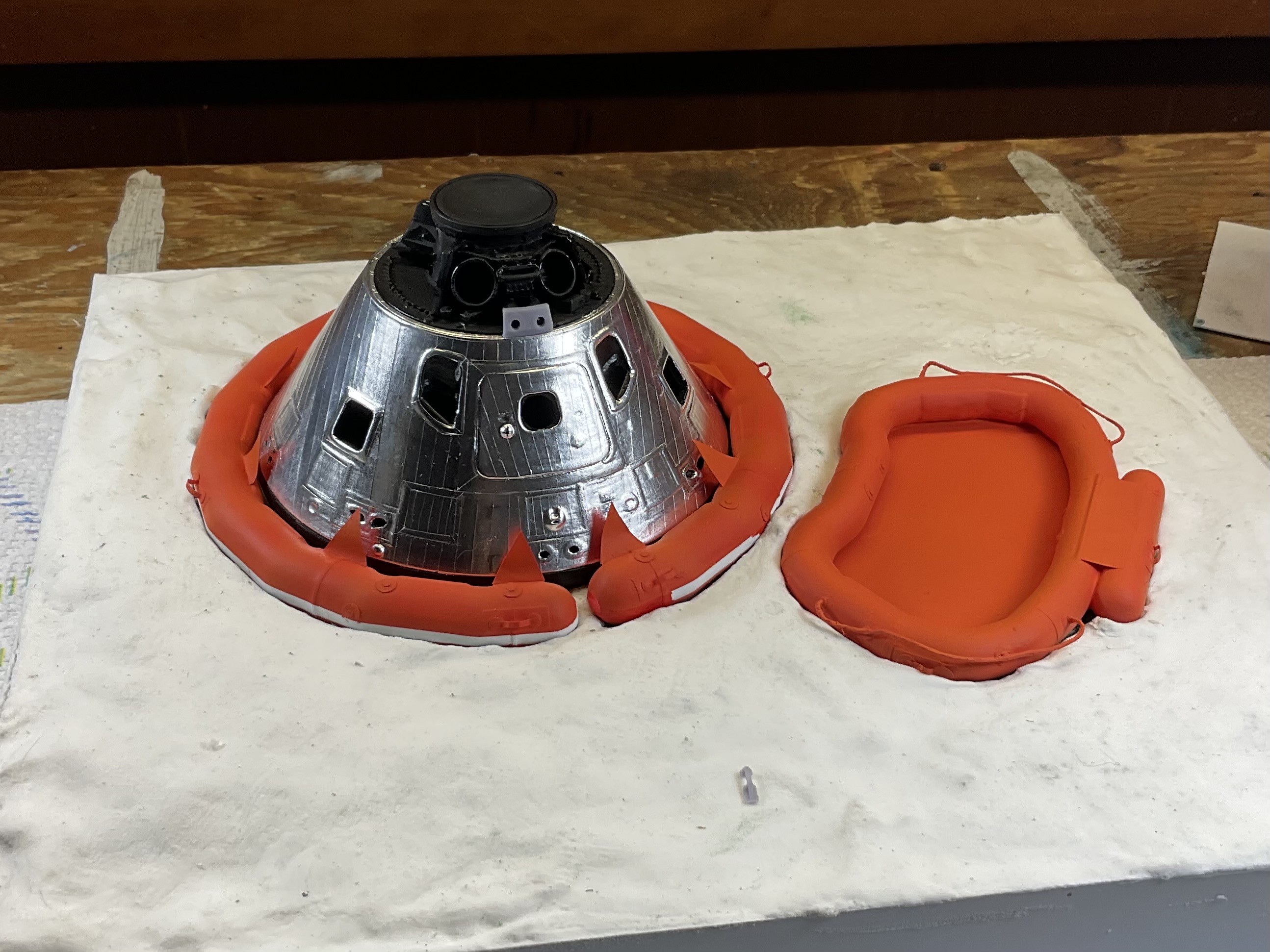

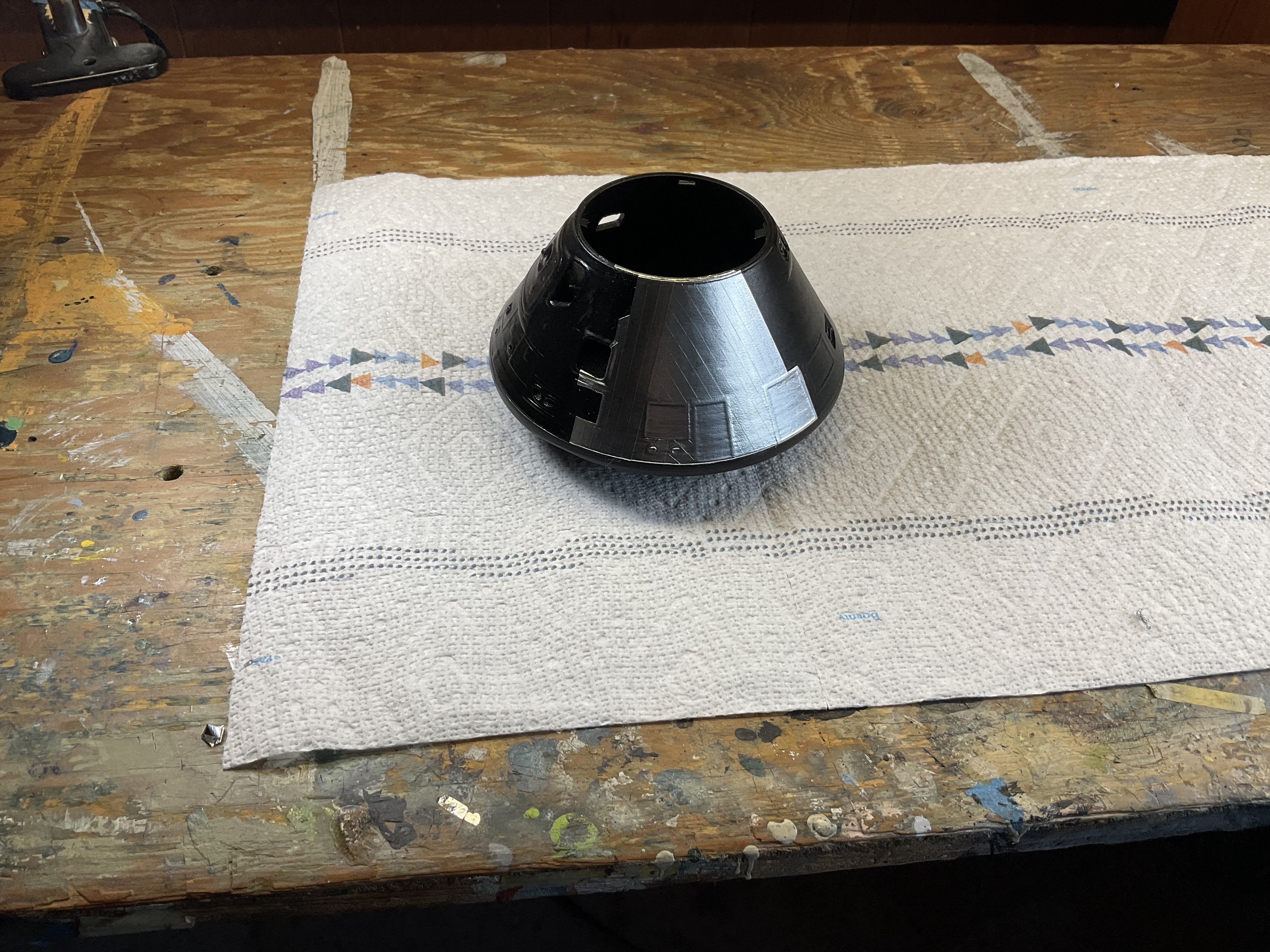

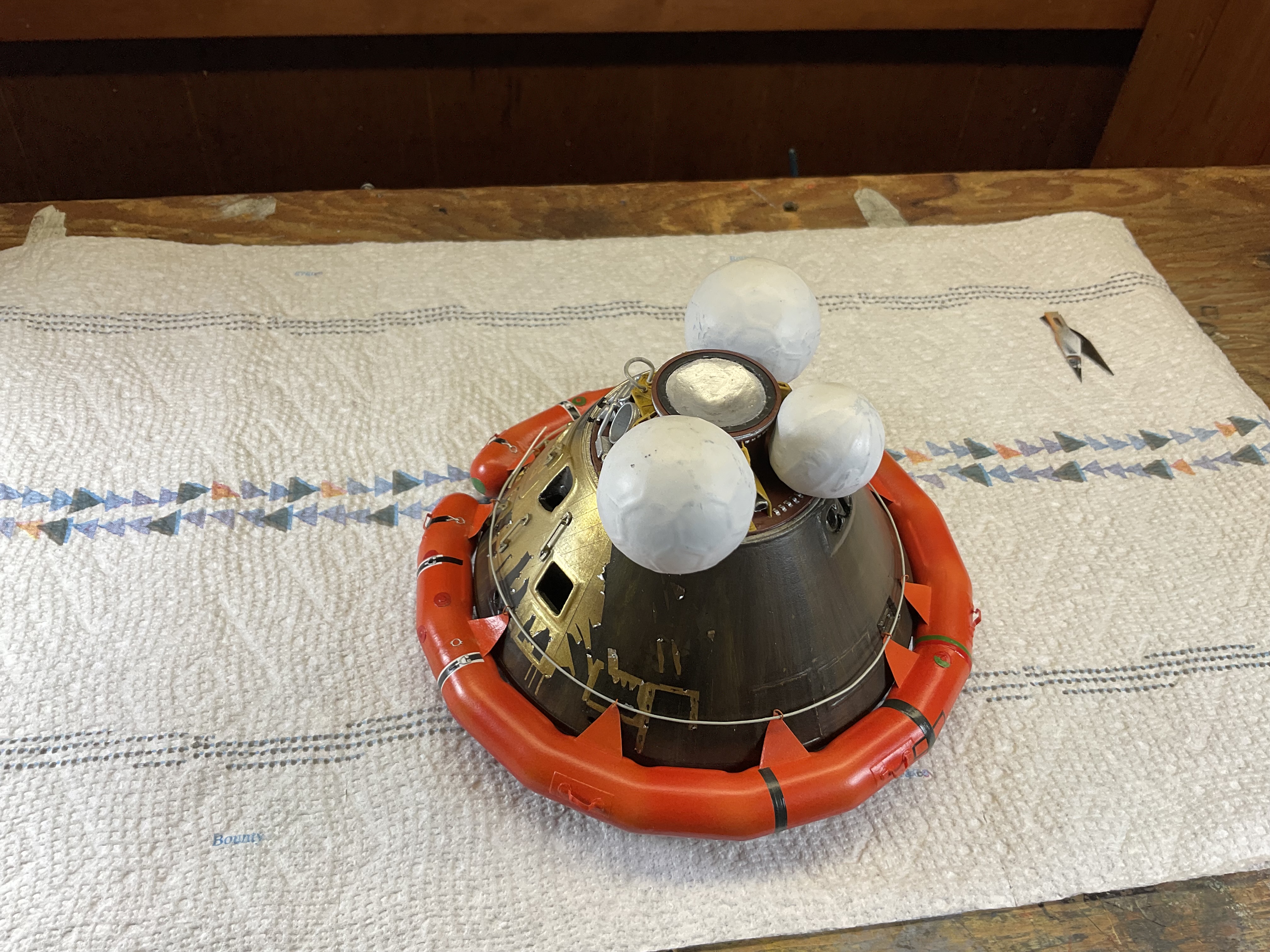

snichols Posted August 28, 2024 Author Share Posted August 28, 2024 (edited) On 8/25/2024 at 6:46 PM, aircommando130 said: My dad was on the Apollo 11 launch team. He worked the rocket engines on the Lunar Module. That’s a wonderful family story to have been a part of the Apollo 11 history. On 8/25/2024 at 8:51 PM, A-10 LOADER said: Remember watching this "live" on tv as a kid, pretty cool concept. Steve I too remember watching the event on television. OK everyone I haven’t done this in years and after it’s applied the bare metal foil replicating the thermal tape will have to be removed carefully and capsule exterior weathered. Edited August 28, 2024 by snichols Quote Link to post Share on other sites
A-10 LOADER Posted August 28, 2024 Share Posted August 28, 2024 BMF, WOW, hats off to you for this. Looks really good so far. Steve Quote Link to post Share on other sites

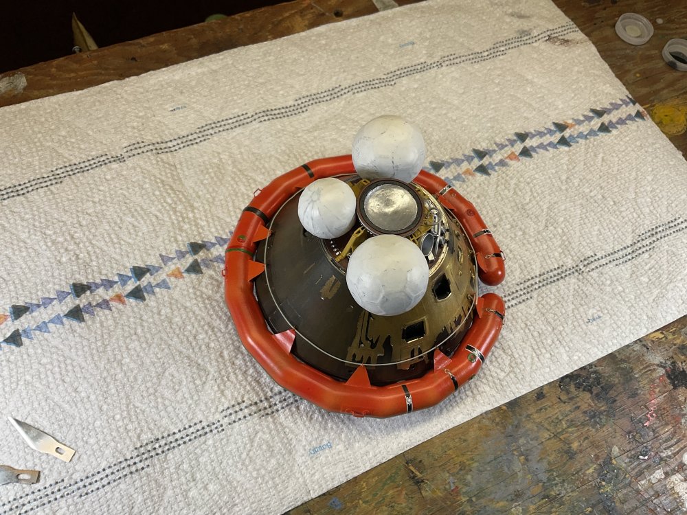

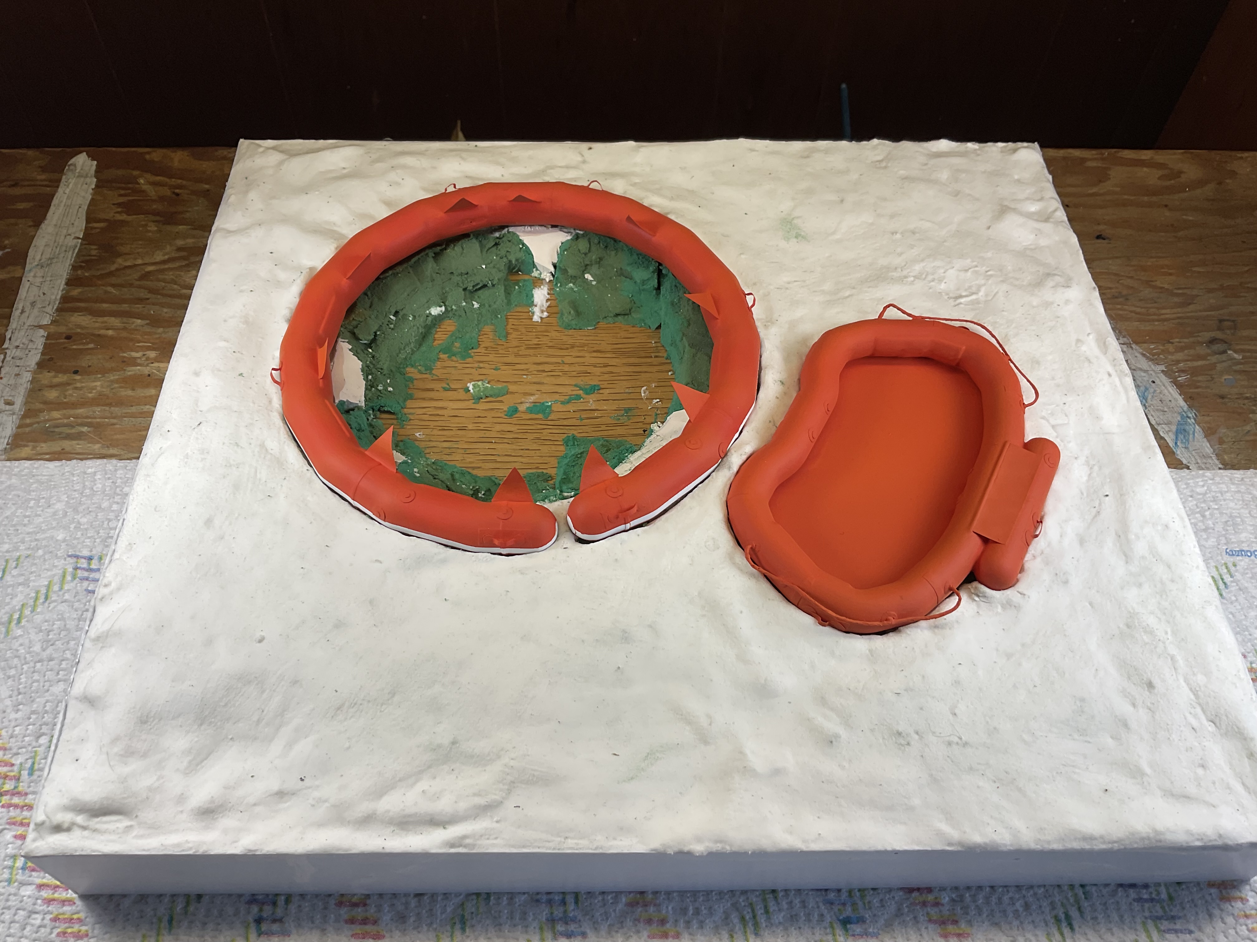

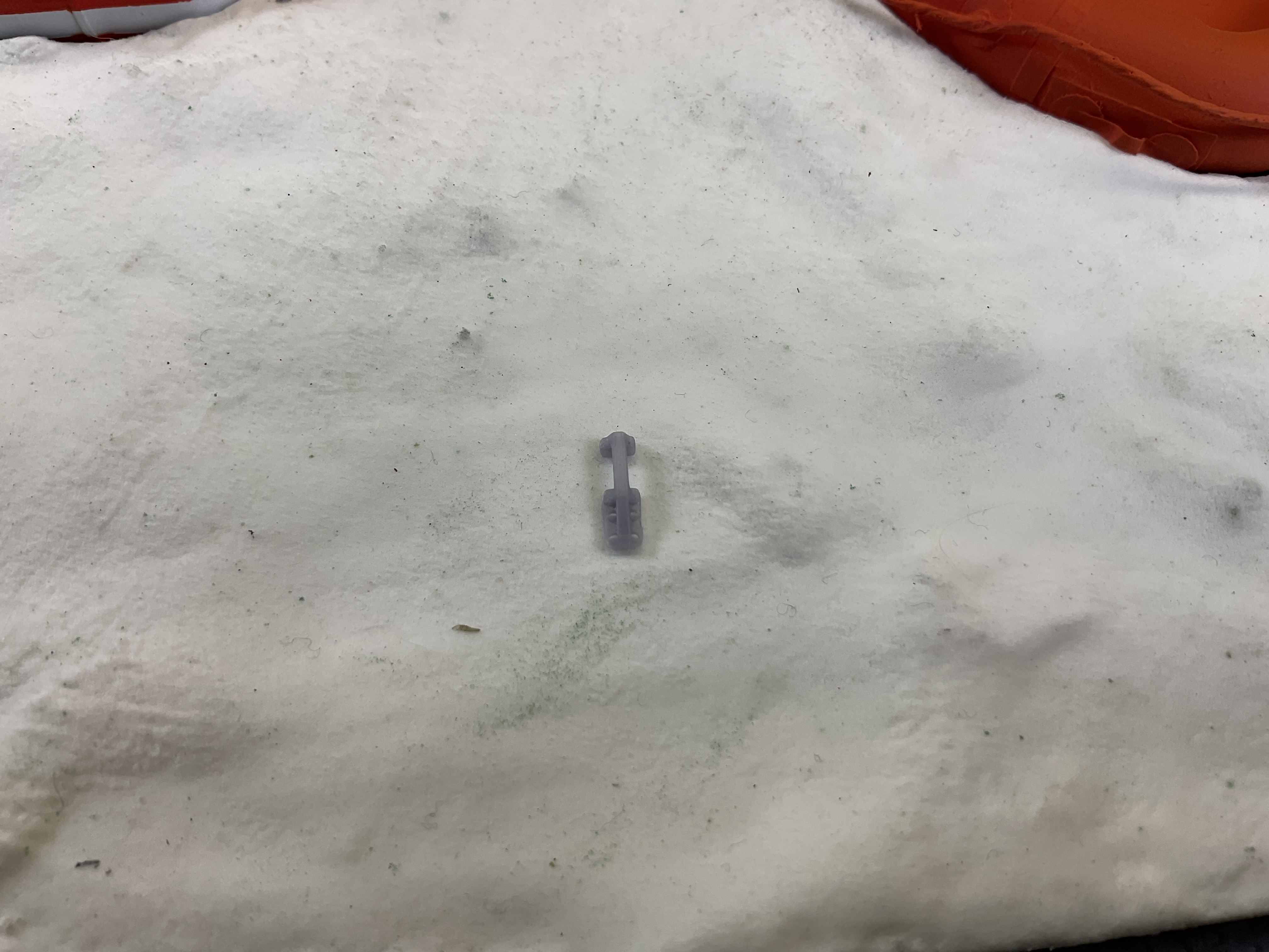

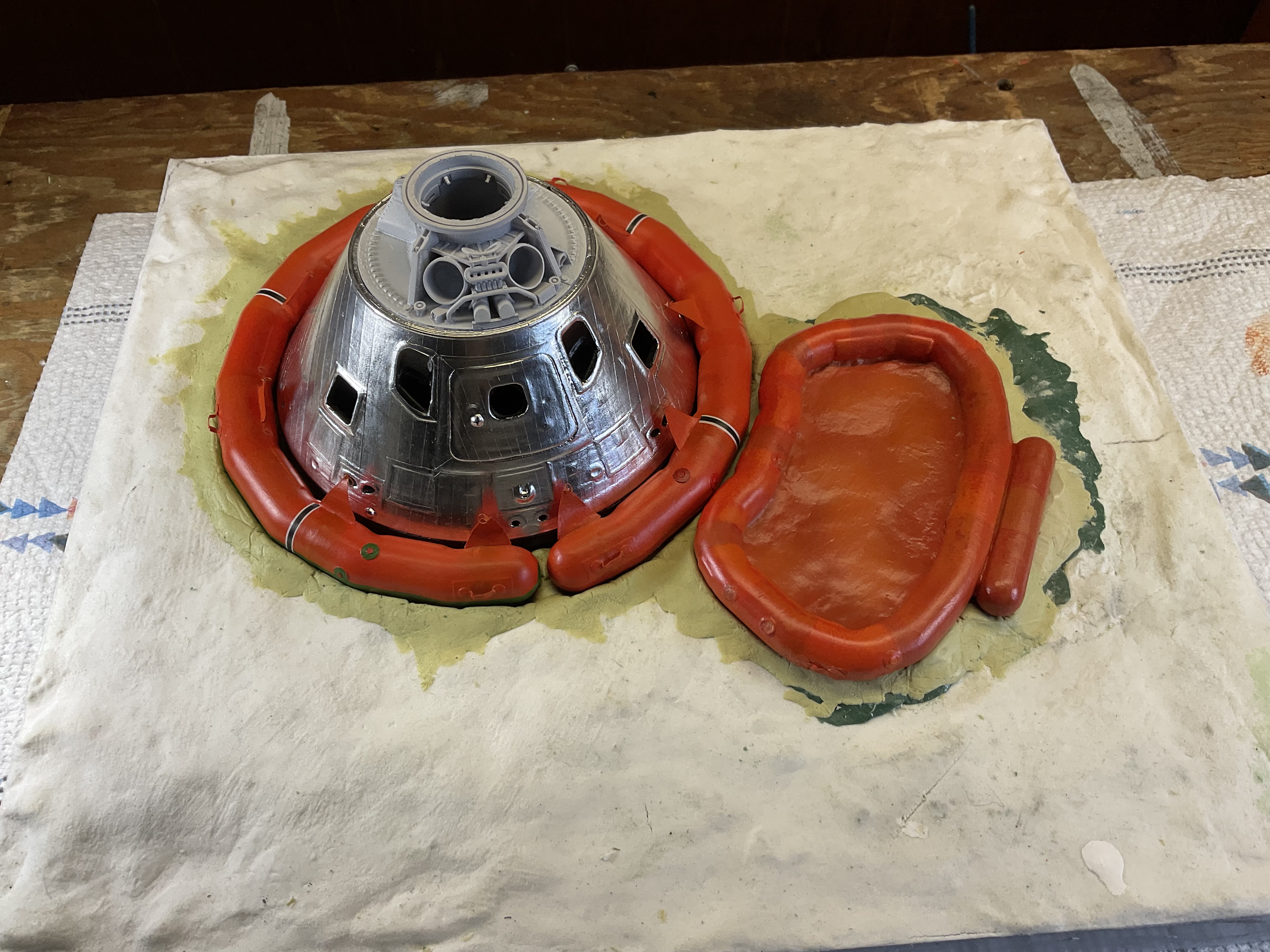

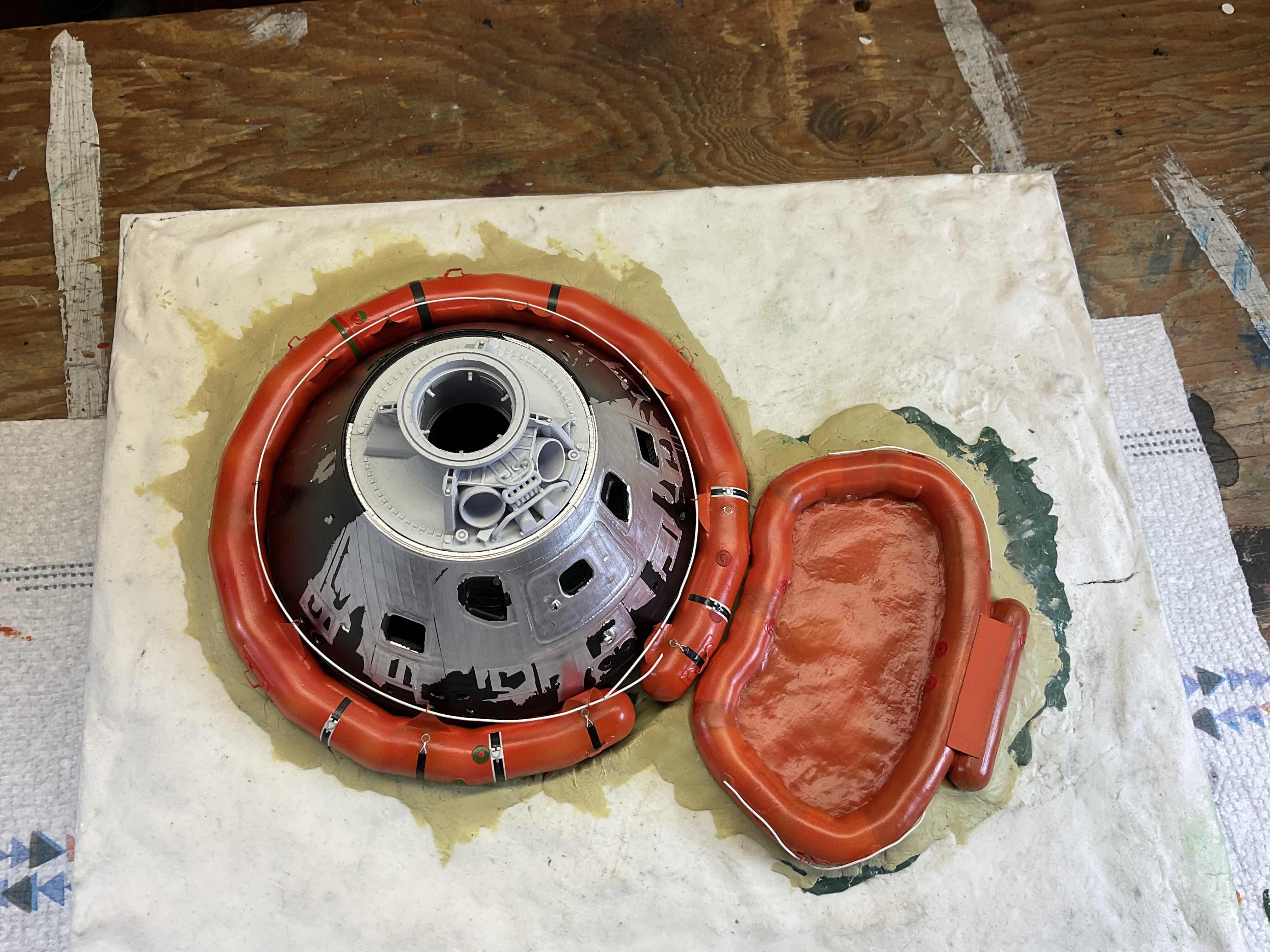

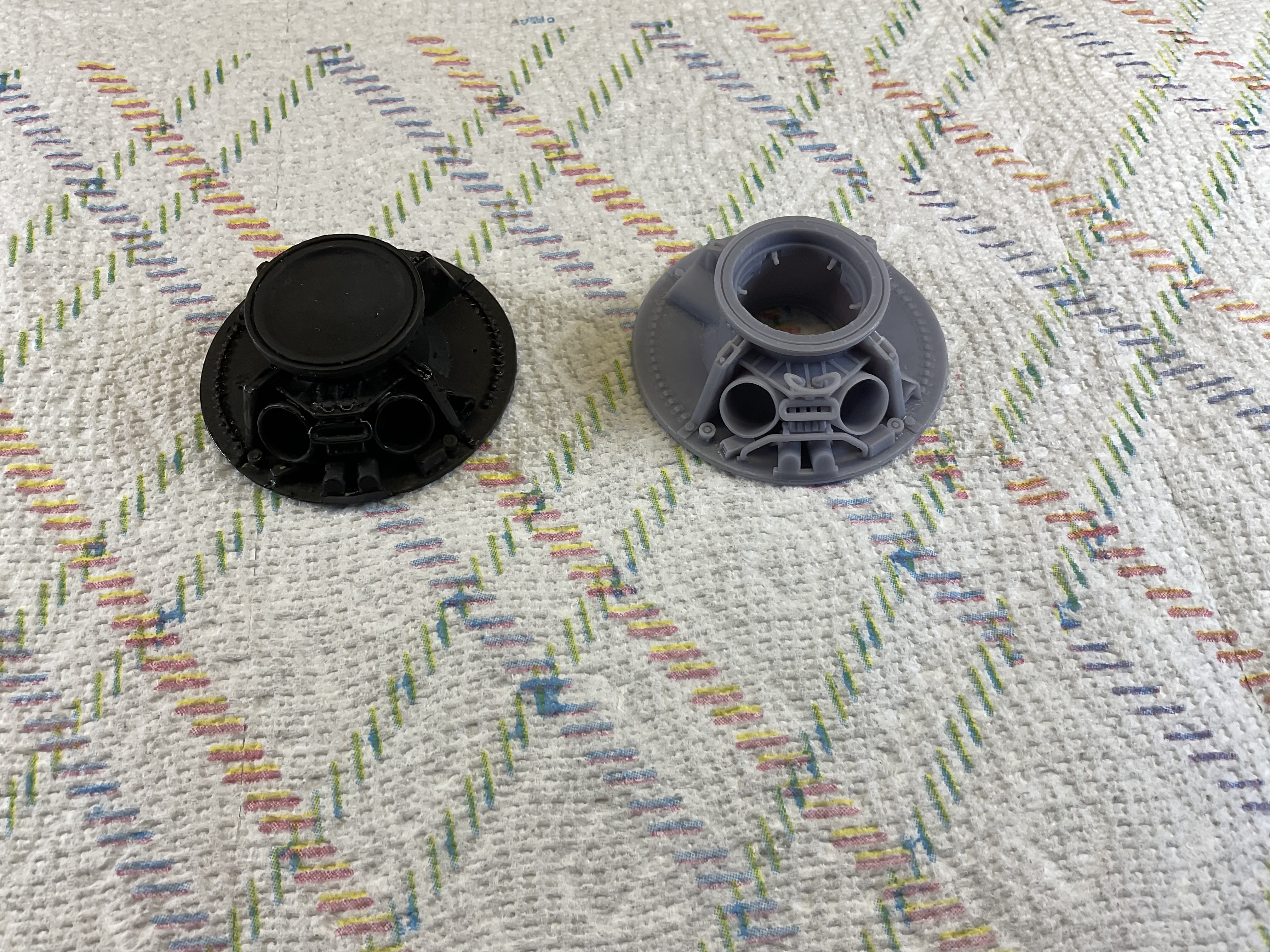

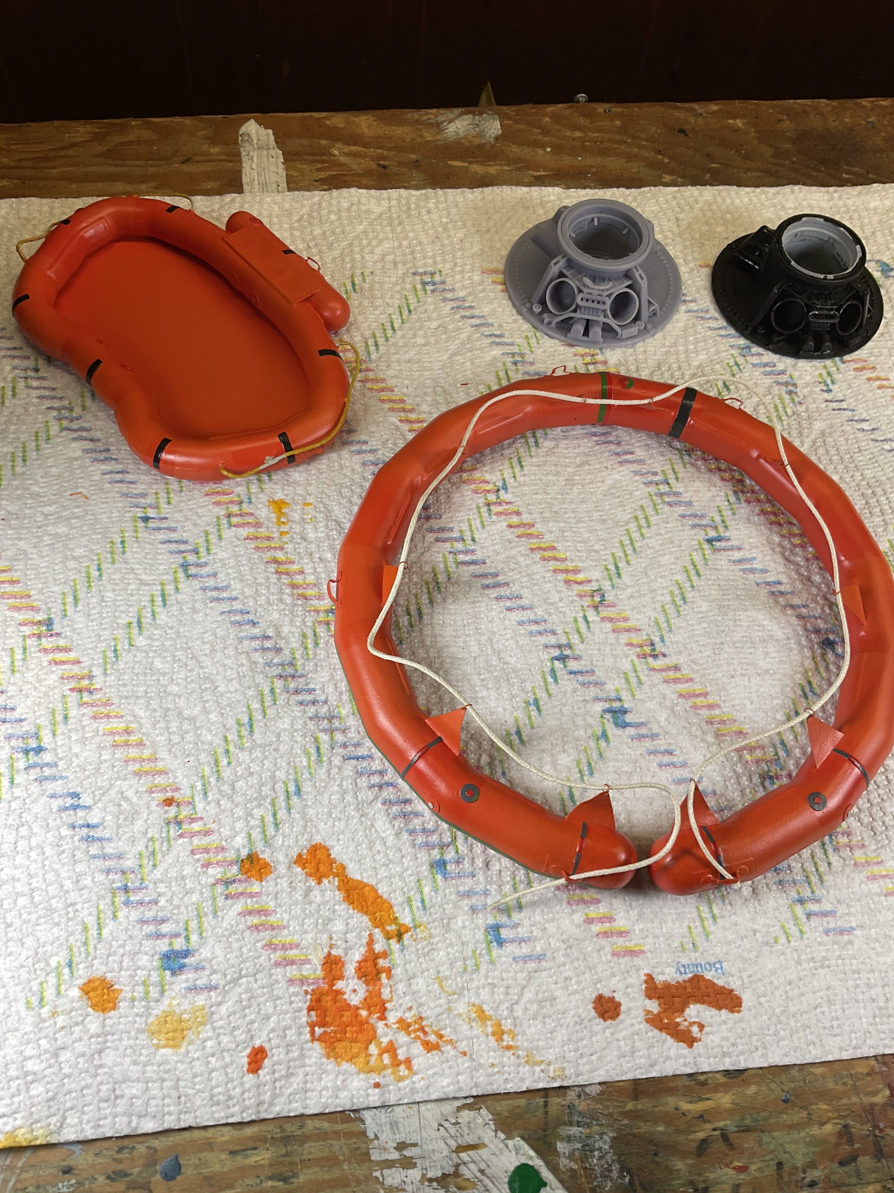

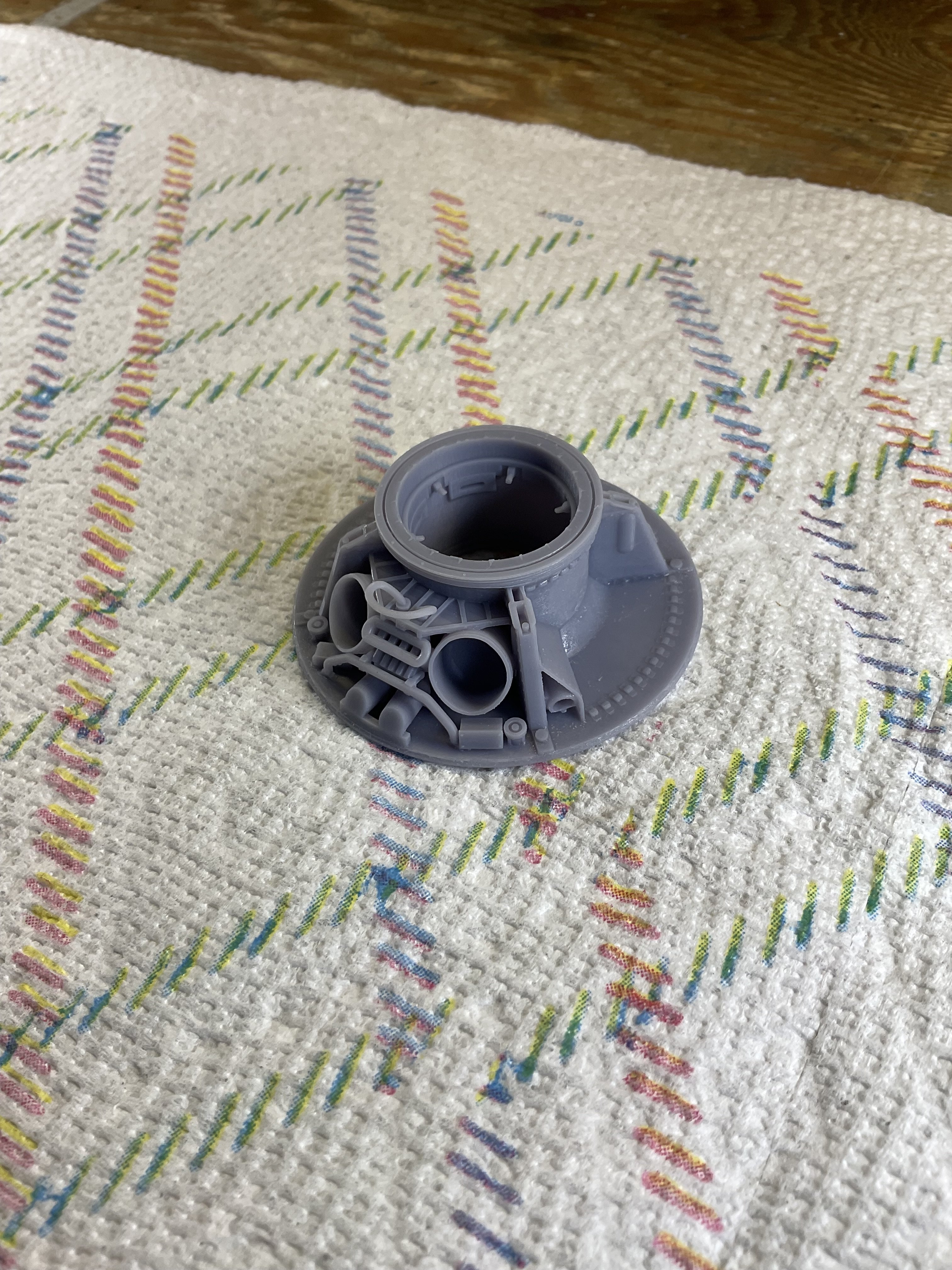

snichols Posted September 4, 2024 Author Share Posted September 4, 2024 (edited) On 8/28/2024 at 12:12 PM, A-10 LOADER said: BMF, WOW, hats off to you for this. Looks really good so far. Steve Thanks , it’s really going to be painful having to remove most of it ….. On 8/28/2024 at 7:11 PM, aircommando130 said: Just remember that most of it burned off coming back through the atmosphere! Cheers....Ron See above😁 Some work completed on the flotation collar and raft but most of my time has been spent trying to figure out resin printing. I’ve been successful with small parts that don’t require any support structures but once I try printing anything with supports, I’am lost. I have resin hardened on the build plate and vat bottom but tomorrow is another day. Edited September 4, 2024 by snichols Quote Link to post Share on other sites

SpacecraftGuy Posted September 6, 2024 Share Posted September 6, 2024 (edited) Ignore this. You are one step ahead. As Ron above said, it sure wasn't shiny by the time it hit the water. Apollo 16 in the water, Apollo 5 on display, and a close-up of I don't know what Apollo. But I don't really see why you applied all that foil if you're planning on removing almost all of it? The Beautiful work, tho'. Damn, I have to get me a printer... Edited September 6, 2024 by SpacecraftGuy Quote Link to post Share on other sites

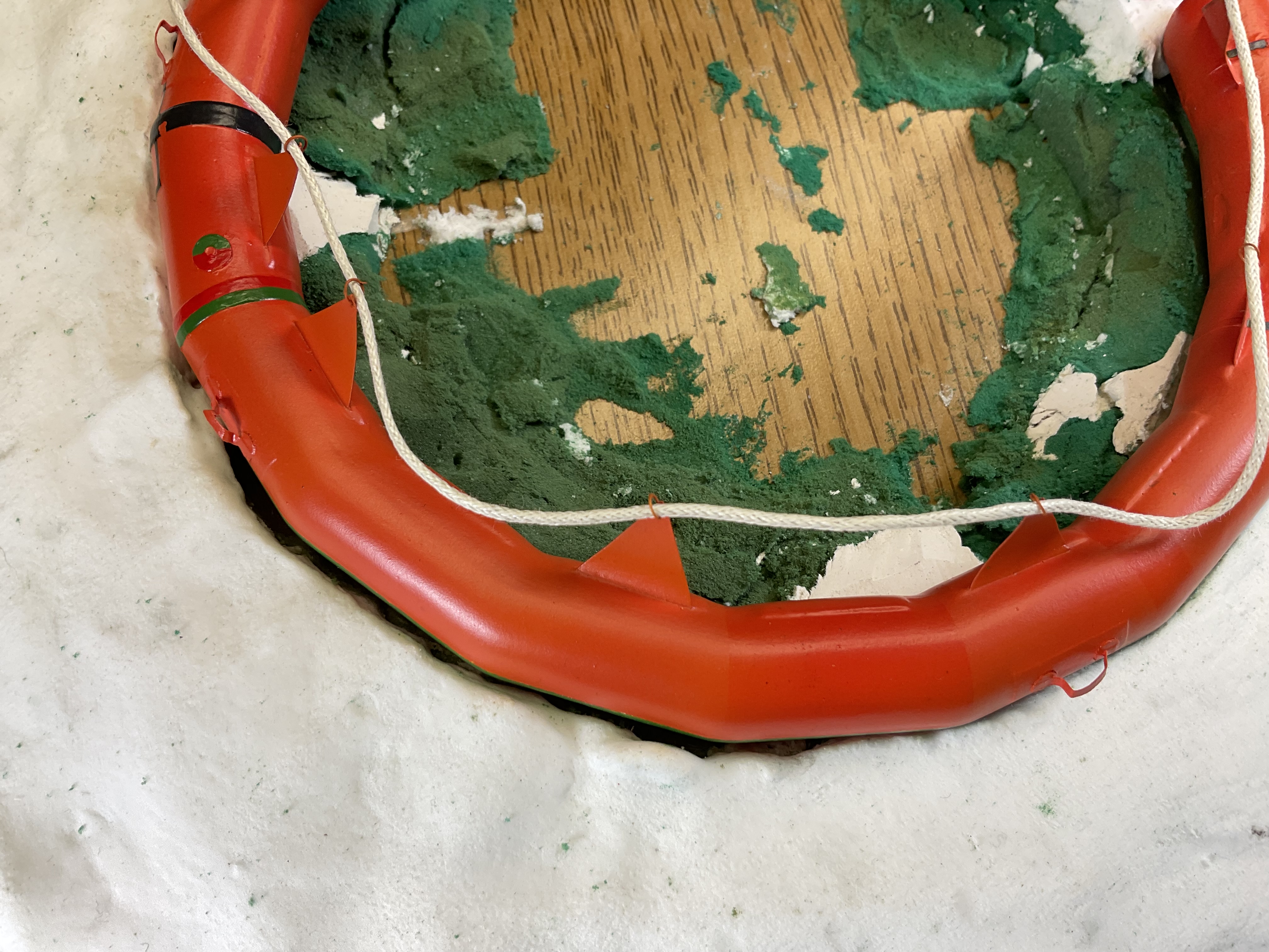

snichols Posted September 10, 2024 Author Share Posted September 10, 2024 (edited) On 9/6/2024 at 6:53 PM, SpacecraftGuy said: Ignore this. You are one step ahead. As Ron above said, it sure wasn't shiny by the time it hit the water. Apollo 16 in the water, Apollo 5 on display, and a close-up of I don't know what Apollo. But I don't really see why you applied all that foil if you're planning on removing almost all of it? The Beautiful work, tho'. Damn, I have to get me a printer... Thanks !! If you look closely at pictures after splashdown you can see the tape pattern is still present on the CM even though most of it is gone. I’ll burn the tape with oil paints after I peel most of it off and hopefully the tape pattern will still be present . I didn’t pay close enough attention to the raft configuration either so some surgery was in order along with possibly a complete re-paint . I may have solved some of the resin printing issues I have been experiencing and was able to print out a new parachute section which I’am quite happy with , thanks to the wife for the tech support. Edited September 15, 2024 by snichols Quote Link to post Share on other sites

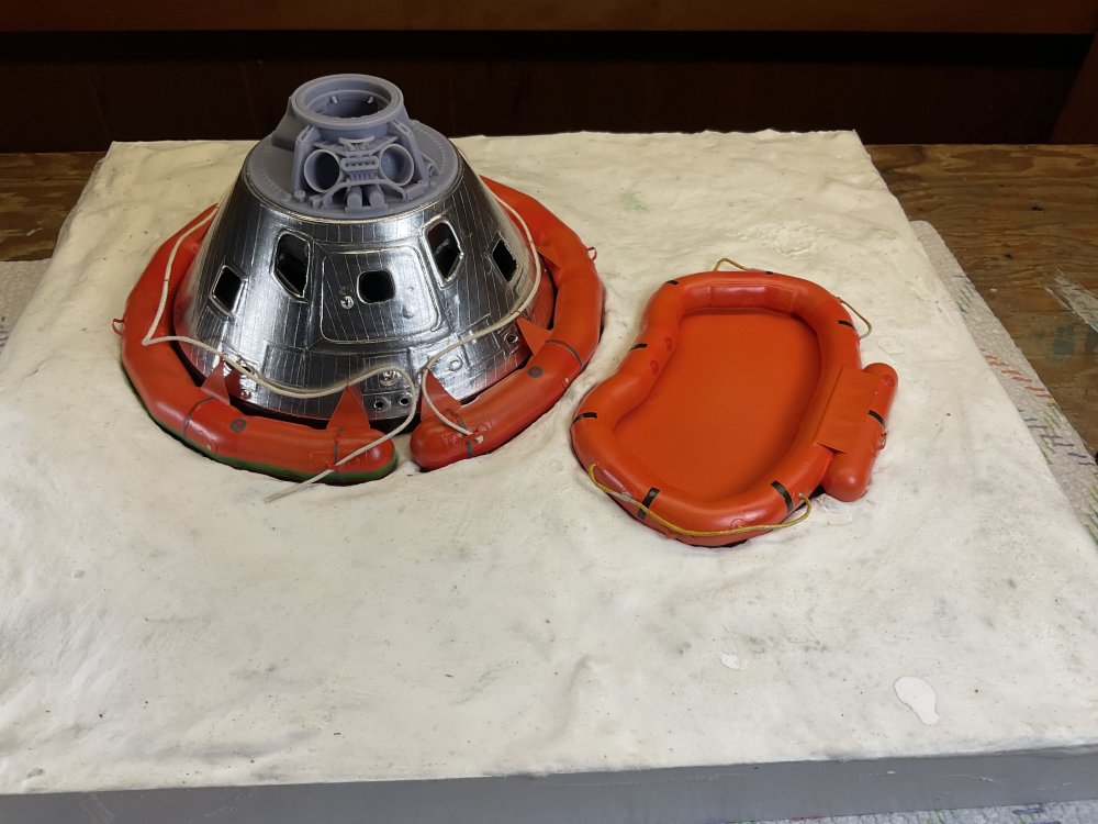

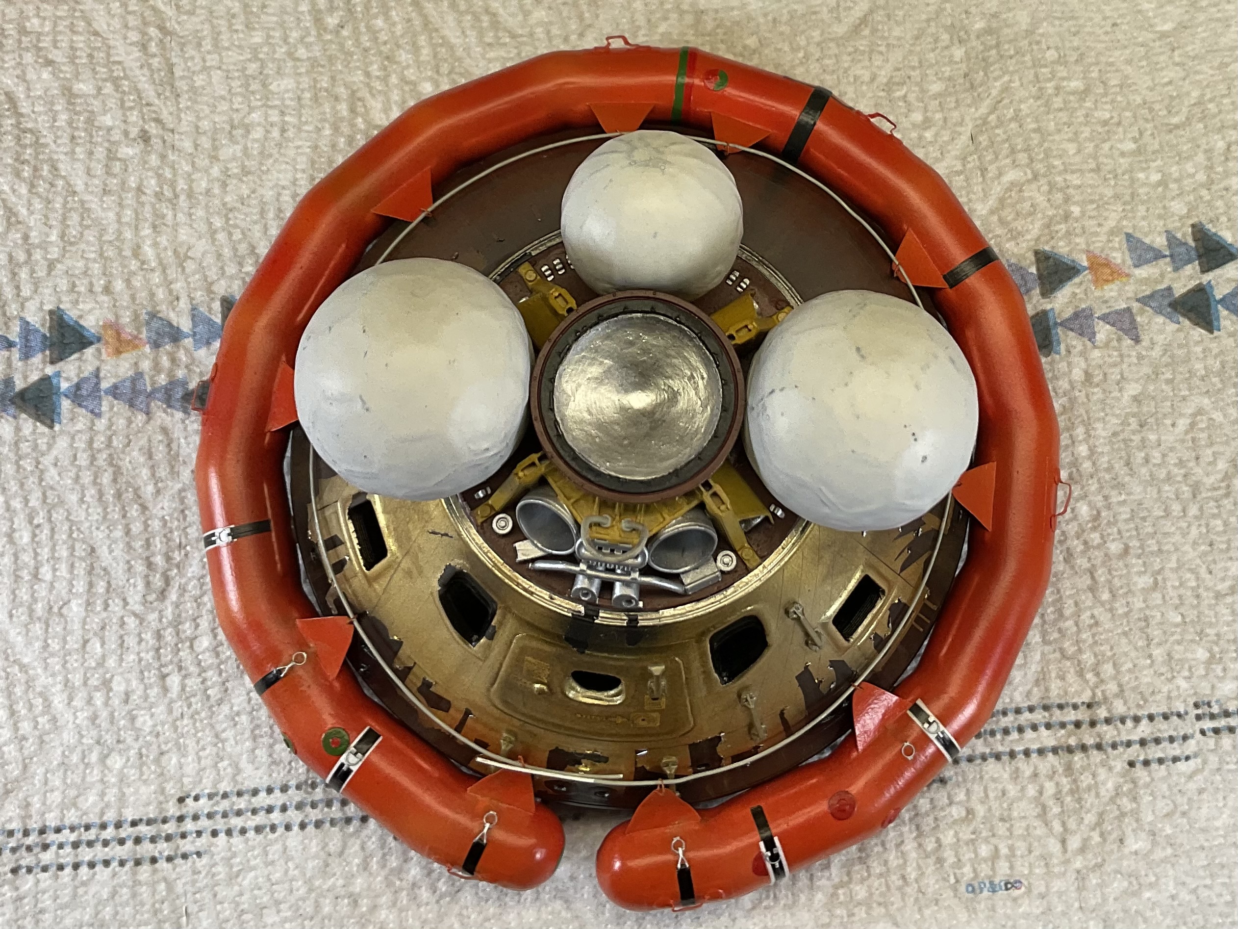

snichols Posted September 17, 2024 Author Share Posted September 17, 2024 (edited) On 9/16/2024 at 7:59 PM, aircommando130 said: Looking good! Are you going to add a shark fin in the water? The SEALS that recovered the spacecraft said the rotors beating the water in addition to the sound of the spashdown attracted some curious sharks out in the Pacific. Cheers....Ron Ron thanks for the encouragement, I was ready to shelve the whole project this morning but I made a decision to continue. Originally I wanted to depict the recovery of Columbia but after some work I realized the raft shape I was using was similar to recovery missions from Apollo 13 -17 only, so at this point I had it painted to look similar to 11’s recovery raft but the shape was different. Now after more research the new vignette will be titled vale Apollo , the recovery of command module America. Edited September 18, 2024 by snichols Quote Link to post Share on other sites

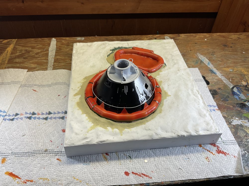

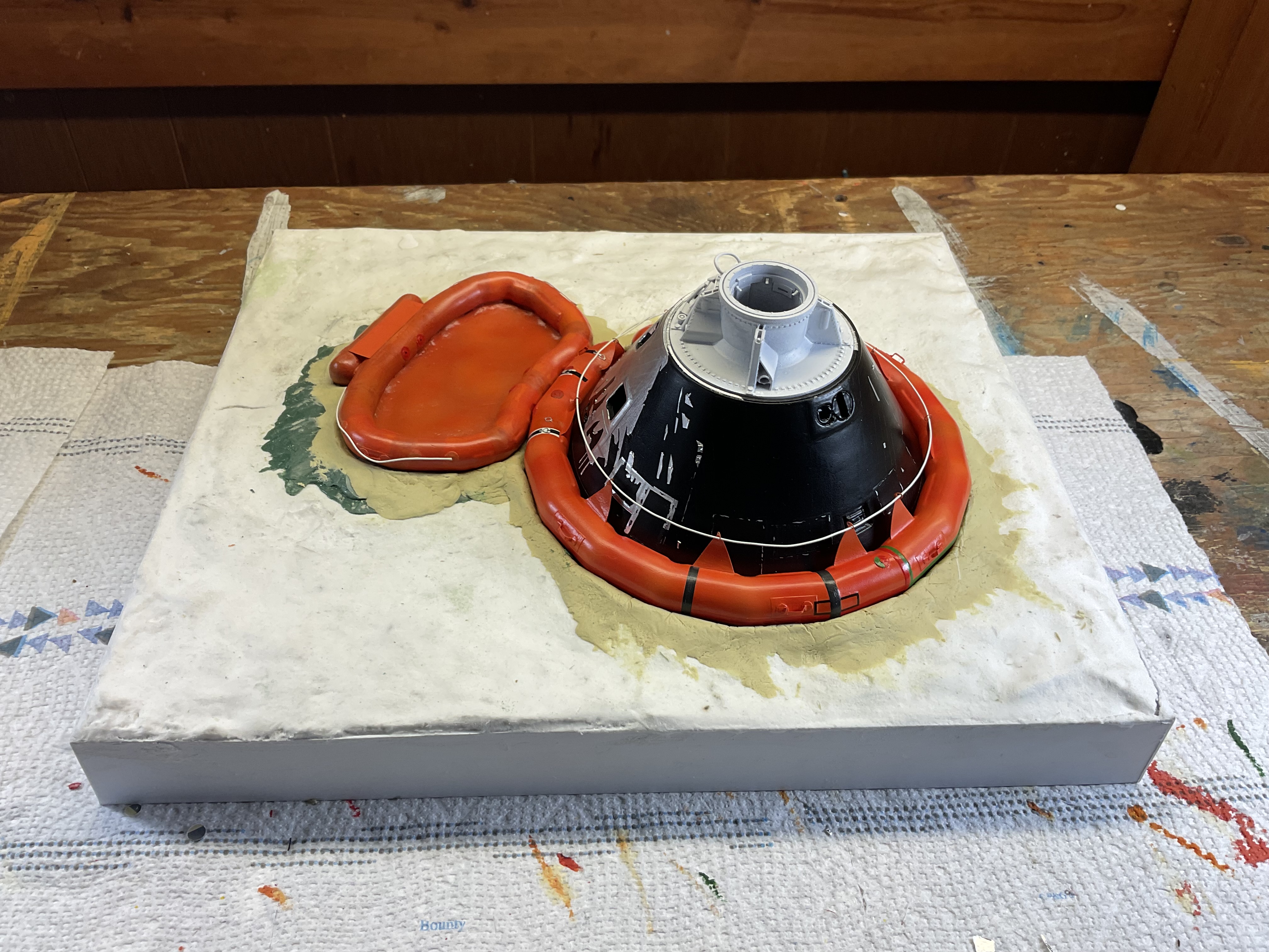

snichols Posted September 24, 2024 Author Share Posted September 24, 2024 Odyssey is starting to look the part after some airbrush work , glazes and oil paint washes. Quote Link to post Share on other sites
