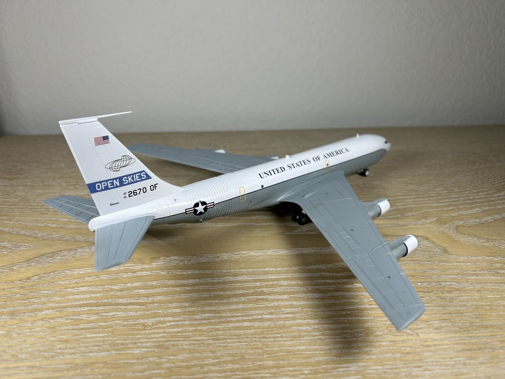

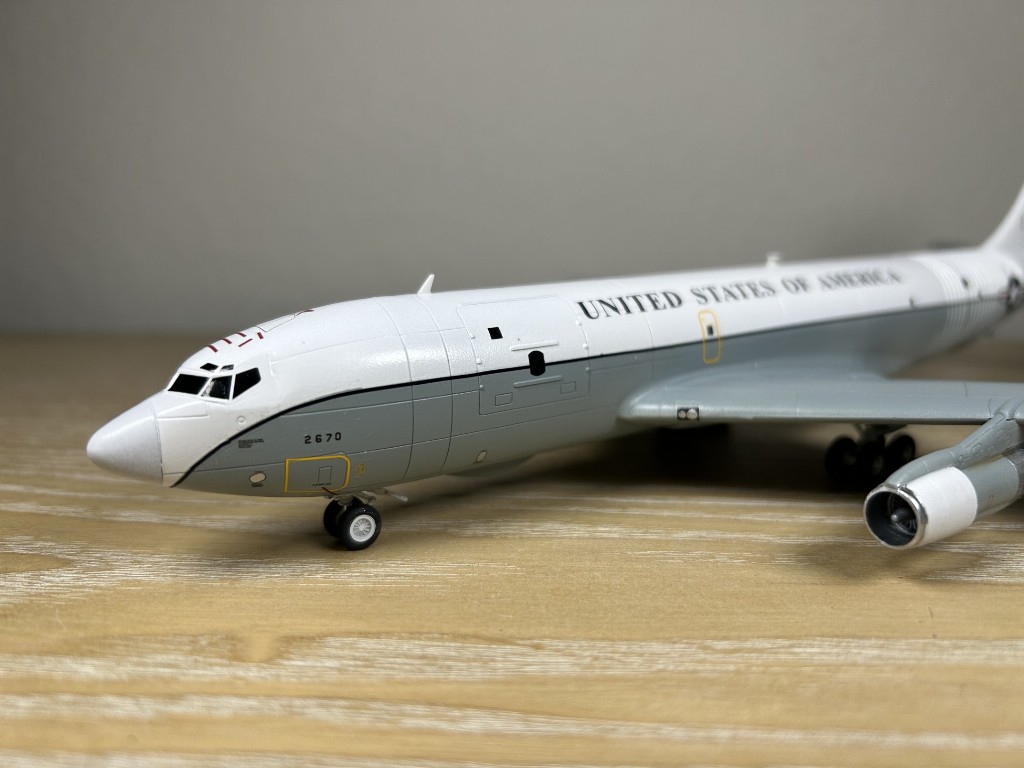

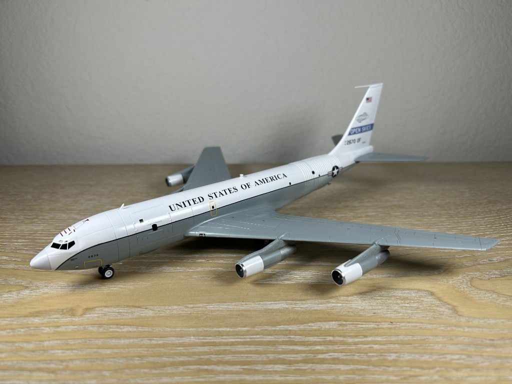

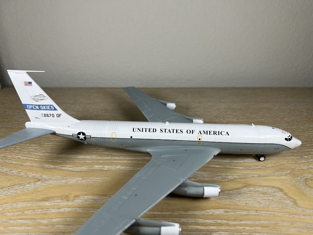

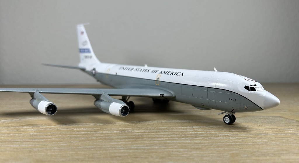

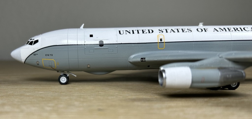

Gator52 Posted September 7, 2024 Share Posted September 7, 2024 (edited) To depict the base C-135B configuration, I replaced the boom with a strip of Evergreen no. 131 for the fuel dump pipe and added the second AC inlet on the bottom of the fuselage (included by Minicraft in the KC-135R release). If I'd been more attentive during construction, I would have realized this C-135B did not have turbocompressor hoods on the inboard engines, since it left the factory with TF33s as opposed to the other C-135 variants re-engined later in their careers. Sensor fairing under the forward fuselage was formed from two RB-36D radomes from the Hobbycraft kit, with a chunk of sprue in between. I cut two shapes from Evergreen strip stock for the sensor fairings on either side of the boom pod. Sensor detail on the cargo door is a combination of decals & strip styrene. The blade antenna is from the spares box, and I scratchbuilt the SATCOM antenna. Paint is Tamiya, Mr Color, and Vallejo; markings are Caracal 144026 & 144004. Chris Edited September 8, 2024 by Gator52 Quote Link to post Share on other sites

Dutch Posted September 8, 2024 Share Posted September 8, 2024 Wow! A real stunner! How difficult was it to perfectly mask the white / gray transition and apply the black cheatline decal? Quote Link to post Share on other sites

Gator52 Posted September 8, 2024 Author Share Posted September 8, 2024 17 hours ago, Dutch said: Wow! A real stunner! How difficult was it to perfectly mask the white / gray transition and apply the black cheatline decal? Thanks Dutch; I have a Maketar "Canopy Survival Kit" mask set that includes assorted radii of curves, so that made the task much easier. Cheatline decal flexed to the desired curve with no problems. Chris Quote Link to post Share on other sites
Trojan Thunder Posted September 9, 2024 Share Posted September 9, 2024 Nice work Chris What grey did you use for your build? Quote Link to post Share on other sites
Gator52 Posted September 9, 2024 Author Share Posted September 9, 2024 Thanks Ray; it's Mr Color c73 Aircraft Gray. First time using the Mr Hobby/Mr Color line, as my supply of Model Master FS 36173 is just about depleted. Chris Quote Link to post Share on other sites

Spruemeister Posted September 17, 2024 Share Posted September 17, 2024 The extra work you did really paid off! And incorporating a little B-36 DNA into the build was genius. It's hard to tell it's only 1/144.. Rick L. Quote Link to post Share on other sites
