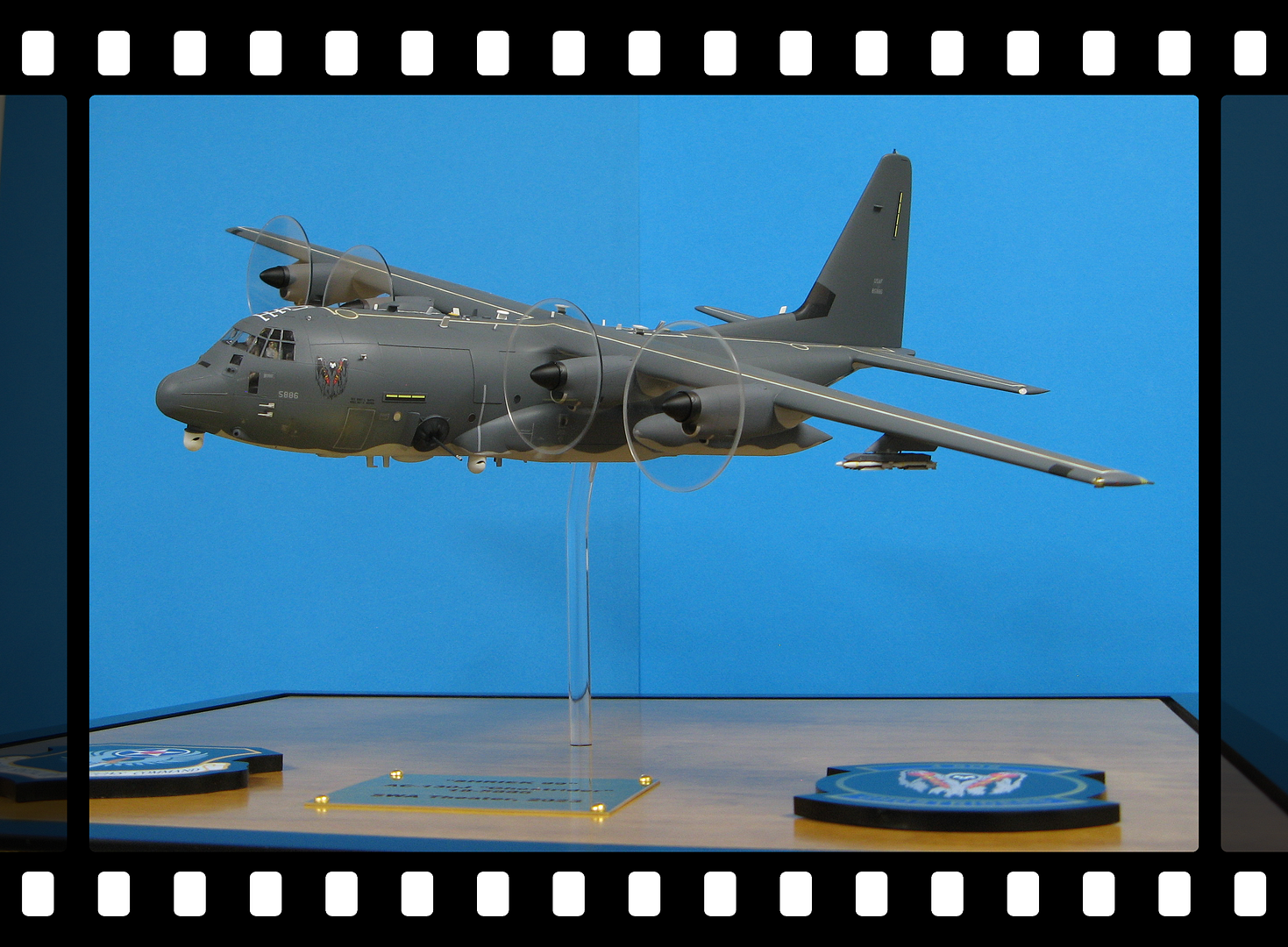

A-10 LOADER Posted September 25, 2024 Share Posted September 25, 2024 (edited) I currently have 4 in-flight displays, a 72nd AC-130J, my 72nd EP-3E and, my 1/18th F-14B and my 1/18th F-14A. Steve Edited September 25, 2024 by A-10 LOADER Quote Link to post Share on other sites

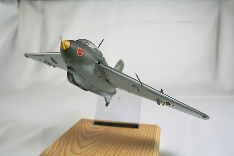

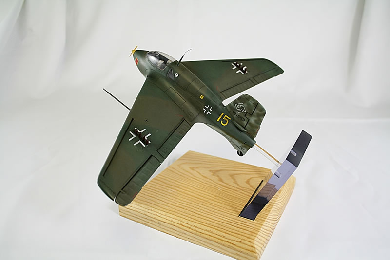

Collin Posted September 25, 2024 Share Posted September 25, 2024 Simple clear sprue (or metal rod) inserted into the belly has been my method over some time. Cheers Collin Quote Link to post Share on other sites

A-10 LOADER Posted September 26, 2024 Share Posted September 26, 2024 I should have added this to my original post. This is what I did for supporting the AC-J and EP-3 on their acrylic rods. I glued a piece of plastic tube for the acrylic rod to slide onto. That plastic tube goes from top to bottom, much more secure. The acrylic rod's outside diameter matches perfectly with the plastic tube's inside diameter so there is no play, again a solid connection. The aircraft can be slid on or off easily, HTH. Steve Quote Link to post Share on other sites

talbot Posted September 27, 2024 Author Share Posted September 27, 2024 21 hours ago, A-10 LOADER said: I should have added this to my original post. This is what I did for supporting the AC-J and EP-3 on their acrylic rods. I glued a piece of plastic tube for the acrylic rod to slide onto. That plastic tube goes from top to bottom, much more secure. The acrylic rod's outside diameter matches perfectly with the plastic tube's inside diameter so there is no play, again a solid connection. The aircraft can be slid on or off easily, HTH. Steve ah ok, that helps on attaching - thank you Quote Link to post Share on other sites

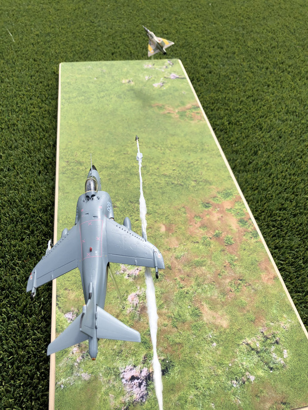

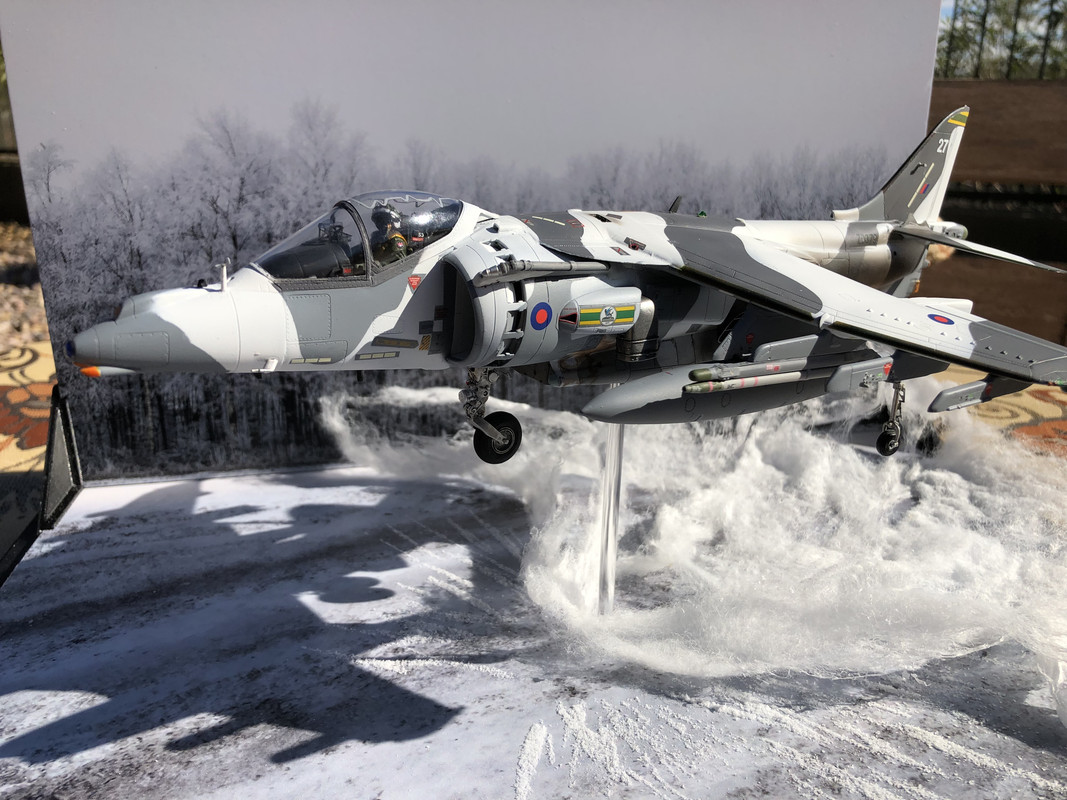

GSymmonds Posted September 28, 2024 Share Posted September 28, 2024 I've done a couple - basic stuff of brass tube embedded with epoxy in the fuselage then slipped over an acrylic rod. I think the key is to get a composition that conveys the feel you want. Graham Quote Link to post Share on other sites
ExchefAndy Posted September 28, 2024 Share Posted September 28, 2024 (edited) 8 hours ago, GSymmonds said: I've done a couple - basic stuff of brass tube embedded with epoxy in the fuselage then slipped over an acrylic rod. I think the key is to get a composition that conveys the feel you want. Graham Those are both the ducks nuts! Awesome scenes and beautifully captured Andy Edited September 28, 2024 by ExchefAndy stuff Quote Link to post Share on other sites
A-10 LOADER Posted September 28, 2024 Share Posted September 28, 2024 4 hours ago, ExchefAndy said: Those are both the ducks nuts! Awesome scenes and beautifully captured Andy Agree, they are really cool. Steve Quote Link to post Share on other sites
talbot Posted September 28, 2024 Author Share Posted September 28, 2024 (edited) Agreed, that Harrier taking off is exceptional Edited September 28, 2024 by talbot spelling Quote Link to post Share on other sites
