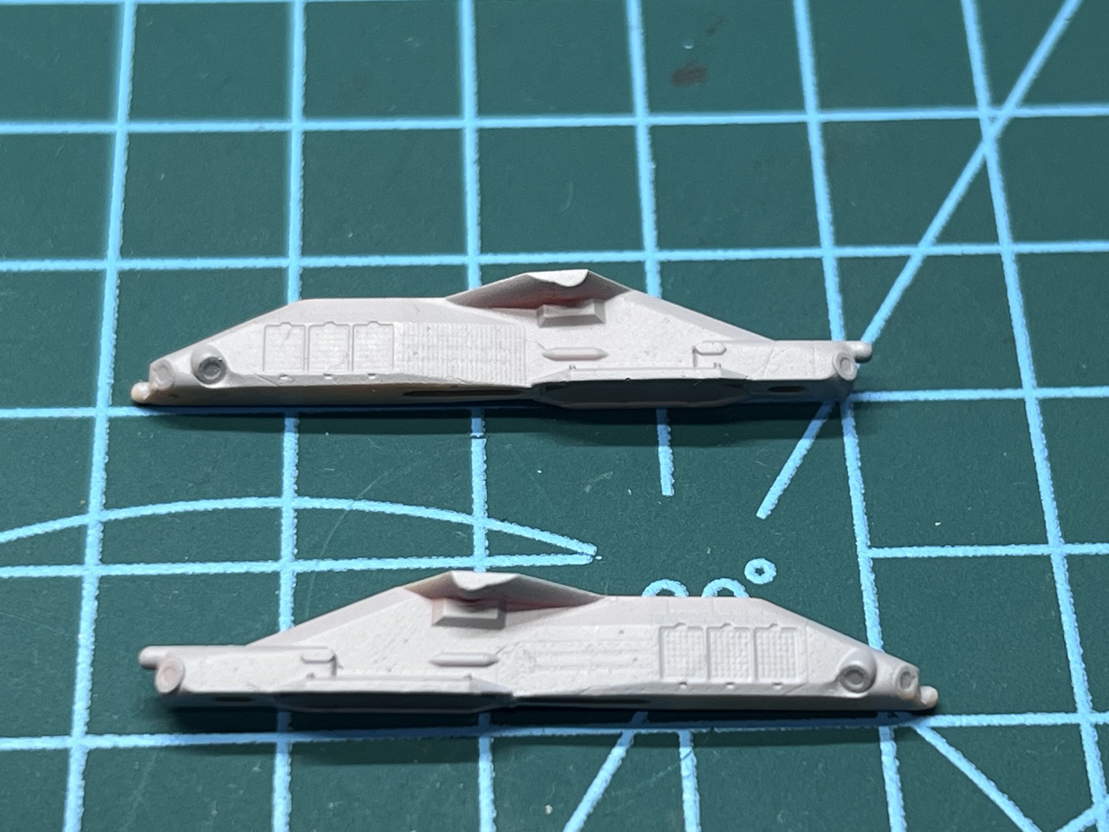

The latest purchase: Fab scale's Terman PIDS+ pylon set just came in. In the bag there is a pair of PIDS+ pylons and the Ukrainian air force insigina.

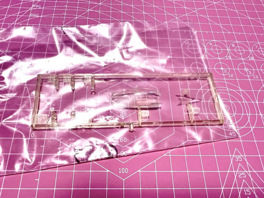

The clear parts are tined, which is not to my liking, as it means the others parts, such as the taxing light, are also tinted, and I think it's wrong.

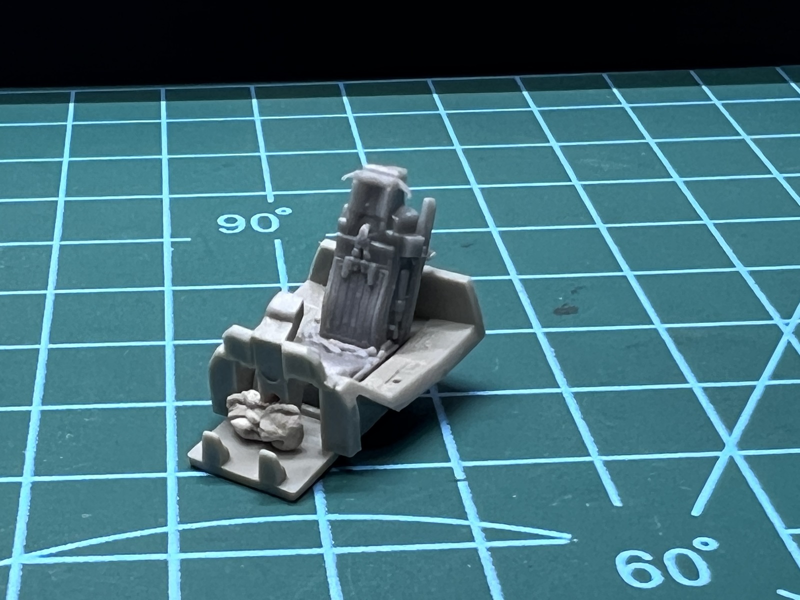

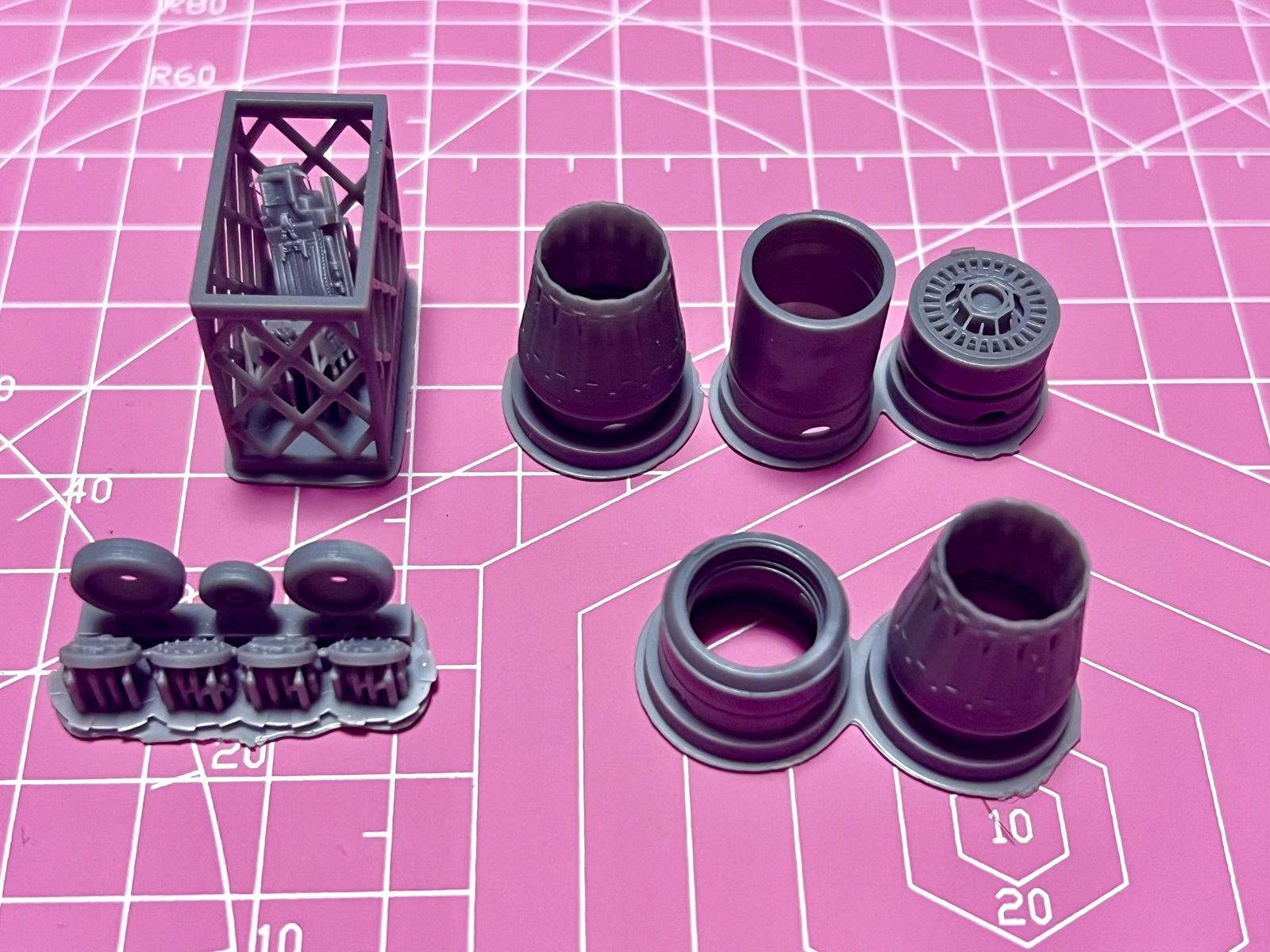

I also bought a 3D printed ASCII seat, exhause and wheels for better details. They look more refined than the kit parts.

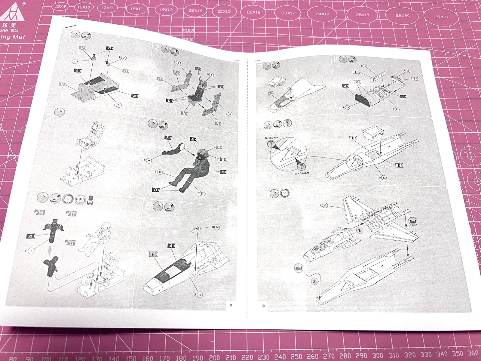

Fimally I printed the instruction of a MLU kit, so I will not use the wrong parts during the build.

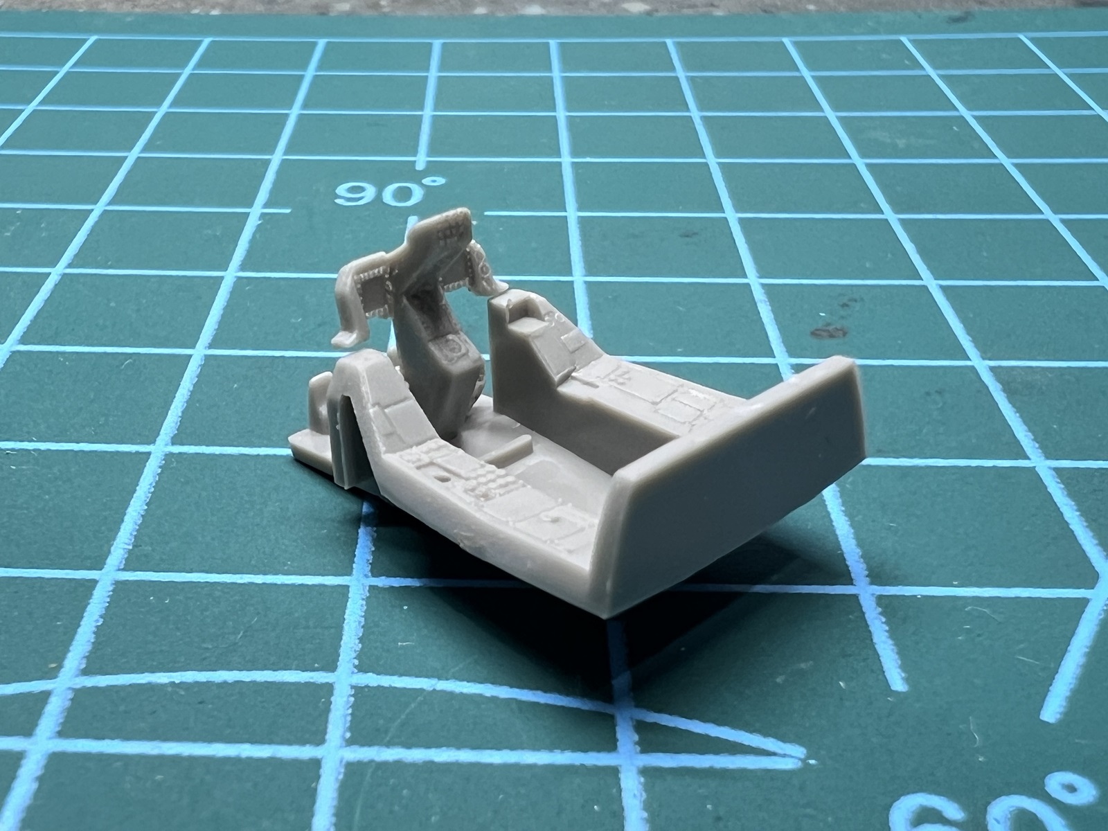

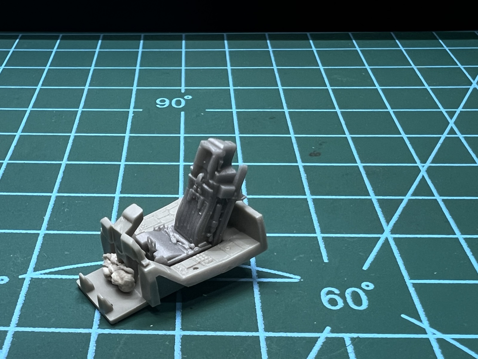

I did a light wash and dried fit it to the tub, the instrument arrangement is right but it's crying for proper decals for the dials. Let me think about it.
The 3D print seat fits the tub well, only I found this is the type with fixed pitot, while it should be the folded type on the UAF aircraft.
Fixing it was easy - I cheated.  I just cut off the part and glued it to the side.
Next I free the Terma pylon from the trees and spayed a thin layer of putty, they are looking good.

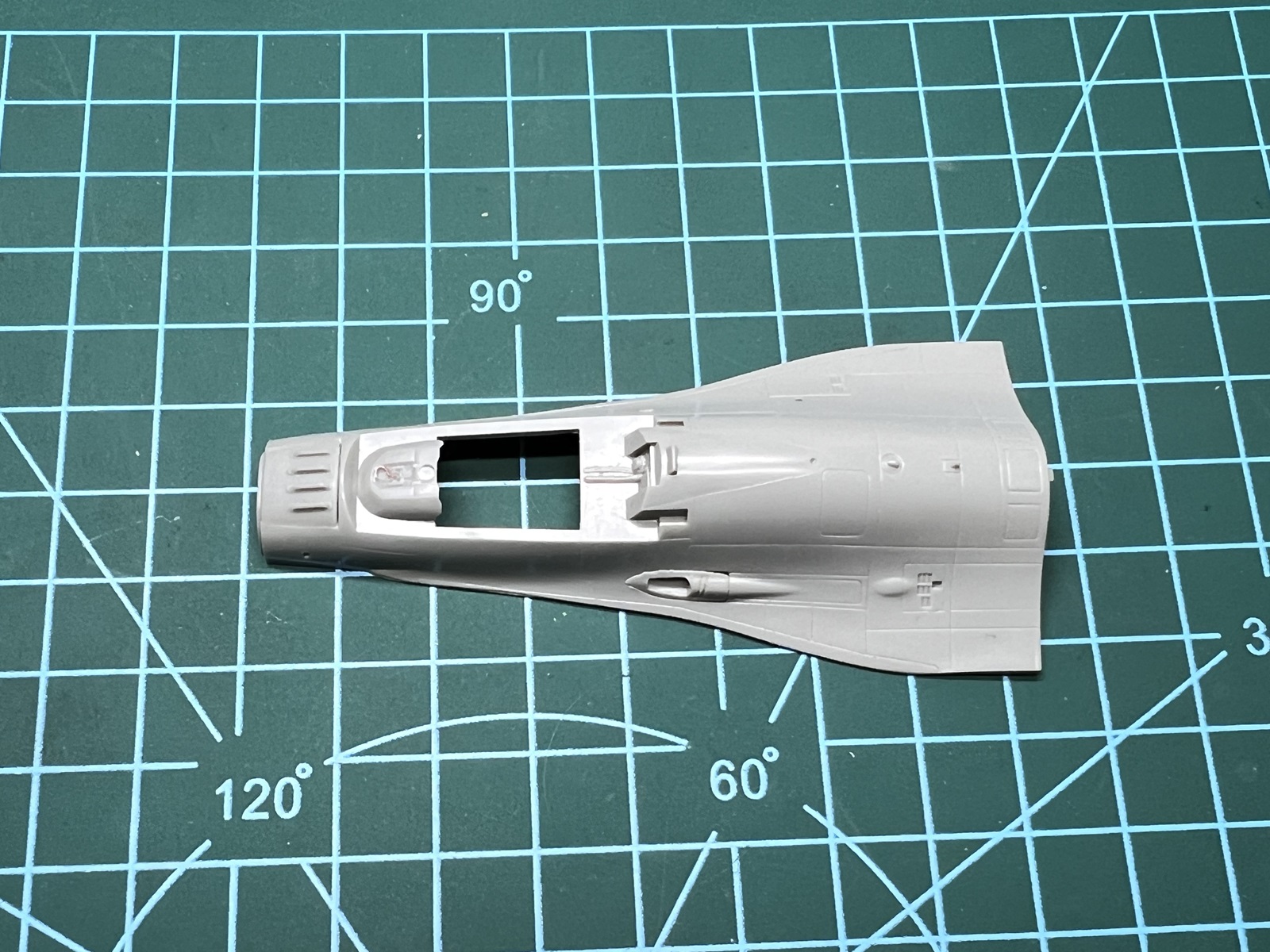

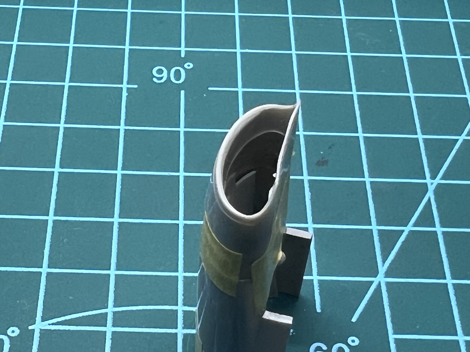

I also dried fit the intake trunk. There is some flash, but my bigger worry is whether there will be a step when gluing the front wjheel well and the intake lip,

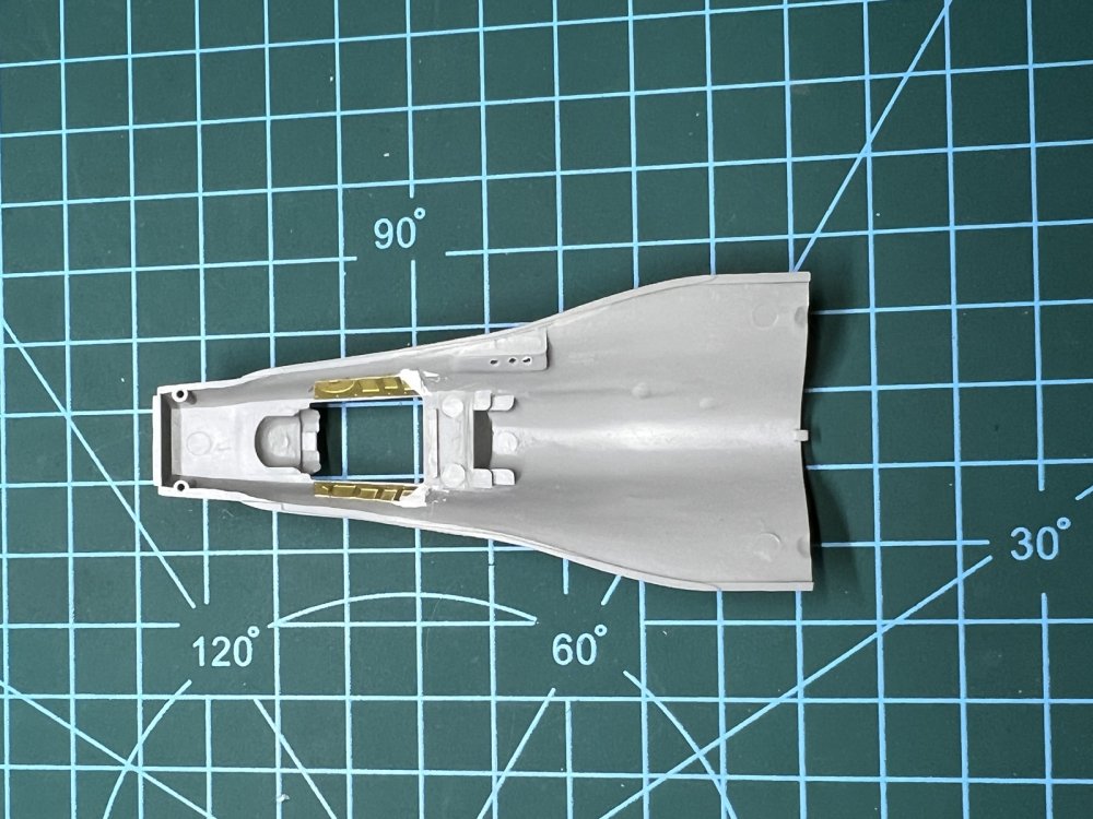

PS. I don't know what happened I can't eidt the post with pictuers, so to be short, the following are the small updates:
cable added to the IP coaming, IFF panel and gun vent added:

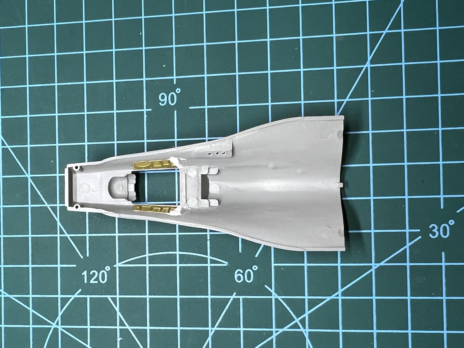

DM PE for internal structure:
I also bought the Platz PE for the idetails:
