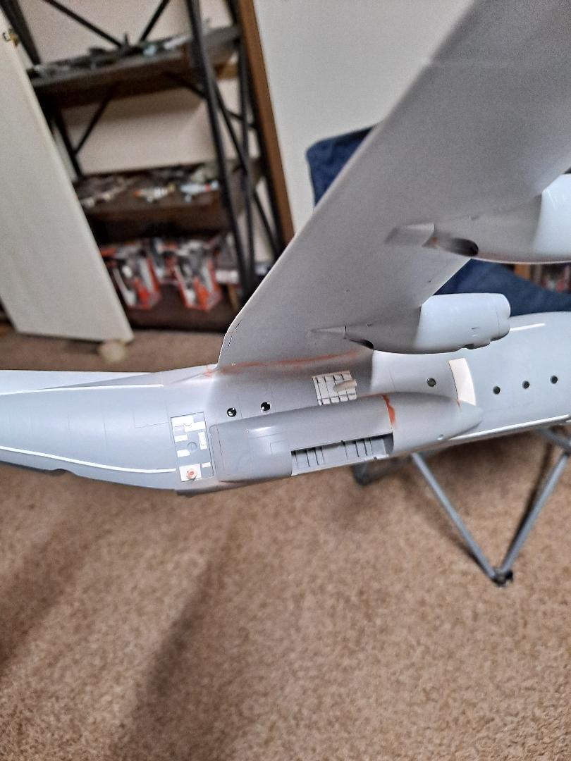

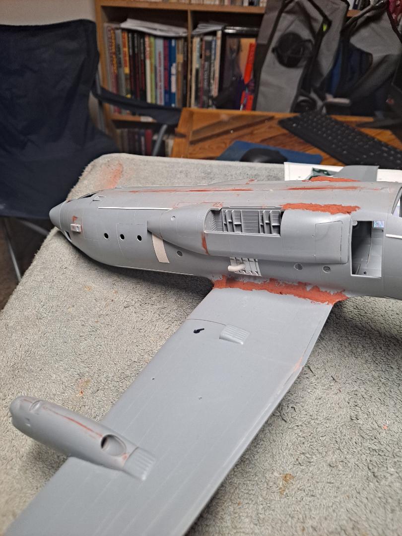

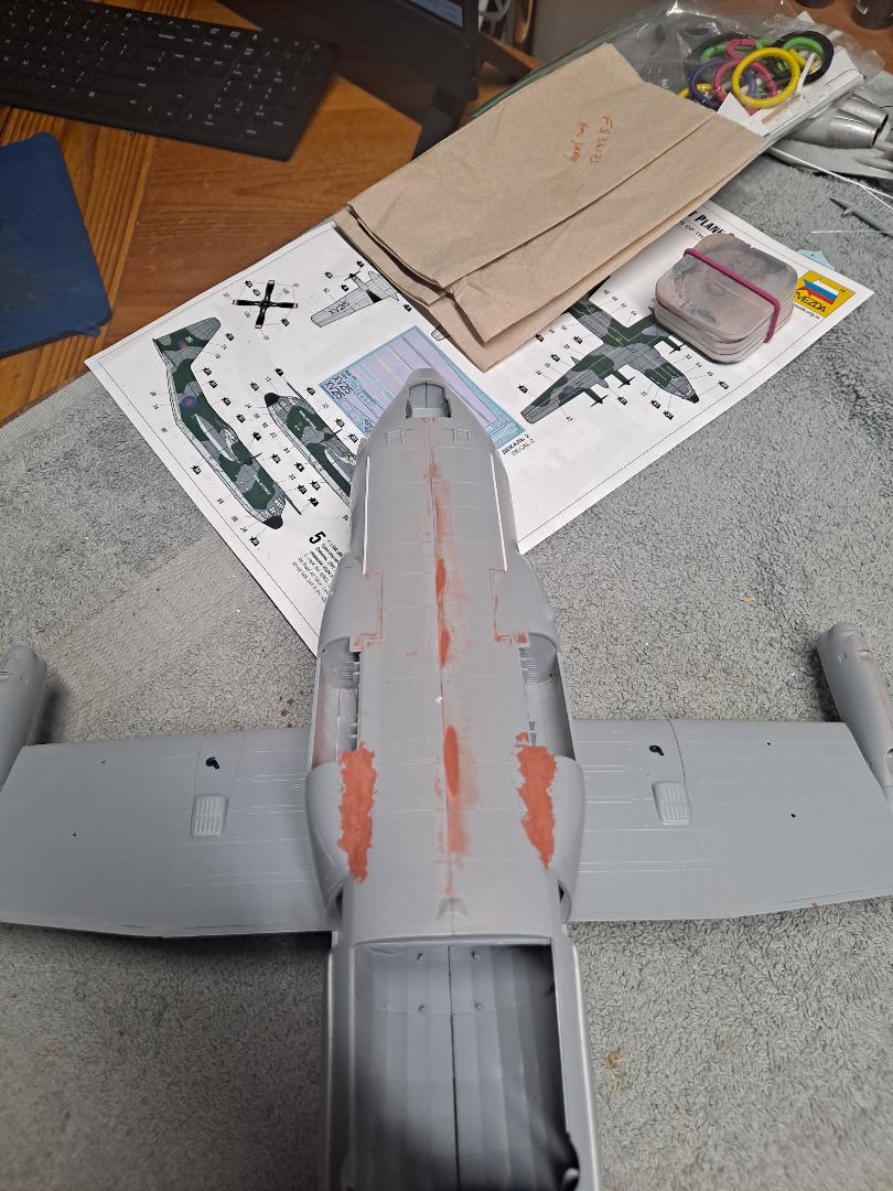

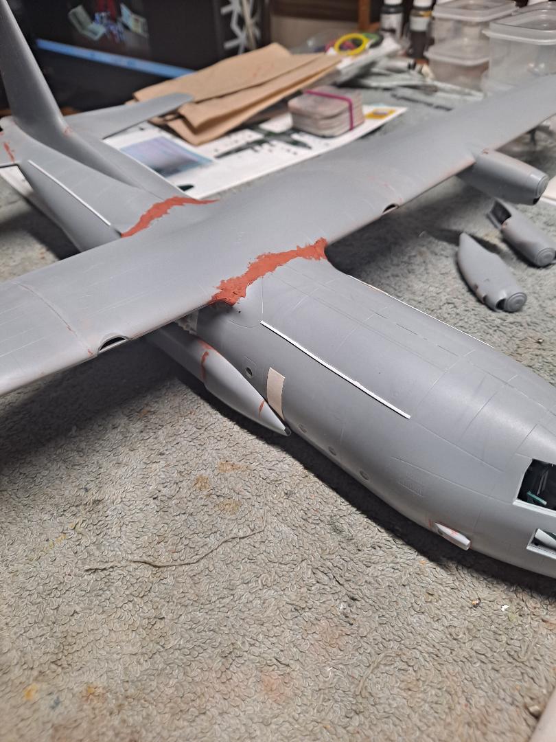

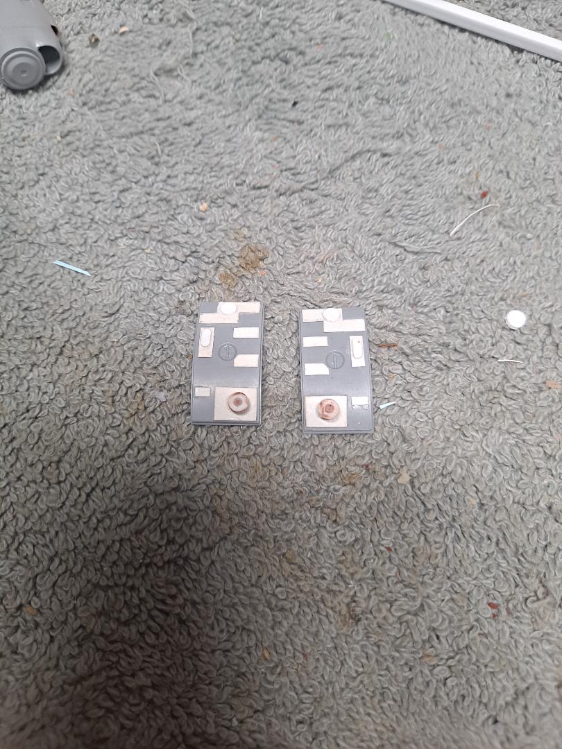

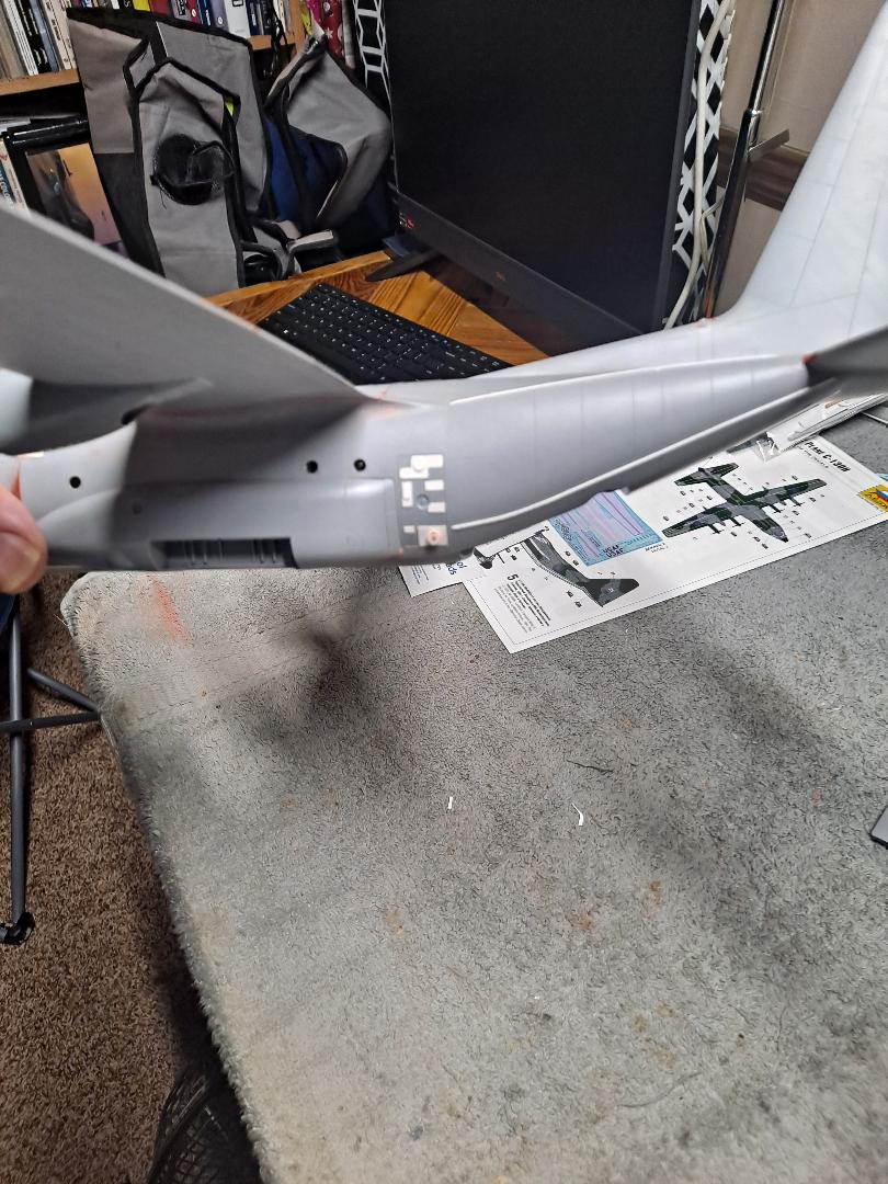

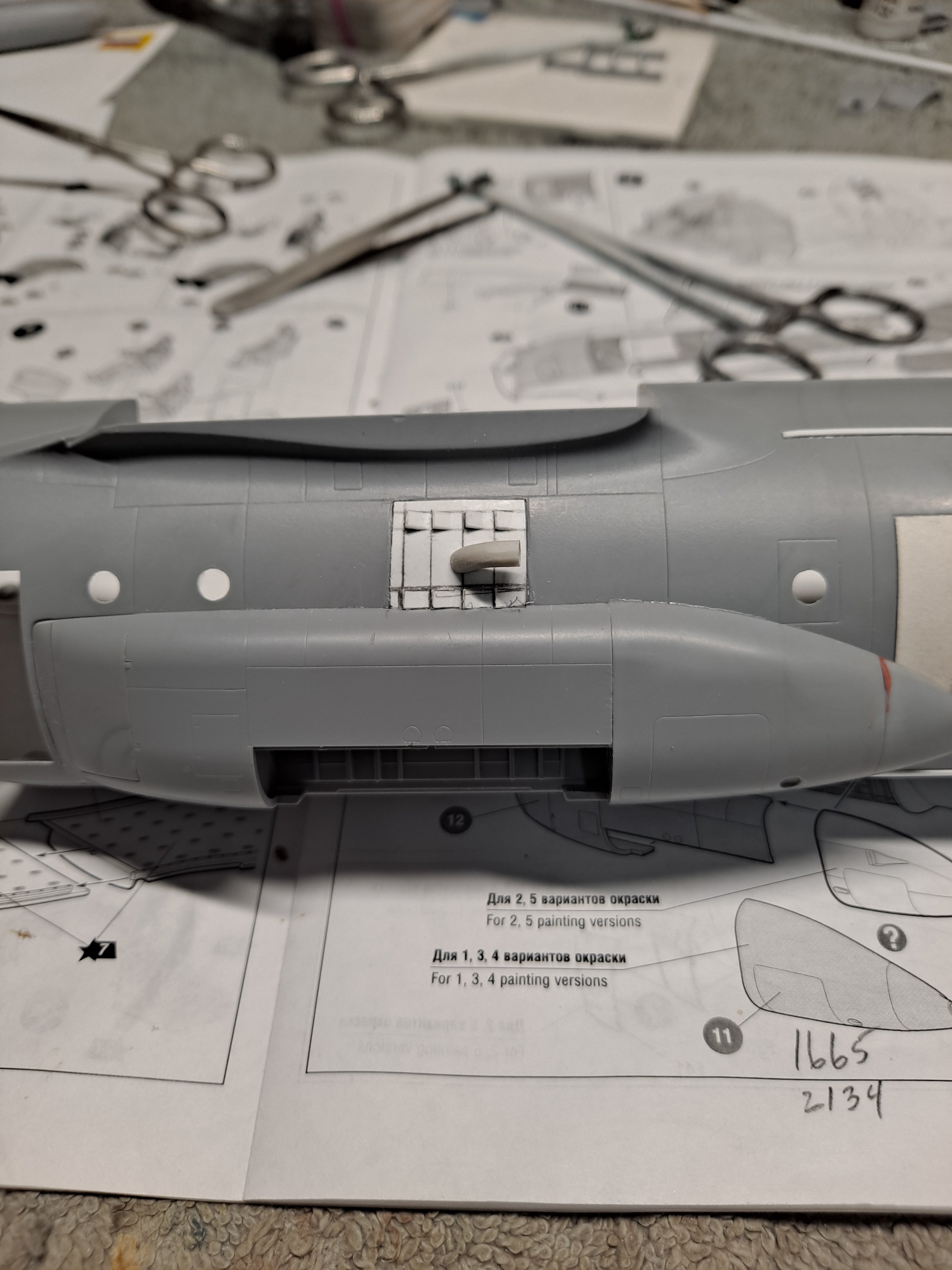

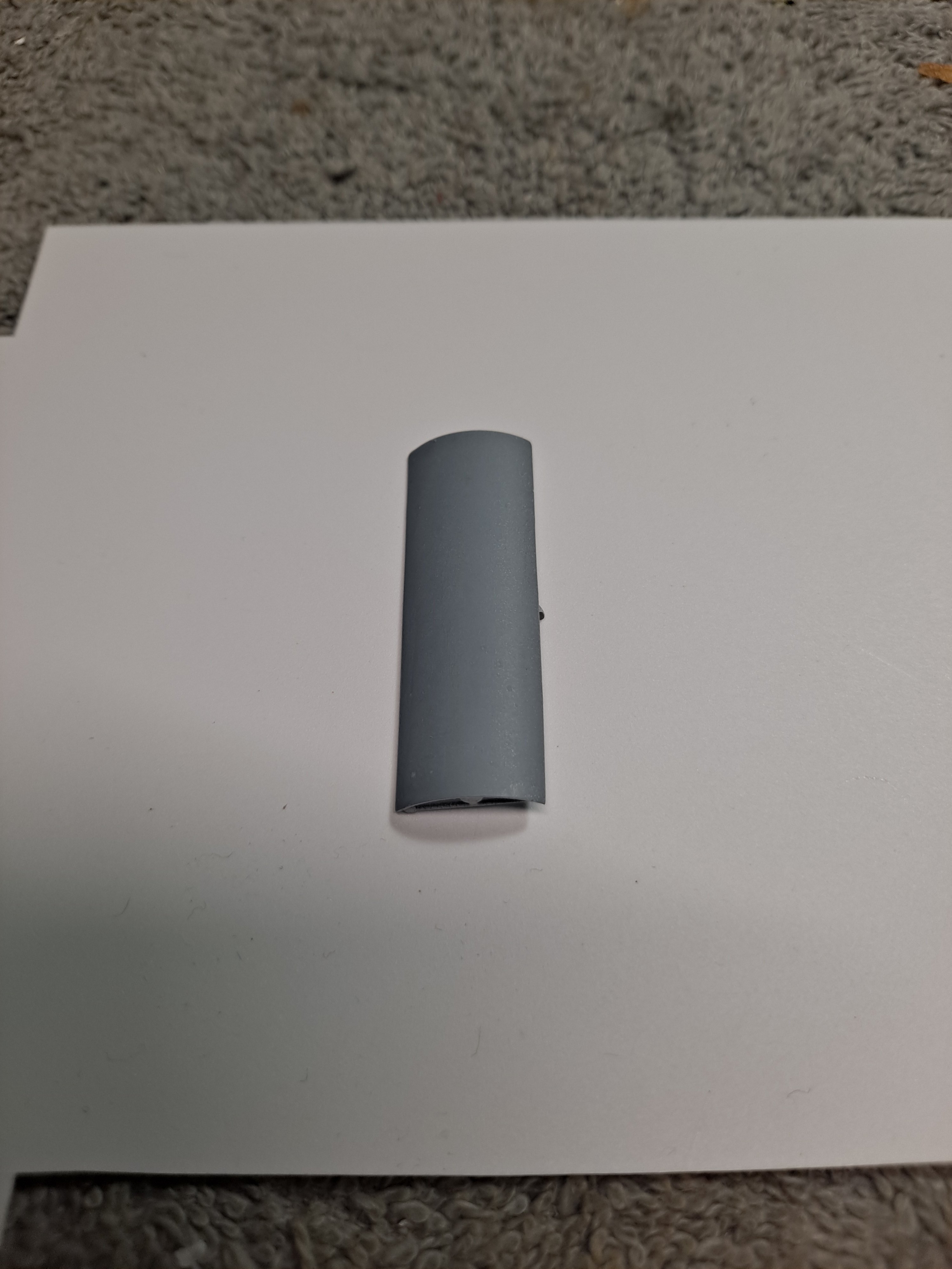

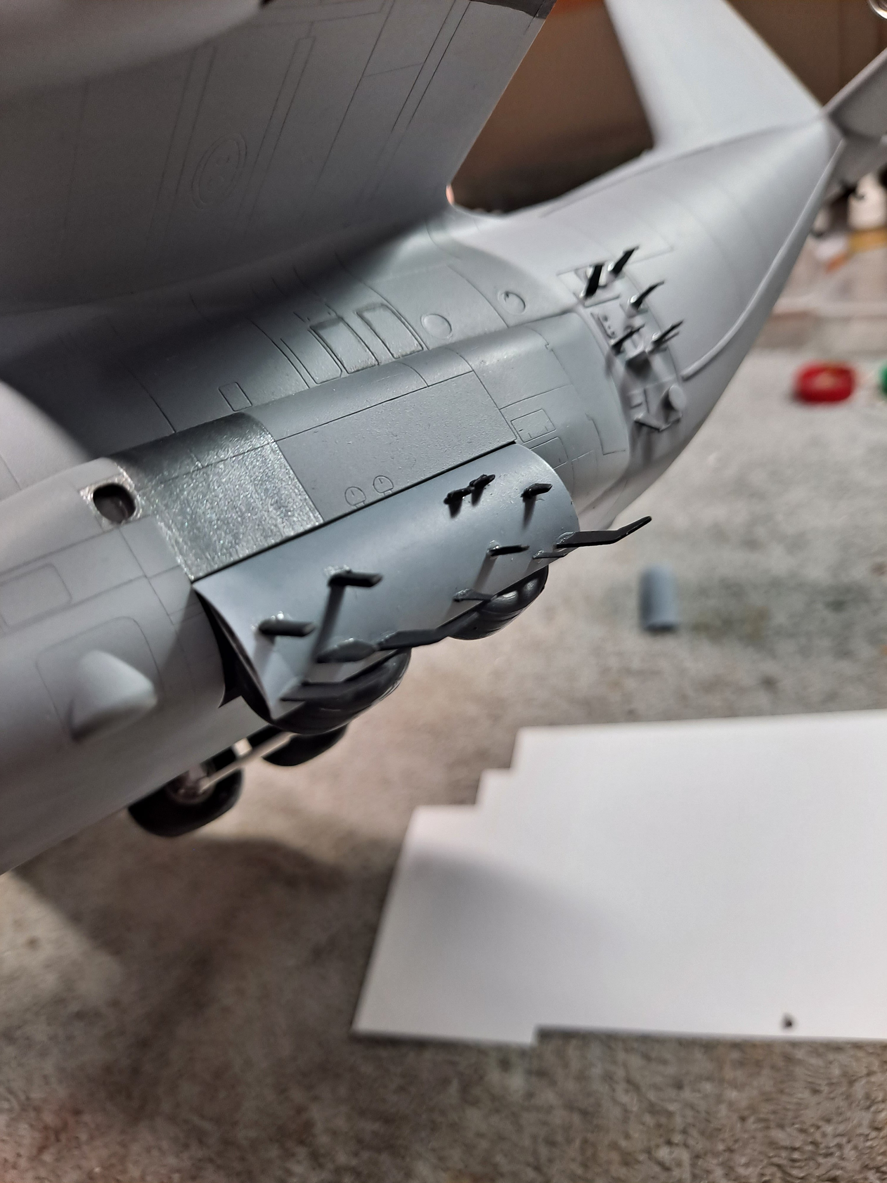

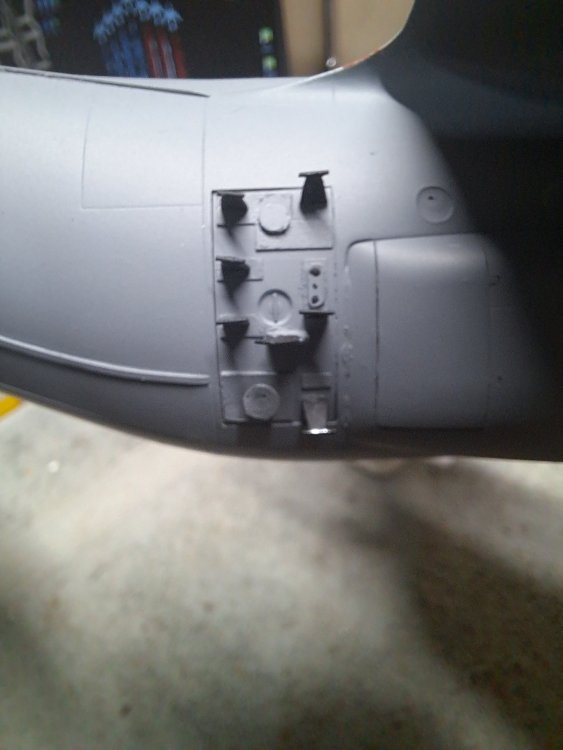

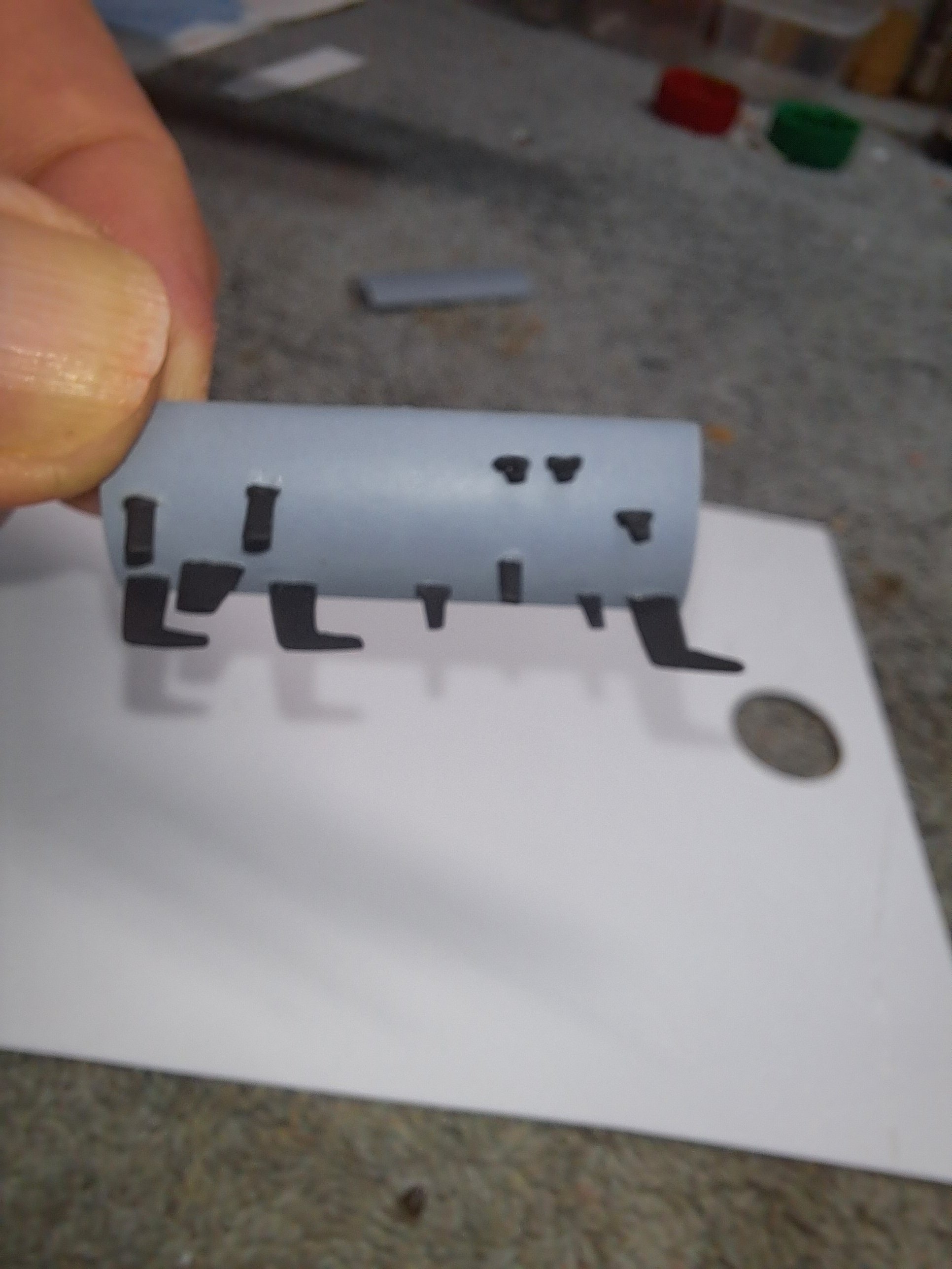

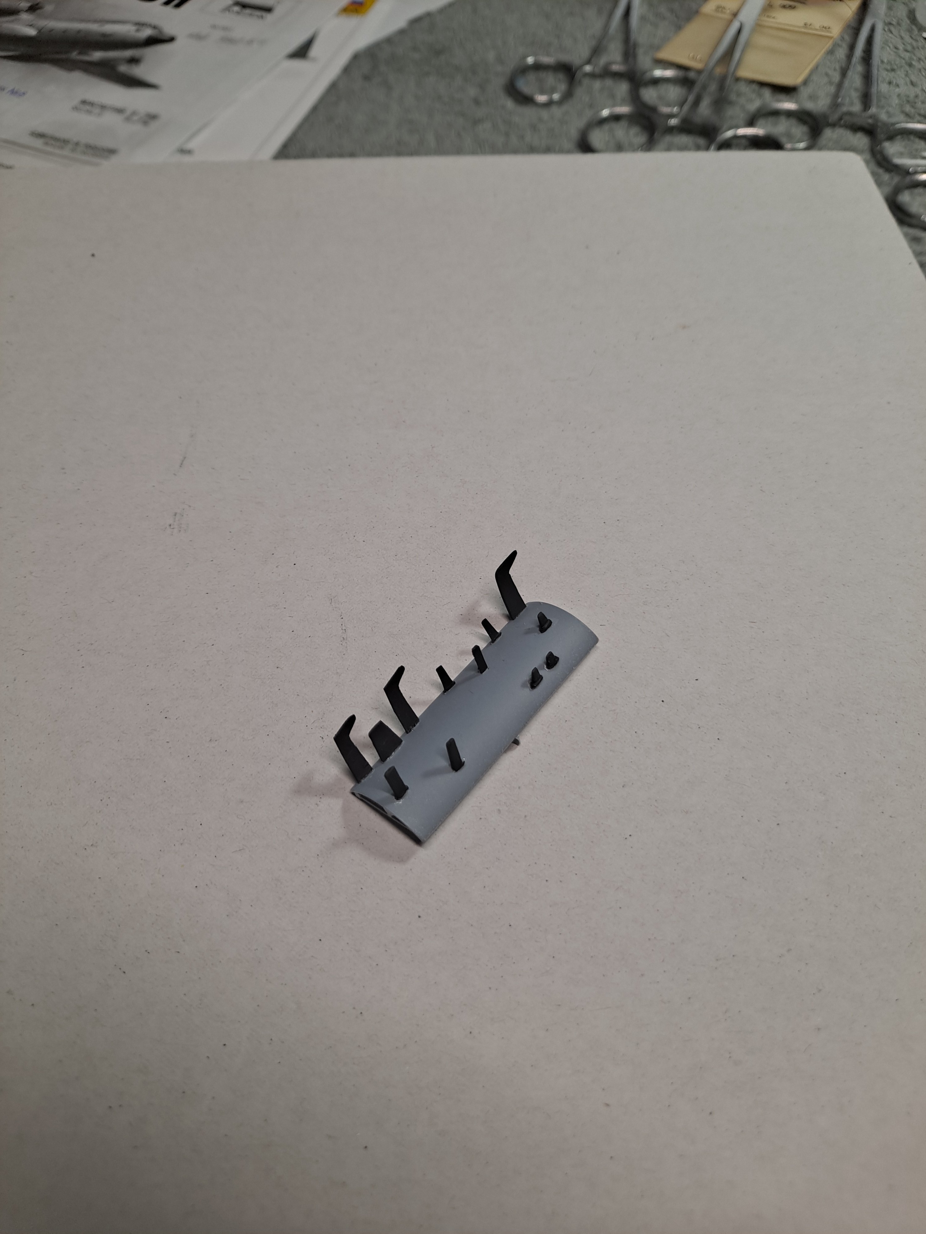

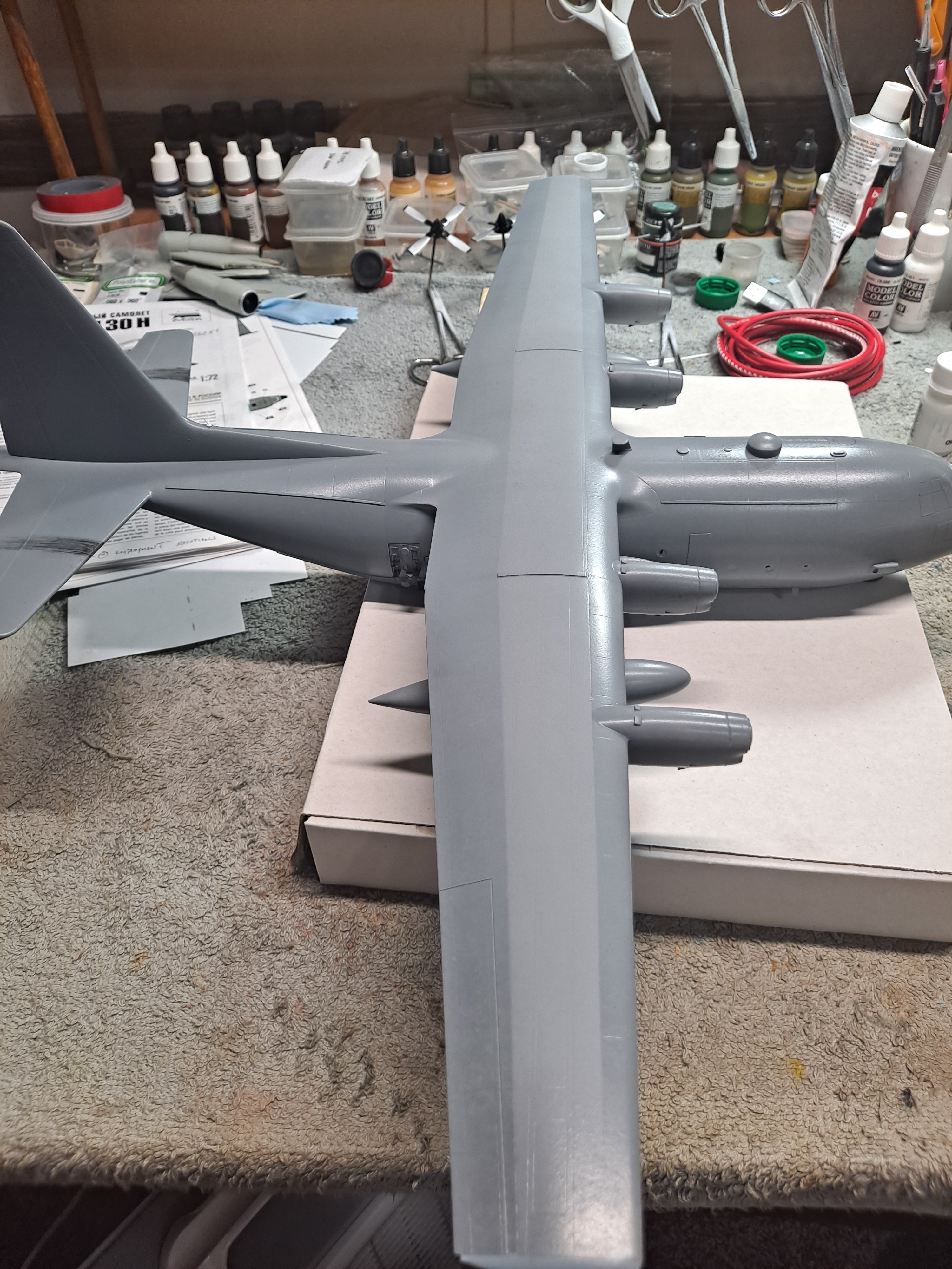

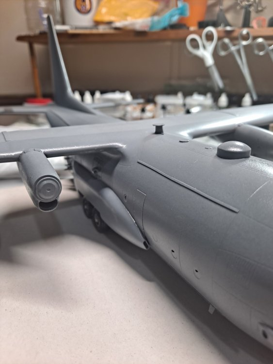

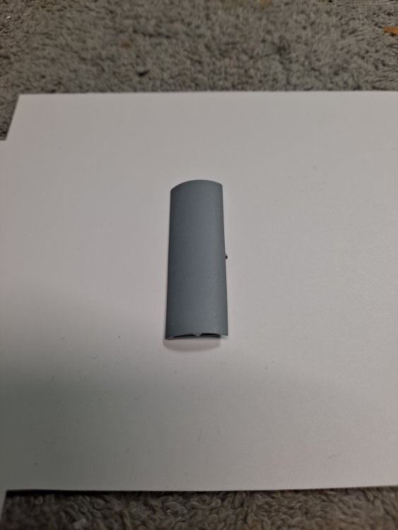

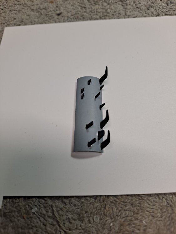

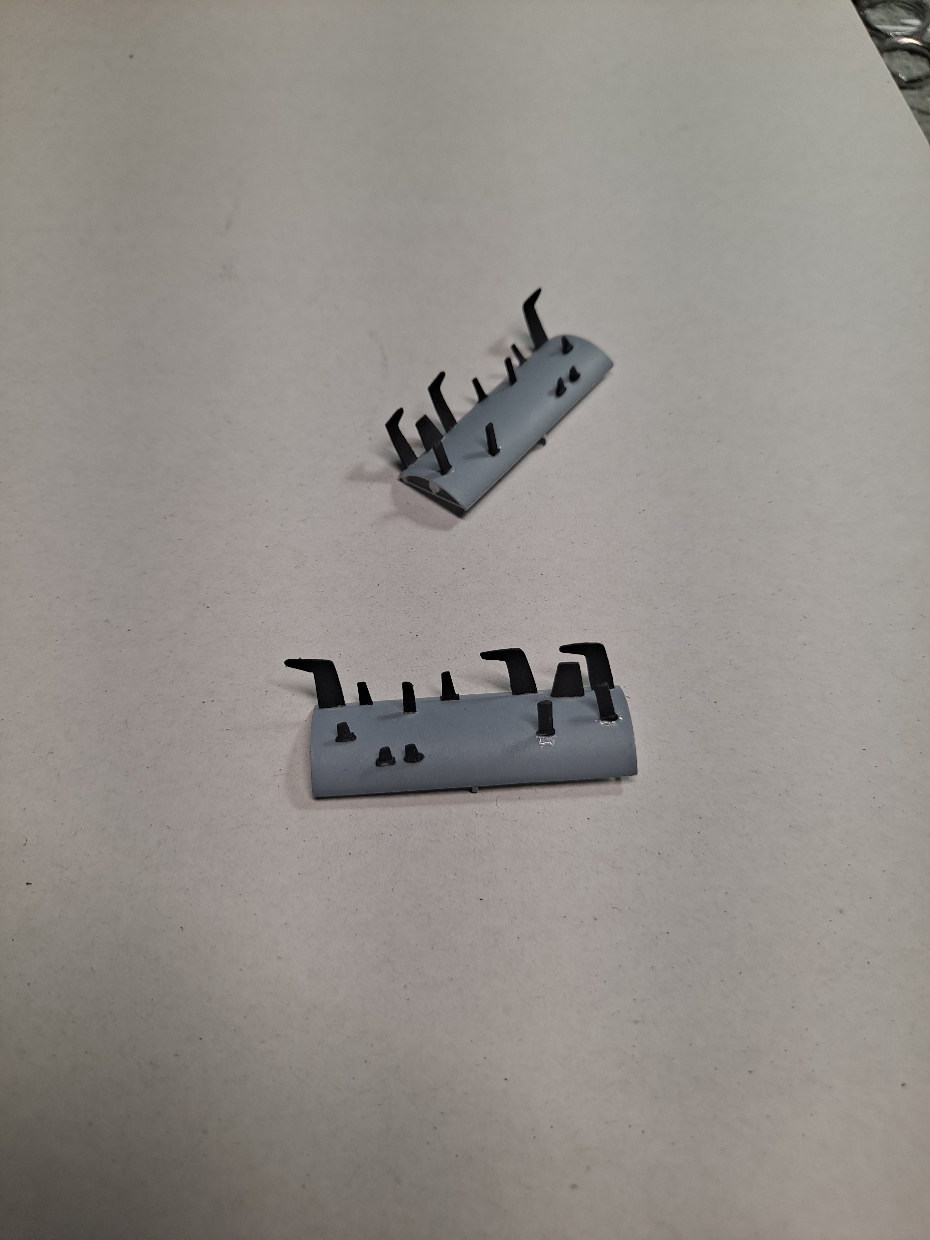

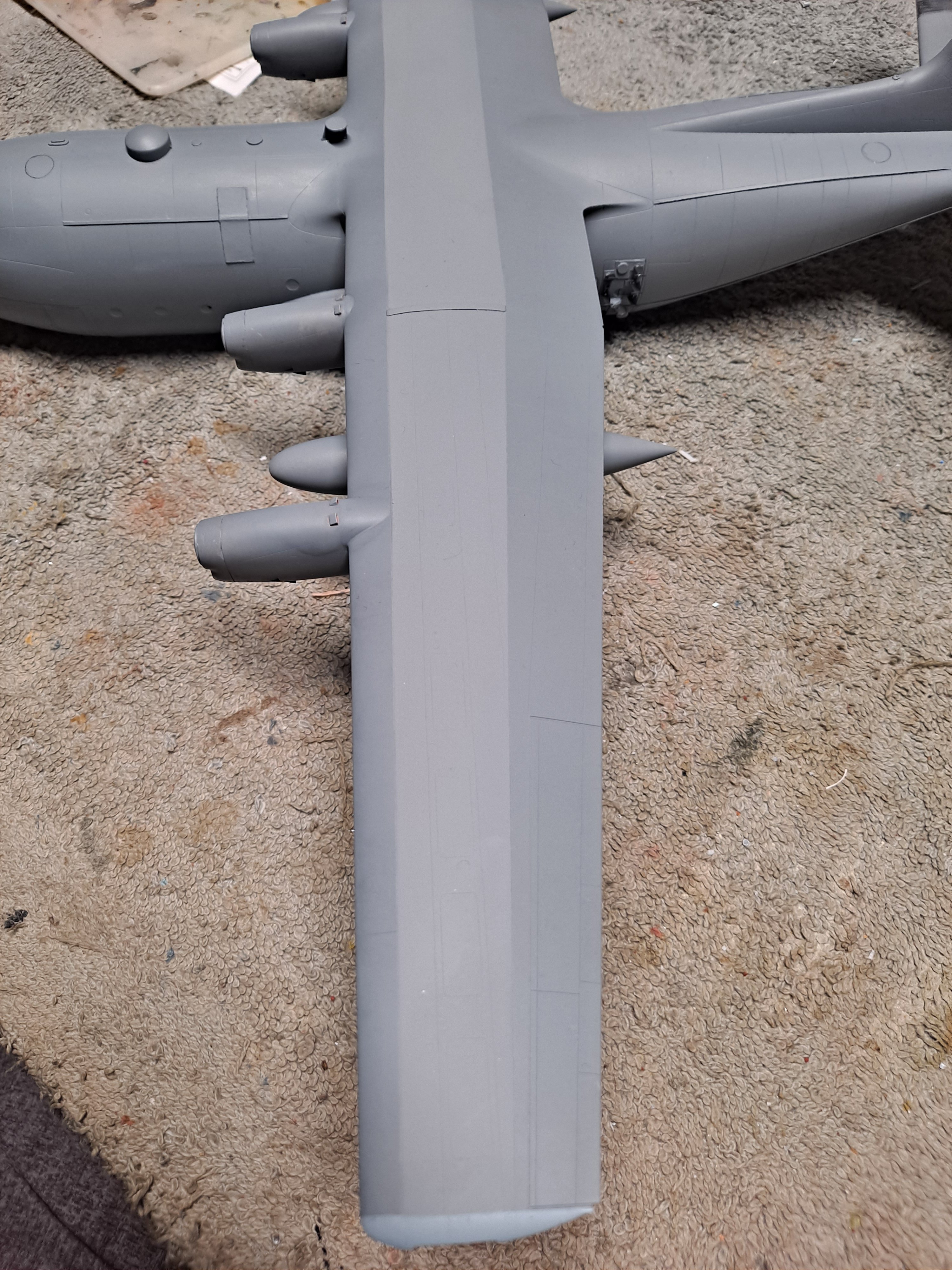

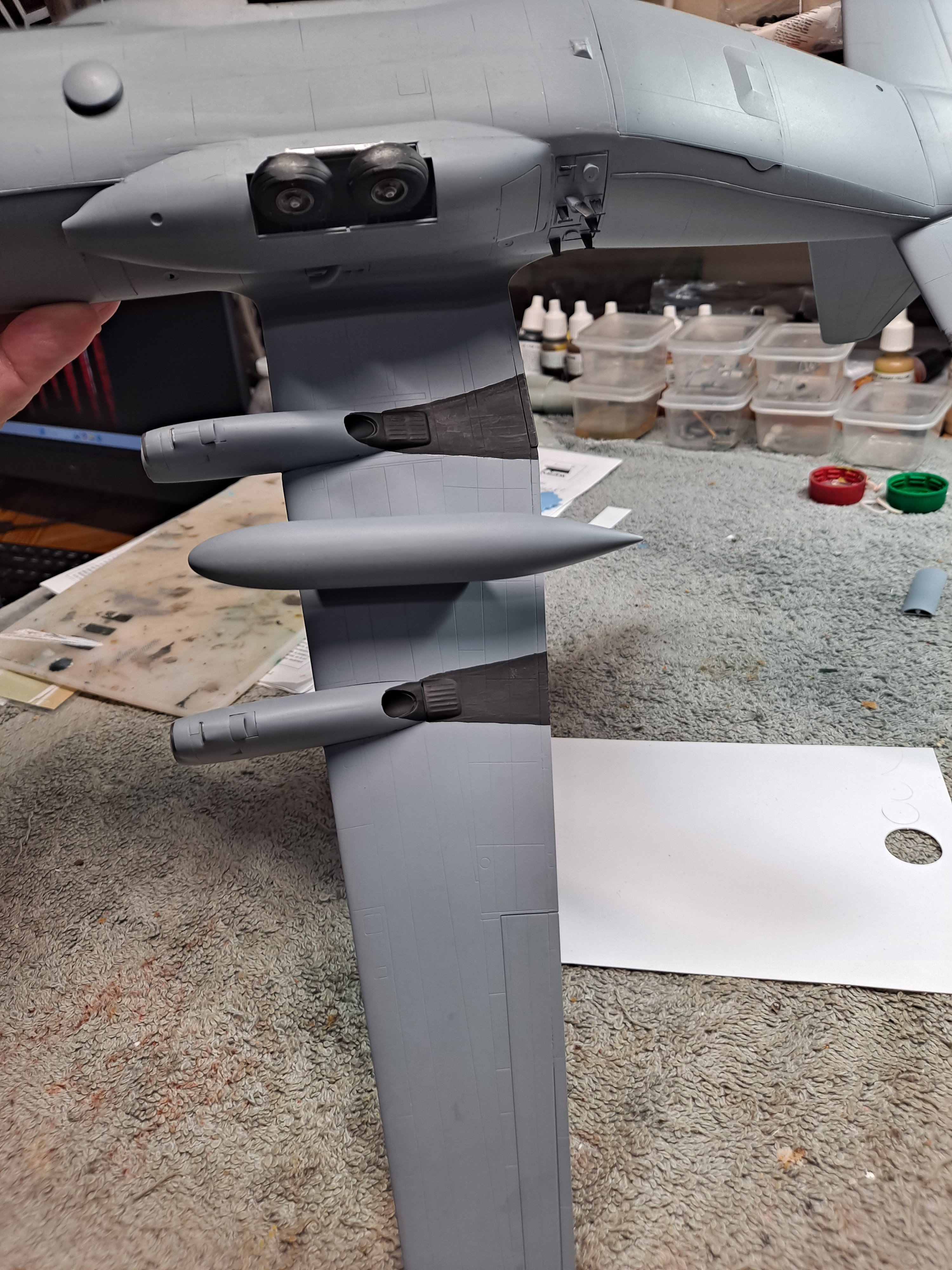

Trooper111 Posted October 7, 2024 Share Posted October 7, 2024 (edited) While in the Air Force and assigned to Dyess Tx. I often saw "them" come and modify the plane where it would get red roped off and guards posted at the four points of it before it would disappear for a few weeks, then come back and turn back into a plain jane again. I walked around as close as I could and made mental pictures for the future. I scrounged the net for photos, but they truly are as scarce as the plane... Yes, there are some, and they will help but not many. I got some pictures from a regular on here and Britmodeller. And so, it begins Moving onward, I was able to complete the beef up strips and apply an initial layer of bondo over the gaps. The wheel sponson fairing gave a bit of trouble with a second touch of bondo being needed but not sanded yet. The wings and belly still need some sanding to make everything fit smoothly. I have begun making the antennas one by one, instead of making one set and then copying them with resin or even 3d duplicates. The doors have their initial "Pre-patch" panels installed where the actual antennas will fit onto them... It's just slow going. The wheel well door antenna will be finicky and I'll have to be extra careful not to break them off, once installed onto the gear doors... So, they may be closer to the end. More as construction continues Edited January 6 by Trooper111 Quote Link to post Share on other sites

Trooper111 Posted October 7, 2024 Author Share Posted October 7, 2024 Yes, A Senior Scout C-130h. I'm still adding features to the external fuselage right now such as the beef up stringer that goes along the rear fuselage. The fuselage beef-up plate, in case the propeller separates from the engine(s) at the moment and such. This is the 1/72 zvezda C-130 model, so itll be tons better than the Italeri one. I'm working on it a bit each day. I have Drawdecal brand for the Dyess markings of an H... the rest will be scrounge Quote Link to post Share on other sites

stevee671 Posted January 2 Share Posted January 2 (edited) When I was working the Senior Scout when I was at Dyess, I recall a lot antenna's on the paratroop doors and the main landing gear doors. I'm surprised this is being talked about here as that program was very classified when I was TDY working Senior Scout/Flowing Pen Mission out of Howard AFB, Panama. I assume, by now, Senior Scout is no longer a relevant system. Edited January 3 by stevee671 Quote Link to post Share on other sites

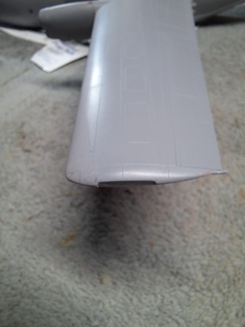

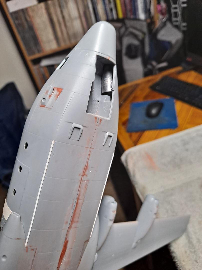

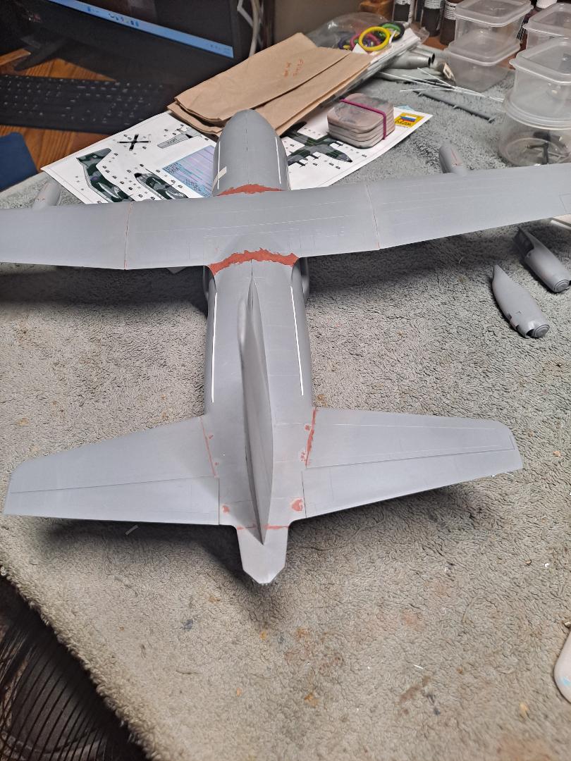

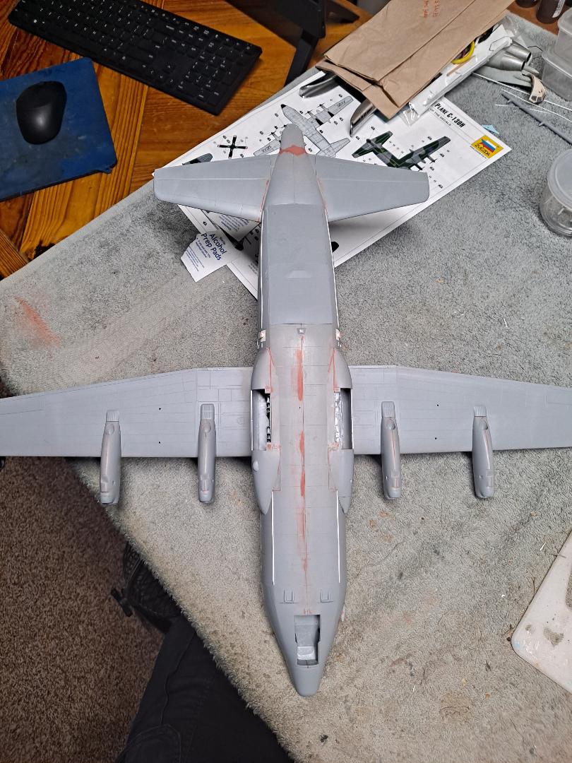

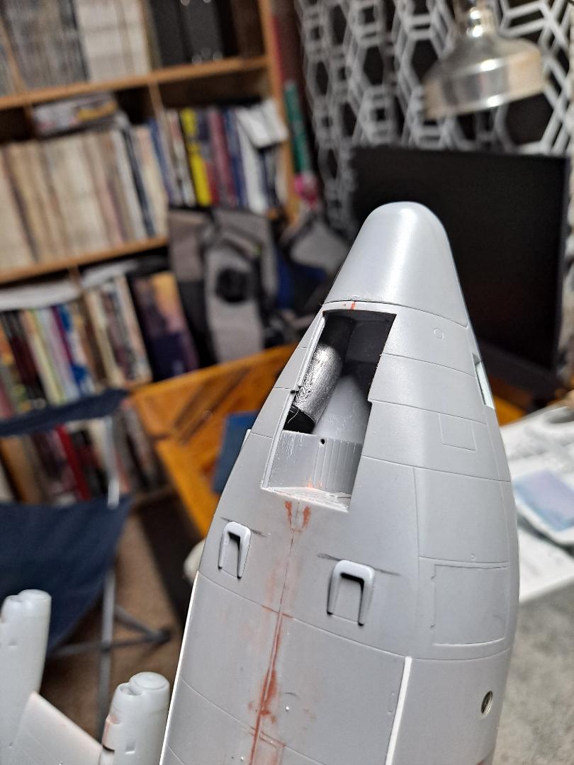

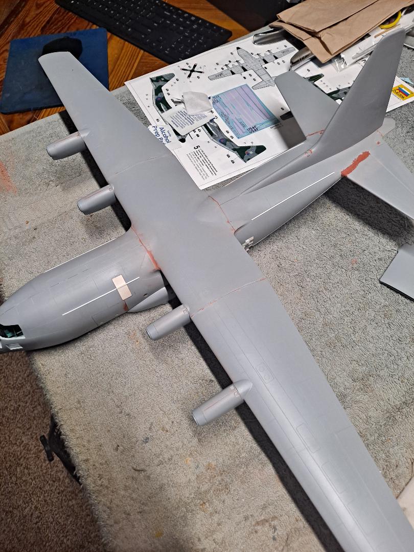

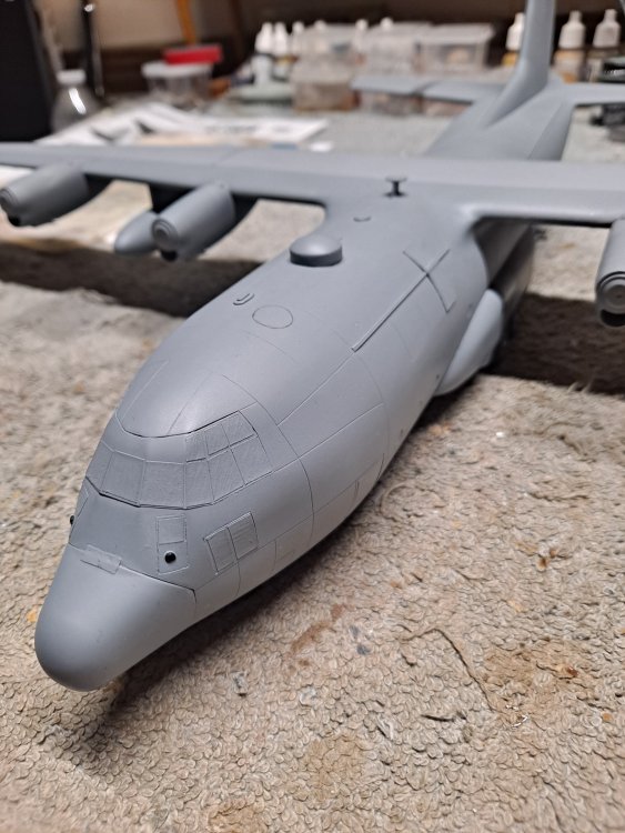

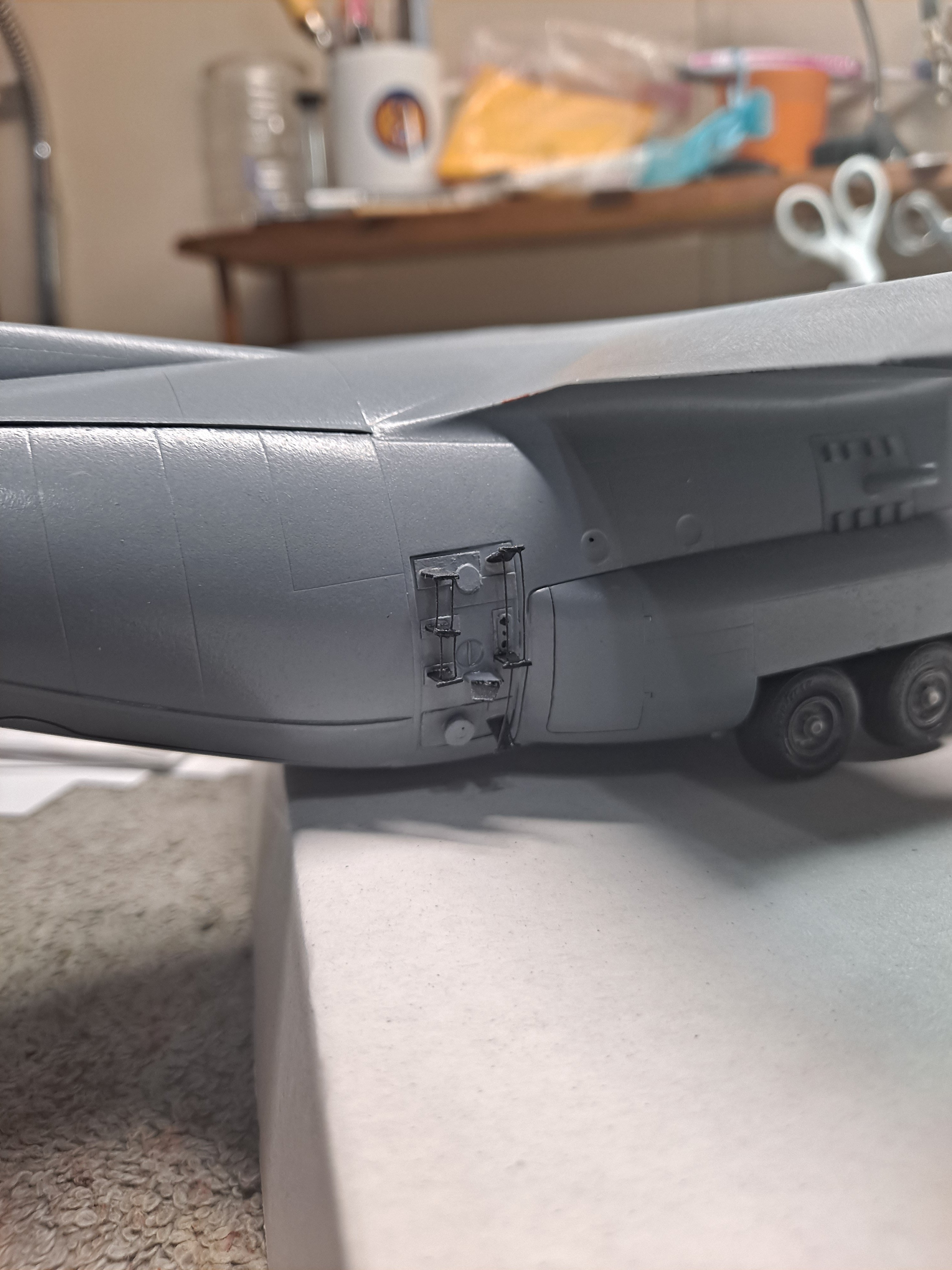

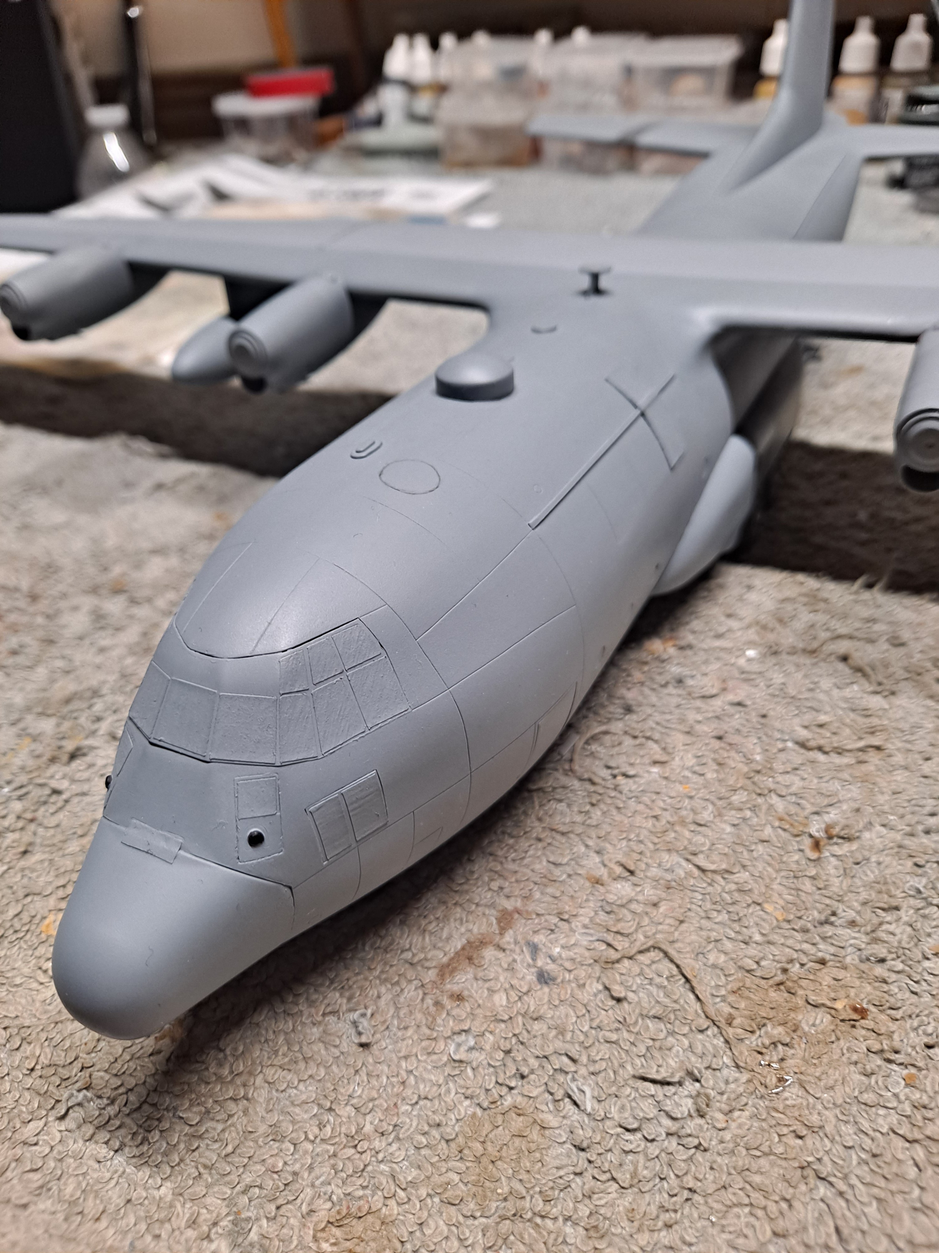

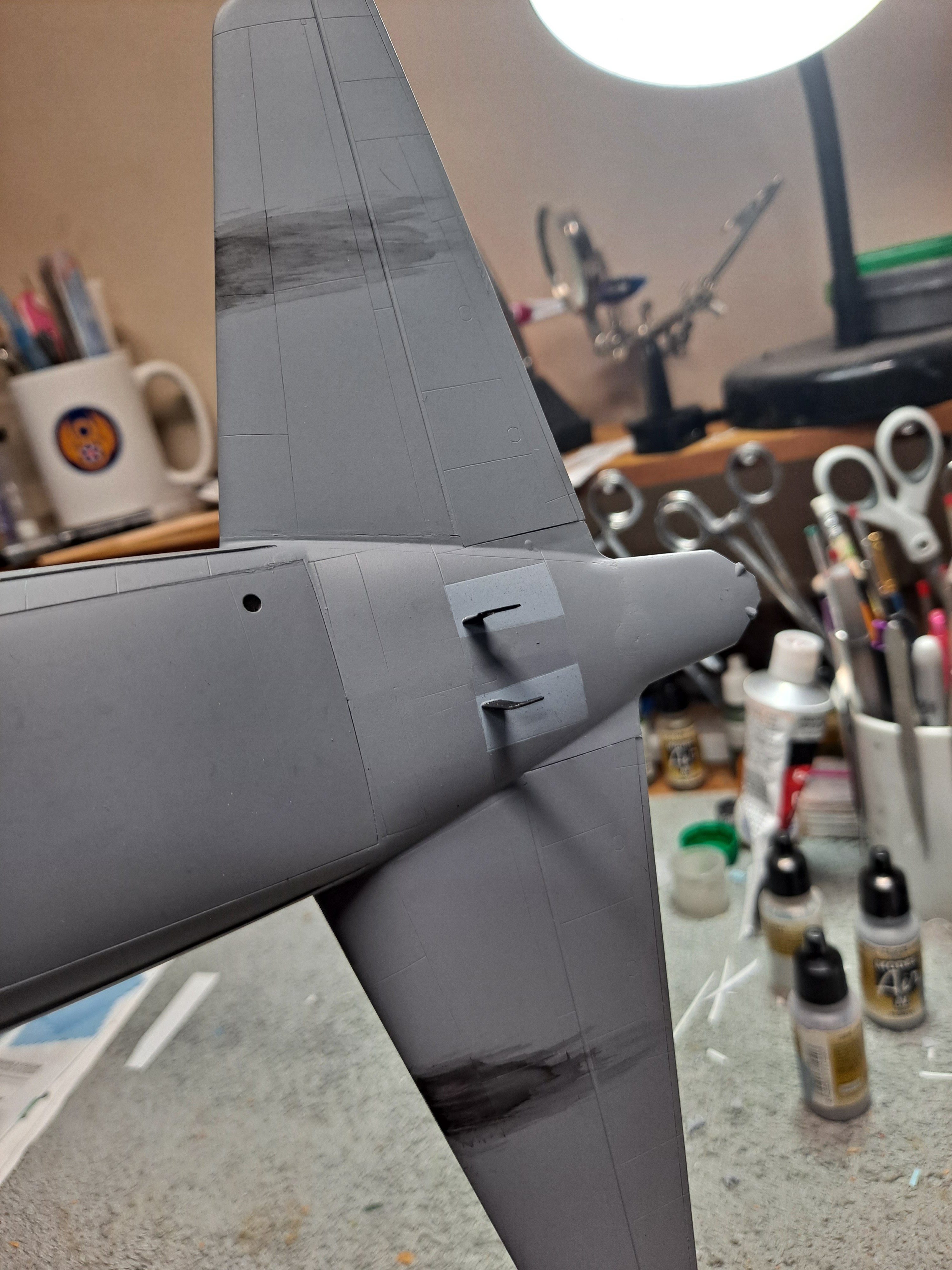

Trooper111 Posted January 7 Author Share Posted January 7 A bit more progress today as it was an "Inside day" here, because of the cold. I had to reglue and Bondo the left horizontal stabilizer because of my clumsiness. I sanded smooth yesterdays Bondo on the wings & belly then added the rear troop doors with the base for the antennas on them already. Added the two inside engines after sanding the wing/fuselage seam but may need a bit of touch-up with Bondo here and there, just to smooth the seam/gap on the two engines. I was able to coax the windscreen into a better fitting shape with about 30 mins use of hot water and minimal bends till it fits soooooo much better. however, I'm still hesitant on using liquid cement on the clear parts, but need something stronger/faster than Testors clear parts adhesive (which I have).............................. Suggestions Anyone? While building the plane, Before I added the nose, I filled it with pieces of cut up fishing weights and super glued them in place, I also added "bullet" weights to each side of the nose wheel bay. They will not be seen once the nose gear, wheel and door are installed. Also, I forgot to post the picture of the Wingtip... When the Senior Scout package is installed, the wingtips are changed out because they too are antennas, but do not have the normal "Wingtip lights" installed in place and the normal rounded wing tip has a flat edge to it that is positively noticeable. Ok, back to work on the antenna farm. More to come later on. Quote Link to post Share on other sites
A-10 LOADER Posted January 7 Share Posted January 7 When I installed my windshield on my AC-J, I used Tamiya extra thin. Steve Quote Link to post Share on other sites
