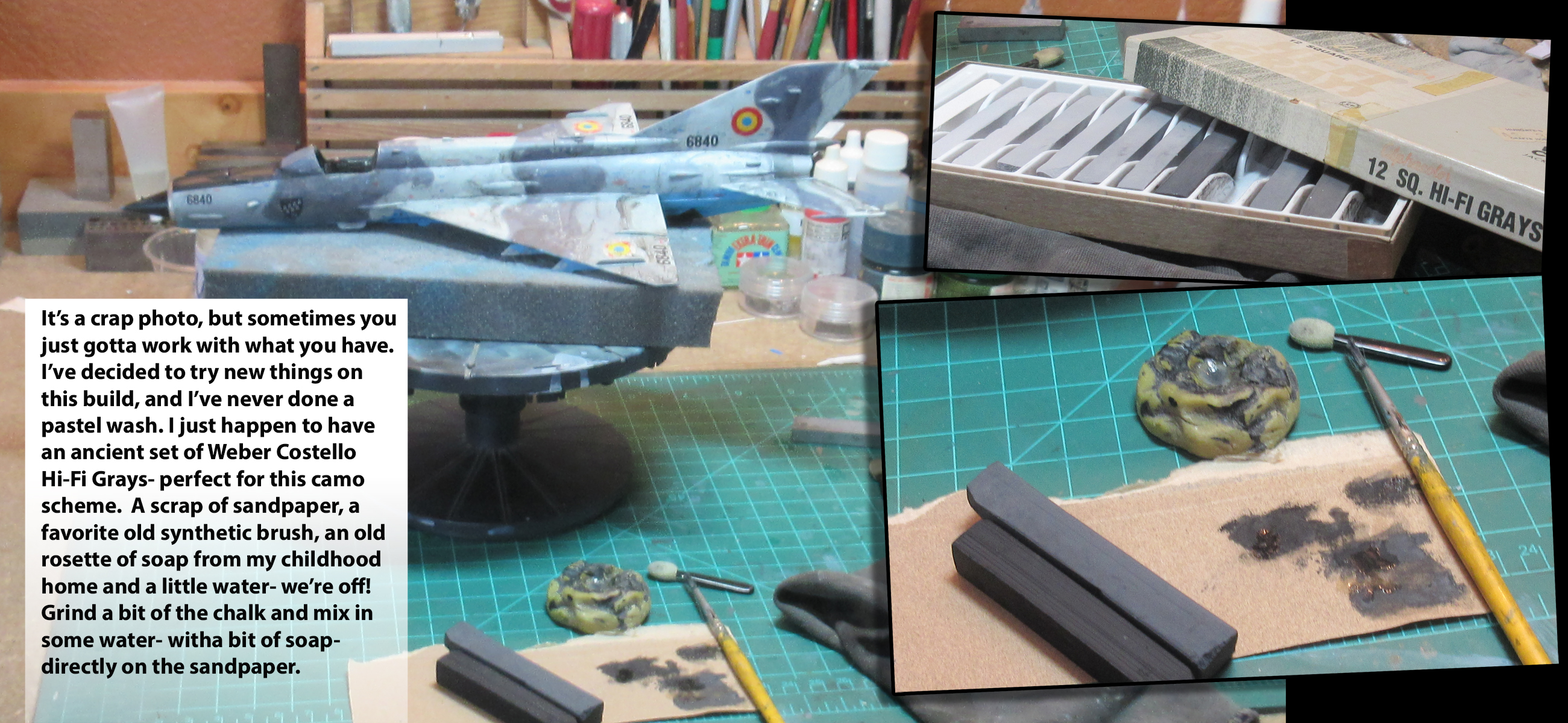

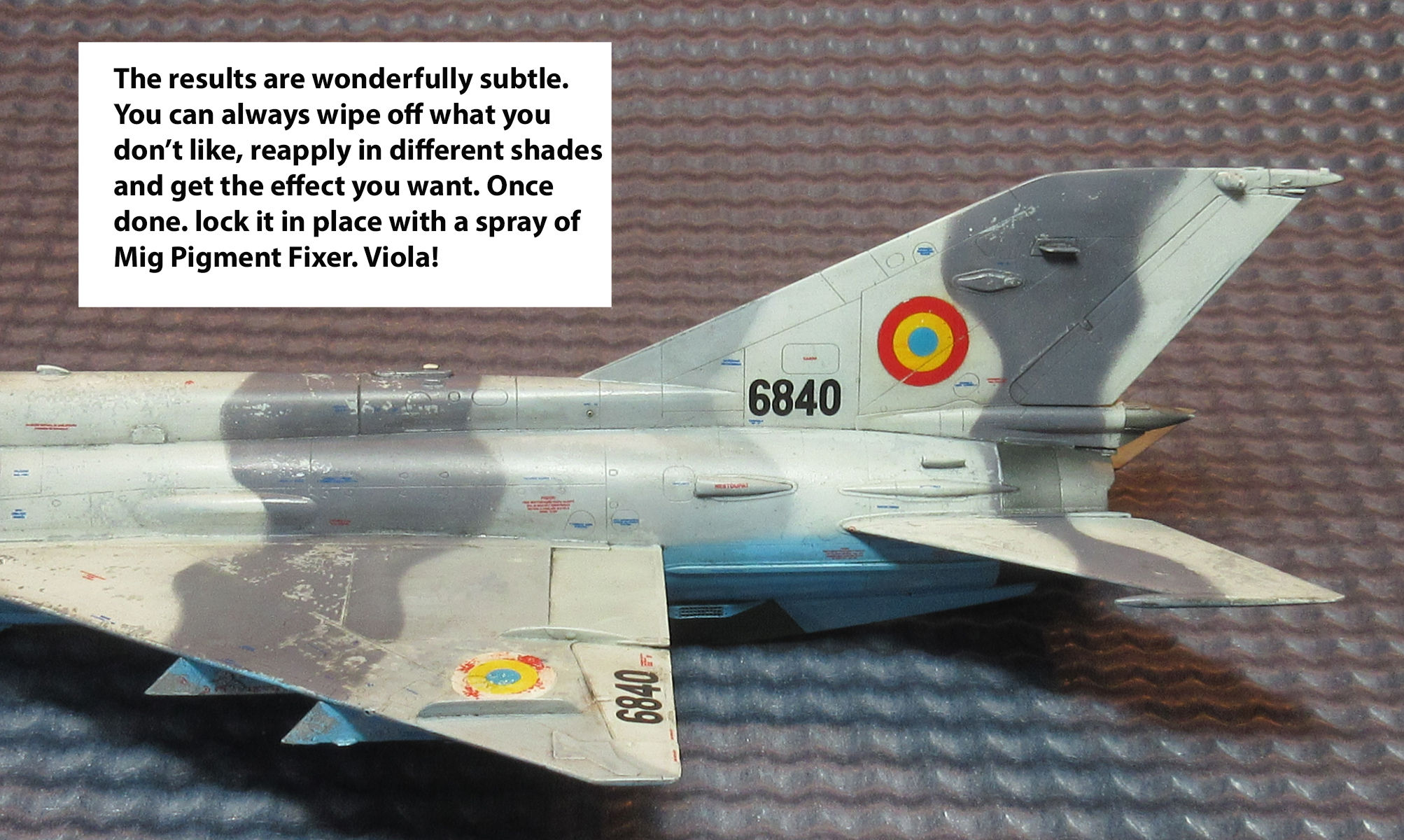

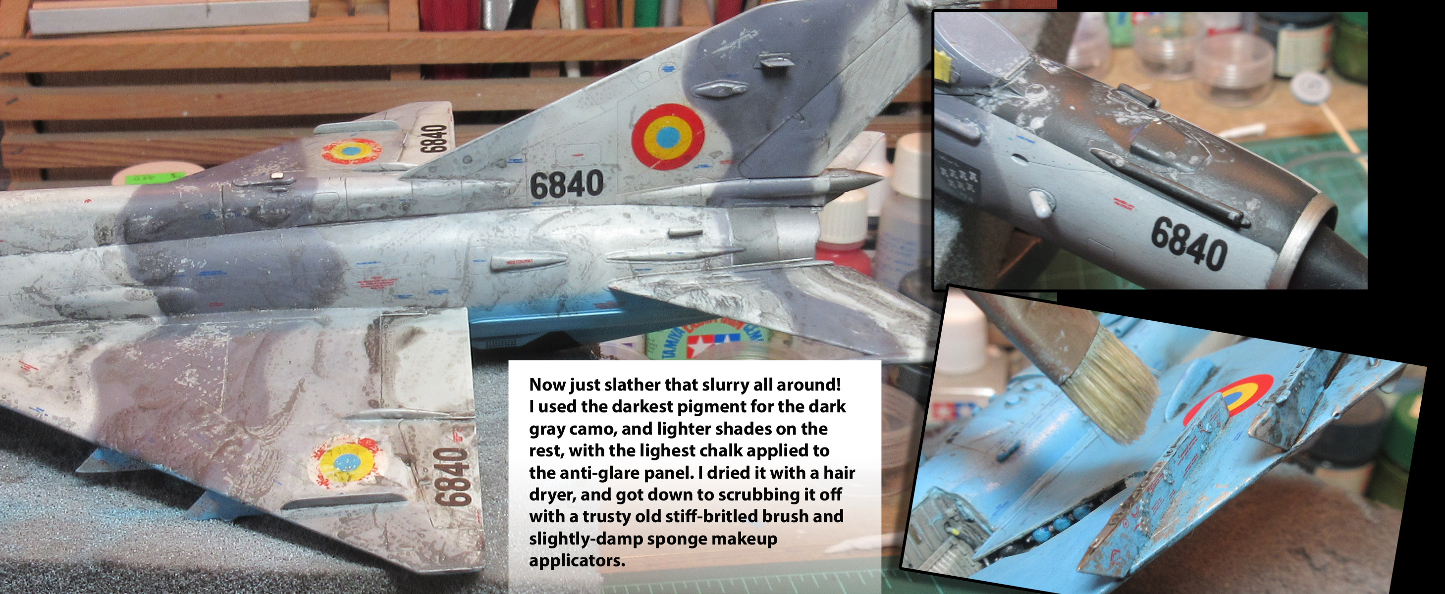

chukw Posted November 2, 2024 Share Posted November 2, 2024 (edited) You can sand artists' pastel sticks of any color to make a great panel wash with water and a bit of soap. Apply to a gloss or satin finish, let dry and wipe away the excess- no fuss! Use the straight dry pigment over a matte finish to apply streaks, etc. Edited November 4, 2024 by chukw Quote Link to post Share on other sites
