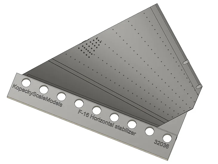

Solo Posted November 3, 2024 Share Posted November 3, 2024 I am building Kinetic's F-16D USAF 310FS 'Mig Killer' now. I know this aircraft has got horizontal stabilizers with 6 rows of rivets. Questions: 1) Are the rivets on these stbilizers only on the top surface or on both surfaces? 2) Which variants of F-16 has got those stabilizers rivetted, and which ones has got clean surface? Anyone can help? Quote Link to post Share on other sites
strikeeagle801 Posted November 3, 2024 Share Posted November 3, 2024 I don't know which ones got them and which ones did not, but the stabs are interchangeable left and right, so if they have them on the top surface, they are going to have them on the bottom as well. Aaron Quote Link to post Share on other sites
habu2 Posted November 3, 2024 Share Posted November 3, 2024 Rivets on both sides, the inner structure of the stabilizer is a "W" pattern web (vs individual spars) Quote Link to post Share on other sites
Solo Posted November 3, 2024 Author Share Posted November 3, 2024 1 hour ago, strikeeagle801 said: I don't know which ones got them and which ones did not, but the stabs are interchangeable left and right(...) Aaron Are you sure that? I have always seen left stabiliser with upper static dischargers, and right ones were always underneath. Never the other way around. Quote Link to post Share on other sites
strikeeagle801 Posted November 3, 2024 Share Posted November 3, 2024 1 hour ago, Solo said: Are you sure that? I have always seen left stabiliser with upper static dischargers, and right ones were always underneath. Never the other way around. Absolutely positive. Information taken directly from Jake's Modern Viper Guide. Aaron Quote Link to post Share on other sites
habu2 Posted November 3, 2024 Share Posted November 3, 2024 Yes the H stabs are interchangeable. Information taken directly from my time on the program at GD/LMTAS. Quote Link to post Share on other sites
BillS Posted November 3, 2024 Share Posted November 3, 2024 I’ll back those guy’sclaims. I was a maint.officer in 4 ‘16 organizations. A big selling point of the 16 was interchangeablability of components and slabs were one of them. The 16 was/is a brilliant thing. Expect to see more models of it for years to come I think. Quote Link to post Share on other sites
Alternative 4 Posted November 4, 2024 Share Posted November 4, 2024 Quote Link to post Share on other sites
CF104 Posted November 4, 2024 Share Posted November 4, 2024 21 hours ago, Solo said: Are you sure that? I have always seen left stabiliser with upper static dischargers, and right ones were always underneath. Never the other way around. They are the same. When on the left the static dischargers are on top and when it's flipped to the right side they are on the bottom. They are built that way on purpose so you will never see them the other way around. Cheers, John Quote Link to post Share on other sites
Solo Posted November 4, 2024 Author Share Posted November 4, 2024 Sweet Lord, you are right, what I have been thinking of... 🙂 Quote Link to post Share on other sites
strikeeagle801 Posted November 4, 2024 Share Posted November 4, 2024 While it is nice to go by something in a book (even when it is written by someone like Jake who really knows what he is talking about) it is nice to have it backed up by someone who has actually worked on the aircraft. Thank you guys for first-person confirmation! Aaron Quote Link to post Share on other sites
