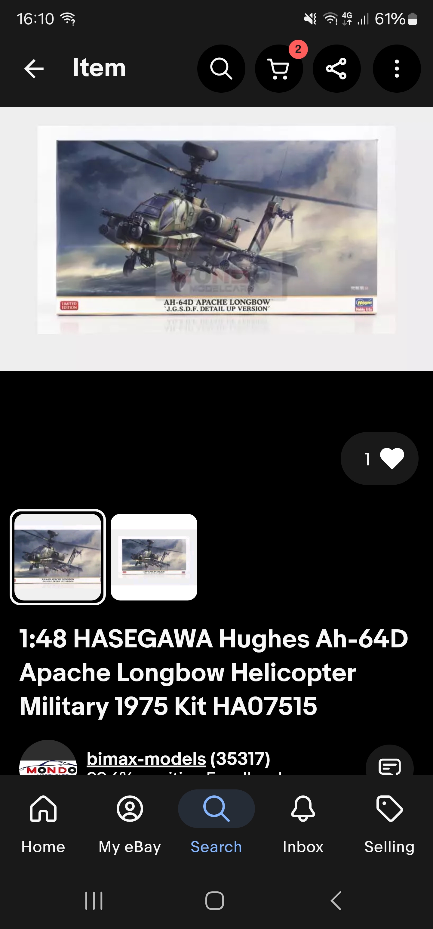

agelos2005 Posted November 23, 2024 Author Share Posted November 23, 2024 This one? Quote Link to post Share on other sites
Tank Posted November 23, 2024 Share Posted November 23, 2024 Yes, you can view the instructions here. https://www.scalemates.com/kits/hasegawa-07515-ah-64d-apache-longbow-jgsdf-detail-up-version--1437466 The kit has the T sprue which should get you the latest US Army D according to the note at the MM link. The S sprue is not needed for US longbows but it has all the other sprues the US longbow kit has. Quote Link to post Share on other sites
Dave Williams Posted November 23, 2024 Share Posted November 23, 2024 That kit doesn’t have the upturned exhausts (V sprue), so its not really the latest US D configuration, if that’s what you’re looking for. But I think those exhausts are available in the aftermarket Quote Link to post Share on other sites

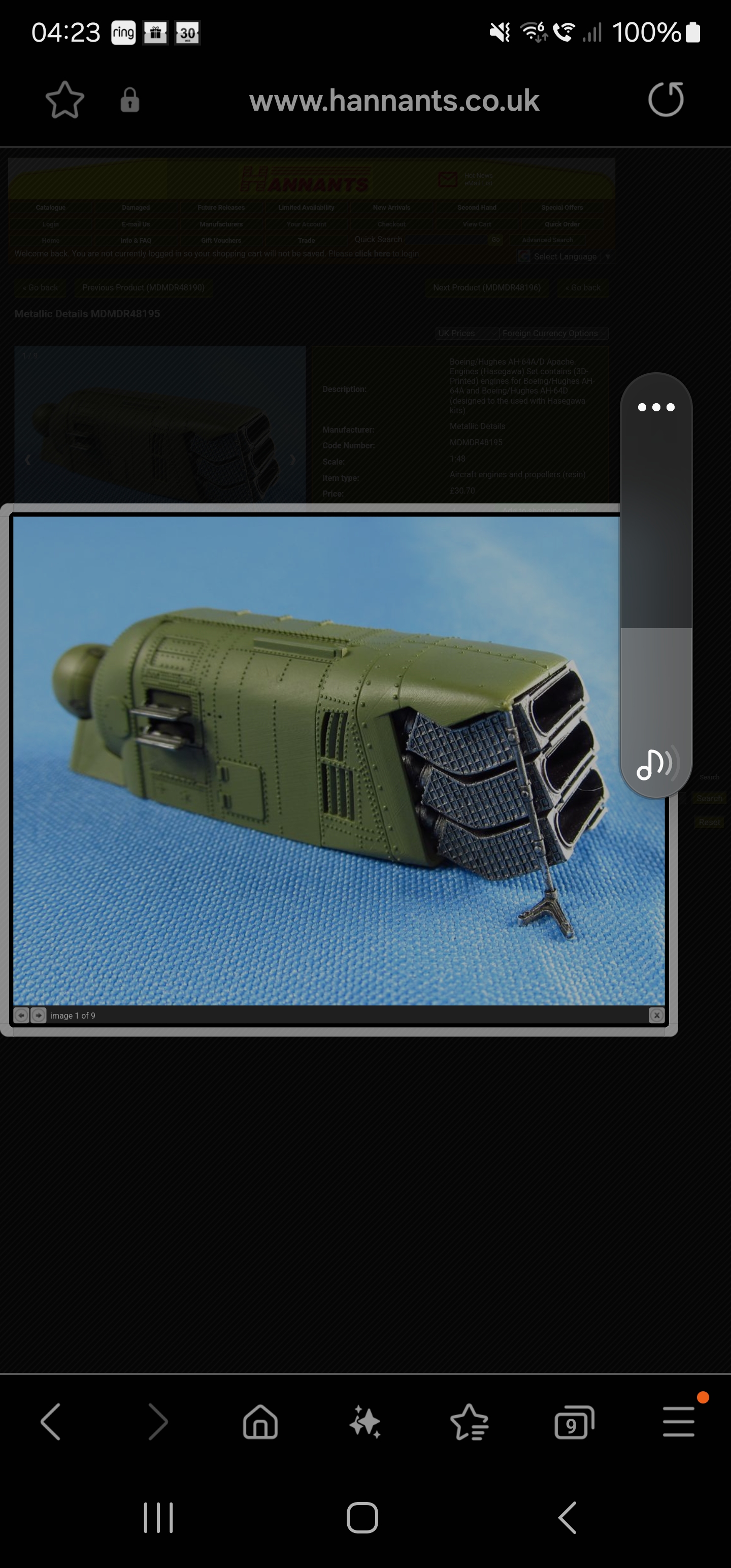

agelos2005 Posted November 25, 2024 Author Share Posted November 25, 2024 Are the metallic engine resin parts good? How do they fit? Quote Link to post Share on other sites
