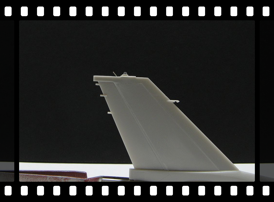

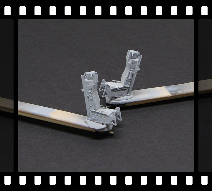

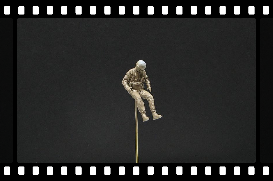

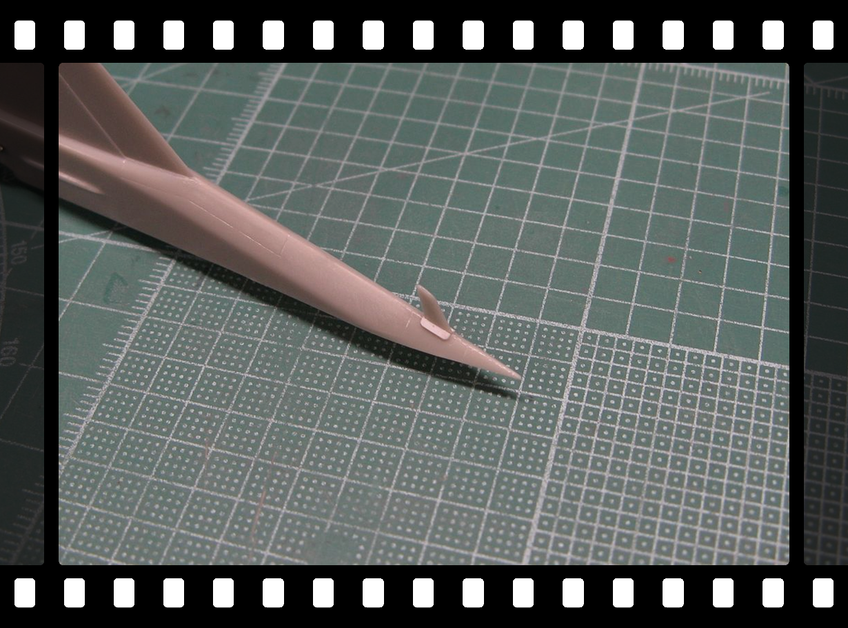

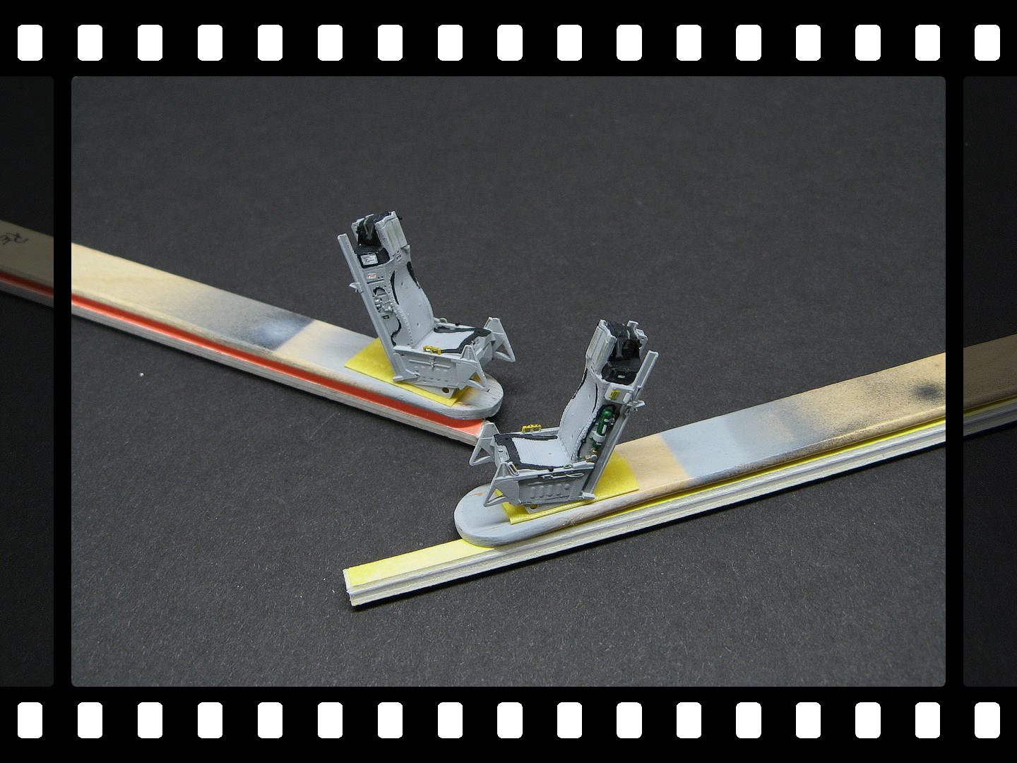

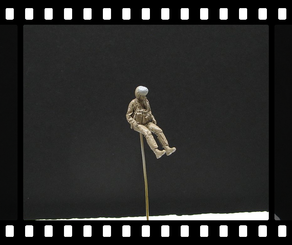

A-10 LOADER Posted December 20, 2024 Author Share Posted December 20, 2024 On 12/17/2024 at 6:48 PM, strikeeagle801 said: Not a problem. You've helped me several times. Glad I could return the favor. Good luck with the rest of the build...I'll be following along. Aaron Thanks Aaron. I didn't get as much accomplished this week as I wanted but, some progress is still better than nothing. Steve The aircrew received their base color for their flight suits. The seats were painted Light Ghost gray. Added the anti-collision strobe light, made from a piece of clear rod and, a static discharger made from a piece of wire to the top of the tail. Added flanges to the UHF antenna using .010" sheet plastic. Removed the mold seam on the canopy and polished it up. Quote Link to post Share on other sites

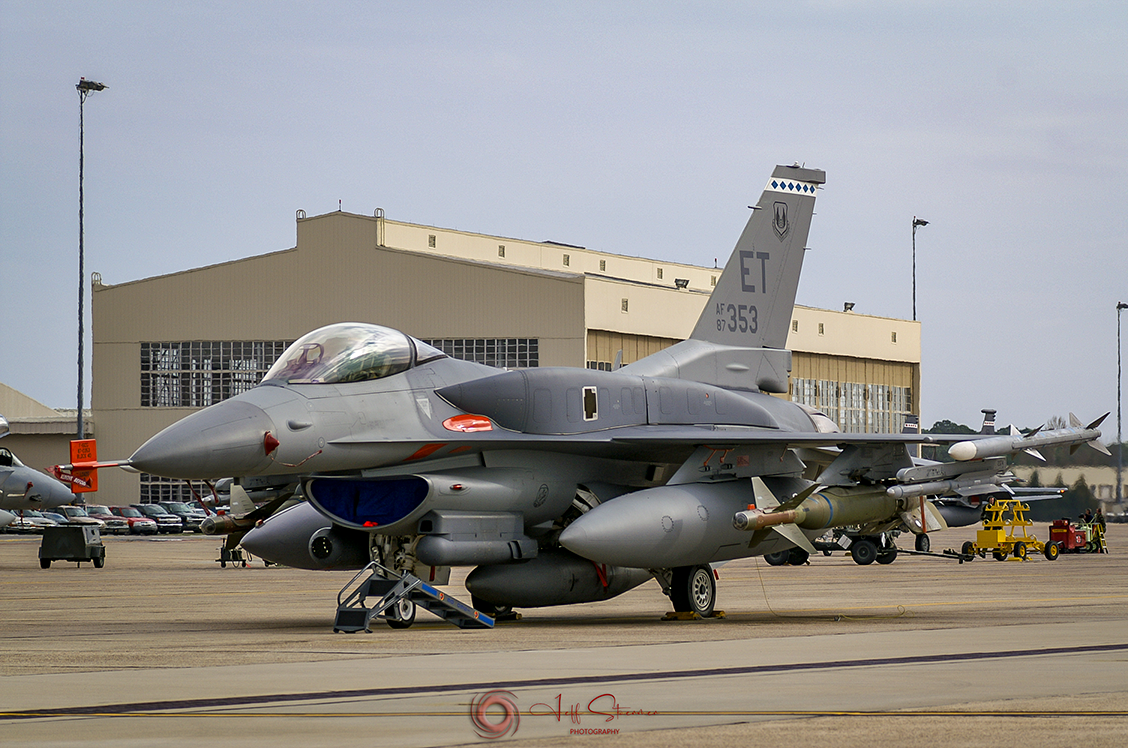

ST0RM Posted December 20, 2024 Share Posted December 20, 2024 Steve, Here's a Eglin test F-16C, I photographed back in 2006. It's carrying the 600gal tanks, in addition to the CFTs. The tank size is very noticeable. Great progress! -Jeff Quote Link to post Share on other sites
A-10 LOADER Posted December 20, 2024 Author Share Posted December 20, 2024 Thanks Jeff, yeah there's a big difference. Steve Quote Link to post Share on other sites
habu2 Posted December 20, 2024 Share Posted December 20, 2024 A USAF Block 40 with CFTs. interesting. Yes I know it's a test sqn. Quote Link to post Share on other sites

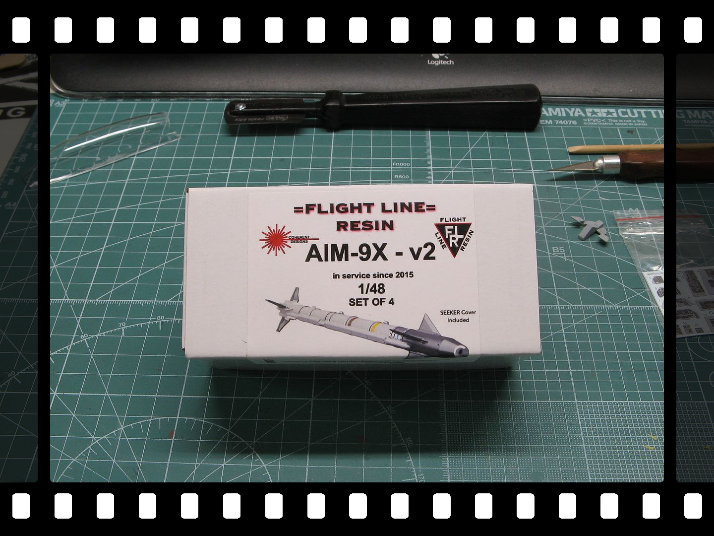

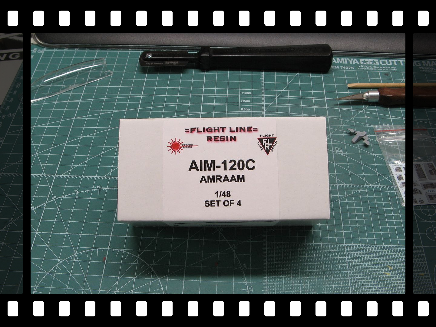

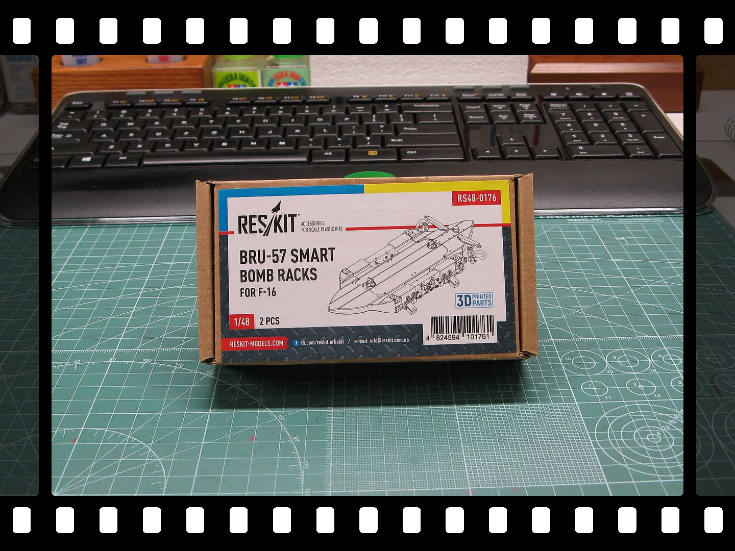

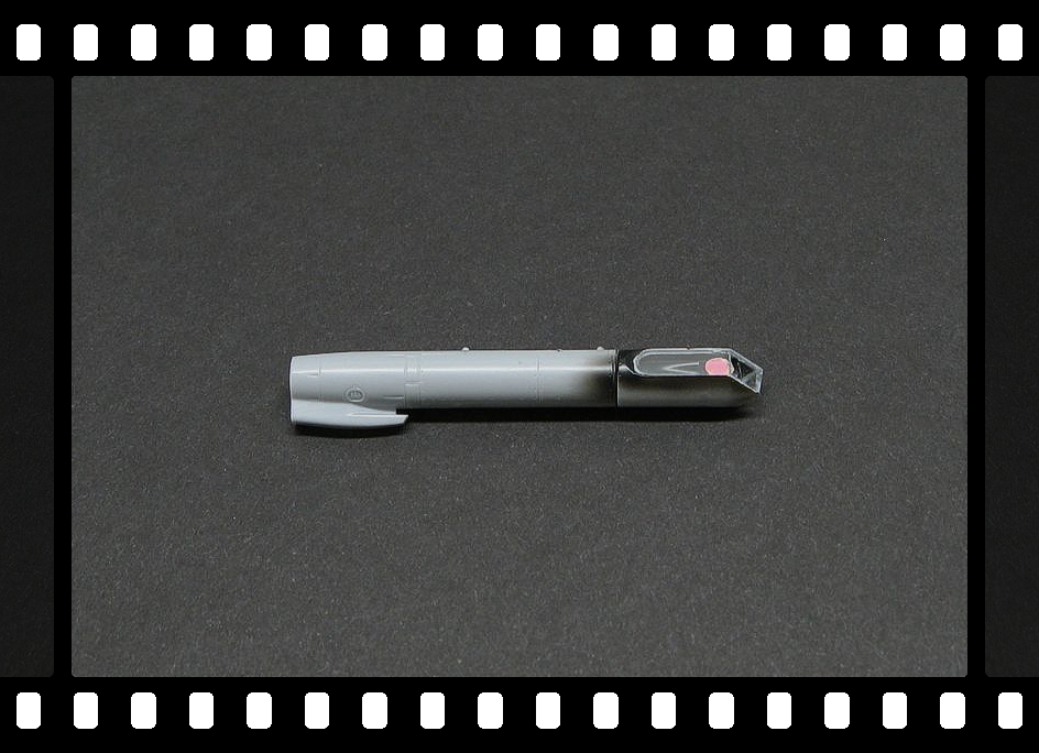

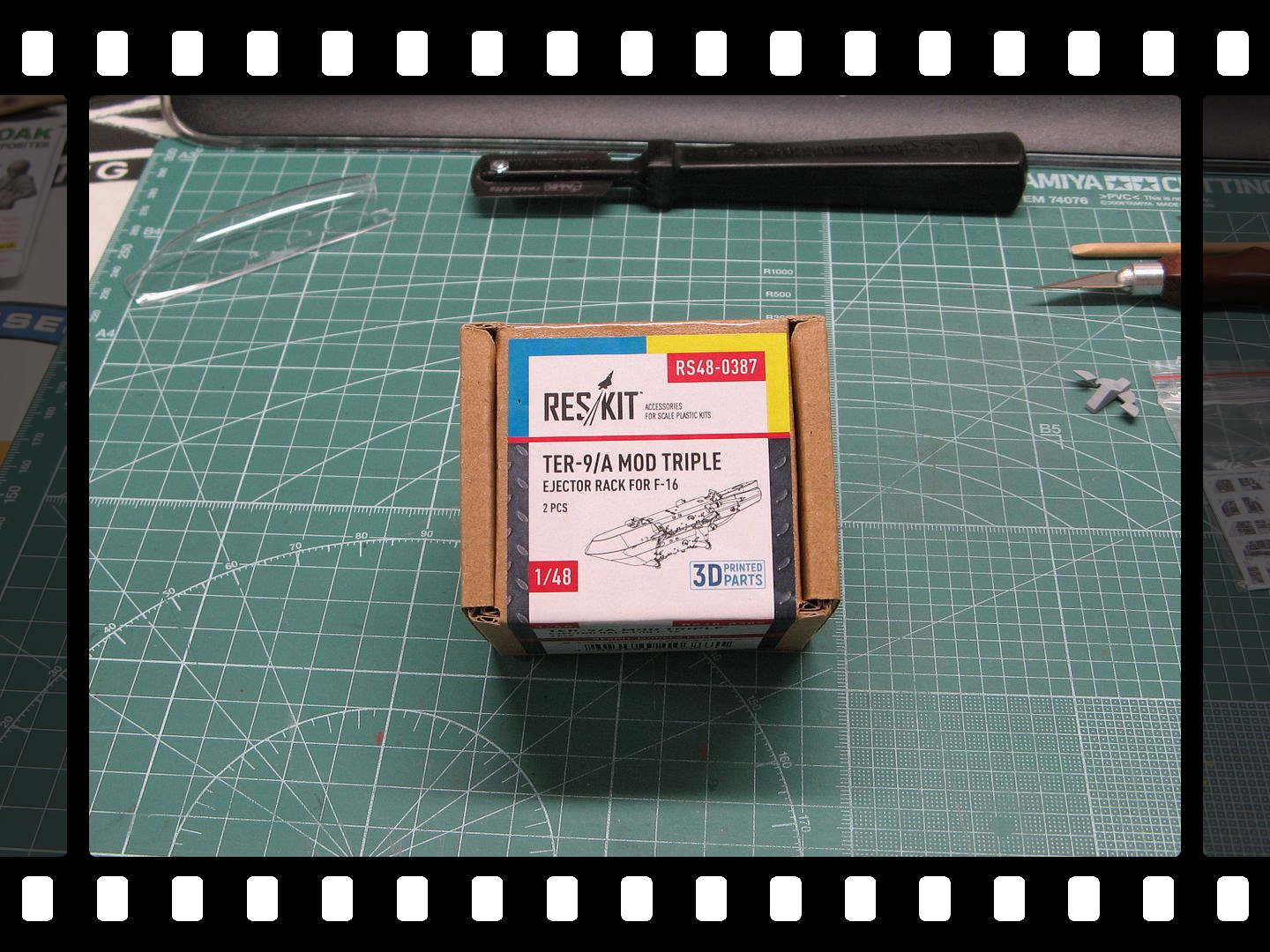

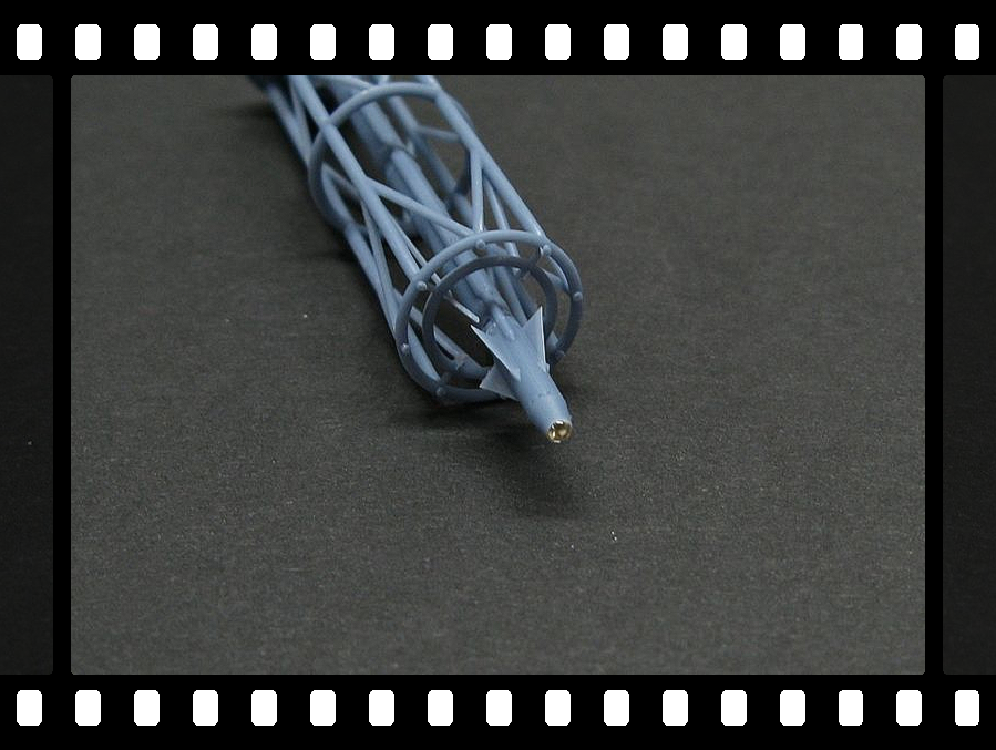

A-10 LOADER Posted December 20, 2024 Author Share Posted December 20, 2024 (edited) Some recently arrived items for the build. Steve Still deciding if these will go on Station # 7 or, a TER with GBU-12's "slant loaded". If I don't use these for this build I'll use them on one of my Academy A-10C builds down the road. https://hosting.photobucket.com/82bbffef-f34a-4318-a6ca-f9f6698b4185/3b99e93f-2c36-4e53-aaf1-ea22baf44e41.png A dab of CA gel glue secured the MV lens ( LS-22 ) for the seeker head on the Flightline Resin AIM-9X. Edited December 20, 2024 by A-10 LOADER Quote Link to post Share on other sites
Gator52 Posted December 23, 2024 Share Posted December 23, 2024 Do the Reedoak figures need any special cleaning/prep? Chris Quote Link to post Share on other sites
A-10 LOADER Posted December 23, 2024 Author Share Posted December 23, 2024 5 minutes ago, Gator52 said: Do the Reedoak figures need any special cleaning/prep? Chris No, I went straight to primer. Steve Quote Link to post Share on other sites
Gator52 Posted December 23, 2024 Share Posted December 23, 2024 Ok thanks. I'll place my first Reedoak order soon, and learn from watching your painting techniques! Chris Quote Link to post Share on other sites
A-10 LOADER Posted December 24, 2024 Author Share Posted December 24, 2024 (edited) 22 hours ago, Gator52 said: Ok thanks. I'll place my first Reedoak order soon, and learn from watching your painting techniques! Chris 😆 Don't watch me brother, I am not a figure painter. I'm just praying I don't screw them up. 🤞 Merry Christmas 🎄 🎅 ⛄ Steve Edited December 24, 2024 by A-10 LOADER Quote Link to post Share on other sites
Thadeus Posted December 25, 2024 Share Posted December 25, 2024 Very nice bunch of resin stuff. Wonder how You will find these BRU-57's. Quote Link to post Share on other sites
A-10 LOADER Posted December 25, 2024 Author Share Posted December 25, 2024 11 minutes ago, Thadeus said: Very nice bunch of resin stuff. Wonder how You will find these BRU-57's. They look extremely nice upon initial inspection of the box when they arrived but, I'll know more once I get to them. I can say this, they're packaging is top notch ! Way better than anything else I've ever received and, this is from a war torn country. Steve Quote Link to post Share on other sites

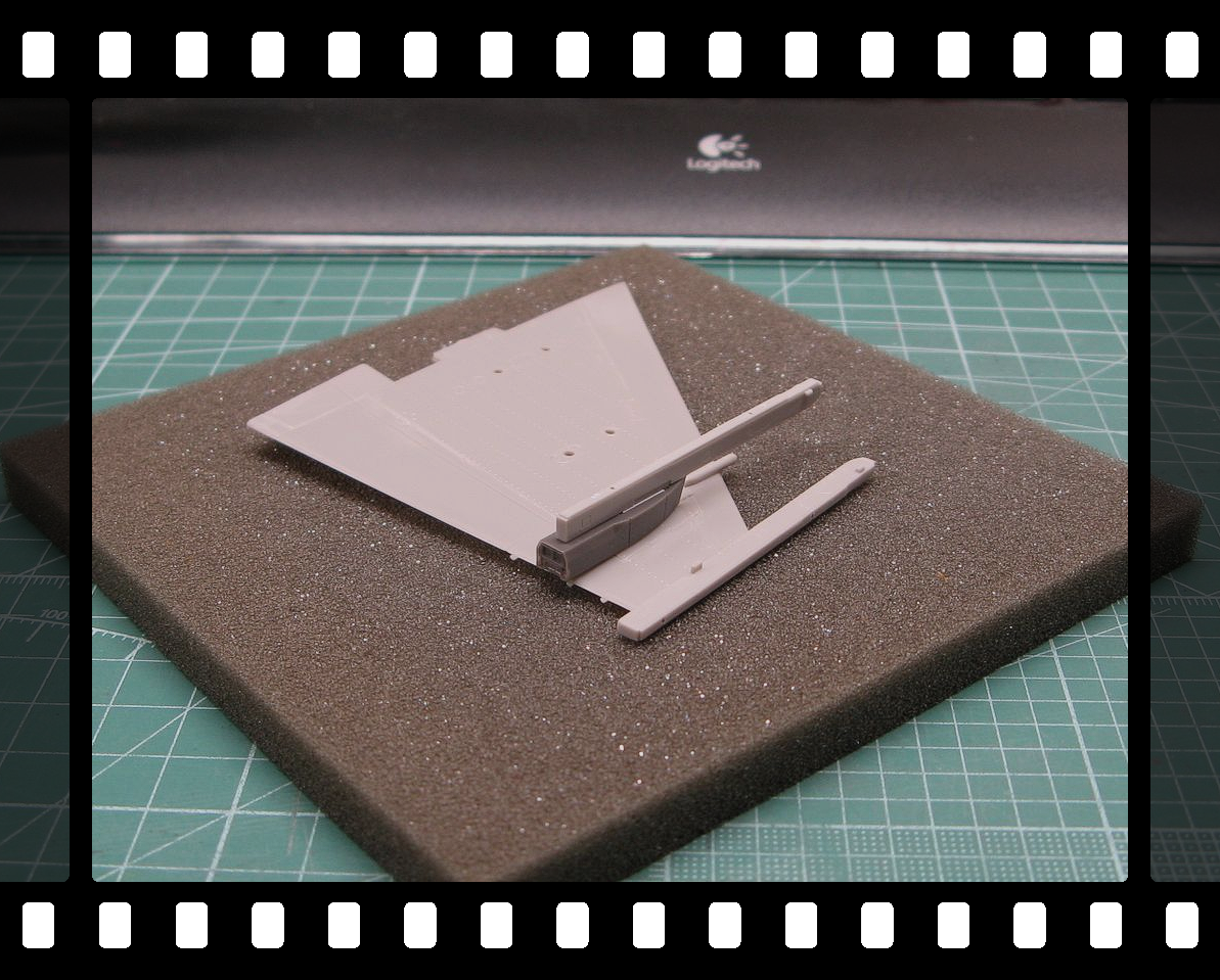

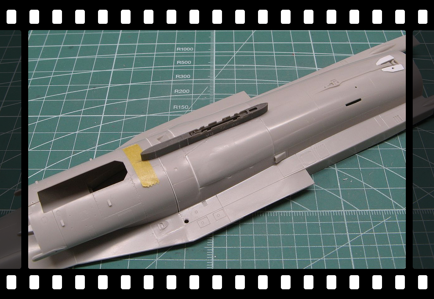

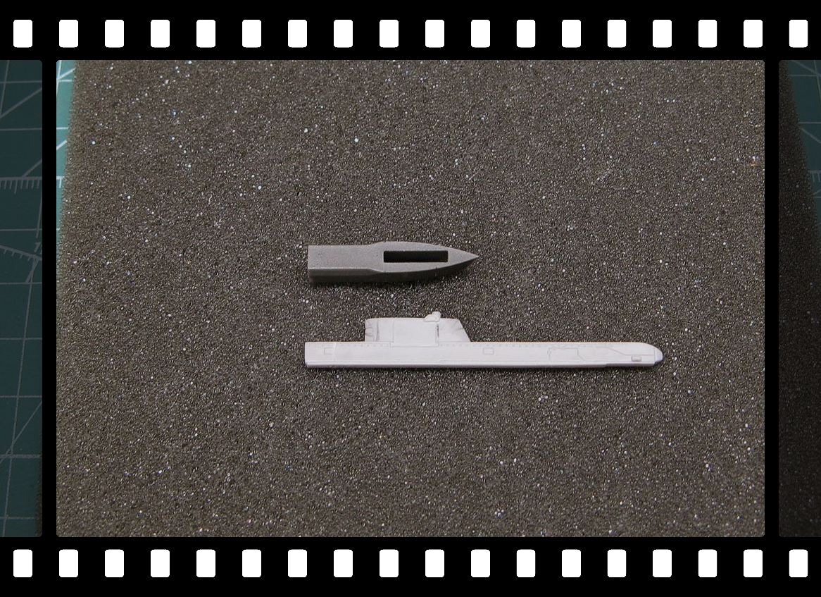

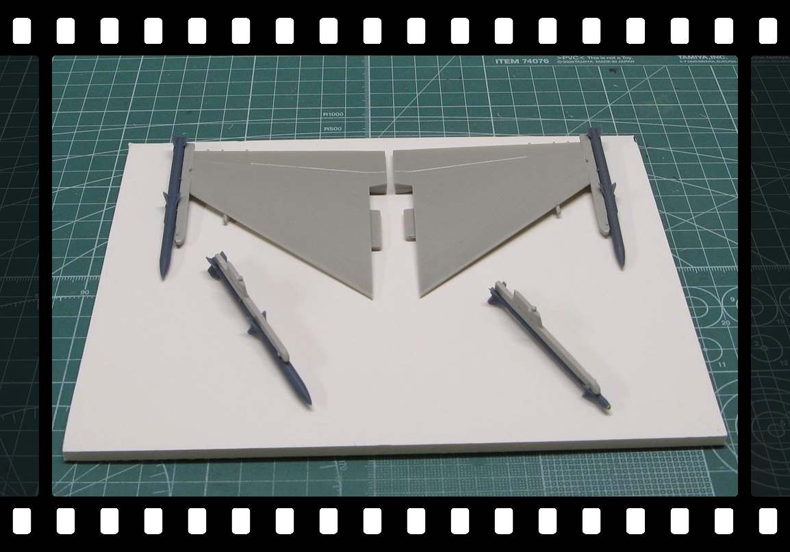

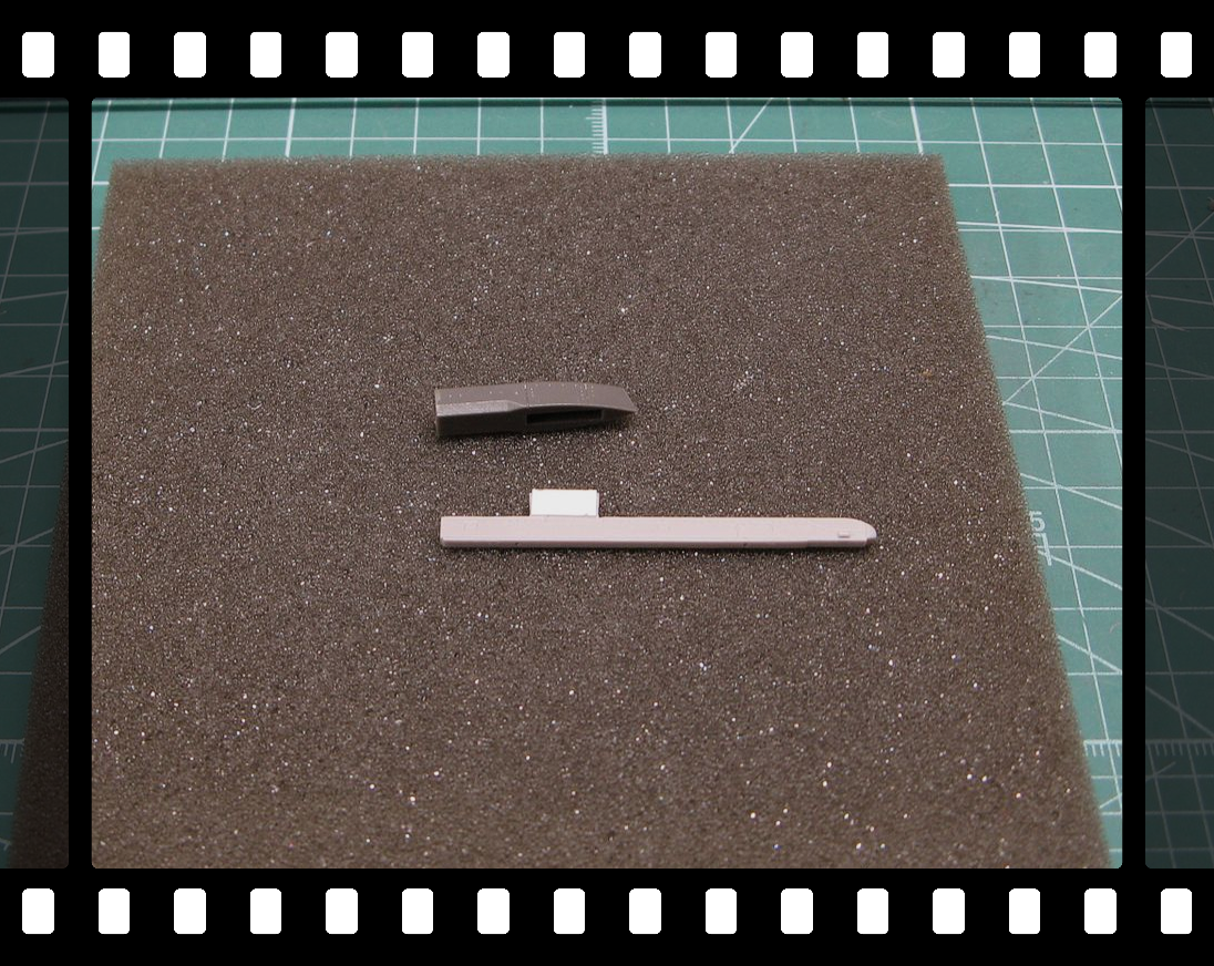

A-10 LOADER Posted December 26, 2024 Author Share Posted December 26, 2024 (edited) Updates for the Viper Part #1, A lot of tedious tasks were accomplished this past week. I got all the missiles "pinned" to their respective pylons using .020" brass rod. The Kopecky Scale Models center line pylon pinned to the fuselage using .032" brass pins. The bomb rack is a separate piece which will make painting easier. Since I'm adding the Kopecky Scale Models ALE-50 wing pylons to my jet, I needed to modify the Hasegawa missile rails to fit the pylon. They were cut to fit the slot in the pylon, then I added a piece of .010" plastic to each side. This whole assembly gives the missile rail a nice snug fit without using any glue. I'll add my usual pins to the ALE-50 pylons so I can paint things separately and, attach them to the wings during final assembly. Thanks for looking, Steve Edited December 26, 2024 by A-10 LOADER Quote Link to post Share on other sites

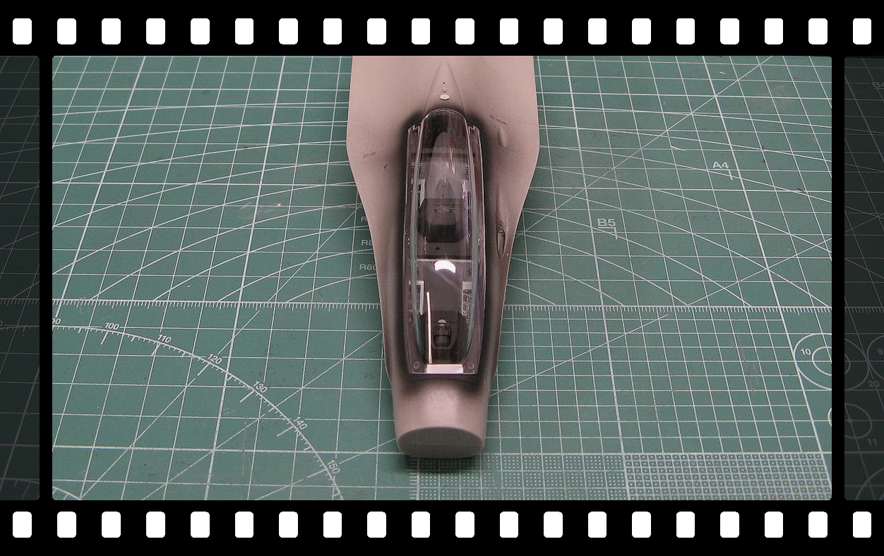

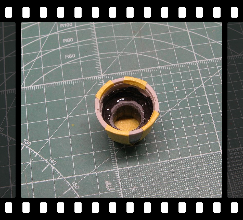

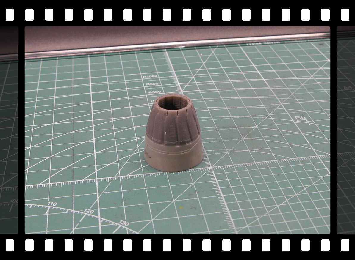

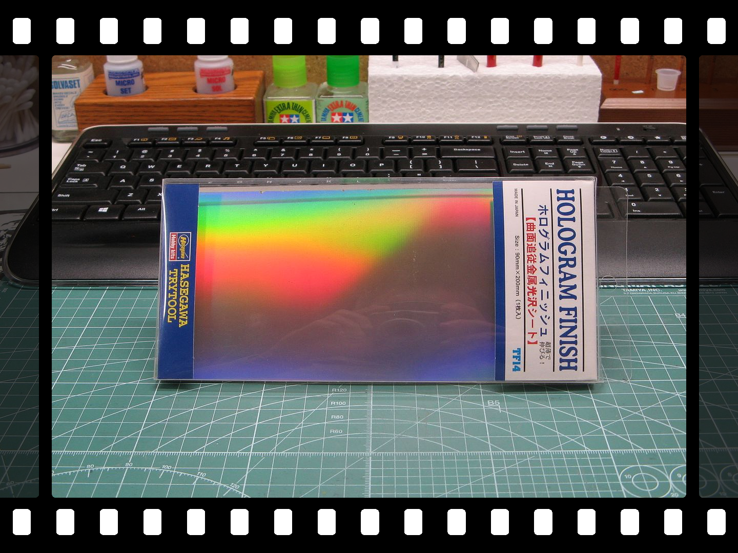

A-10 LOADER Posted December 26, 2024 Author Share Posted December 26, 2024 Part #2, I punched out a disk of this to use as the seeker head for the Sniper pod, which is from the Hasegawa Weapons Set E. I painted the seeker head interior black, attached the disk and, glued the glass in place. The KA Models resin exhaust nozzle was attached to the kit part using two-part epoxy. Finally, a few decals were added to the Eduard seats and, the paint work was finished. I didn't paint the center sections of the seat or back to allow for attaching the aircrew with two-part epoxy. I'm also waiting to add the center ejection handles until after the aircrew are in the seats to see if there is any interference with anything. Thanks again for looking, Steve Quote Link to post Share on other sites
