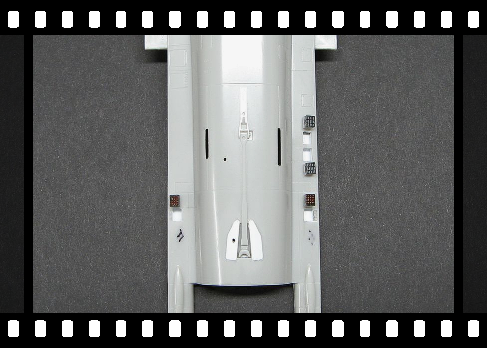

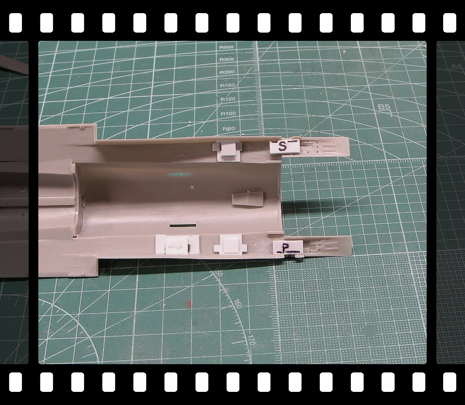

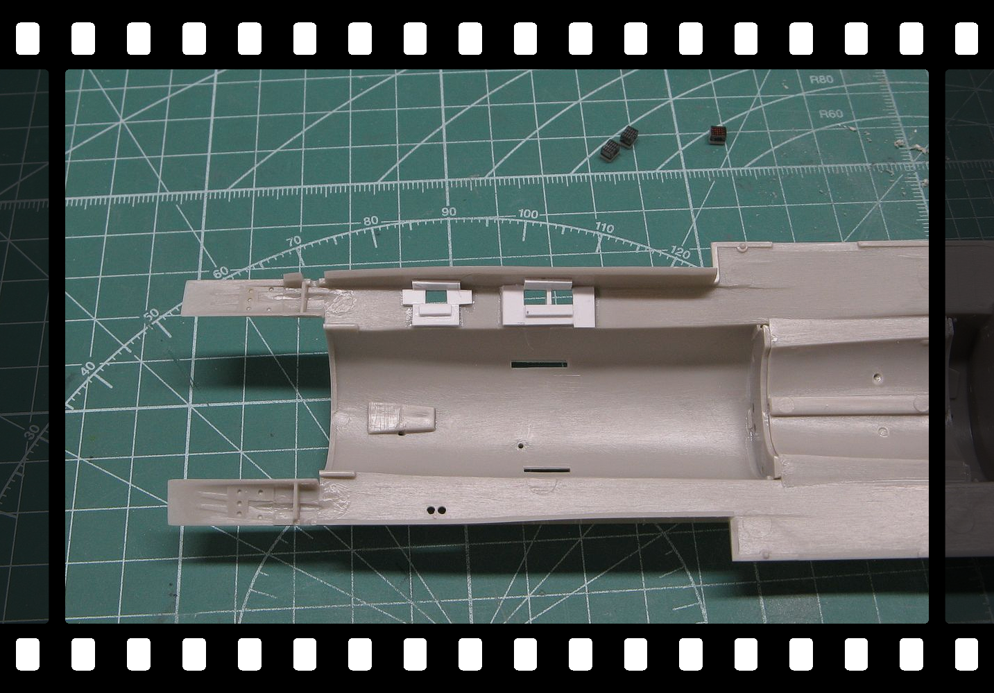

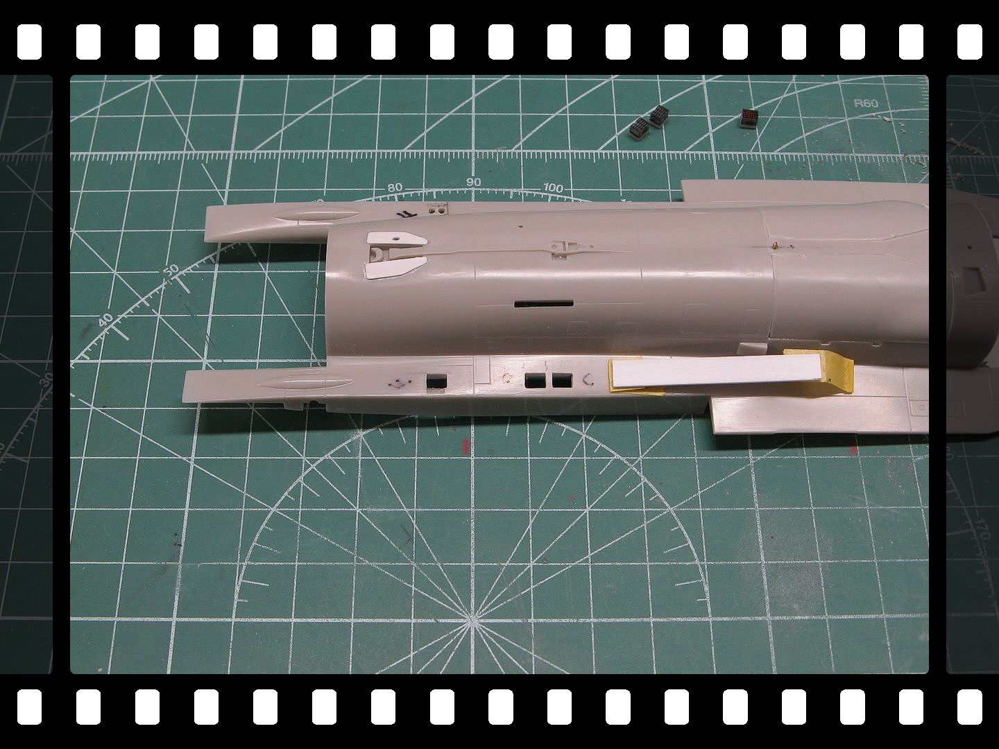

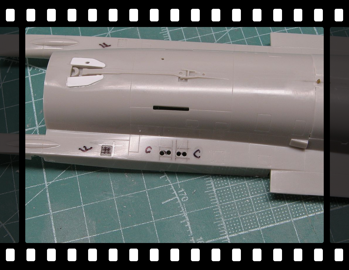

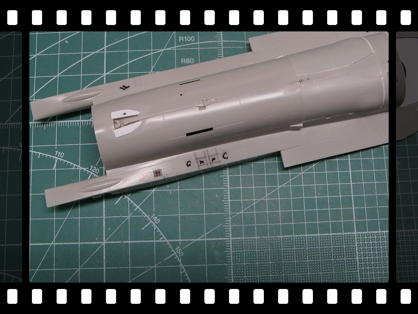

A-10 LOADER Posted February 7 Author Share Posted February 7 Viper update, The chaff / flare magazine well's are finished. Not as hard as I thought they'd be once I got going but, I'm glad they're finished. Steve I used this piece of sheet plastic to keep the chaff / flare buckets flush with the outside of the fuselage while I built up the plastic pieces on the inside. These will be added at the end of the build. Quote Link to post Share on other sites

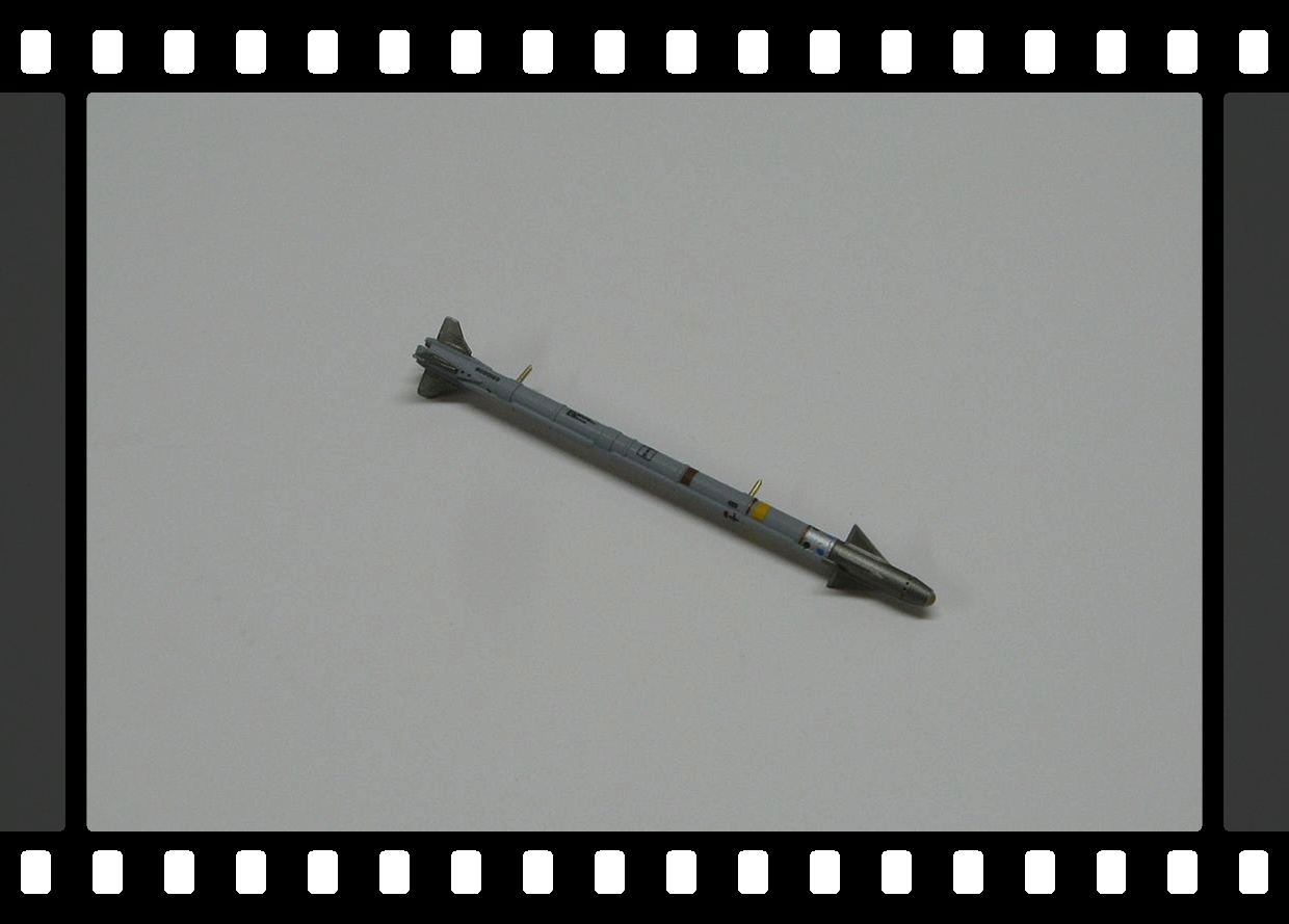

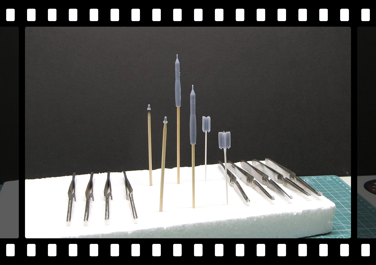

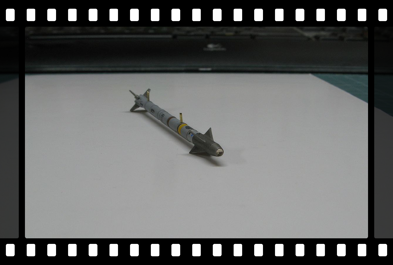

A-10 LOADER Posted February 7 Author Share Posted February 7 28 minutes ago, ST0RM said: Nice buckets!! Taking it to another level, Steve. Thanks amigo. I forgot to add this earlier, the Flight Line Resin AIM-9X is finished. I used a #22 MV lens for the seeker head. I'm waiting on my RES/KIT GBU-12's and fuel tanks in the mail yet. Steve Quote Link to post Share on other sites

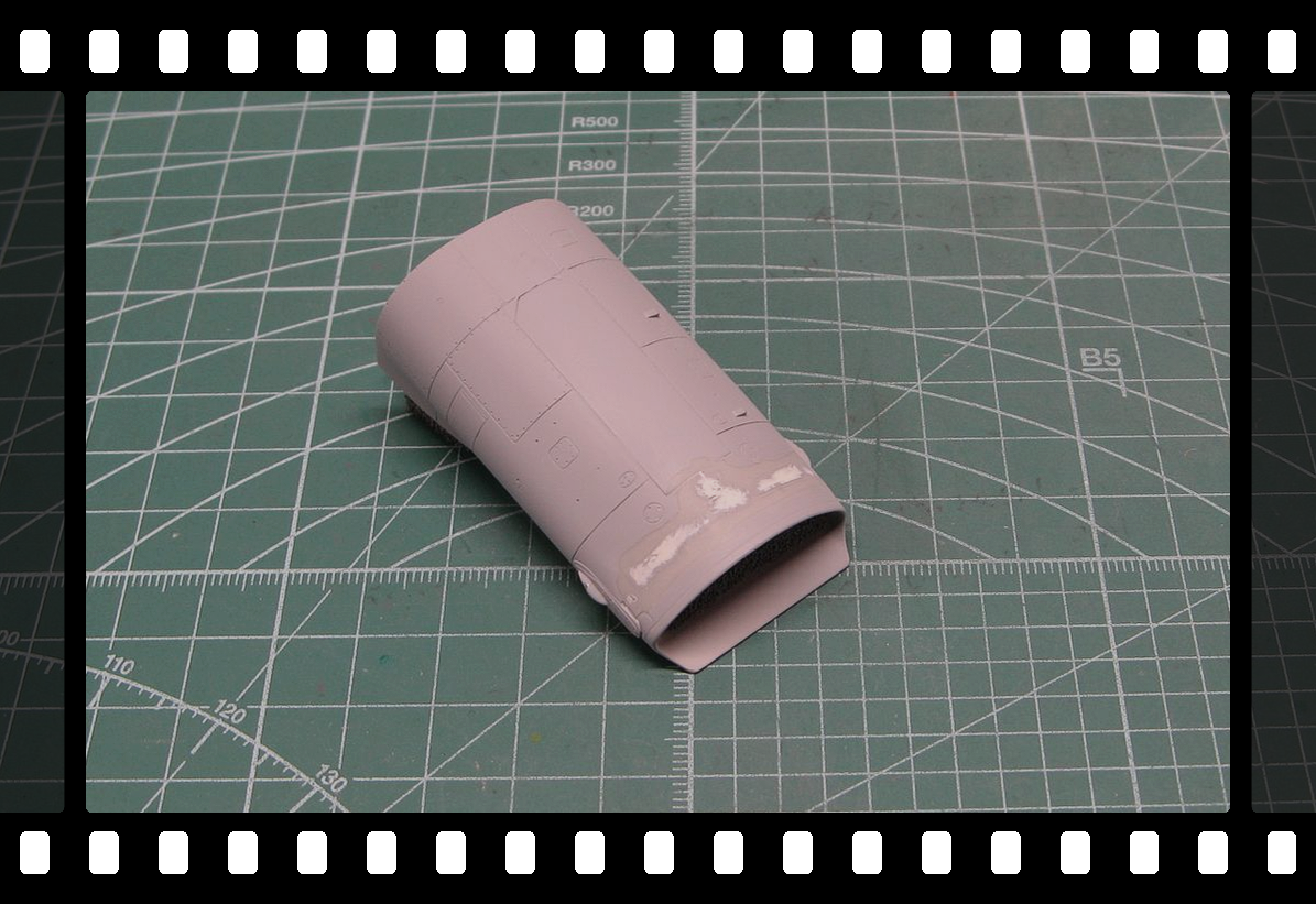

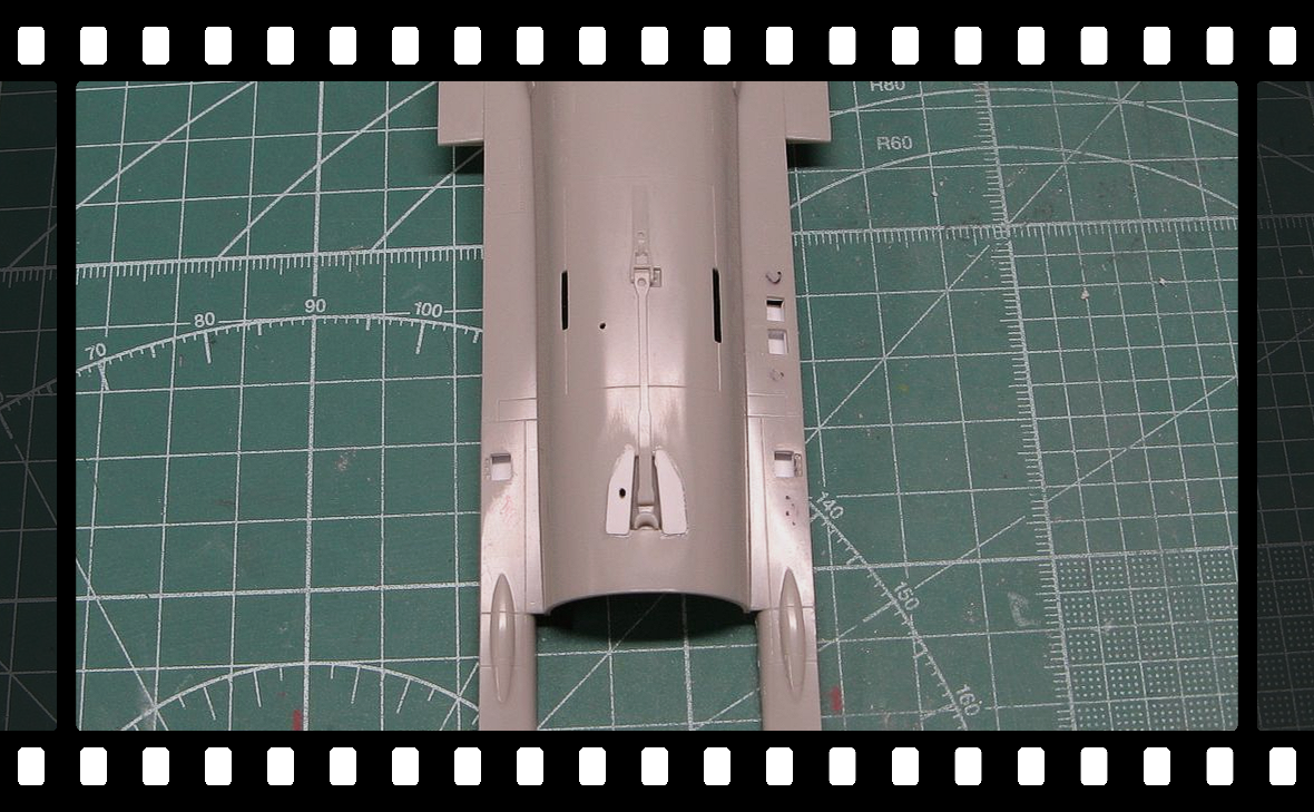

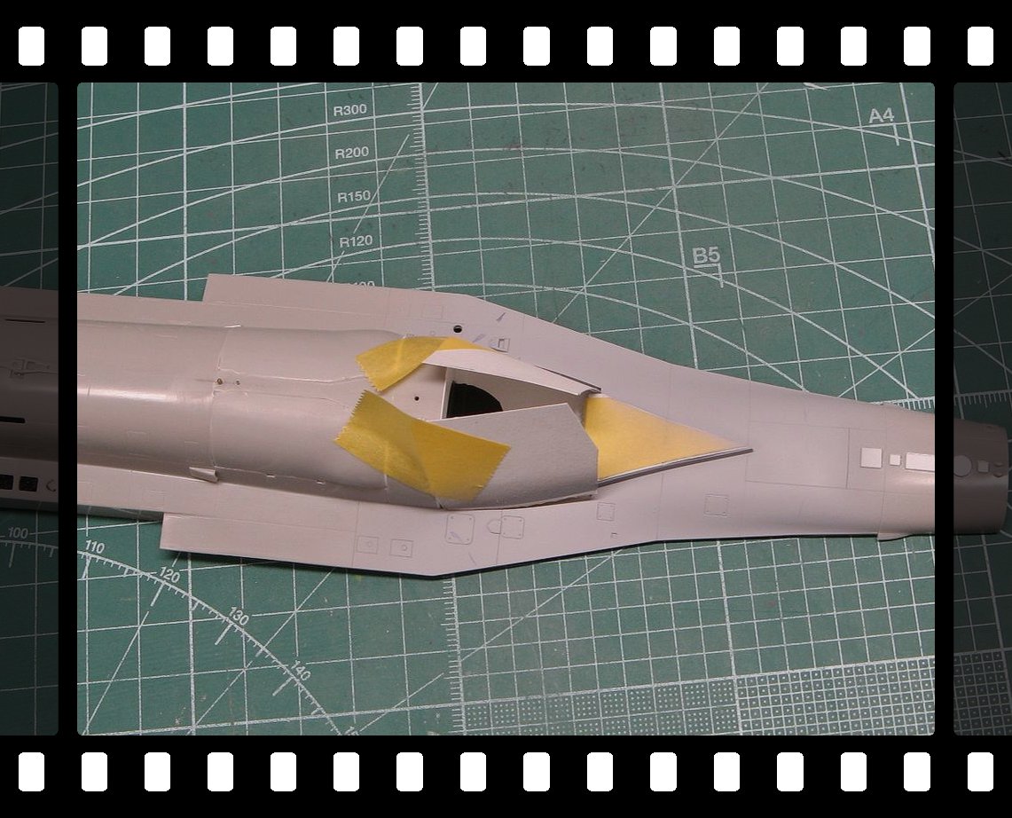

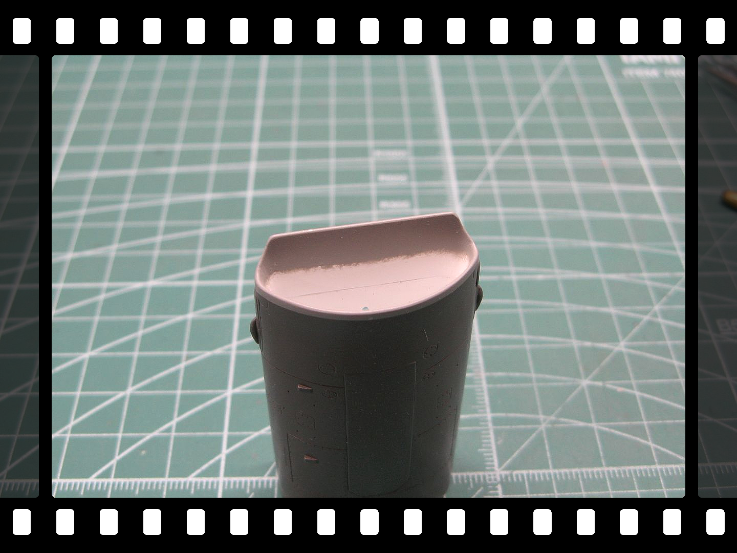

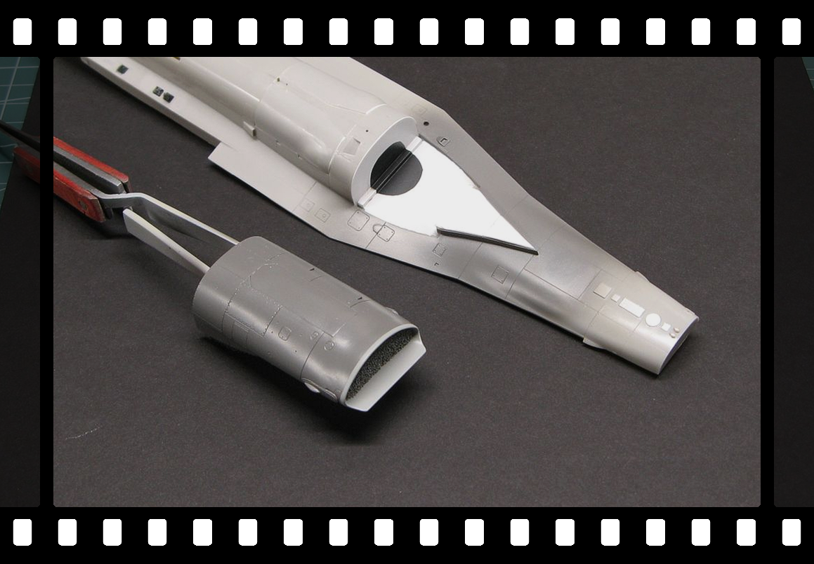

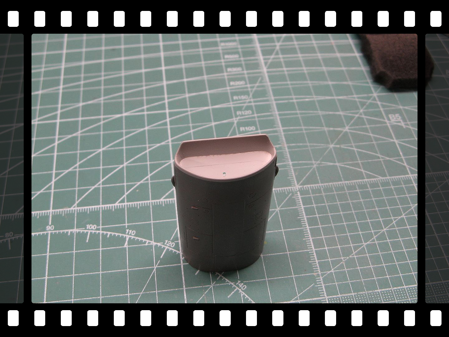

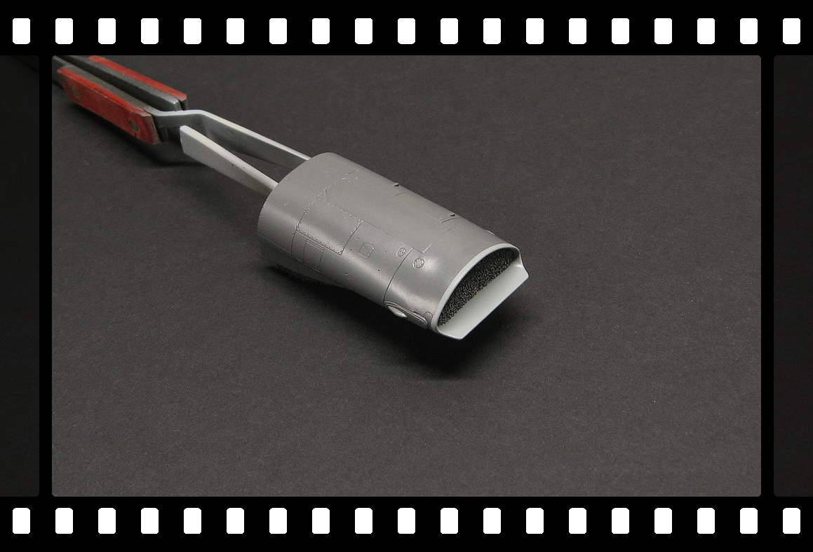

A-10 LOADER Posted February 11 Author Share Posted February 11 Another update on the Viper, After numerous dry-fitting sessions, I've decided to attach the intake to the lower fuselage before gluing the fuselage halves together. I can get a tighter fit, where the intake meets the fuselage, when I slightly flex the forward part of the fuselage up. This is easier to do without the top fuselage on. Before I attach the intake I want to get some color on the topside of it, mask / paint the intake lip and, get some color on the underside of the fuselage above where the intake will cover because it's much easier with them as separate pieces. I primed those areas first and corrected some seam issues on the intake lip area. Steve Cut some card stock to use as a paint shield to keep the intake interior area from over spray. I masked off, to preserve the details, before applying the Tamiya white putty. Wet sanded with some 400 and ready to re-prime the body work area. Quote Link to post Share on other sites

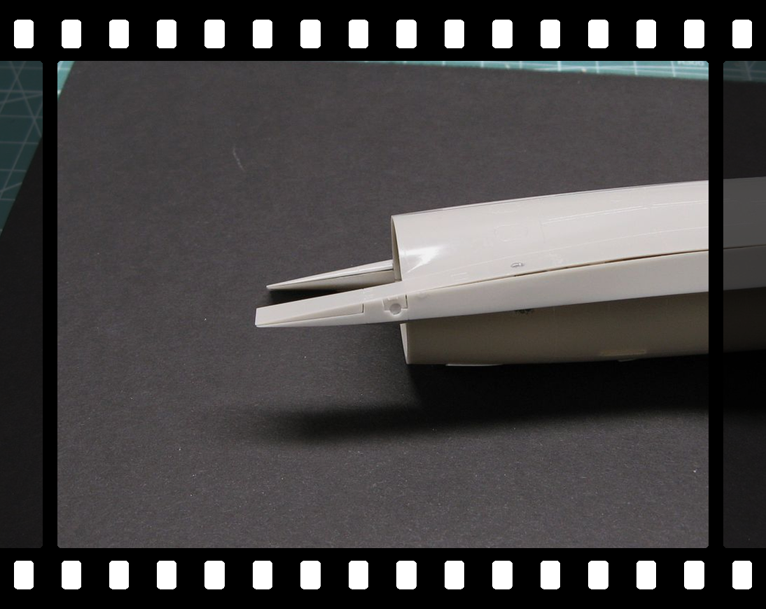

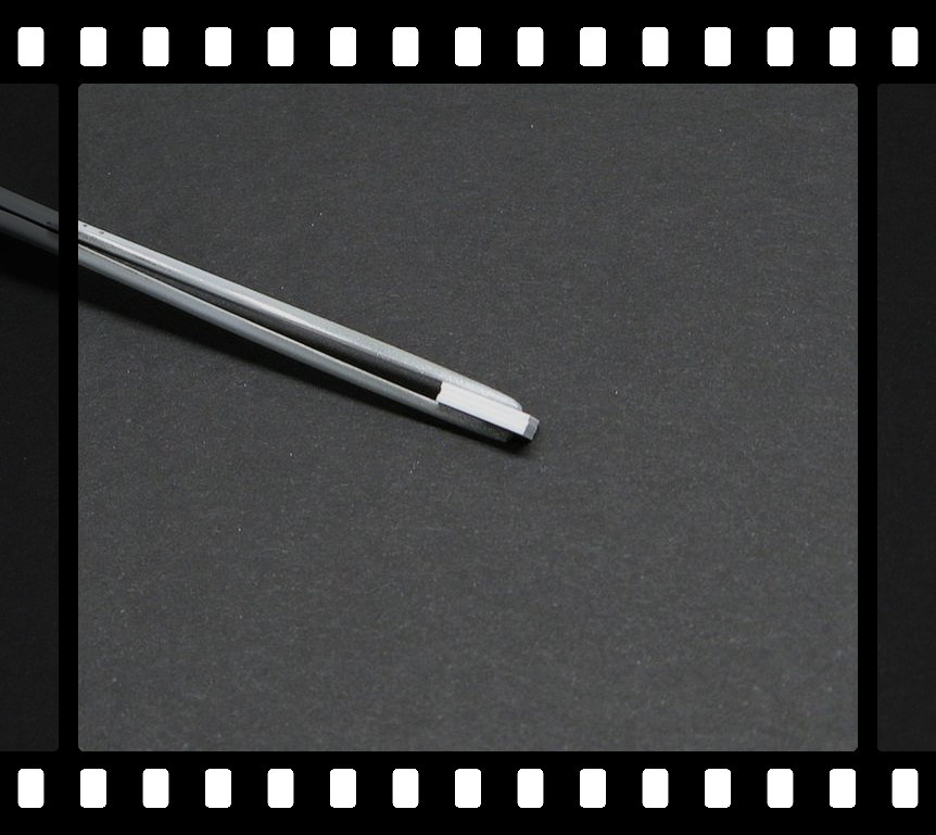

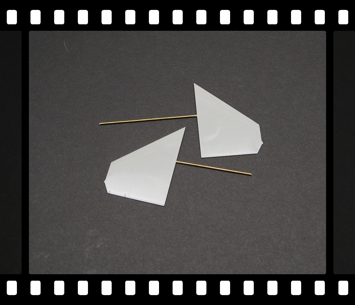

A-10 LOADER Posted February 11 Author Share Posted February 11 6 hours ago, lgl007 said: Amazing work so far 🙂 Keep the pics comin... -Greg Thanks very much Greg. Another area I wanted to improve was the way the horizontal stabs attached to the jet. I never liked the way Hasegawa made the attachment point for them with that tiny nub and the oversized opening, weak connection. I cut the nubs off the stabs and drilled a hole for a piece of .040" brass rod. The fit of the rod is very snug, no glue needed. Now I can paint the horizontal stabs separately from the jet. I also drilled the #80 holes for the static dischargers in the stabs, wings and, the tail while I was at it. Three pieces of .030" plastic glued together to make the "block" that will get drilled to hold the horizontal stabs. Blocks glued into place. I can now drill a hole for the brass rod into the block and the stabs will be a press fit at the end of the build. Quote Link to post Share on other sites

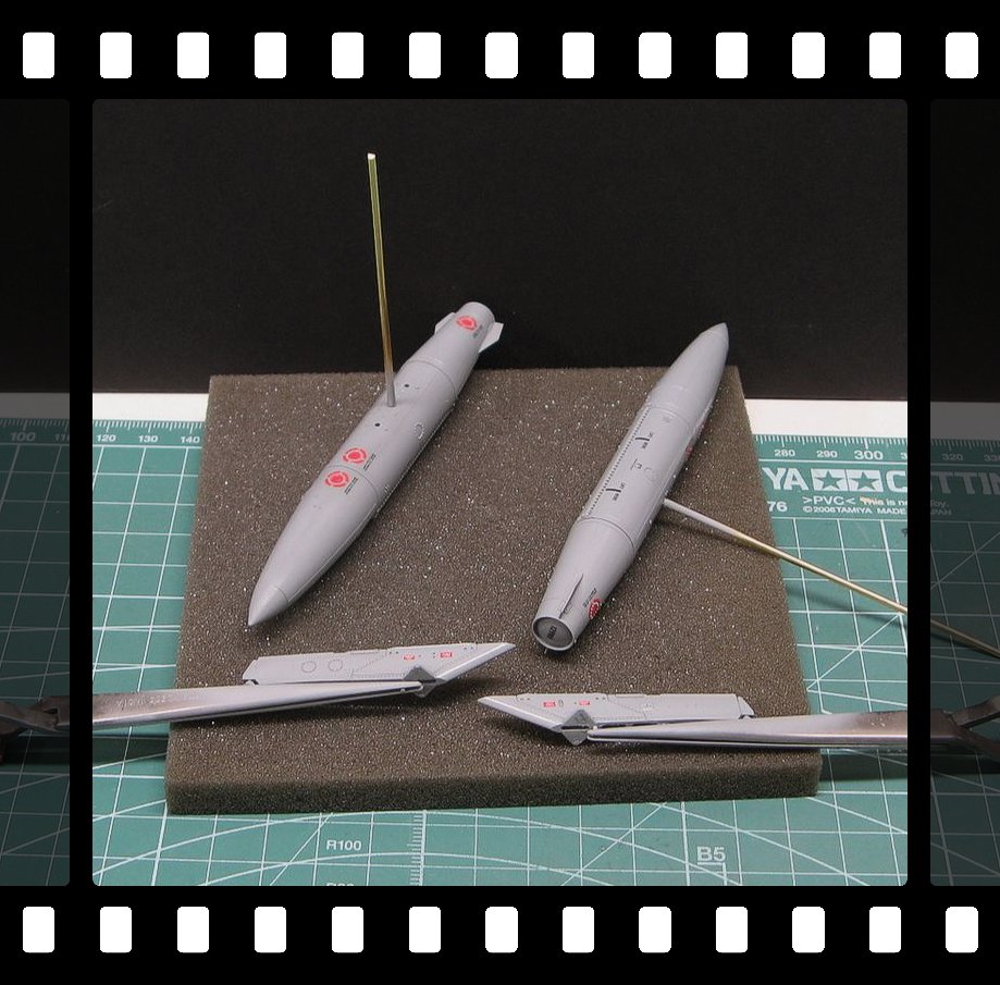

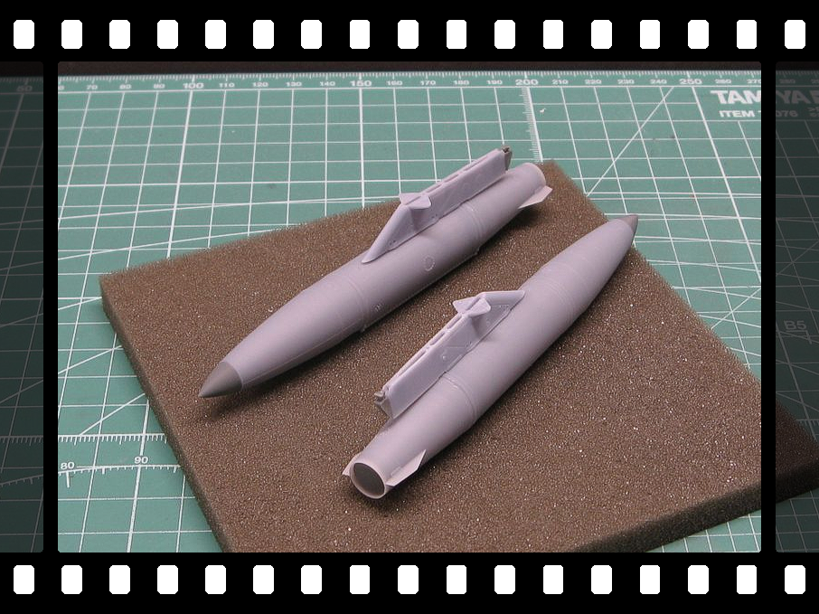

A-10 LOADER Posted February 13 Author Share Posted February 13 The last pieces to this puzzle arrived yesterday so today I got everything cleaned up and assembled the fuel tanks. I can't help but be amazed at the level of detail with their 3D products, beautiful stuff. Steve GBU-12's and parts ready for primer / paint. Fuel tanks assembled. The wing pylon is not glued. I still have to add the "pins" to the pylons for them to attach to the wings. The tanks will be glued to the pylons at the end of the build. Quote Link to post Share on other sites

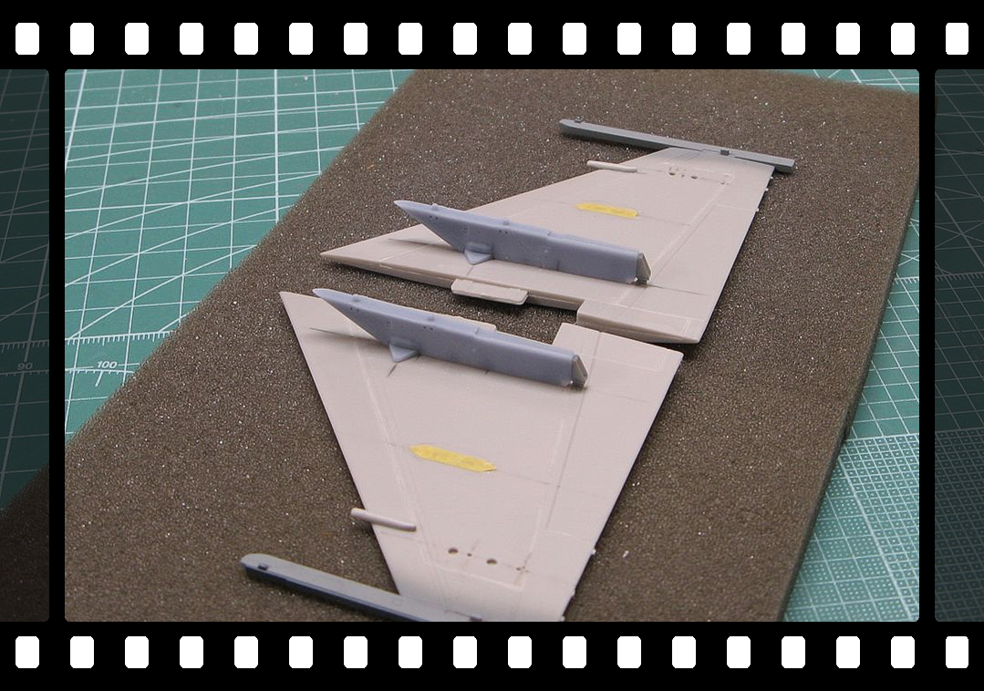

A-10 LOADER Posted February 14 Author Share Posted February 14 Worked on getting the last items "pinned" to the wings, the fuel tank pylons. Next I'll prime the GBU-12's and the fuel tanks / pylons. Steve Quote Link to post Share on other sites

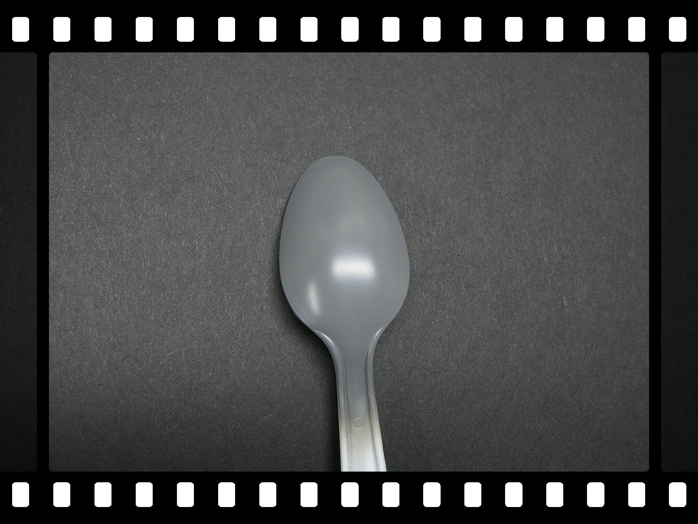

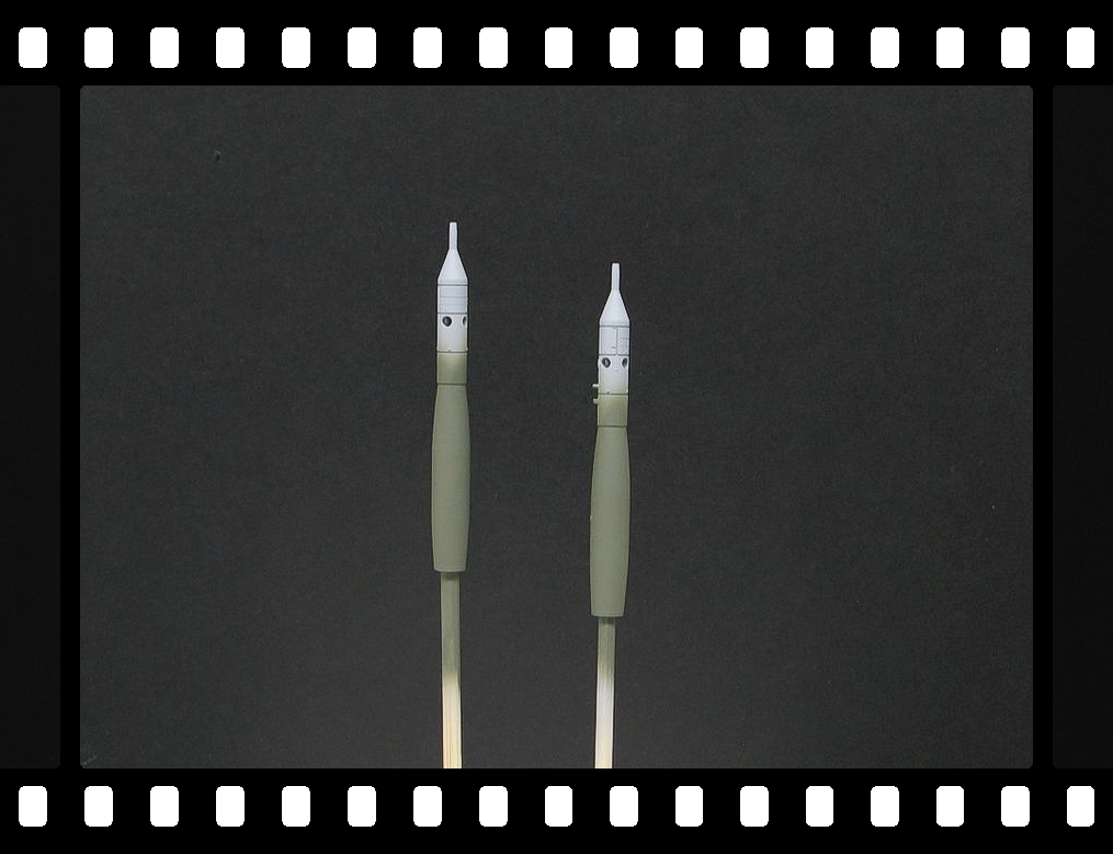

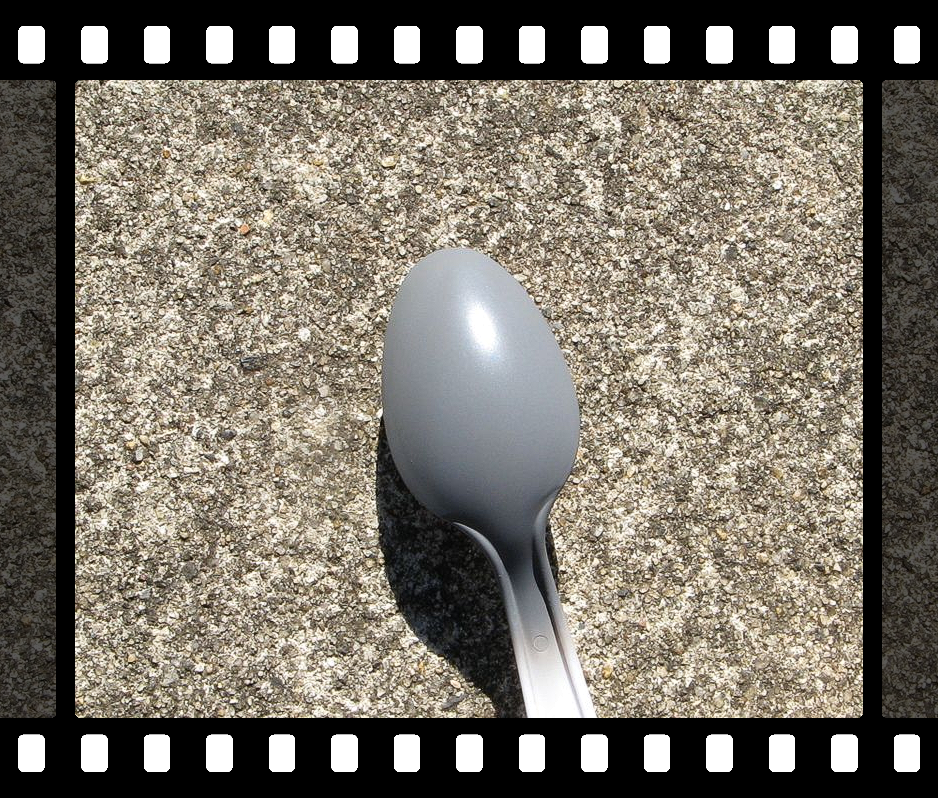

A-10 LOADER Posted February 22 Author Share Posted February 22 Thanks Red Dog. I made some progress this week on some things. I got all the GBU-12 parts, the fuel tanks and, the pylons primed. The bomb bodies were sprayed with faded olive drab. The fuel tanks and pylons are finished and awaiting weathering. After lots of research, reading and, seeing finished builds I decided to give AK a try for the HG5 finish. I primed some spoons and shot one with the paint, straight out of the bottle, a 50/50 mix with MCLT, to see if any metallic color would need to be added. These pics won't do it justice, you need to see it in person but, I think it will work. It looks much better outside and you can really see the metallic "sheen" to it in natural sunlight. It's subtle which works for the scale effect. I still need to spray a semi-matte over this to see if the "sheen" changes so, we'll see. Quote Link to post Share on other sites

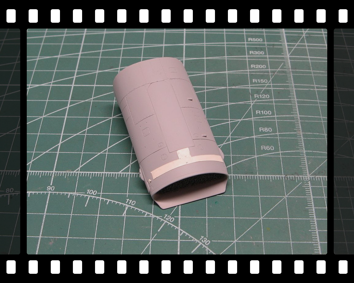

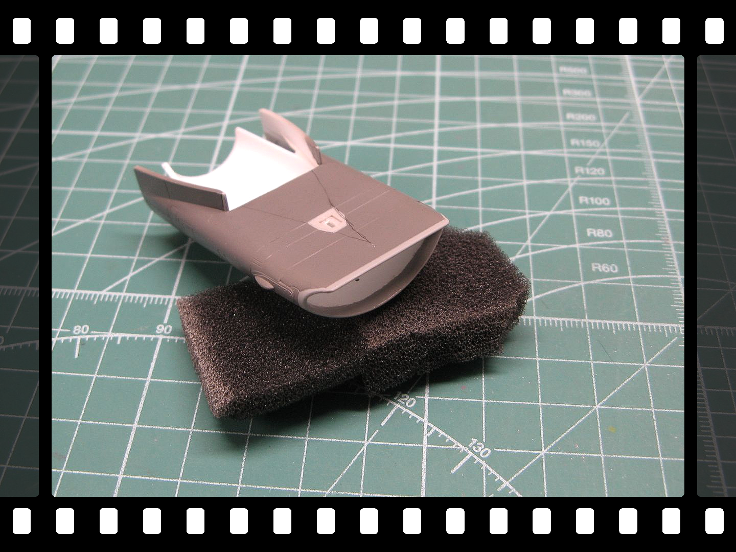

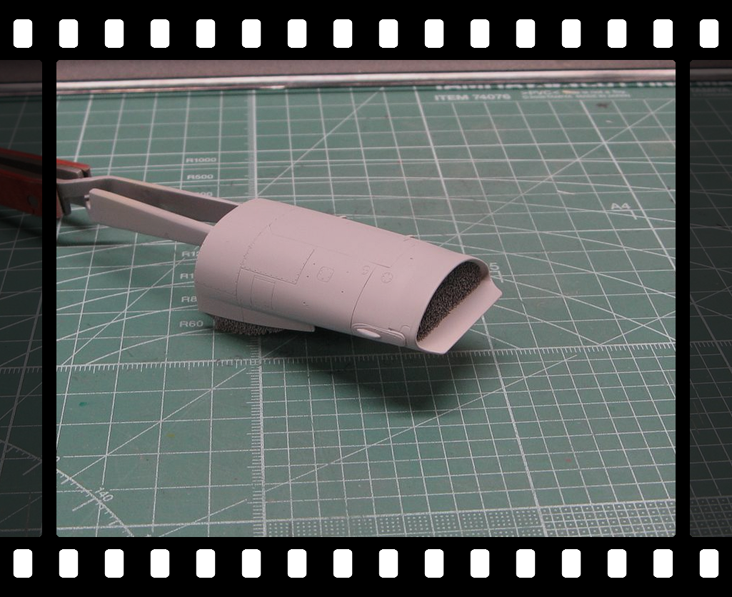

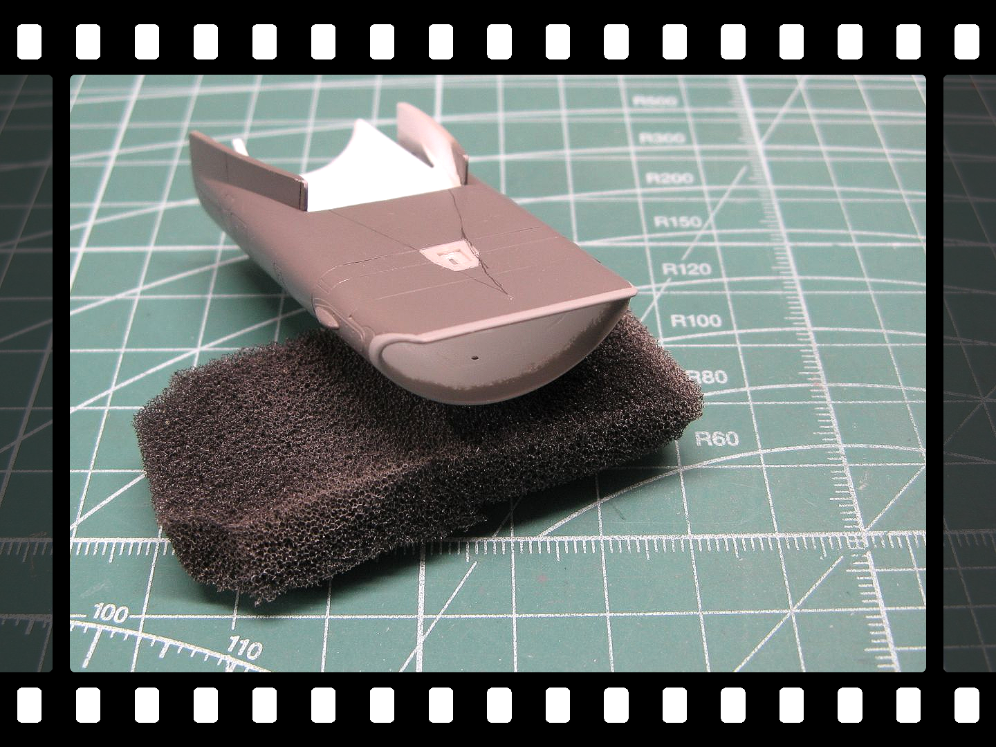

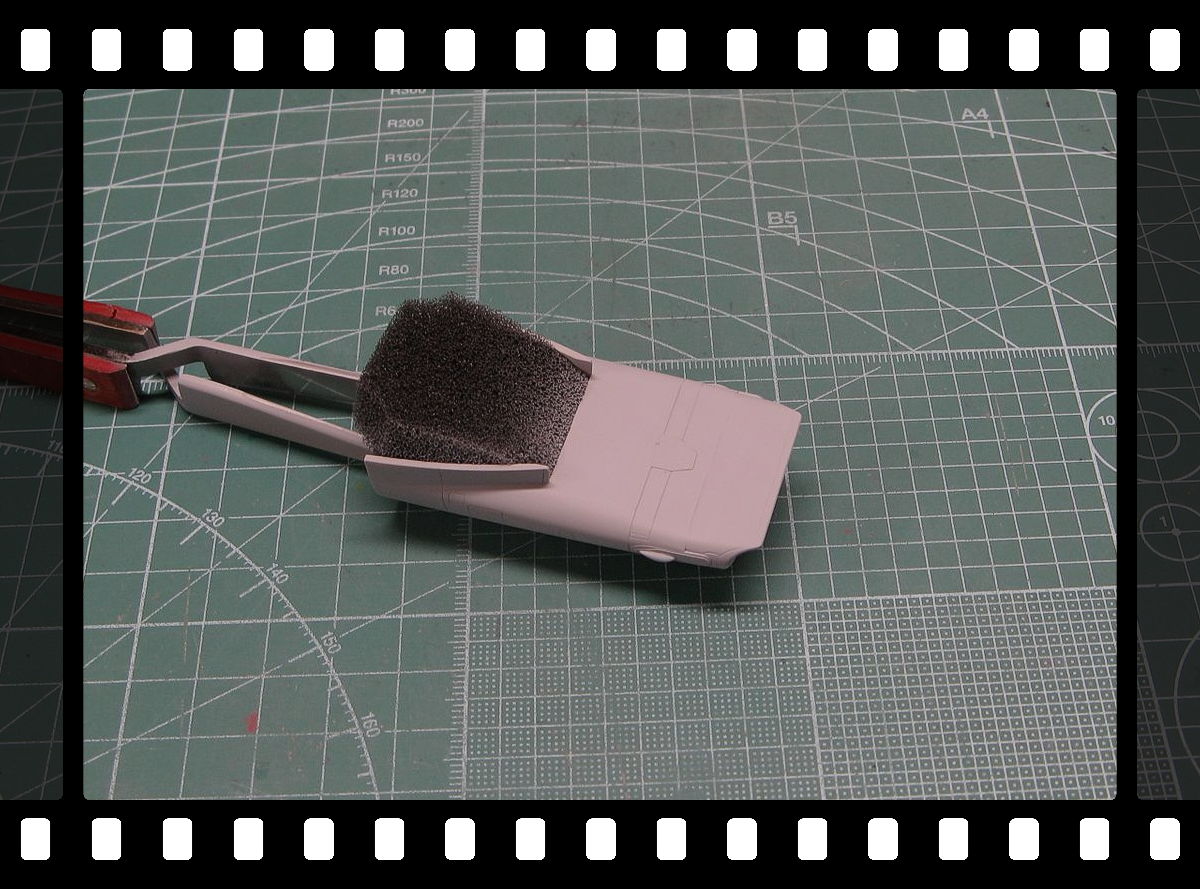

A-10 LOADER Posted February 27 Author Share Posted February 27 Thanks for checking in guys and, your supportive comments. Upon removing the foam from the intake, I was very disappointed to see the mess that was left behind 😠. I've used the foam on past projects with good results but, not this time. When I first started the intake I spent an hour trying to mask it off but, it just wasn't cooperating so, went with the foam plug. I need to get this fixed and insert the intake reinforcement strut before I attach the intake to the lower fuselage. How people attach this part first then try to mask and paint, I have no idea. After some careful hand brushing I was able to get it looking better. It's not perfect or being entered in a contest so, I'll call this a win. Quote Link to post Share on other sites

A-10 LOADER Posted February 27 Author Share Posted February 27 (edited) Thanks Mr. Happy. The AK sprayed very nice. It's a lacquer so I mixed it 50/50 with Mr. Color Leveling Thinner shot thru my Gaahleri airbrush with a 0.5 needle. Great airbrush, atomizes the paint extremely well which is key since this color has a LOT of metallic in it. Wishing you a speedy recovery. Steve Edited February 28 by A-10 LOADER Quote Link to post Share on other sites
