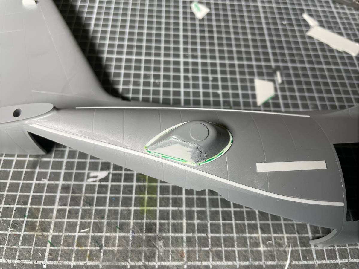

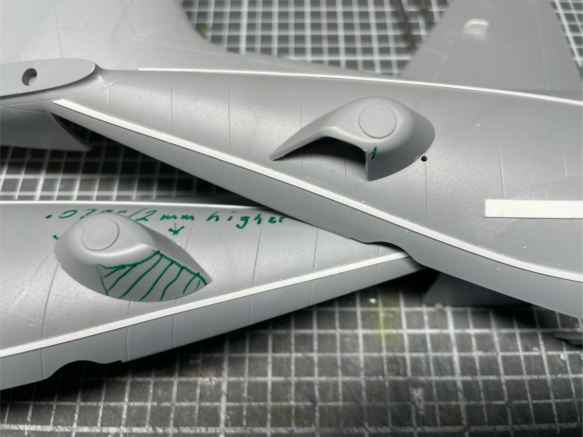

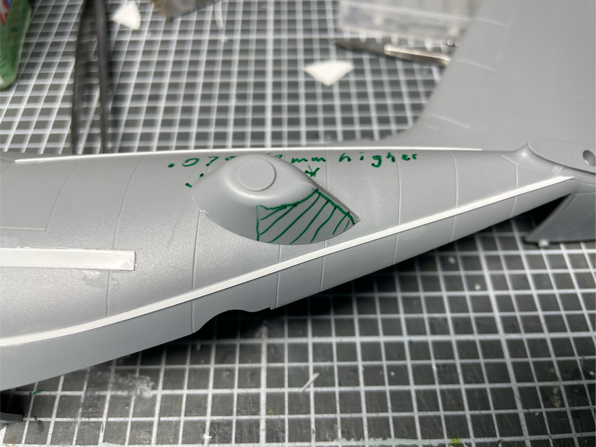

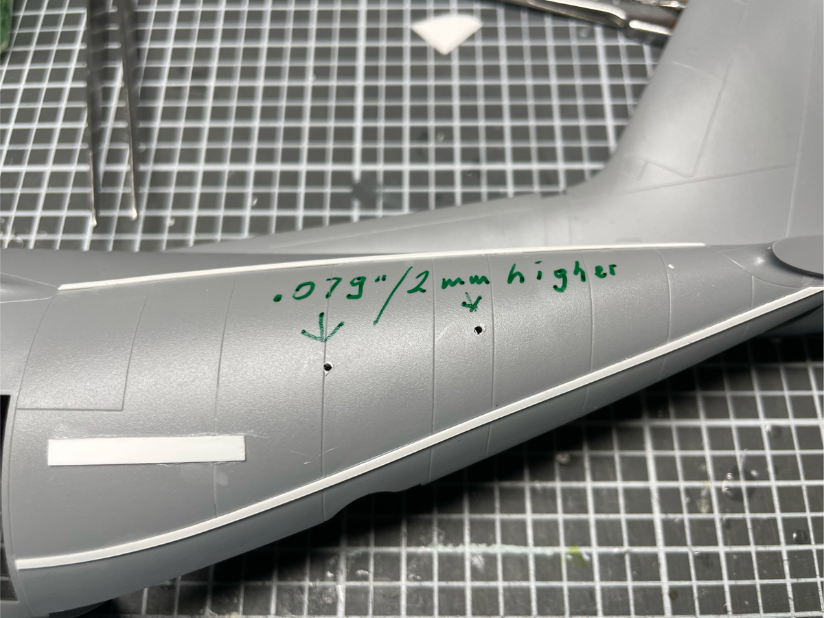

AWACS-RESIN Posted December 3, 2024 Share Posted December 3, 2024 Hi all, here I am starting another challenge with the construction of a Lookeed Martin EC-130J from the Zvezda kit in 1/72 scale. I started with some reinforcements and the DIRCM fairings. Thanks for looking. Quote Link to post Share on other sites

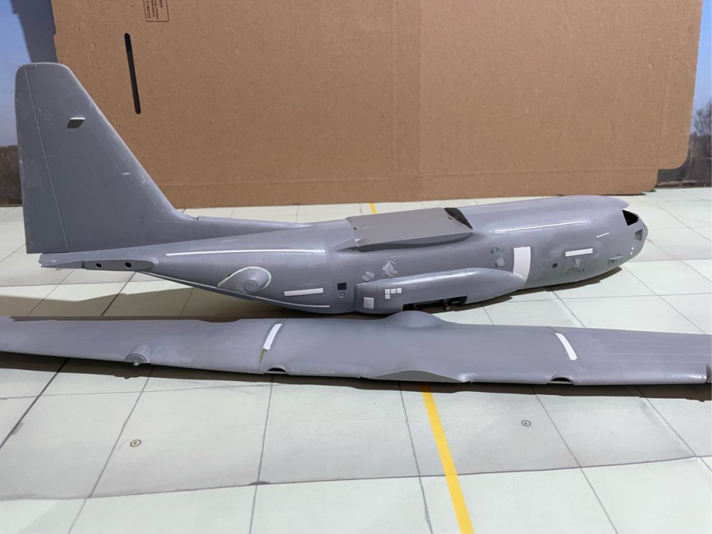

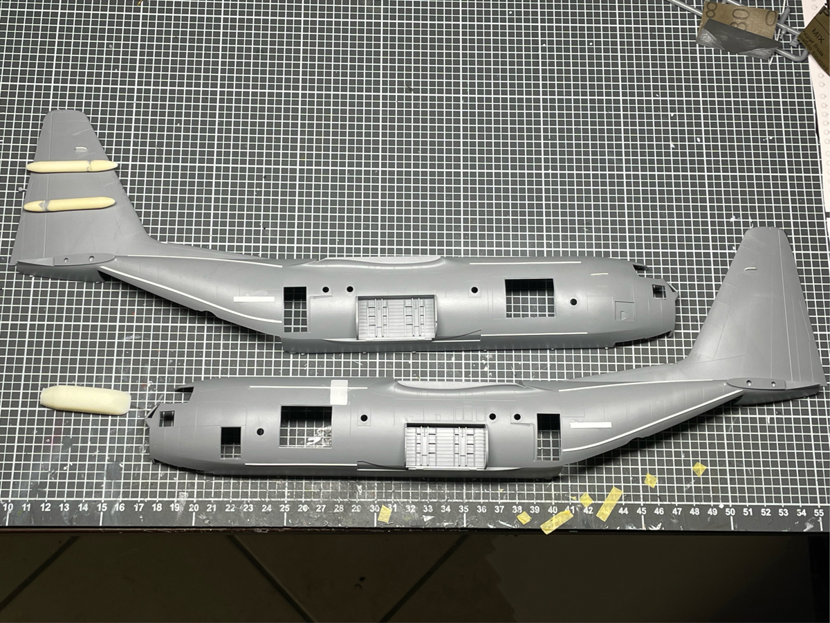

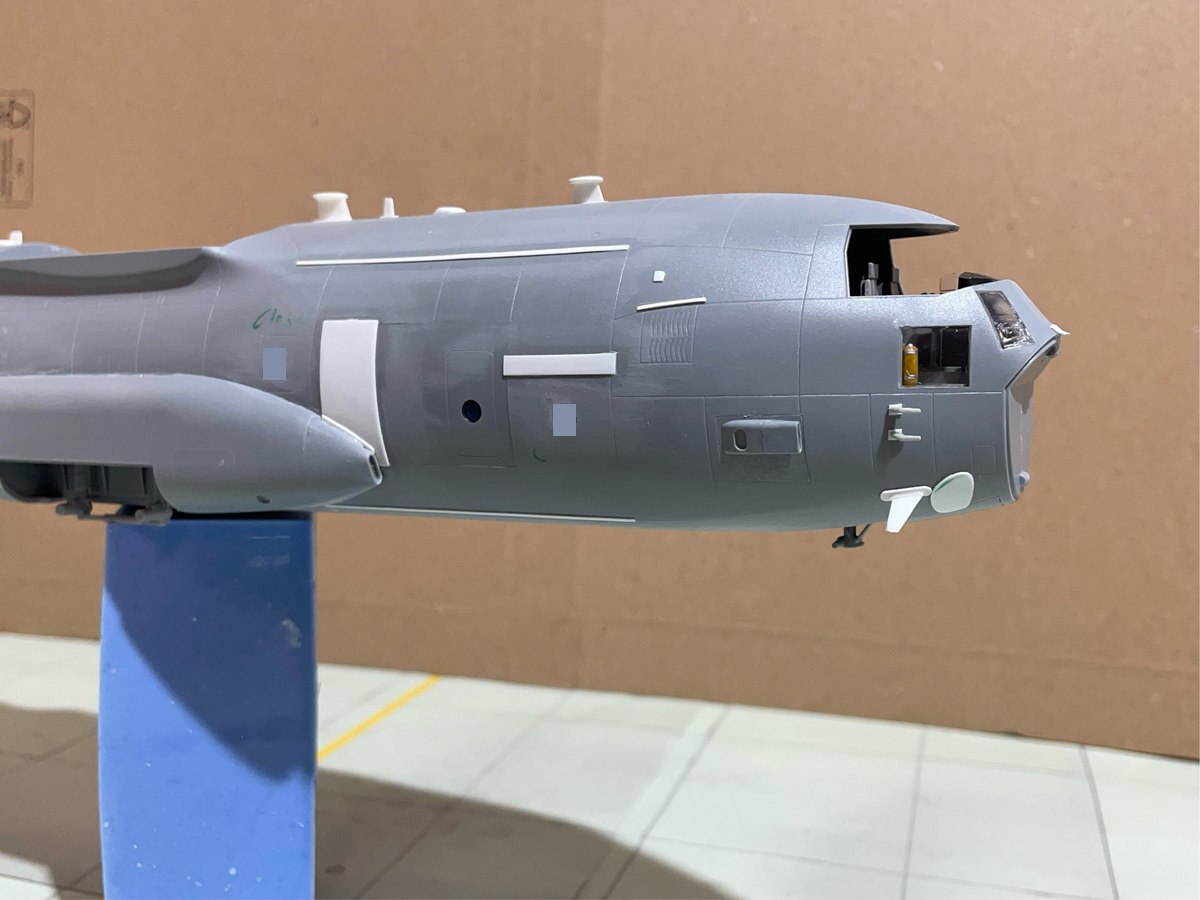

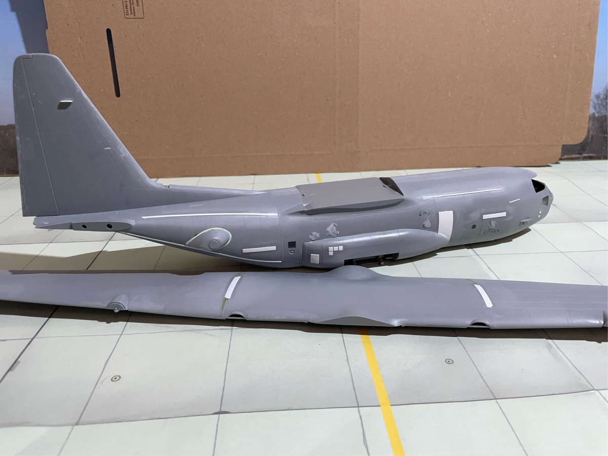

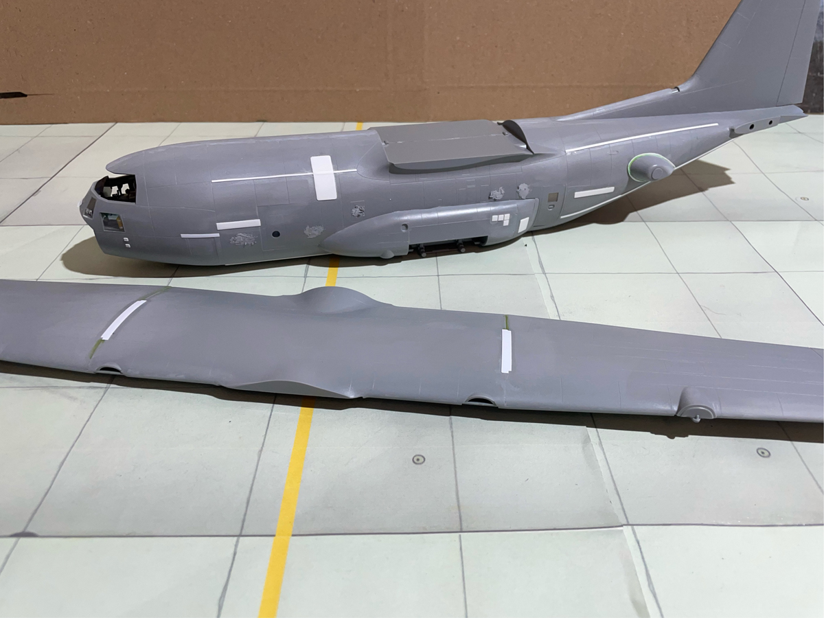

AWACS-RESIN Posted December 18, 2024 Author Share Posted December 18, 2024 Progress on the build. Glued the fuselage and wings together and added a few more reinforcement stripes. Quote Link to post Share on other sites
A-10 LOADER Posted December 19, 2024 Share Posted December 19, 2024 Looking good Jost, she's taking shape. Steve Quote Link to post Share on other sites

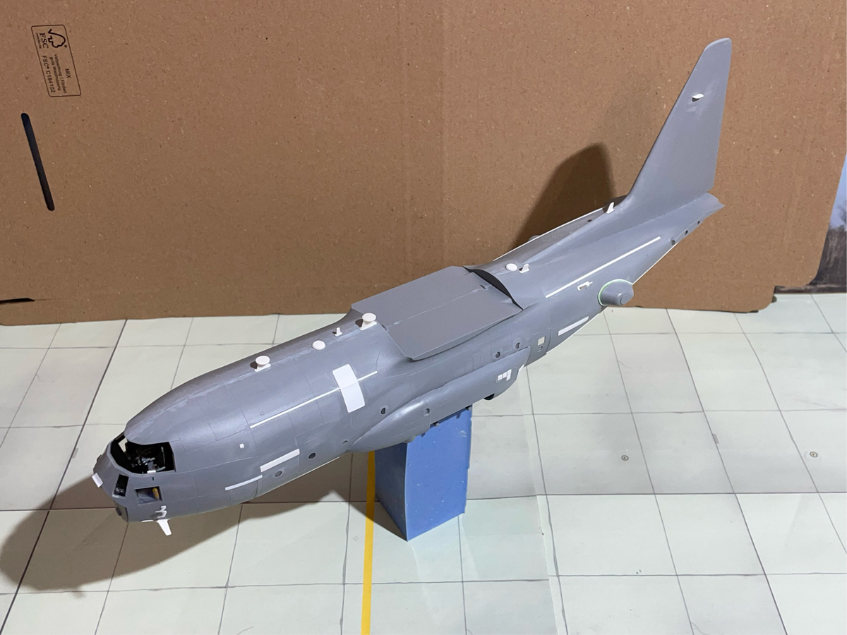

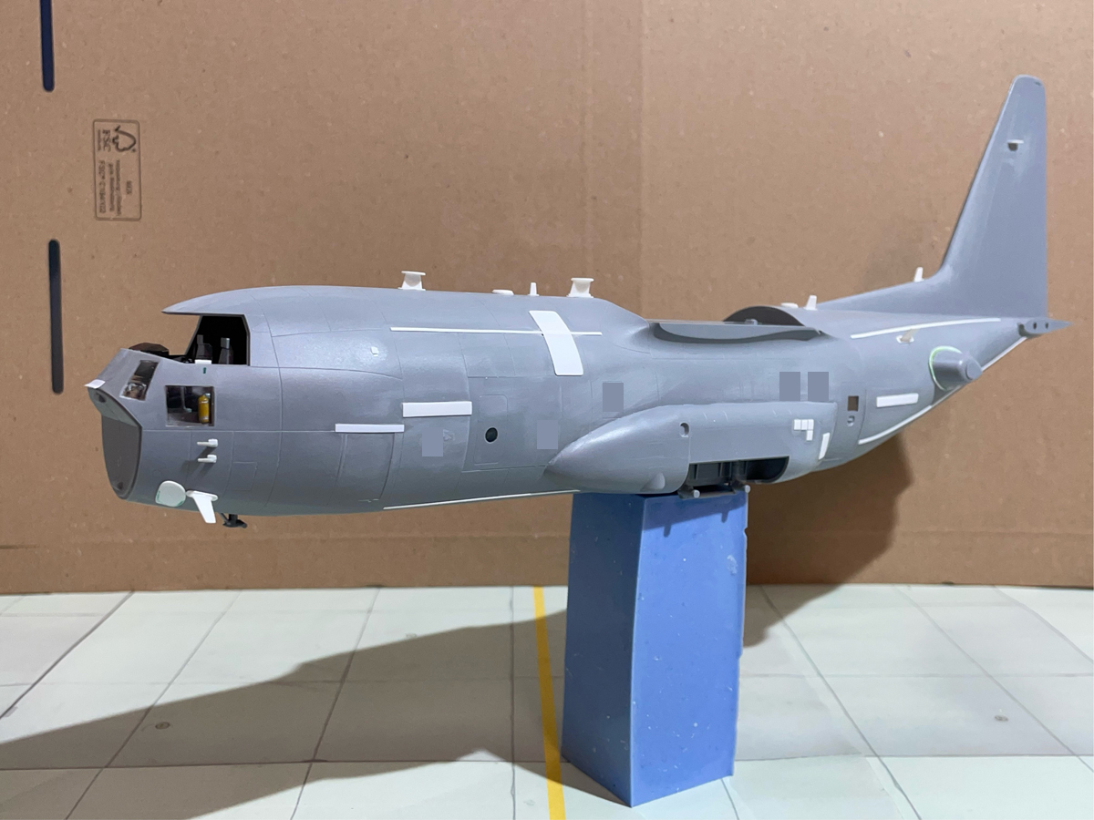

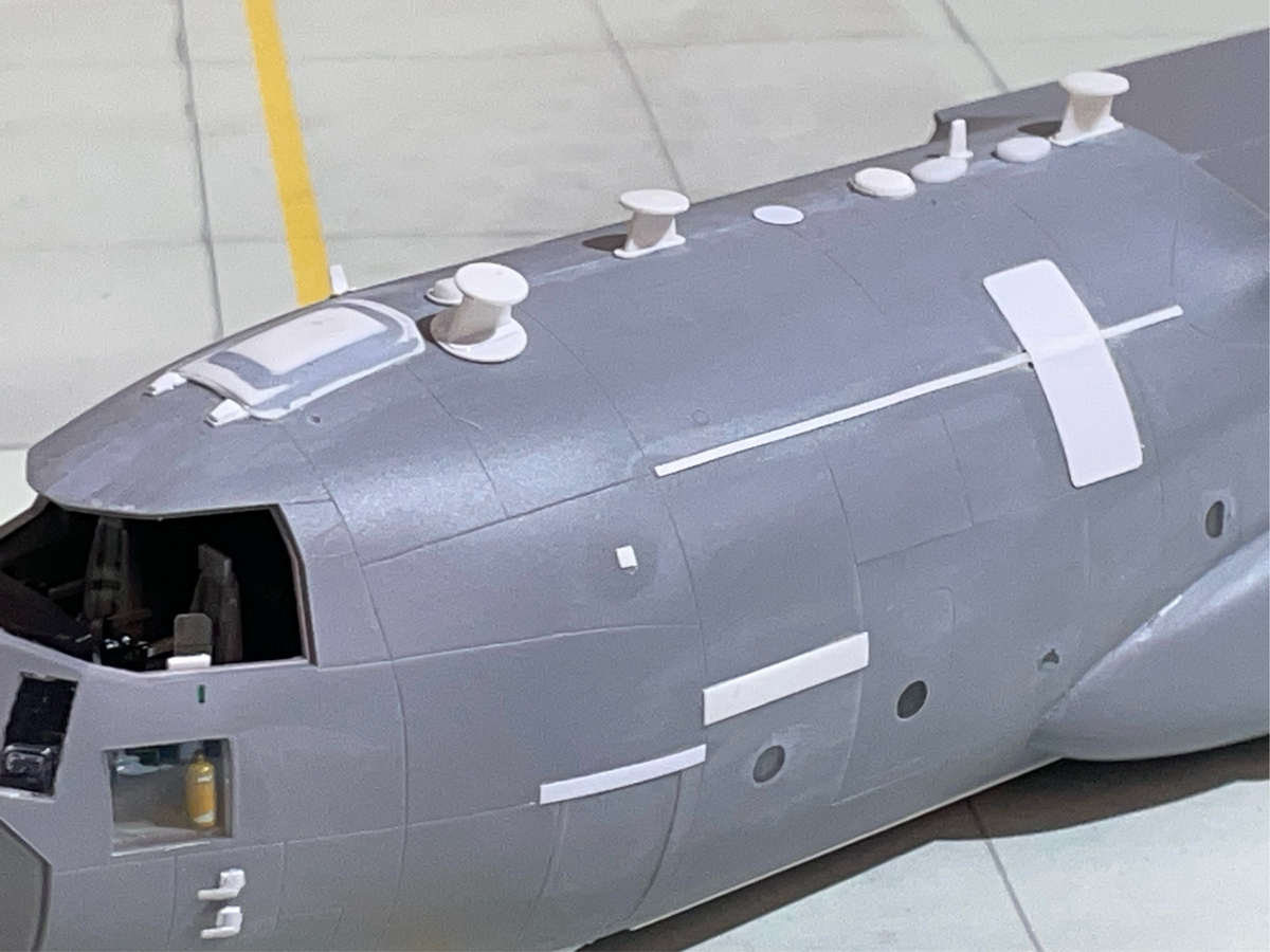

AWACS-RESIN Posted December 21, 2024 Author Share Posted December 21, 2024 The EC-130J also continues with the antennas on the top and on the front sides. This is the last update before Christmas. Merry Christmas to you all. Quote Link to post Share on other sites
Ichitoe Posted December 21, 2024 Share Posted December 21, 2024 Fantastic work! Looking forward to the rest of your build. Those antennae wouldn’t survive more than a session with my heavy handed modeling, LOL! Quote Link to post Share on other sites
A-10 LOADER Posted December 21, 2024 Share Posted December 21, 2024 She's looking really good too Jost, keep it up. Steve Quote Link to post Share on other sites

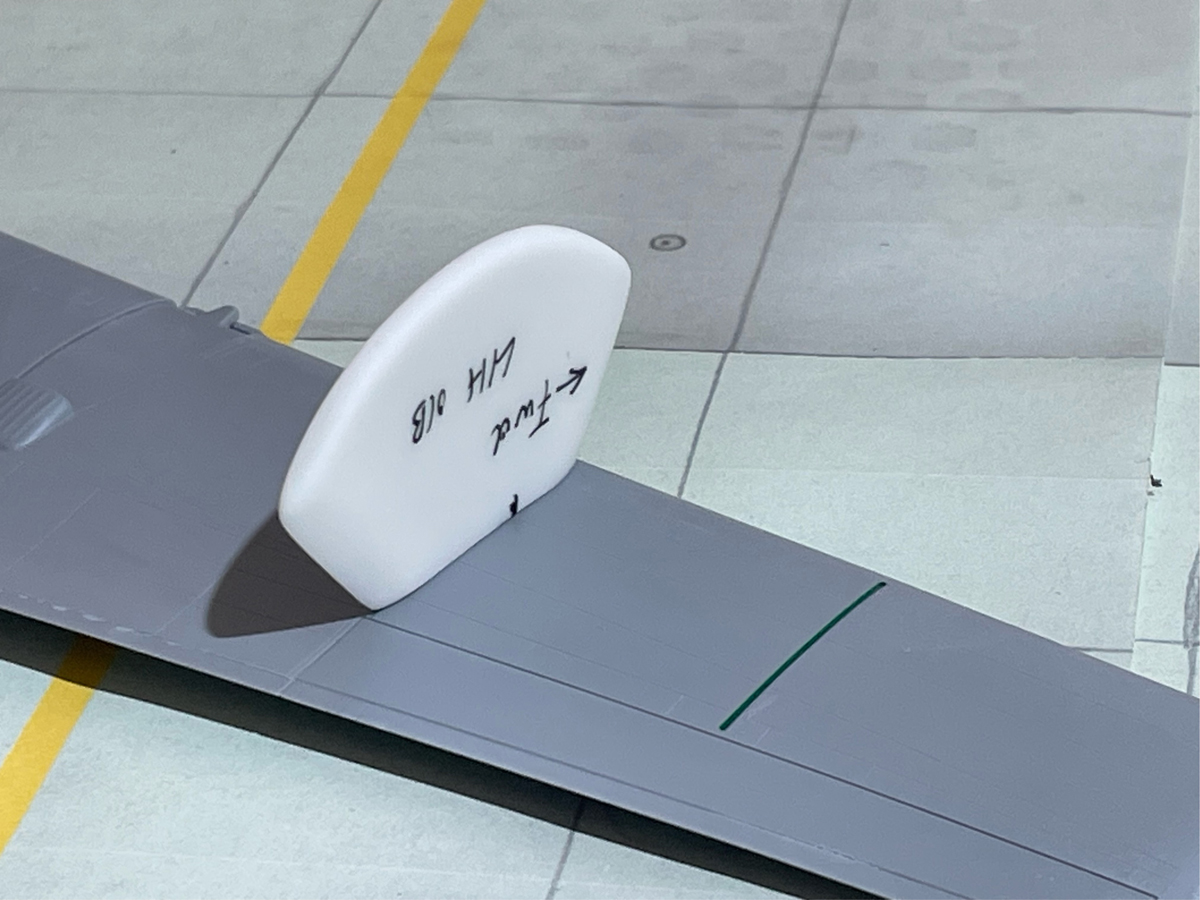

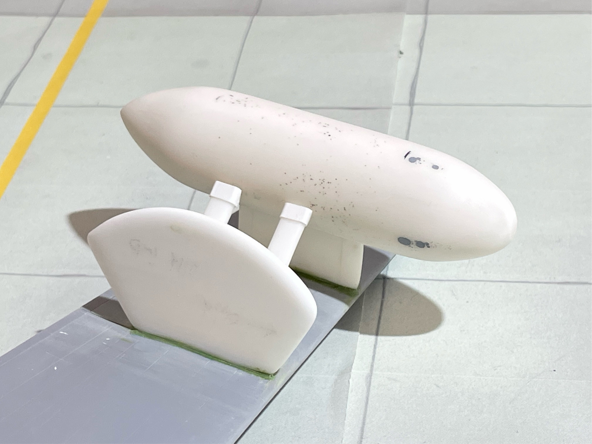

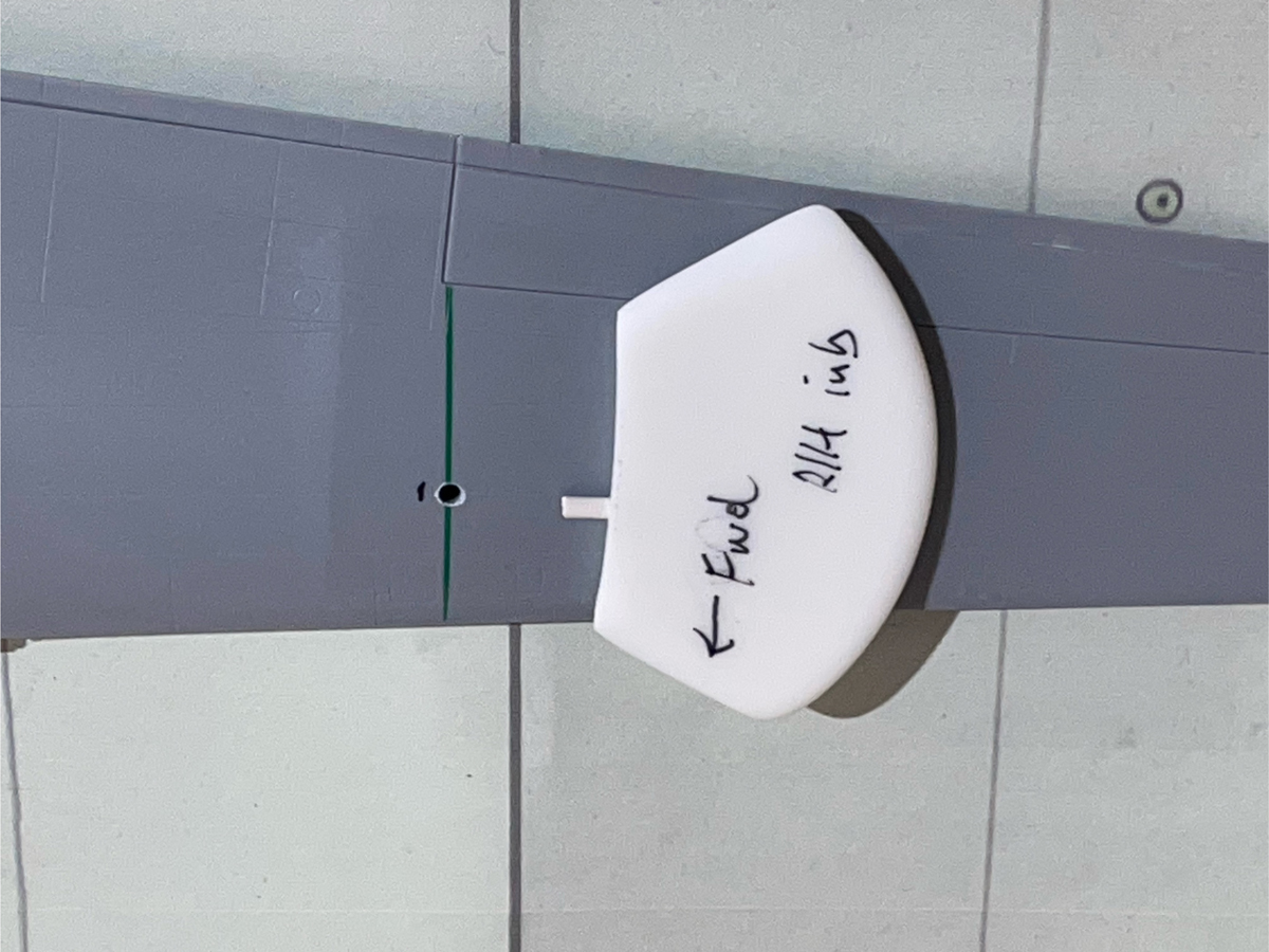

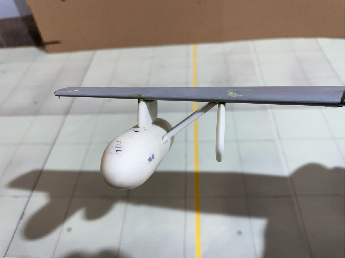

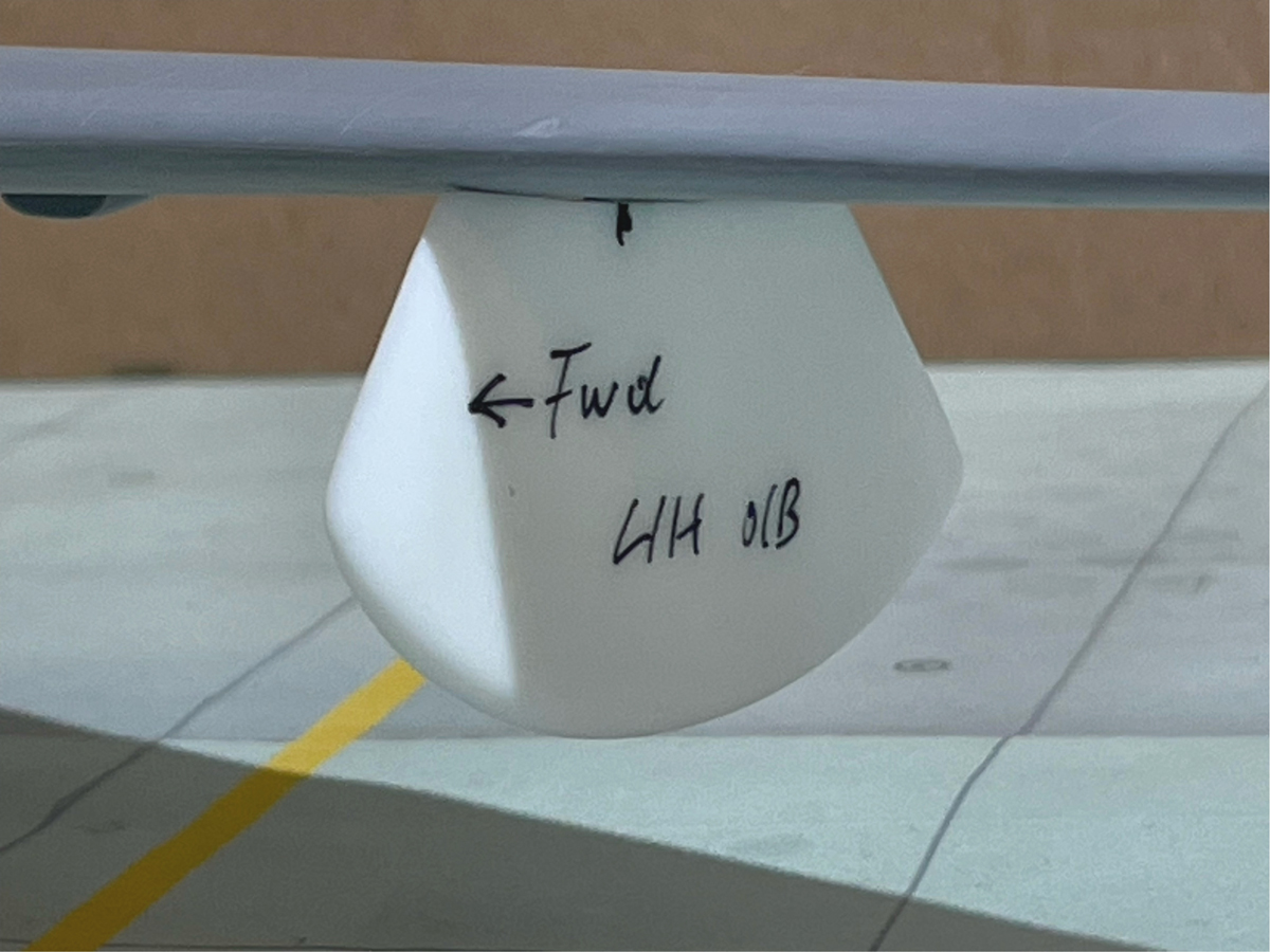

AWACS-RESIN Posted December 27, 2024 Author Share Posted December 27, 2024 Today I starded on the wing blade antennas and electronic equipment pods. Quote Link to post Share on other sites

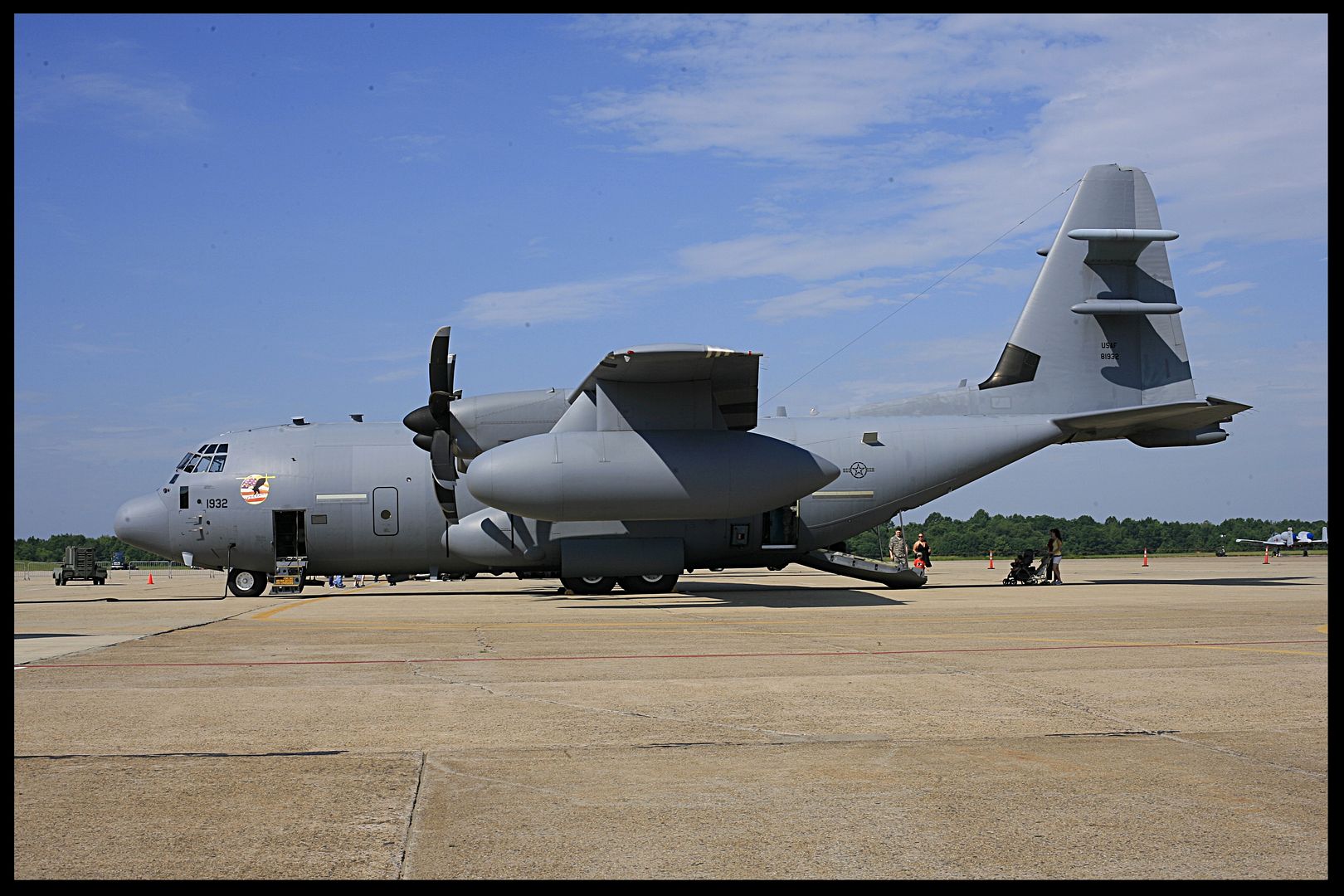

A-10 LOADER Posted December 27, 2024 Share Posted December 27, 2024 (edited) Looks great Jost. You're very fortunate you're able to cast your own parts, they look good. Here's a shot I took at our "Family Day" of a 193rd J model. EC-130J, 193rd SOW / 193rd SOS, 98-1932, Willow Grove ARS, June 6, 2010. "FLIGHTLINE PHOTO" Steve Edited December 27, 2024 by A-10 LOADER Quote Link to post Share on other sites
AWACS-RESIN Posted December 27, 2024 Author Share Posted December 27, 2024 37 minutes ago, A-10 LOADER said: Looks great Jost. You're very fortunate you're able to cast your own parts, they look good. Here's a shot I took at our "Family Day" of a 193rd J model. EC-130J, 193rd SOW / 193rd SOS, 98-1932, Willow Grove ARS, June 6, 2010. "FLIGHTLINE PHOTO" Steve Thanks, Steve. Nice Pic. I like to paint my EC-139J in that scheme but not 100% shure, what FS # it is. Can’t find anything. Do you know the number? Regards, Jost Quote Link to post Share on other sites
A-10 LOADER Posted December 27, 2024 Share Posted December 27, 2024 6 minutes ago, AWACS-RESIN said: Thanks, Steve. Nice Pic. I like to paint my EC-139J in that scheme but not 100% shure, what FS # it is. Can’t find anything. Do you know the number? Regards, Jost It's AMC Grey, FS 36173. Steve Quote Link to post Share on other sites
AWACS-RESIN Posted December 27, 2024 Author Share Posted December 27, 2024 6 minutes ago, A-10 LOADER said: It's AMC Grey, FS 36173. Steve I almost thought so, but I wasn't sure. Perfect, thank you very much Steve. Quote Link to post Share on other sites
A-10 LOADER Posted December 27, 2024 Share Posted December 27, 2024 1 minute ago, AWACS-RESIN said: I almost thought so, but I wasn't sure. Perfect, thank you very much Steve. You're welcome. Steve Quote Link to post Share on other sites
Da SWO Posted December 28, 2024 Share Posted December 28, 2024 I love 130's, but COMMANDO SOLO II had to have been the ugliest 130 built. Nice model though, I am in awe of you fabrication skills. How did you make the blade antennas? Quote Link to post Share on other sites
AWACS-RESIN Posted December 28, 2024 Author Share Posted December 28, 2024 6 hours ago, Da SWO said: I love 130's, but COMMANDO SOLO II had to have been the ugliest 130 built. Nice model though, I am in awe of you fabrication skills. How did you make the blade antennas? Thanks Da SWO, For all those large Antennas and pods I cast resin plates and round rods.Then they are cut and sanded until they have the shape of my previously created 1:72 scale drawings. And of course very good photos. Quote Link to post Share on other sites

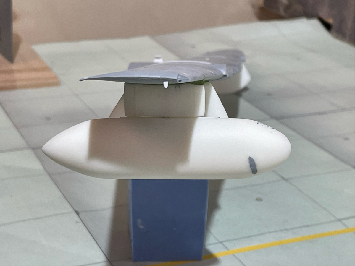

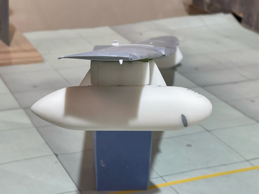

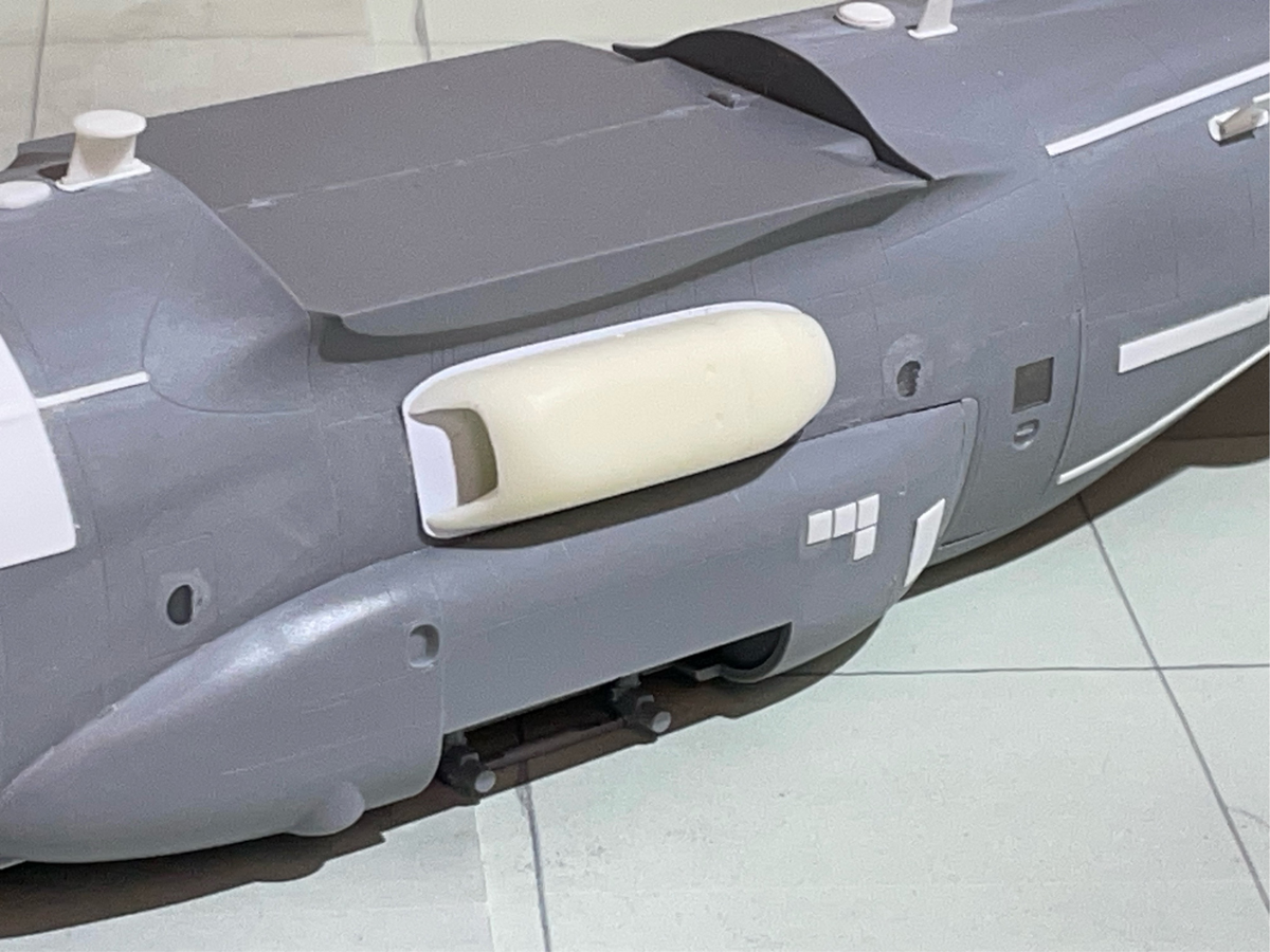

AWACS-RESIN Posted January 5 Author Share Posted January 5 Happy New Year all. Except for the four small lights, the upper fuselage is finished. I'll have to see, because I don't have a transparent rod to make them. The cooling air duct is attached on the left side. The electronic pod is provisionally attached under the right wing. Maybe a few more details will be added. Quote Link to post Share on other sites
A-10 LOADER Posted January 5 Share Posted January 5 Fantastic work on the add-ons, those underwing pods look great. Steve Quote Link to post Share on other sites

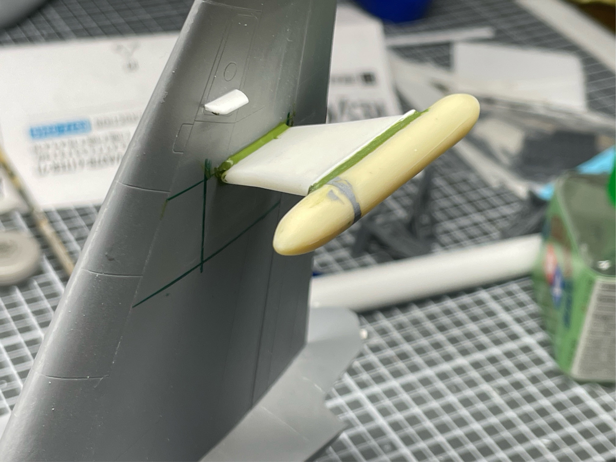

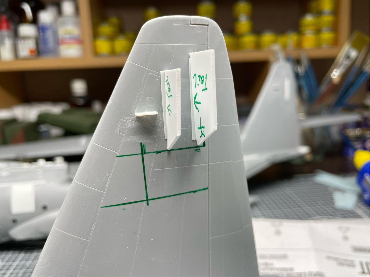

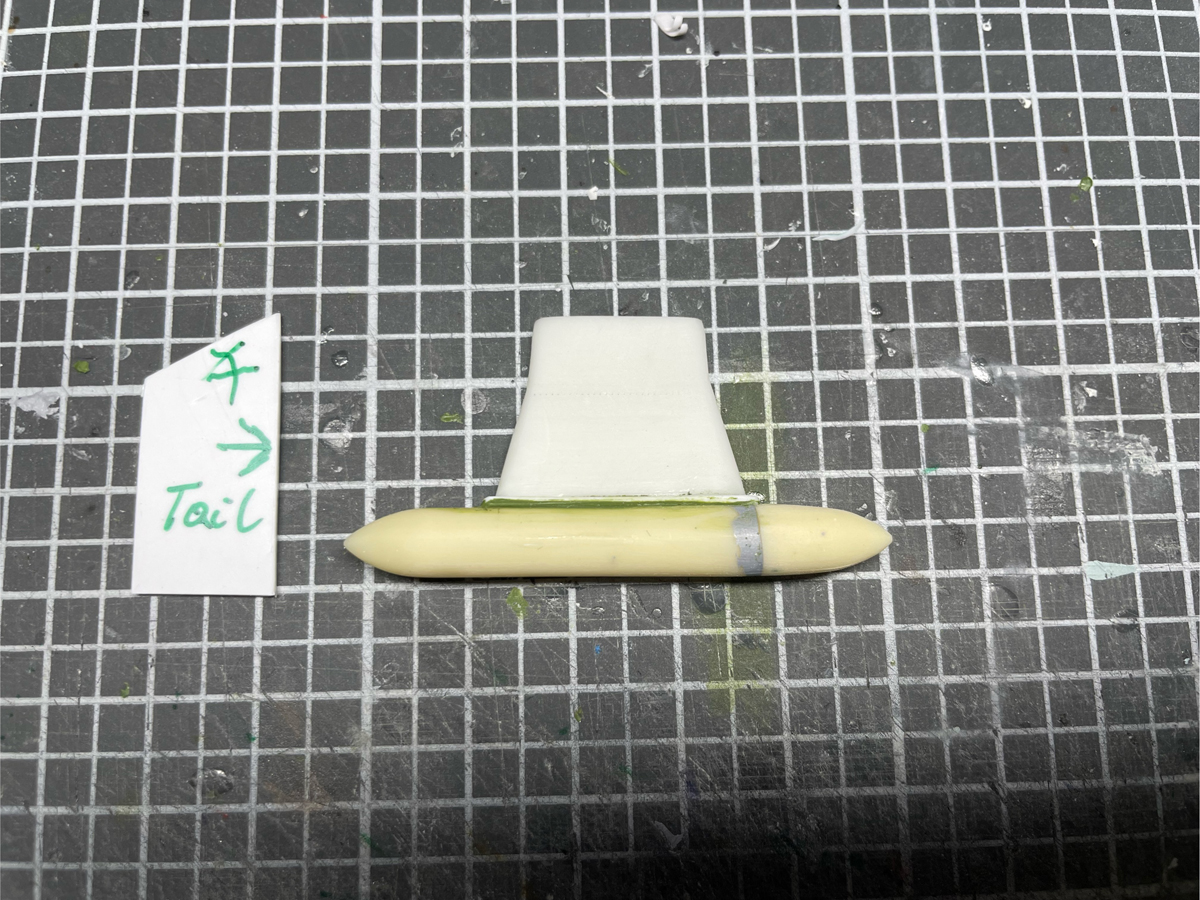

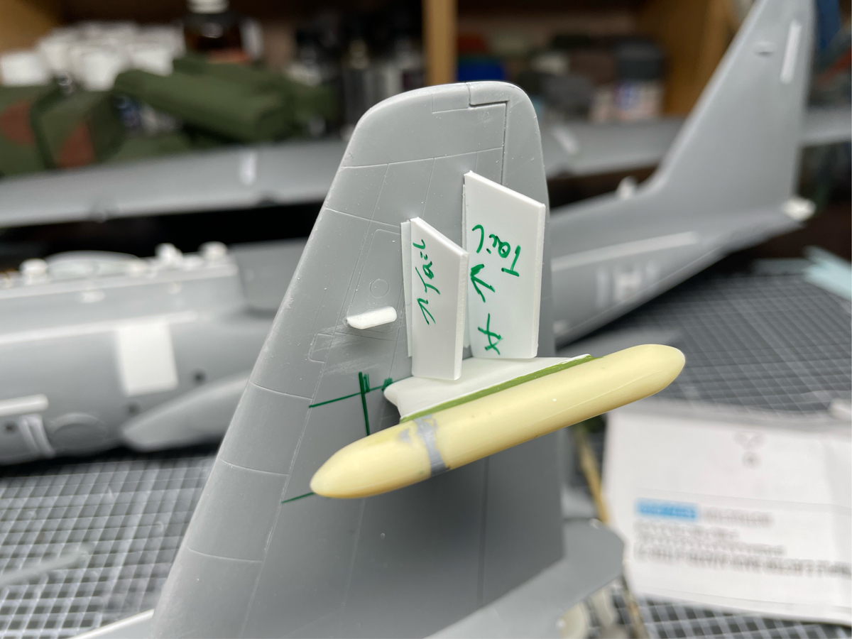

AWACS-RESIN Posted January 11 Author Share Posted January 11 Hi all, I took a break from the wings and will now continue with the antennas on the tail. The first one is finished and attached. I made an angle so that all four antennas have the same angle. The other three antennas are cast. Thank you for stopping by. Quote Link to post Share on other sites
A-10 LOADER Posted January 11 Share Posted January 11 The antennas looks great and, I was wondering how you were going to attack this. This will be a tough area to get paint into once they are all attached. Steve Quote Link to post Share on other sites
AWACS-RESIN Posted January 11 Author Share Posted January 11 18 minutes ago, A-10 LOADER said: The antennas looks great and, I was wondering how you were going to attack this. This will be a tough area to get paint into once they are all attached. Steve Thanks, Steve. Well, it always gets harder when parts are in the way. Things also get difficult with the antennas and e-pods under the wings. But I think it's easier here to inject everything at once. We'll see. It remains exciting. Cheers Quote Link to post Share on other sites
