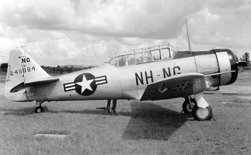

Hooker169 Posted December 4, 2024 Share Posted December 4, 2024 (edited) Does anyone know what version Texan this is? @Dutch I know you have an extensive library of New England aviation, and most probably have the answer but I feel you may be covered up in post hurricane restoration. I'm starting my nesting chores on a New Hampshire ANG aircraft lineage collection, but I want to make sure I’m getting them right. If anyone else can help with versions of other a/c flown by the 133rd out of NH, wether it’s Grenier or Pease that would be awesome! Thanks in advance Mike Edited December 4, 2024 by Hooker169 Quote Link to post Share on other sites
andyf117 Posted December 5, 2024 Share Posted December 5, 2024 (edited) Originally an AT-6C-15-NT and still around, according to these: http://warbirds-eaa.net/tuskegee-airmen-national-museums-north-american-t-6g/ https://www.aerialvisuals.ca/AirframeDossier.php?Serial=33378 https://www.airhistory.net/photo/225168/N884TA/248884 Also pictured here: https://www.skytamer.com/NA-88_AT-6C.html https://www.silverhawkauthor.com/post/warplanes-of-the-usa-new-hampshire-historic-photos http://www.tomhildrethphotos.com/AIRCRAFT/AIRPORTS/MHT/NHANG.htm Edited December 5, 2024 by andyf117 Quote Link to post Share on other sites
Hooker169 Posted December 5, 2024 Author Share Posted December 5, 2024 1 hour ago, andyf117 said: Originally an AT-6C-15-NT and still around, according to these: Perfect, Thanks Andy! Quote Link to post Share on other sites
Dutch Posted December 6, 2024 Share Posted December 6, 2024 (edited) Hooker, What Andy said. I just check ARC once a day and missed your RFI. Here is what Baugher says: 42-48772/49069 North American AT-6C-15-NT Texan Redesignated T-6C Jun 11, 1948 48884 (MSN 88-12794) Accepted by USAAF 27Mar43. 890th Single Engine Flying Training Squadron, Tuskegee Field, AL. Mid-air collision with a towed target at Eglin Auxiliary Field #7, Valparaiso, FL 28Sep43. Damaged in accident on the ground at Tuskegee Field 24Feb44. Squadron B, 2143rd Base Unit (Pilot School, Basic-Advanced), Tuskegee Field, AL. Damaged when ground looped at Tuskegee Field, AL 9Feb45. Damaged when nosed over when taxying at Tuskegee Field 17Aug45. Then going Independence, MO 4185th Base unit: 16 June 46 then to Tinker AAF, 18 June 46, then 554 Base Unit Memphis TN, 14 Aug 46. then 42nd Air Base Unit at Maxwell AAF, 6 Oct 46 Finally to 133 FS NH ANG Grenier AAF. 4 Jan 1948 To NAA for rebuild to T-6G on 14 Jan 1951. Rebuilt as T-6G 49-3190 in 1951 BTW, The cowl ring is deep red. break-break Andy, Excellent links you posted! BTW, I have one note on the excellent site by Harold Skaarup on New England Aviation. Concerning the photo of the C-124C, this was actually the delivery flight of the first C-124 to the NH ANG as it still wears MAC markings. That's the reason why the brass are present for the arrival! (USAF Photo) Douglas C-124C Globemaster II and aircrew, 133rd Military Airlift Squadron, New Hampshire Air National Guard, ca 1967. Edited December 6, 2024 by Dutch Quote Link to post Share on other sites
