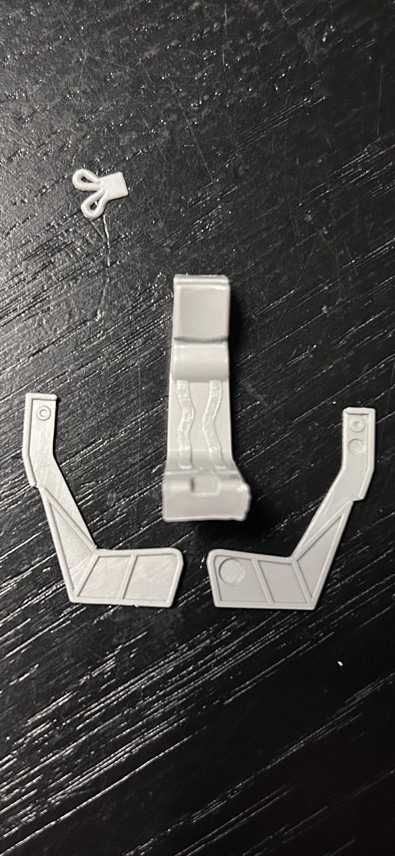

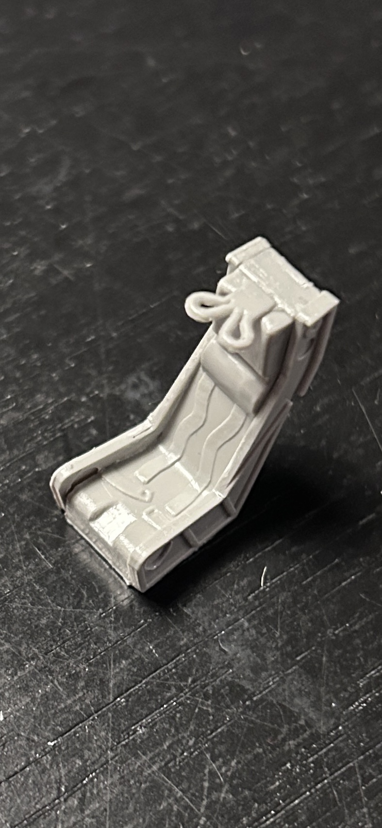

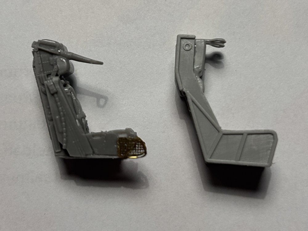

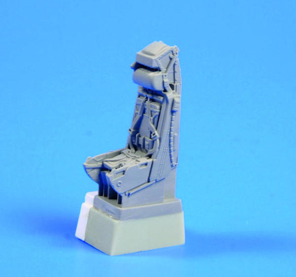

BastianD Posted December 27, 2024 Author Share Posted December 27, 2024 Starting with the ejection seat… 🤦🏻 My god, what a shame of this simple thing missing any detail… Think I will look for a very nice detailed seat of CMK (last photo). Quote Link to post Share on other sites

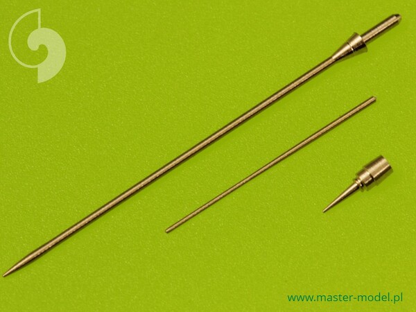

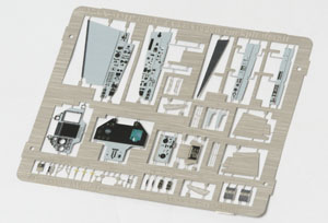

BastianD Posted January 4 Author Share Posted January 4 Ordered already a few aftermarket parts to improve the build: -CMK ejection seat -Brass pitot tubes and AOA probe -Maestro JA-37 cockpit set -Maestro air duct and first front fan Quote Link to post Share on other sites

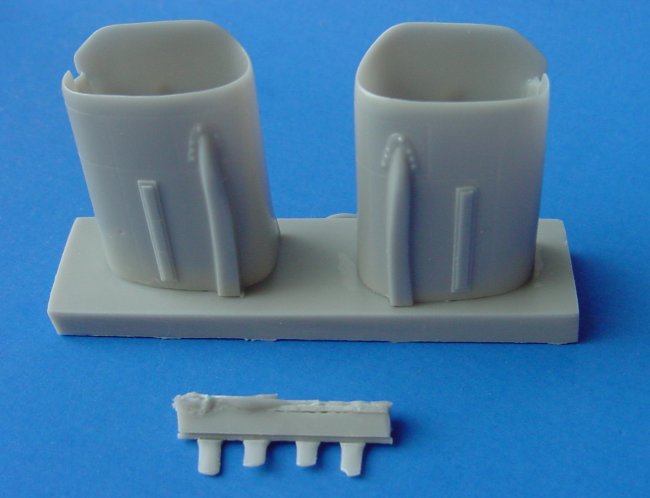

BastianD Posted January 4 Author Share Posted January 4 Want to add the Two Mikes improved intakes as well, but need to find them somewhere. Quote Link to post Share on other sites
Aigore Posted January 7 Share Posted January 7 Those intakes are oop since long. The kit intakes are easy to fix though. Quote Link to post Share on other sites
BastianD Posted January 7 Author Share Posted January 7 19 hours ago, Aigore said: Those intakes are oop since long. The kit intakes are easy to fix though. Thanks for letting me know. How would you advise to modify them? Quote Link to post Share on other sites
Aigore Posted January 10 Share Posted January 10 On 1/7/2025 at 9:35 PM, BastianD said: Thanks for letting me know. How would you advise to modify them? First cut off the guiding plug from the inside half. Then you need to cut a little notch in the lower intake lip, next to the splitterplate. Quote Link to post Share on other sites
BastianD Posted January 11 Author Share Posted January 11 On 1/10/2025 at 11:51 AM, Aigore said: First cut off the guiding plug from the inside half. Then you need to cut a little notch in the lower intake lip, next to the splitterplate. Thanks @Aigore Quote Link to post Share on other sites

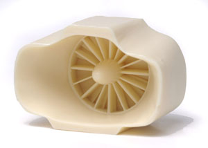

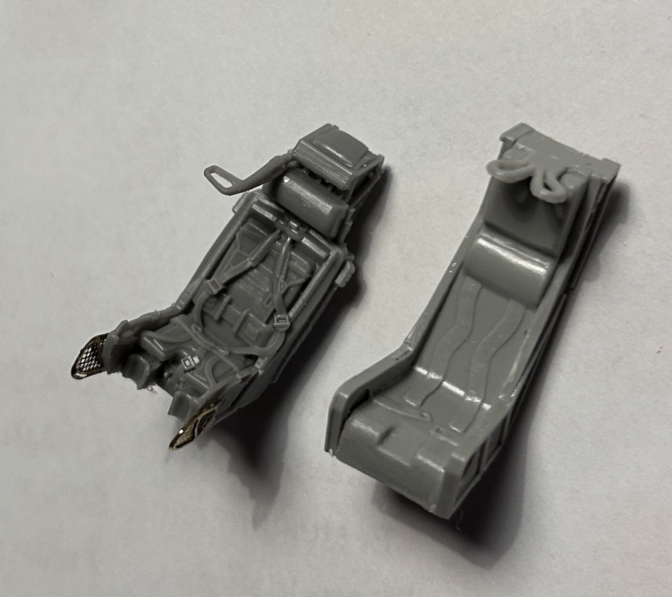

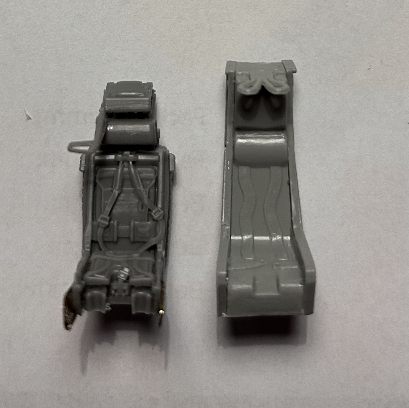

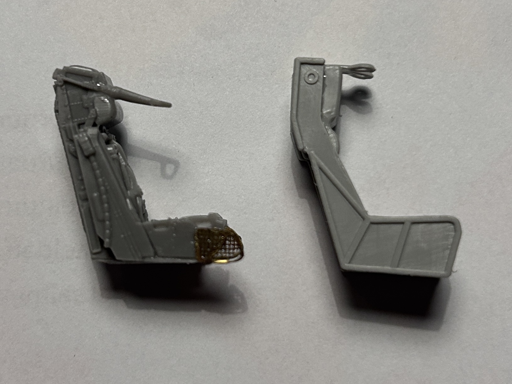

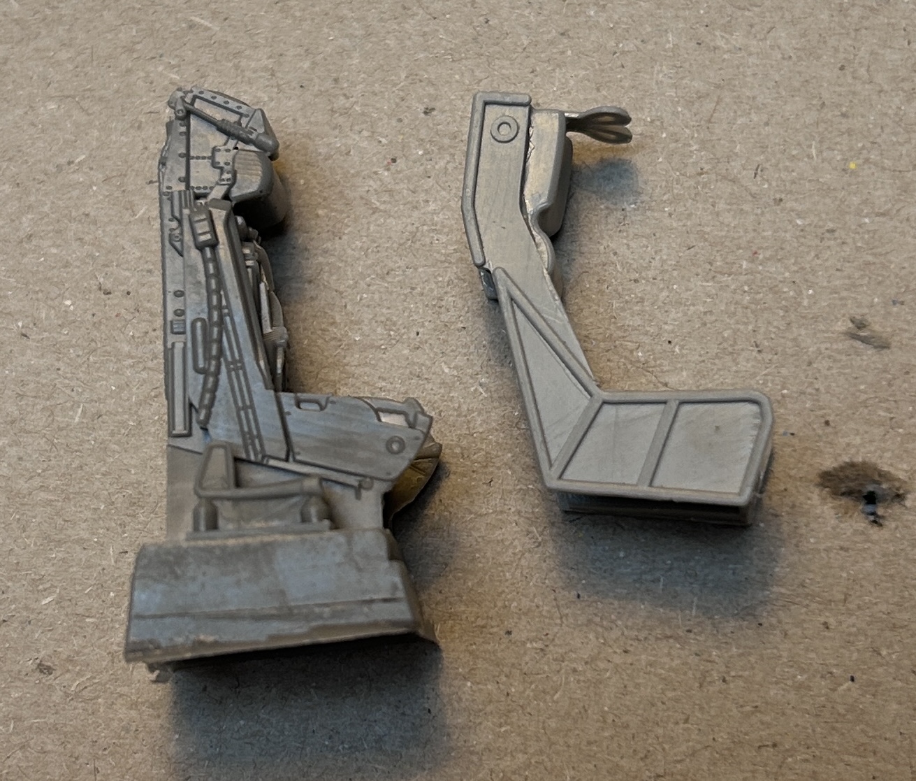

BastianD Posted January 19 Author Share Posted January 19 Just test fitting and comparing the aftermarket parts. What a difference does the ejection seat make compared to the kit’s version: much more detail and better overall look. Also the air duct with front fan seems to fit quite nicely, and will give a very much improved internal look after the intakes are being opened. Quote Link to post Share on other sites

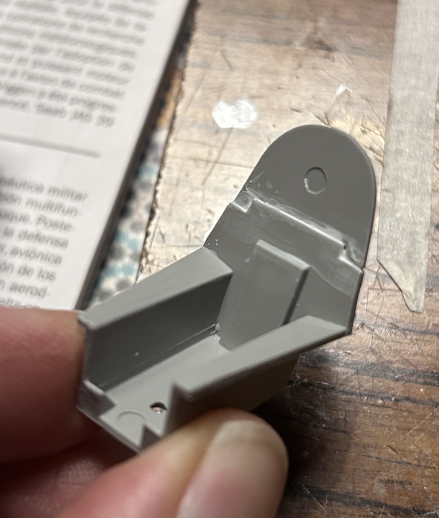

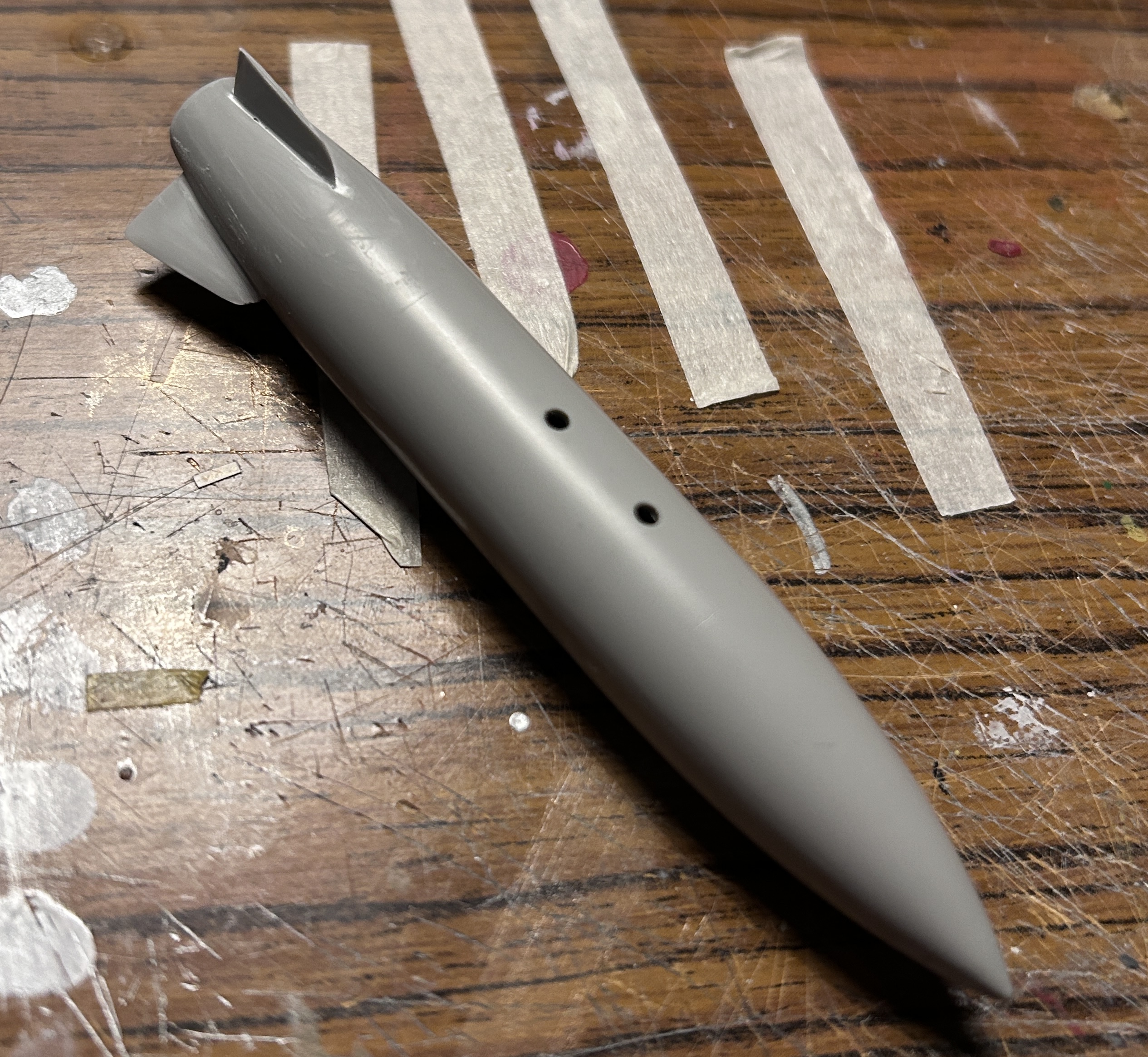

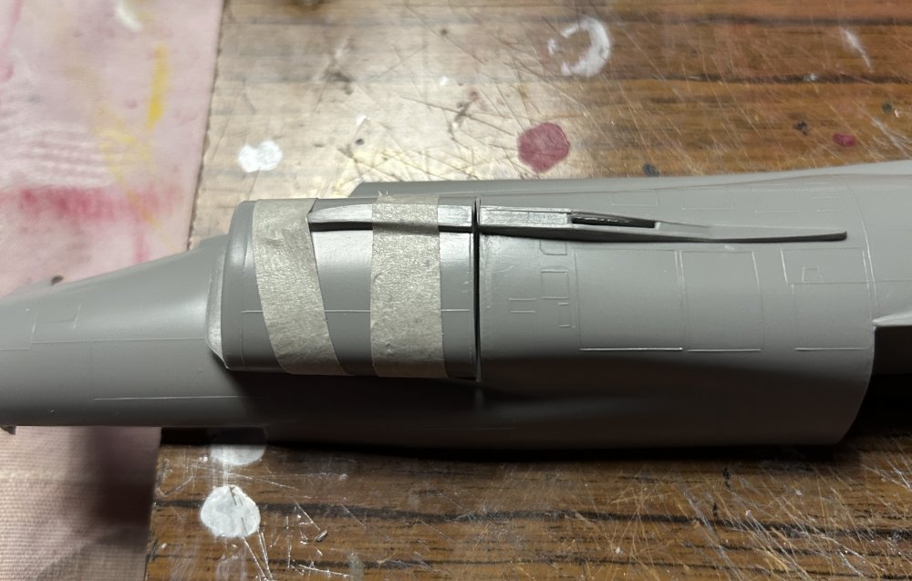

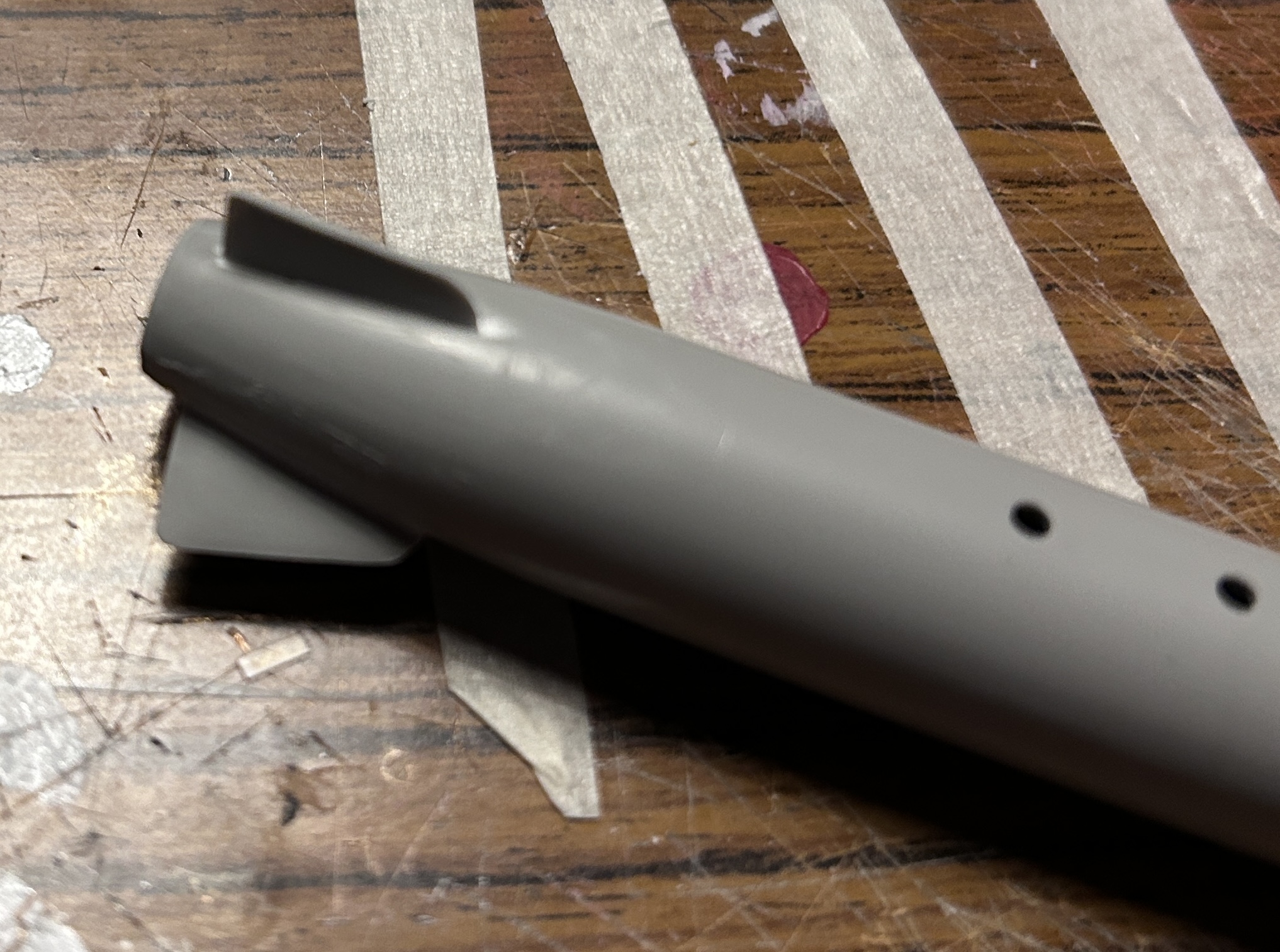

BastianD Posted January 23 Author Share Posted January 23 This kit is really giving you every bit of challenge. The fuselage lacks every piece of guiding, pinpoints or whatsoever to perfectly fit and align both fuselage halves. The cockpit tub is as spartan as it can be, and needs high modification (thank hod I have the Maestro modification set), especially the floor and back part behind the seat. Fuel tank however is a good fit and I glued the fins and used putty to make the smooth fit. Quote Link to post Share on other sites

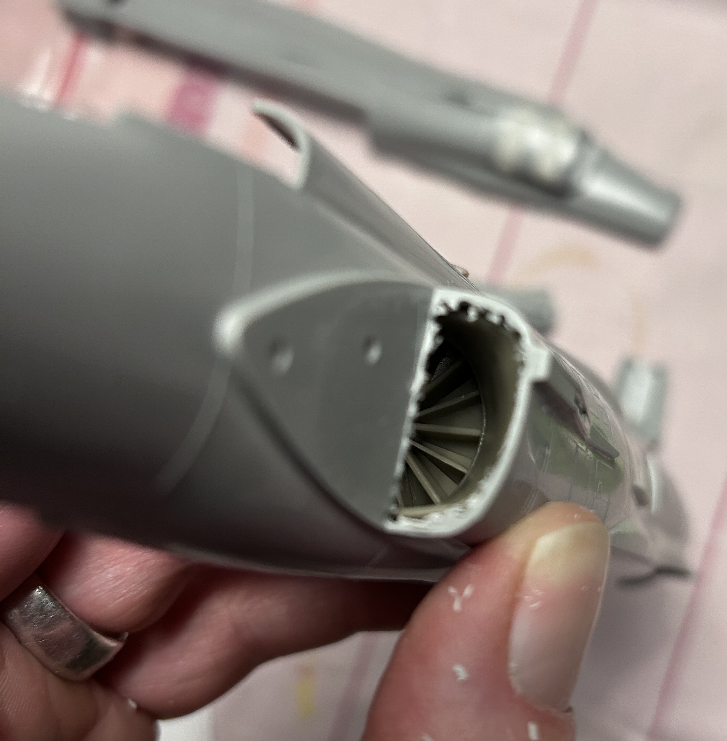

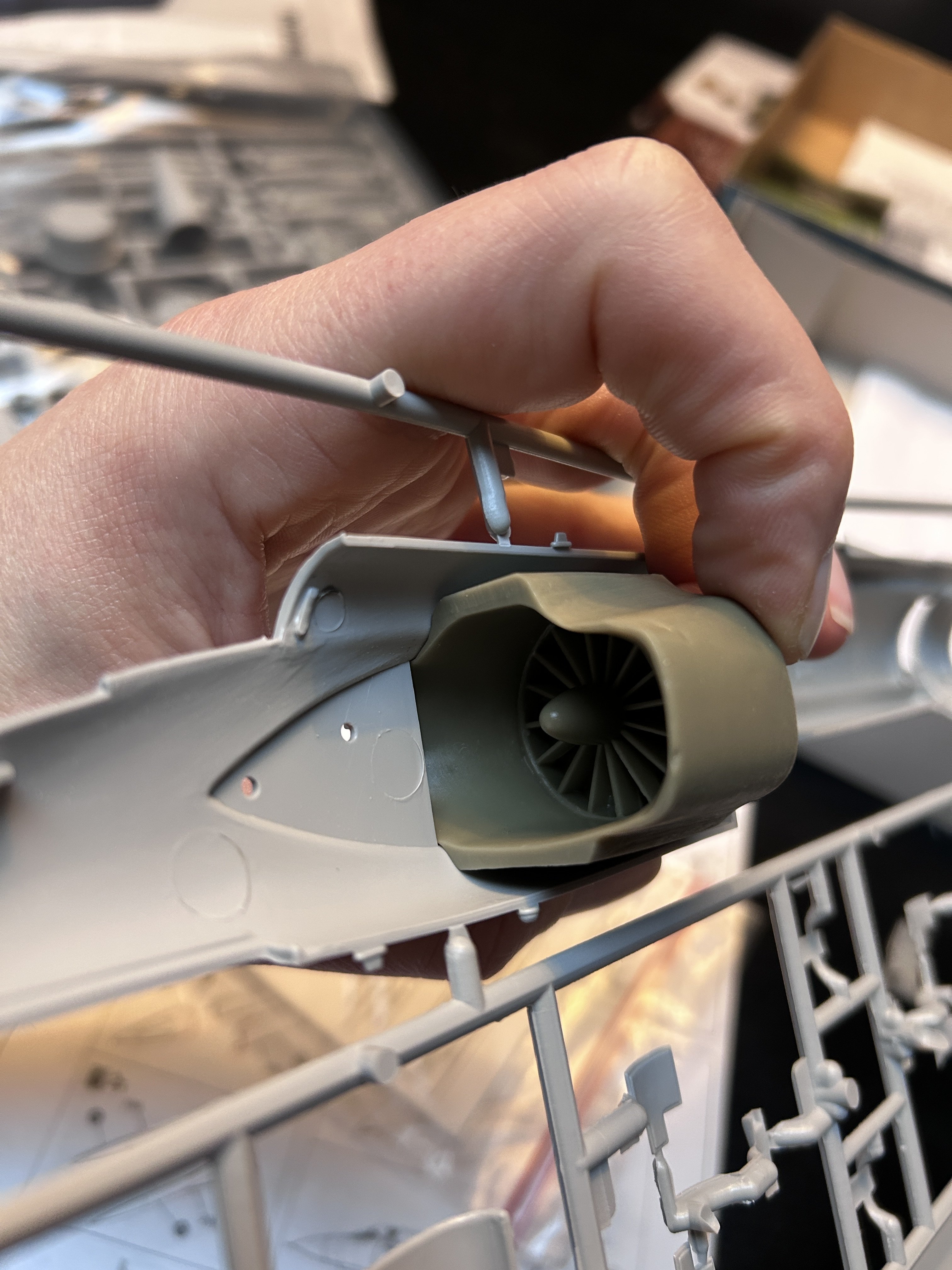

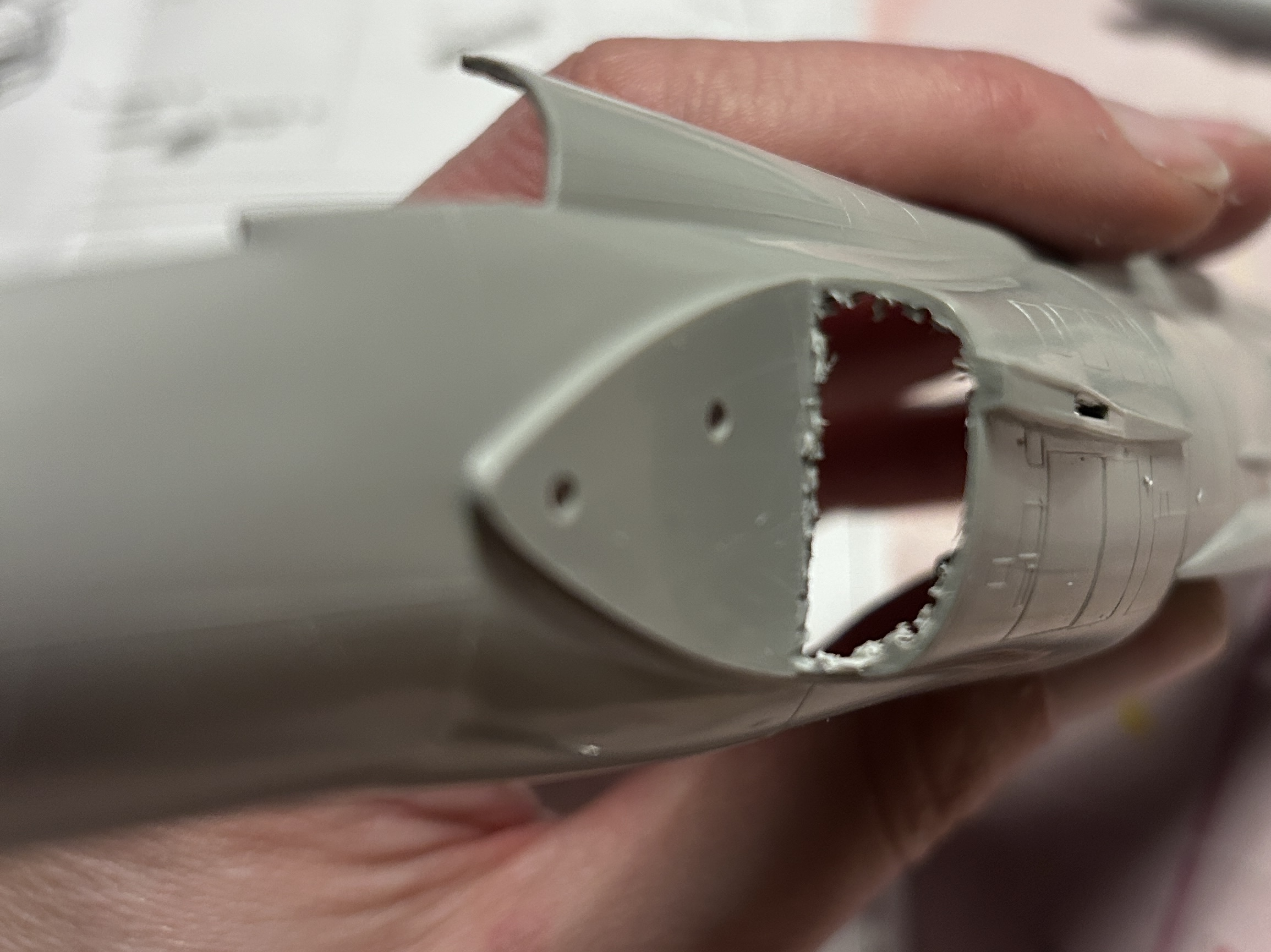

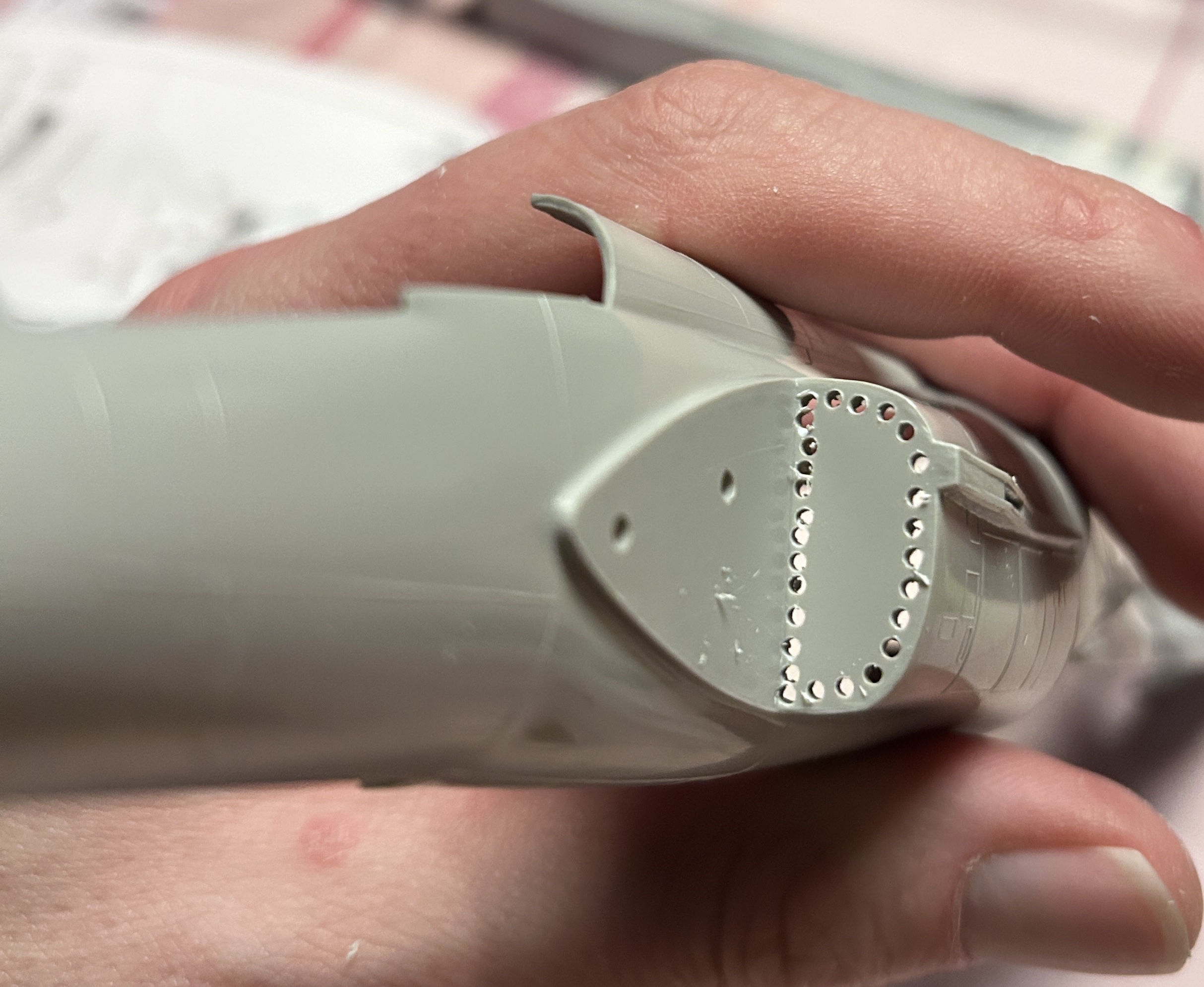

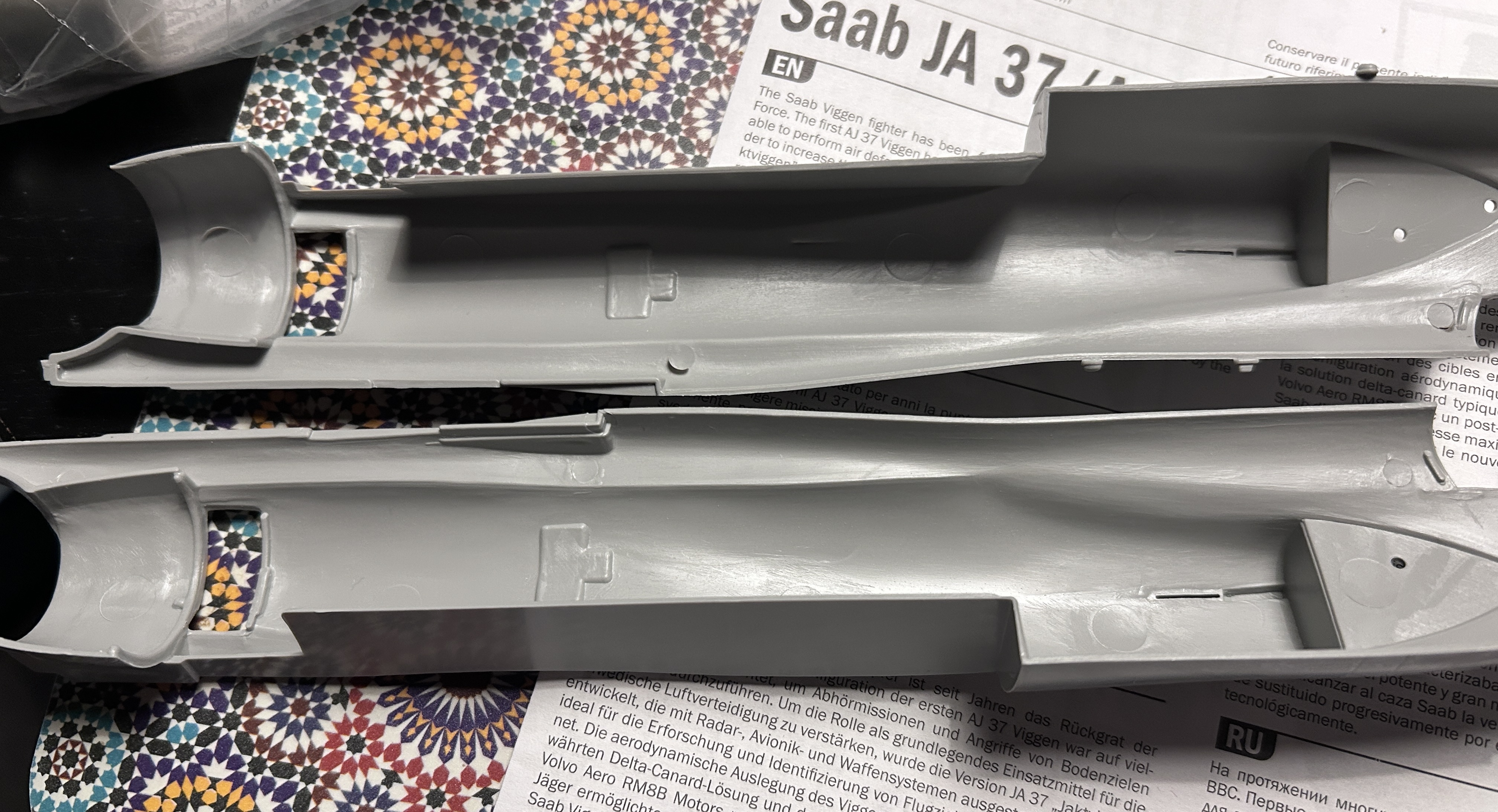

BastianD Posted January 26 Author Share Posted January 26 Test fitting the intakes… somebody took too much margin for the parts to fit… Quote Link to post Share on other sites
BastianD Posted January 26 Author Share Posted January 26 Opening up the fuselage after the intakes, it’s just plain plastic. After opening, the Maestro air duct gets a great view and gives a lot of detail. Quote Link to post Share on other sites

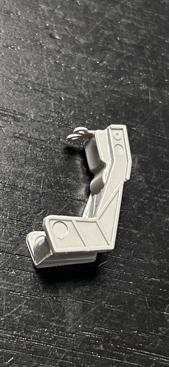

BastianD Posted January 26 Author Share Posted January 26 And the 2 ejection seat, where the resin from CMK is ready for primer. Quote Link to post Share on other sites

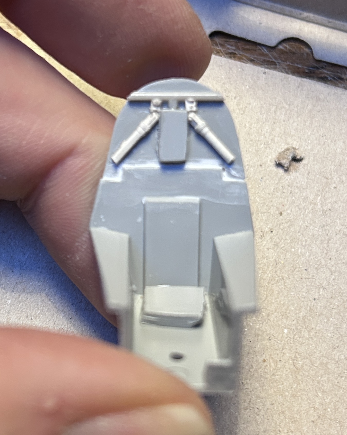

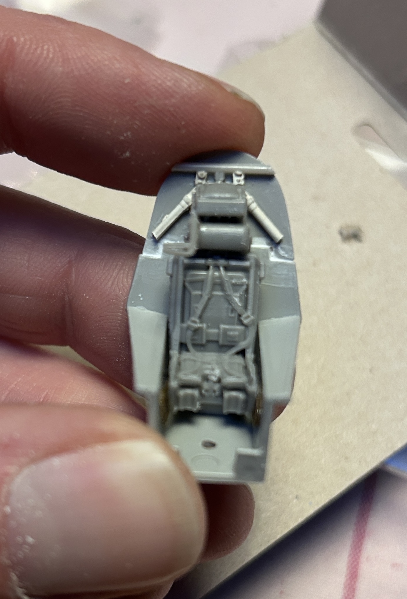

BastianD Posted February 1 Author Share Posted February 1 (edited) Working on the cockpit tub, and adding more details to the hood behind the ejection seat. It was flat, and some aftermarket resin sets showed far more detail. So I took my spare parts stash and looked for the right pieces to glue on. Also glued a plate in under the ejection seat, so it comes up to the right height in the cockpit. Edited February 1 by BastianD Quote Link to post Share on other sites
