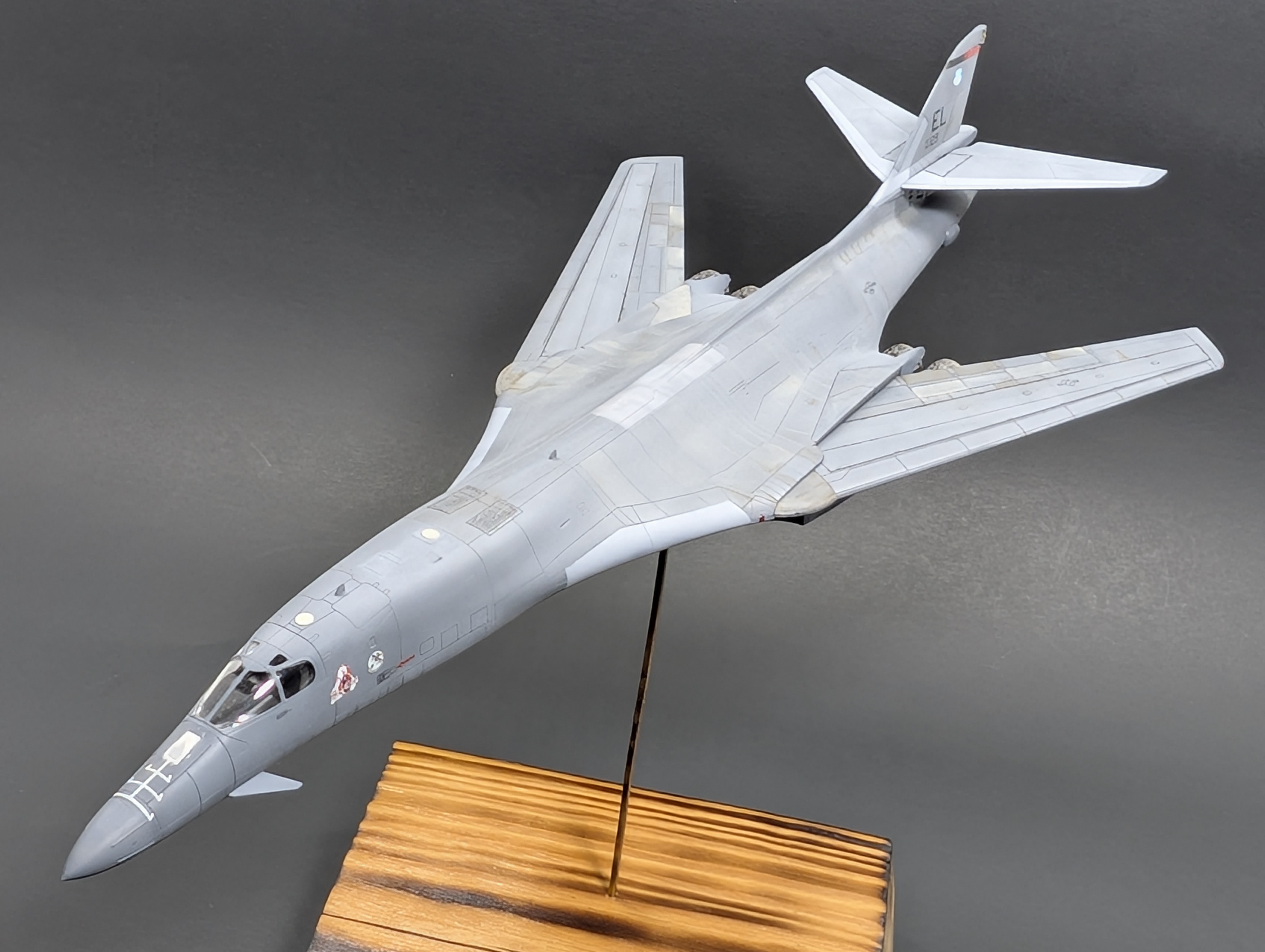

jbryan911 Posted February 26, 2025 Share Posted February 26, 2025 I used it for the first time on this Bone. Mr Surfacer 1500 black primer, and the Gunship gray thinned roughly 50/50 with Mr Leveling thinner. Sprayed on very smooth, and I was able to get a nice tight fine line as well. Quote Link to post Share on other sites
A-10 LOADER Posted February 26, 2025 Share Posted February 26, 2025 Good looking BONE, would like to see more of her in The Display Case. Steve Quote Link to post Share on other sites
