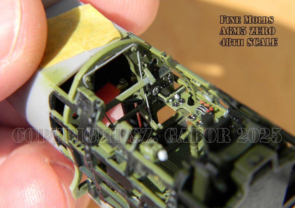

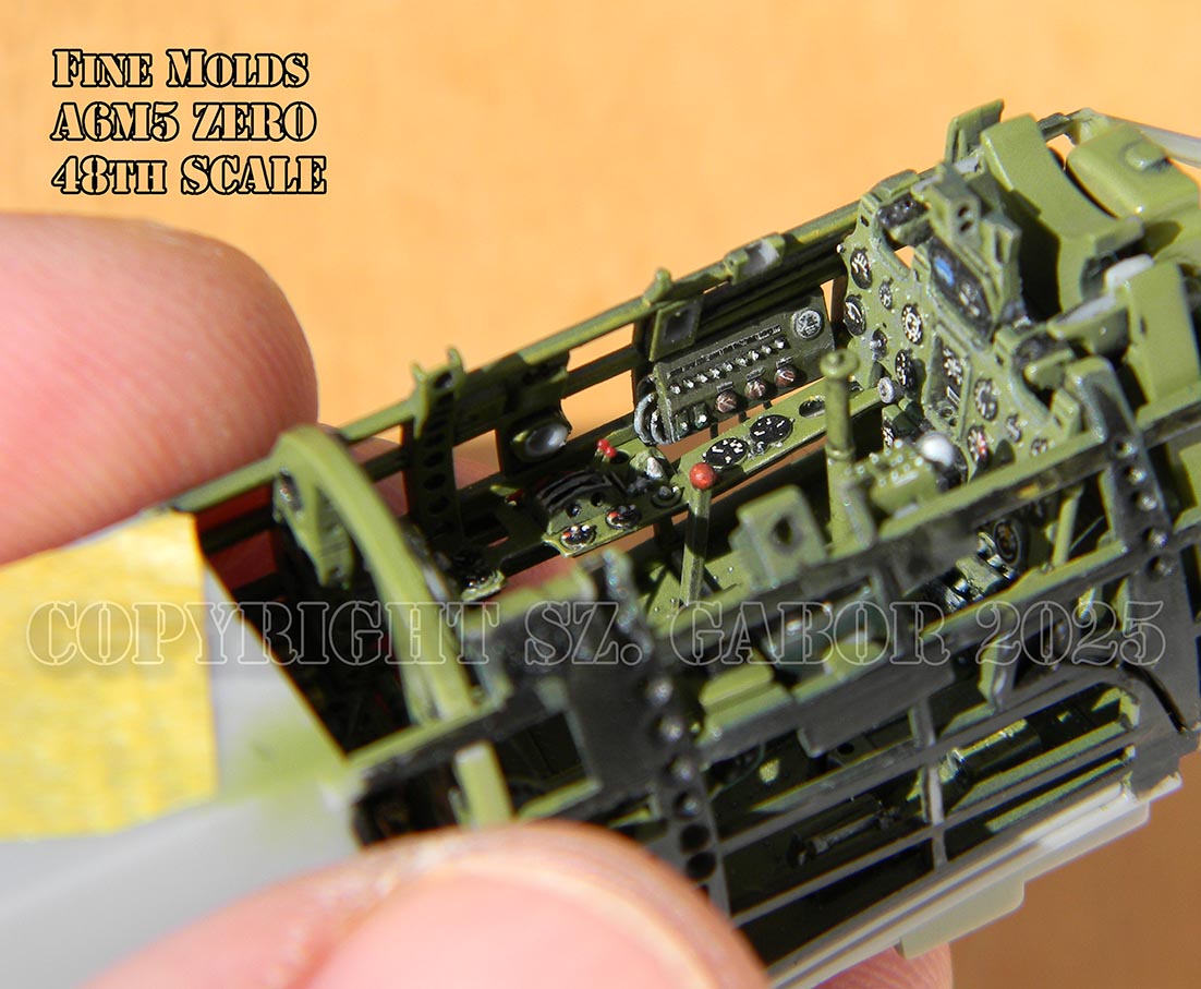

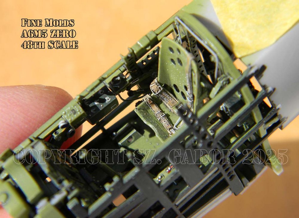

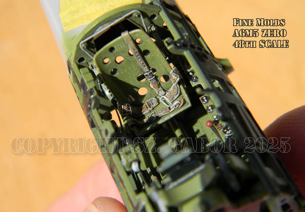

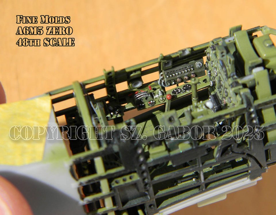

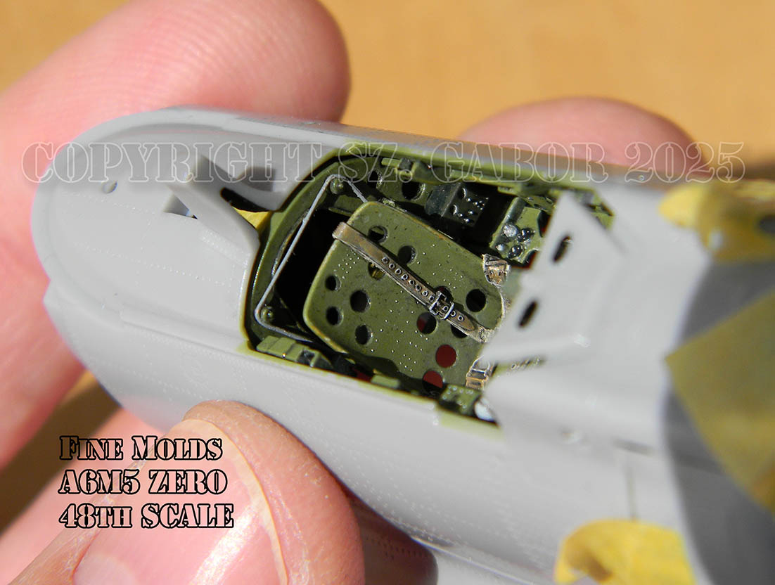

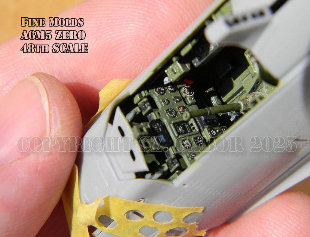

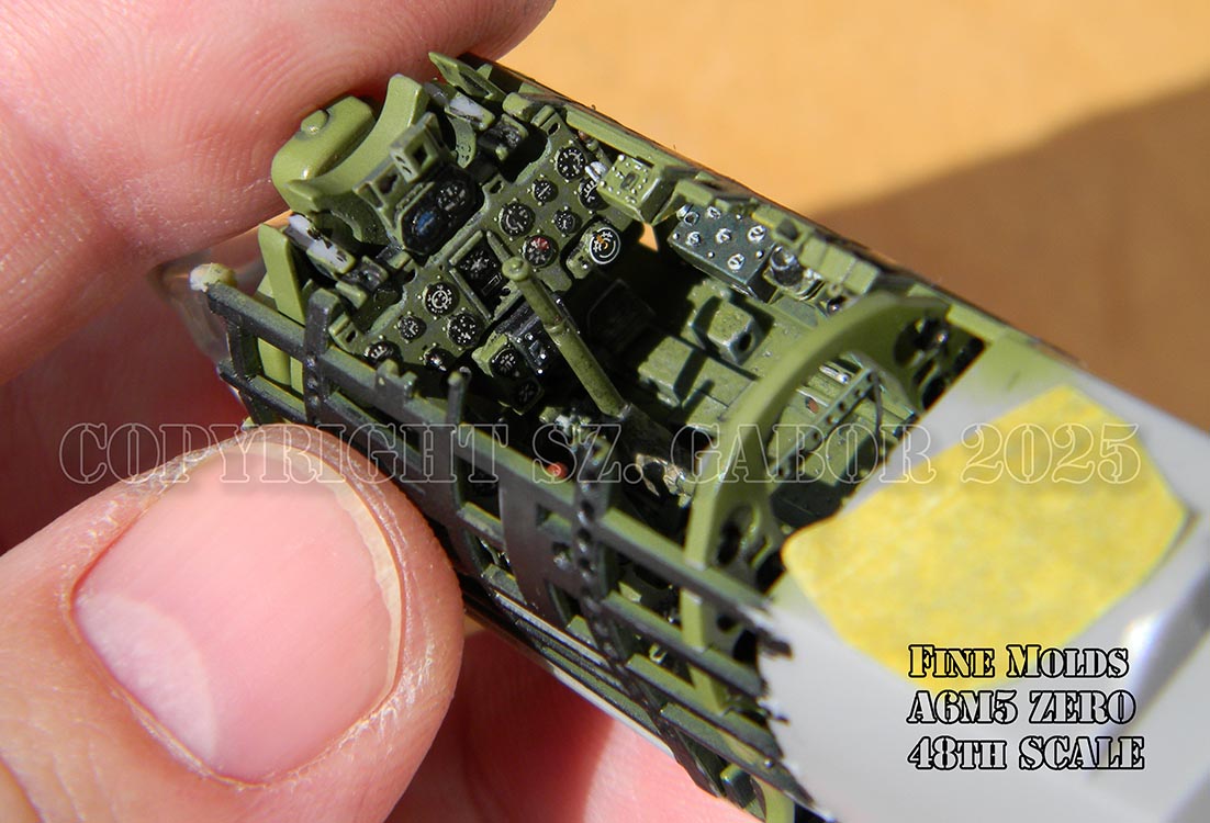

Had a little time, so here are some new pics of the cockpit in different stages of assembly. Most of it is still dry fit since there are a lot of bits and pieces missing at the moment that I want to put in there.
If I can find a way to transport it in safety then will take it with me to this weekend “start of the year” model show.
Best regards
Gabor

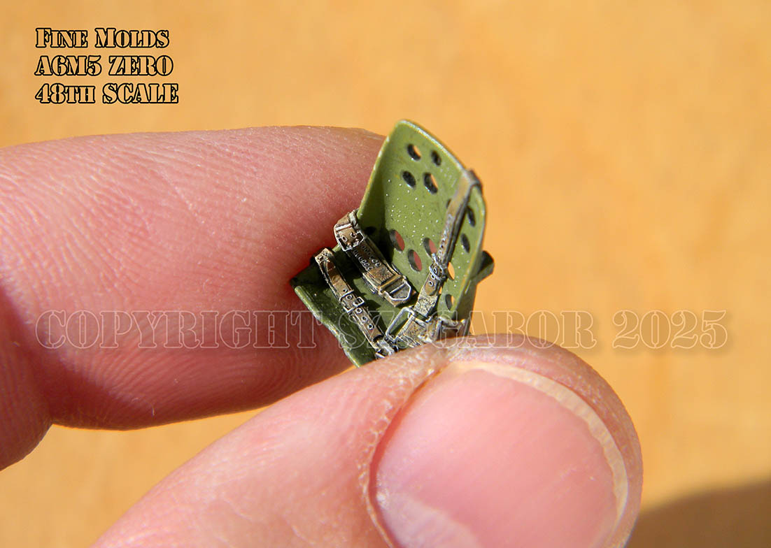

On the Czech forum there were questions raised about the Zero seat shown above and the straps on it. My answer could be of interest here also.
Here it is.
The seat is from the kit. All I did was to add some detail to it with the holes in the sides, some support plates and at the end a bit of Mr. Pain colours. That is all.
The seat belts are from Fine Molds Nano set NC2. They are injection moulded plastic parts, but EXTREMELY thin! Since they are plastic, a softer type of plastic, it is possible to bend them to shape. Not easy, but possible. The trick is to bend them to the shape you will want them to be on the seat, check it against the seat, bend it again, check again, bend it again, check again. . .  Only after it is considered to be as good as you can get it should they be painted.
I am sure there are other ways to do it, but this is how I did my examples.
In the NC2 sets box you get four sprues, each sprue with the 4 different straps of one seat, so it is basically contains seat straps for four seats. If something goes wrong during bending you will still have three more sets to work with.  : )  : )    No body is perfect and accident do happen! : )   : )   : )
The trick in bending them is to try to bend around a round support and NOT at a sharp angle. Since it is injection moulded plastic you can get it broken just as with any other plastic. But if the bending is carried out in stages then you can get a very nice and natural looking result!
As “some” people say: we are modellers so we should be able to do it.  : )  : )
All is left to do is to paint them.
Best regards
Gabor

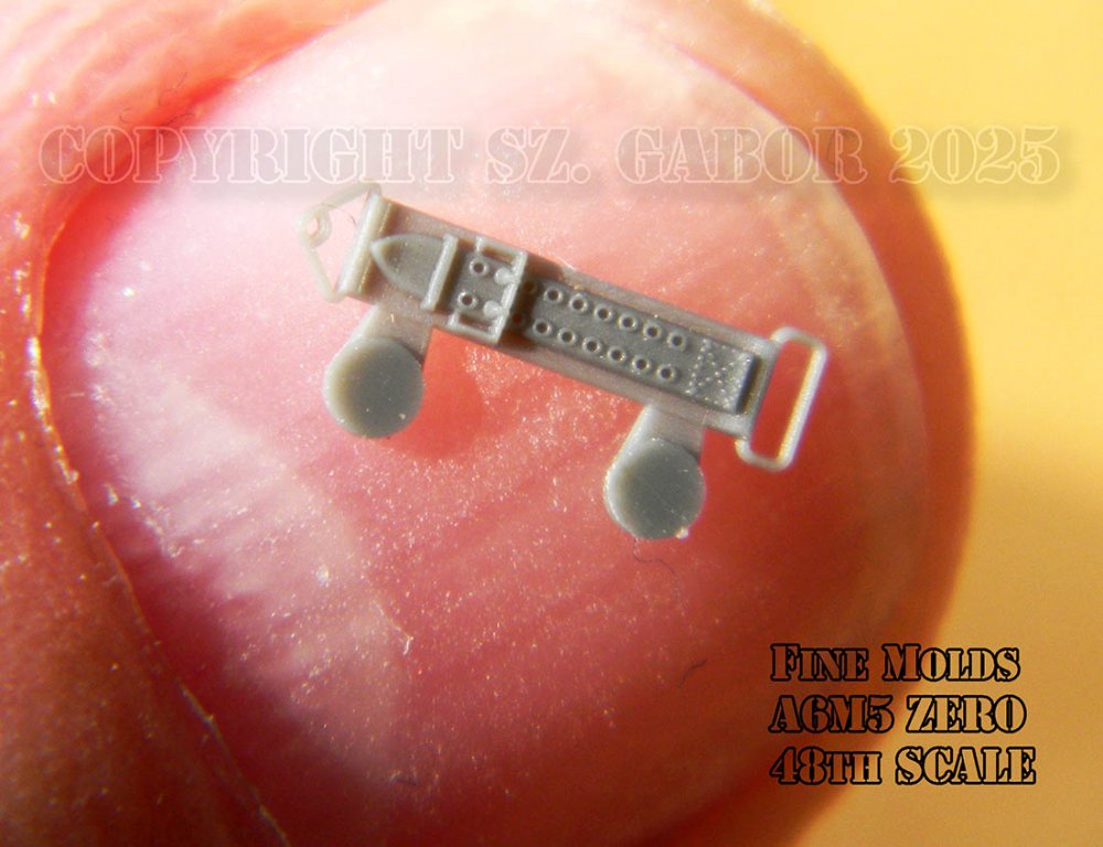

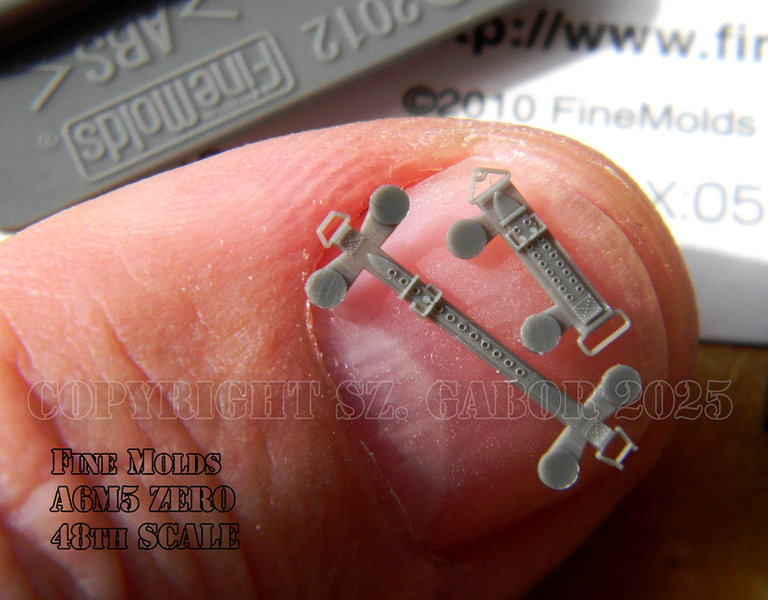

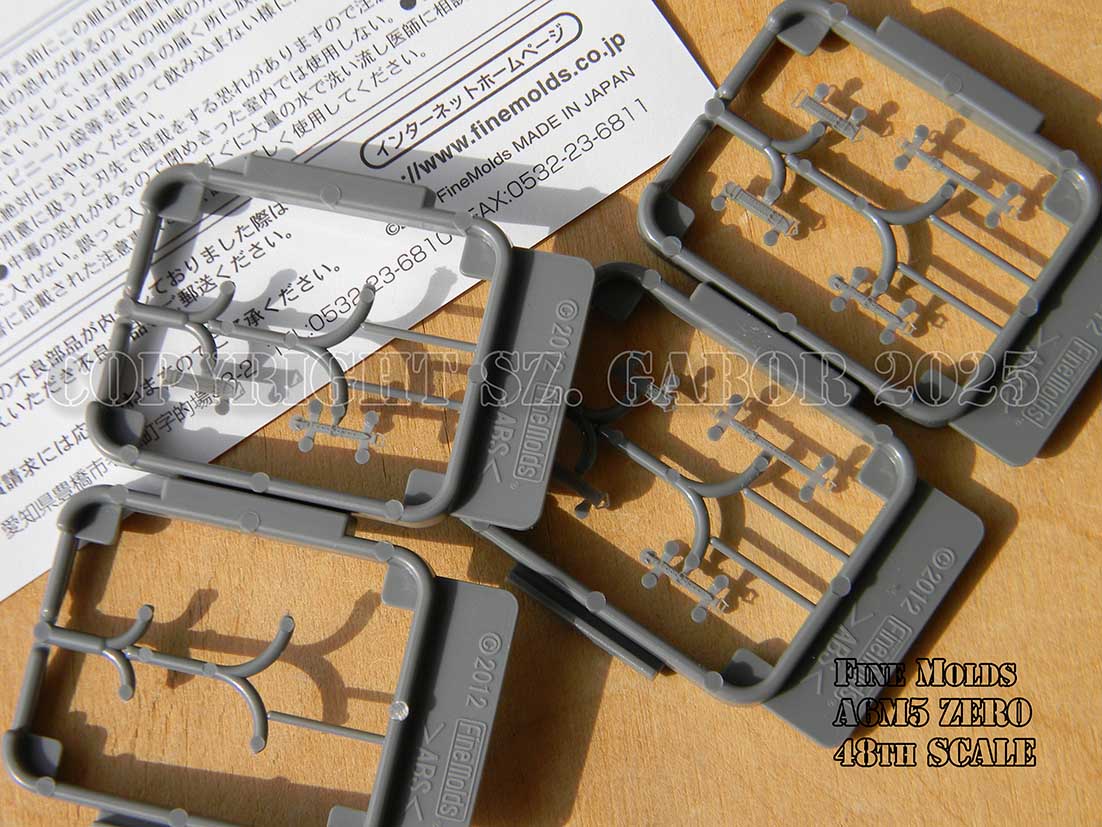

Here are some close-ups (going step by step closer) of the Fine Molds Nano NC02 set I took this morning to illustrate just how small and how detailed the straps, the fittings on them. The straps overlay each other, the buckles are three dimensional and not just a flat image and there you can see those nice stiches.
As said before the straps parts are extremely small so special care should be taken when working with them!!!!!!  I actually use a big black cardboard as a work surface so that even if the parts “fly off” in direction of the carpet monster I can find them. They are very thin and the soft plastic could act as a spring when handled. So take care, but Fine Molds provides 3 spear sets of straps which helps if disaster strikes!  : )  : )   : )
Best regards
Gabor
