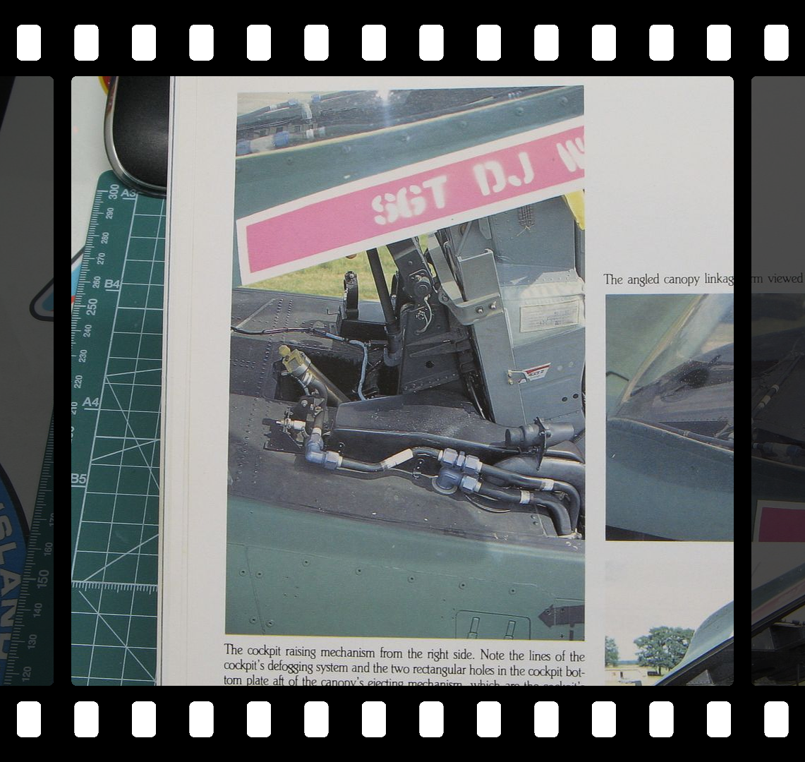

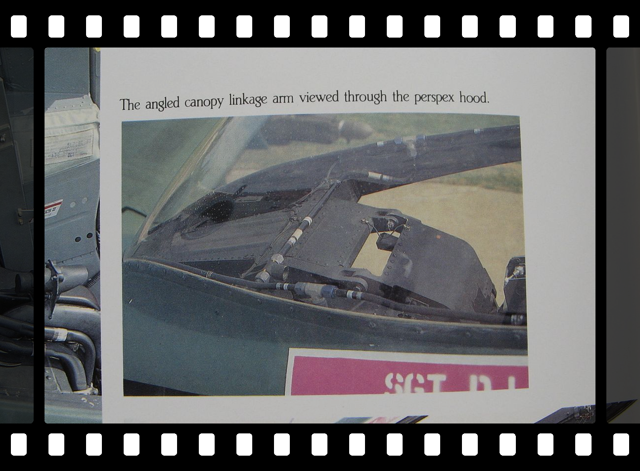

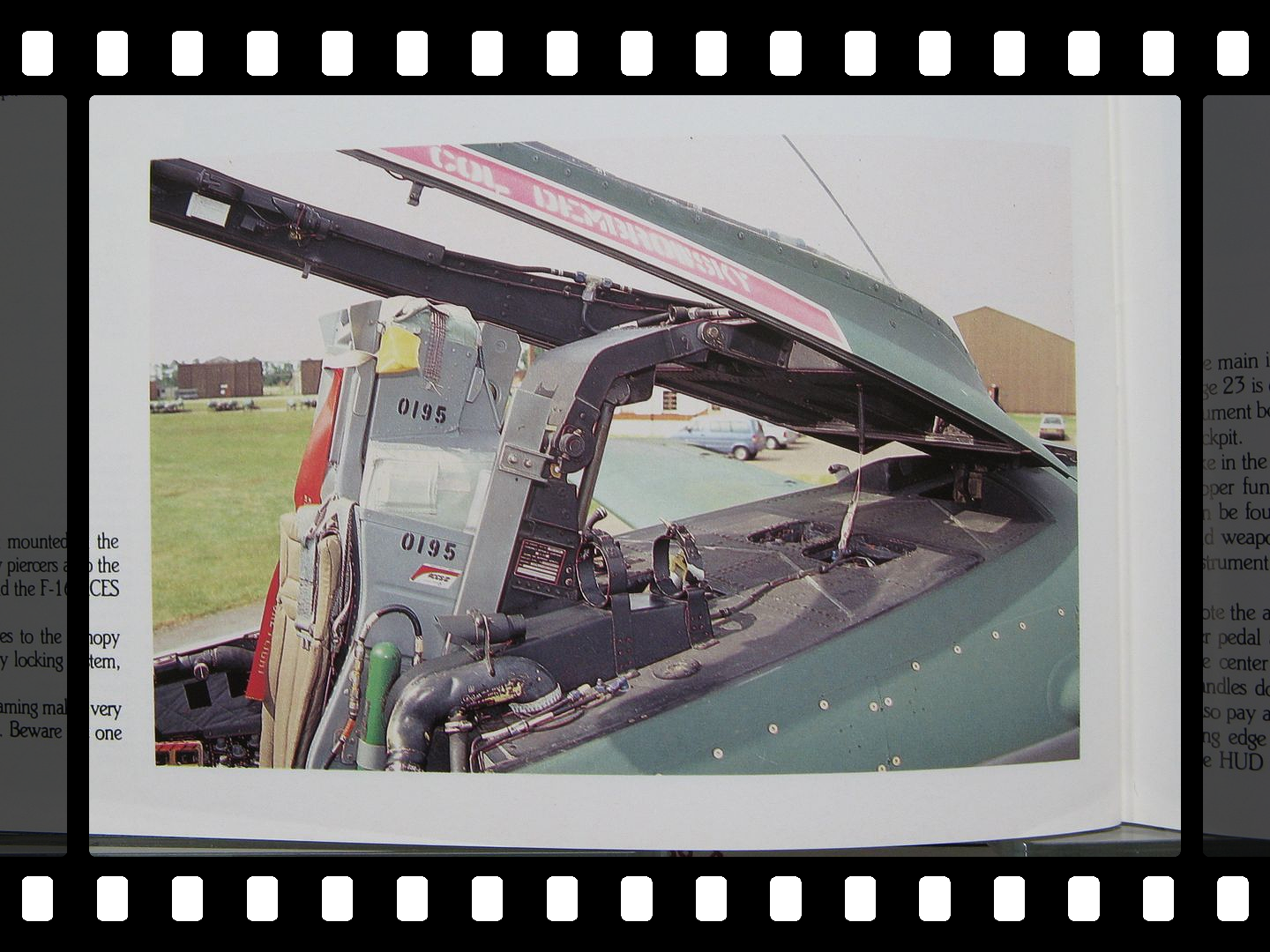

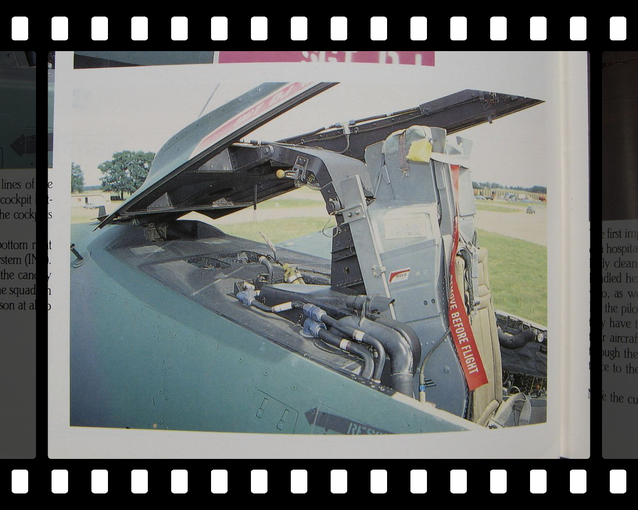

A-10 LOADER Posted January 28, 2025 Share Posted January 28, 2025 Jake's book has tons of pics but, he doesn't want them floating around the internet without his permission. Here are some pics from my Verlinden Lock-on book, hope they help. Steve Quote Link to post Share on other sites
Lasinaatti Posted January 28, 2025 Author Share Posted January 28, 2025 4 hours ago, A-10 LOADER said: he doesn't want them floating around the internet without his permission. That's understandable! I'll definitely have to look into getting that. These photos are exactly what I was looking for though! Quote Link to post Share on other sites
