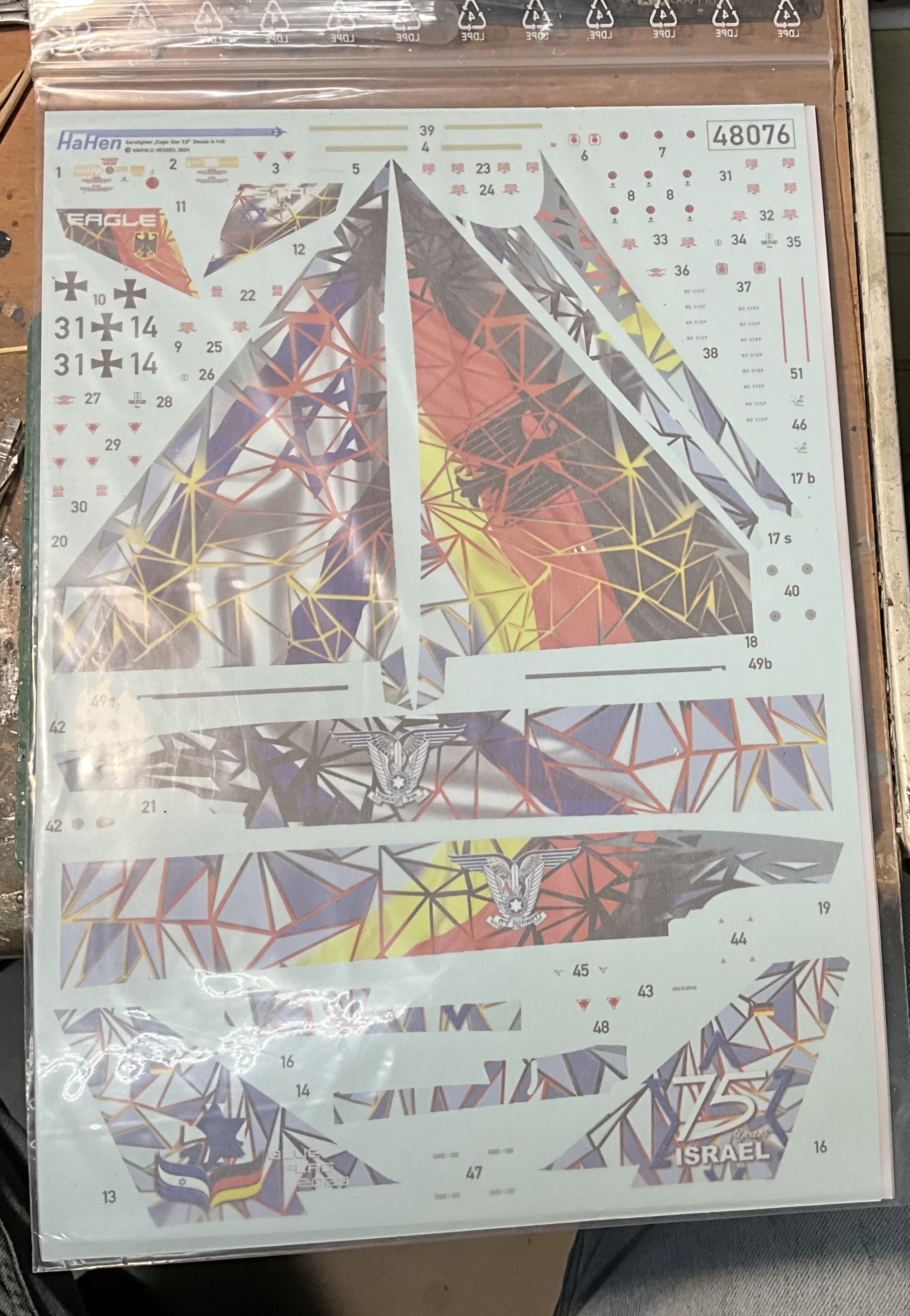

lavony Posted January 29, 2025 Share Posted January 29, 2025 (edited) Hello starting a new and challenging project, 1/48 Eurofighter Typhoon in the Eagle Star 2.0 scheme. this scheme was painted especially for the Blue Flag exercise that was held in Israel, celebrating 75 years . the kit is Revell and the decals are by HaHen from Germany. yossi Edited January 29, 2025 by lavony Quote Link to post Share on other sites

lgl007 Posted January 30, 2025 Share Posted January 30, 2025 WOW... looking forward to following this one 🙂 Who makes the decals? -Greg Quote Link to post Share on other sites
lavony Posted January 30, 2025 Author Share Posted January 30, 2025 1 hour ago, lgl007 said: WOW... looking forward to following this one 🙂 Who makes the decals? -Greg Hi The decals are made by HaHen , from germany . https://www.hahen.com/Eurofighter-Eagle-Star-20/en Quote Link to post Share on other sites

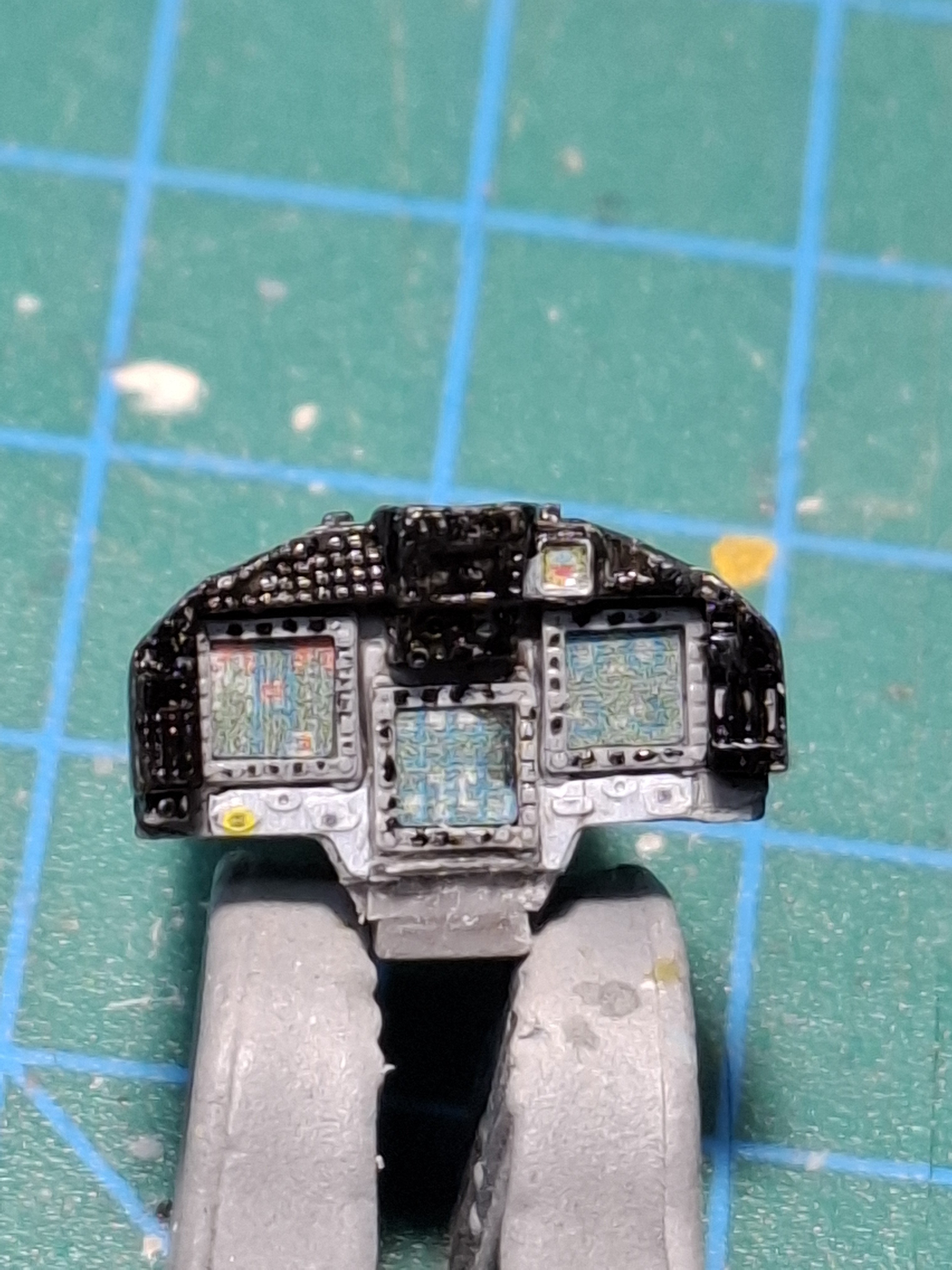

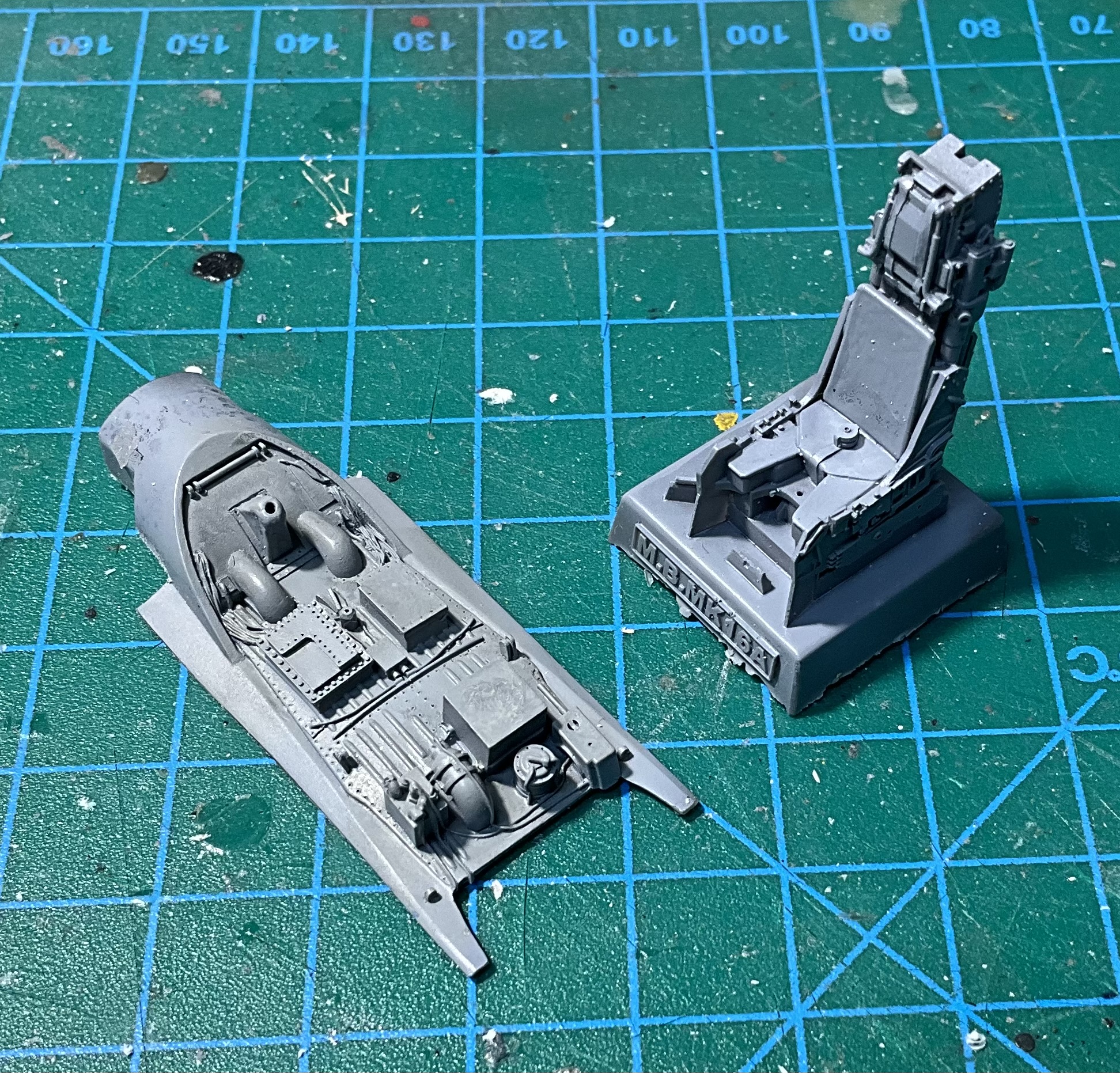

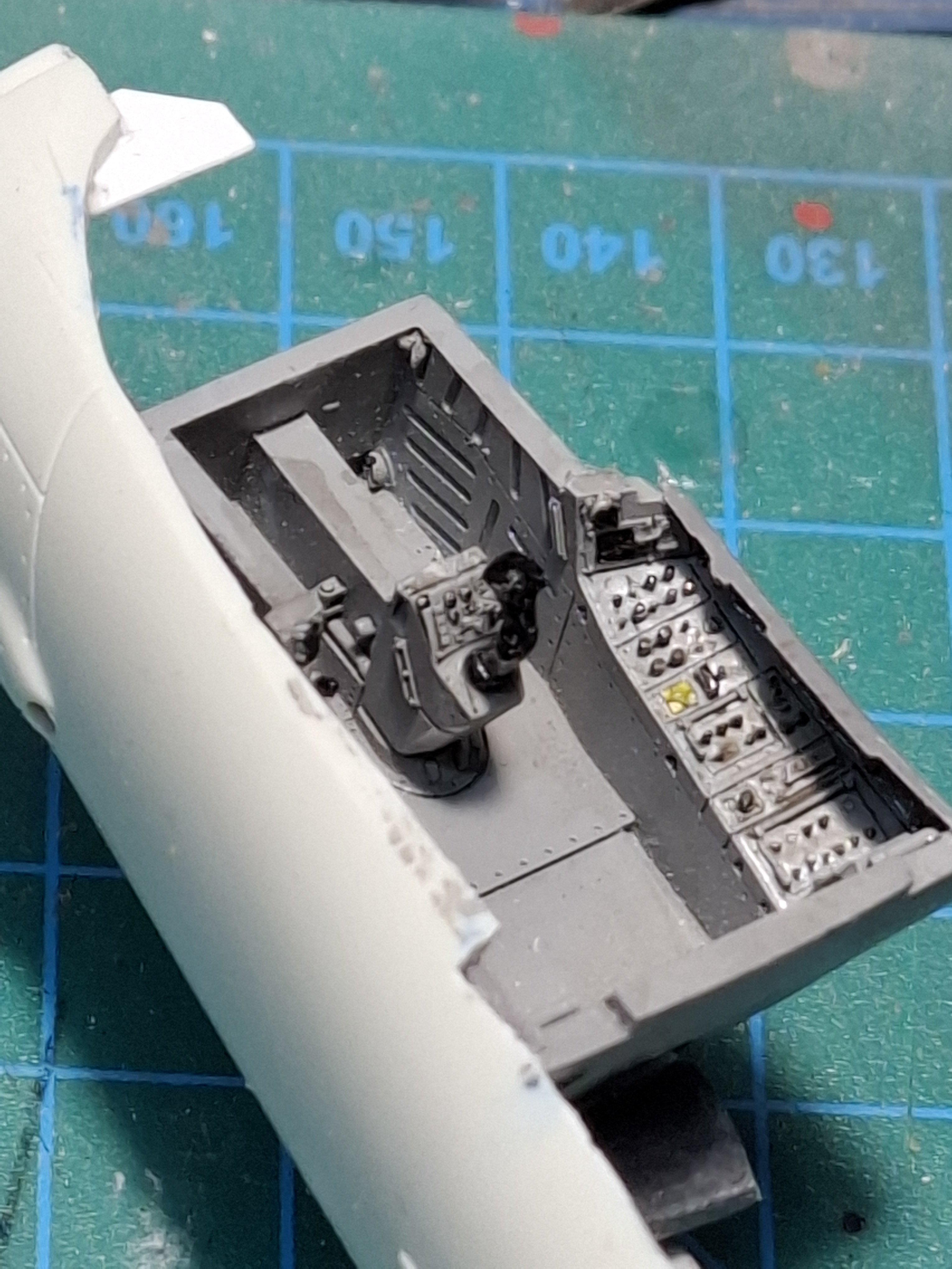

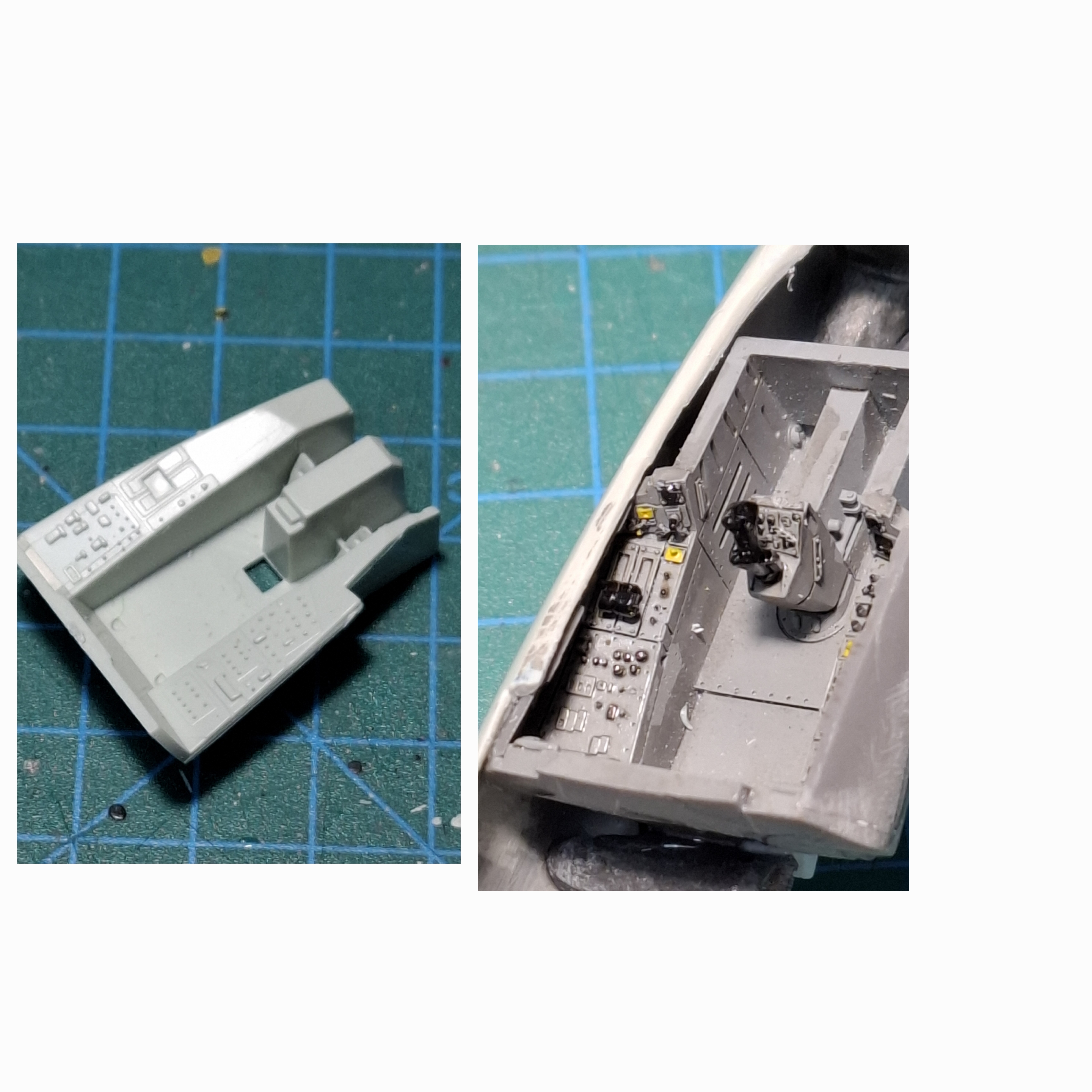

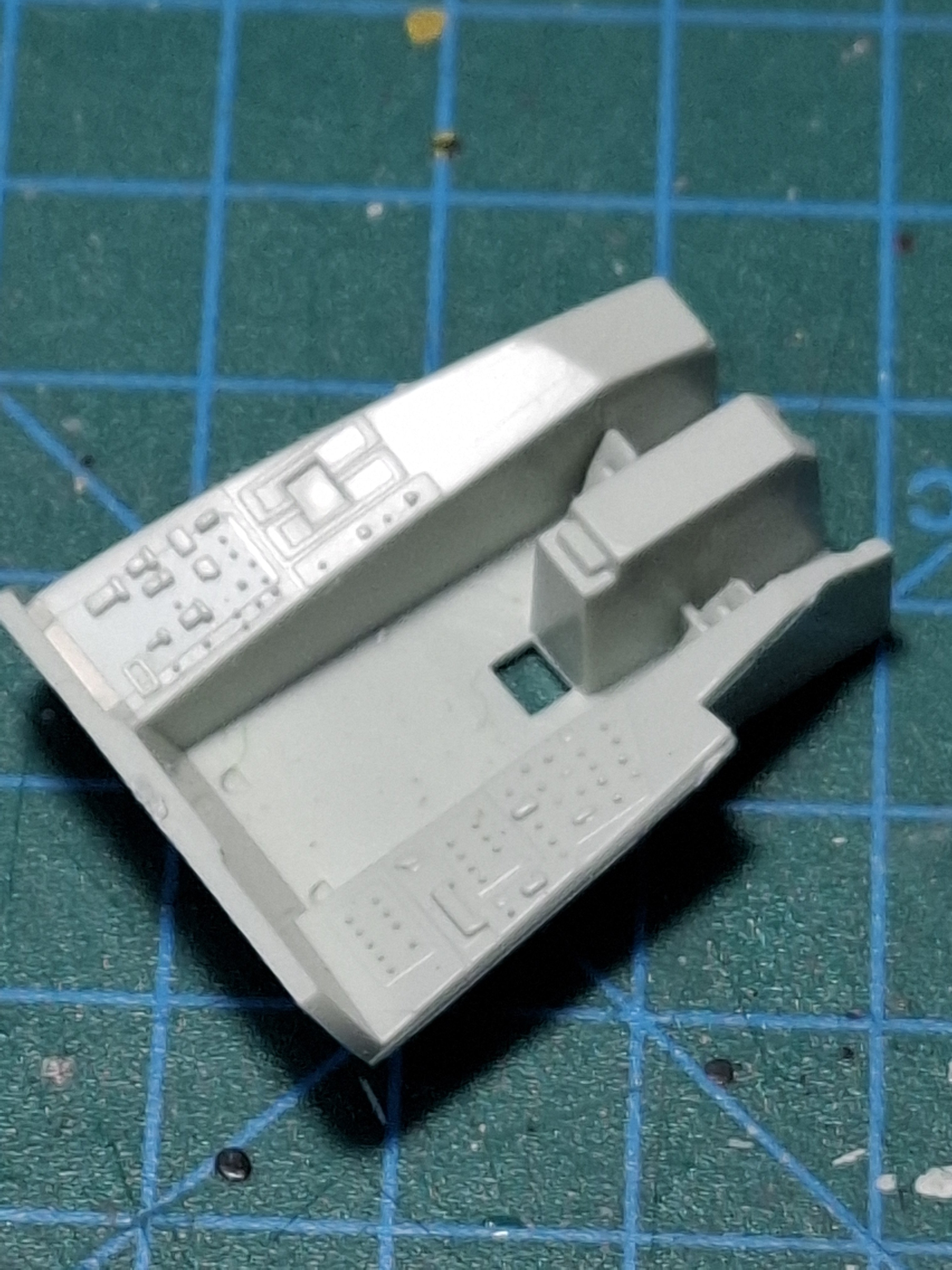

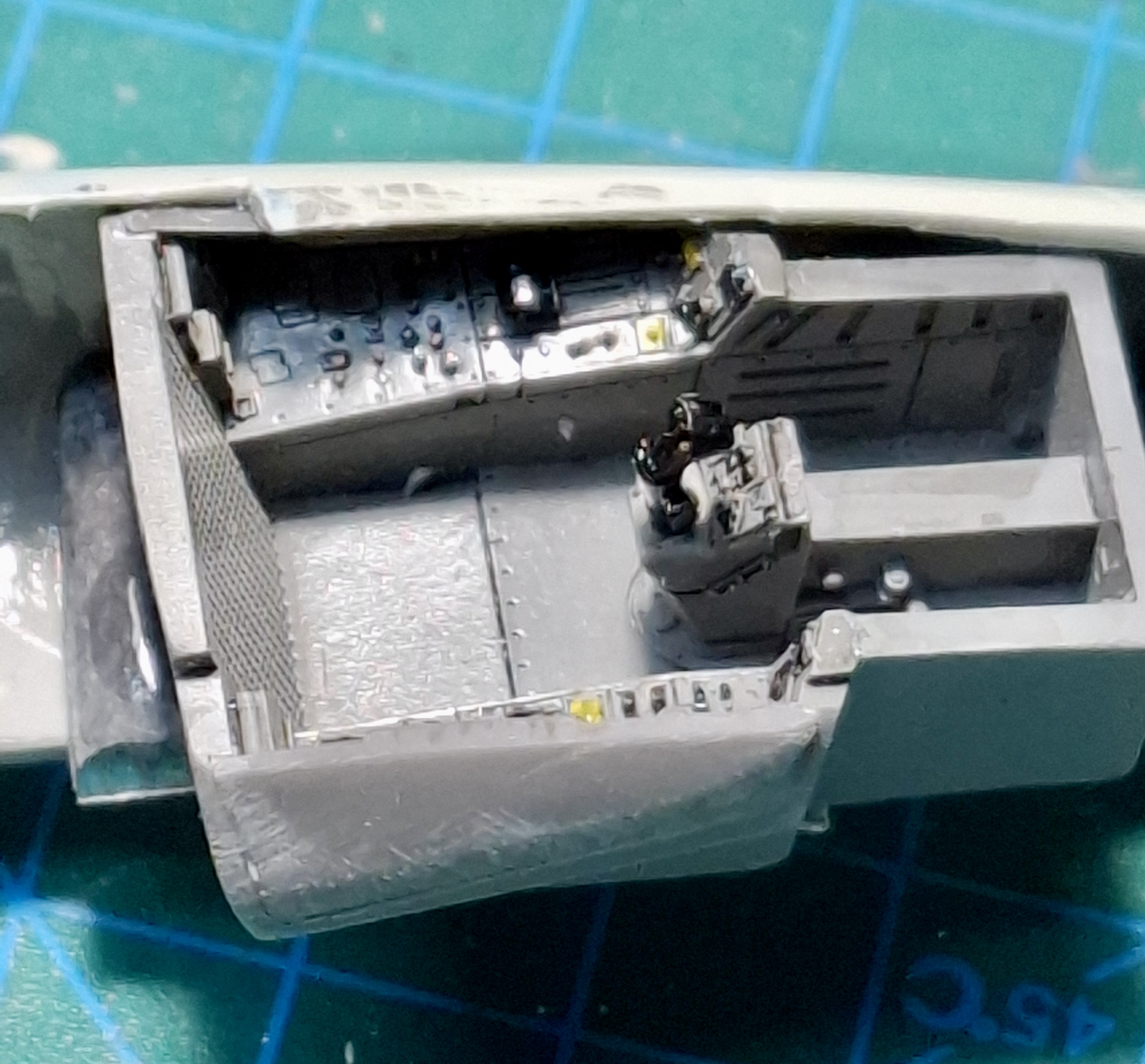

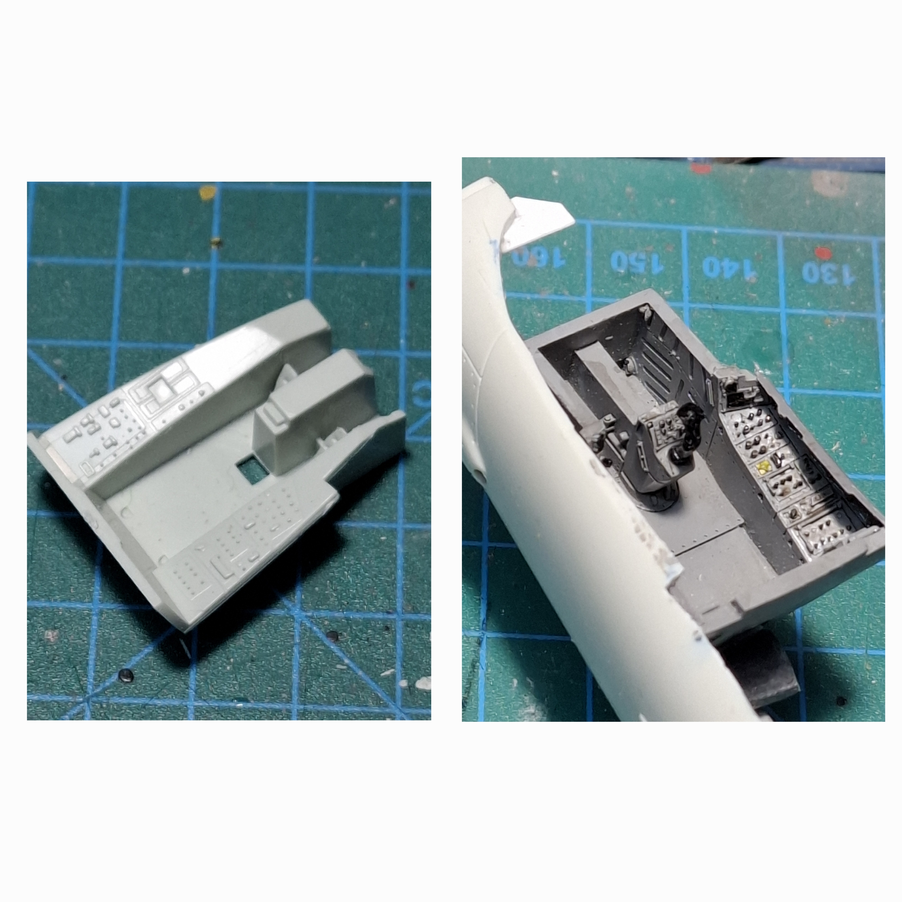

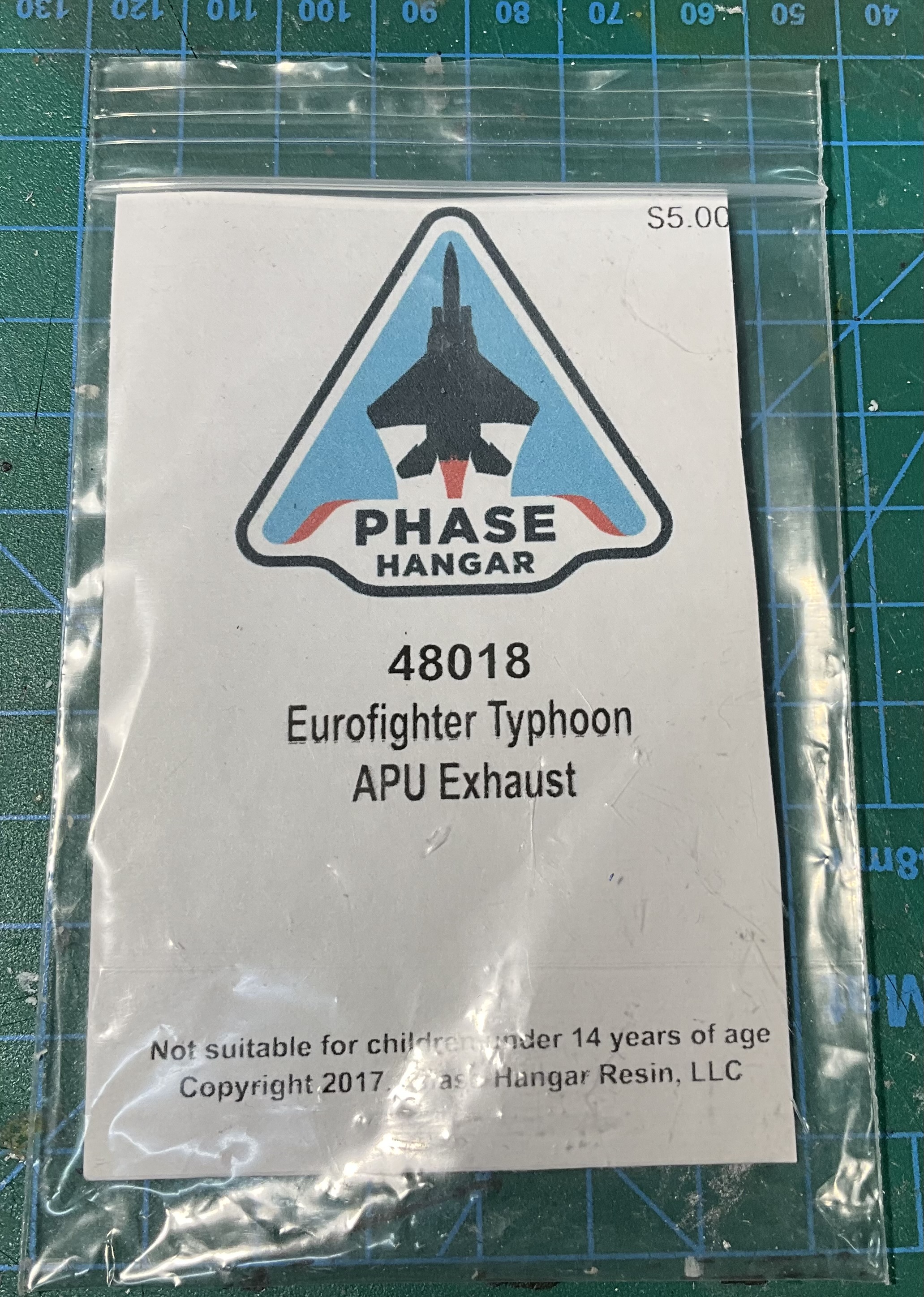

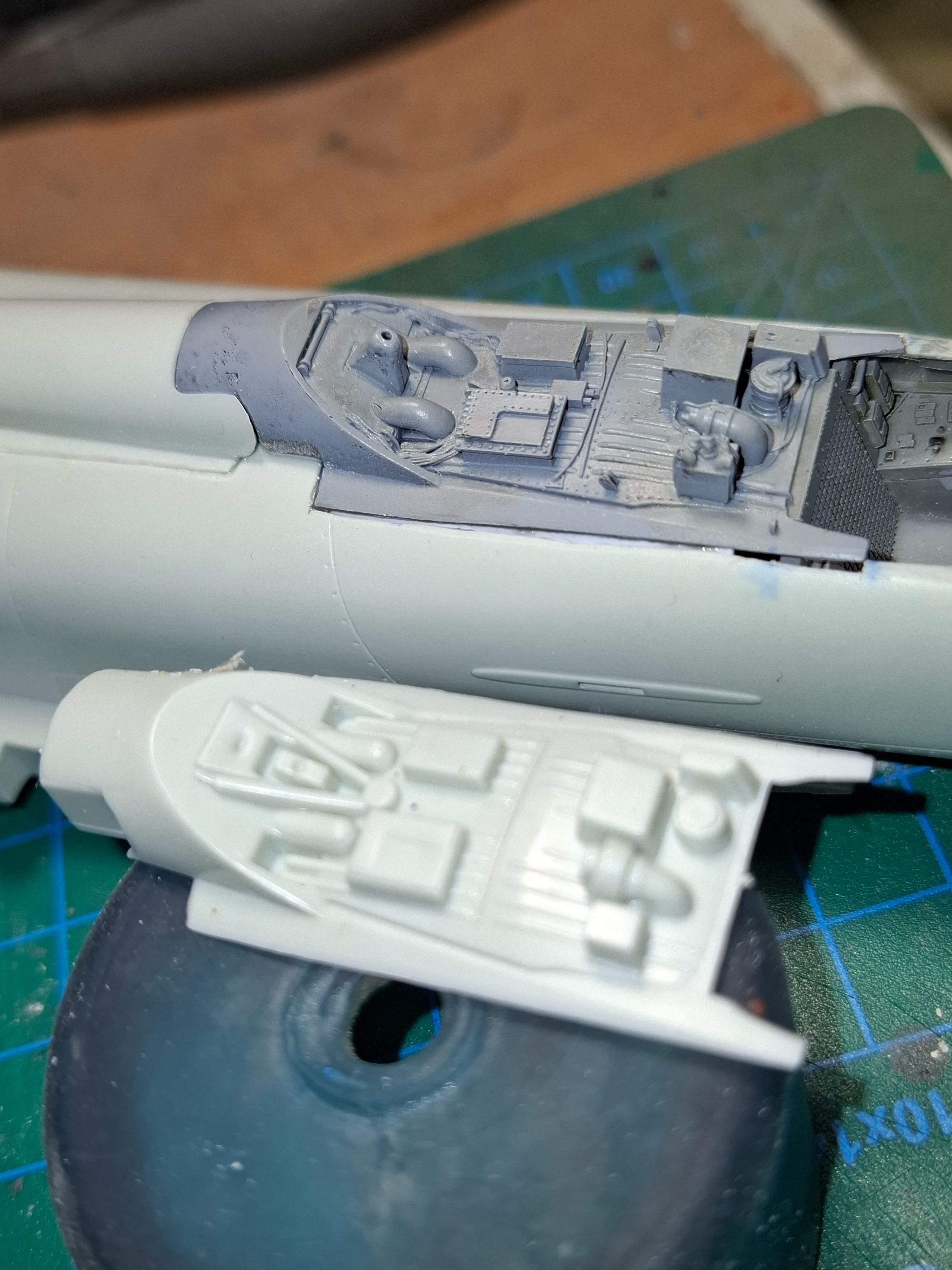

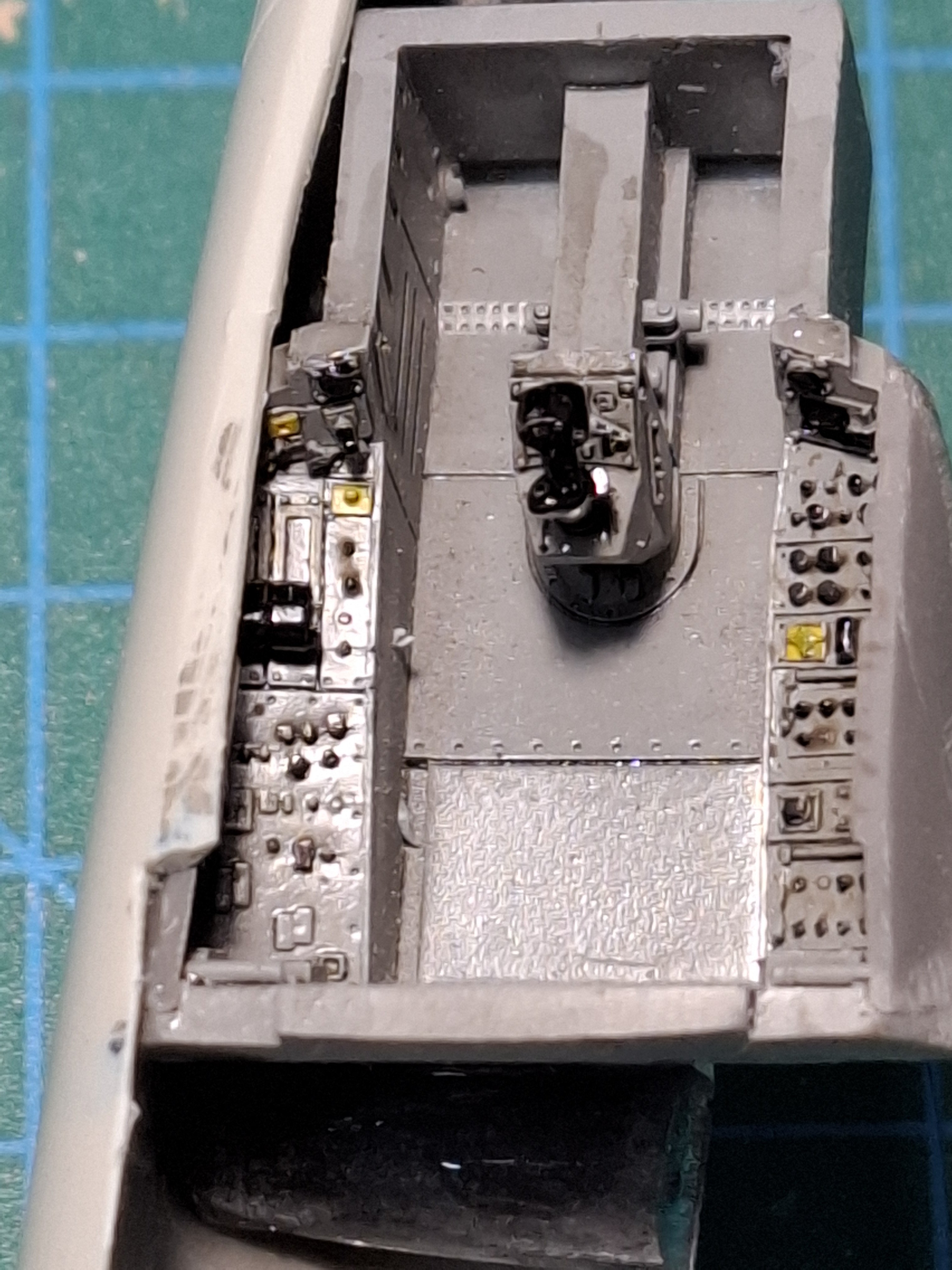

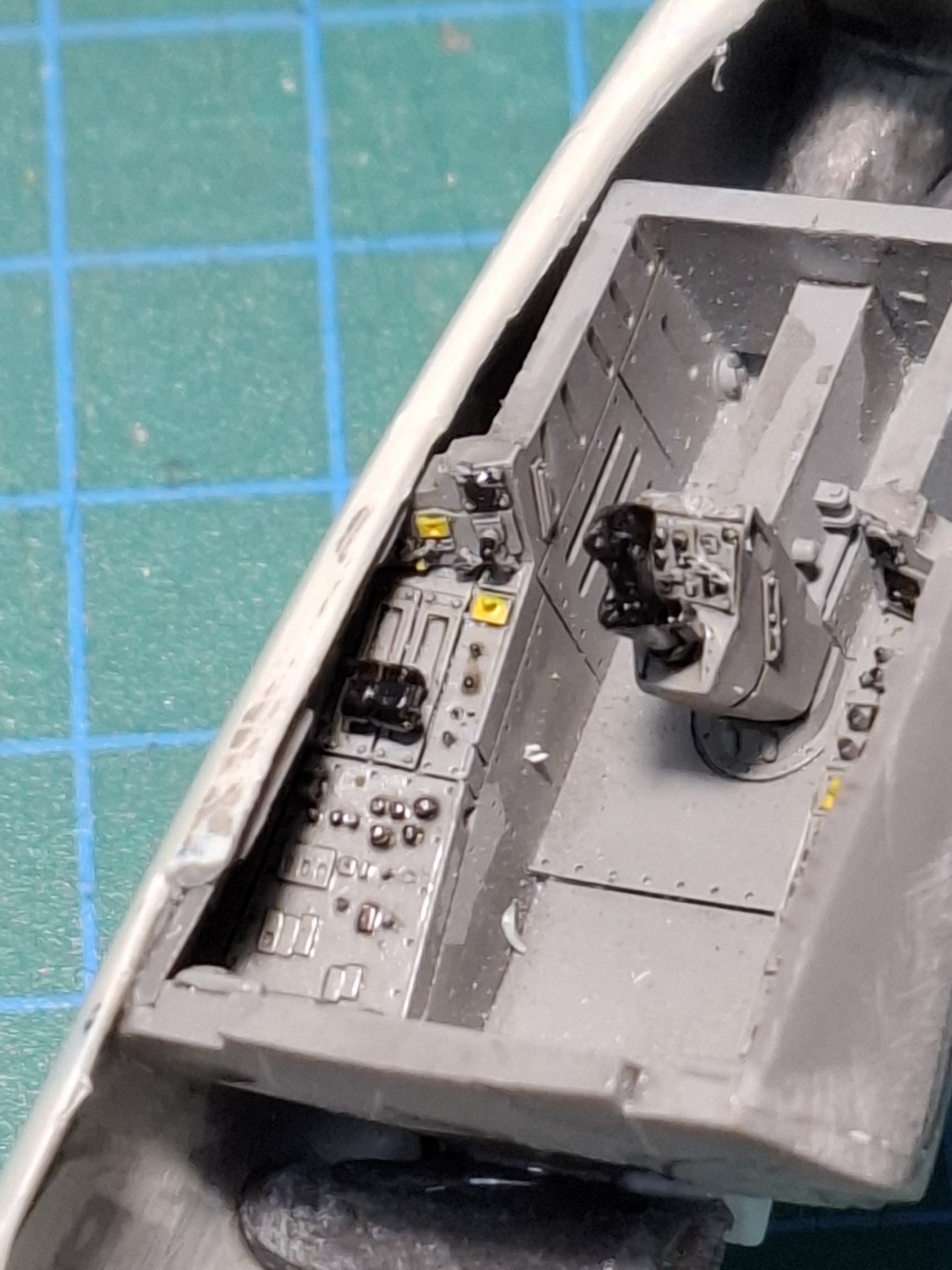

lavony Posted January 31, 2025 Author Share Posted January 31, 2025 Getting started… after reading some reviews about the kit, I decided to add aftermarket to the cockpit & APU. For the cockpit I’m using the AIRES 4917 set, and for the APU it’s the flight path set. also attached is the decals sheet. the cockpit is great, but the fitting to the kit needed a gentle cutting. I’ve painted it light gray , the switches were painted black and then I did a black wash . the APU section fits great without any major issues. also attached are photos to compare the kit’s cockpit Vs the Aires. to be continued… Quote Link to post Share on other sites

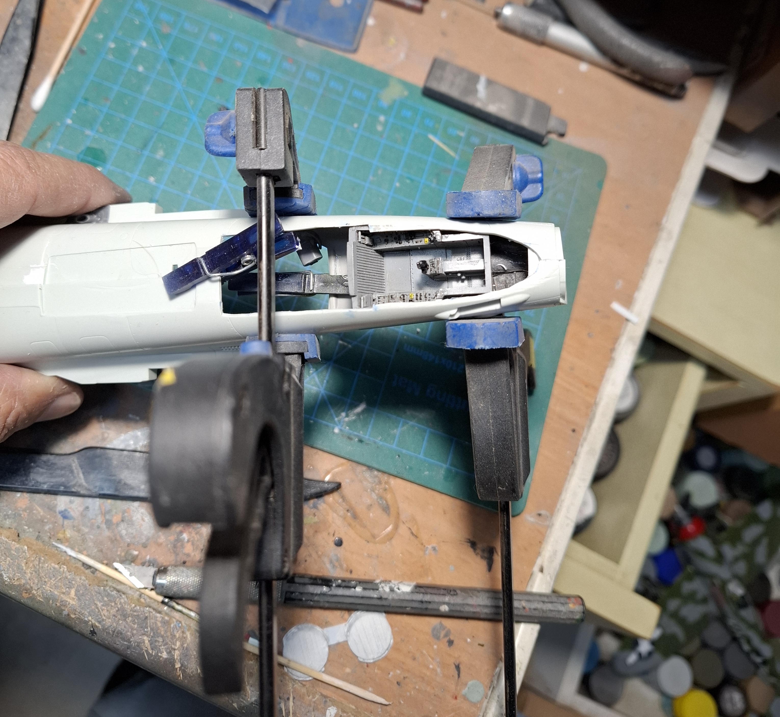

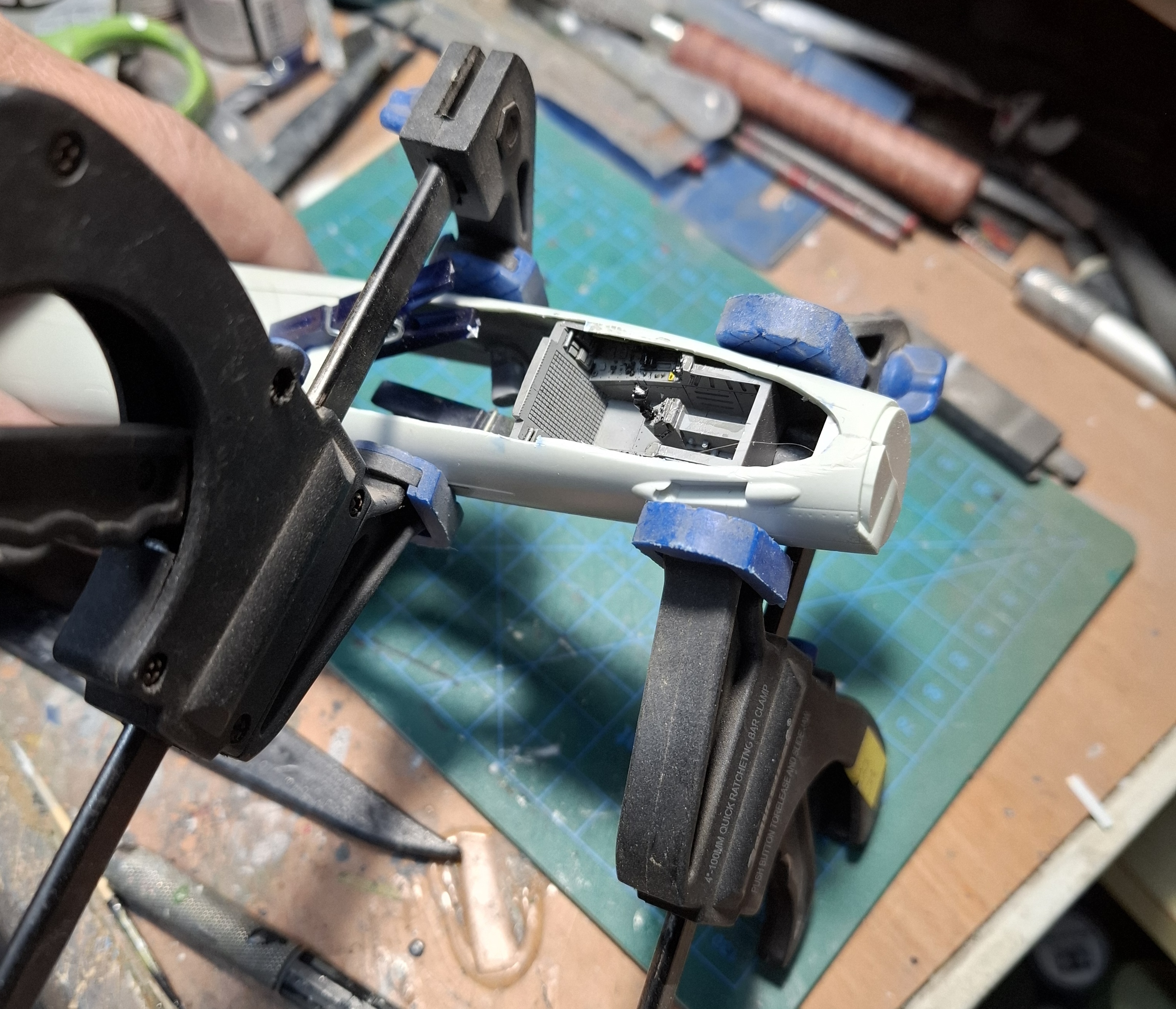

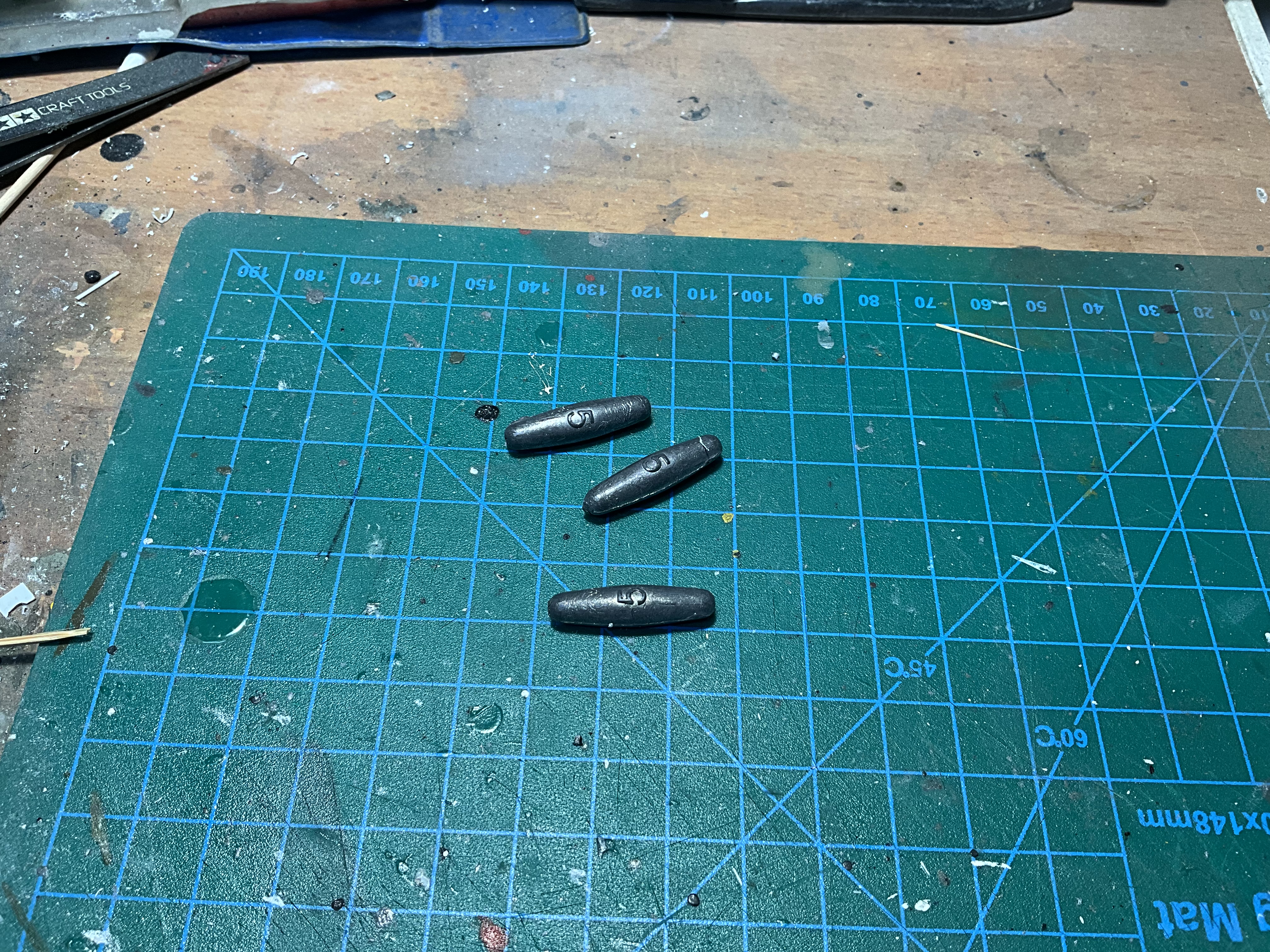

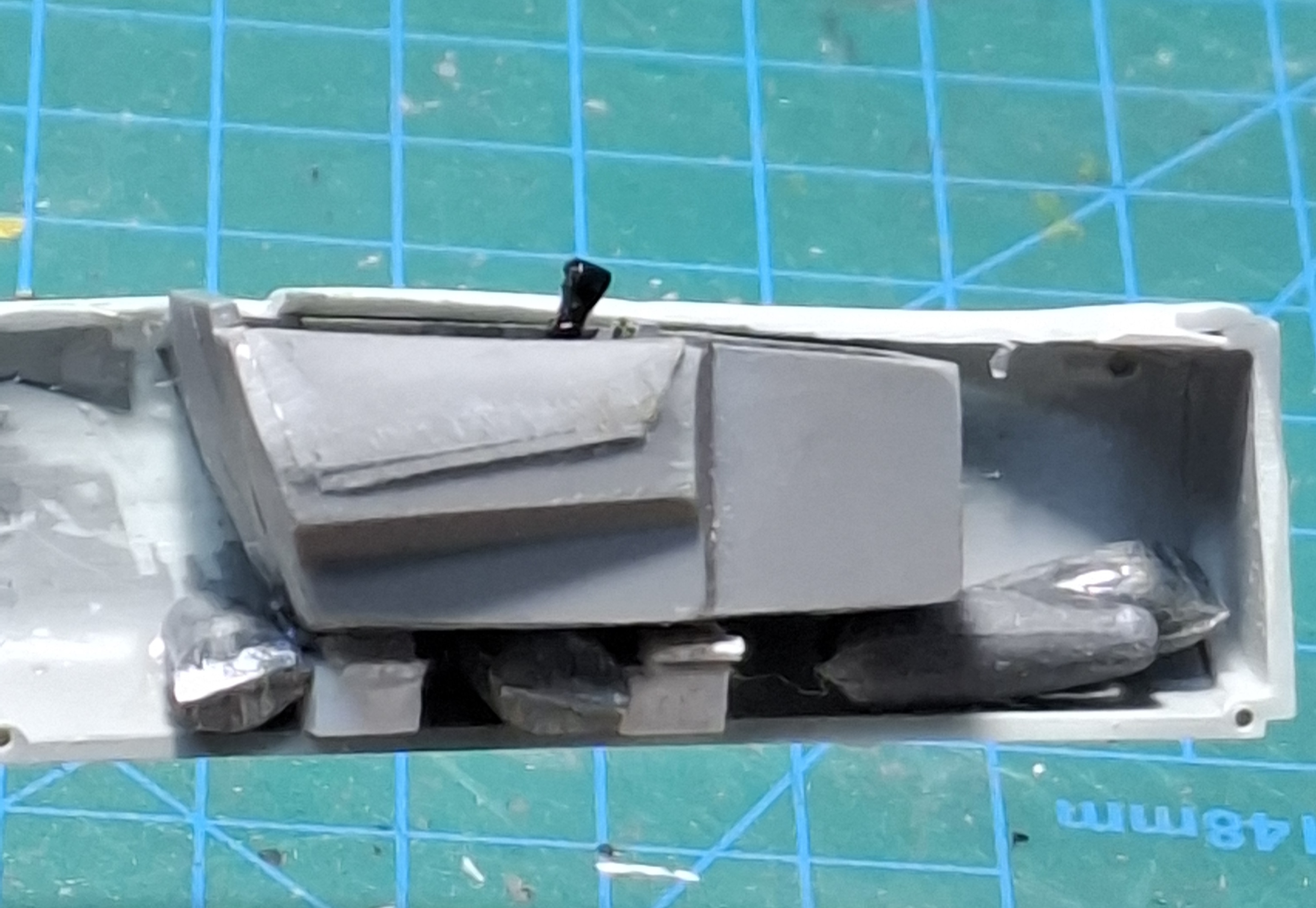

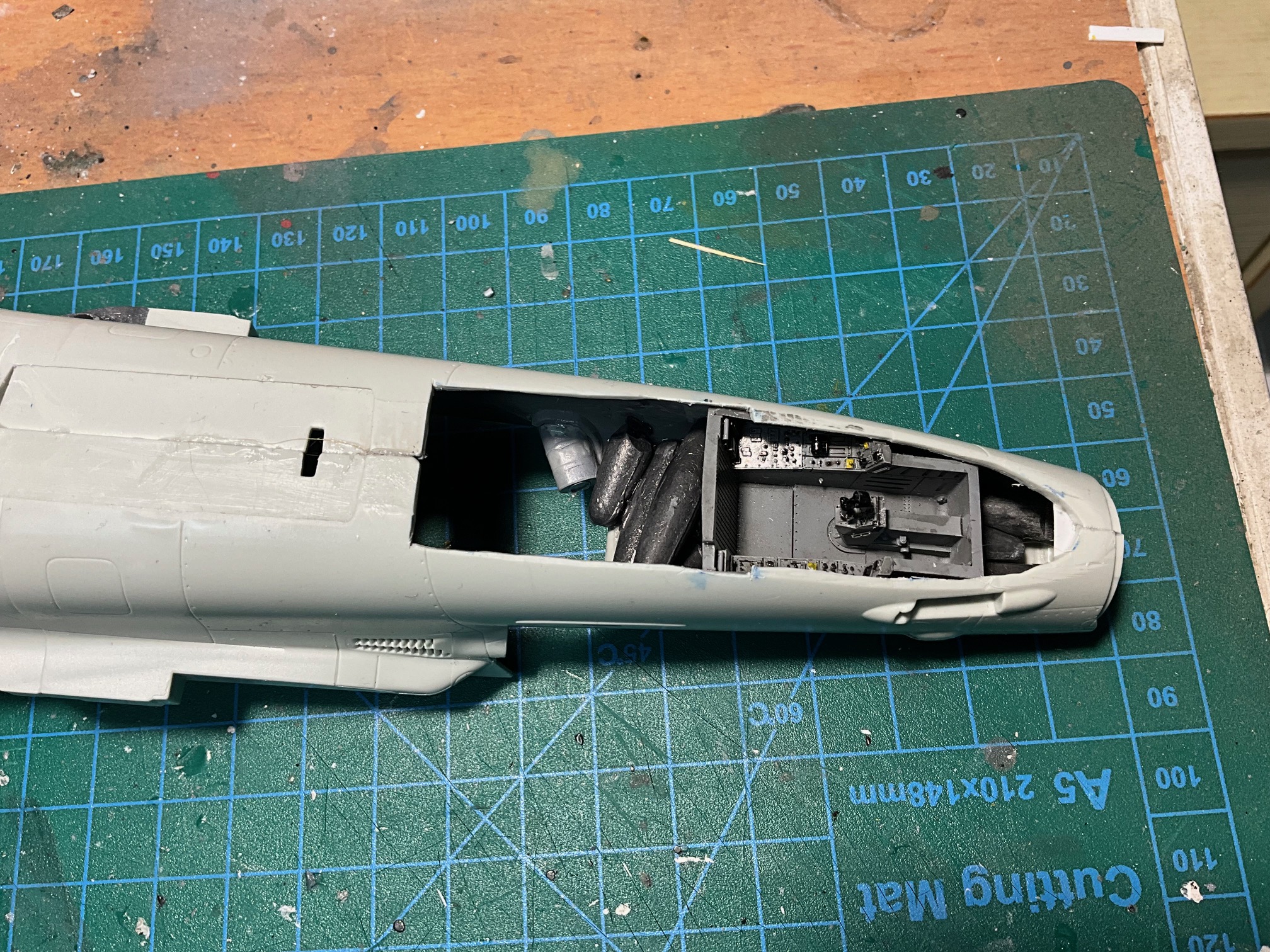

lavony Posted February 1, 2025 Author Share Posted February 1, 2025 (edited) Work continues… for fitting the cockpit tab , some plastic removal is needed around the cockpit. the cockpit was glued to the fuselage, adding some plastic support at the bottom, to help holding it in place. the instructions call for 30 grams of, in order to prevent it from sitting on his tail, so I’ve used 6 * 5 grams fishing weights and glued them around the cockpit. than it was time to glue the fuselage and it’s getting a shape 😀 Edited February 1, 2025 by lavony Quote Link to post Share on other sites

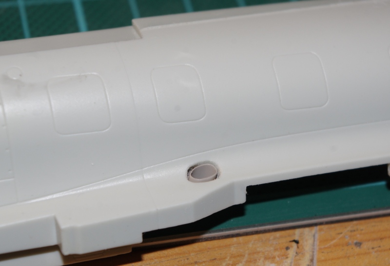

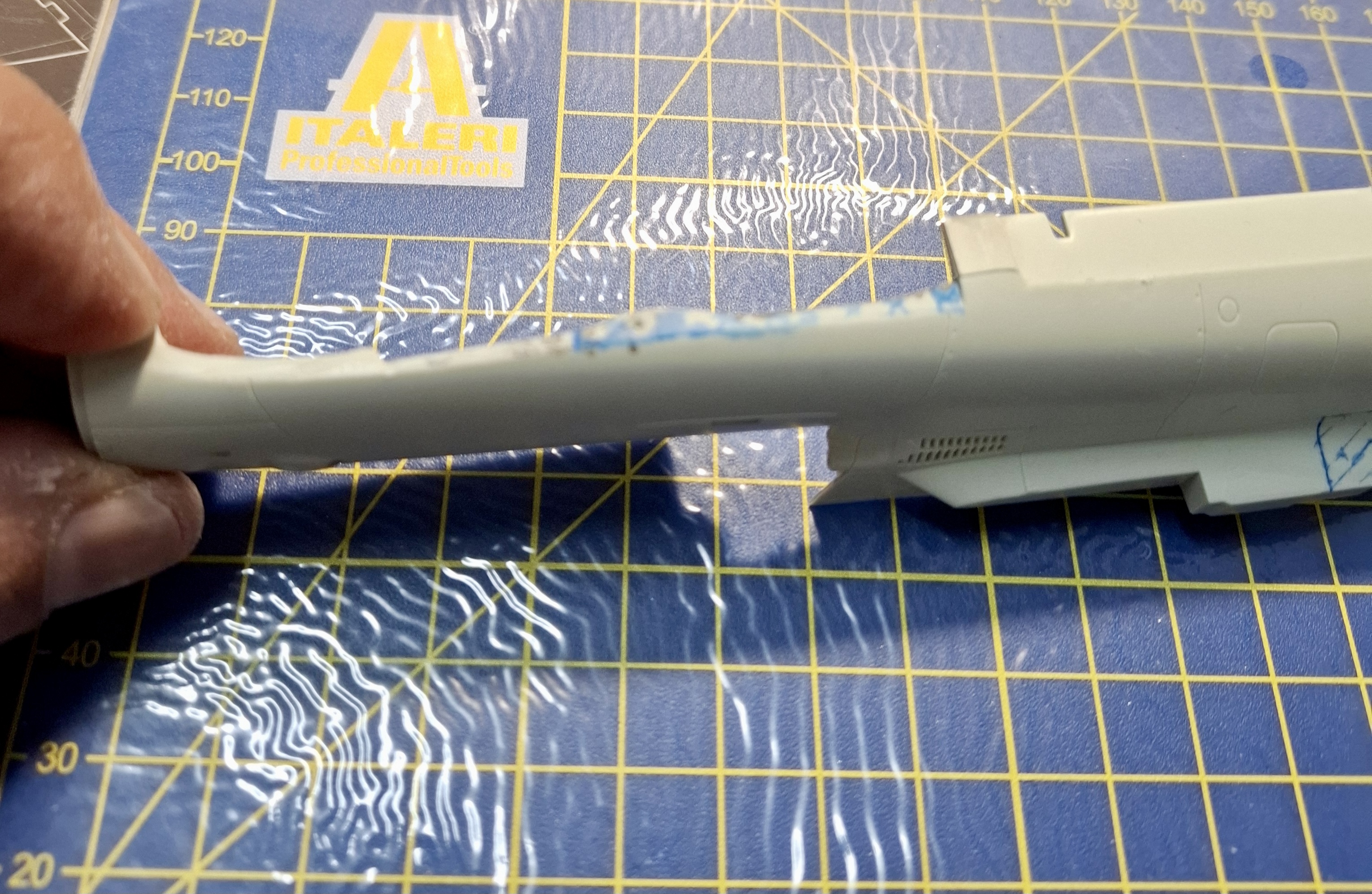

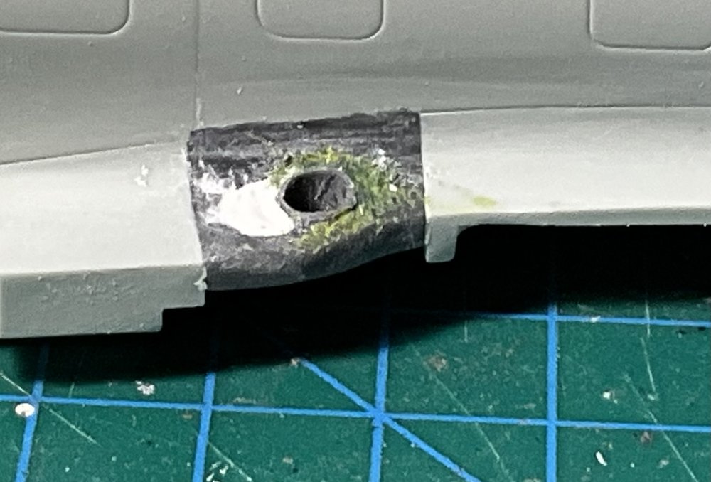

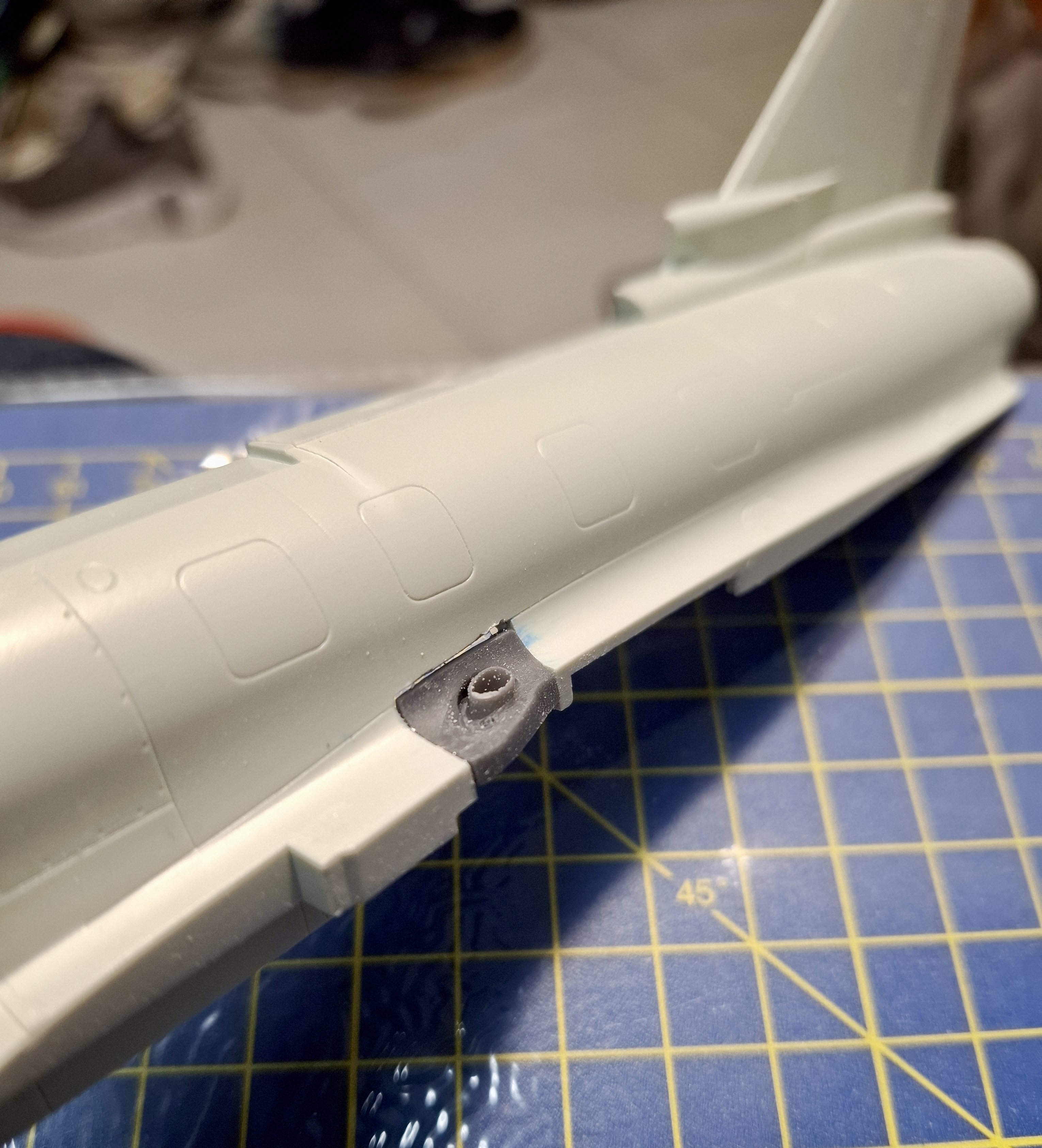

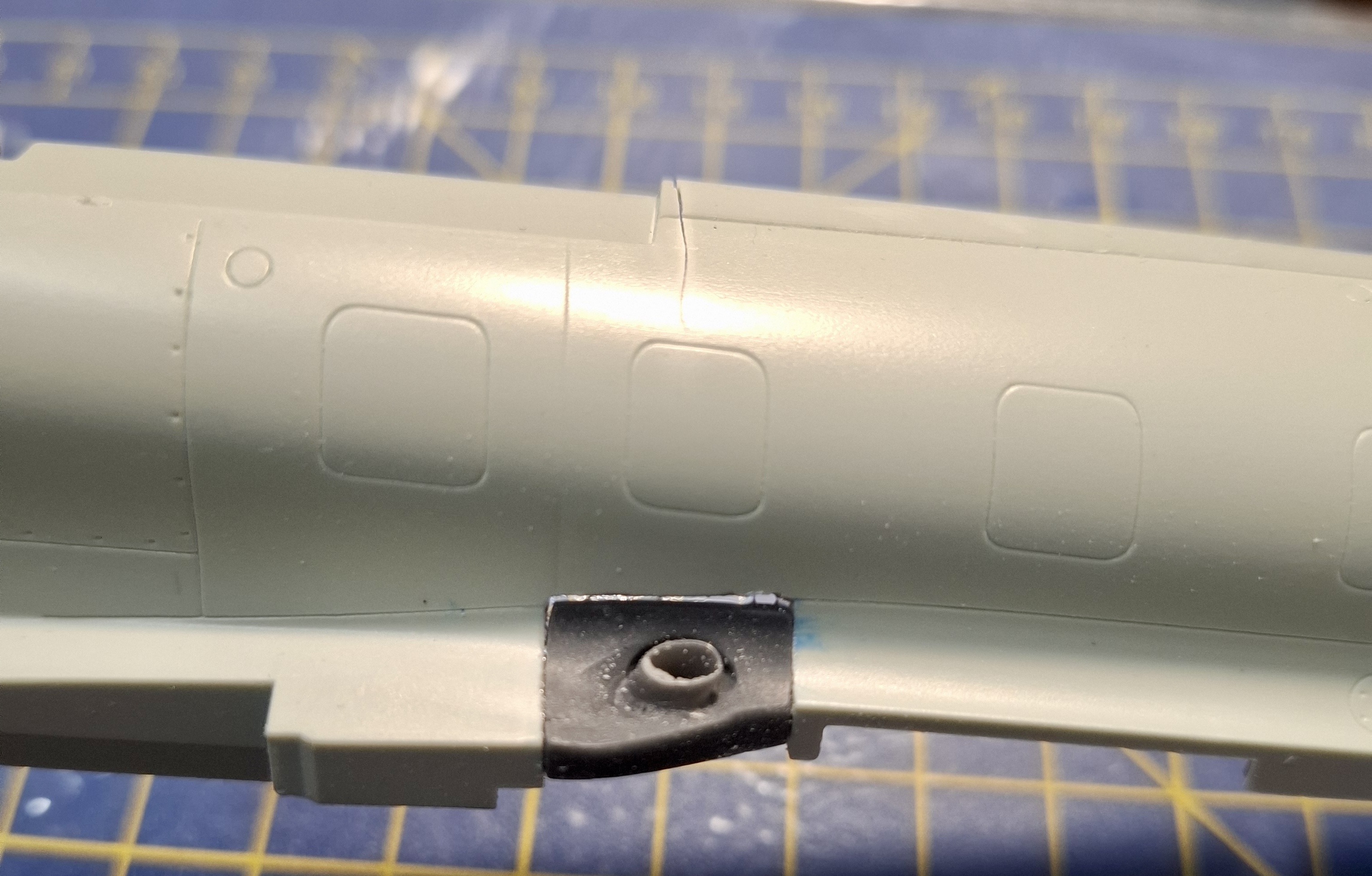

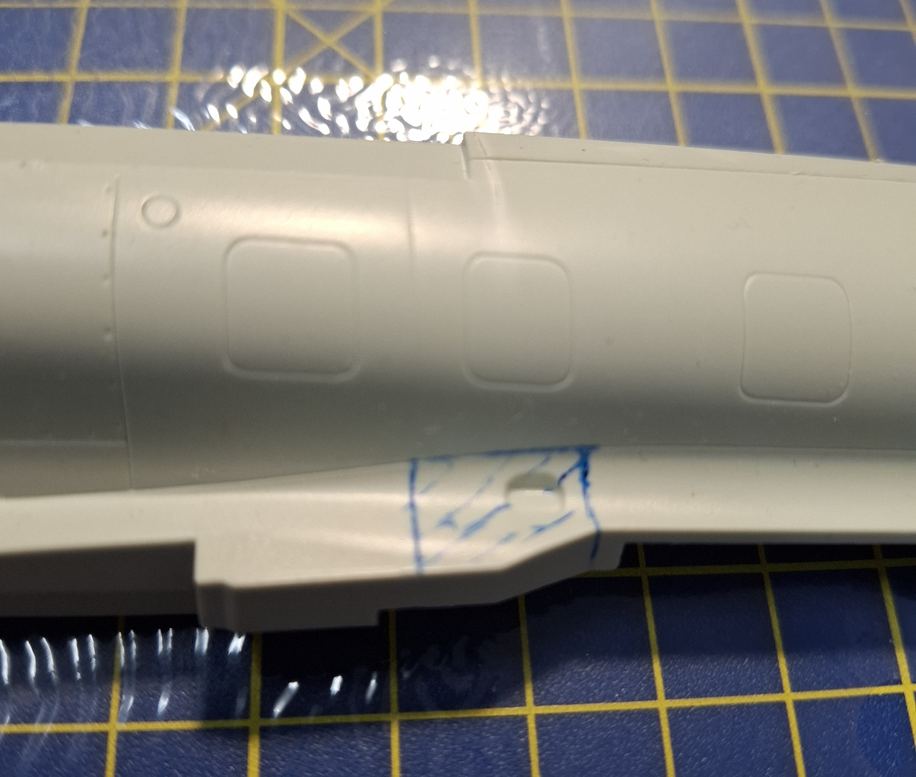

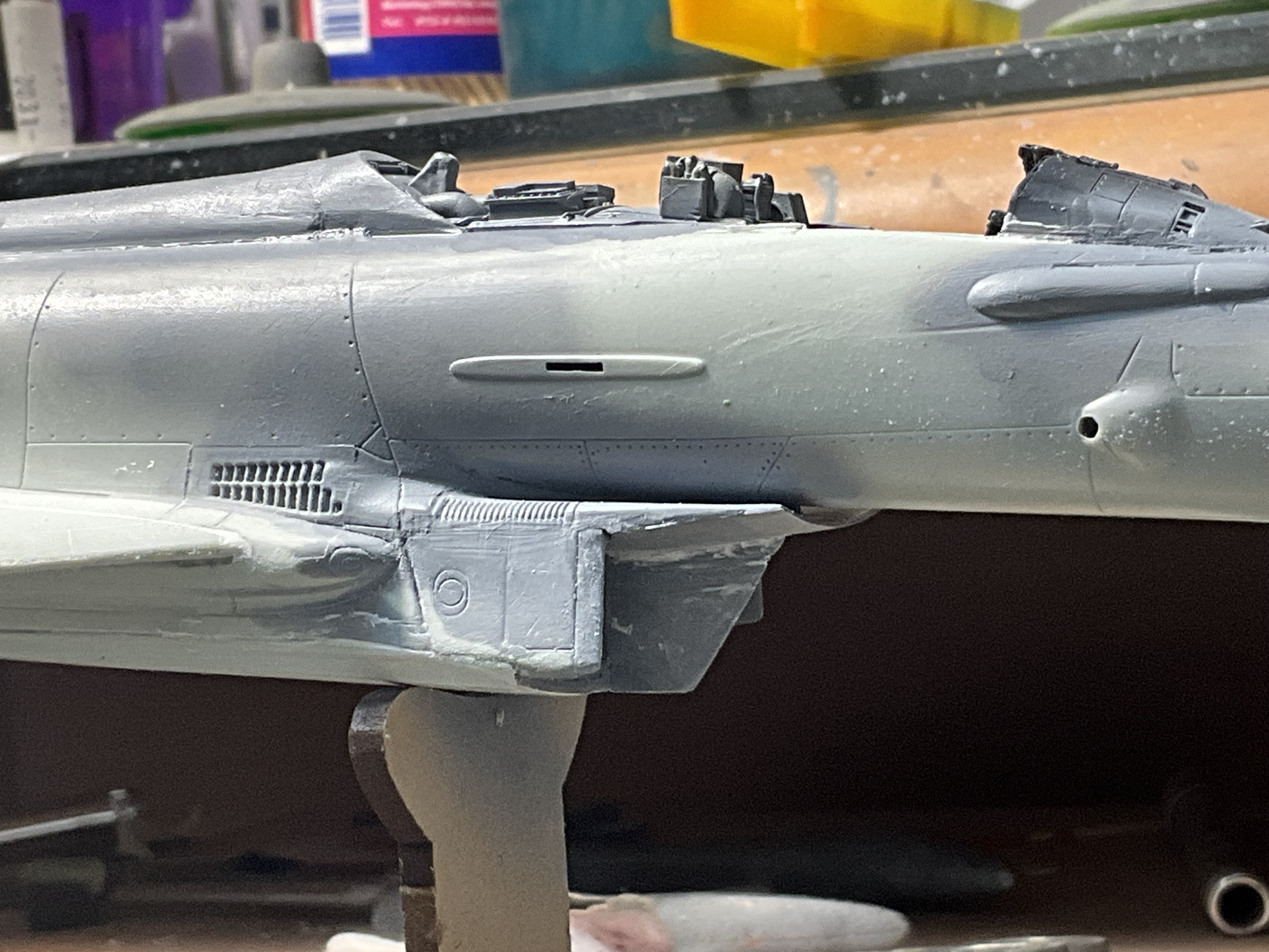

delayar Posted February 3, 2025 Share Posted February 3, 2025 On 1/31/2025 at 7:36 AM, lavony said: the APU section fits great without any major issues. That is a great project. I tackled this kit some years ago, and it was not an experience I would like to do again. I guess it is already too late, but I think that APU Resin part is supposed to go under the kit plastic, with only a hole drilled for the actual APU exhaust itself, since the exhaust sits flush with the fuselage. This is how it looked on my build: I am looking forward to seeing how your build turns out. Cheers, Markus Quote Link to post Share on other sites
lavony Posted February 3, 2025 Author Share Posted February 3, 2025 Thanks for the comment Markus My APU set didn't came with instructions, so I did as it looked right… Hope 🙏 it'll look OK after primer and paint. Yossi Quote Link to post Share on other sites

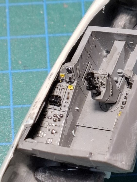

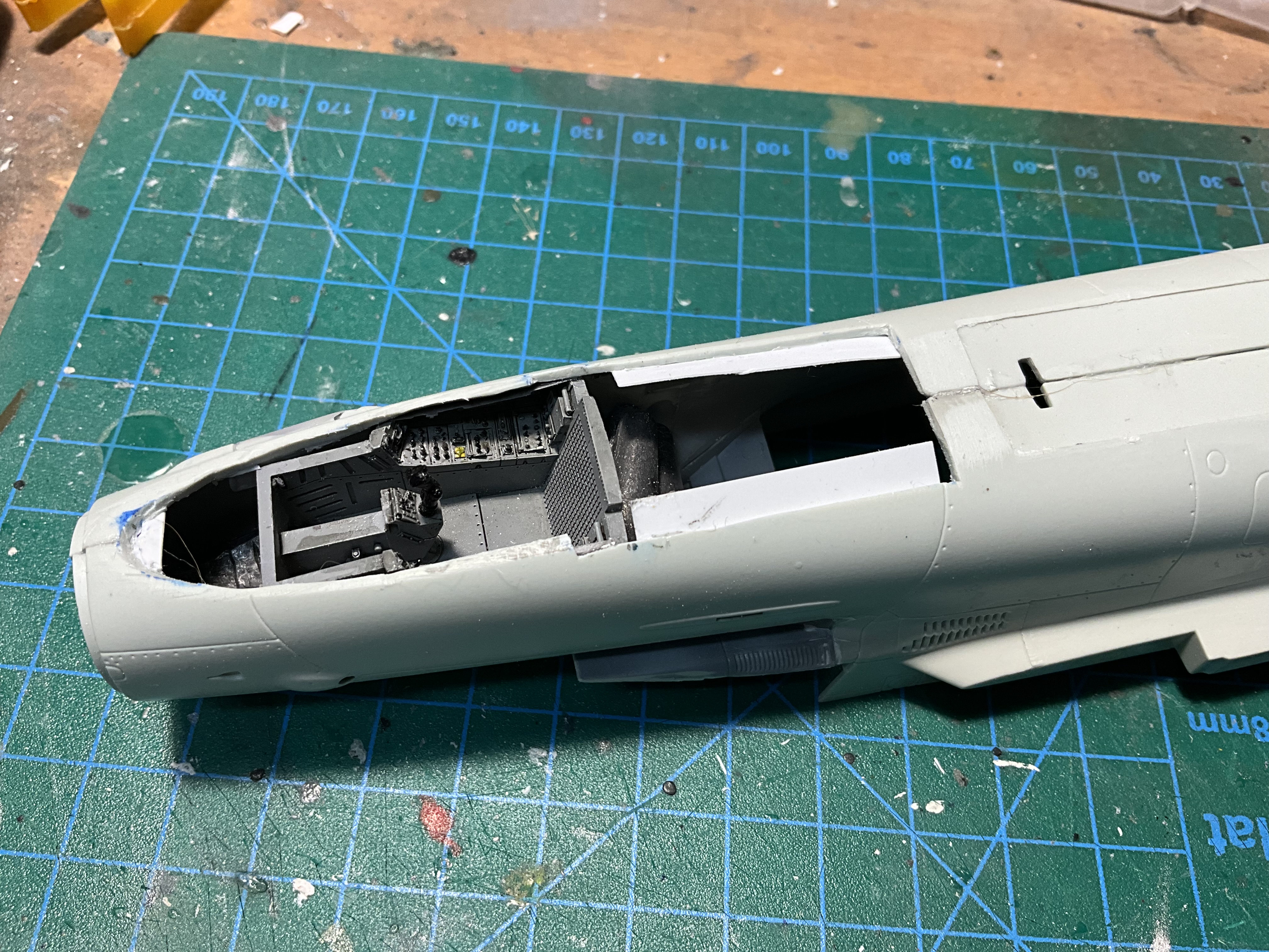

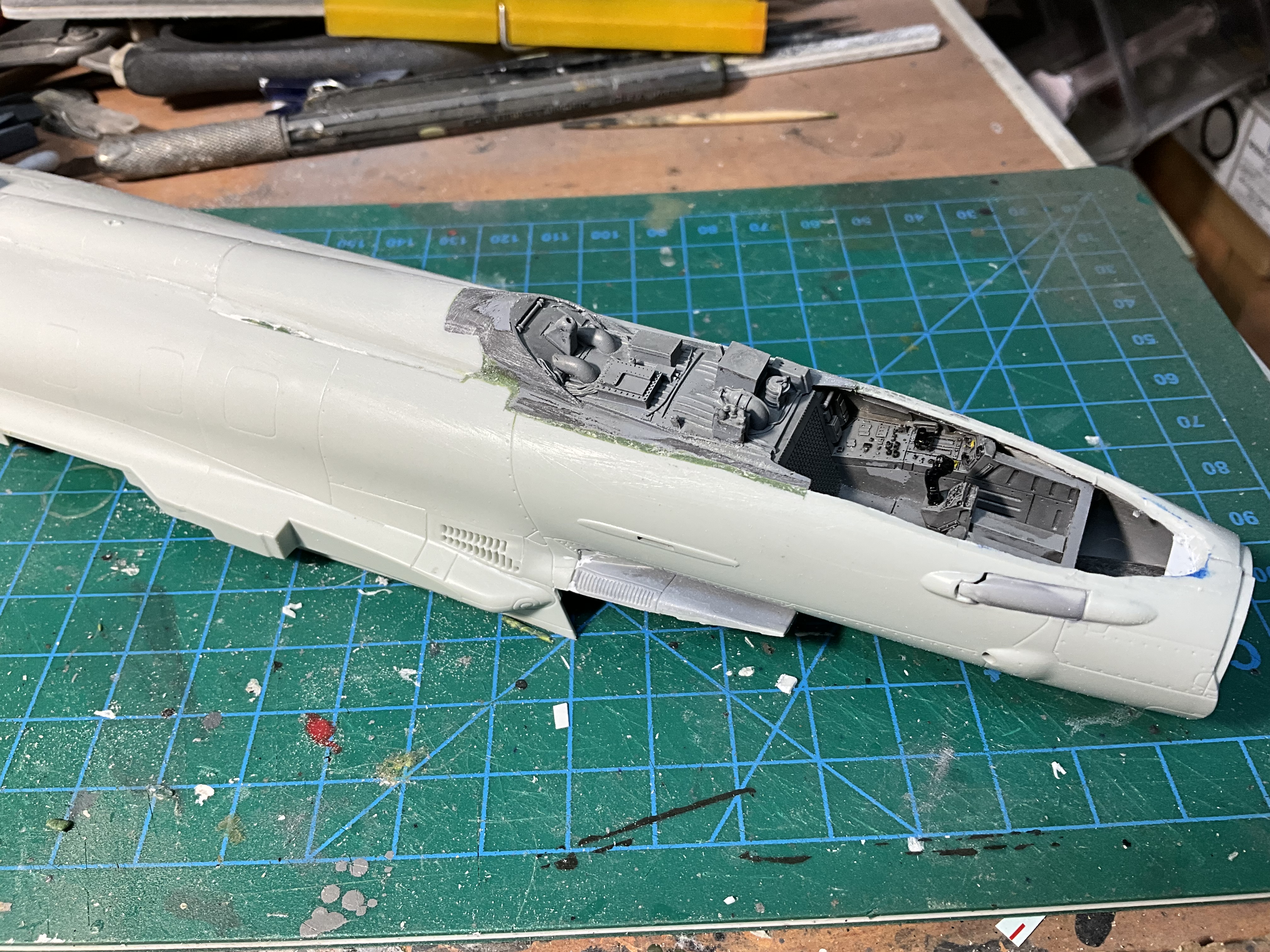

lavony Posted February 8, 2025 Author Share Posted February 8, 2025 The fuselage is glued, and it’s time to add the cockpit resin parts. some filling is needed around, and since the gaps are too wide, I’ll use epoxy putty later. Quote Link to post Share on other sites
arnobiz Posted February 8, 2025 Share Posted February 8, 2025 On 2/3/2025 at 7:39 AM, delayar said: That is a great project. I tackled this kit some years ago, and it was not an experience I would like to do again. I guess it is already too late, but I think that APU Resin part is supposed to go under the kit plastic, with only a hole drilled for the actual APU exhaust itself, since the exhaust sits flush with the fuselage. This is how it looked on my build: I am looking forward to seeing how your build turns out. Cheers, Markus It definitely goes under the plastic. Instructions from the BAM set which has a similar design (and with the vertical fin vents which add nice detail 😉) https://bam-models.com/bam48004-eurofighter-typhoon-ef2000-auxiliary-exhausts-instructions/ Arnaud Quote Link to post Share on other sites

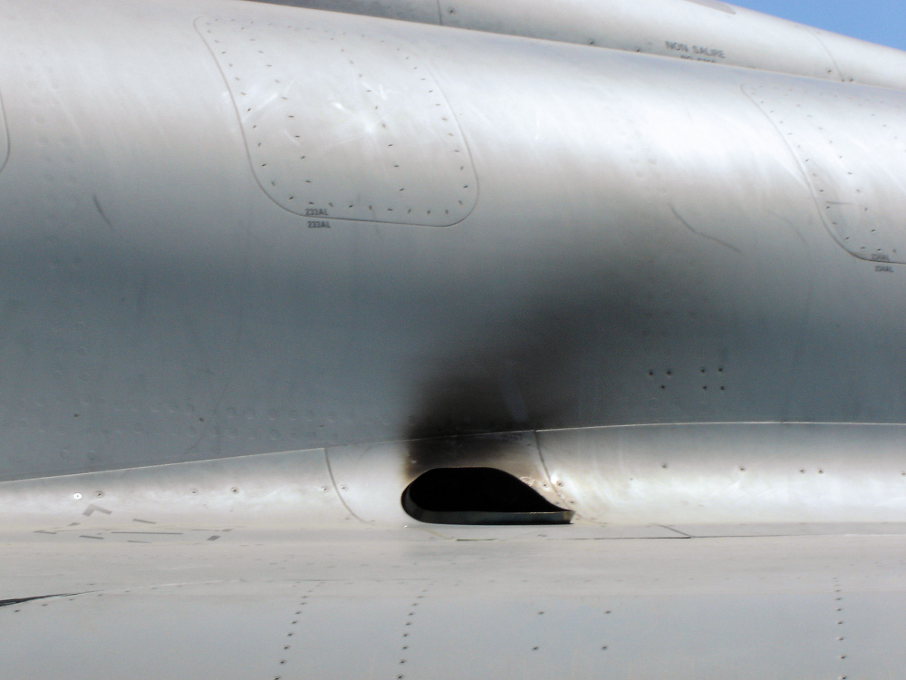

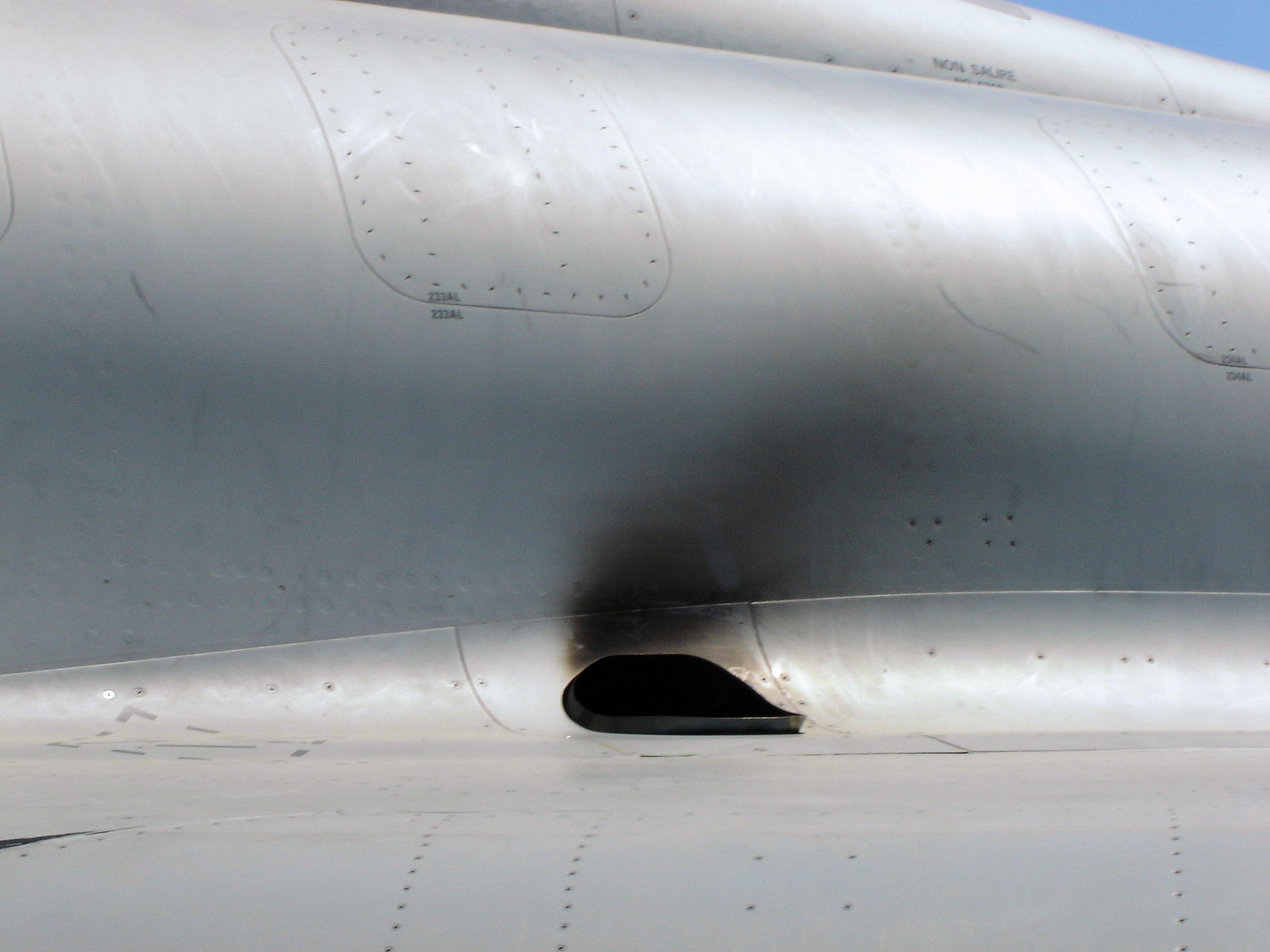

lavony Posted February 8, 2025 Author Share Posted February 8, 2025 (edited) 1 hour ago, arnobiz said: It definitely goes under the plastic. Instructions from the BAM set which has a similar design (and with the vertical fin vents which add nice detail 😉) https://bam-models.com/bam48004-eurofighter-typhoon-ef2000-auxiliary-exhausts-instructions/ Arnaud Thanks btw here’s a photo from the real aircraft : (guess I needed to do a better preparation before cutting the plastic 🙁…) Edited February 8, 2025 by lavony Quote Link to post Share on other sites
lavony Posted February 8, 2025 Author Share Posted February 8, 2025 Filling the gaps : Quote Link to post Share on other sites

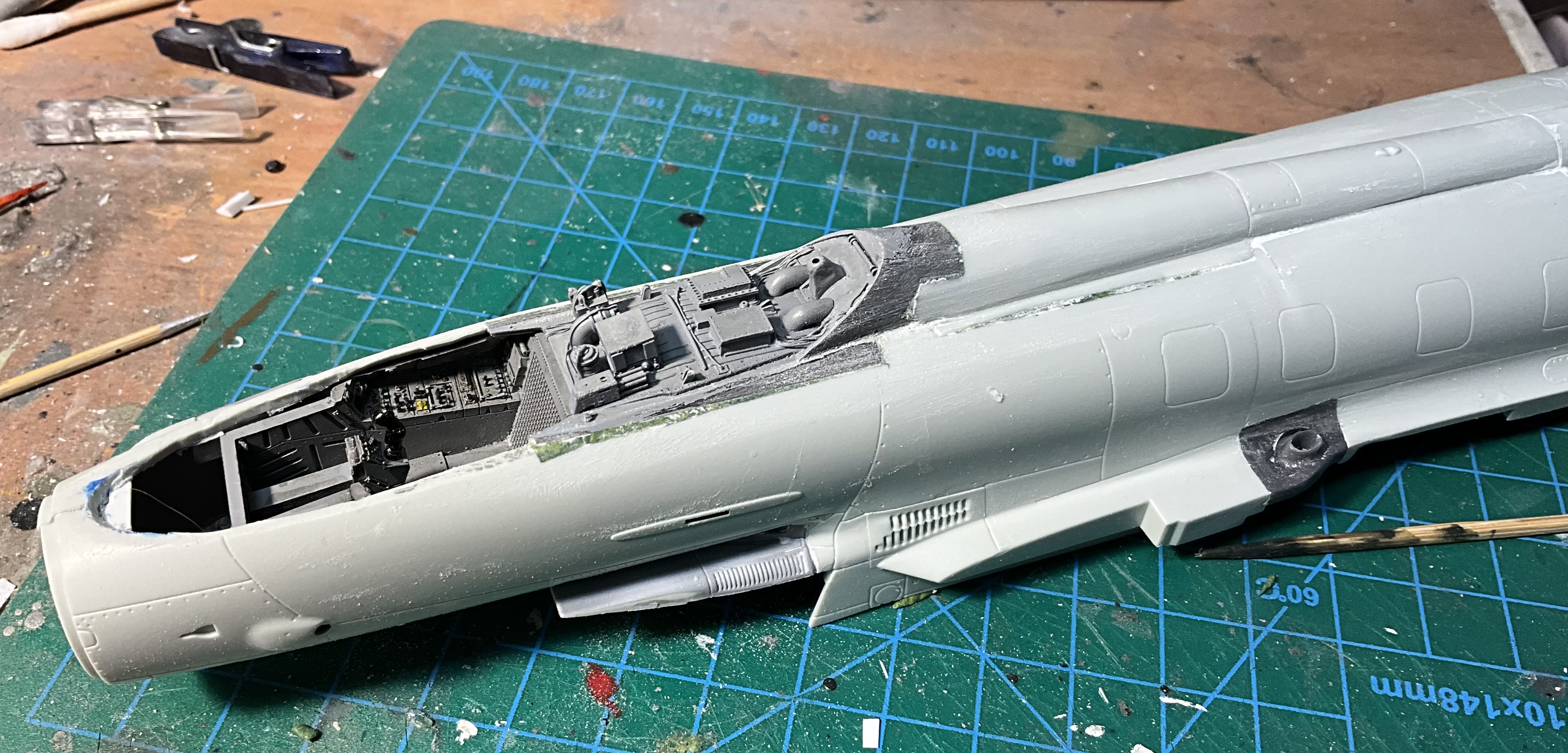

lavony Posted February 8, 2025 Author Share Posted February 8, 2025 According to the good comments & reference photo, I’ve shortened the exhaust and filled the tranches… hope it’ll look better after sending and priming. Quote Link to post Share on other sites

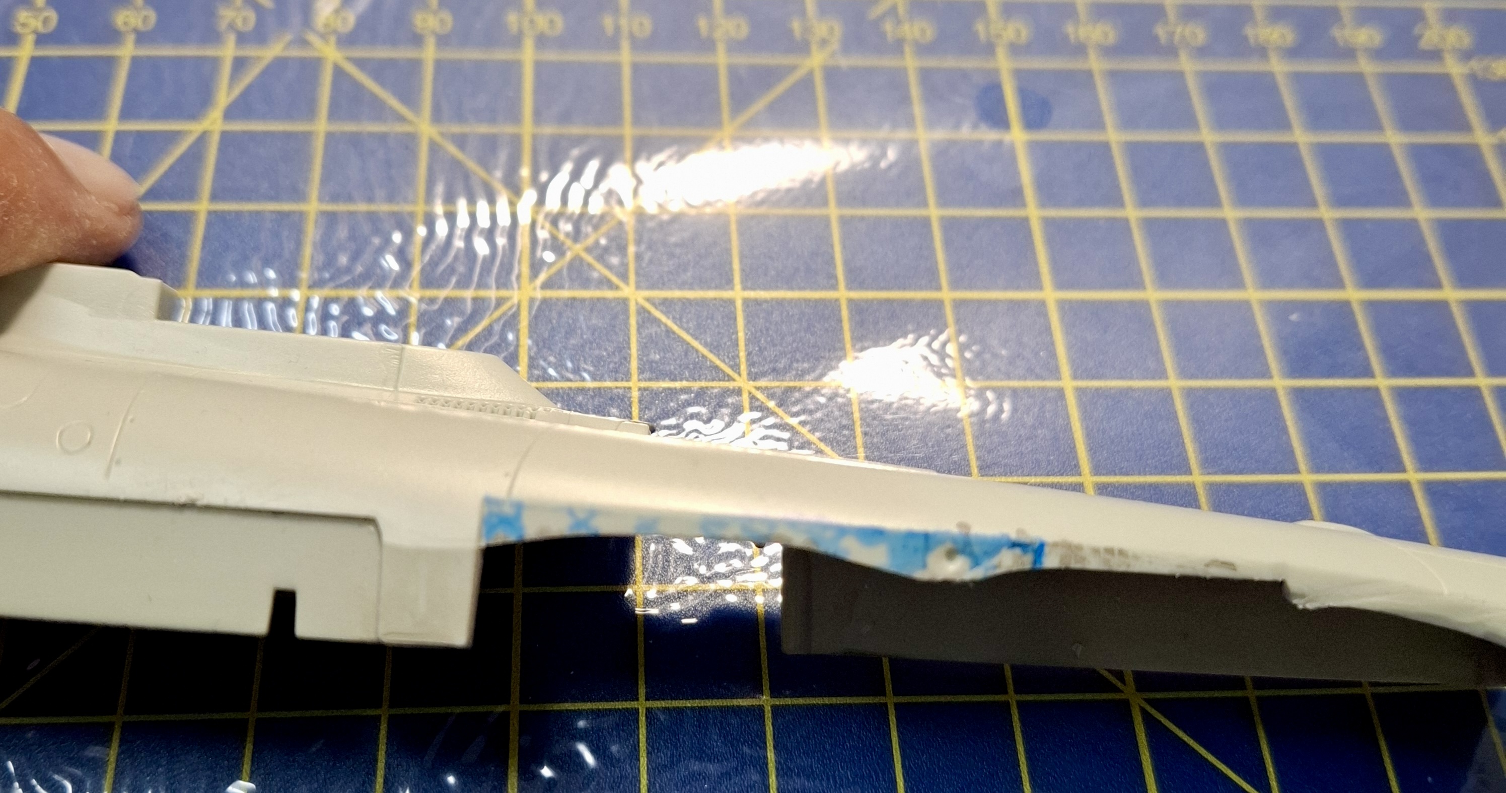

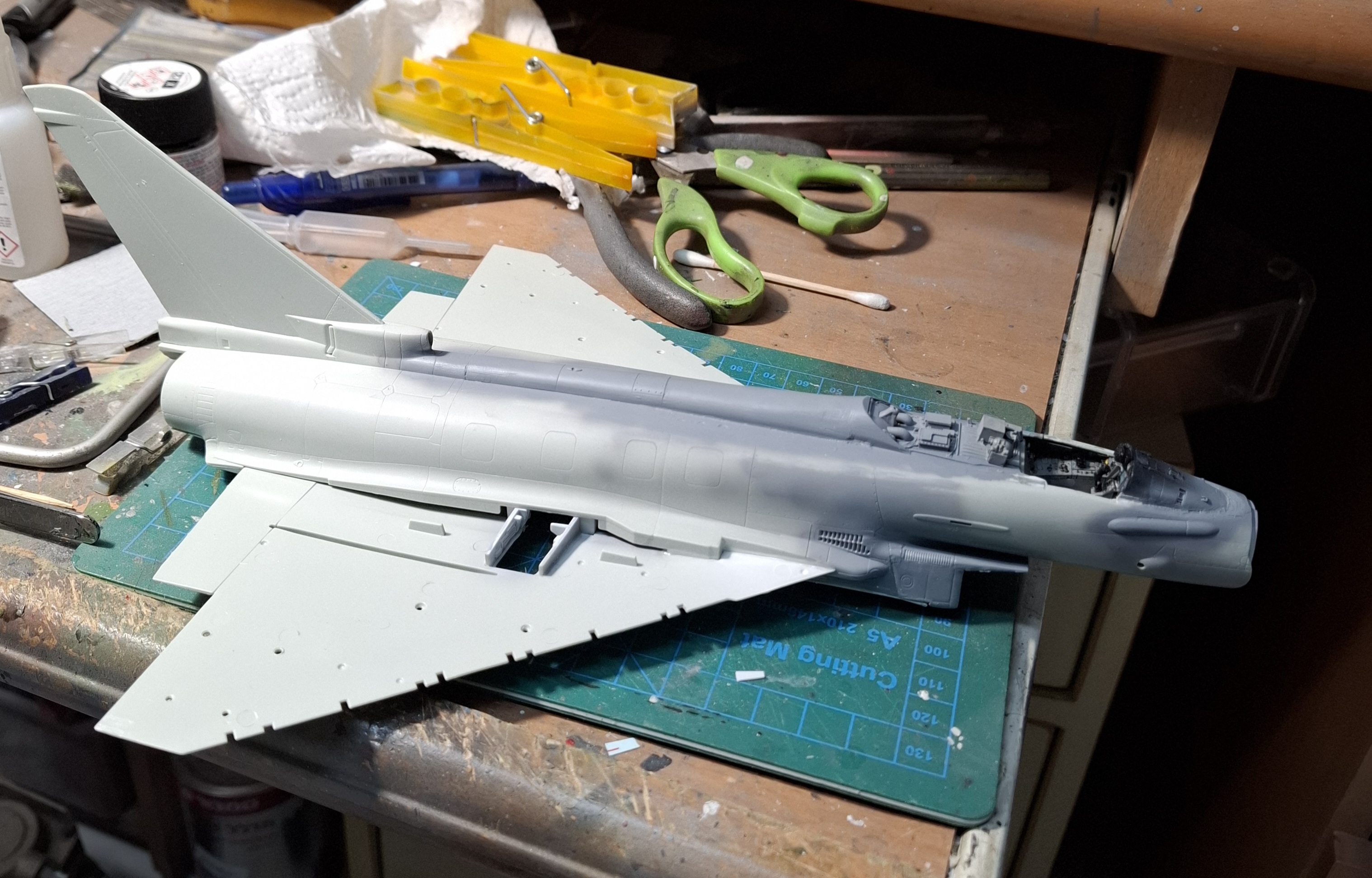

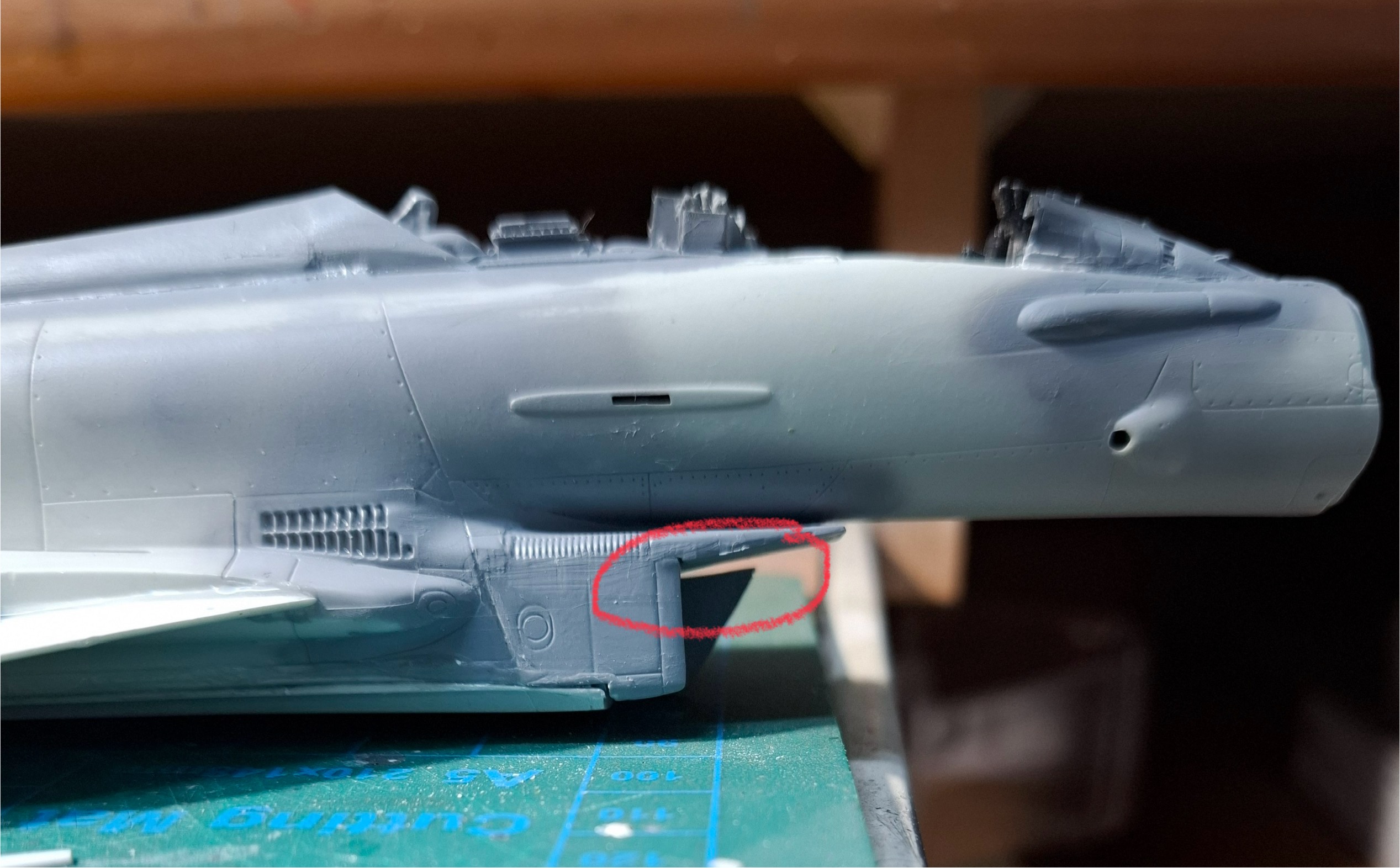

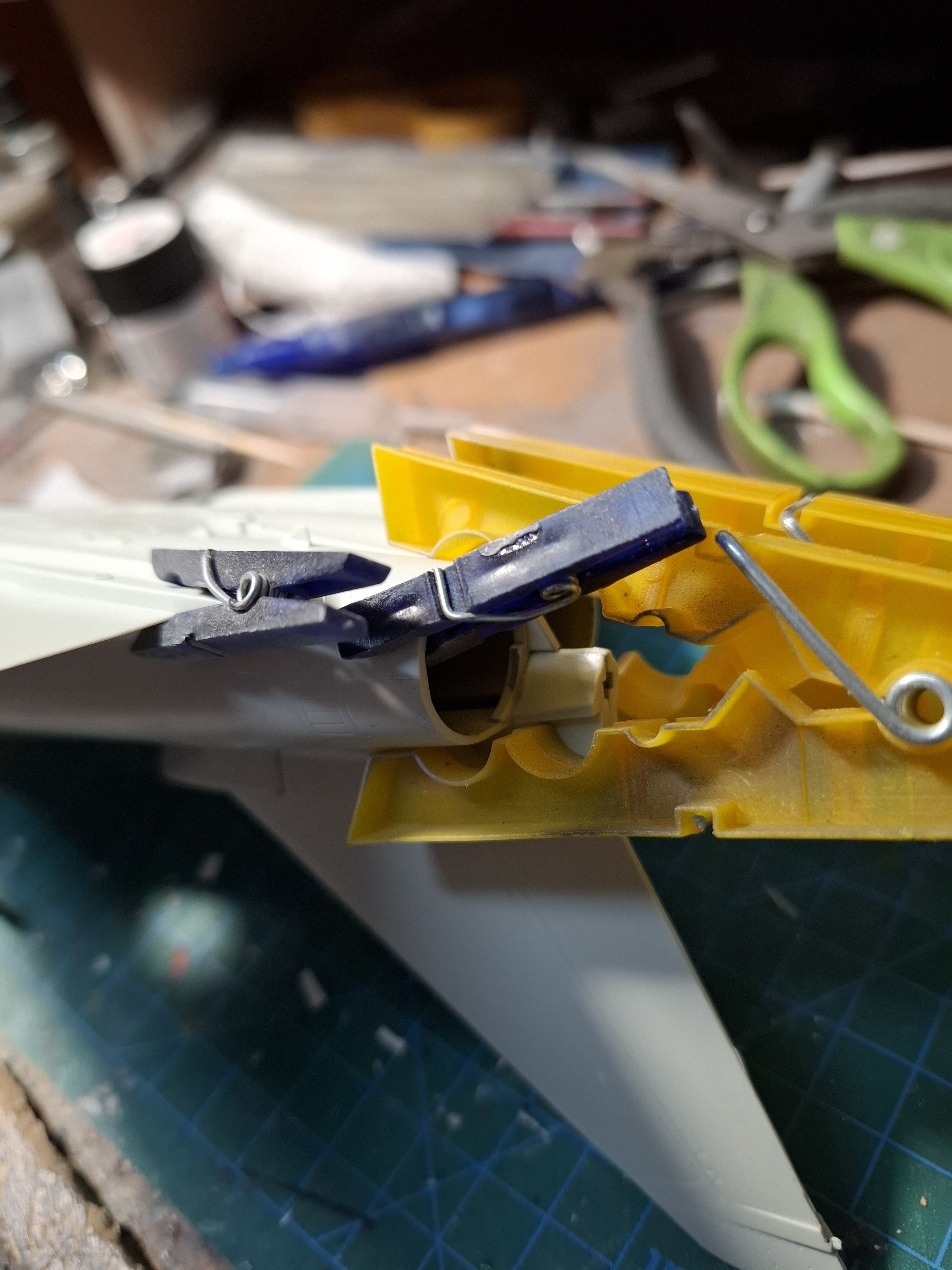

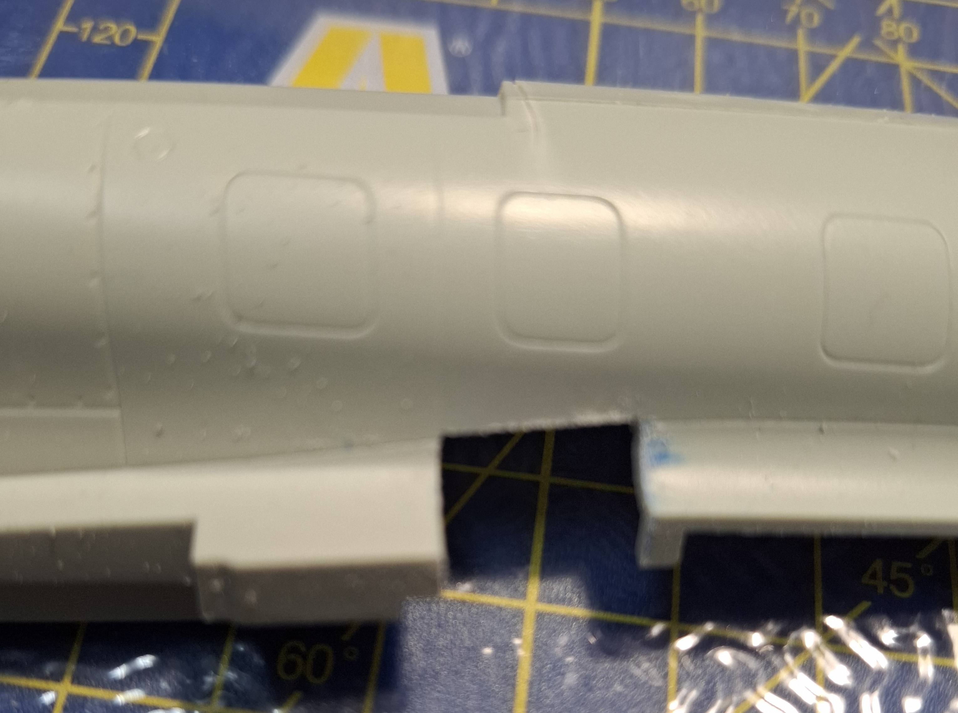

lavony Posted February 12, 2025 Author Share Posted February 12, 2025 (edited) Time to attach the bottom wing to the fuselage. started from back and moving forward, as recommended in a video build I’ve seen. again , probably my mistake ☹️, but a large gap in the front of the intake. Will require fix…. Edited February 12, 2025 by lavony Quote Link to post Share on other sites
delayar Posted February 13, 2025 Share Posted February 13, 2025 Hi, Your progress looks good. This will be a great model once you are finished. And no, it probably was not a mistake. The intake section is a nightmare with this kit. Apart from some other missing details, especially in the region of the exhaust, this is the worst part of the kit and requires a lot of work to hide all the seams and gaps. That is the reason why I don't intend to build another one, even if by now there are a lot of interesting liveries to build. I hope that one day we will get a better kit of the Eurofighter. Cheers, MArkus Quote Link to post Share on other sites

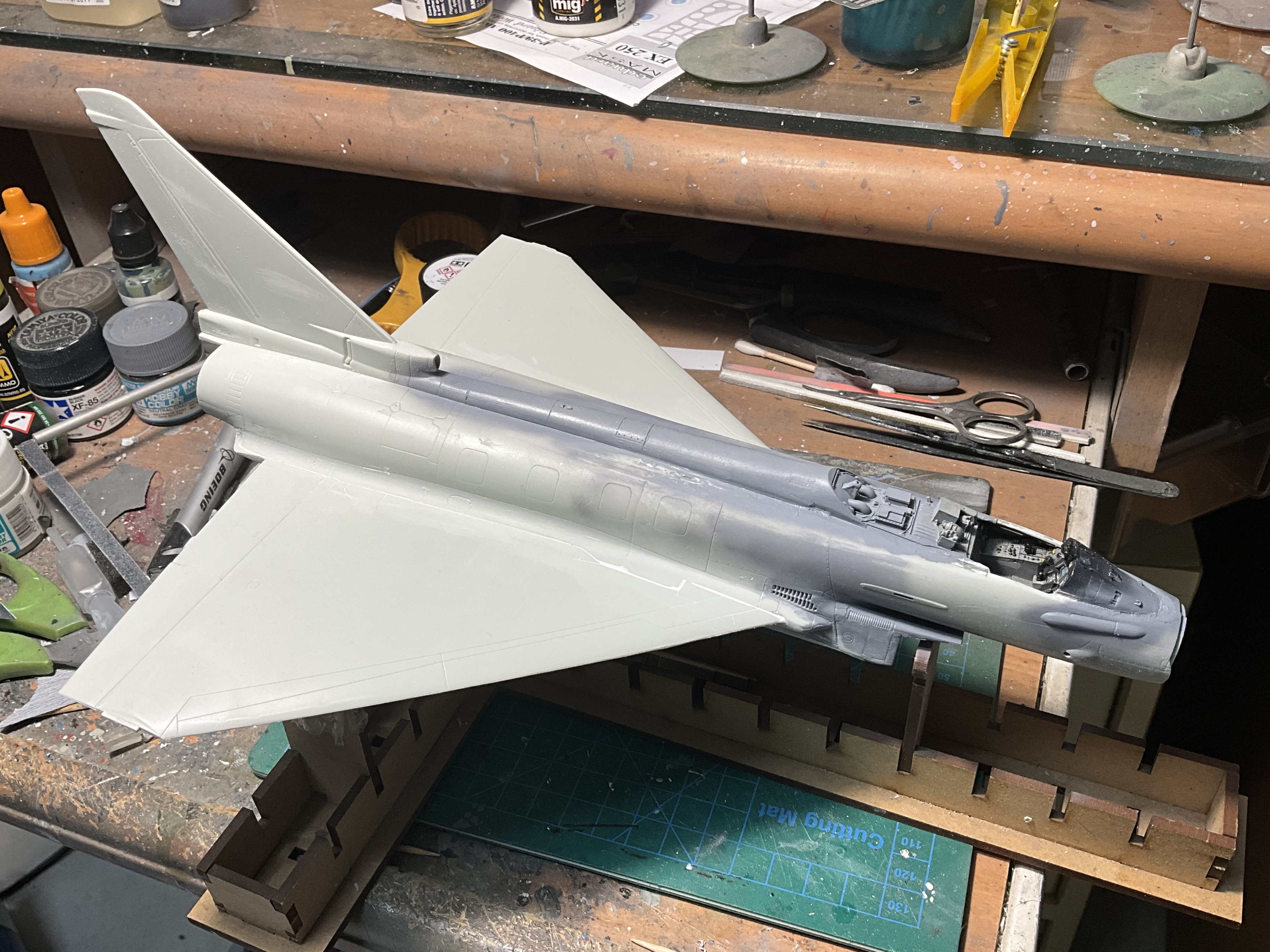

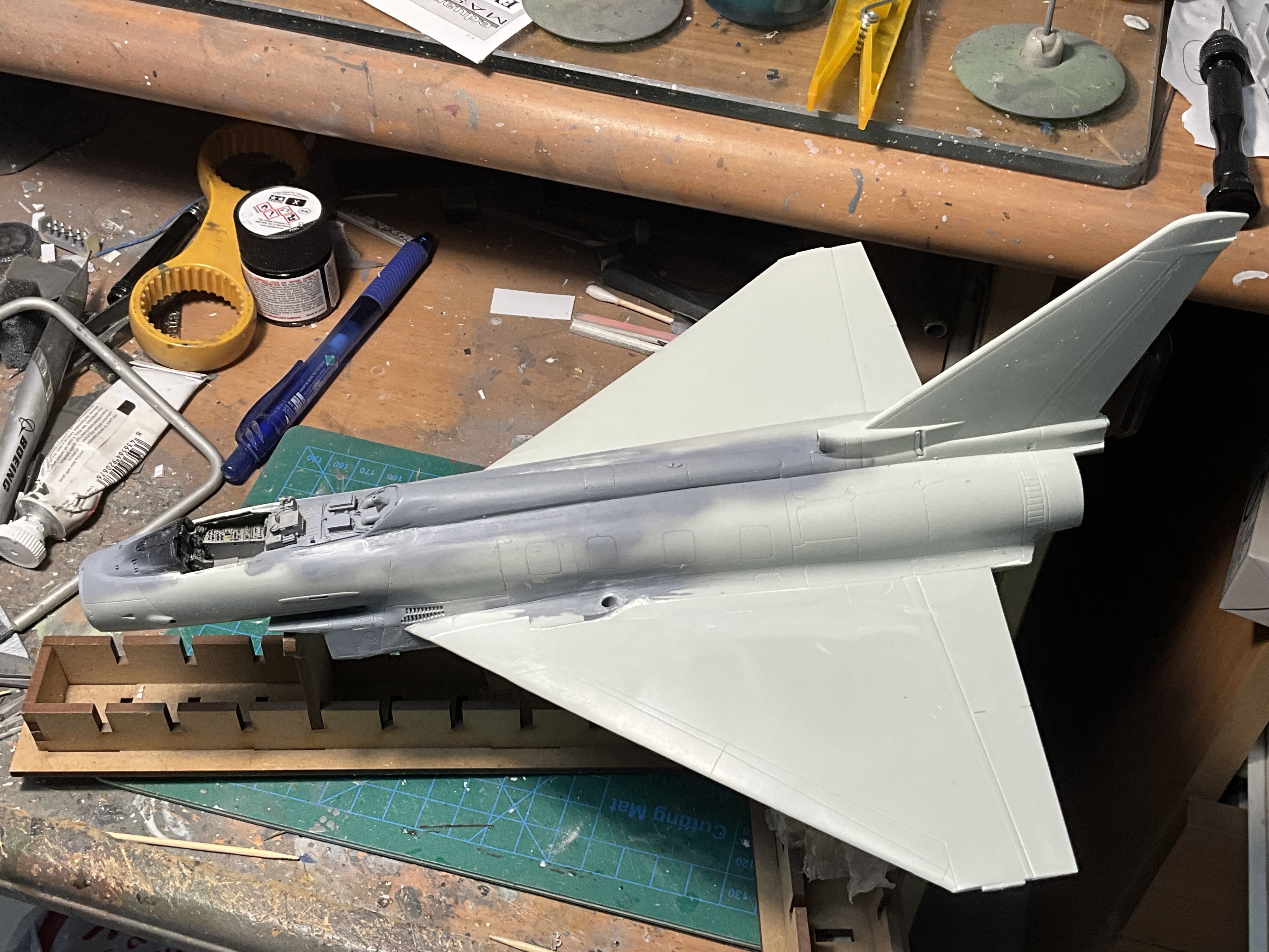

lavony Posted February 21, 2025 Author Share Posted February 21, 2025 Fix of the intake gap is done using epoxy putty. wings are attached, and now it’s time for some putty filling , sanding & priming. hope it won’t take too long 😀 Quote Link to post Share on other sites

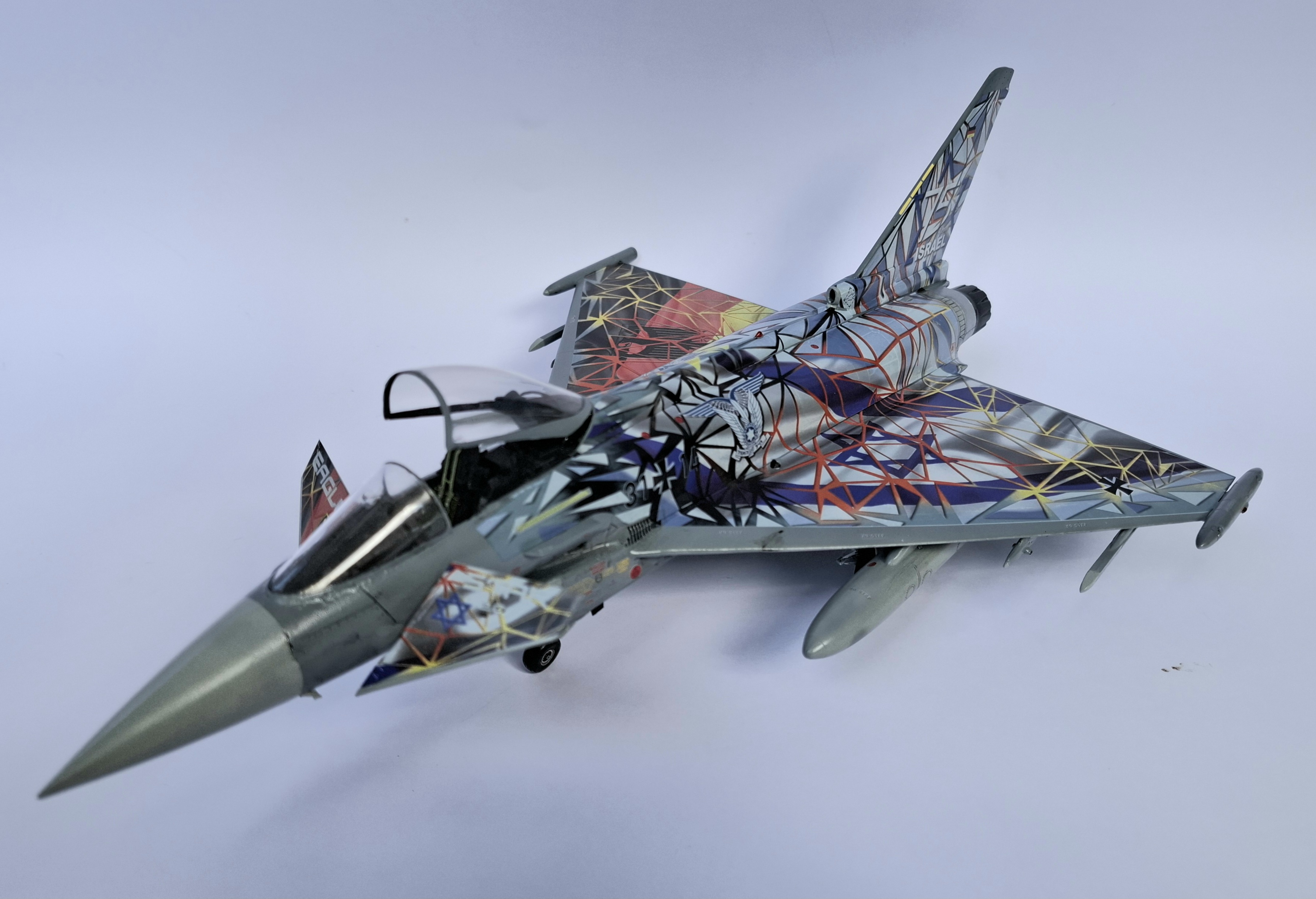

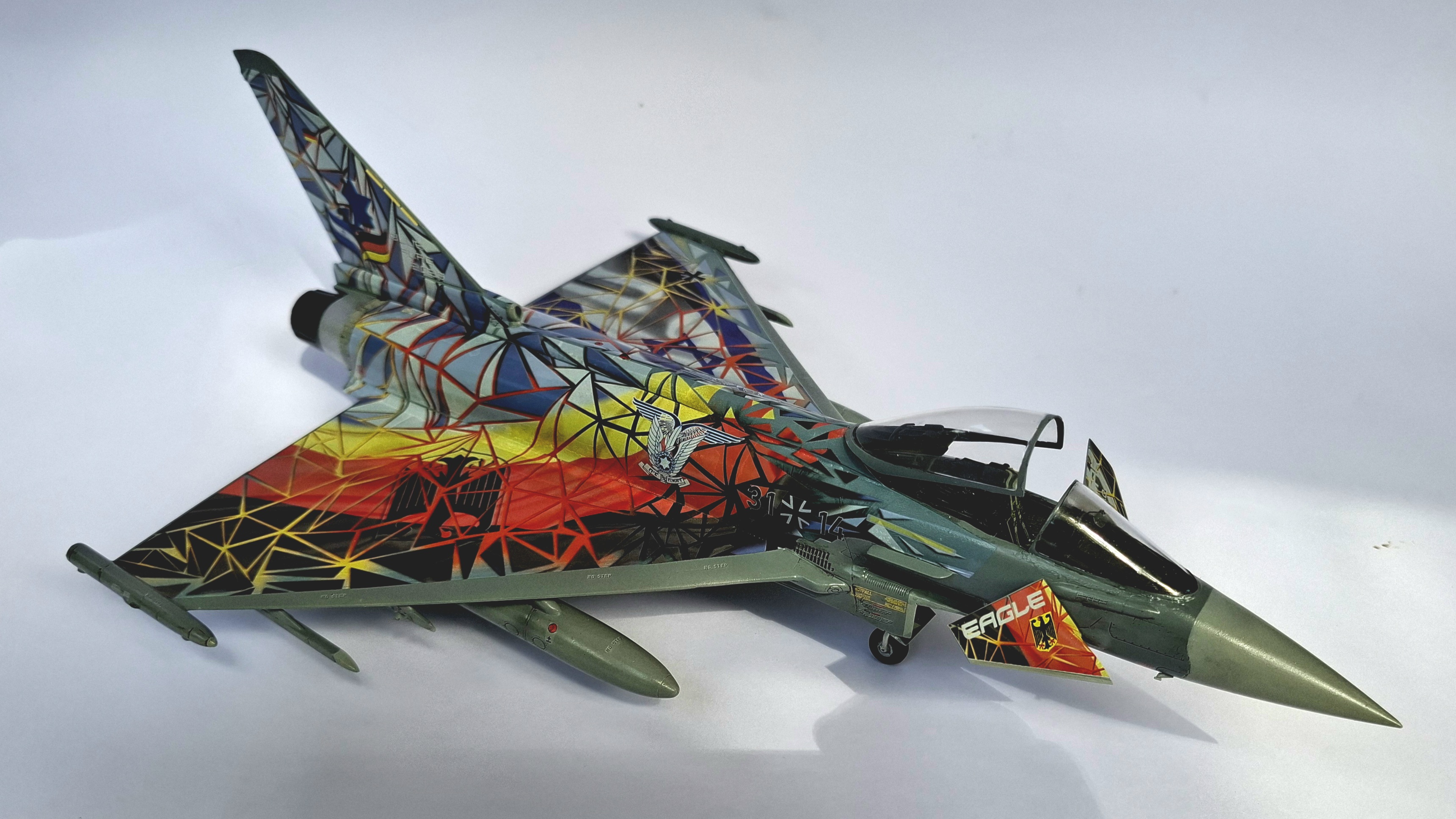

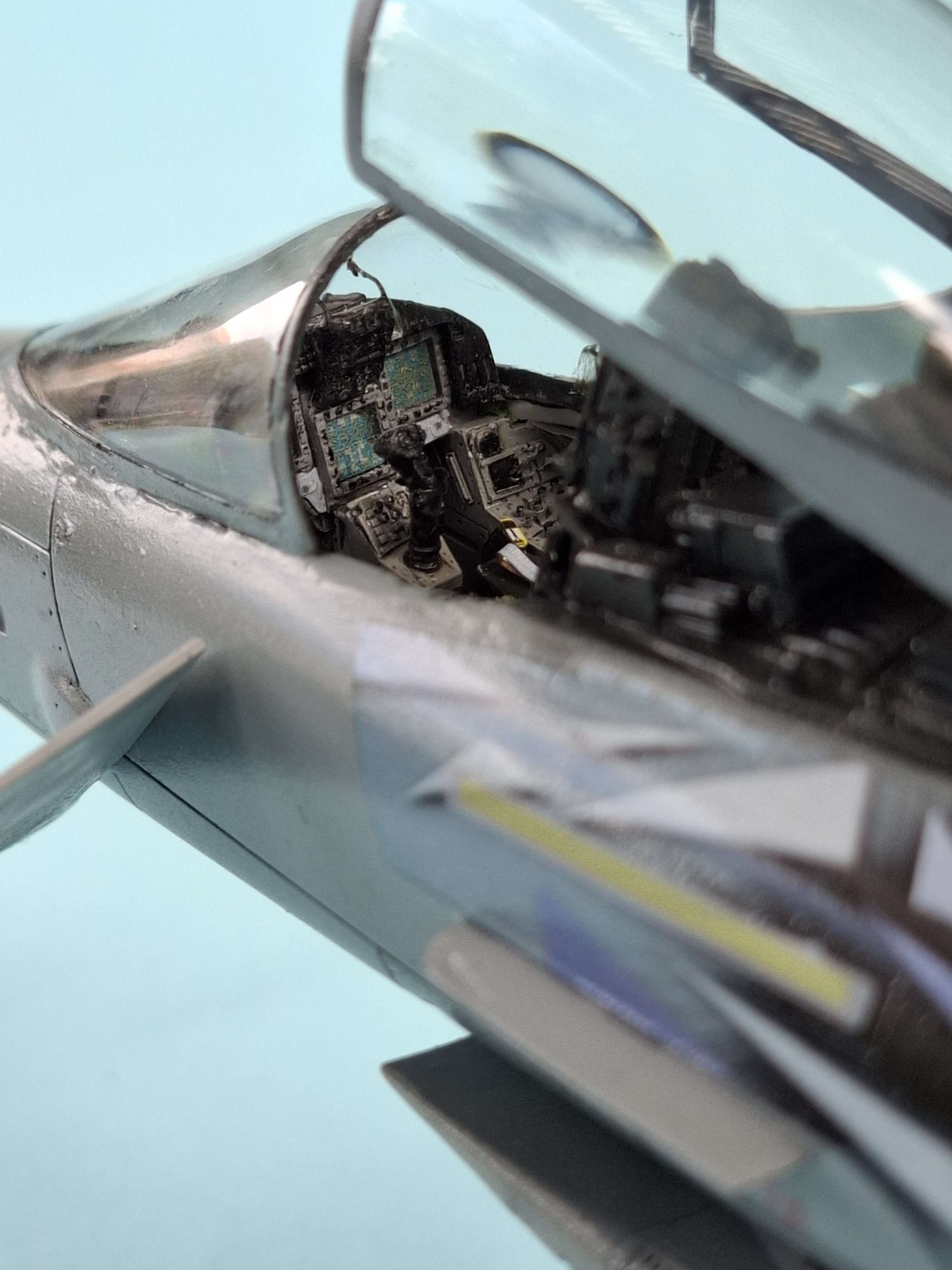

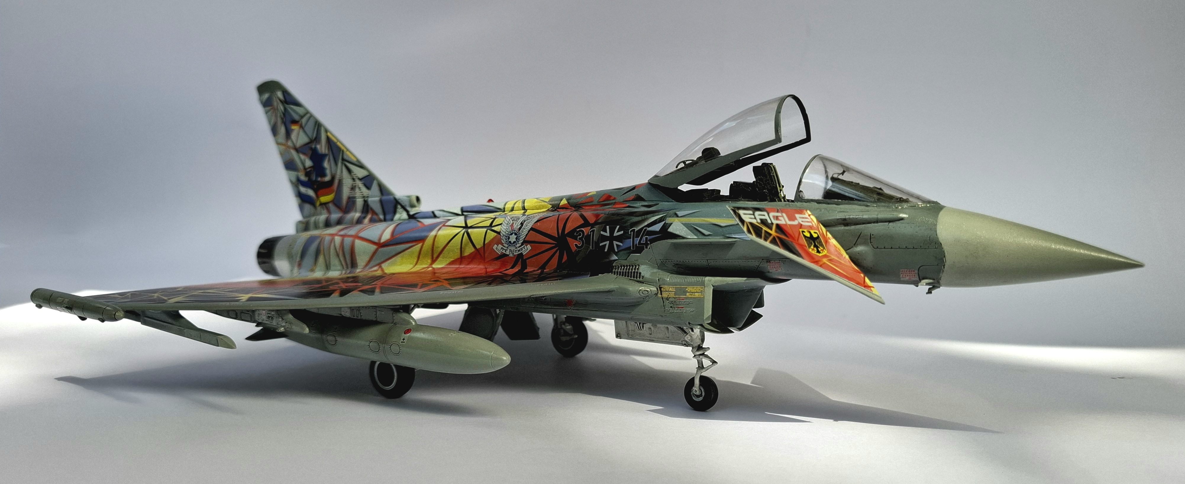

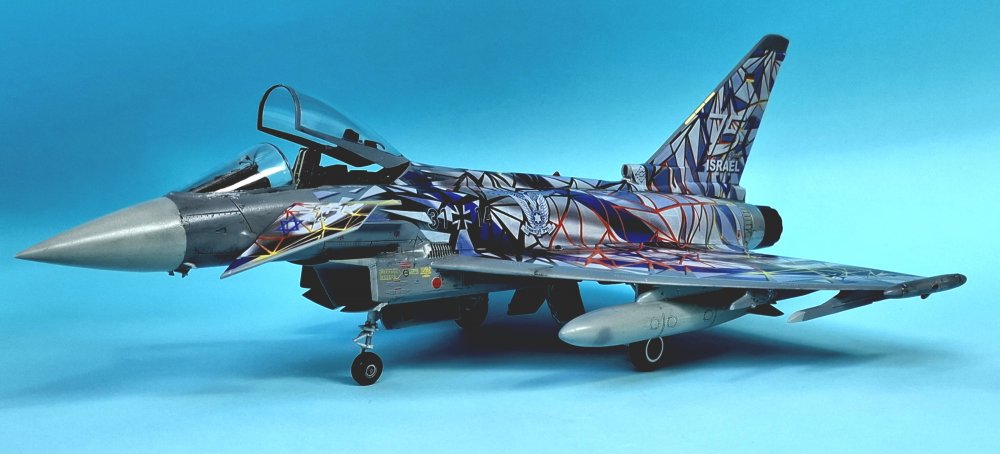

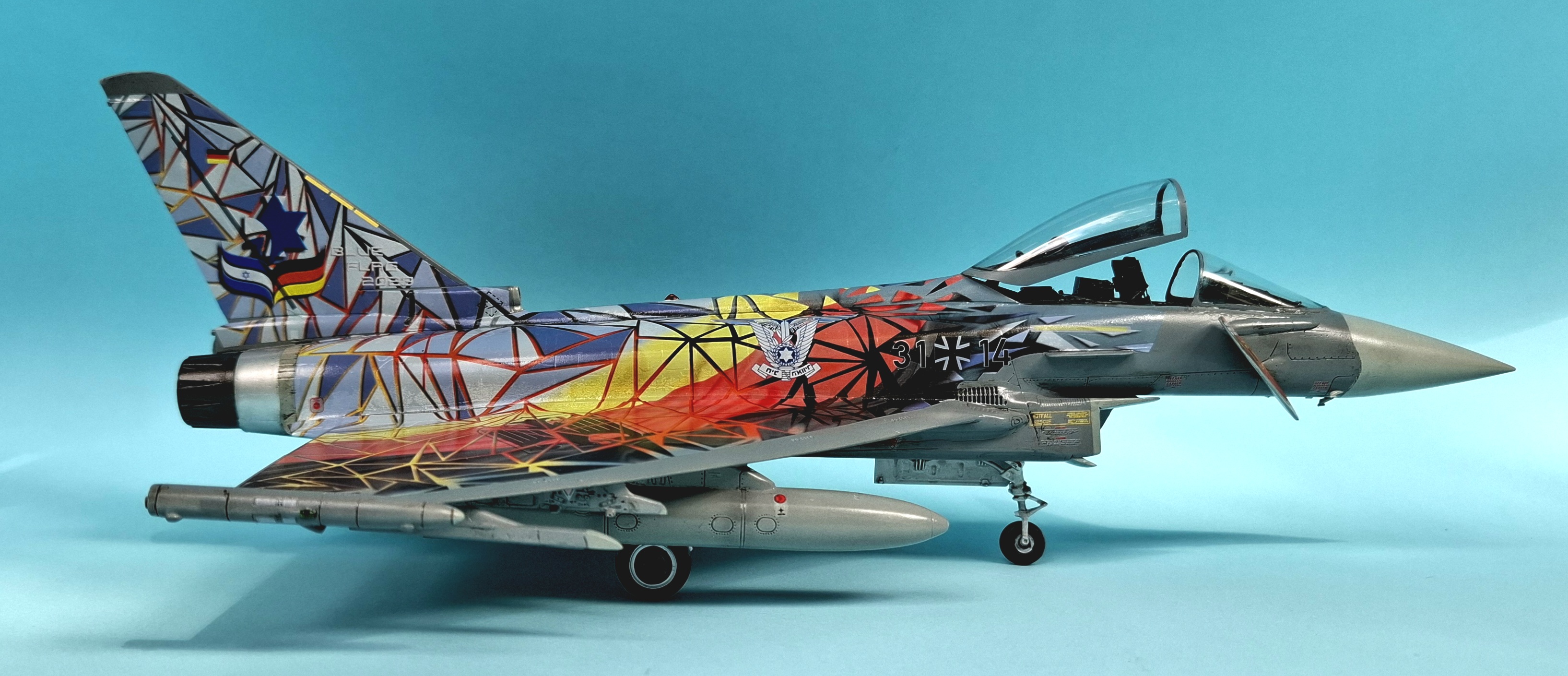

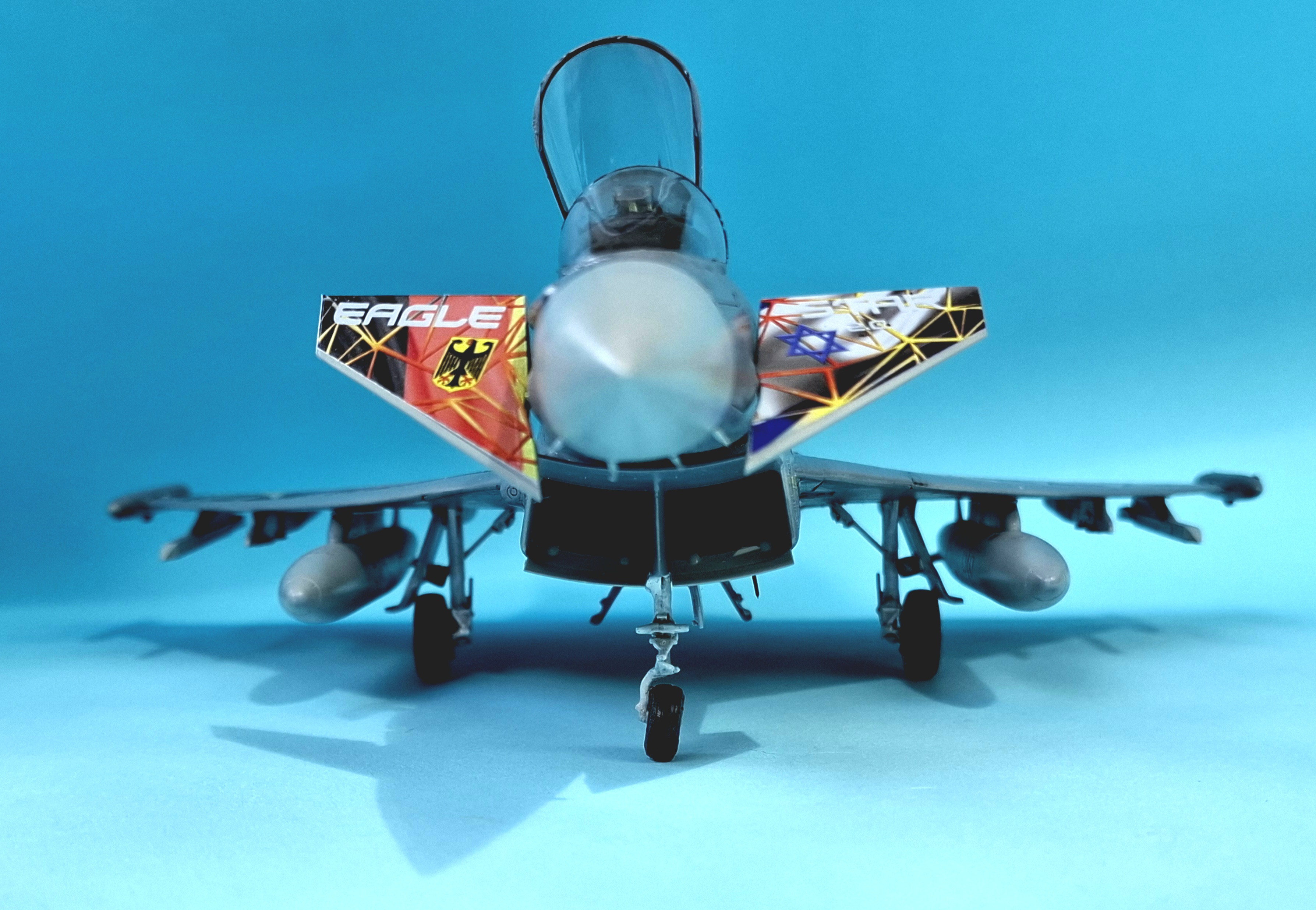

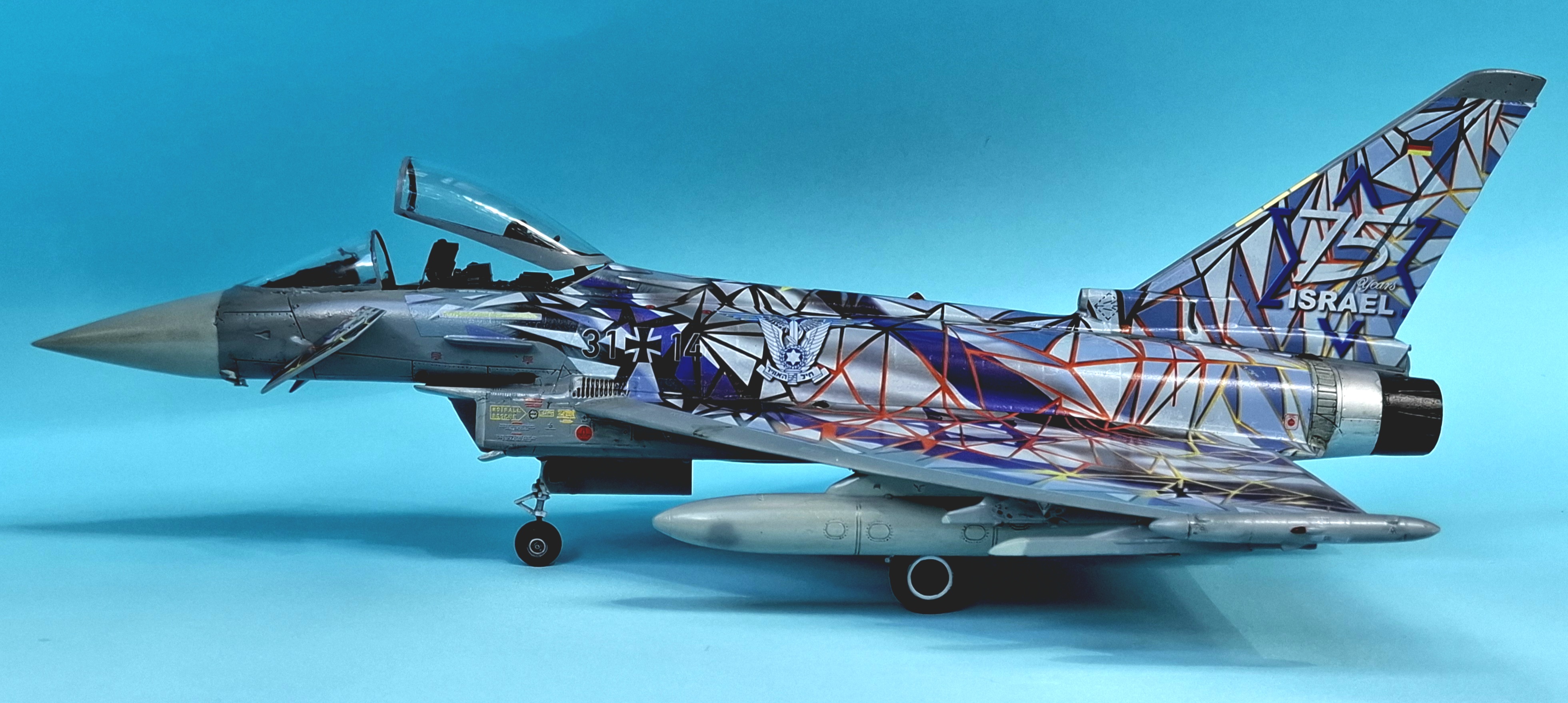

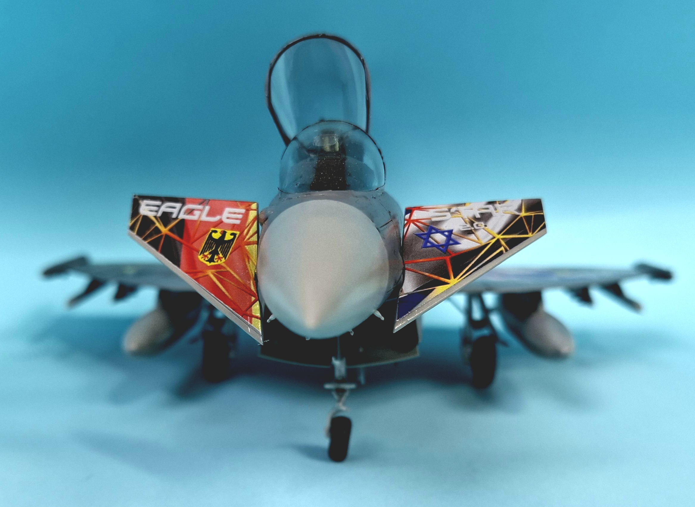

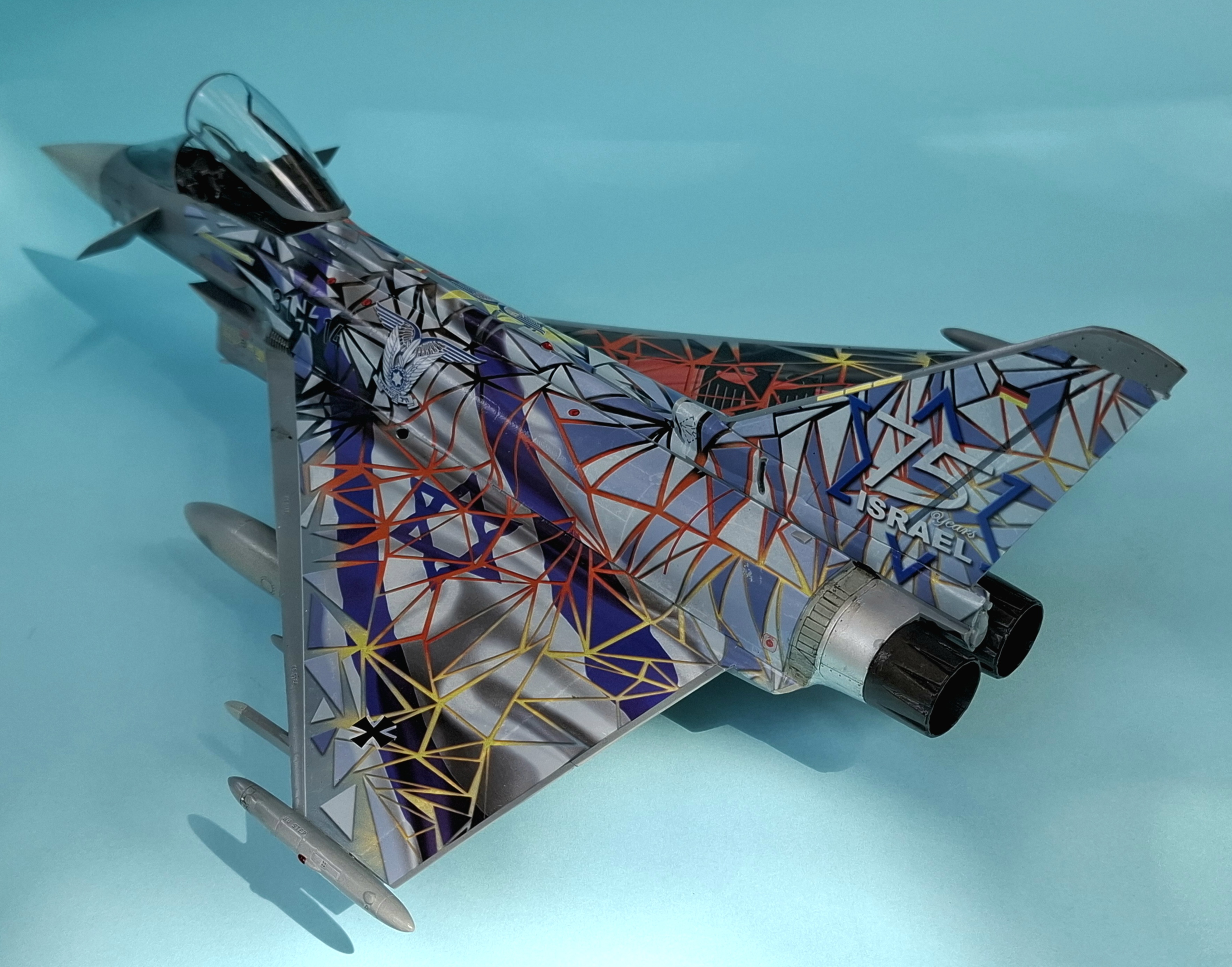

lavony Posted April 27, 2025 Author Share Posted April 27, 2025 completed the kit/ 2 problems with the decals: 1- some mis-matches with the pattern lines. 2- the IAF emblam on the Right Hand side is written in the wrong direction (mirrored). it will be fixed in the coming prints, and I will correct it as soon as I'll get my replacement decal from Harald. the paints that i've used are Mr. Color C337 & C334. anothe small problem is with the Nose White Metal Landing gear. seems to Bend a bit, as seen from the Forward photo. Quote Link to post Share on other sites
BastianD Posted April 30, 2025 Share Posted April 30, 2025 A stunner!!! Very nice livery and well done! Quote Link to post Share on other sites
lgl007 Posted April 30, 2025 Share Posted April 30, 2025 Holy Cow! What a beauty! Well done 🙂 -Greg Quote Link to post Share on other sites
