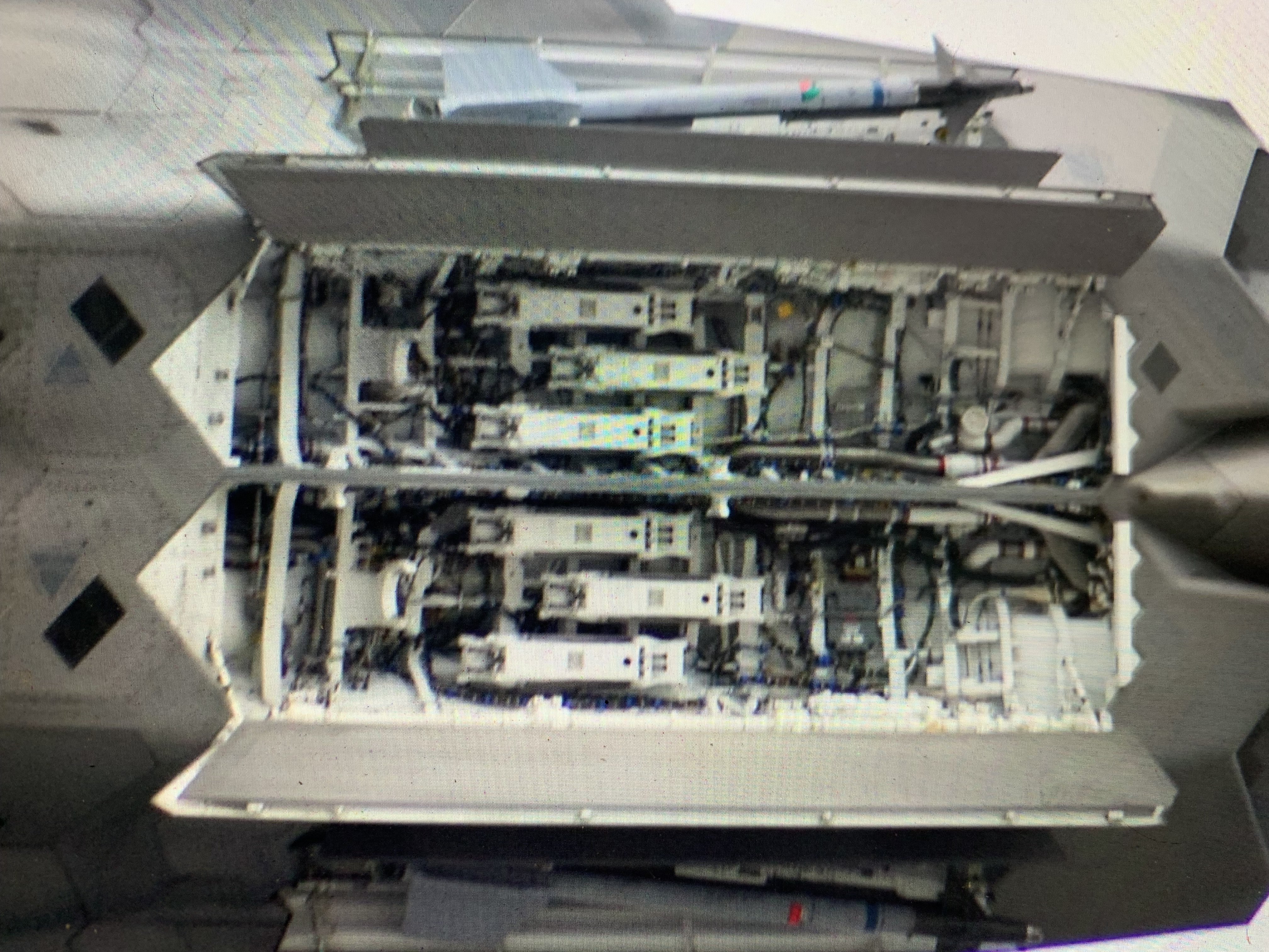

ExchefAndy Posted February 2 Share Posted February 2 Please excuse the rubbish photo, but would this image be of any use? Andy Quote Link to post Share on other sites
Raptor.777 Posted February 3 Author Share Posted February 3 2 hours ago, ExchefAndy said: Please excuse the rubbish photo, but would this image be of any use? Andy Thank you, but I'm not seeing the part in question. Maybe Hasegawa had a typo Jeff Quote Link to post Share on other sites
ExchefAndy Posted February 3 Share Posted February 3 I've just downloaded the kit instructions, and I can see roughly where it goes. The problem is the photo above, and further illustrations showing placement of the under carriage... this piece is absent! I'd not bother with it, but that's just me🙃 Sorry I couldn't help you out further Andy Quote Link to post Share on other sites
Raptor.777 Posted February 3 Author Share Posted February 3 1 hour ago, ExchefAndy said: I've just downloaded the kit instructions, and I can see roughly where it goes. The problem is the photo above, and further illustrations showing placement of the under carriage... this piece is absent! I'd not bother with it, but that's just me🙃 Sorry I couldn't help you out further Andy That's what I was thinking to Thanks Jeff Quote Link to post Share on other sites

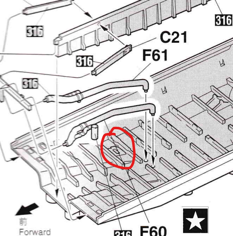

flanker27 Posted February 3 Share Posted February 3 From the instructions from scalemates, I think it goes into this part here? Quote Link to post Share on other sites
Raptor.777 Posted February 4 Author Share Posted February 4 3 hours ago, flanker27 said: From the instructions from scalemates, I think it goes into this part here? Thats it! Keen eye. My instructions do not look like this one. My instructions show the main center beam in place and really doesn't show that area all that well. Thank you sir Jeff Quote Link to post Share on other sites
