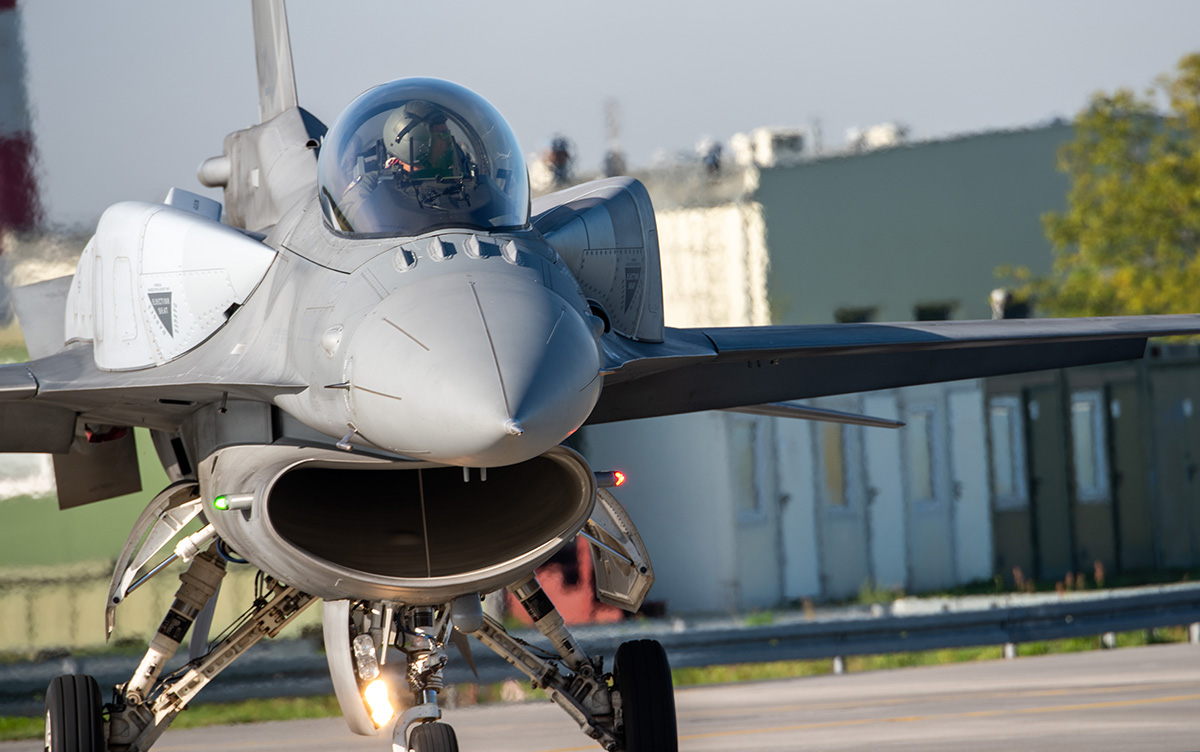

gb_madcat_sl Posted February 19, 2025 Share Posted February 19, 2025 (edited) On 2/17/2025 at 3:42 AM, F4DPhanv3 said: Gentlemen: So for particulars of my 1/48th build, I'm currently planning on using the Kinetic kit K48007 and Zotz decals sheet ZTX48016 for a RSAF F-16D while deployed at Cannon AFB (1990's?) for aircrew training. Have been using Jake Melampy's excellent book, ' The Modern Viper Guide, 2nd edition: The 16C/D Exposed.....great reference, as it has many photos/comments on RSAF F-16D's. 1. Understand NCI/Smallmouth intakes. I guess there is a 'bump' in the intake to accomadate the heavier nose landing gear, but hardly think it will be visible in 1/48th scale. Anyone have recommendations for aftermarket seamless intake for this kit? 2. Cockpit: was going to try to fit the Quinta F-16D 'decal' to the Kinetic kit with some modifications; understand there is a HUD repeater in rear cockpit; any recommendation for cockpit detail sets and after market correct ejection seats? Any recommended Eduard detail/PE sets to consider? 3. RHAW antenna/lumps & bumps: any thoughts/recommendation for additional lumps/bumps that need to be added and/or removed from stock Kinetic kit? 4. LANTIRN/NAV Pods: for the intake mounted LANTIRN & NAV Pods, can I use the Eduard AN/AAQ-14 & An/AAQ-13 pods? 5. Landing gear/landing gear doors: assume heavier/larger nose wheels & Main wheels and enlarged landing gear doors for each? Any aftermarket recommendations? 6. Since portraying an RSAF aircraft while deployed at Cannon for training, what would be a reasonable set of ordnance loads to display? ...would like to have both LANTIRN & NAV pods on....... Appreciate everyones thoughts and recommendations! Thanks! Mike 1. No need for the small bump in the intake. The only Ds with the bump are D+s aka the Sufa to accommodate its beefier nose tire. The bump can be seen in this photo of a D+: https://commons.wikimedia.org/wiki/File:RSAF_F-16D_Block_52%2B_Fighting_Falcon_with_Conformal_Fuel_Tanks_04.jpg 2. Quinta cockpit set. Resin or 3D printed seats from any of your favourite brands 3. Nil. But do look at reference photos for the correct lumps and bumps to attach. In general, the RSAF Ds are pretty slick in this regard compared to say Greek or Polish examples 4. Yes, RSAF Ds operated with the LANTIRN system. These have now been replaced by Sniper XR 5. They're provided in the kit. Unsure what aftermarket is available for these 6. Blue (inert) GUB-10s or 12s. CATM-9Ms, ACMI pods if at the range. No AMRAAM. Detachment at Cannon pre-dated the release of AMRAAM to the RSAF by the US. As such, use only 16S210 rails for both underwing pylons and wing tip stations. Hope this helps! Looking forward to seeing your build. Edited February 19, 2025 by gb_madcat_sl Quote Link to post Share on other sites

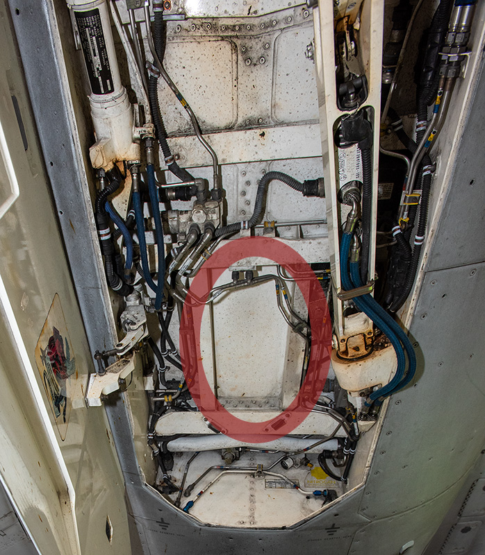

potez Posted February 20, 2025 Share Posted February 20, 2025 (edited) On 2/19/2025 at 3:06 PM, gb_madcat_sl said: 1. No need for the small bump in the intake. The only Ds with the bump are D+s aka the Sufa to accommodate its beefier nose tire. The bump can be seen in this photo of a D+: https://commons.wikimedia.org/wiki/File:RSAF_F-16D_Block_52%2B_Fighting_Falcon_with_Conformal_Fuel_Tanks_04.jpg I can not agree because every heavy gear F-16 have bump inside ( see F-16C Block 52 photo.) This very bump is space for fork while folding fatter front undercarriage . A view of the space from inside is marked with red oval Edited February 20, 2025 by potez Quote Link to post Share on other sites
habu2 Posted February 20, 2025 Share Posted February 20, 2025 If the jet is capable of carrying CFTs then it will have the intake bump. The CFTs require the increased strength/size landing gear over non-CFT capable jets. Quote Link to post Share on other sites
gb_madcat_sl Posted February 23, 2025 Share Posted February 23, 2025 428FS jets at Cannon were not CFT-capable so no intake bump. Quote Link to post Share on other sites
