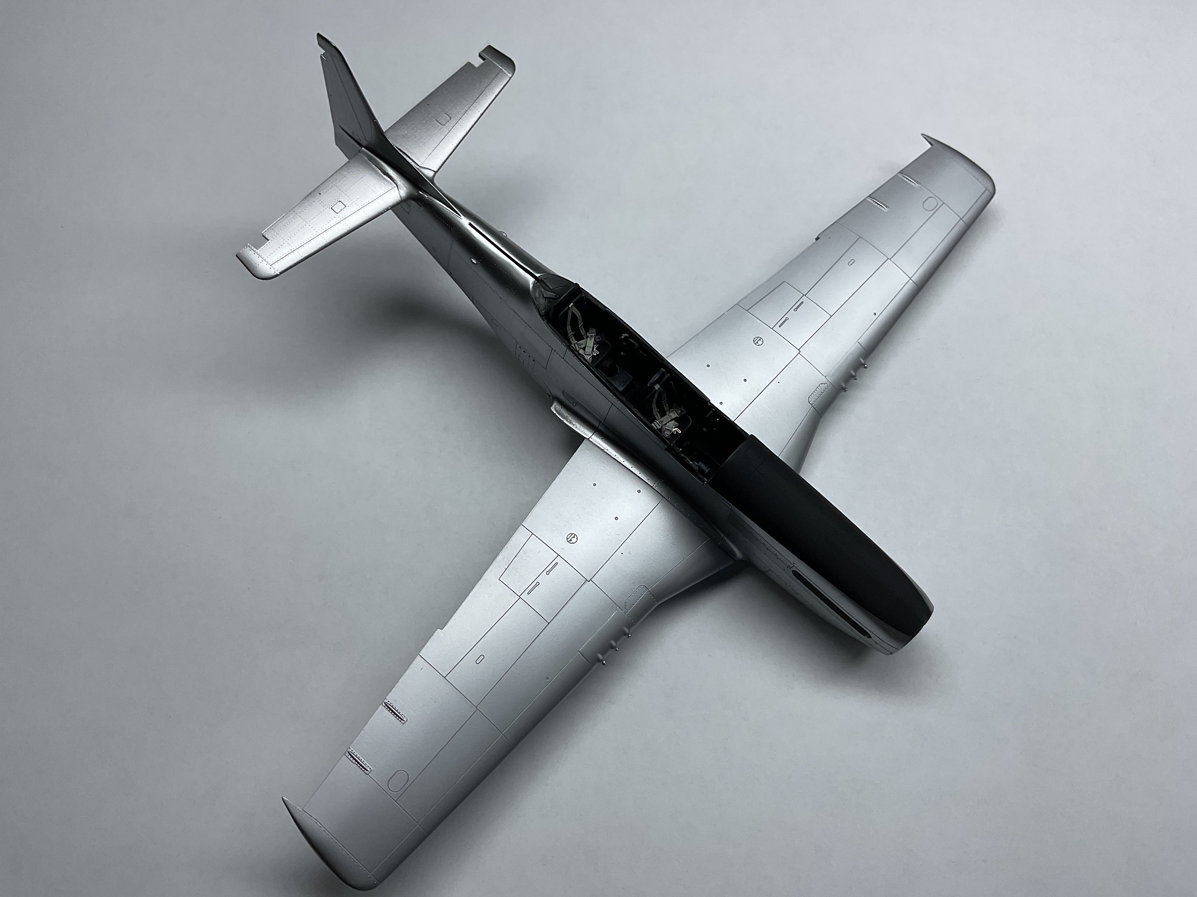

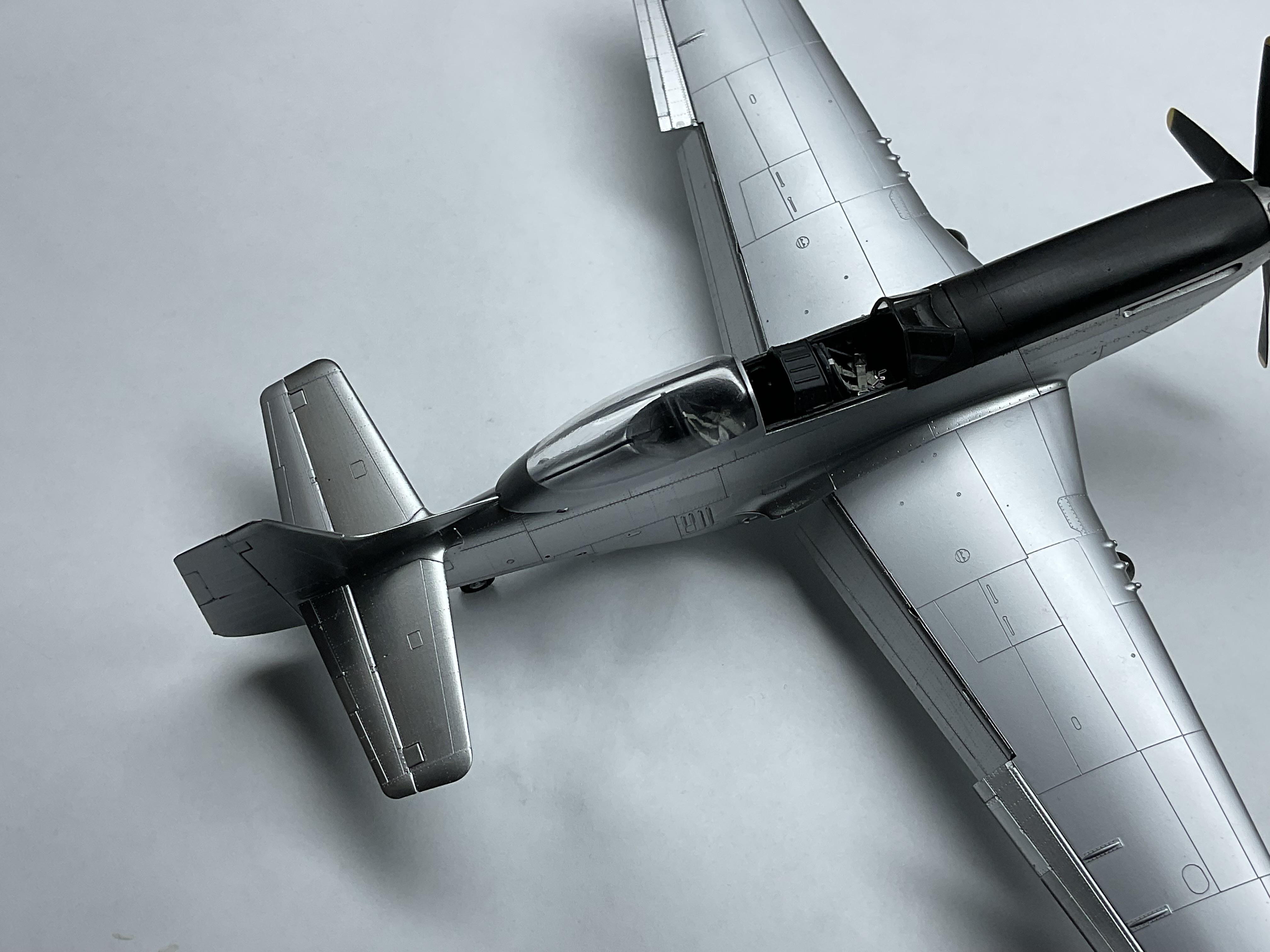

dai phan Posted March 13, 2025 Author Share Posted March 13, 2025 (edited) Howdy all, Added the anti glare panel tonight and did some touch ups. Dai Edited March 13, 2025 by dai phan Quote Link to post Share on other sites

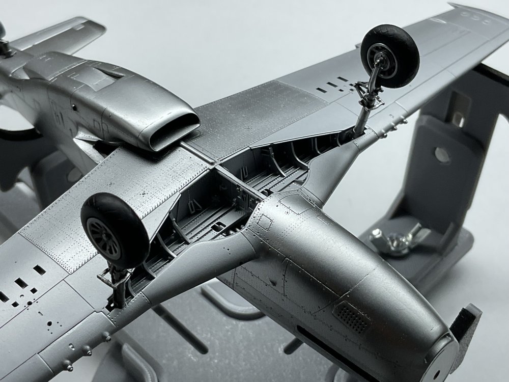

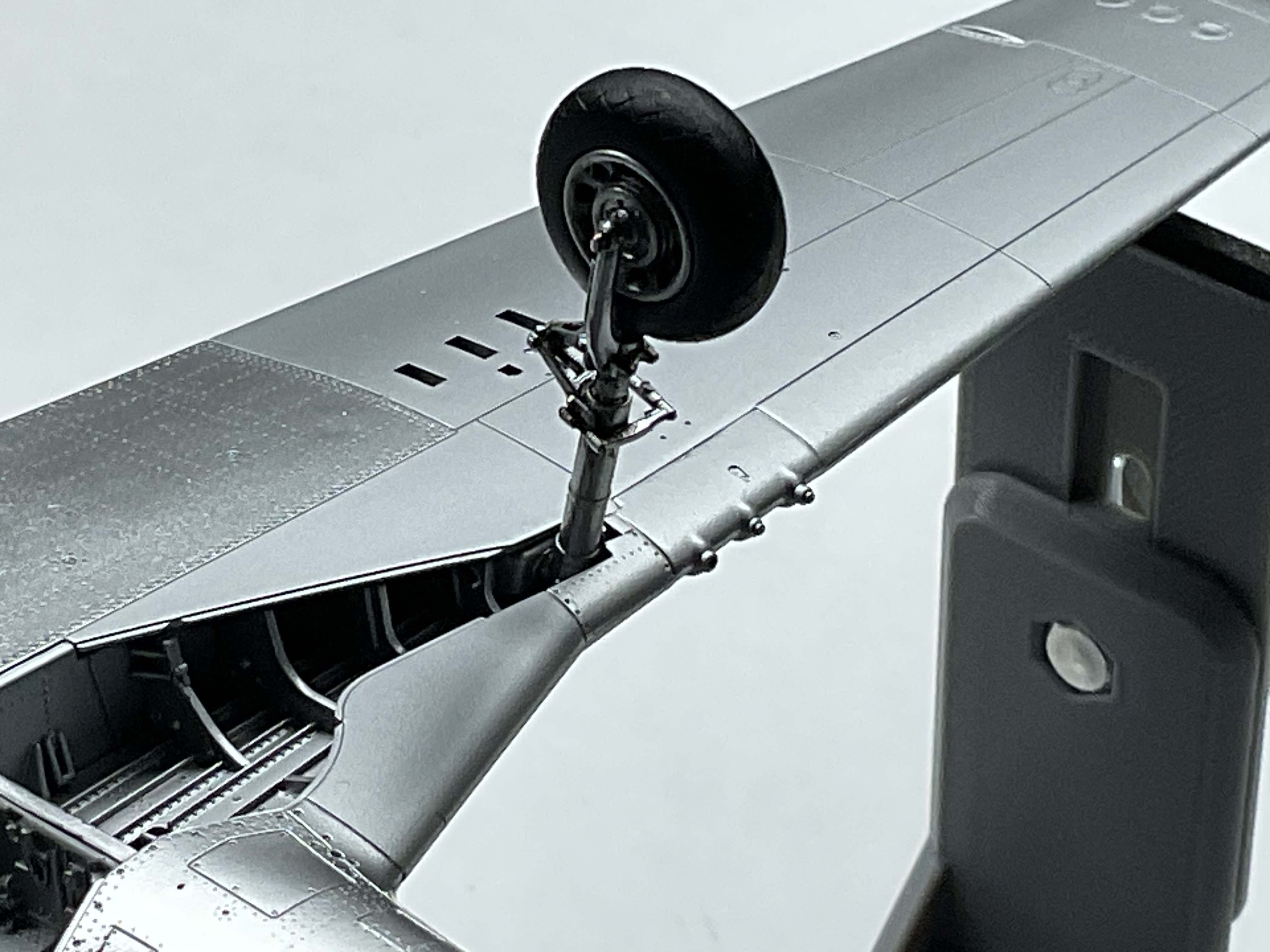

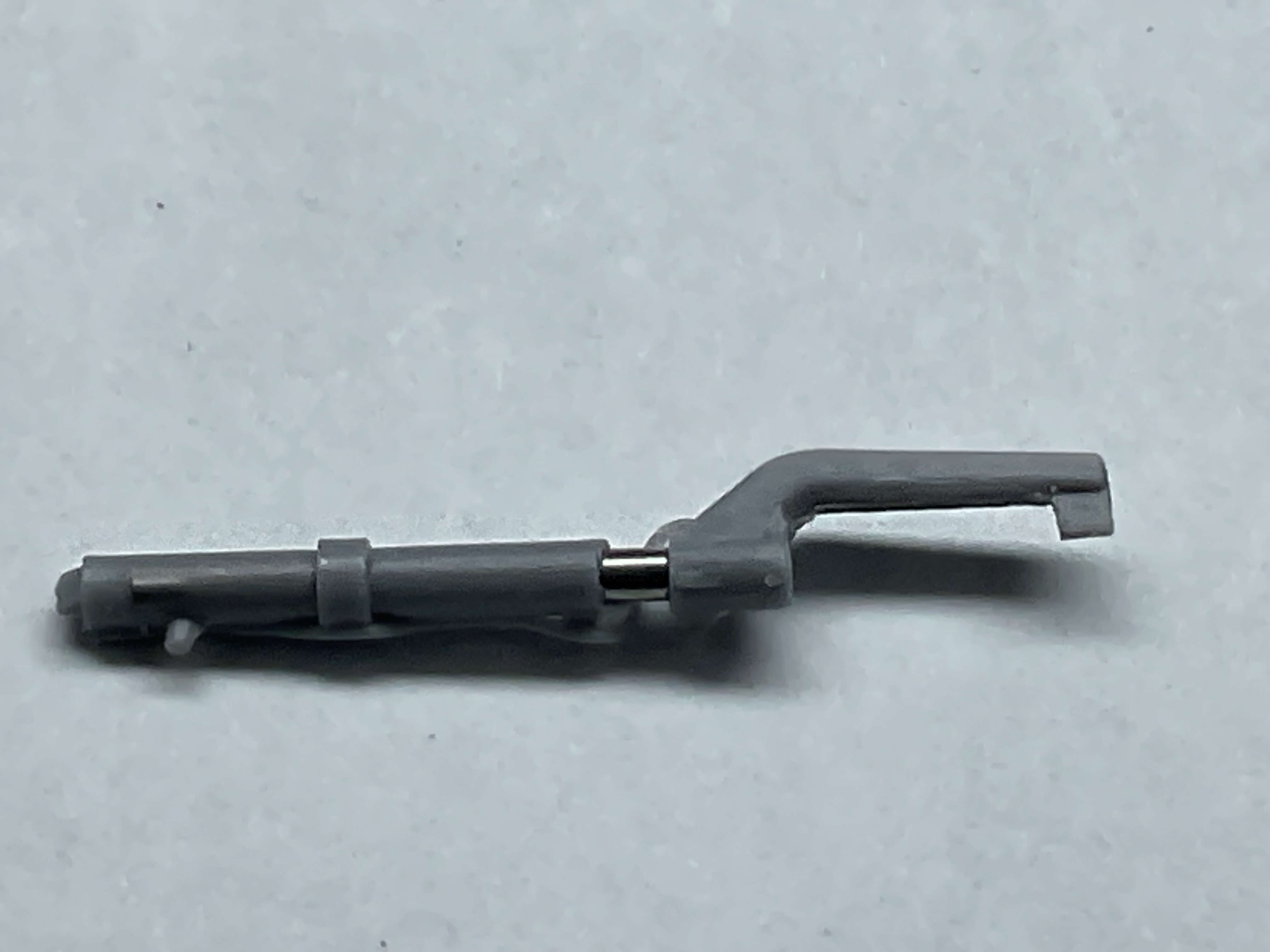

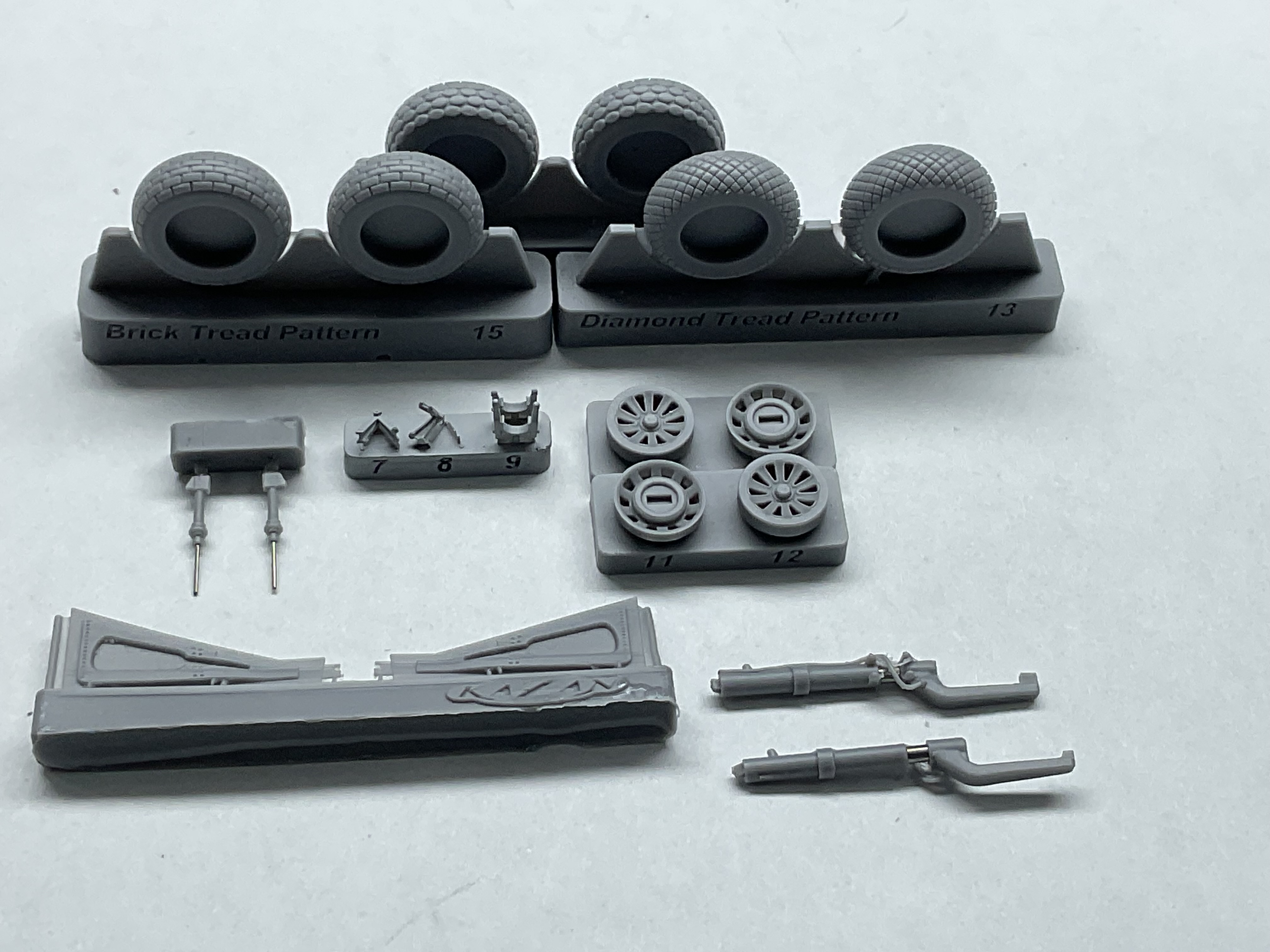

dai phan Posted March 14, 2025 Author Share Posted March 14, 2025 (edited) Greetings, I got both the Kazan (resin) and Eduard’ bronze landing gears. Much better than stock gears. The Kazan gears are designed to go into its resin wheel hubs rather than Eduard’s.Kazan connecting point to the hub is rectangular while the Eduard’s is round. Some minor mods will be needed should you want to use Kazan with Eduard’s wheels. I ended up using the Eduard’s brass version as the gears have the struts casted in. However the resin Kazan is more to scale. If you are building the Eduard’s kit, spend a little more and get these after market gears. Dai Kazan gears. The tire thread detai is very sharp. Eduard's Brassin set. The struts are already molded in and this is what I ended up using. Some minor sandings with sanding stick is needed so they can go into the wheel wells. The surface appears pebbly but looks OK after a coat of paint. SAC also makes a metal set and these are nothing more than sub-standard copy of the kit's parts. Stay away from those. Edited March 14, 2025 by dai phan Quote Link to post Share on other sites

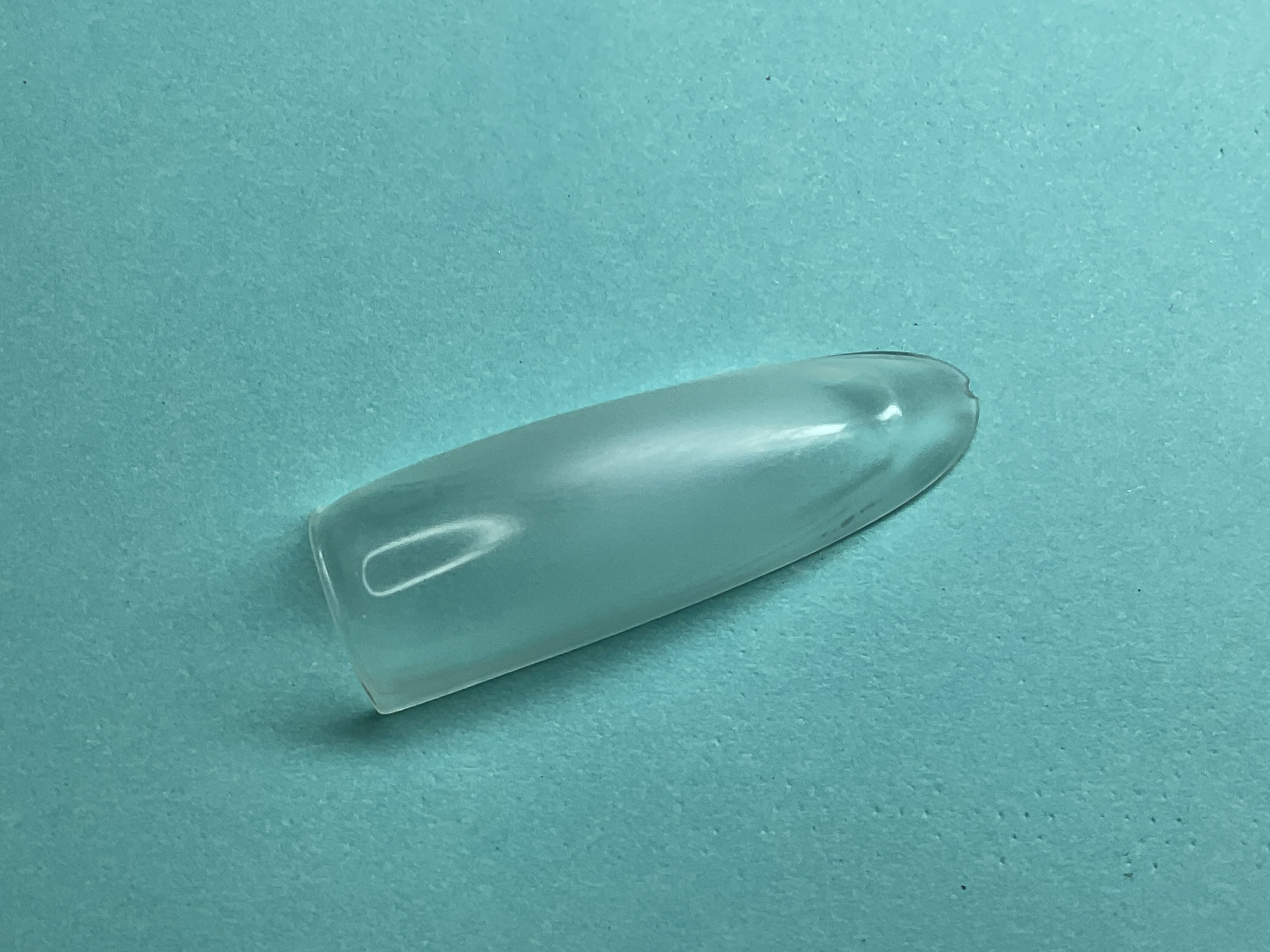

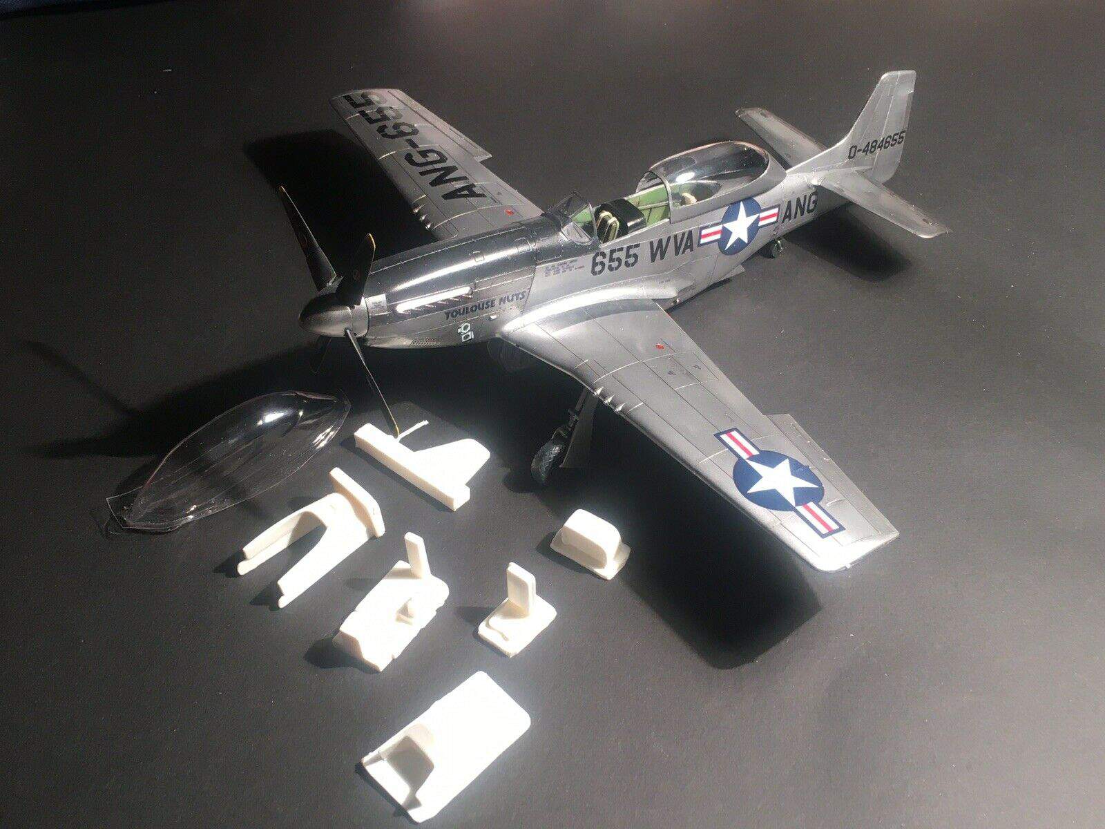

dai phan Posted March 15, 2025 Author Share Posted March 15, 2025 (edited) Helllo all, I simply cannot get the resin canopy to be polished. Polishing compounds only makes matter worse. Perhaps this type of clear resin is not meant to be polished and buffed? I have send email to Halberd about the issue. I am planning to duplicate a master then vacuum form it. That will give me a chance to correct the rear profile of the canopy too. Dai Edited March 15, 2025 by dai phan Quote Link to post Share on other sites

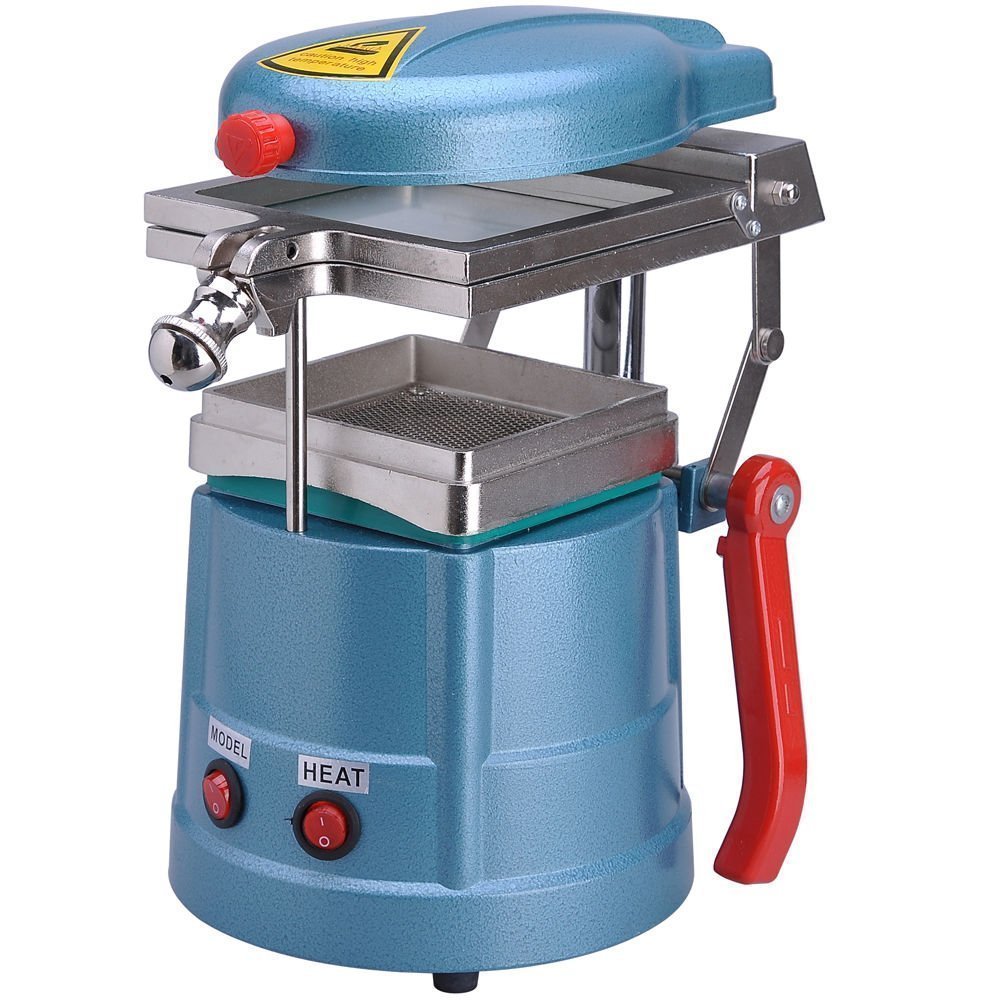

dai phan Posted March 15, 2025 Author Share Posted March 15, 2025 (edited) Howdy all, Just ordered this vacuum machine and I remember having used it before at my work place with great result. However this is likely to be cheap Chinese knock off version. I see it has good reviews on Amazon however. Dai Edited March 17, 2025 by dai phan Quote Link to post Share on other sites

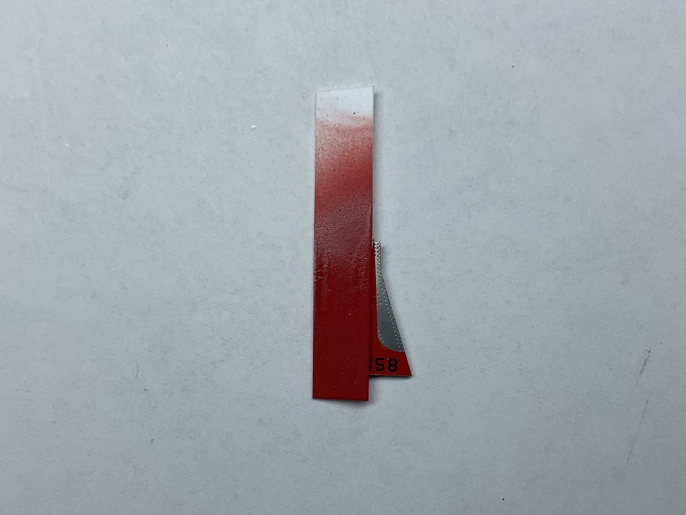

dai phan Posted March 17, 2025 Author Share Posted March 17, 2025 (edited) Hello all, I tried to match the red on the decal but still no go. I then decide to go for the West VA ANG but this bird has the retractable tail wheel which is not accurate for the conversion tooling. I will try to match the red again and this time, I will start with orange base then add the red. There is nothing worse than the red decals and the paint do not match. The photo shows I I added yellow to the red to get the orange hue to match the decal but still no go. It may look close here but after I painted the spinner the mismatch was still very evident. Dai Edited March 17, 2025 by dai phan Quote Link to post Share on other sites

Bob Beary Posted March 17, 2025 Share Posted March 17, 2025 On 3/14/2025 at 9:46 PM, dai phan said: Howdy all, Just ordered this vacuum machine and I remember having used it before at my work place with great result. However this is likely to be cheap Chinese knock off version. I see it has good reviews on Amazon however. Dai Yeah, those Buffalo Dental vacu-formers are indestructible! Quote Link to post Share on other sites

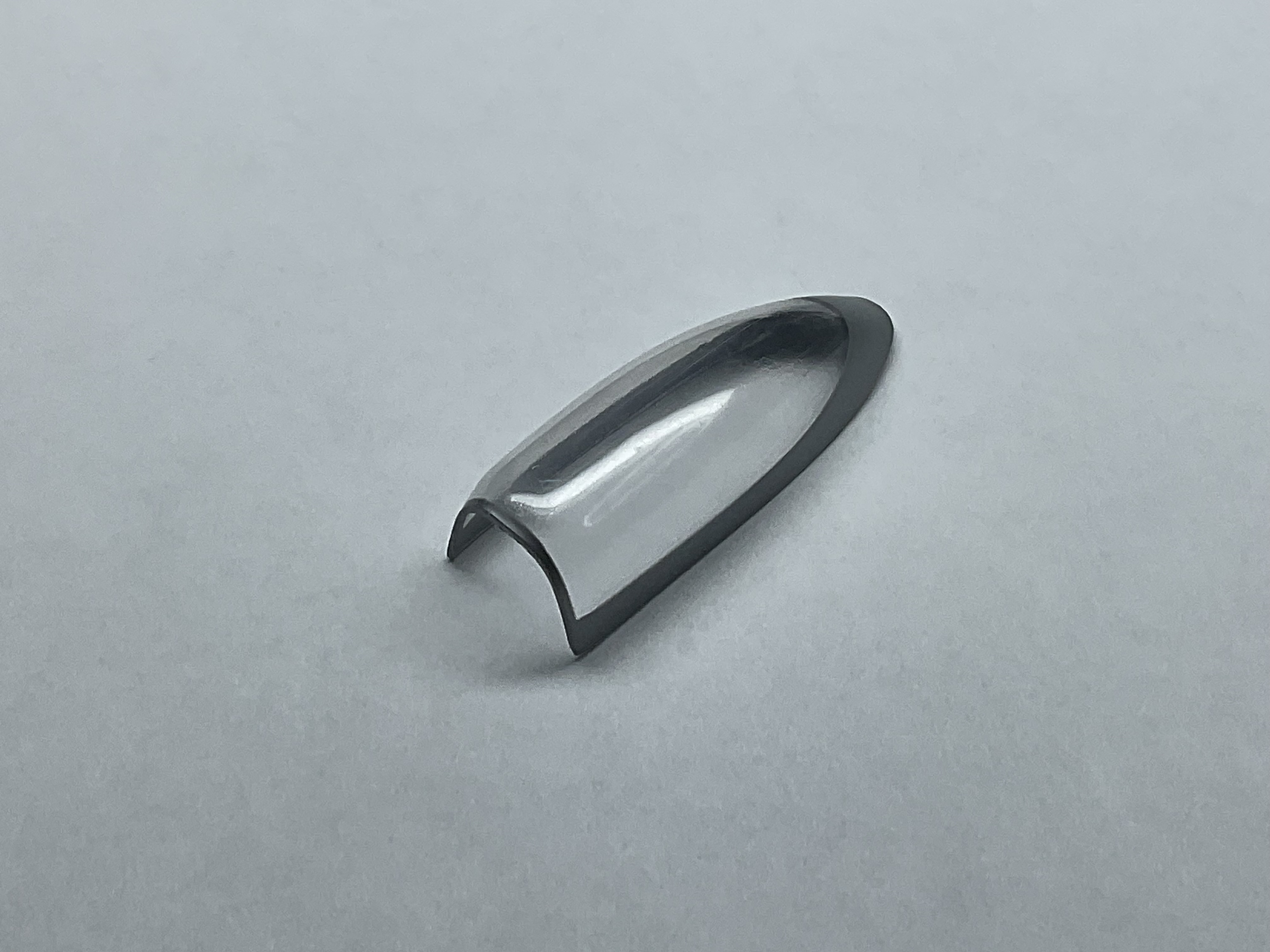

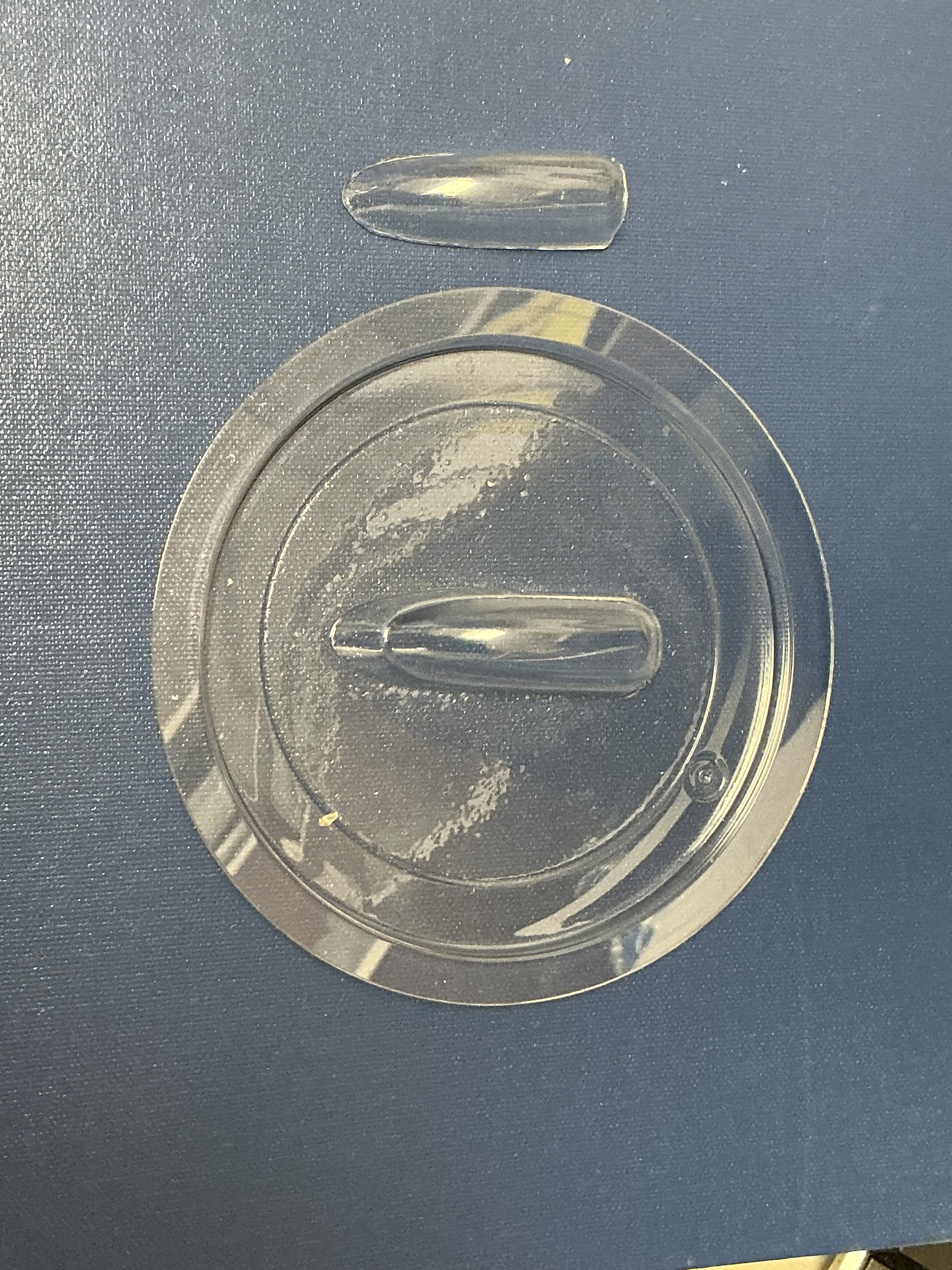

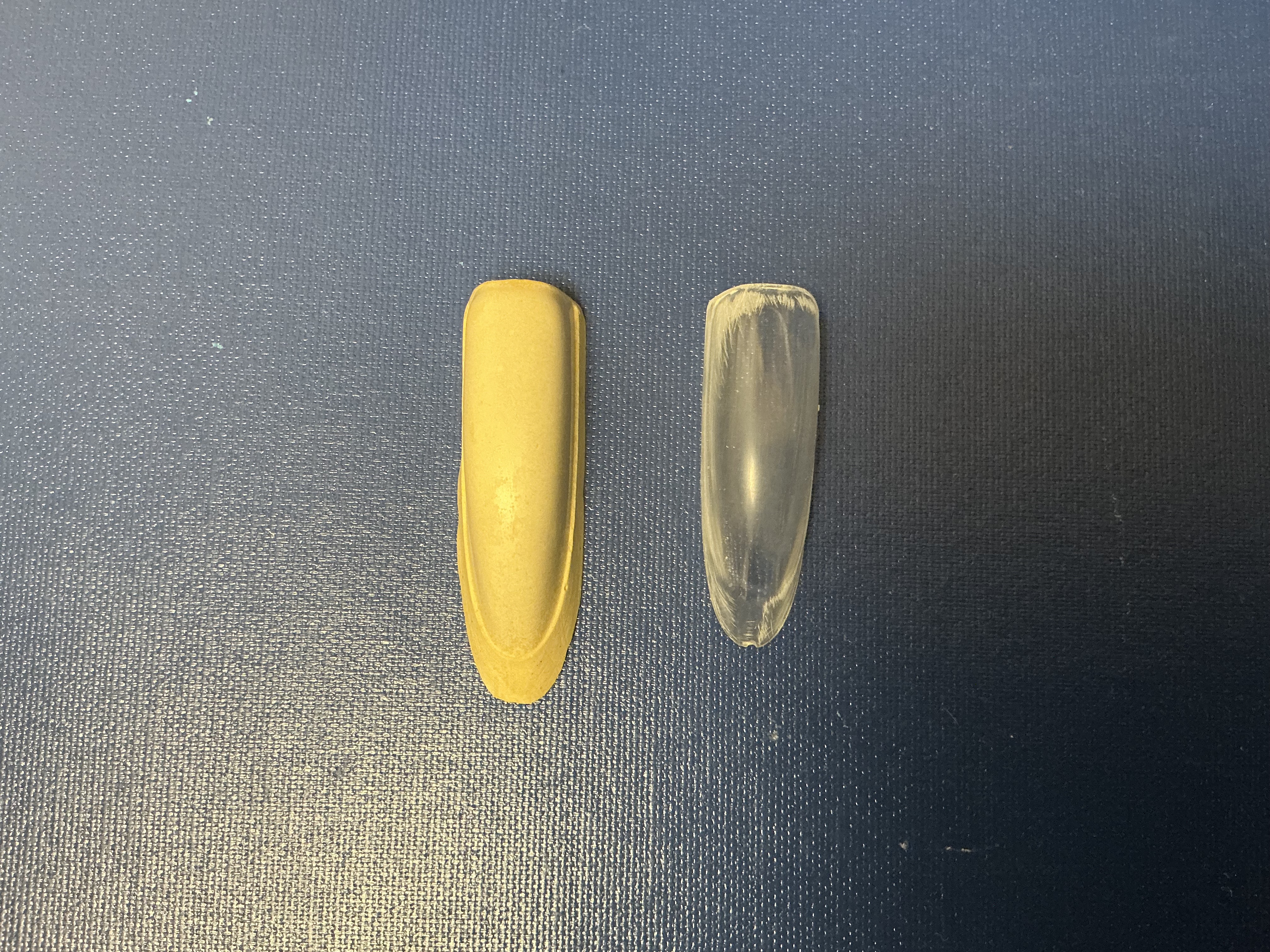

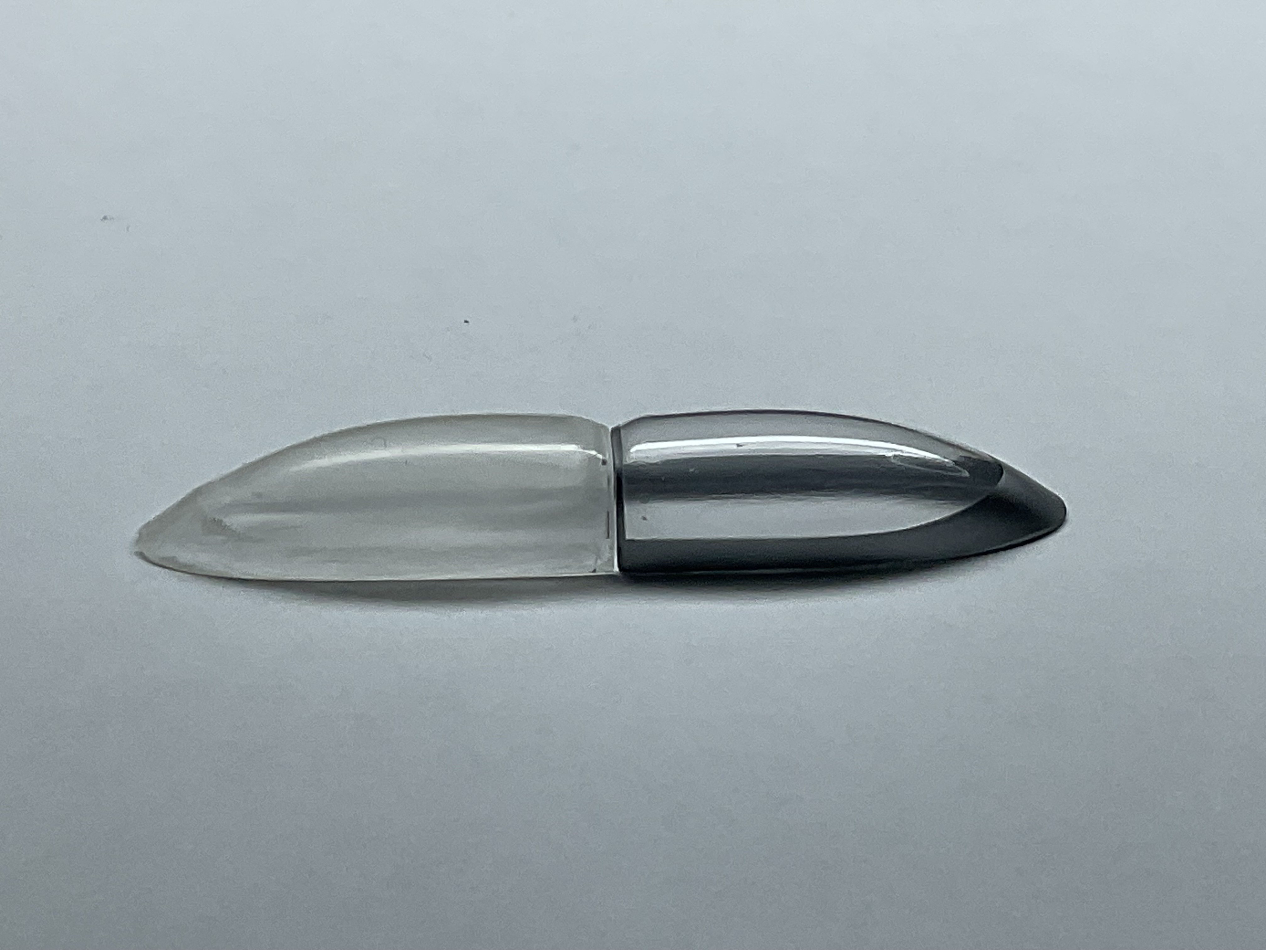

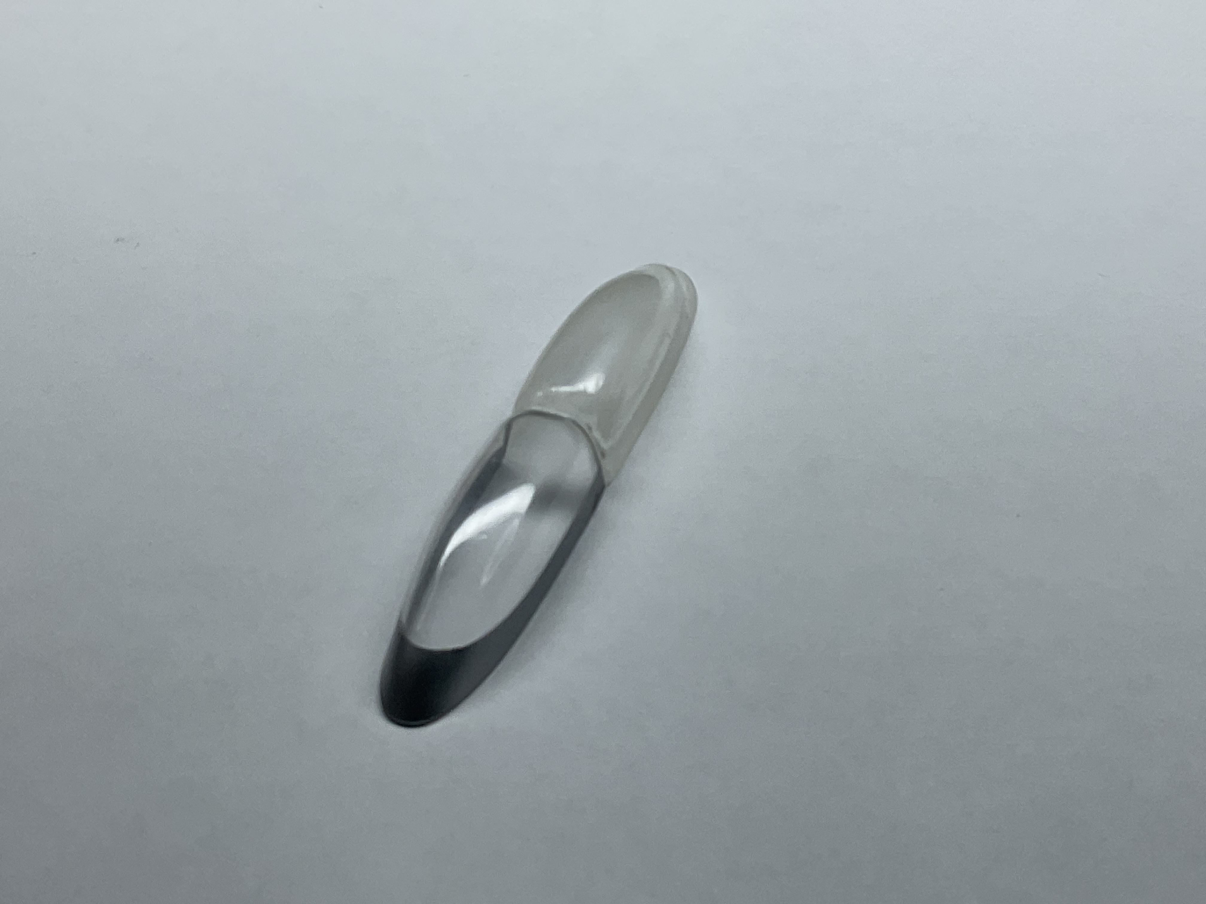

dai phan Posted March 17, 2025 Author Share Posted March 17, 2025 (edited) Hello all, I went to work and used the professional vacuum machine for fabrication of orthodontic retainers. I sealed all the sides of the master then pour the dental stone onto it to produce a master cast. Then I used the vacuum machine to produce canopies. When I get home tonight I will clean things up and see how that looks. Dai Edited March 18, 2025 by dai phan Quote Link to post Share on other sites

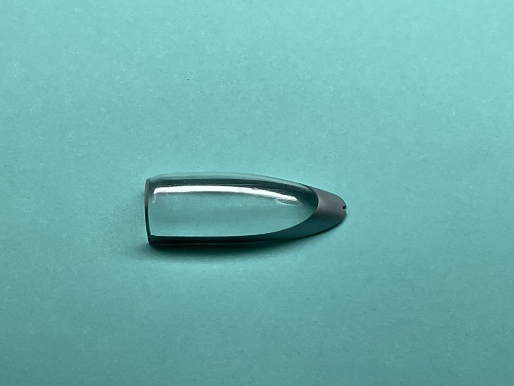

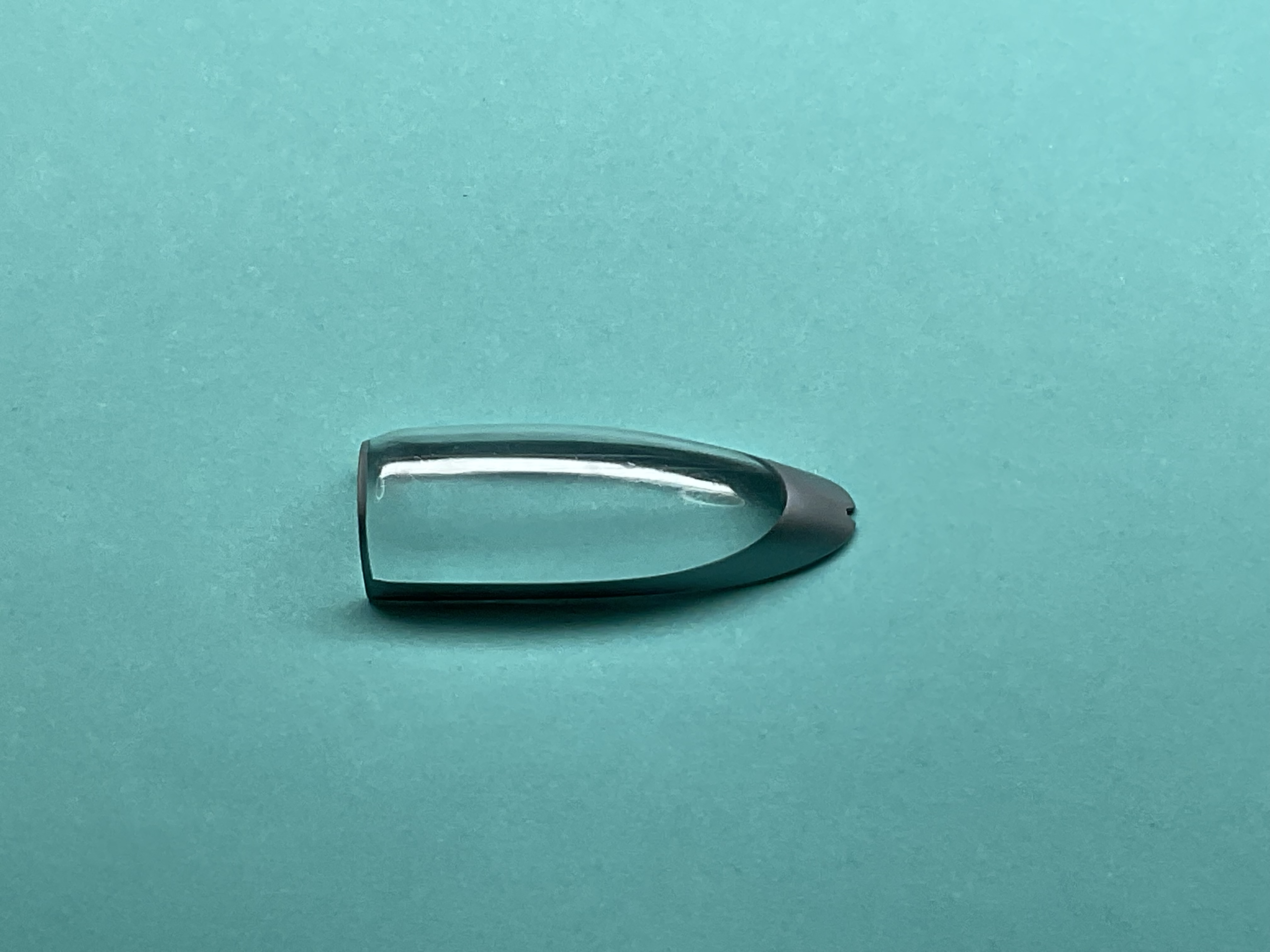

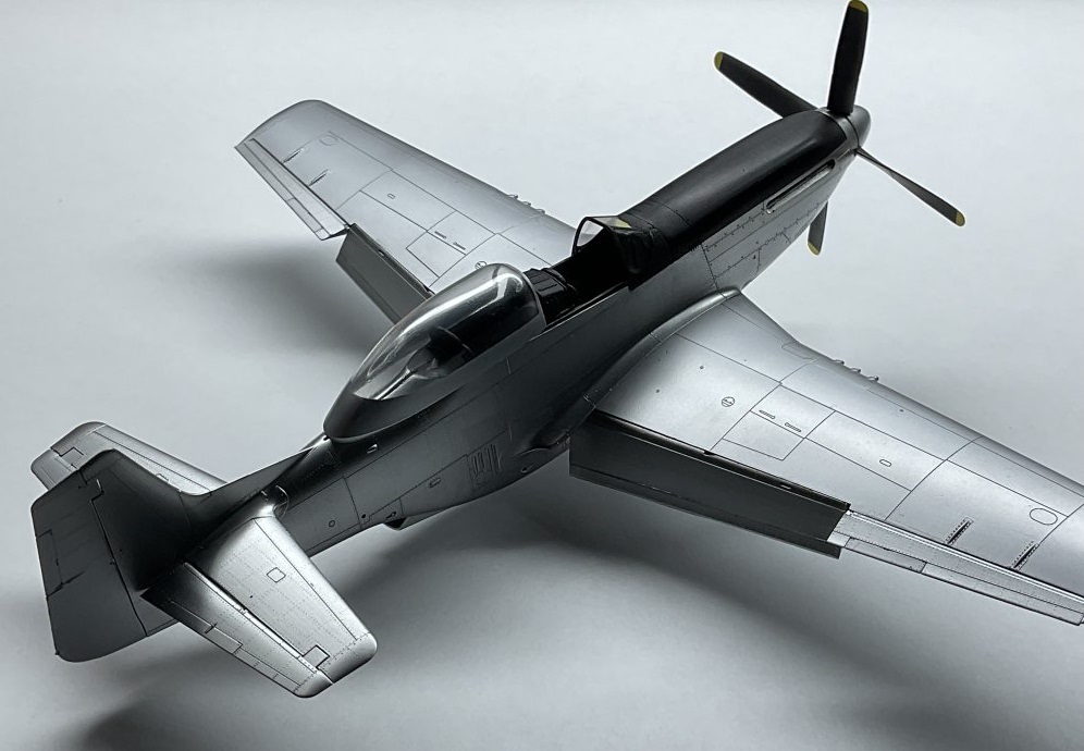

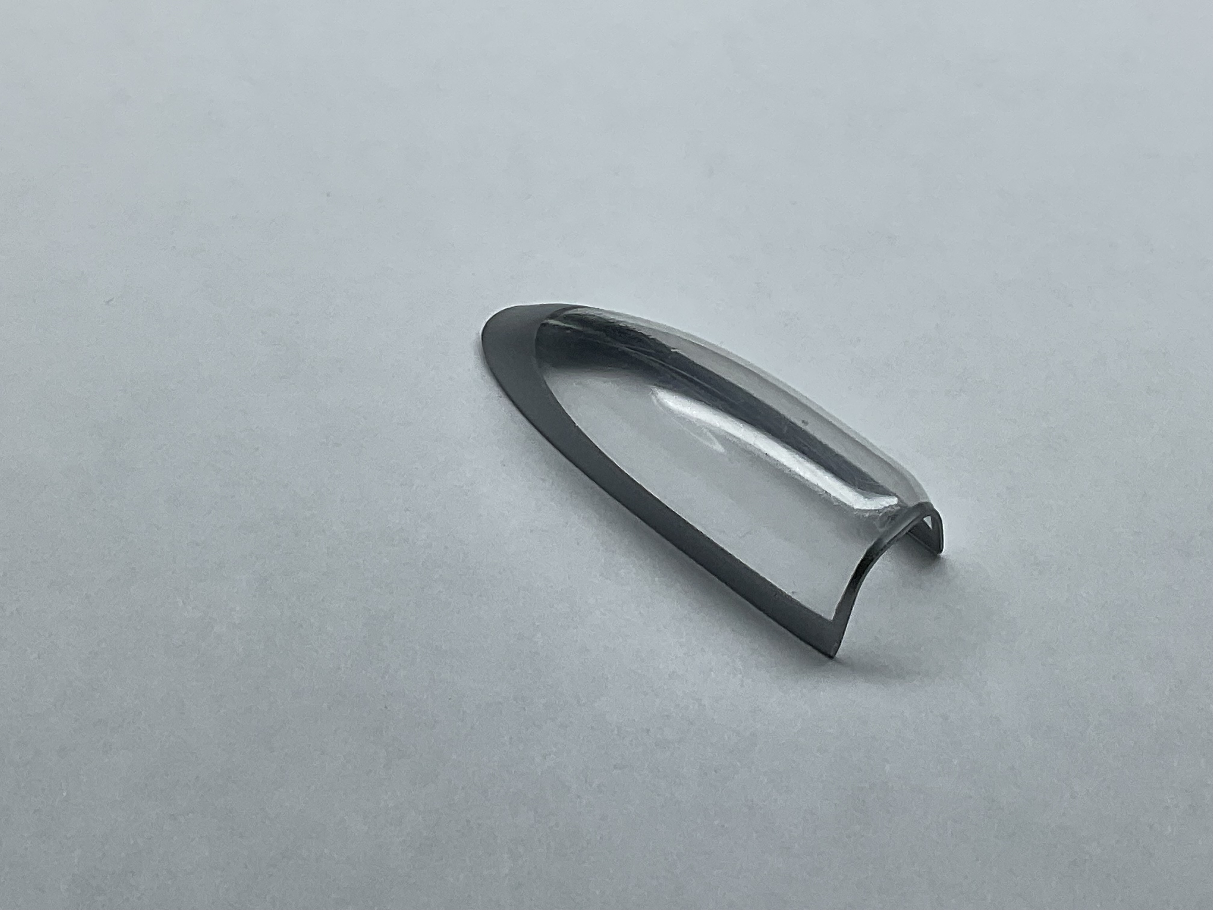

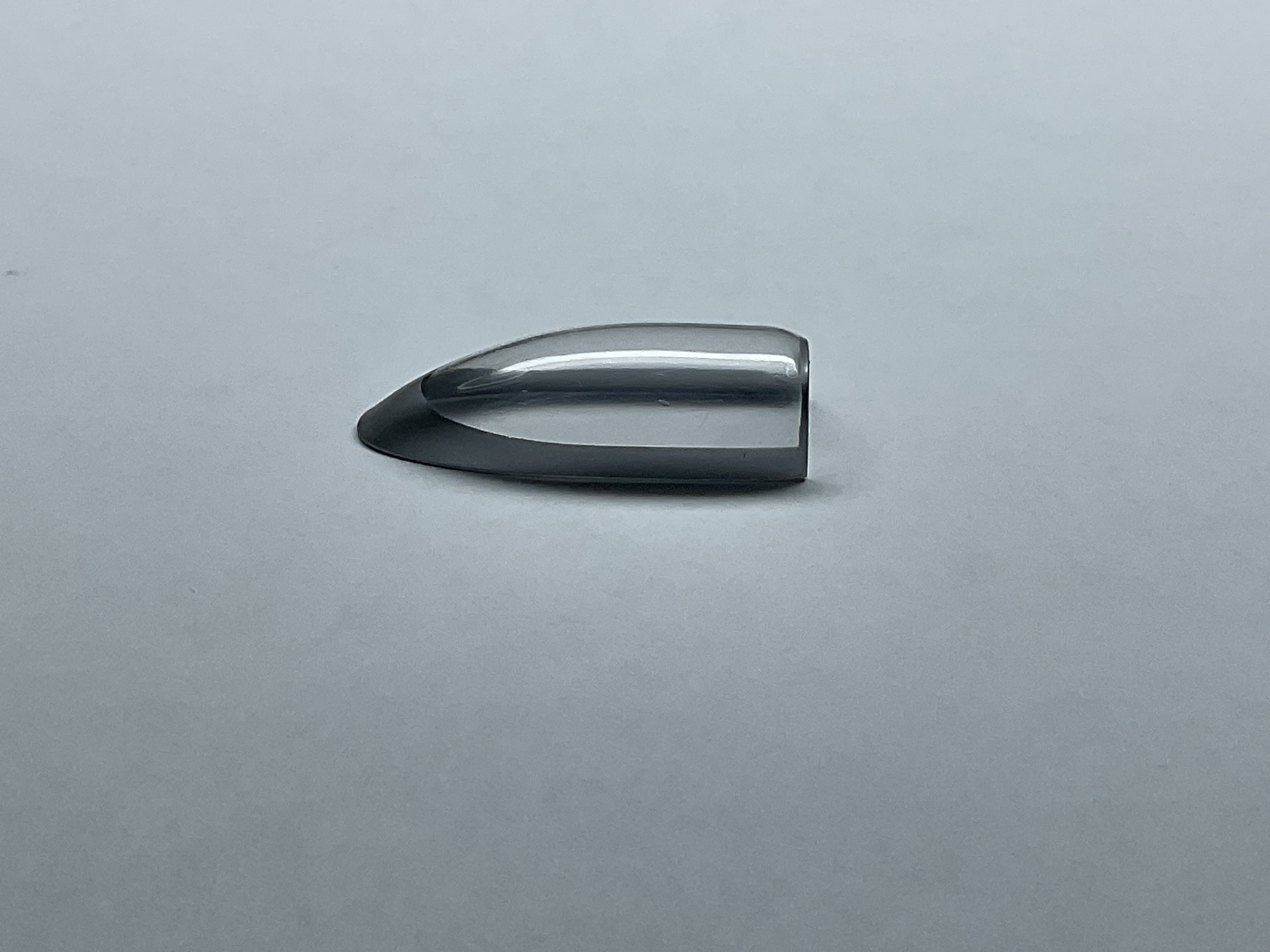

dai phan Posted March 18, 2025 Author Share Posted March 18, 2025 (edited) Hi all, Trimmed and painted the frame. Looks very good but not quite perfect as I hope. Will do couple more to see if they are any better. I took photos of the originial and the reproduction for comparision. Dai Edited March 18, 2025 by dai phan Quote Link to post Share on other sites

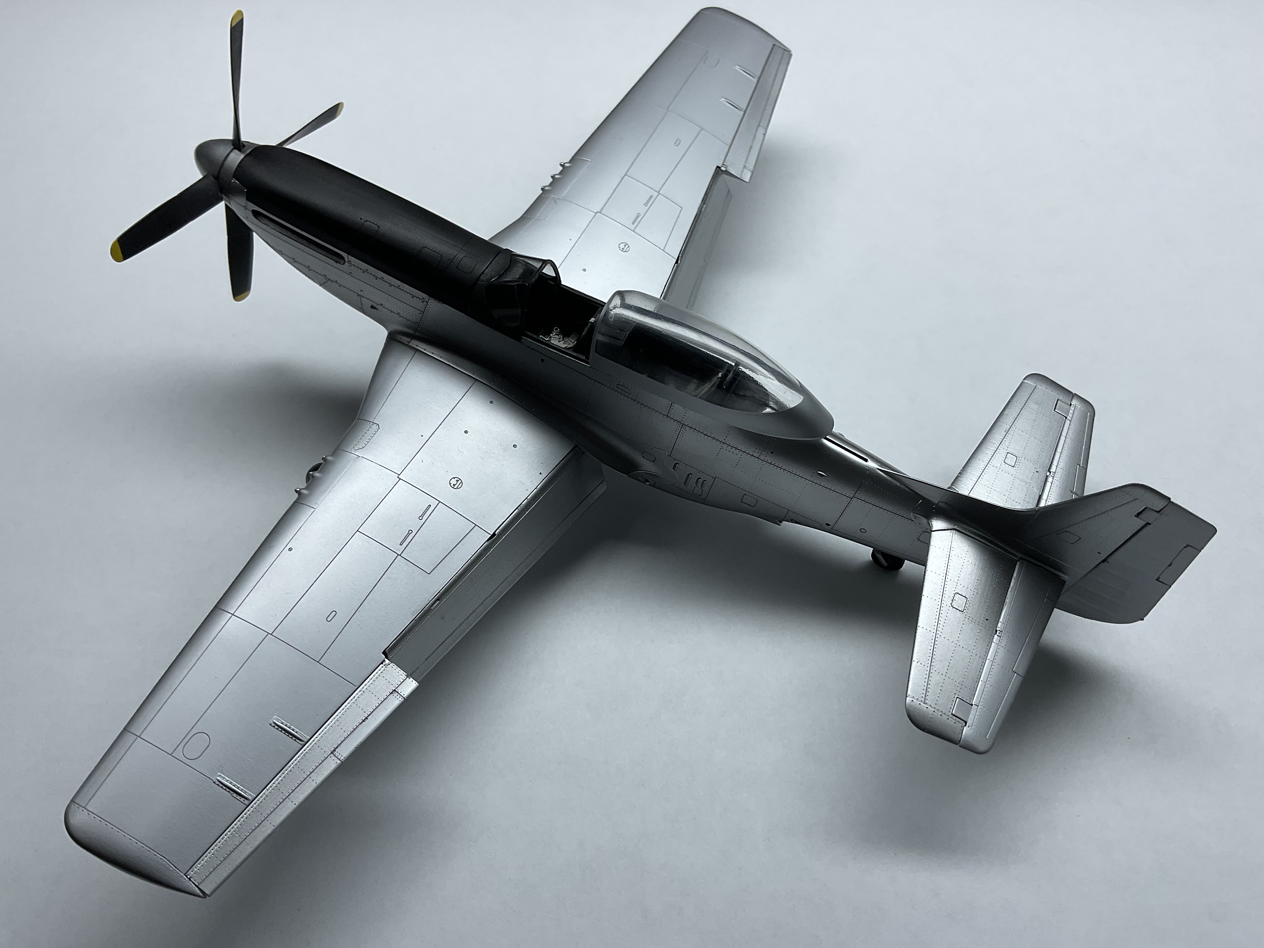

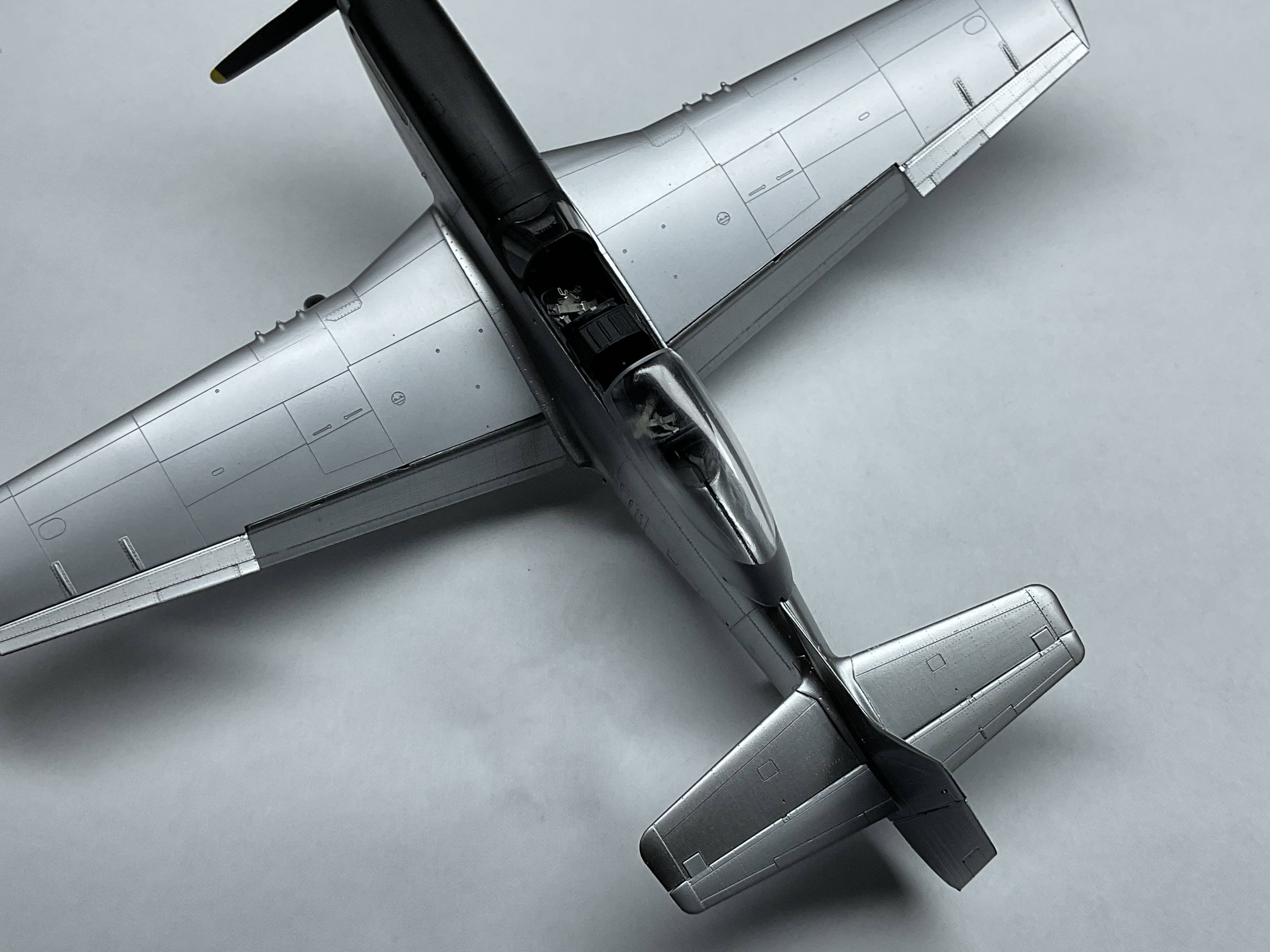

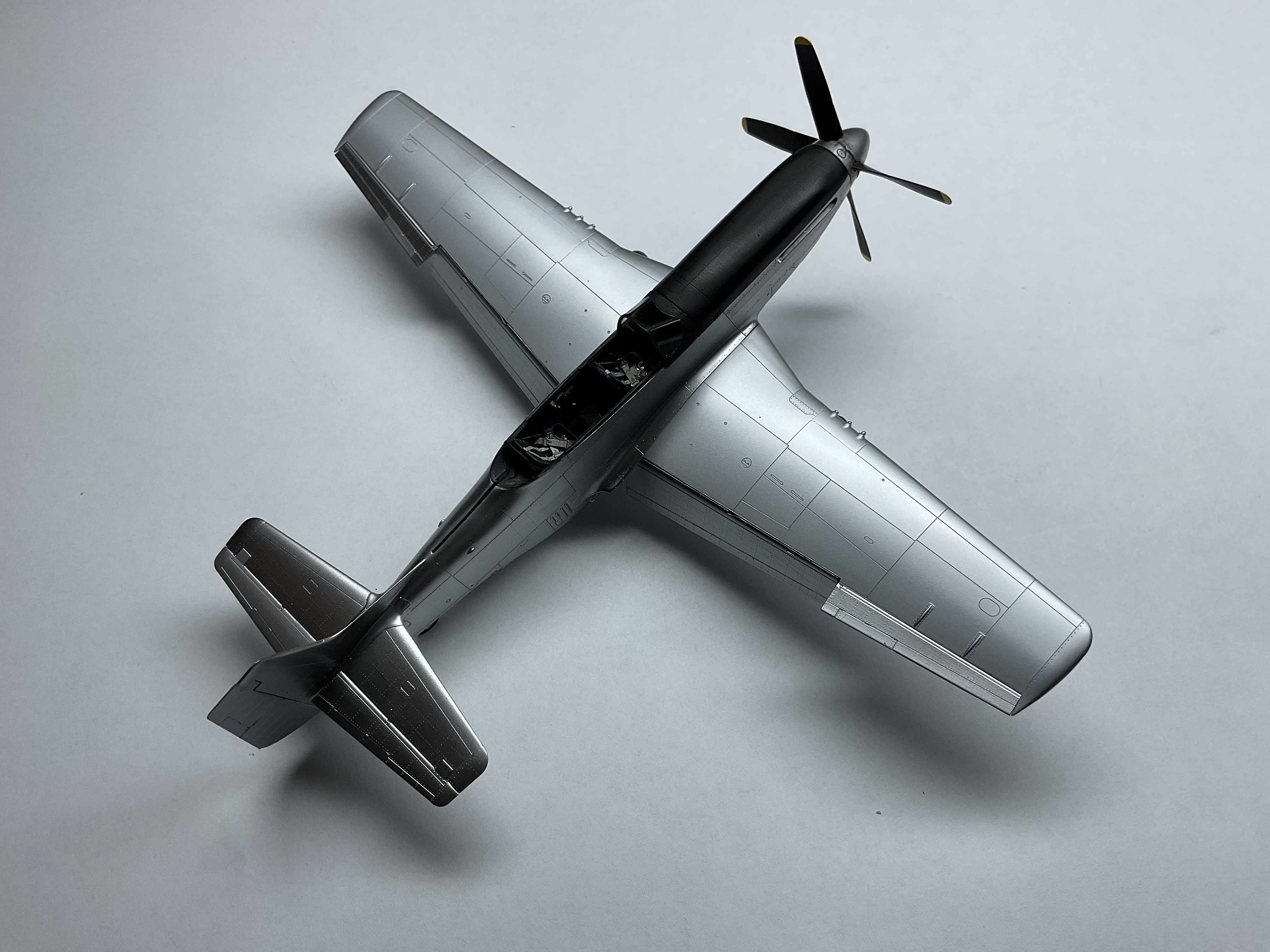

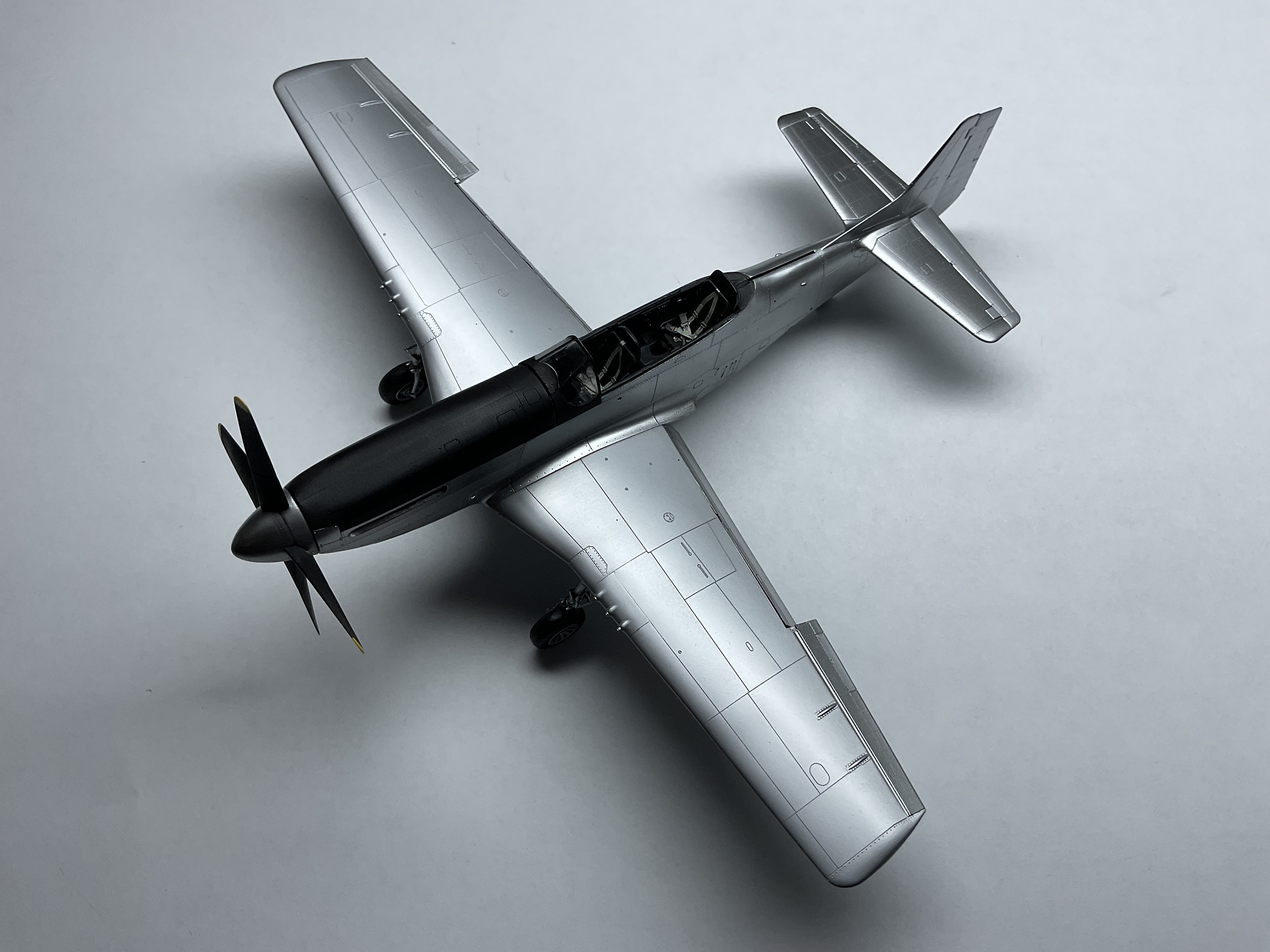

dai phan Posted March 18, 2025 Author Share Posted March 18, 2025 (edited) The two seater variant is taking shape. Dai Edited March 18, 2025 by dai phan Quote Link to post Share on other sites

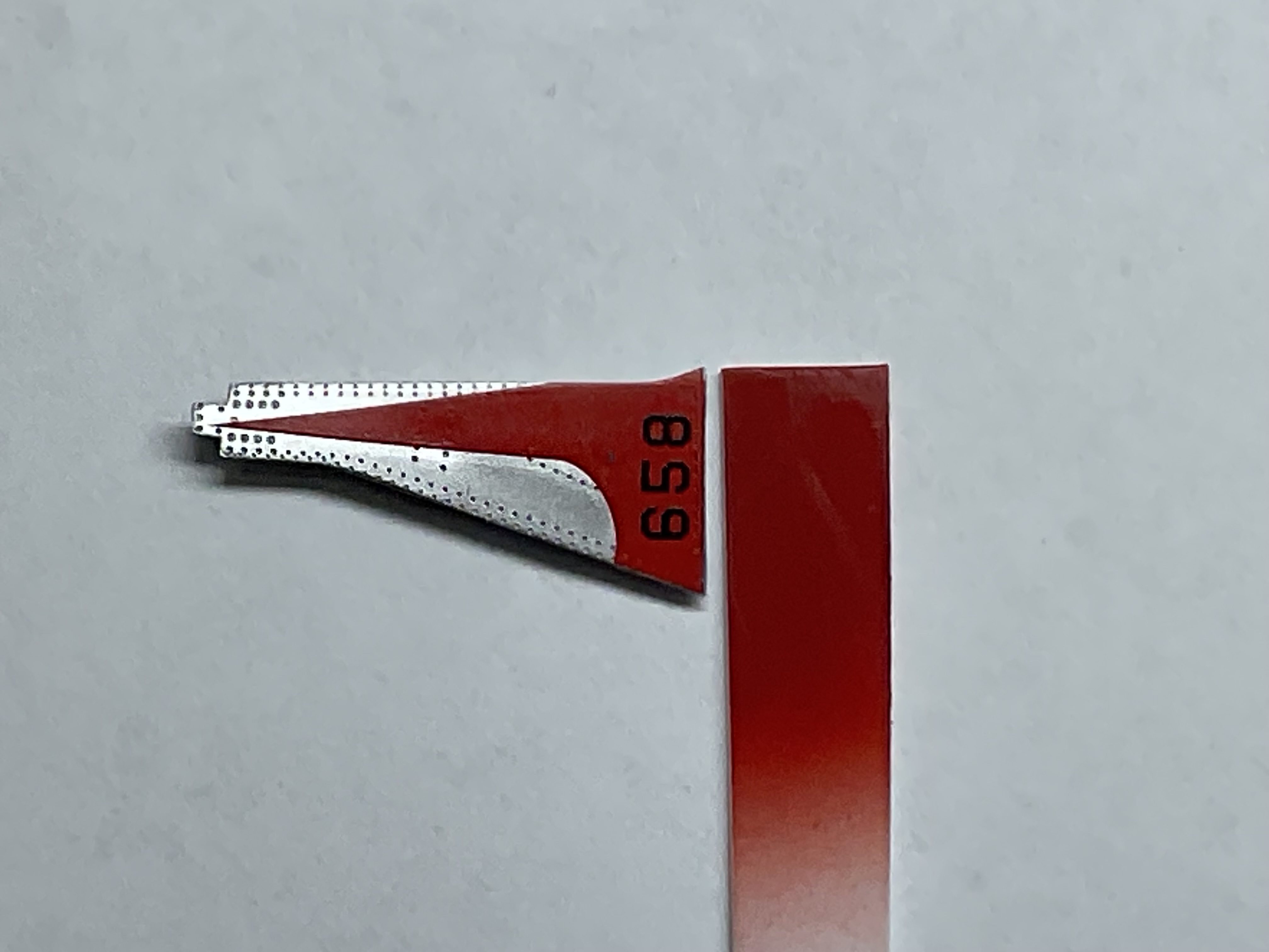

dai phan Posted March 21, 2025 Author Share Posted March 21, 2025 (edited) Hi all, The paints have arrived. Will try to match the red on the decals tonight. The red has a slight orange hue that is hard to duplicate. Dai Edited March 21, 2025 by dai phan Quote Link to post Share on other sites

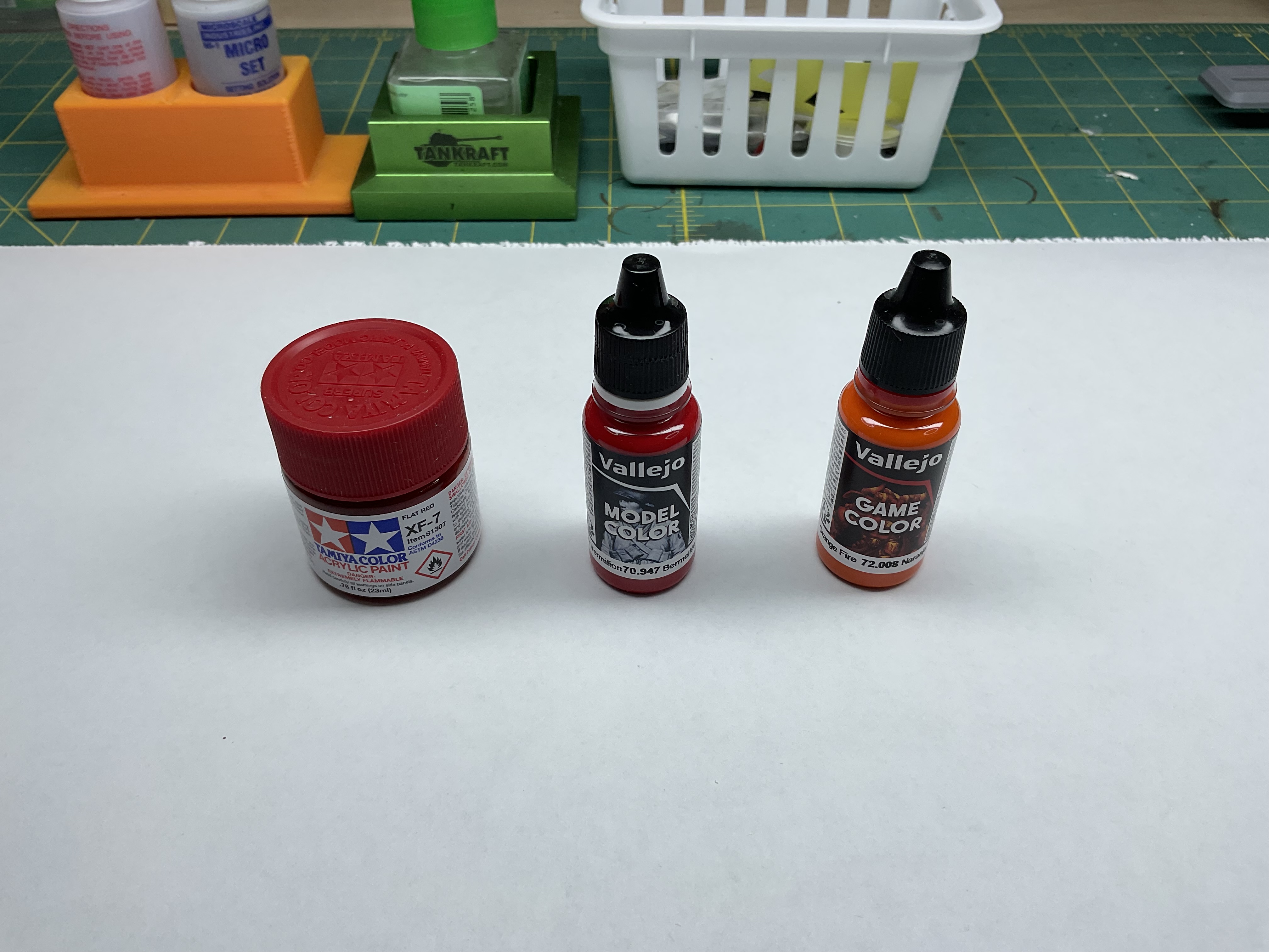

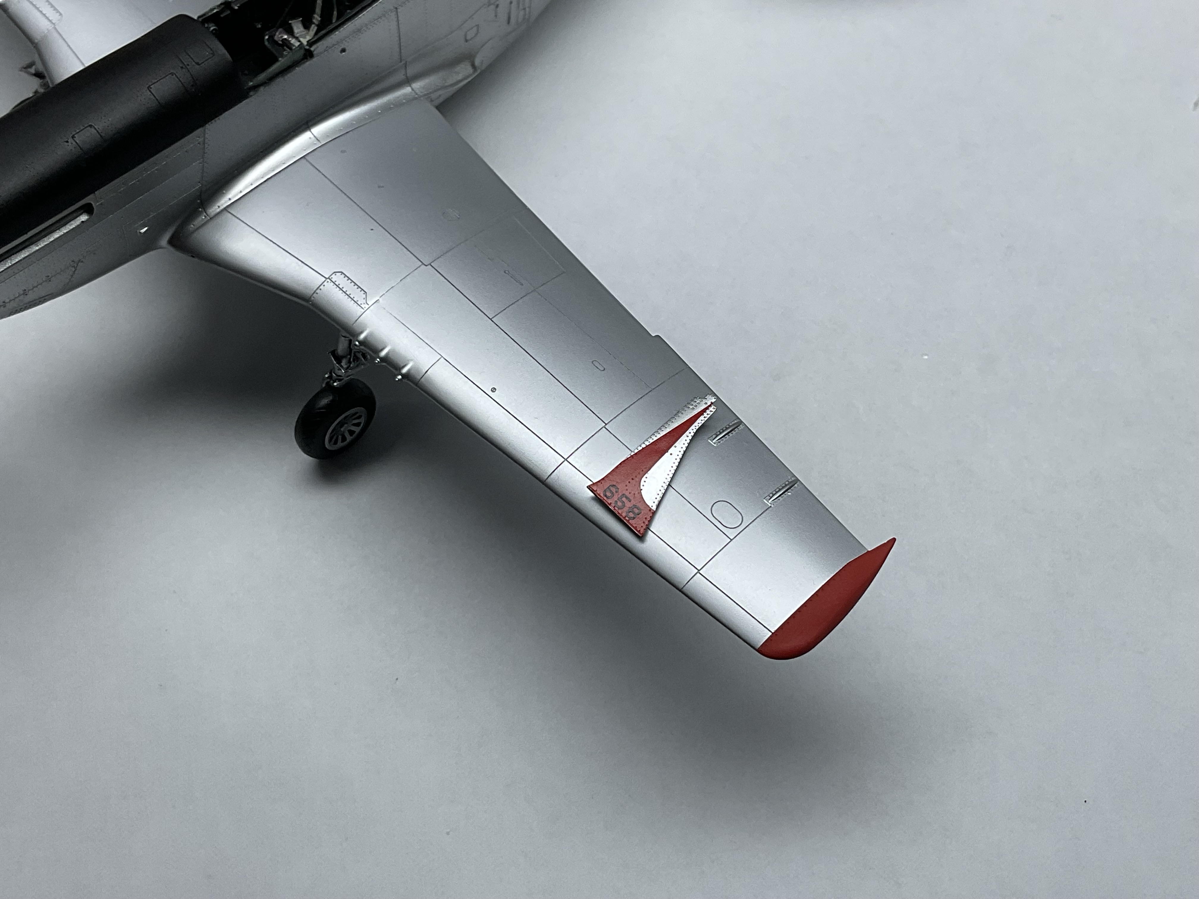

dai phan Posted March 23, 2025 Author Share Posted March 23, 2025 (edited) Hello all, I tried to match the paint color as best as I could to the red decals. I will paint the nose ring to make the red match with each other. I think the decal will show the mismatch as it is next to the painted spinner. Not perfect but the mismatch is small enough that does not jump out at you when the decals and the red paint are far away.. The paints I used are Vallejo Red (Model Color) and Vallejo Orange Fire (Game Color). Dai Edited March 23, 2025 by dai phan Quote Link to post Share on other sites

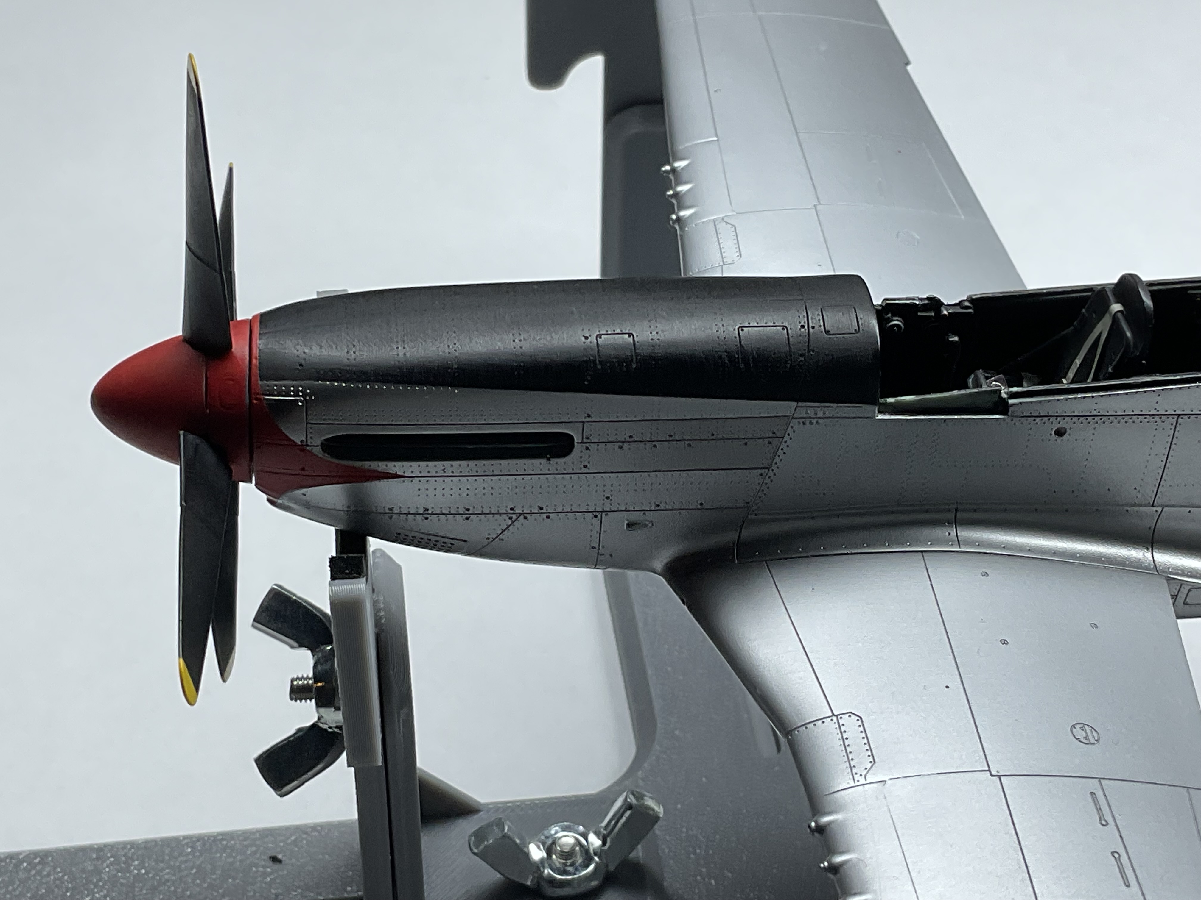

dai phan Posted March 25, 2025 Author Share Posted March 25, 2025 (edited) Hlello all, Tonight painted the nose band. There is no mismatch of the spinner color and the nose red trim now. Dai Edited March 27, 2025 by dai phan Quote Link to post Share on other sites
ExchefAndy Posted March 25, 2025 Share Posted March 25, 2025 Fantastic match, well worth the effort! Andy👍 Quote Link to post Share on other sites
dai phan Posted March 25, 2025 Author Share Posted March 25, 2025 (edited) On 3/25/2025 at 3:22 AM, ExchefAndy said: Fantastic match, well worth the effort! Andy👍 Thank you Andy. It is not an easy task at all. The red decal was applied over NMF so when I match, I must match the paint also over NMF. The color is different depending on the base coat. Red over gray, silver, white will have different hues. So the base color has to be the same. Also flat paint will appear lighter then gloss which the red decal has. So I have to paint match then apply a light coat of water to get the same sheen with the red decal. You do not want to match the paint then discover after clear coat it ended being darker (lower value) than the red decal. The red decals have a slight orange tint so matching is quite a challenge. Dai Edited March 29, 2025 by dai phan Quote Link to post Share on other sites
