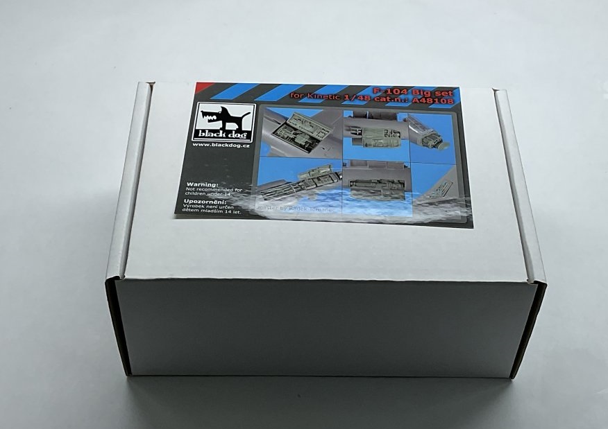

dai phan Posted February 24 Share Posted February 24 (edited) Howdy all, It is going a few weeks before I get the Halberd TF-51 so I am going to start this project while I wait. The civilian F-86A should be completed this week as the decals are coming to me. I think this will be a very nice project with all the open bays. Dai Edited March 7 by dai phan Quote Link to post Share on other sites

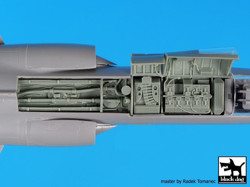

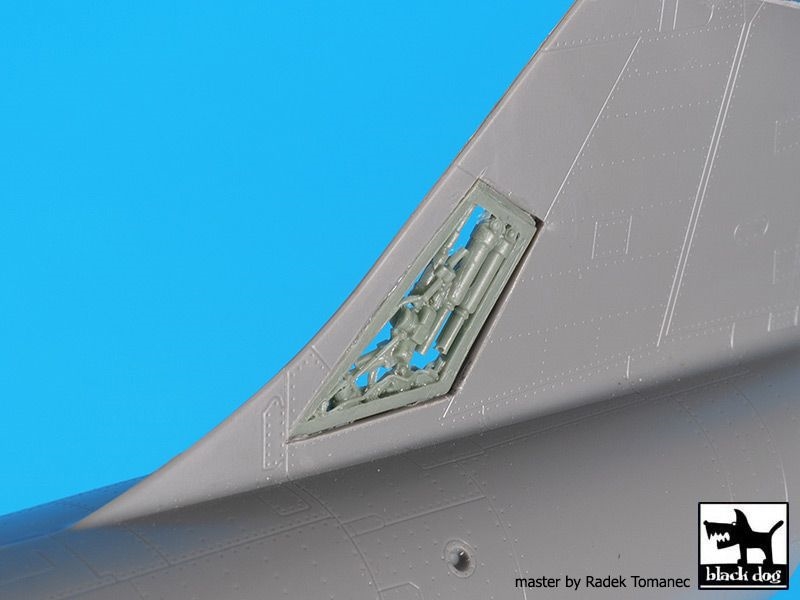

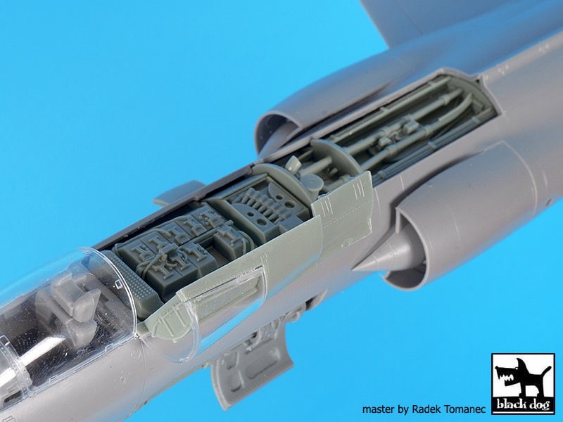

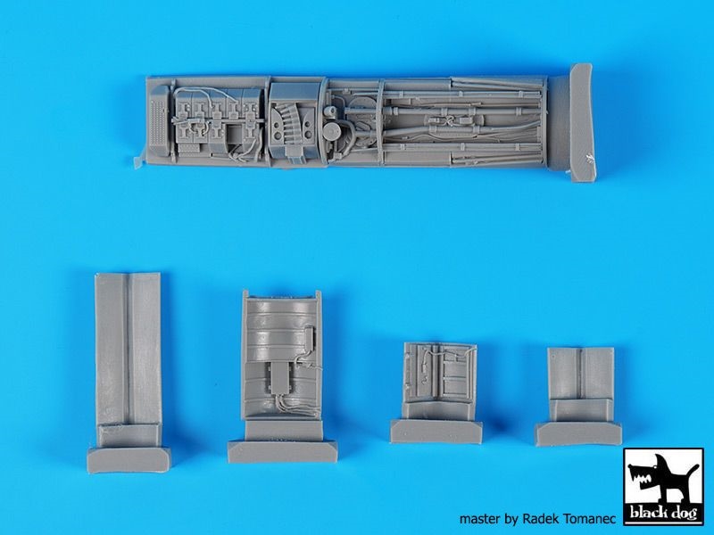

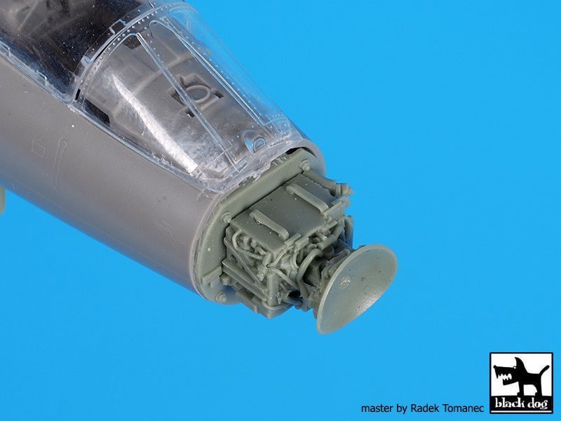

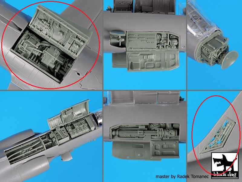

dai phan Posted February 25 Author Share Posted February 25 Hello all, I will not be able to use all the detail parts because the TF version does not have the cannon nor avionics due to the second seat taking space of the avionics. Therefore I could only use the engine, vertical tail bay, part of the top fuse fuselage compartment and nose antenna. Dai Quote Link to post Share on other sites

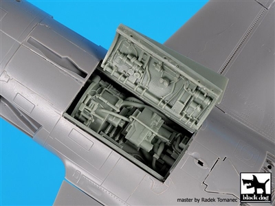

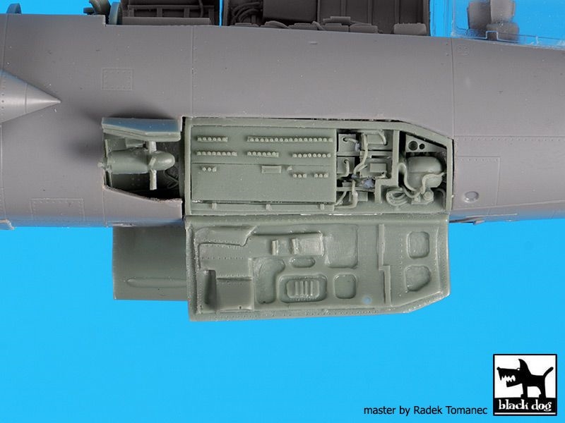

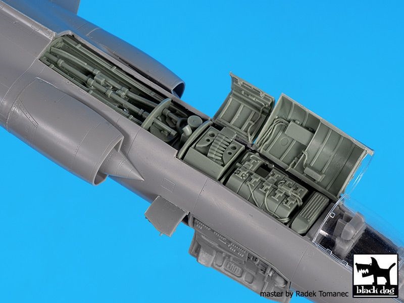

dai phan Posted February 25 Author Share Posted February 25 Hello all, For F-104 experts, do you know if the TF 104 has this on the right side? Dai Quote Link to post Share on other sites
lgl007 Posted February 25 Share Posted February 25 WOW... this is gonna be good 🙂 -Greg Quote Link to post Share on other sites
Snowbird3a Posted February 26 Share Posted February 26 12 hours ago, dai phan said: Hello all, For F-104 experts, do you know if the TF 104 has this on the right side? Dai The dual seat bay is smaller and much different. There are images on page 13 of the Verlinden Lock-On book on the ‘104 Quote Link to post Share on other sites
dai phan Posted February 26 Author Share Posted February 26 4 hours ago, Snowbird3a said: The dual seat bay is smaller and much different. There are images on page 13 of the Verlinden Lock-On book on the ‘104 Thank you very much! Damnation! Dai Quote Link to post Share on other sites

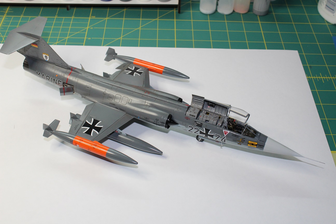

dai phan Posted February 26 Author Share Posted February 26 Greetings, This is the Hasegawa kit with Daco correction set I built 5 years ago. Dai Quote Link to post Share on other sites

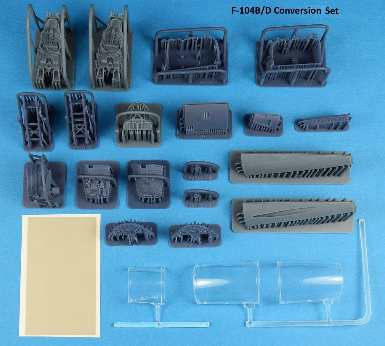

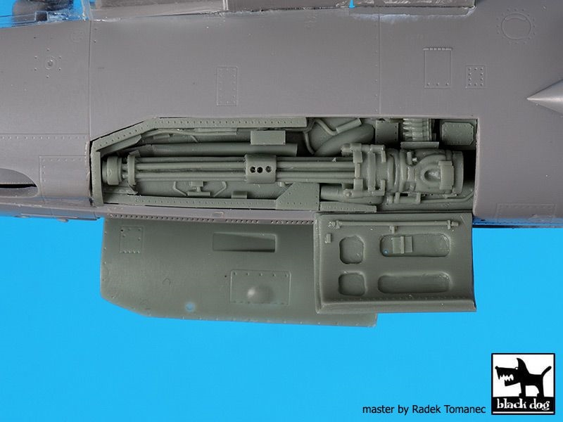

dai phan Posted February 26 Author Share Posted February 26 (edited) Hello all, This conversion set backdates the 2 seater version to the B and D models (two seater versions of the single seat B and D). I wonder if that will allow me to use the avionic or the cannon resin sets? Dai Edited February 26 by dai phan Quote Link to post Share on other sites
lockheed2004 Posted February 26 Share Posted February 26 There is no such thing as a single seat B or D, they’re both two seat models. Neither version has the gun as the second seat occupied the space where the gun went. Quote Link to post Share on other sites

dai phan Posted February 26 Author Share Posted February 26 1 hour ago, lockheed2004 said: There is no such thing as a single seat B or D, they’re both two seat models. Neither version has the gun as the second seat occupied the space where the gun went. Ah yes, my memory failed me. Thanks Dai Quote Link to post Share on other sites

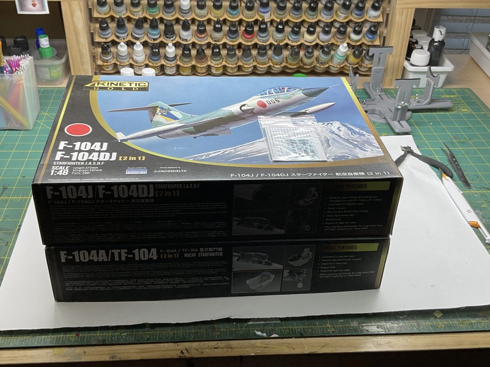

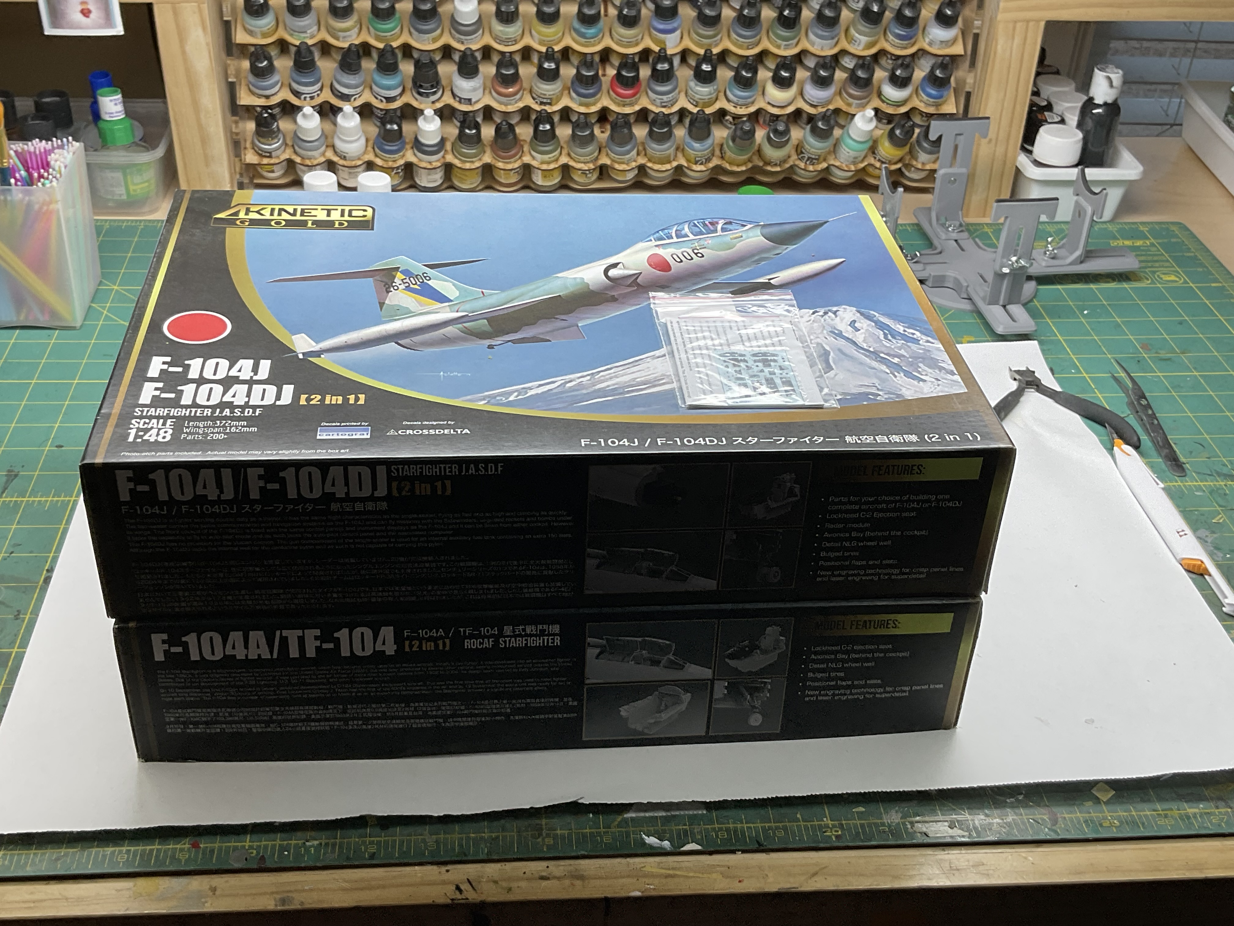

dai phan Posted February 26 Author Share Posted February 26 Howdy all, Upon closer examination, the "2 in 1" boxing does not mean you get 2 separate complete kits like Eduard's Dual Combo. What you get are 2 different fuselages (single and 2 seater) and you can only complete ONE airframe. So the left over fuselage is rather a waste. If you know what version you are going to build, then just buy the normal version rather than spending for an extra fuselage that you will not need. Dai Quote Link to post Share on other sites

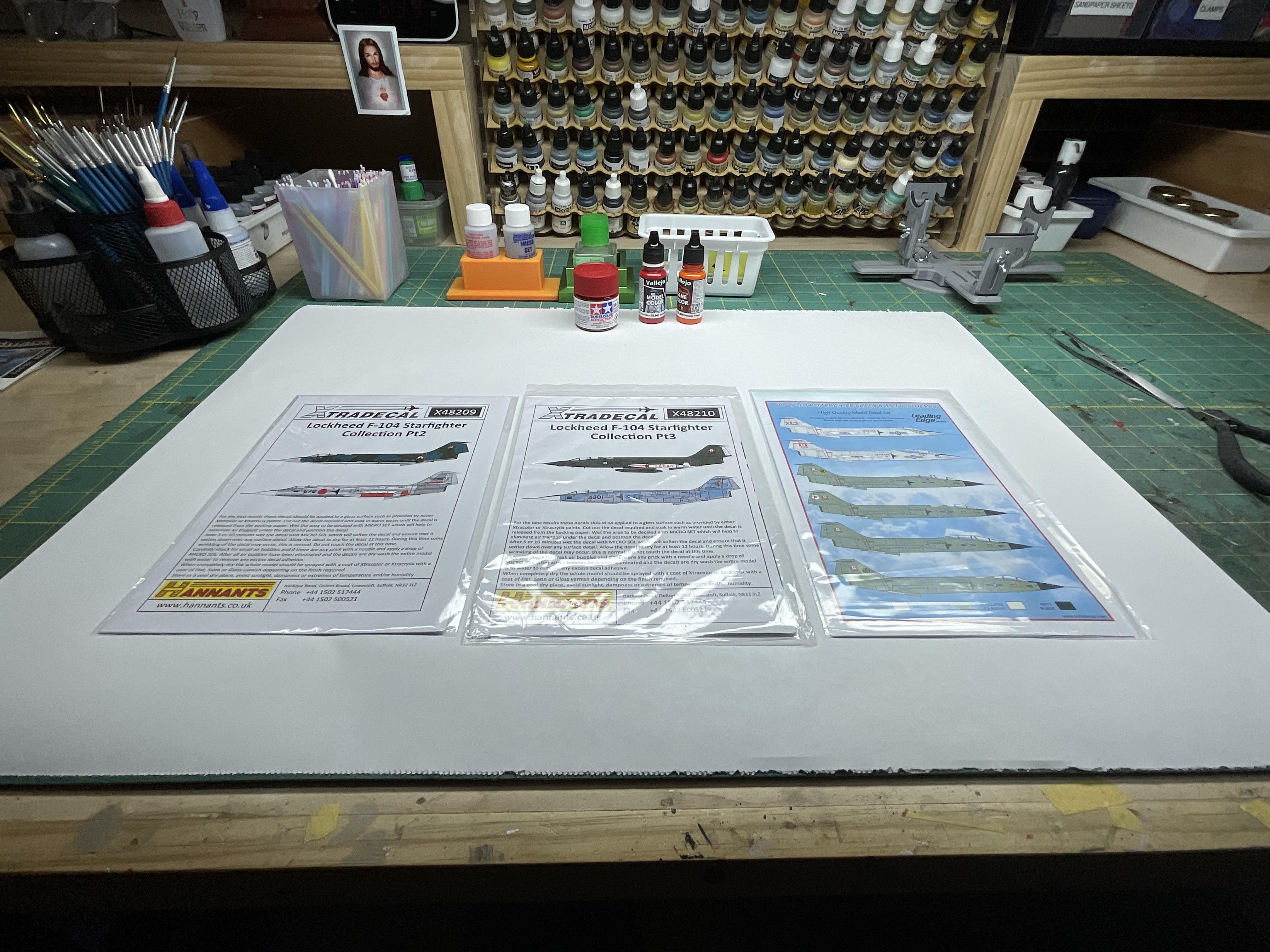

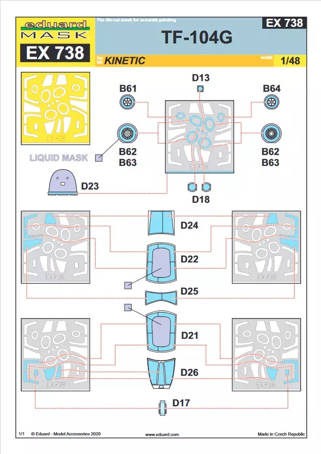

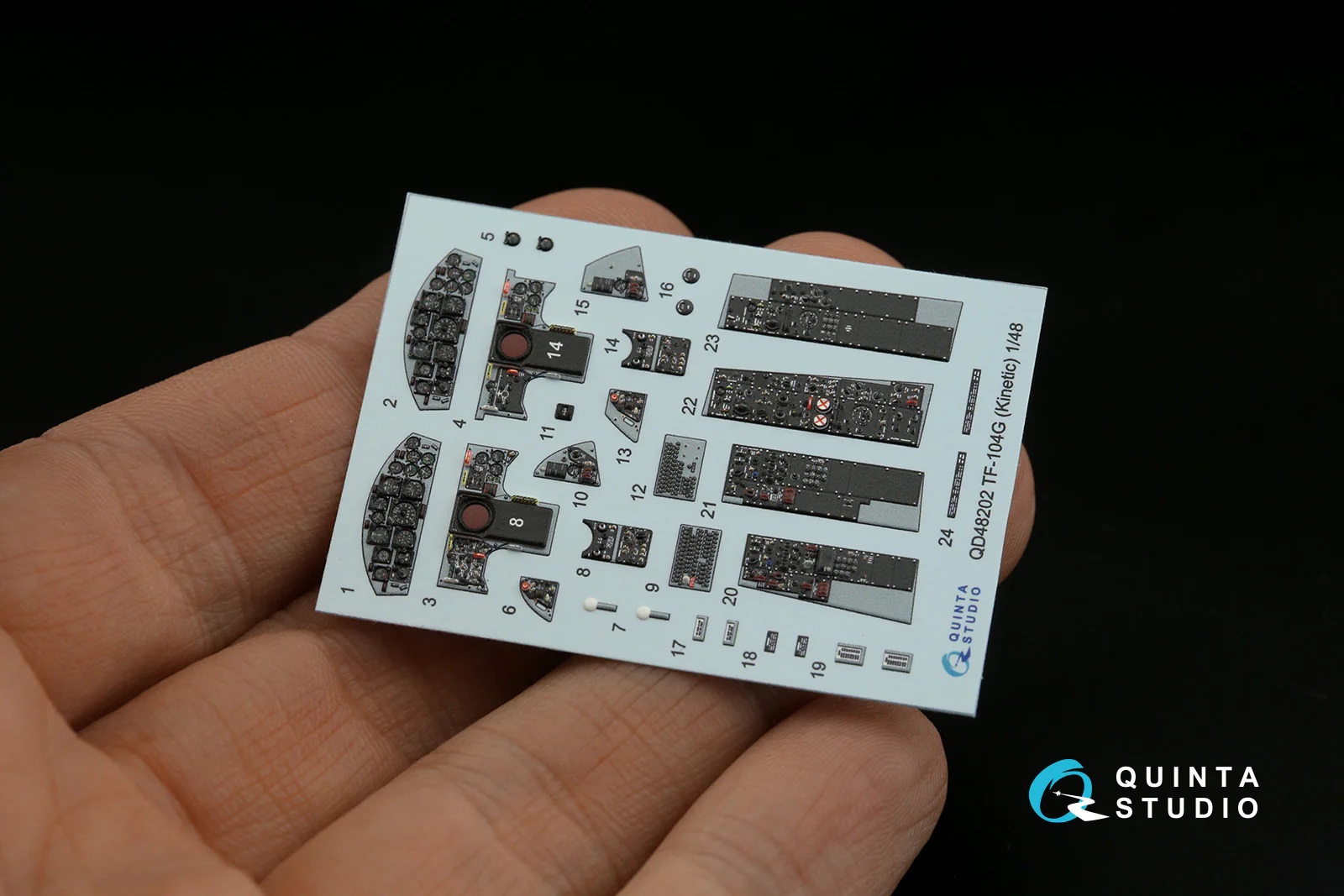

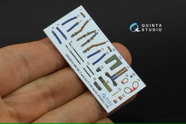

dai phan Posted February 28 Author Share Posted February 28 (edited) Hello all, Good stuff have arrived. I simply could not know what version/s the set is designed for. I emailed BD but did not get an answer. I would assume for the common F-104G? Dai Edited March 1 by dai phan Quote Link to post Share on other sites
dai phan Posted March 1 Author Share Posted March 1 (edited) Just ordered some good stuff... Dai Edited March 1 by dai phan Quote Link to post Share on other sites

Winnie Posted March 5 Share Posted March 5 Downward firing seats were only used on very early A models I believe. Anything used by anyone other than the USAF would have upwards ejecting seats. The F-104G and CF-104 used by MOST countries other than Germany and Italy would initially have had the Lockheed C-2 seat with just the lower ejection handles, then SOME nations changed later to the MB Q7 seat. The Norwegian CF-104D pictured on the book cover got the Q7 seats as a mod after retirement. The bay below the tail is access to the hydraulic systems. right behind it will be the drag chute compartment. Quote Link to post Share on other sites
dai phan Posted March 6 Author Share Posted March 6 (edited) 21 hours ago, Winnie said: Downward firing seats were only used on very early A models I believe. Anything used by anyone other than the USAF would have upwards ejecting seats. The F-104G and CF-104 used by MOST countries other than Germany and Italy would initially have had the Lockheed C-2 seat with just the lower ejection handles, then SOME nations changed later to the MB Q7 seat. The Norwegian CF-104D pictured on the book cover got the Q7 seats as a mod after retirement. The bay below the tail is access to the hydraulic systems. right behind it will be the drag chute compartment. Hello, Likely I will do the CF-104 two seater. Upon review of the Kinetic sprues, the CF variants use the same sprues as with the TF-104G. That is not very accurate correct? Dai Edited March 6 by dai phan Quote Link to post Share on other sites
Dave Williams Posted March 6 Share Posted March 6 1 hour ago, dai phan said: Hello, Likely I will do the CF-104 two seater. Upon review of the Kinetic sprues, the CF variants use the same sprues as with the TF-104G. That is not very accurate correct? Dai The Kinetic kit sprues contain both seats, both wheels, and both MLG doors, so it doesn’t matter. The “wrong” parts for the version you’re building are simply unused. Quote Link to post Share on other sites
dai phan Posted March 6 Author Share Posted March 6 6 minutes ago, Dave Williams said: The Kinetic kit sprues contain both seats, both wheels, and both MLG doors, so it doesn’t matter. The “wrong” parts for the version you’re building are simply unused. That is very good to hear that Kinetic does provide correct CF version parts. Dai Quote Link to post Share on other sites
