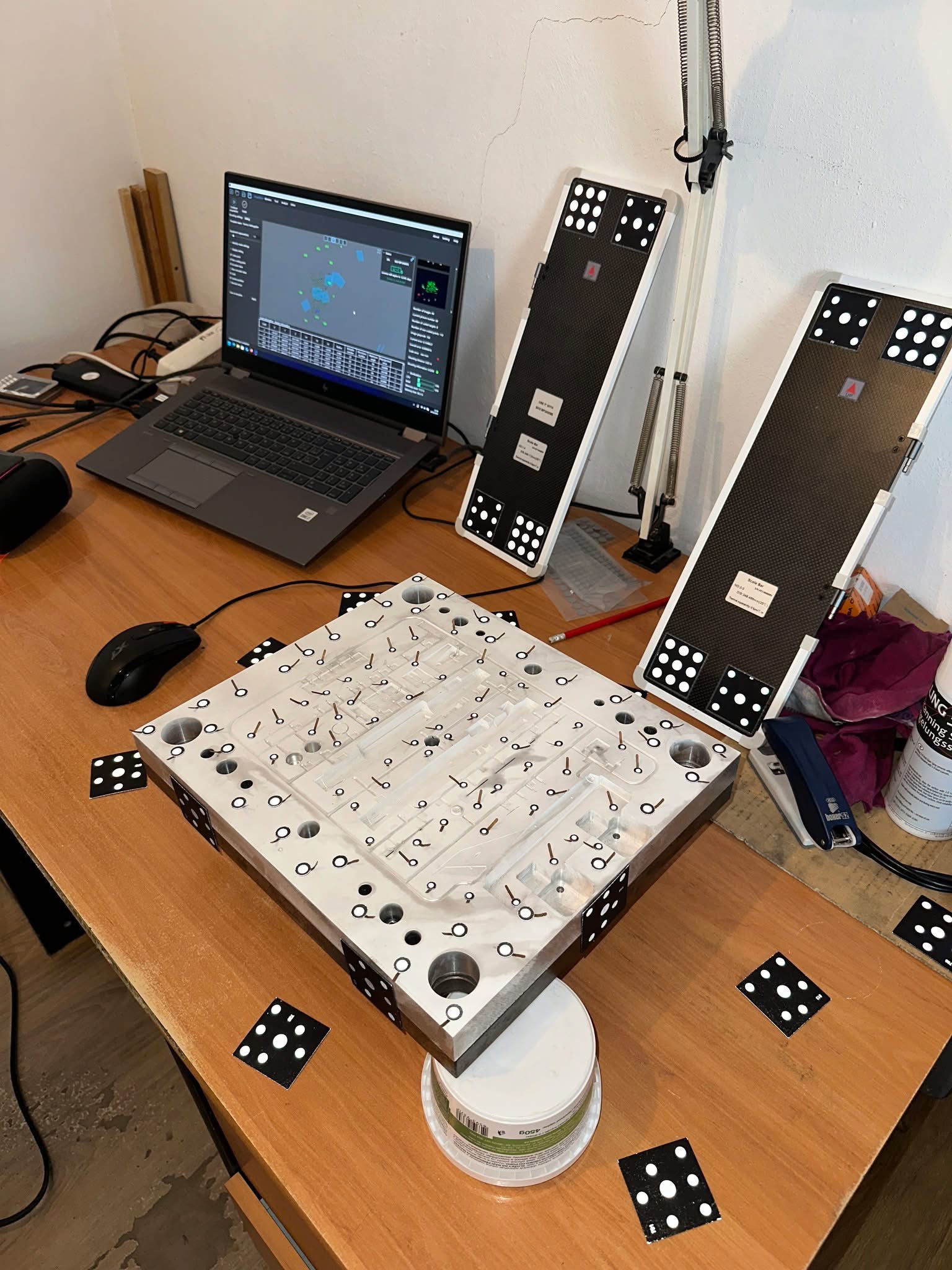

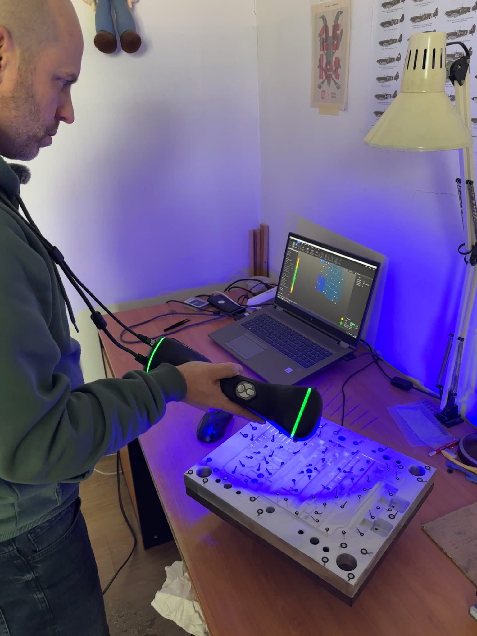

ya-gabor Posted March 12, 2025 Author Share Posted March 12, 2025 Some fresh news of this planned MiG-21bis. Just to show what is going on in the background for a more complete picture. Best regards Gabor Quote Link to post Share on other sites

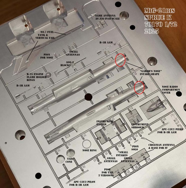

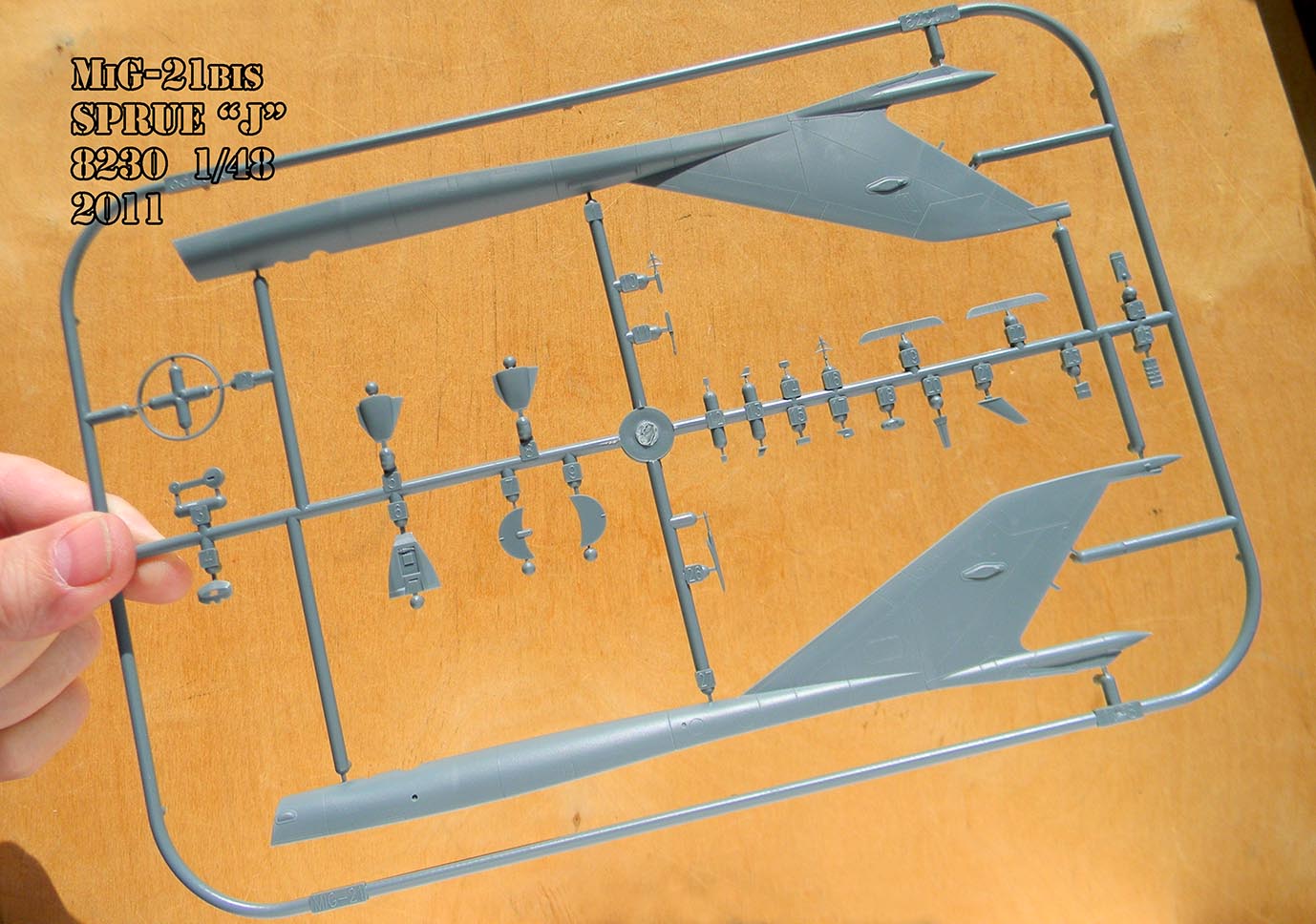

ya-gabor Posted March 12, 2025 Author Share Posted March 12, 2025 The brand new MiG-21bis kit will include just one single new sprue to represent this late version Fishbed. It is Sprue „K” 70170. Let’s see what really new on this sprue in comparison to Sprue J8230 which was included in the 2011 48th scale MiG-21bis kit. Actually in a sense there is more but also less. There is more in that a new pair of air to air missiles are provided. The R-3R radar guided missiles are included along with the appropriate APU-13U2 launch pylons. (by the way they were already available in the aftermarket range for many years in 72nd scale) There is also a pair of flare dispenser, the ASO-2 version or something which should look like it. Unfortunately the shape is off, but as usual this is just a MINOR problem. Of course there is the main fuselage halves. If you remember in 2011 the company boss was defending the irrelevance of the different nose shape by saying that in 48th scale the difference can be measured in fractions of millimetre. So there is absolutely no point in making what they called “Gabor’s nose” at a very high expense for the company. Modellers should be happy with a MiG-21MF fuselage and nose shape. . . It is interesting that now in the much smaller 72nd scale at a considerable expense to the company after all they decided to make that “Gabor’s nose” on the fuselage. If it was not worth making in quarter scale why was it suddenly important in 72nd where it is even less noticeable and can be measured just in microns!?!? Basically the same antenna sets are included, like the “Pion” antennas of the RSBN system. There is one under the nose and one on top of the fin. A complete separate “Pion” antenna is also provided. It is the same as in the 48th scale version. More soon Best regards Gabor Quote Link to post Share on other sites

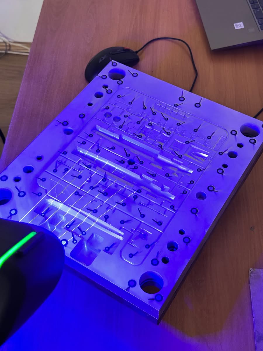

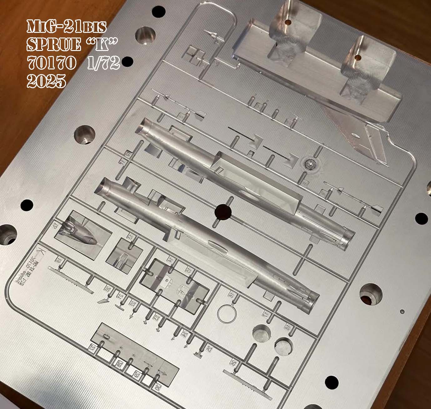

ya-gabor Posted March 14, 2025 Author Share Posted March 14, 2025 So the new kit will have one new frame “K” plus all the old sprues from the 7 year old MiG-21MF “Interceptor” kit. Which is the later version of the MF manufactured in Aircraft factory №21 in Gorki. Here is the frame and also a list of the parts. This is the moulding tool for the outer side of the sprue, that is where most of the surface details are. The inner half of the mould is less “exotic” although it also has some interesting details. The third part is the slide mould insert for the one piece fuel tank/fin Part K3 inside. Frame K 70170 parts list: (same as . . . Refers to identical parts made for the 48th scale kit back in 2011) Part 1 Antenna Same as J20 Part 2 Small Same as J23 Part 3 one part №7 fuel tank with fin including rudder Same as J1 + J27 Part 4 Small antennas Same as J12 Part 5 “Pion” RSBN antenna under the nose with no “wings” Same as J26 Part 6 R-3R Air to Air missile Part 7 2 ASO-2 flare dispensers Part 8 Engine afterburner flame holder rings Part 9 R-3R Air to Air missile Part 10 Fuselage left side Part 11 Fuselage right side Part 12 Radio compartment cover & di-icing alcohol cover Part 13 Instrument panel cover under the windshield Same as J6 Part 14 Instrument panel without surface details for photoetch parts Part 15 Instrument panel with surface details Part 16 Intake ring Part 17 Tail section Part 18 Tail Part 19 APU-13U2 missile launch rail Part 20 Croatian antenna Same as J21 Part 21 Part 22 Solo “Pion” RSBN antenna with “wings” Same as J16 Part 23 Small intake on the nose Same as J17 Part 24 Small antenna Same as J13 Part 25 Part 26 APU-13U2 missile launch rail Part 27 Croatian antenna base Same as J4 Part 28 Small Same as J14 Part 29 “Pion” RSBN antenna on top of fin without “wings” Same as J10 Part 30 “Pion” RSBN antenna on top of fin Same as J11 Best regards Gabor Quote Link to post Share on other sites

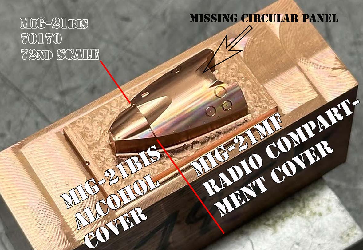

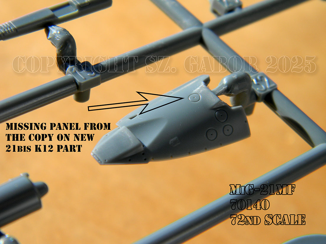

ya-gabor Posted March 15, 2025 Author Share Posted March 15, 2025 What are the actual new parts or true 100% MiG-21bis parts on this new Frame “K”? Let’s start from the nose area. Part K12 is the combined forward radio compartment cover plus the Alcohol bottle cover panel. In 48th scale the Alcohol cover was a separate part or to be more precise two parts. Two versions of the cover were given in 48th scale, the “early” Part J8 and the “late” version Part J5. Since the breakdown of parts for the line of kits in 72nd scale had a different setup (one piece nose cover) for the new 72nd scale MiG-21bis the same combined part was designed. The alcohol cover was redesigned for the early 21bis version. Here start one of the problems. As indicated before everything is connected with everything and since the MiG-21bis has brand new equipment, a new radar with new cooling system including the far bigger combined Alcohol container. The Alcohol bottle is much larger which interferes with the radio compartment cover after of it. So the shape of the cover was modified by the Mig designers and since it had different “black boxes” inside they had different circular access panels in comparison to those for the MiG-21MF. I am speaking here of course about the real full size aircraft. What do we have on Part K12? At the front a new Alcohol cover (ala early 21bis) followed by a straight forward copy of the MiG-21MF radio compartment cover. Part K12 is a HYBRID between MF and 21bis. Well basically it is a downscale of the same “minor mistake” as on the 48th scale 21bis kit where they left the original MF cover for the MiG-21bis kit. Is K12 a simple copy of the earlier MF kit? Well not exactly, somewhere on the way one of the circular panels was left off from the engraving file for the anode. This is a very simple technological mistakes in production which could have been avoided with a little attention by the tool maker. Only the fast-lock screw head of that panel was engraved. Oh well, the circular access panels are all wrong anyway for a 21bis version! There is nothing new under the sun. Forgetting panel lines can happen. On frame 70140A (“Interceptor” version which will be included for this MiG-21bis kit) there are similar “minor” problems of forgetting panel lines in production. So get out the engraver tool and . . . The company boss suggested that I will create/see problems with or on the kit. Here is what he wrote in March issue of his company publication: . . . „I am sure that Gabor is already sharpening his teeth to chew this kit apart and spit it out, but there will be no Gabaresque issues with the intake this time around” . . . I don’t have to invent anything, the company does it all for us. : ) : ) The silly blunders are served on a silver plate by the company! : ) : ) I hear you ask: Why didn’t you contact the company directly with the details? Well, as a matter of fact I did. Back in 2011 ALL AND EVERY DETAIL, MEASUREMENT, PHOTO . . . WAS PROVIDED TO THEM to help with design. Including the cover of the radio compartment on the MiG-21bis the way it was on the real aircraft. Stay tuned there is more to come. : ) : ) Best regards Gabor Quote Link to post Share on other sites

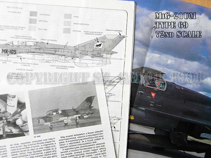

ya-gabor Posted March 16, 2025 Author Share Posted March 16, 2025 16 hours ago, Memphis said: Well. It's better than nothing. Nowadays, not many people know the details of the design of certain modifications. I would like to see UM/US more than Bis. But Bis is also good news. I am sure eventually there will be a manufacturer who will make a decent, right scale and in all its details true replica of the MiG-21U / US / UM two seat versions of the Fishbed. But for the moment don’t expect it from the Czech aftermarket manufacturer! As for the MiG-21bis. This is the best that they could do by using existing sprues from previous MiG-21MF sets with the addition of a single Frame “K”. Best regards Gabor Quote Link to post Share on other sites

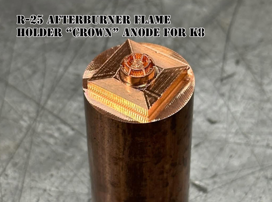

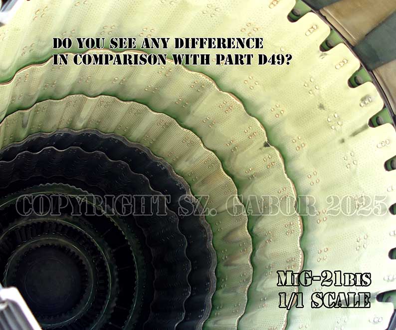

ya-gabor Posted March 16, 2025 Author Share Posted March 16, 2025 After a look at details of parts for the front of the aircraft let’s have a look at the other end of it. Everything is related to everything else and MiG-21bis differed from its predecessors by having a new engine, the R-25. It looks very different from the R-11’s and R-13’s of earlier Fishbed versions. Here I am speaking not about how the engine looks like from the outside and its performance parameters but more about the inside or to be more precise what is visible of it from the outside, looking up its tail end. What is visible of it on a model, after all this is what should interest us. The R-25 engine had a new set of constriction petals which make up the ring at the very end of it. It was new and had new colours but what is far more noticeable is the inner walls of the burner duct. They had a very distinct heat protection shield running all the way to the front (looking from the after end), to the afterburner flame holder rings. It is very similar to what the J-79 engines look like with that perforated wavy inner surface. In comparison to this the earlier MiG-21 engines had a tube with plain surface, welded from sheets of heat resistant alloy. The R-25 engine also had a distinct set of three afterburner flame holder rings, once again very similar to those in the J-79 engine. So what do we get on Frame “K” for our new MiG-21bis kit to represent the R-25? There is a new part here which was not addressed in the 48th scale kit at all. Part K8 is the “crown” so to say of the flame holder rings. For the afterburner duct one has to go back to Frame “D” 70140 the “common” for all versions sprue with a lot of different MiG-21 parts. Of course for the earlier versions on Frame “D” one will find parts D49 and D54 for the engine burner duct assembly. Since the earlier versions used the plain surface duct they have unfortunately little reality to represent the R-25 engine of the MiG-21bis. You can say that little of the burner duct will be visible on the finished model. Yes. You could be right, but then again you have Part K8 for the afterburner flame holder rings which is buried far deeper inside that “black hole” and far less visible and still it was produced. Surely the manufacturer decided to cut corners in preparing this MiG-21bis kit and said let’s use what we have on that Frame “D” for the duct itself. No point in making those fairly big parts brand new and true representation of the R-25, no one will see the difference anyway. Here is what the afterburner duct of a real MiG-21bis looks like and what will be provided in the kit. Do you see any difference??? The solution in the 48th scale kit was that after a time one was able to buy from this aftermarket company an “upgrade” photoetch set to make it look a little closer to a MiG-21bis. Later on, even at a higher price a resin R-25 engine was offered separately but overall this increased the amount the modeller pays even further making a “cheap” injection moulded kit not so cheap after all. I would imagine that the same will happen here. Just one question: Has anyone tried to make all those waves on the photoetch and then bend it into a tube and fit it inside the burner can? Even in 48th scale it is challenging, what will it be like in 72nd scale? One can say, “But the kit hasn’t been released yet so how can you tell”? All we can go by at the moment are the official company statements over the years, the presentations at shows/trade fairs dealing with the kit, the openly talked about plans for this kit, officially released images of the sprue in making. Now either this is just a cunning plan for global misinformation of other manufacturers and modellers worldwide or it is in fact the truth of what is to be released in this kit. Of course it is possible that images of Frame “K” were only a fiendish ploy, and in reality several new sprues with all the correct MiG-21bis details were prepared in secret . . . : ) : ) I for one would be the happiest modeller if this was true!!! : ) : ) Best regards Gabor Quote Link to post Share on other sites
Memphis Posted March 20, 2025 Share Posted March 20, 2025 On 3/16/2025 at 10:53 AM, ya-gabor said: I am sure eventually there will be a manufacturer who will make a decent, right scale and in all its details true replica of the MiG-21U / US / UM two seat versions of the Fishbed. But for the moment don’t expect it from the Czech aftermarket manufacturer! I know how it works: I just need to start building (I have an Eastern Express MiG-21UM and some additional sets) with using drawings and Eduard announces it. Quote Link to post Share on other sites

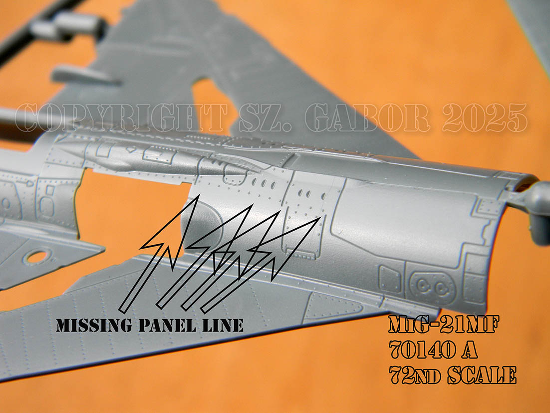

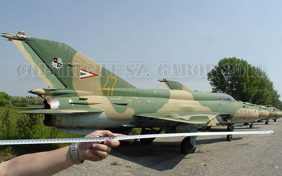

ya-gabor Posted April 2, 2025 Author Share Posted April 2, 2025 After all the constructive comments, especially on the Czech forum it is time to get back to the question of the MiG-21bis in 72 nd scale. It is important to identify the differences from the MiG-21MF before one does any work but it is also important to get the dimensions right. There are kit manufacturers who produce Me-109G6 in strange scale and after “strong attacking comments” from deviant modellers realize how big a blunder they have made and start again from scratch. To avoid this in my own research I did go out and measure the real metal of a MiG-21bis. Here it is. I know April first was yesterday but . . . Best regards Gabor Quote Link to post Share on other sites
ya-gabor Posted April 10, 2025 Author Share Posted April 10, 2025 (edited) As a journalist I feel it is important to show the other side of the coin. Here is what the company is writing now: . . . So we went back to Gatow, and we measured both the Bisa and the MF in the hull area behind that ring. We did it really thoroughly, we spent two days there. I'll never forget it, because the sun burned my bald head, face and neck very badly. The result of the measurement was that in the place that Gábor indicated as wrong, there was a difference in the hull diameter in 1/48 scale of about 0.6 mm. Gábor made a fundamental mistake of the kit out of this, wrote about it wherever he could and wherever they gave him space, and managed to convince at least some modelers that the kit was wrong because of that. And he's been dragging it out for 14 years now. In fact, 0.6 mm is in the place where the alleged error occurred, basically within the tolerance in the production of any kit, even on fundamental dimensions such as the fuselage length or span. On the fuselage diameter, it is something that you are not able to recognize on a built model (or on an unbuilt kit). It is really a negligible value that does not affect anything at all, because how the model works is affected by the front ring and its diameter on the leading edge. And that is correct, it is correctly larger than on the MF, it has a larger diameter and depth, the only deviation is in tenths of a degree in the slope of the side wall relative to the base. I believe that there will be people who will claim that they see the deviation on the model. But I would see it more as their problem, not ours. . . We are back to the company narrative from 2011 in describing the differences in fraction of millimetres in DIAMETER. It is suggested on Czech forums that apart from me that no one else is interested in the differences and also in the actual MiG-21bis version at all! Well the fact that the company many a considerable investment in this version suggest differently. Just a small reminder that NO ONE ever forced the manufacturer to produce this new kit and to MAKE A BRAND NEW FUSELAGE WITH THOSE EXACT FRACTION OF MILLIMETER CHANGES in 72nd scale! While in the much bigger 48th scale back in 2011 it was considered completely unimportant, unworthy for consideration and fiction of my imagination as “Gabor’s nose”. The thing is that even though the size difference is small but the SHAPE difference is great and visible, just as you will see differences on a Spitfire sub versions or on a Me 109 from different production batches. For those new born modellers and those who missed it first time around here is something. Digging back in my archive here is a photo made in 2011 to illustrate the difference in the nose shape of the MiG-21bis (in the background) and the MiG-21MF in the front. In 2011 there was a chance to spend several days with the aircraft and to position the two real aircraft versions side by side for this photo. Just looking at it on its own one can say that there is little visible shape difference. This is why I have added on the noses some black tape along the longitudinal axis at exactly the same distances on both airframes to show what is important. This way the continuous curvature with decreasing diameter of the MiG-21MF is visible, just as the constant cylindrical shape of the MiG-21bis nose diameter which suddenly goes into a rounded shape just before the intake lip. Although the intake diameter was changed but the important point is that the SHAPE of the nose was changed completely! You don’t have to believe in what I say, here are the real aircraft and you can look at it to make up your own mind. It is the same shape difference as that for the dorsal saddle №7 fuel tank. The difference is although visible and can be measured well but the real difference is in the overall shape of this big fuel tank on the back of the airframe. Best regards Gabor Edited April 10, 2025 by ya-gabor Quote Link to post Share on other sites

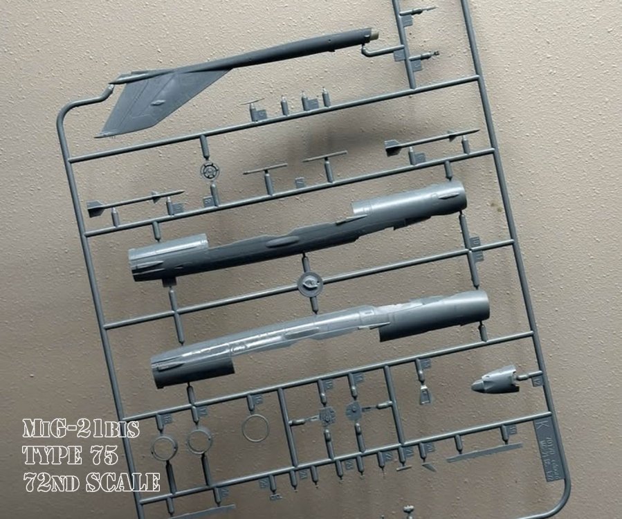

ya-gabor Posted April 10, 2025 Author Share Posted April 10, 2025 So here it is, Frame K for the MiG-21bis in 72nd scale. This is the only new sprue in the new kit, the rest is everything from the previous MiG-21MF kits. Best regards Gabor Quote Link to post Share on other sites
Memphis Posted April 10, 2025 Share Posted April 10, 2025 Have you received MiG-21bis kit yet? Or is this picture from Eduard's website/blog? Quote Link to post Share on other sites
ya-gabor Posted April 10, 2025 Author Share Posted April 10, 2025 15 minutes ago, Memphis said: Have you received MiG-21bis kit yet? Or is this picture from Eduard's website/blog? Of course not! As you can see from the previous "communications" from the company I have nothing to do with this kit and according to them I have never contributed anything to this or previous projects so . . . why should I have anything to do with this kit or receive it. 😄 😄 😄 I would be interested in it if I wanted to build a Hybrid MF/bis version. But I am after a TRUE MiG-21bis as such. The photo of Sprue K shows clearly that it is a perfect copy of the press tools shown before by the company. It is an answer to those who were asking for commenting only after the we actually see the sprue. The press tool shown perfectly what it will be like. Best regards Gabor Quote Link to post Share on other sites
Memphis Posted April 11, 2025 Share Posted April 11, 2025 Hmm. I don't sure, but the nose looks as dog's nose that a wasp has been stung. Quote Link to post Share on other sites
