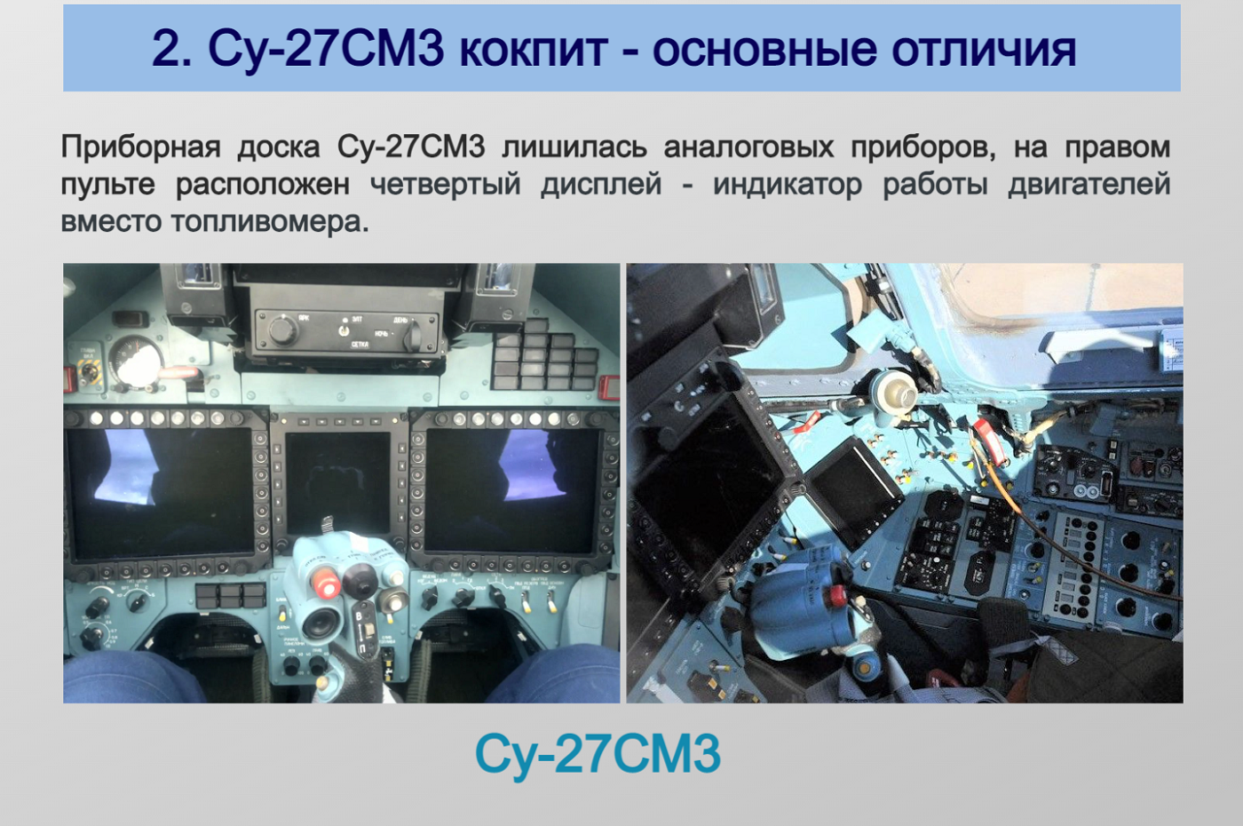

Sergei Galicky, Russia Posted April 11, 2025 Share Posted April 11, 2025 (edited) Hi, LuckyZero! You can build a full-fledged SM or SM3 from the KH, and there are many visual differences in the cockpit and outside. A good cockpit for the SM version made by Quinta Studio. Use this reference for modification. https://cloud.mail.ru/public/1mP9/HTCqRjyxy Best regards! Sergey Edited April 16, 2025 by Sergei Galicky, Russia Quote Link to post Share on other sites
