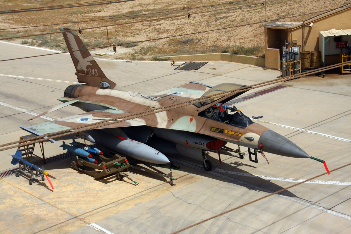

Solo Posted April 16 Share Posted April 16 I have just found out about 600 galons fuel tanks for F-16 and I think they look really cool under the wings of Viper. Now I am making F-16D Block 42 and I wanted to use normal, 370 galons tanks, but now I am thinking about 600 ones. Few questions: 1. Which blocks of F-16 are valid to use those 600s? Could Block 42 have it? 2. Do those tanks influence for available range of choices for air to ground weapons on neighbouring pylons? 3. I know ResKit makes those tanks and offers for them strange pylons, as you can see them on picture below - are those pylons suitable for that tanks for sure? I mean unusual pylon endings. Anyone can help? Quote Link to post Share on other sites

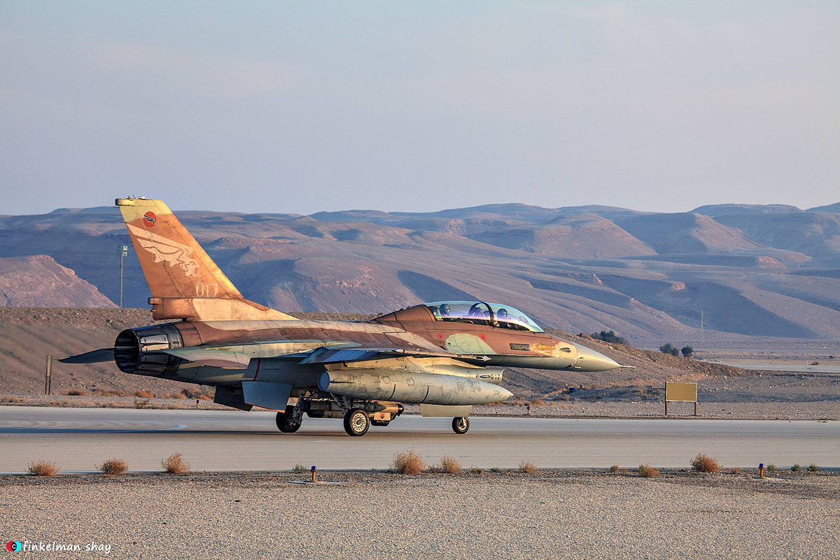

scotthldr Posted May 5 Share Posted May 5 2 hours ago, iaf-man said: IAF A/B did use them They appear to be standard 370 tanks Quote Link to post Share on other sites
Niels Posted May 6 Share Posted May 6 23 hours ago, scotthldr said: They appear to be standard 370 tanks They are. The B has been observed with the 600 gallon tanks, but not seen any of the A's with them. Both of these pics however show the regular 370 gallon tanks. Quote Link to post Share on other sites
iaf-man Posted May 6 Share Posted May 6 23 hours ago, scotthldr said: They appear to be standard 370 tanks You are correct, my mistake Quote Link to post Share on other sites
