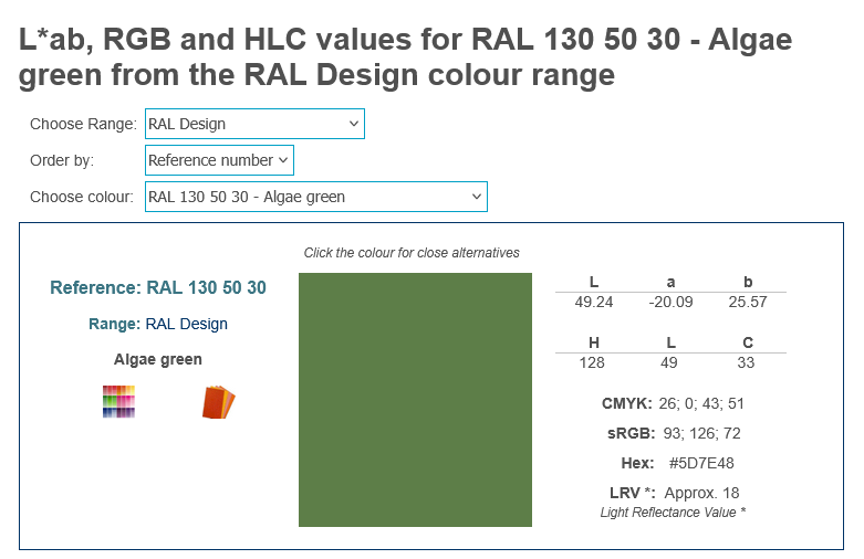

bentwaters81tfw Posted May 31, 2025 Author Share Posted May 31, 2025 Right guys, after further research , consensus is FS14087 is the suspect. What is more I can get it here in aerosol. It has an equivalent in RAL 130-50-30, close enough for Gubbermint work, so I will go for that. Thanks for all your input. Frank Quote Link to post Share on other sites
andyf117 Posted May 31, 2025 Share Posted May 31, 2025 RAL 130 50 30? Both too light, and too green... ....as I said previously, the renumbered/replacement for FS14087 is FS14084: Quote Link to post Share on other sites
