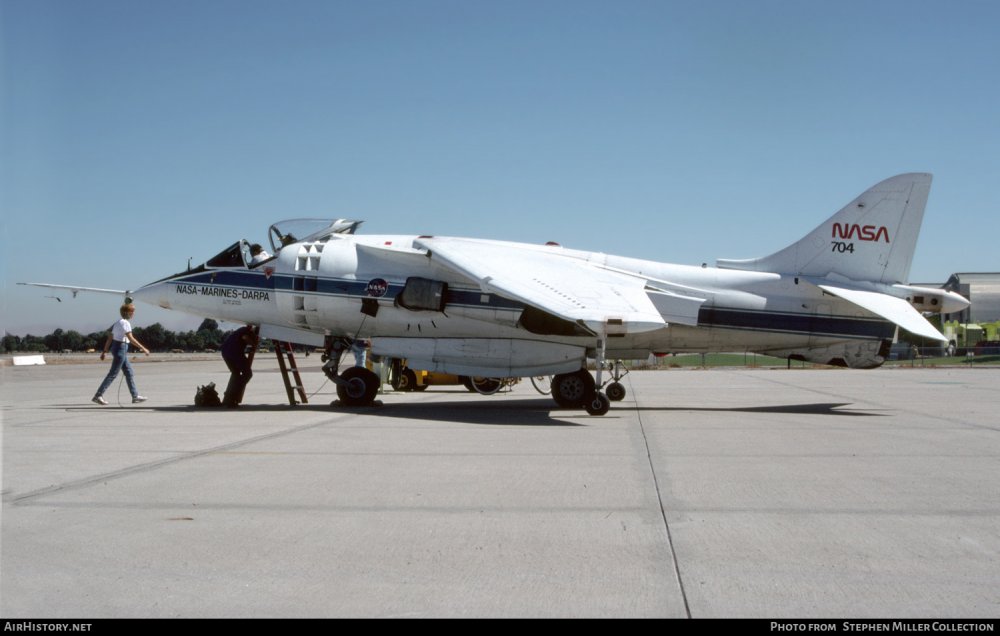

Dutch Posted June 17, 2025 Share Posted June 17, 2025 NASA used one of the early Kestrels. I photograped it at an outside aircraft park by Langley AFB circa early 90s. Later it was moved indoors to the Hampton Roads Aviation Museum in Hampton. Quote Link to post Share on other sites

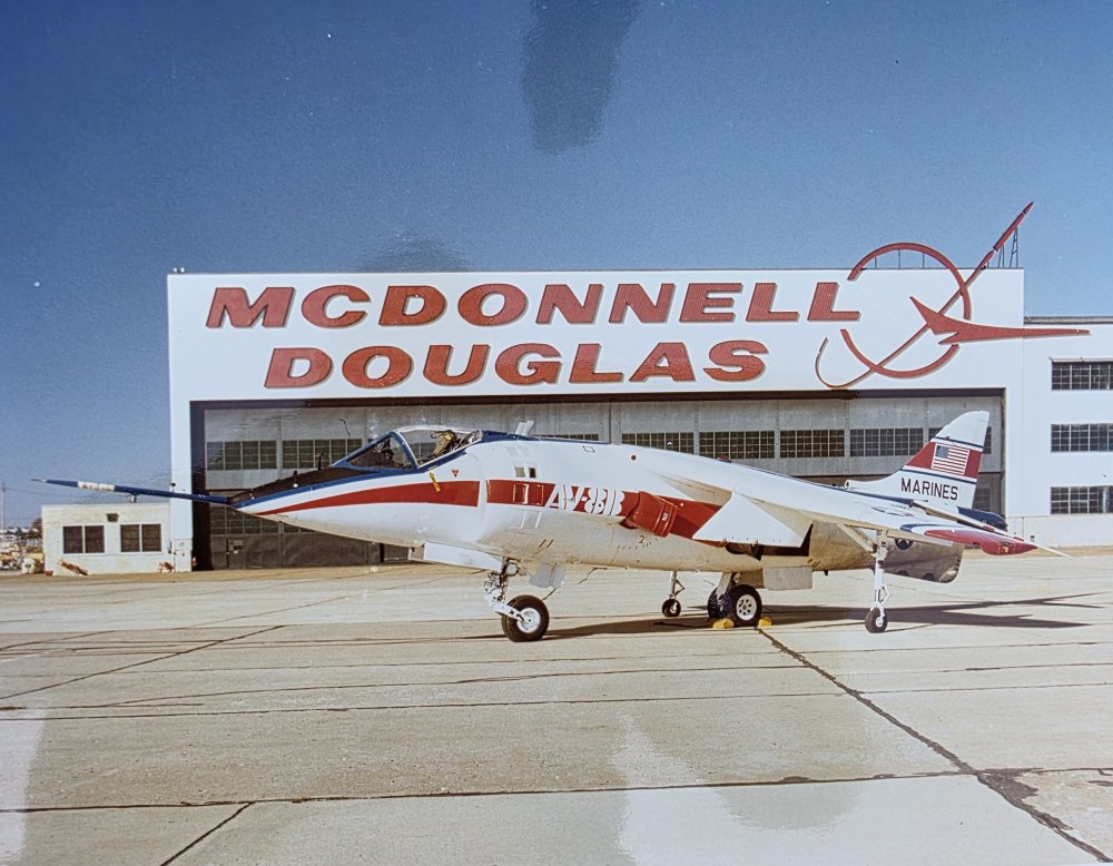

KursadA Posted June 17, 2025 Author Share Posted June 17, 2025 What would be the best way to put together a YAV-8B though? Kitbashing both Monogram kits together? Transplanting the Monogram AV-8A/C nose to the Hasegawa kit?? Quote Link to post Share on other sites

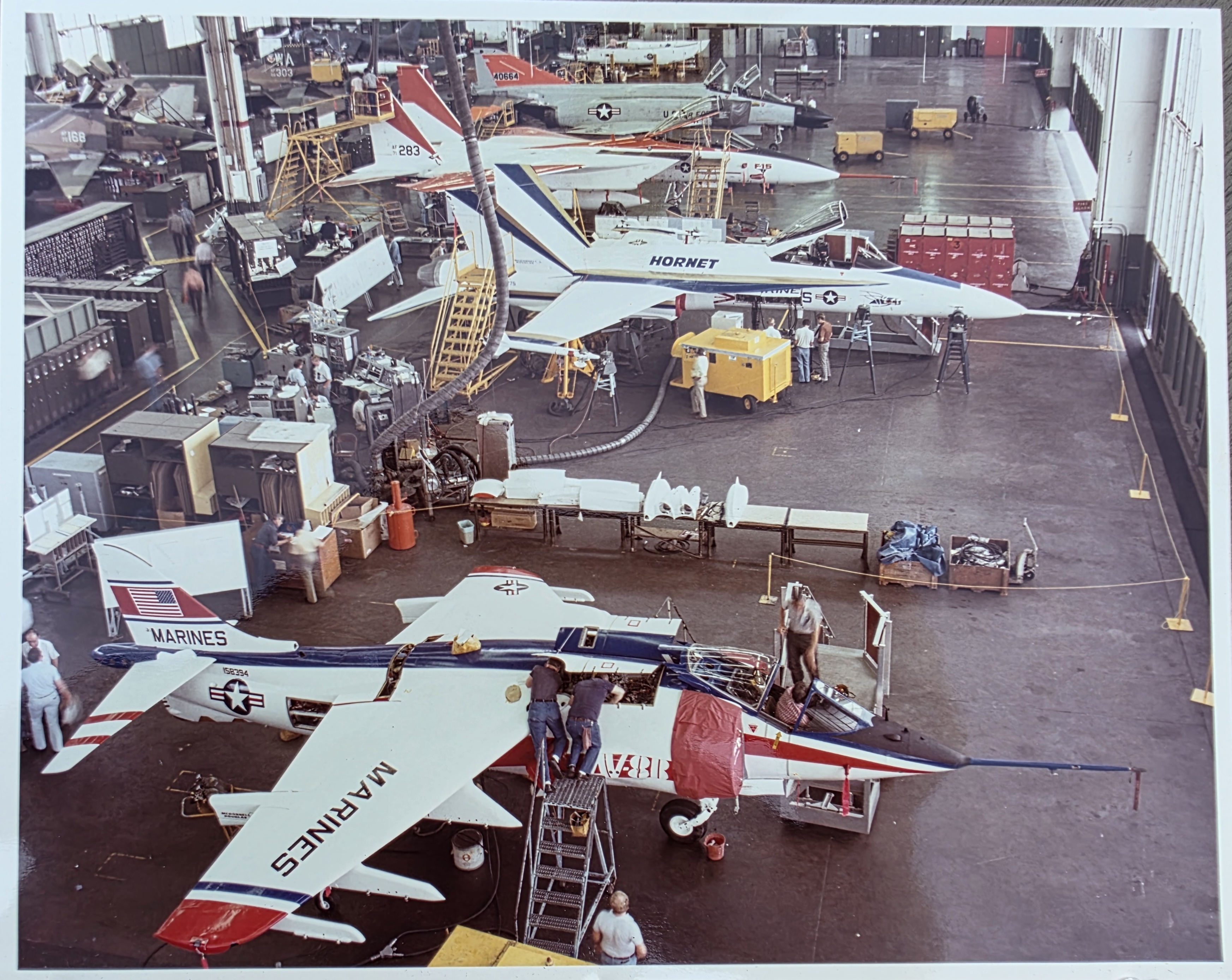

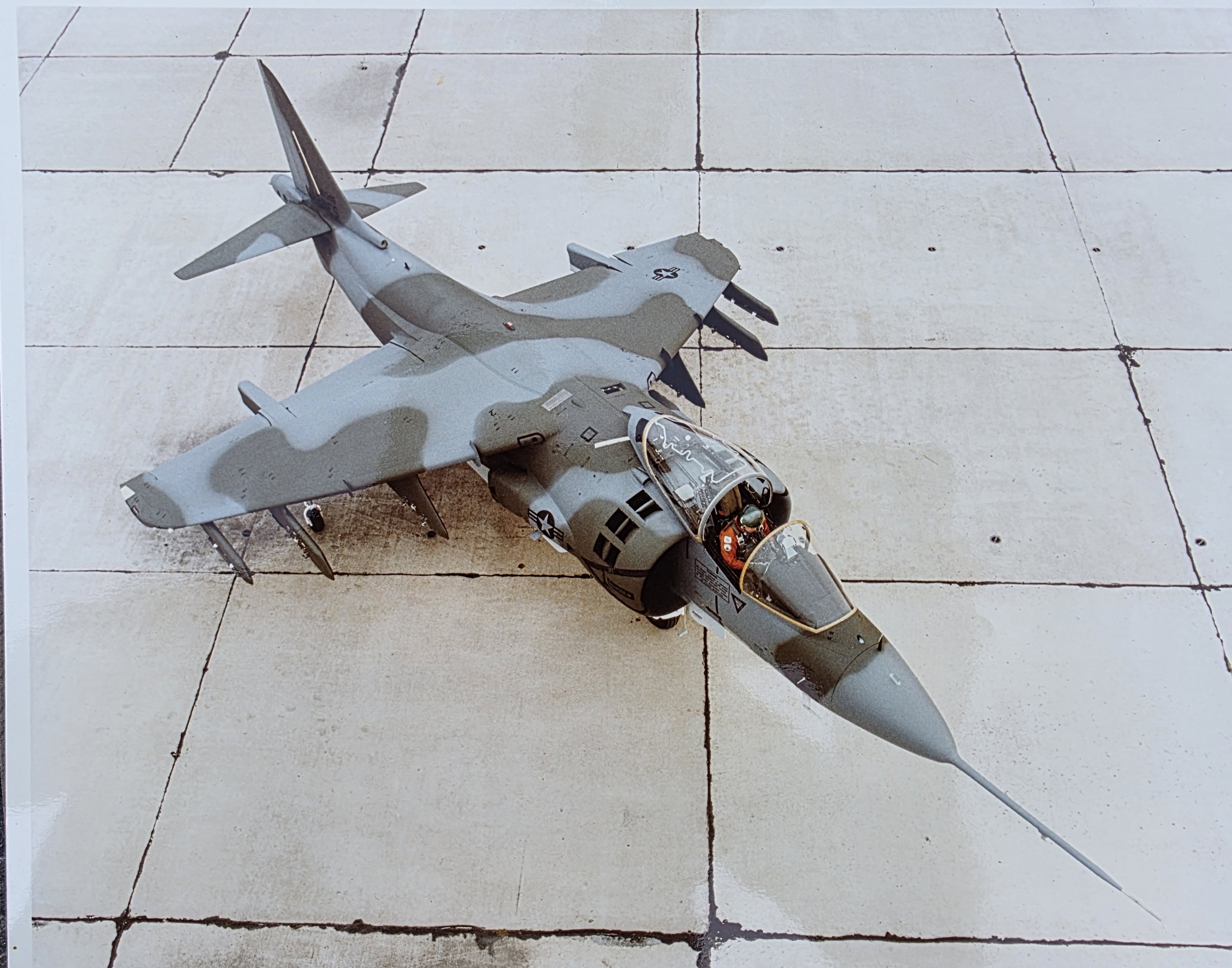

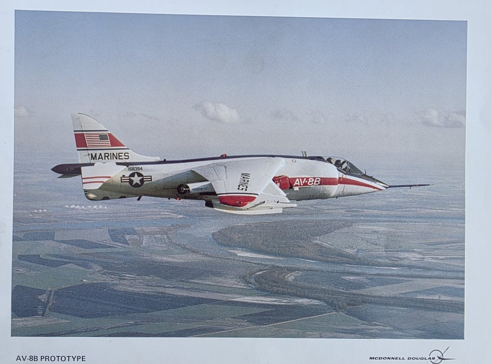

fasteagle12 Posted June 17, 2025 Share Posted June 17, 2025 (edited) A kit bash would definitely be needed to do the first prototype. I'm not sure of all of the differences, but I know the 'B' wing was mounted to an 'A' fuselage (or maybe a full 'B' fuselage and wing with only the 'A' nose/cockpit). The camo bird was one of the early full 'B' birds. The red, white, and blue photos are from Oct 1978 and the camo from Oct 1981. Edited June 18, 2025 by fasteagle12 Clarification Quote Link to post Share on other sites

The Arrowhead Posted June 22, 2025 Share Posted June 22, 2025 (edited) There is already a 1:48 YAV-8B and Kestrel sheet available (somewhere in Northern Europe where they take care of baby seals 😉 ) but I’ m definitely in for a treatment the Caracal way. It’s my next cross-kitting on the list (Kinetic AV-8A x Hasegawa AV-8B)! There were slight marking evolutions during the life of both YAV-8Bs (one of the two being very short lived indeed), not to forget the final NASA guise. Along with some colorful FSD jets, it would make for a perfect Early Years sheet! Edited June 22, 2025 by The Arrowhead Quote Link to post Share on other sites
