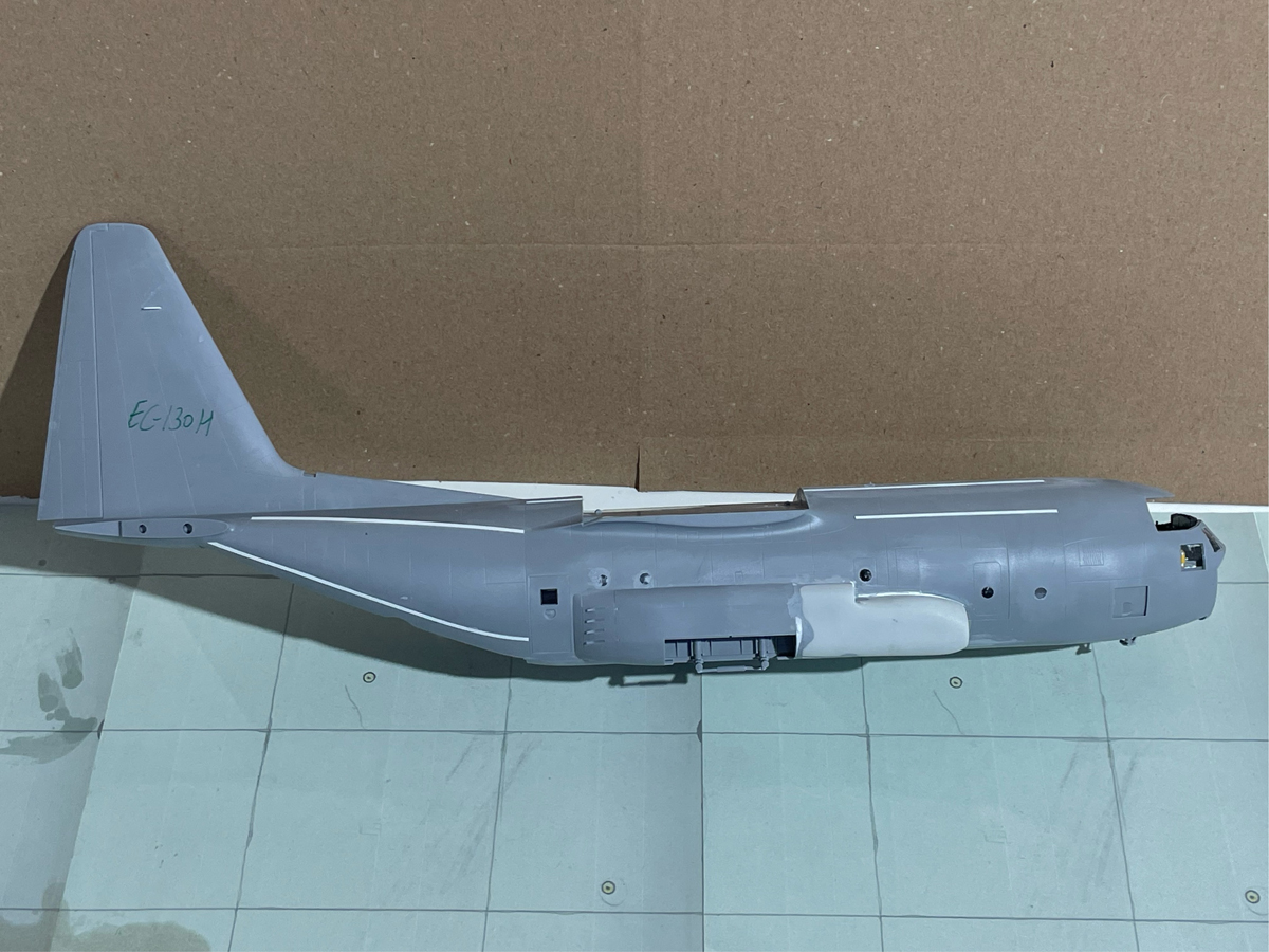

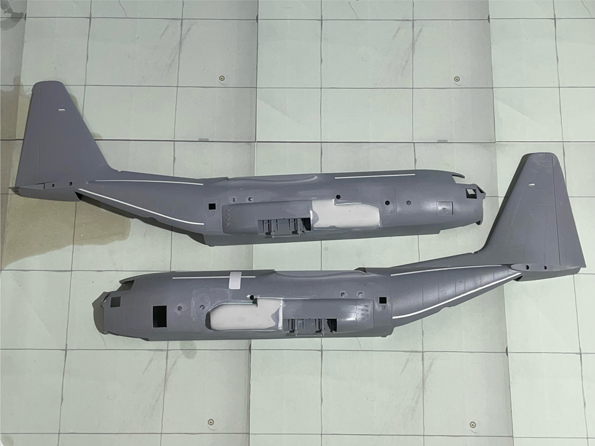

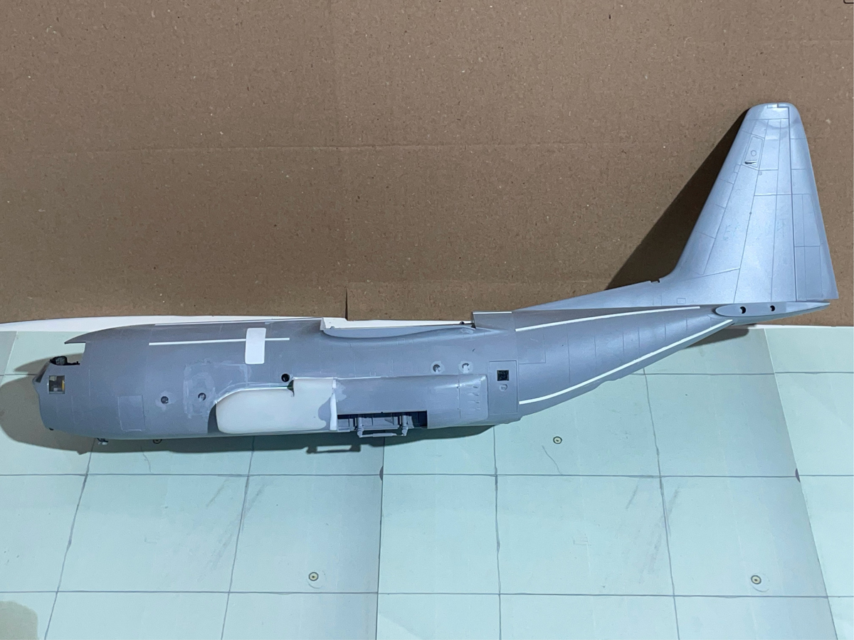

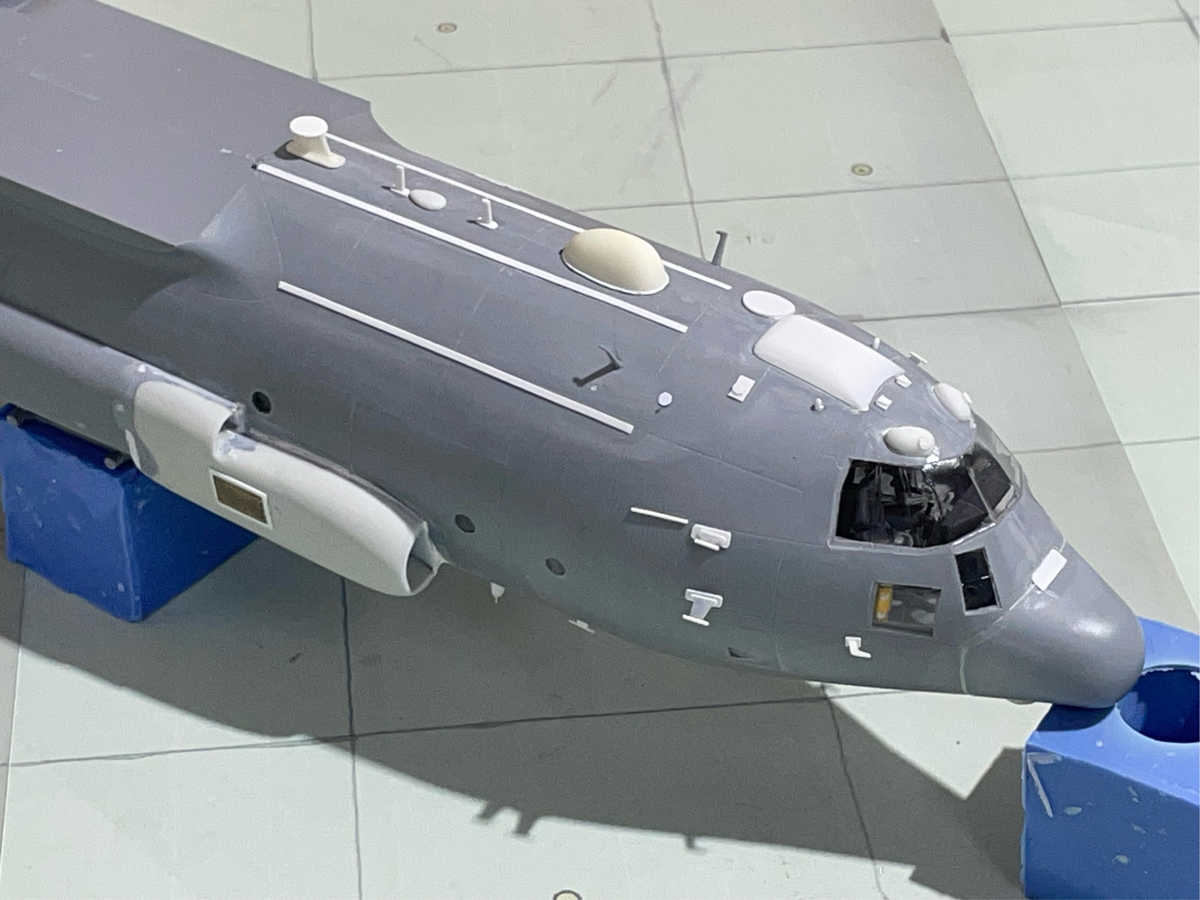

AWACS-RESIN Posted July 17 Share Posted July 17 Now I'm tackling a challenging project: the EC-130H Compass Call. I started with some reinforcements on the fuselage and then moved on to the two sponsons that needed modification. These are longer and each have two air intakes. Some windows also need to be sealed. We'll see how the project develops. I'm excited. Quote Link to post Share on other sites
A-10 LOADER Posted July 17 Share Posted July 17 Nice start so far Jost. I'm very interested to see what you'll do for all that "netting" of aerials. Steve Quote Link to post Share on other sites

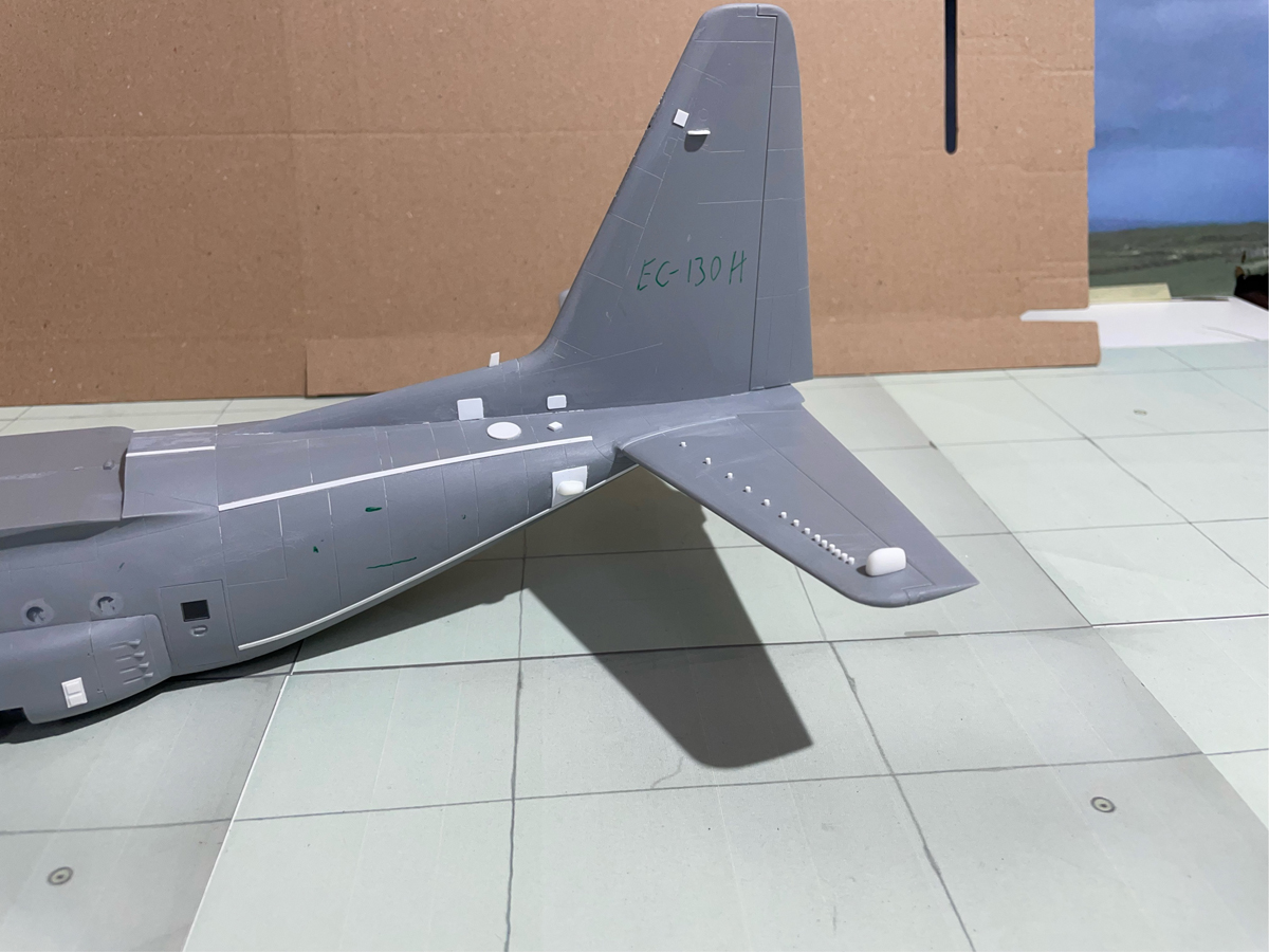

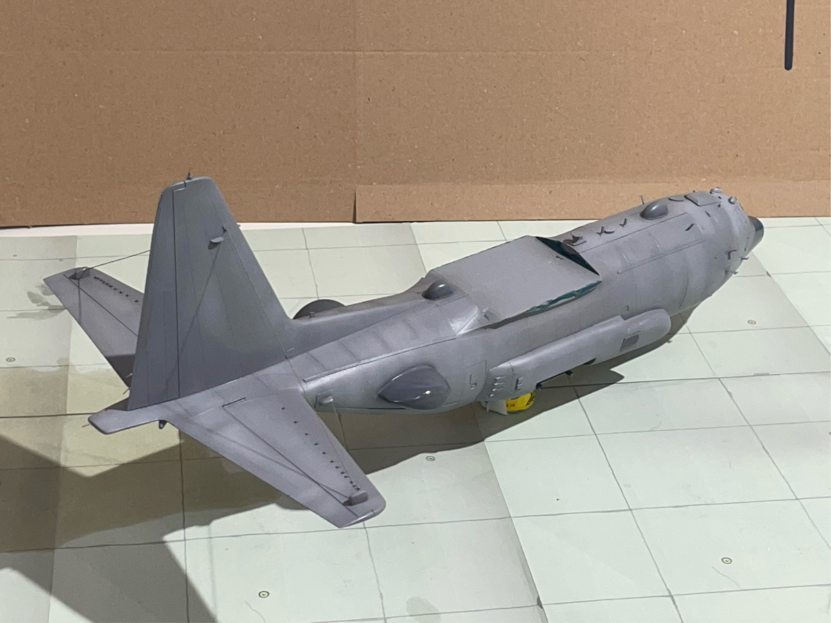

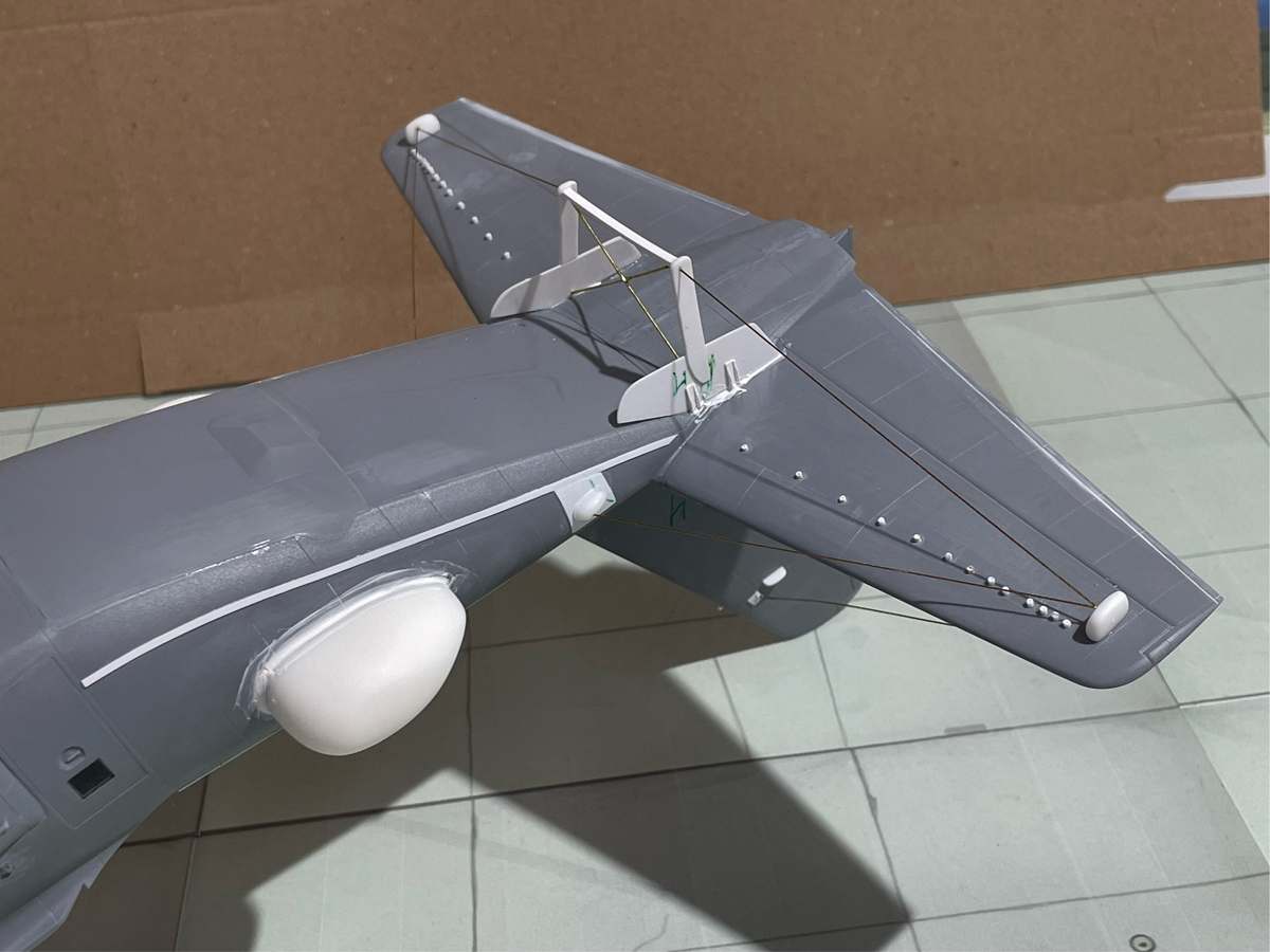

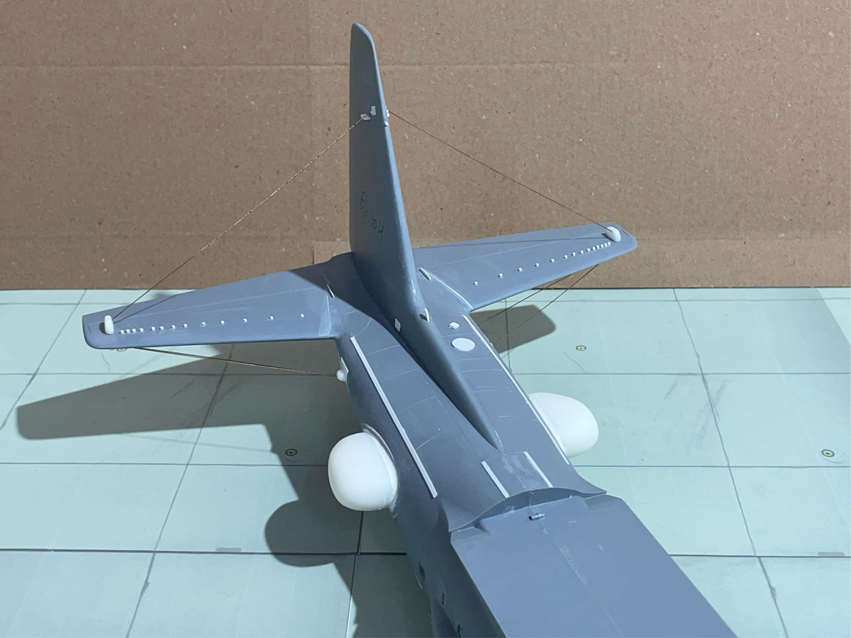

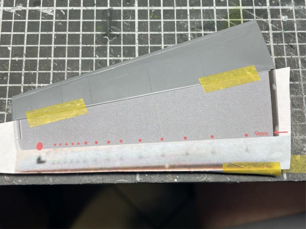

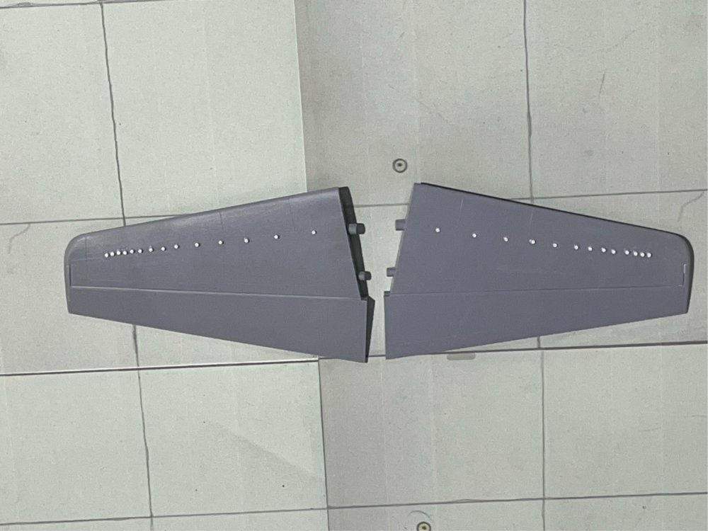

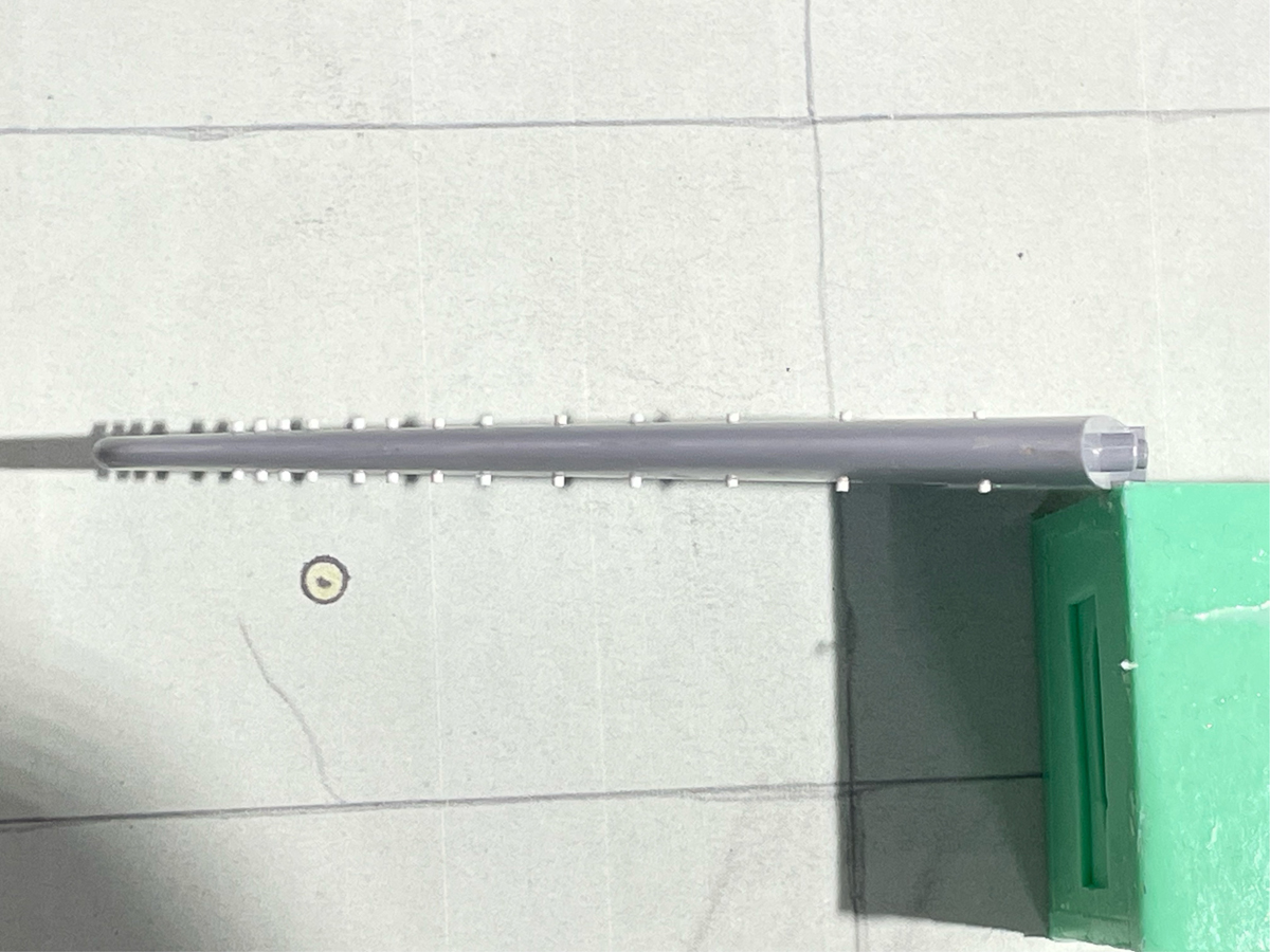

AWACS-RESIN Posted July 19 Author Share Posted July 19 (edited) Next up are the horizontal stabs. I've installed the bases for the 14 wires at the top and bottom. To get the correct spacing, I made a template. Now I have attached the stabs and some add ons in the rear area of the fuselage. The six base wires were then attached. The next challenge will be installing the wire mesh. But first I have to order thin wire. But in the meantime, I've finished making and installing the frame under the fuselage. Also, I made the 2 large fairings and installed them to the rear sides. All in all, I'm relatively happy with the look of the whole installation. Edited July 19 by AWACS-RESIN Quote Link to post Share on other sites

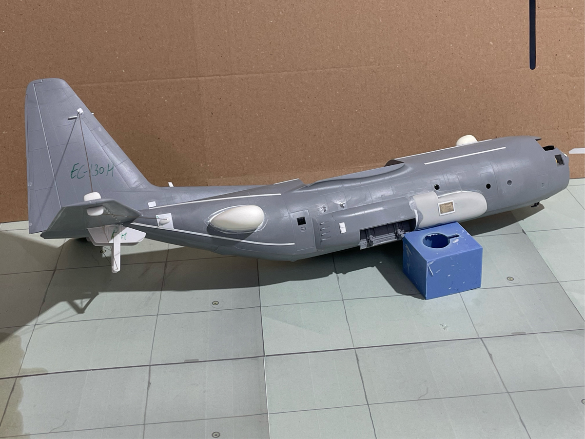

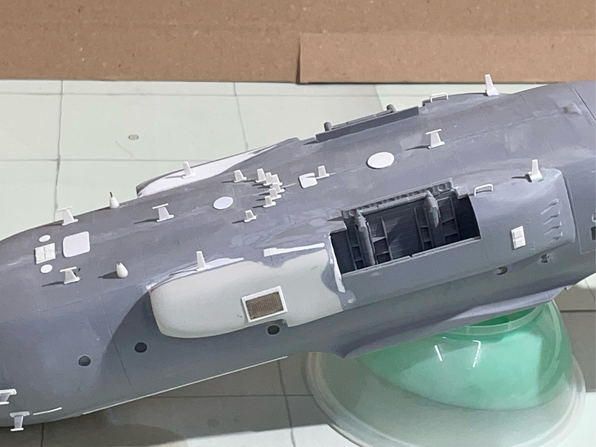

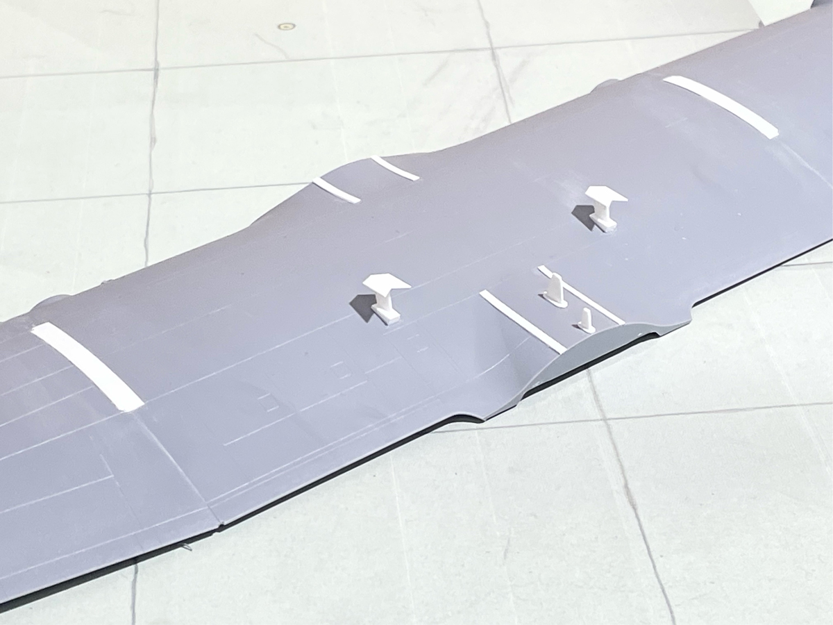

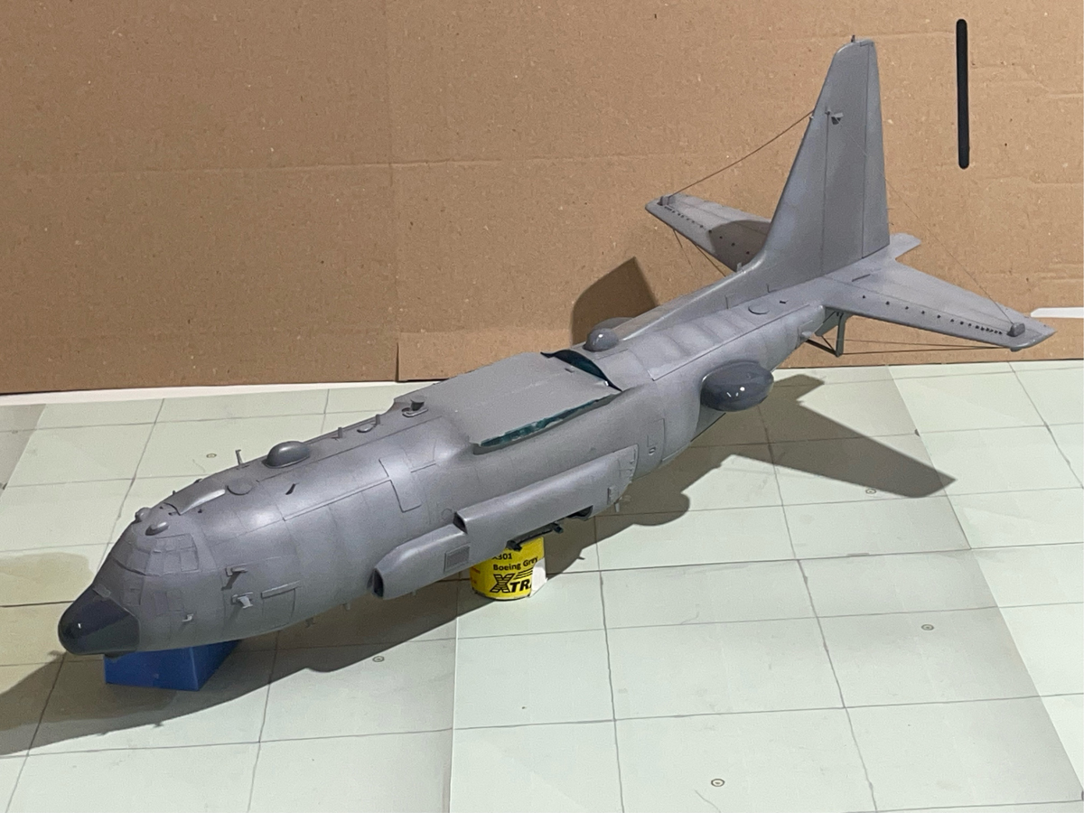

AWACS-RESIN Posted July 21 Author Share Posted July 21 A bit more work on the FWD Fuselage and the wings. Quote Link to post Share on other sites

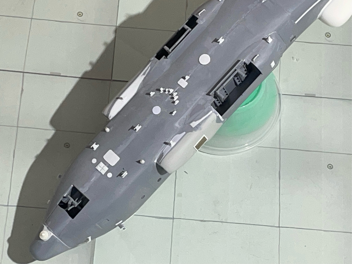

AWACS-RESIN Posted July 24 Author Share Posted July 24 The fuselage is now largely finished. Now everything is being cleaned and prepared for spraying. However, I haven't decided yet whether I will spray the fuselage before or after installing of the antenna mesh. Quote Link to post Share on other sites
A-10 LOADER Posted July 24 Share Posted July 24 Great job on all the add-ons Jost ! If it were me, I'd leave the antenna mesh off until the end. Steve Quote Link to post Share on other sites
AWACS-RESIN Posted July 24 Author Share Posted July 24 41 minutes ago, A-10 LOADER said: Great job on all the add-ons Jost ! If it were me, I'd leave the antenna mesh off until the end. Steve Thanks Steve. Yes, maybe I‘ll do that. Quote Link to post Share on other sites

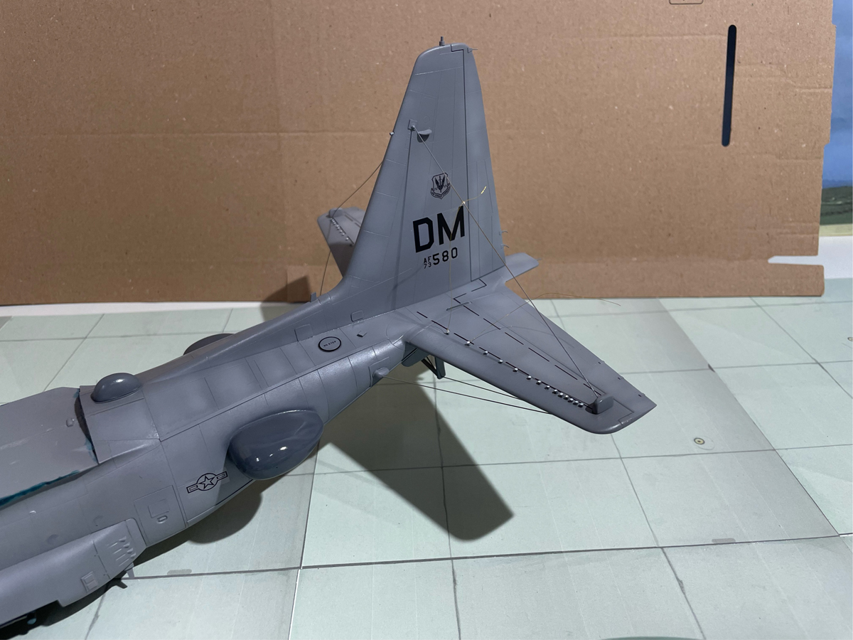

AWACS-RESIN Posted August 8 Author Share Posted August 8 So, on with the Compass Call. I've finished spraying the fuselage and applied some decals to the tail. I usually use Xtracolor paints. For this aircraft, I used Hataka Orange Line paint. Since the ECs had weathered over time, as you can see in many photos, the Hataka paint was a great fit. Its color, FS36173, is a bit lighter than Xtracolor. It's very easy to work with. I then added some more lightened paint. Now comes the difficult part. I'll slowly start installing the mesh. Since the wire is very thin, gluing it together isn't so easy. I'm using wood glue for this. Let's see how it goes. Quote Link to post Share on other sites
