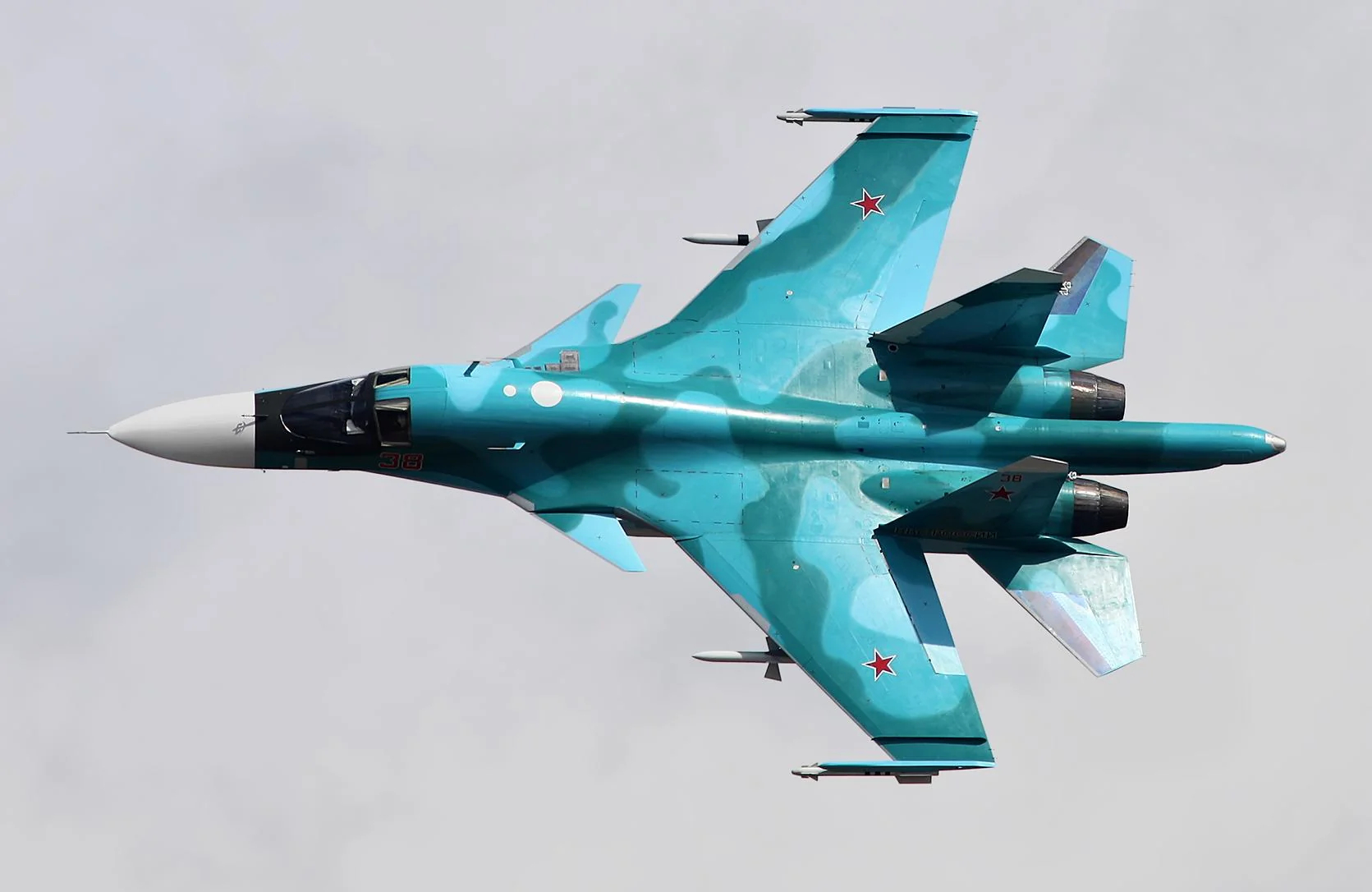

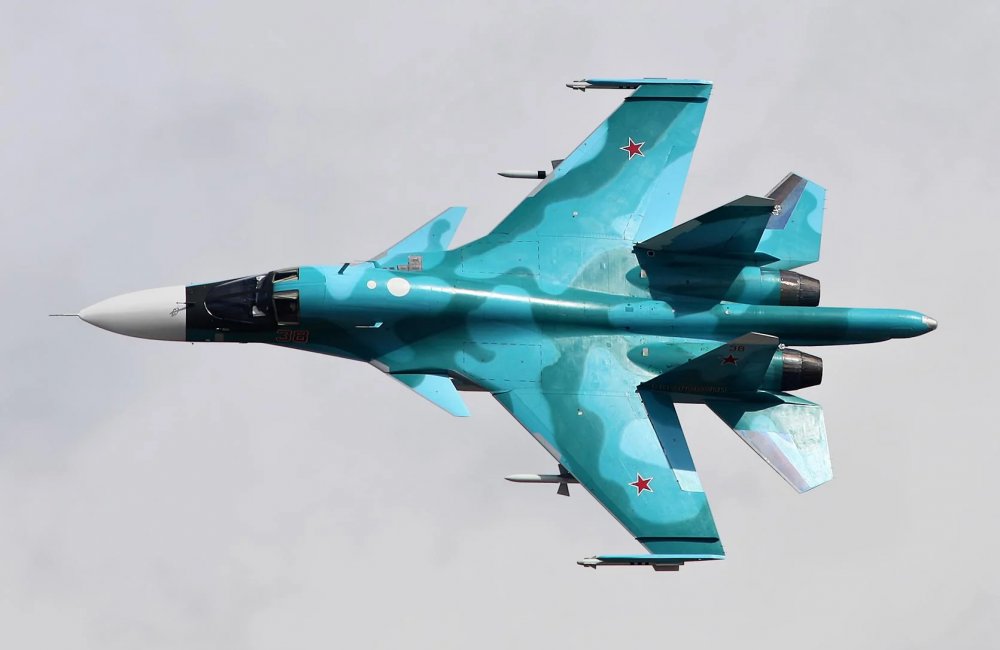

wm_cheng Posted August 20, 2025 Share Posted August 20, 2025 Help, what are the best Mr. Color lacquer paints to use for this 3-tone blue/green camo for the SU-34? (I see MRP makes a set, but I am not familiar with them, are they a lacquer - I would prefer to stick to Mr. Color if possible). I think there might be some mixing involved I guess. (I'm prepping for the upcoming 1/72 TempModels resin SU-34 but I don't have Mr. Color information). TIA! Quote Link to post Share on other sites
seawinder Posted August 20, 2025 Share Posted August 20, 2025 IMHO MRP will be a better choice if they've got the correct colors in their line. MRP is a lacquer (can be mixed with Mr. Color). The paints are pre-thinned and airbrush only. They don't nail every shade (who does?), but in my experience they're generally at least well within the ballpark. Quote Link to post Share on other sites

seawinder Posted August 21, 2025 Share Posted August 21, 2025 I'm not sure what true lacquers are. MRP paints are part of that growing group of lines that are often called acrylic lacquers. As I said, they mix easily with Mr. Color, which I think is also characterized as an acrylic lacquer (whether accurately or not). Like Mr. Color, MRP paints are impervious to mineral spirits (regular paint thinners), and things like Tamiya Panel Line Accent can be used over them without the need for a barrier coat. Dunno if this is any help. As for sourcing them, are you able to purchase from Sprue Brothers? If so, they carry the MRP line and have four different Su-34 colors in stock: https://spruebrothers.com/search-results-page?q=su-34 Quote Link to post Share on other sites

Helmsman Posted September 1, 2025 Share Posted September 1, 2025 AKAN is a very good option. https://tempmodels.ru/sovremennaya-aviaciya-rossii-su-32-34 Quote Link to post Share on other sites
