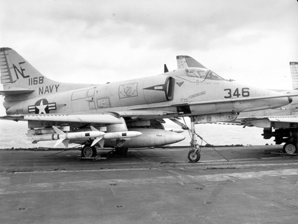

Skinny_Mike Posted September 22, 2025 Share Posted September 22, 2025 Hi everyone! I’m currently working on an A-4 that I plan to put on a carrier deck base. I’m trying to understand where the wing tie down points are. I have the attached photo as reference. Any help is appreciated. Quote Link to post Share on other sites

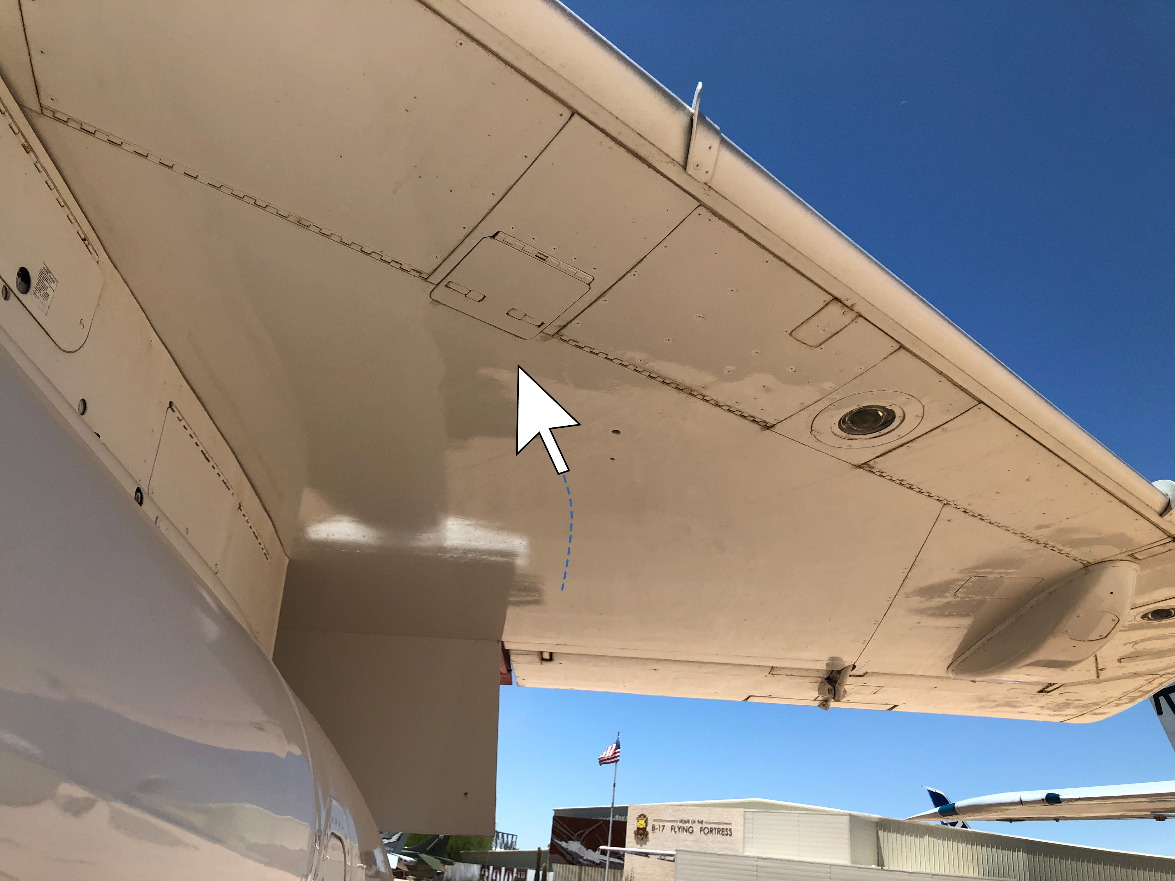

RichB63 Posted September 22, 2025 Share Posted September 22, 2025 Quote Link to post Share on other sites
Skinny_Mike Posted September 22, 2025 Author Share Posted September 22, 2025 Thanks Rich! That is kind of where I thought the tie down point would be. Does anyone happen to have a picture of what’s behind the door? thanks Mike Quote Link to post Share on other sites

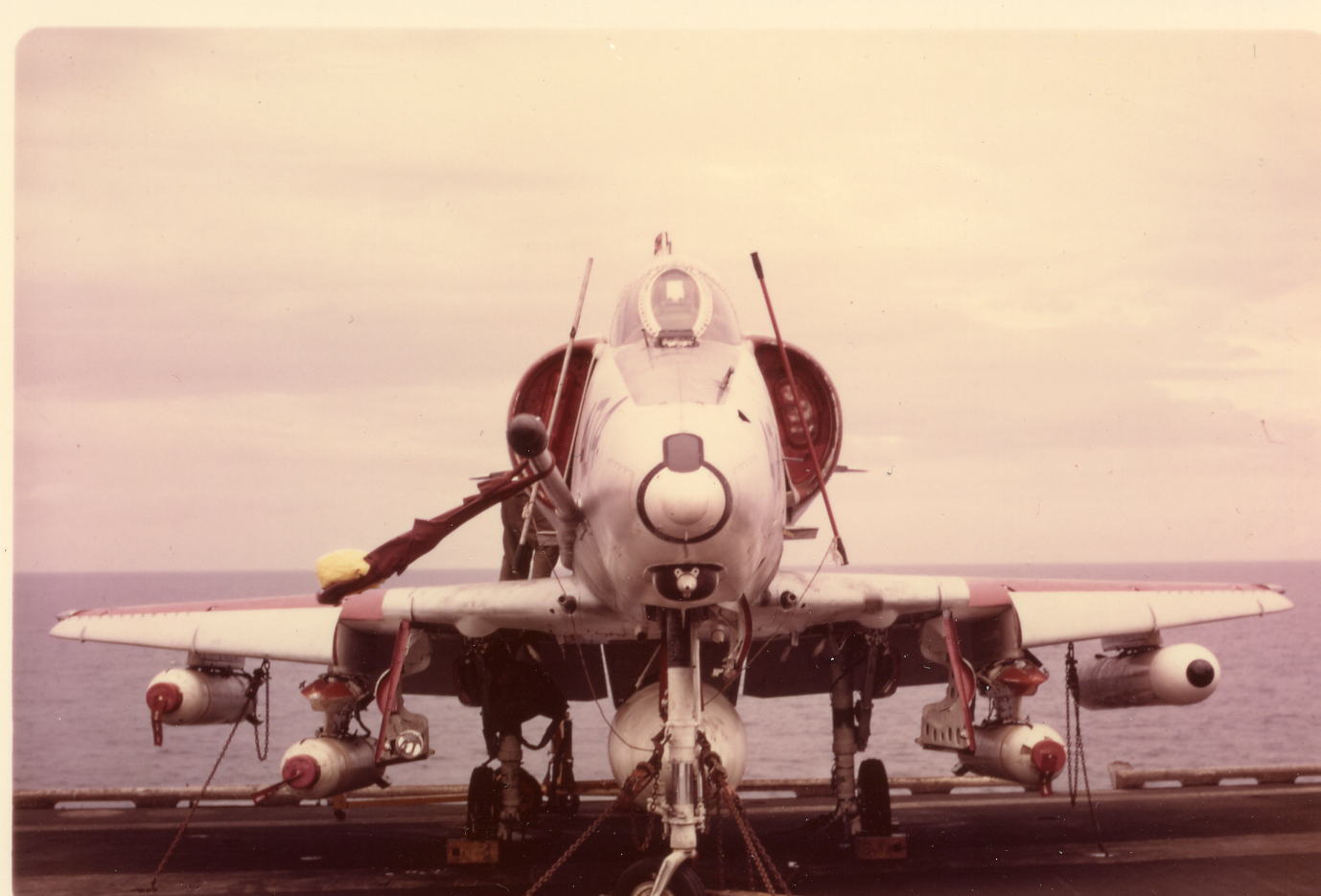

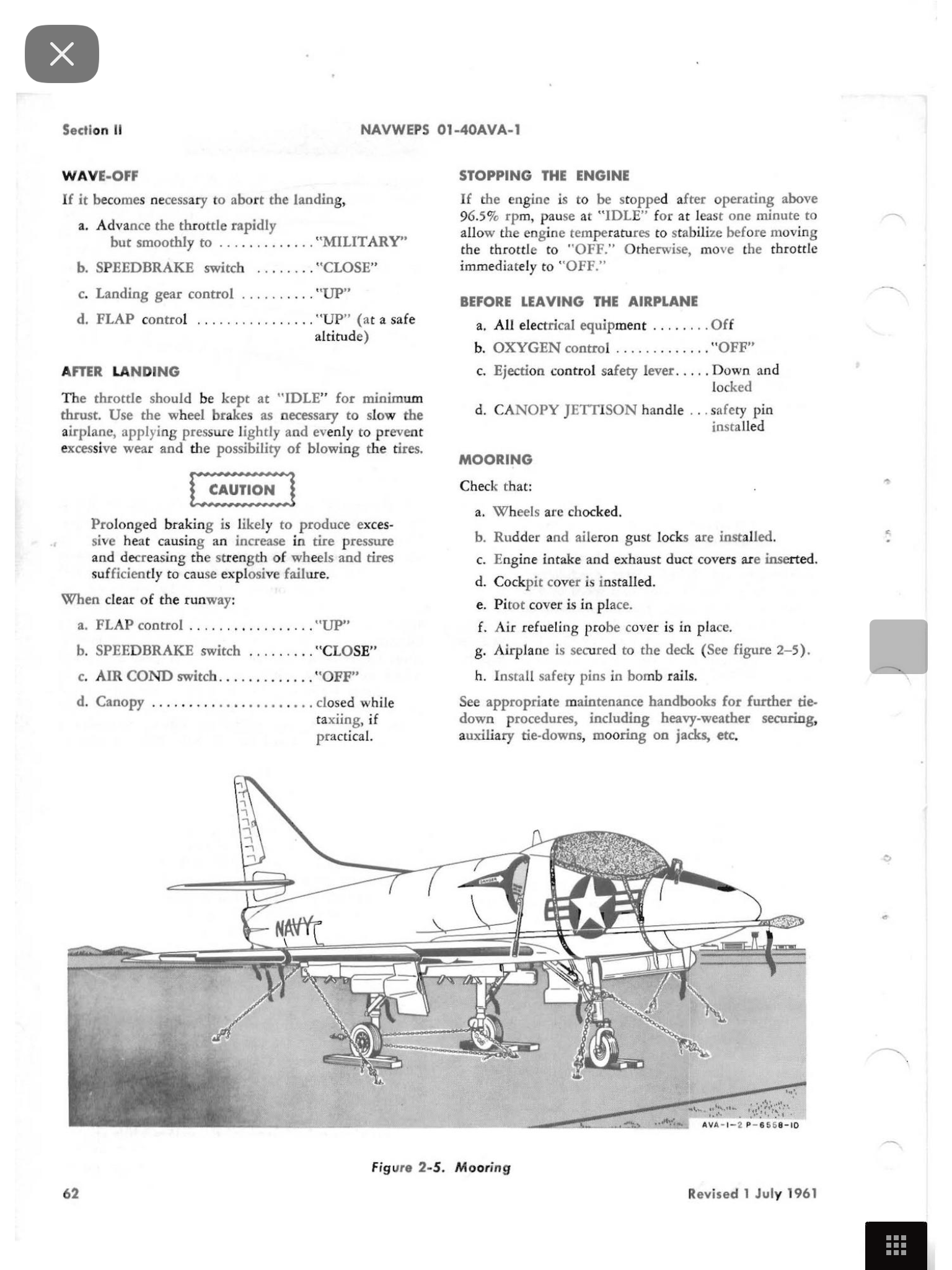

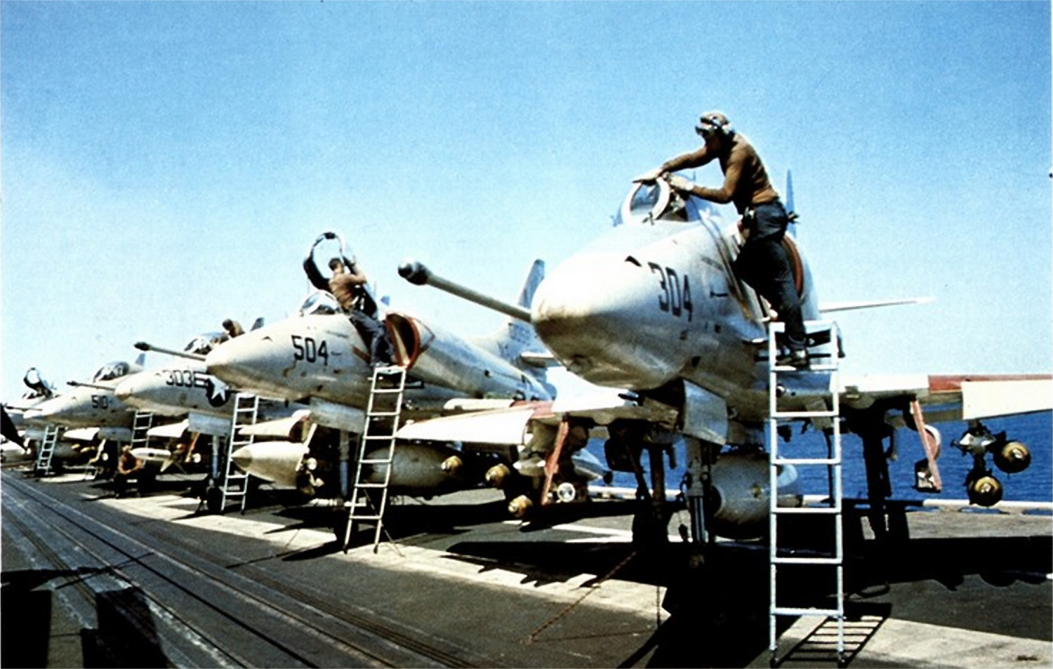

Finn Posted September 22, 2025 Share Posted September 22, 2025 (edited) Here are a few examples, i think the wing tie down chains were removed to make loading easier: edit: one more, if not due to go flying soon it looks like chains were put back on and pins installed: Jari Edited September 22, 2025 by Finn Quote Link to post Share on other sites
GW8345 Posted September 23, 2025 Share Posted September 23, 2025 For a plane that is ready for the next launch (i.e. loaded and prep'ed), only 6 chains would be on the aircraft. Usually the plane would have 2 chains per landing gear strut unless there wasn't a way to do that, then other tie down points would be used. hth GW Quote Link to post Share on other sites
