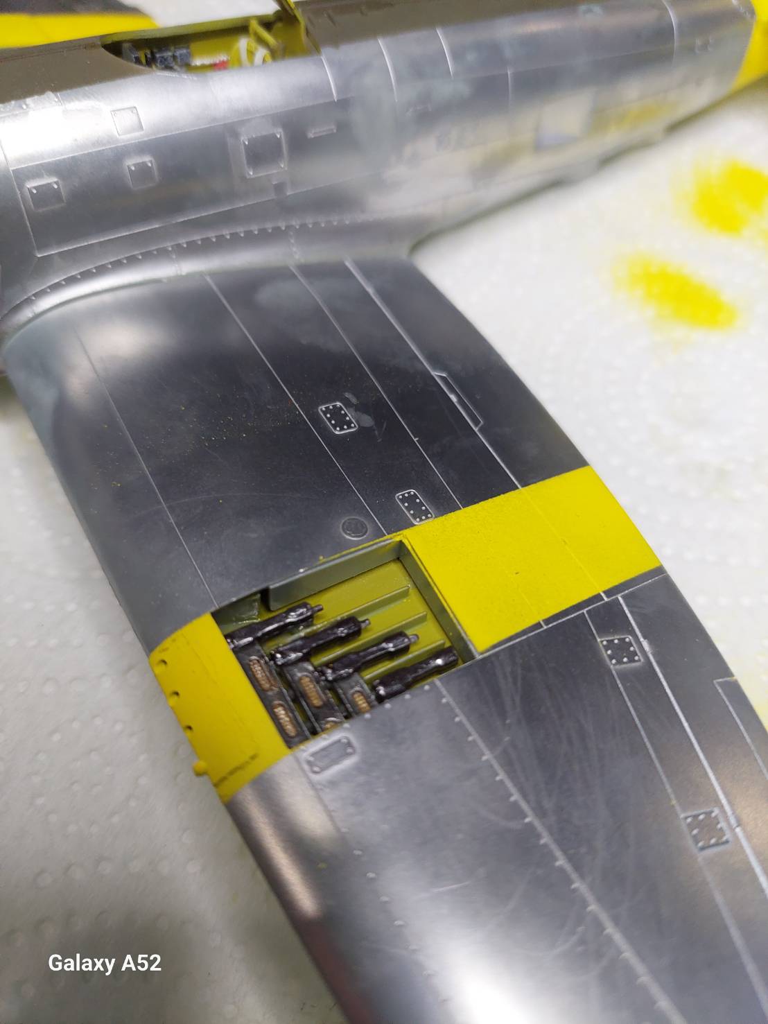

Dog1 Posted September 23, 2025 Share Posted September 23, 2025 hello , i finished applying mr metallic aluminium on my styrene wings and fuselage and left it to rest 24 hrs then buffed and all is well . Now i want to apply stainless mr color for the first time to a couple of panels for contrast . Since its the first time , is there anything i must know before proceeding , any risks , issues ? Quote Link to post Share on other sites

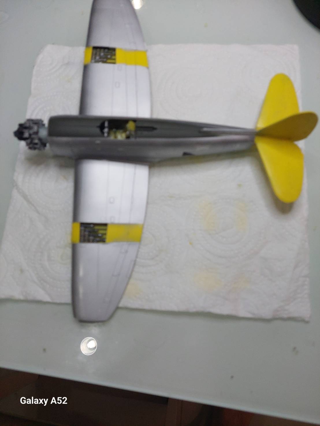

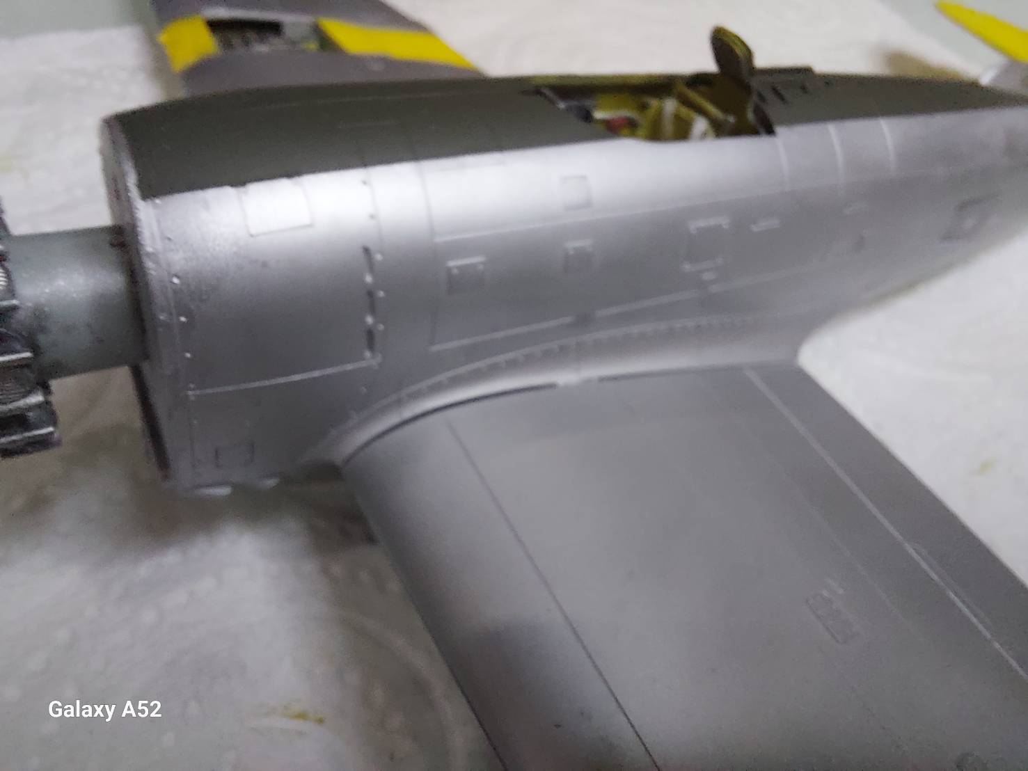

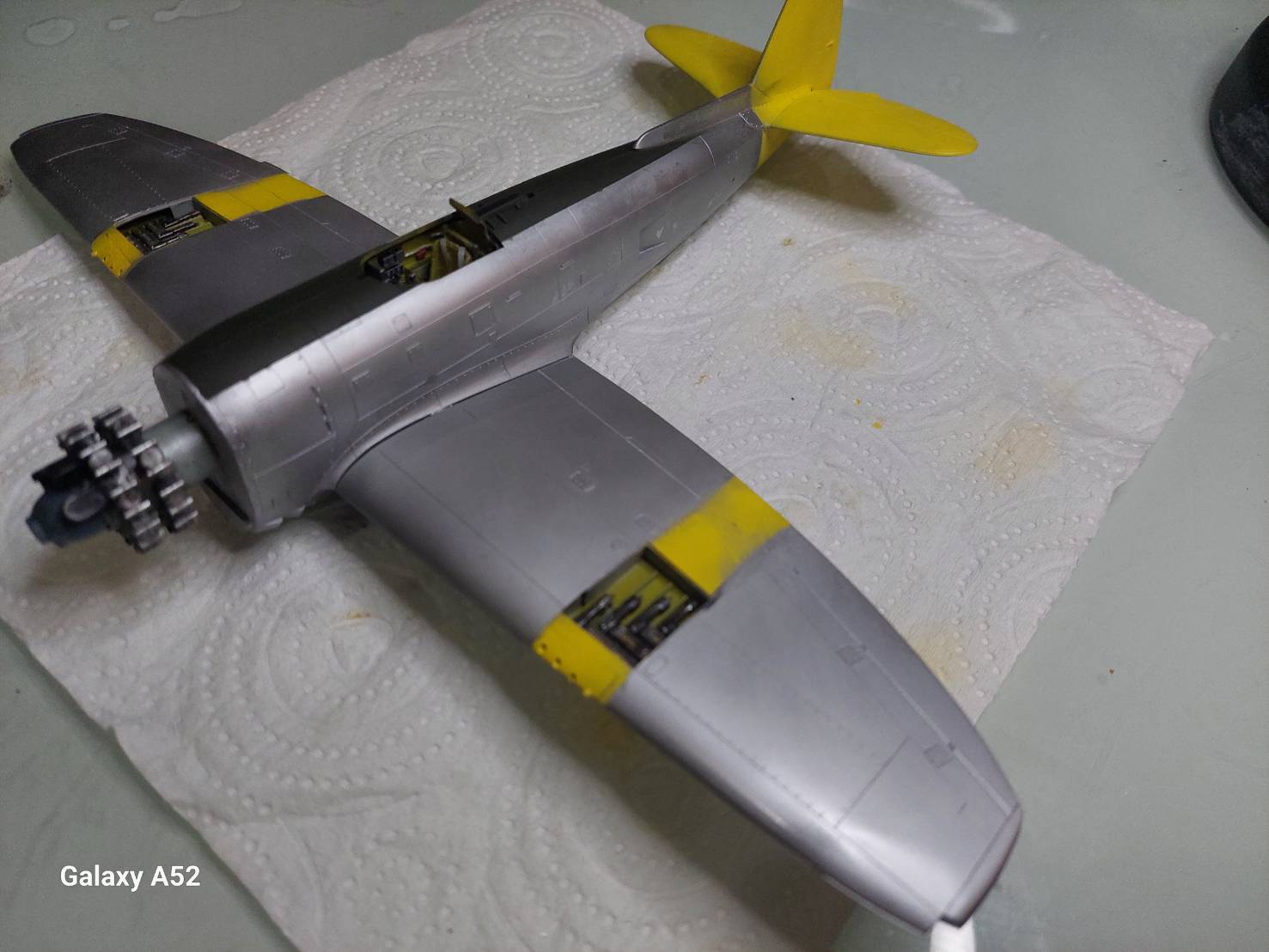

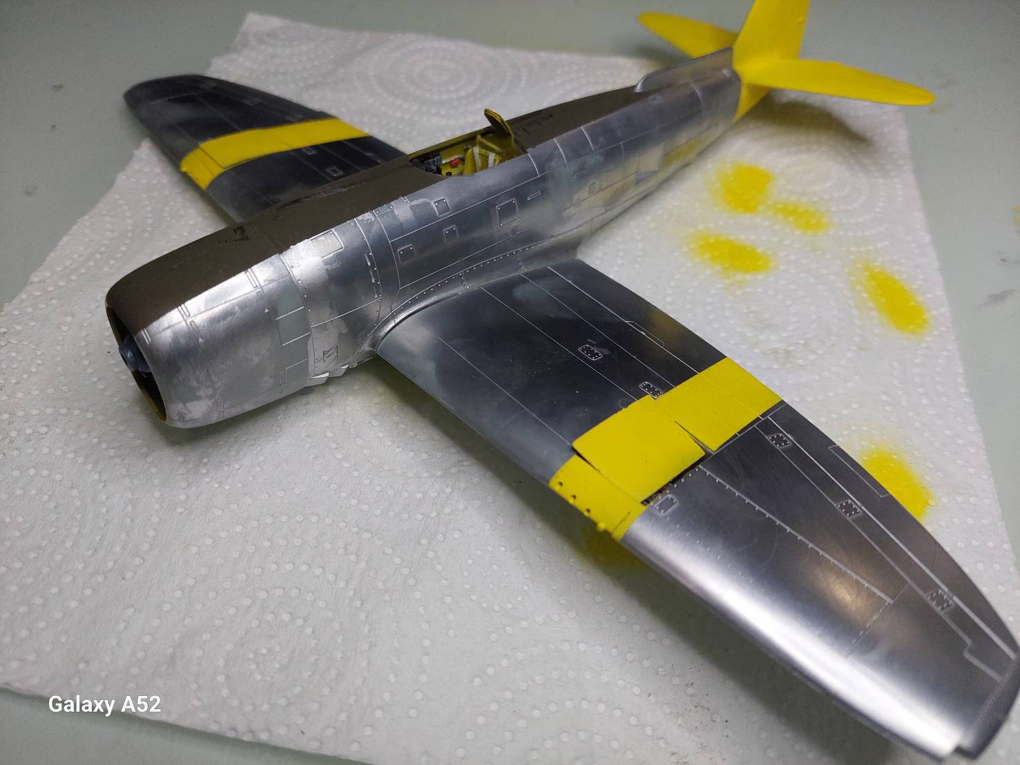

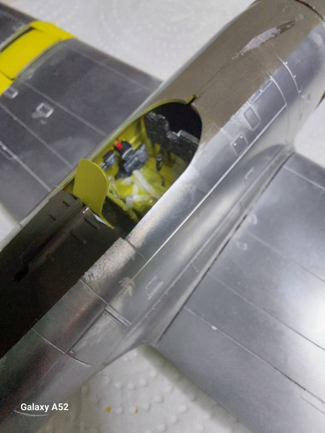

Dog1 Posted September 26, 2025 Author Share Posted September 26, 2025 (edited) here is where i stand now and i am not satisfied at all with the result , your opinions would be greatly appreciated to avoid this mistake the next time i do a NMF aircraft , my question is why did i succeed in my first atempt spraying only one layer of tamiya aluminium and buff with kitchen paper a couple of hrs later i get the NMF effect " polished aluminium " and then applying the 2 extra coats and rest for 24 hrs before buffing with a cotton t shirt i never got back to the first layer NMF effect now it looks "aluminium " , i then buffed and sprayed tamiya clear , i get something very different as per set of photos . your comments and advice would be appreciated . Edited September 26, 2025 by Dog1 Quote Link to post Share on other sites
