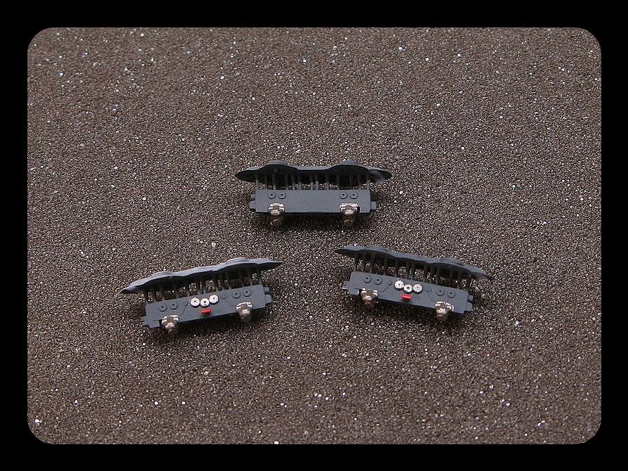

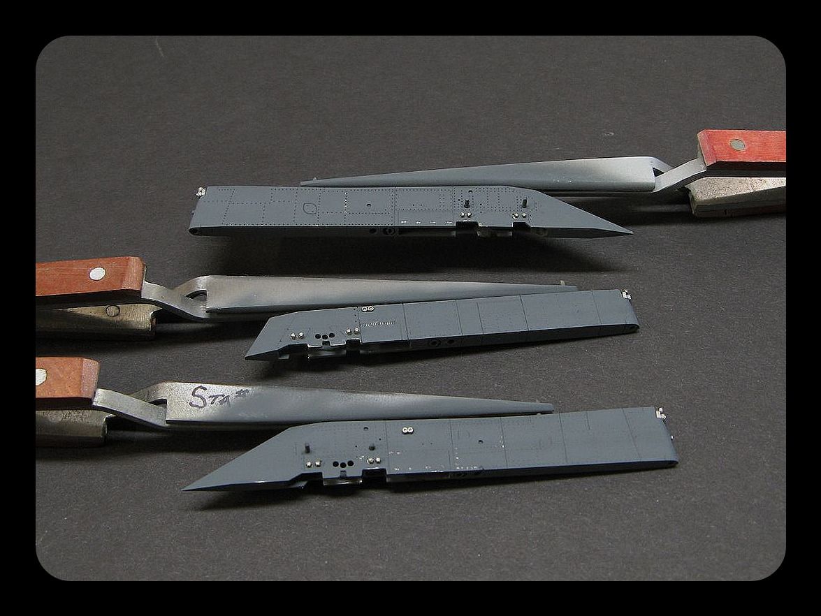

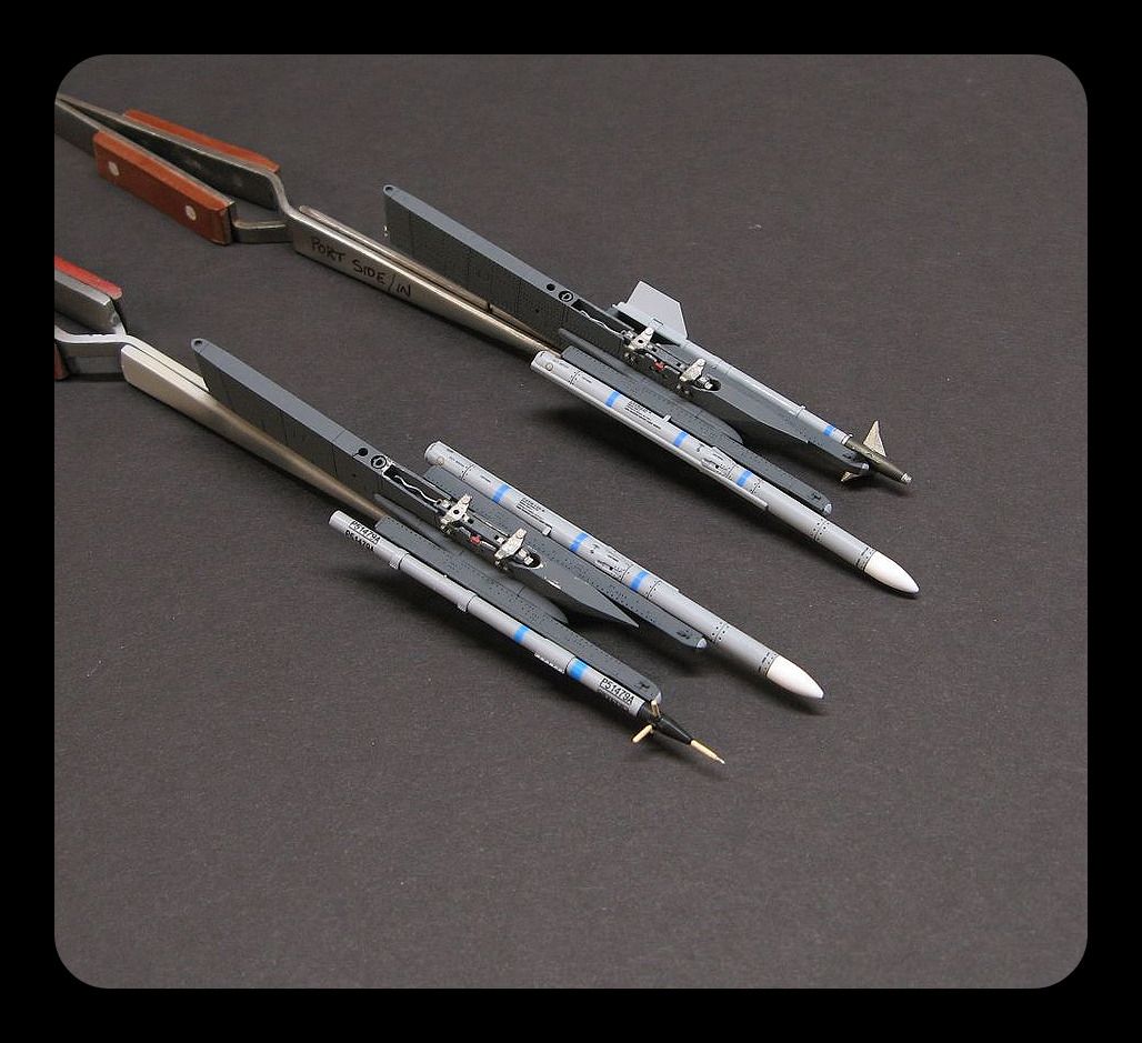

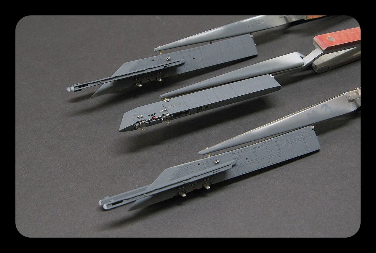

A-10 LOADER Posted November 30, 2025 Author Share Posted November 30, 2025 Thanks Jeff. Update for today, I finished up the Phase Hanger Resin wing / center line pylons and bomb racks. They are a big improvement over the kit parts. Steve Quote Link to post Share on other sites

HOLMES Posted November 30, 2025 Share Posted November 30, 2025 WOWZERS! Steve , the bomb racks and centre line pylons look splendidly. For sure they are absolutely superbly done. Quote Link to post Share on other sites

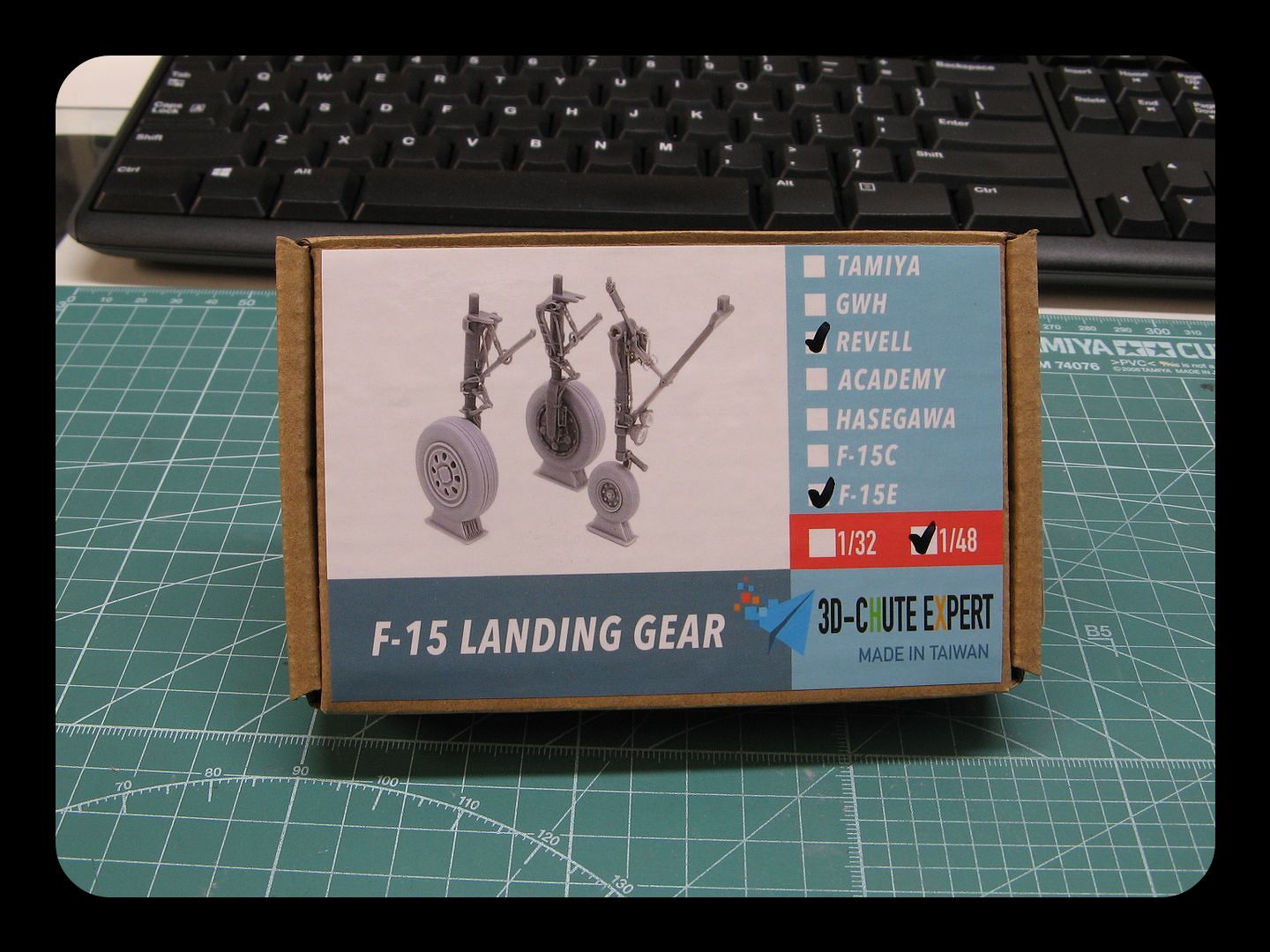

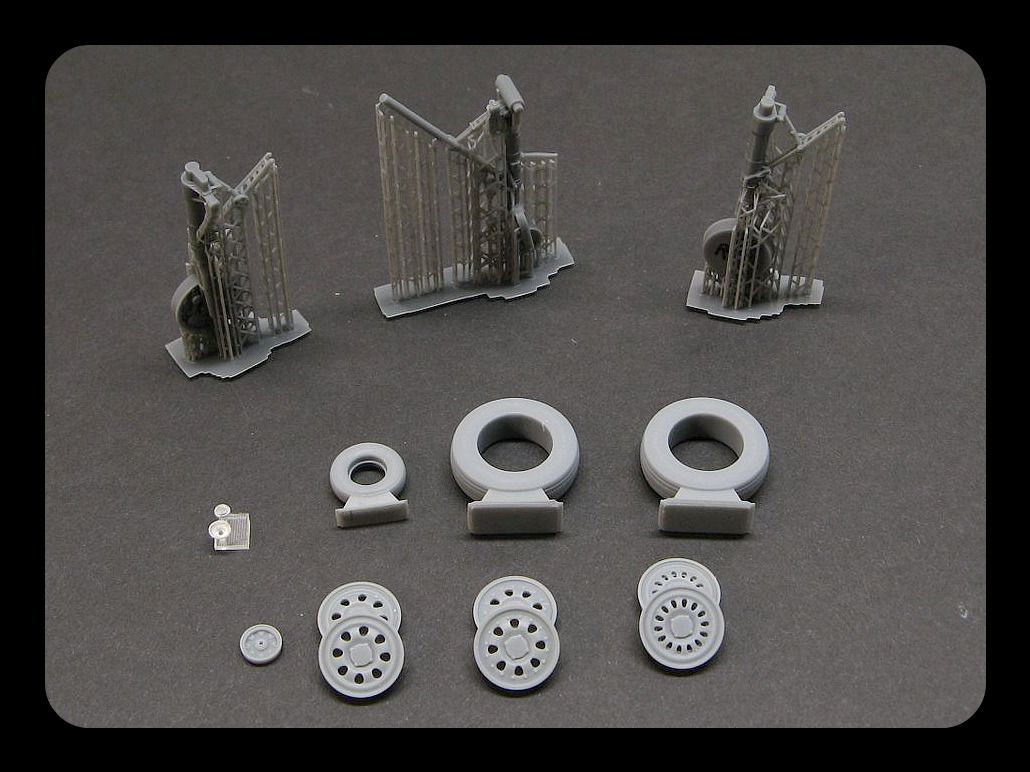

A-10 LOADER Posted December 7, 2025 Author Share Posted December 7, 2025 (edited) I need help from the Strike Eagle experts. My build is from the 2007 timeframe so, what rim face would be correct ? I'm guessing "B" ? I know "C" is late and I'd assume "A" is early. Steve Edited December 7, 2025 by A-10 LOADER Quote Link to post Share on other sites
LDM Posted December 7, 2025 Share Posted December 7, 2025 Here's a pic from Flickr that shows 90-0257 in 2010: https://www.flickr.com/photos/68498610@N03/52524433777/. It looks to be the "Type A" that you show above. It's definitely not "C" and I don't see the bolt heads that "B" has. This earlier photo from 2006 isn't as closeup on the landing gear but appears to be the same wheel: https://www.jetphotos.com/photo/5921534 Quote Link to post Share on other sites
A-10 LOADER Posted December 8, 2025 Author Share Posted December 8, 2025 Thanks LDM, appreciate the pic. I have the lower one saved in my reference folder. Steve Quote Link to post Share on other sites

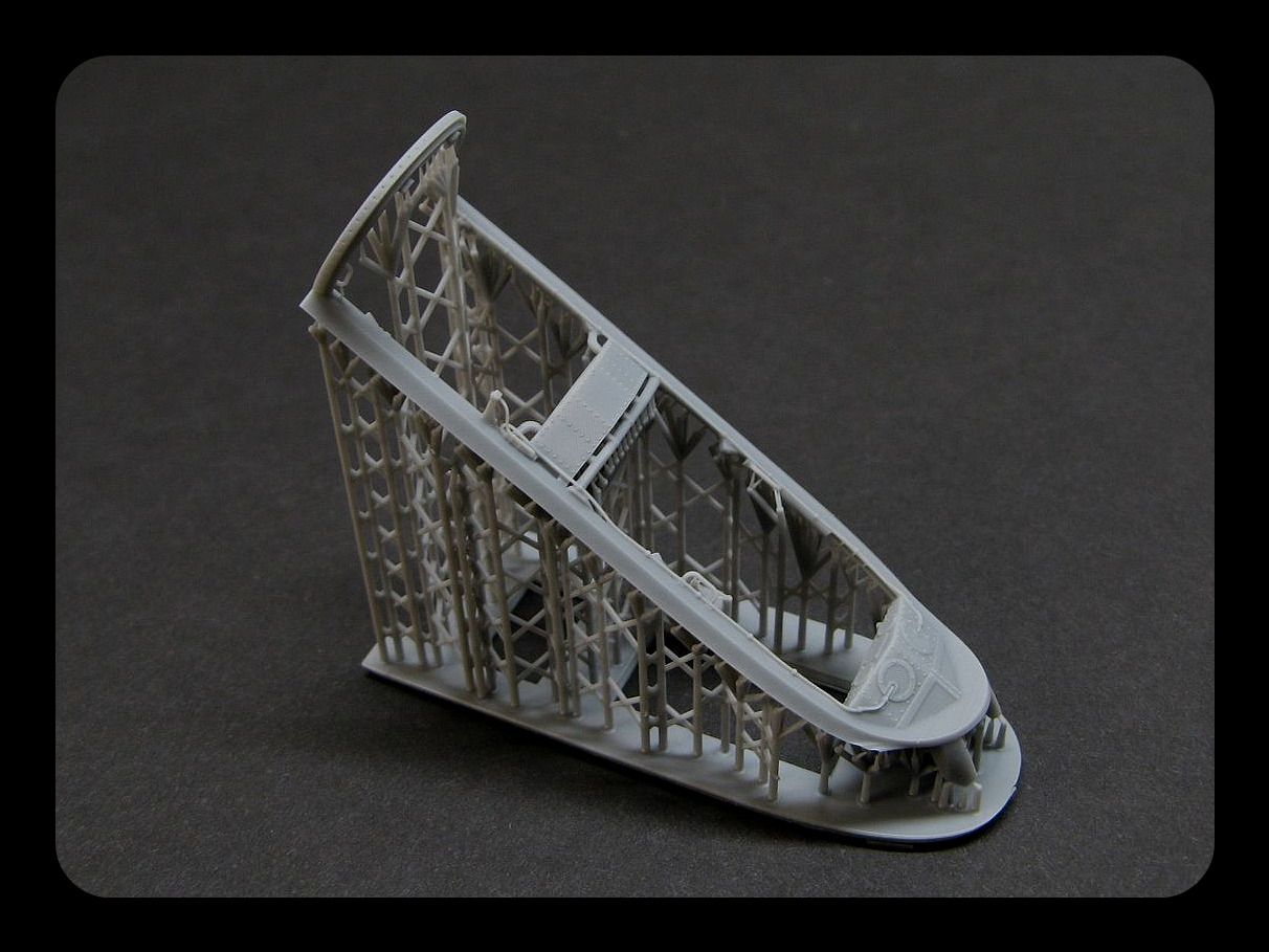

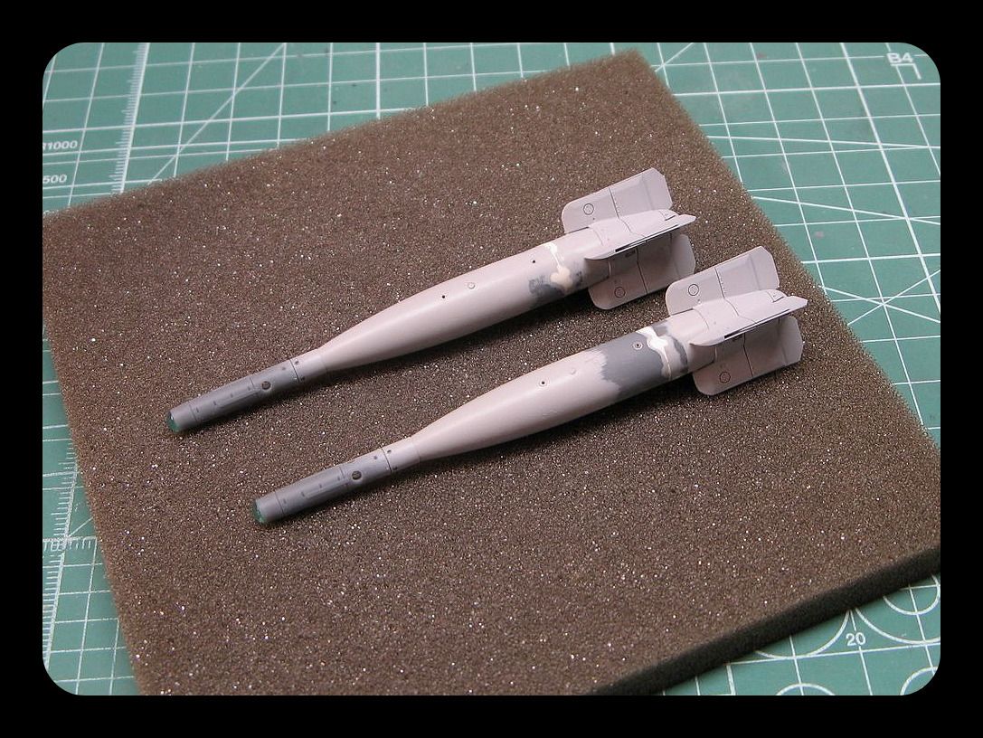

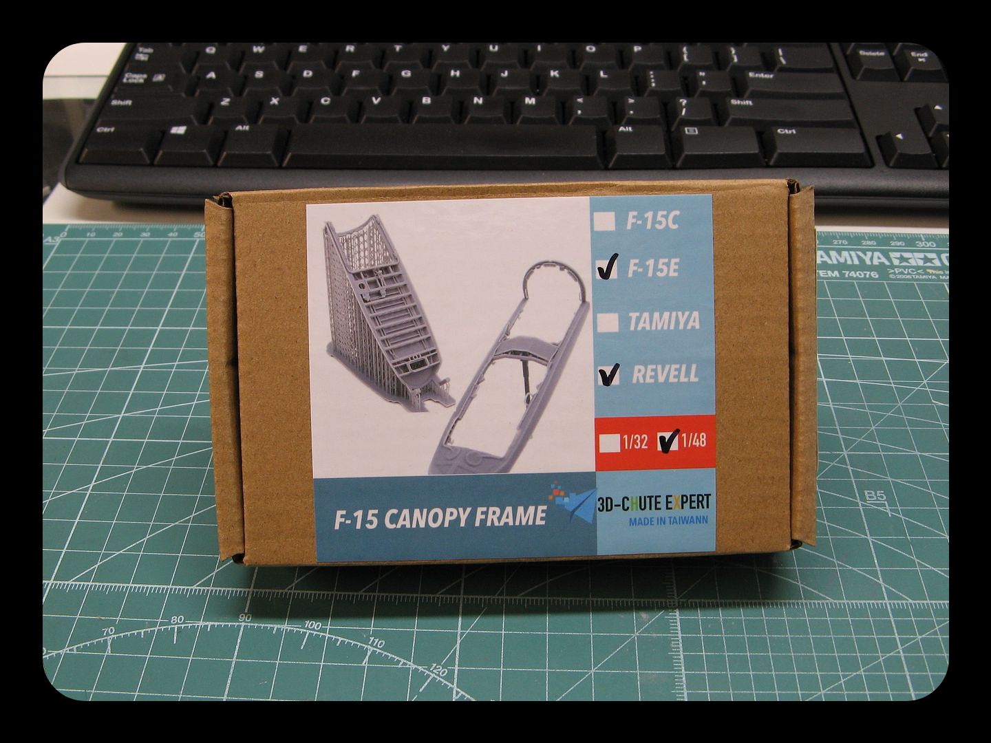

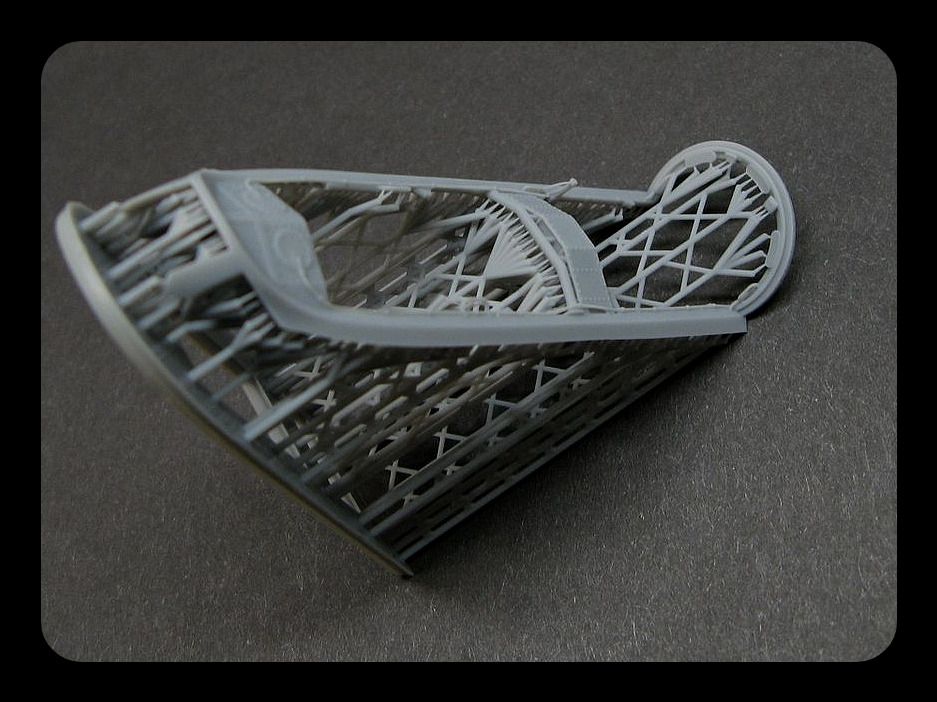

A-10 LOADER Posted December 8, 2025 Author Share Posted December 8, 2025 (edited) Early Christmas gift from a buddy of mine at the model meeting yesterday. Not sure how he was able to get it but, glad he did. Steve Hopefully the seam on the bomb body is fixed this time🤞. This all could have been eliminated if RES/KIT would have just made the tail fin assembly and the bomb body separate pieces. Also would have made painting a lot easier too, now I have to do a lot of masking. Edited December 8, 2025 by A-10 LOADER Quote Link to post Share on other sites
strikeeagle801 Posted December 8, 2025 Share Posted December 8, 2025 I'd go with A. The 3d-Chute stuff is great. Every time I've ordered direct from them, there's been an extra "sample" in with it. I'm building the ResKit GBU-24A/B in both 48th and 32nd scale right now (damn, them boys is big!) and they have the tail piece separated right at the base, so I don't know what the were thinking with the older style ones you're building. Aaron Quote Link to post Share on other sites

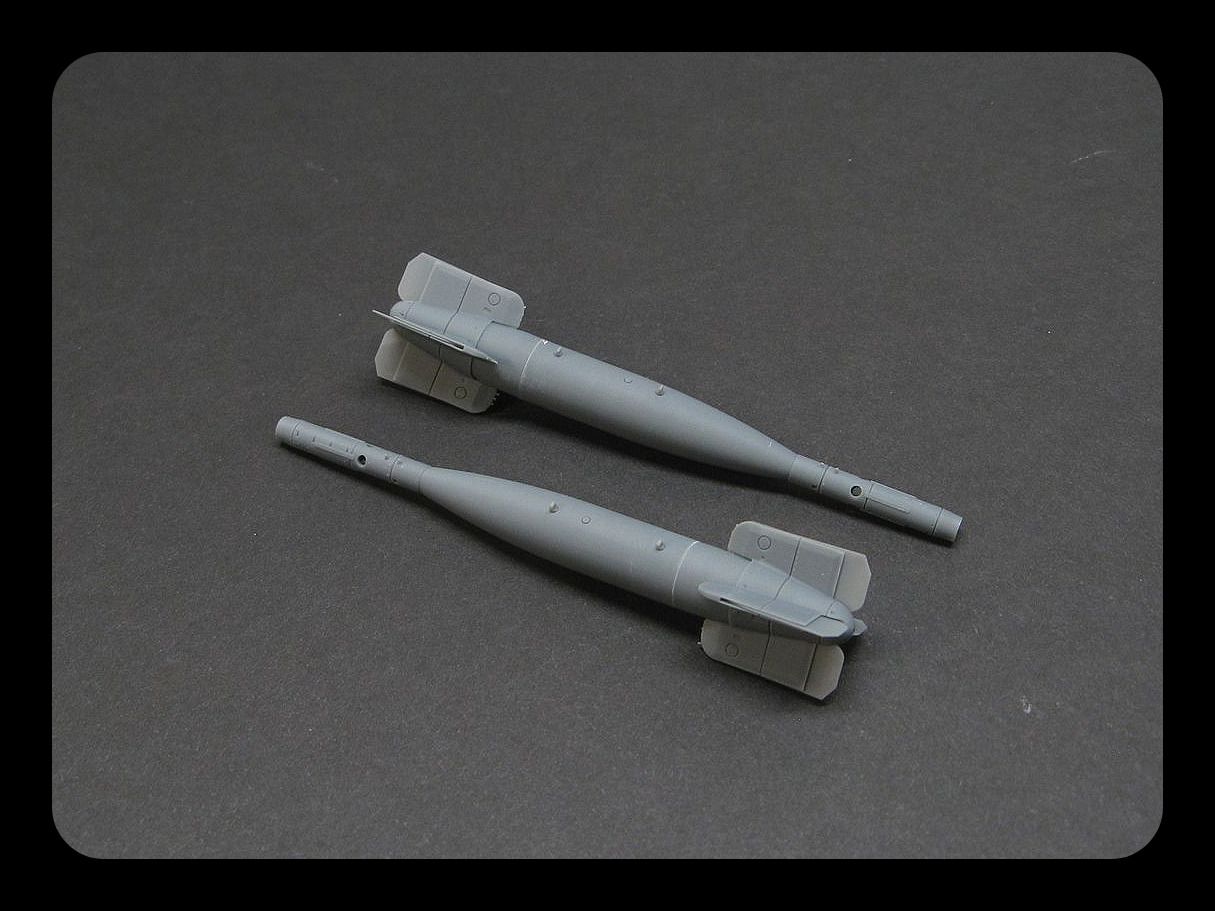

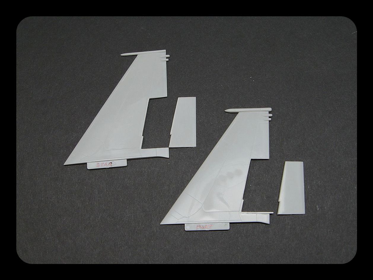

A-10 LOADER Posted December 13, 2025 Author Share Posted December 13, 2025 (edited) I was able to get some things accomplished since my last post. I got the seam on the bomb body taken care of and sprayed the blue, now I'll have to do masking to paint the tail fin assembly. Steve Decided to open up this can of worms, tail rudders cut out using a jeweler's saw and X-ACTO knife. Added some plastic at the bottom of the starboard rudder and bottom edge of the port tail because my cuts were a little off. I'll put two pins in each rudder so I can position them slightly one way or the other. I'll also be adding the "bulges" to the rudders as these were added for strengthening purposes. Edited December 13, 2025 by A-10 LOADER Quote Link to post Share on other sites

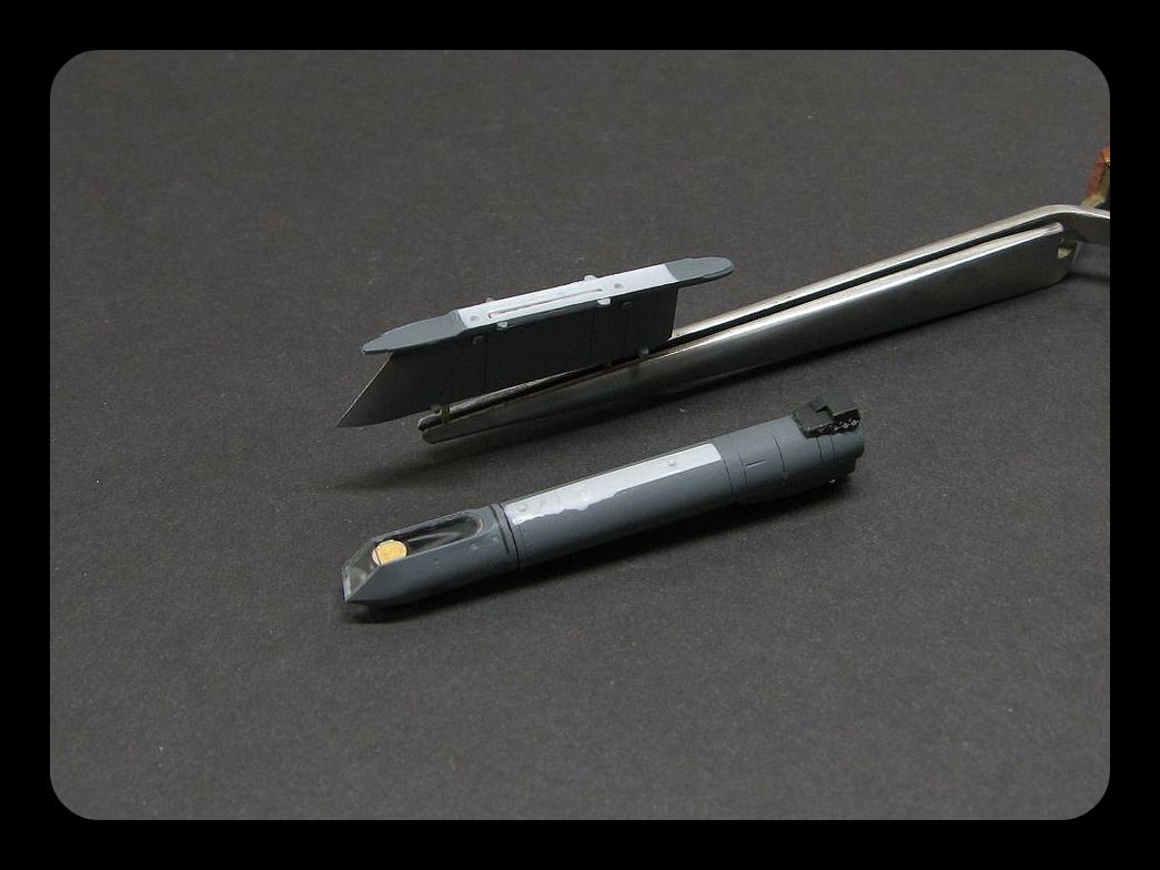

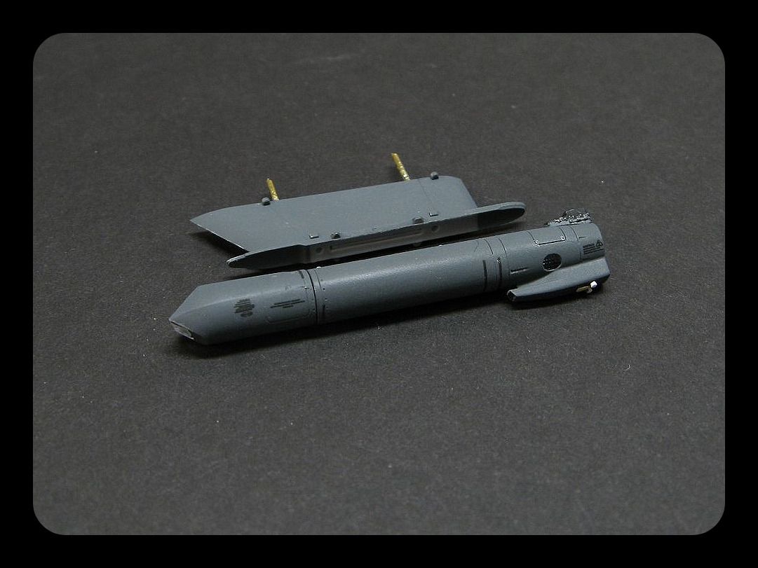

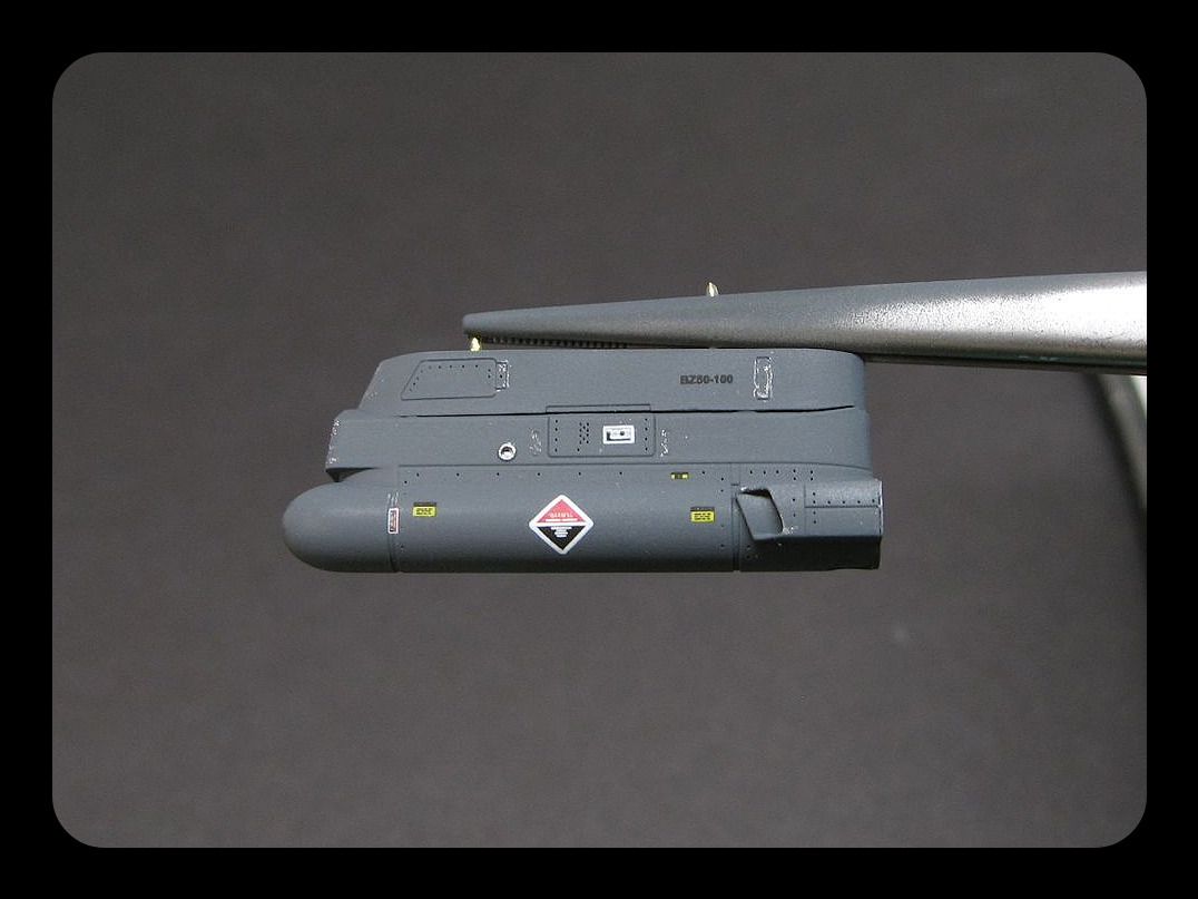

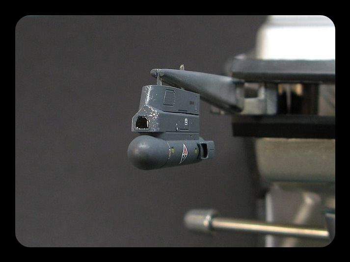

A-10 LOADER Posted December 16, 2025 Author Share Posted December 16, 2025 (edited) Wrapped up the Eduard AN/AAQ-13 LANTIRN pod and the Hasegawa SNIPER pod. I'll glue the Sniper pod to the pylon at the end of the build. I still have some work to do on the missiles and ACMI pod. Once they are finished I'll focus on getting the GBU-24's wrapped up. Thanks to those who still check in and are following along. Steve Edited December 17, 2025 by A-10 LOADER Quote Link to post Share on other sites

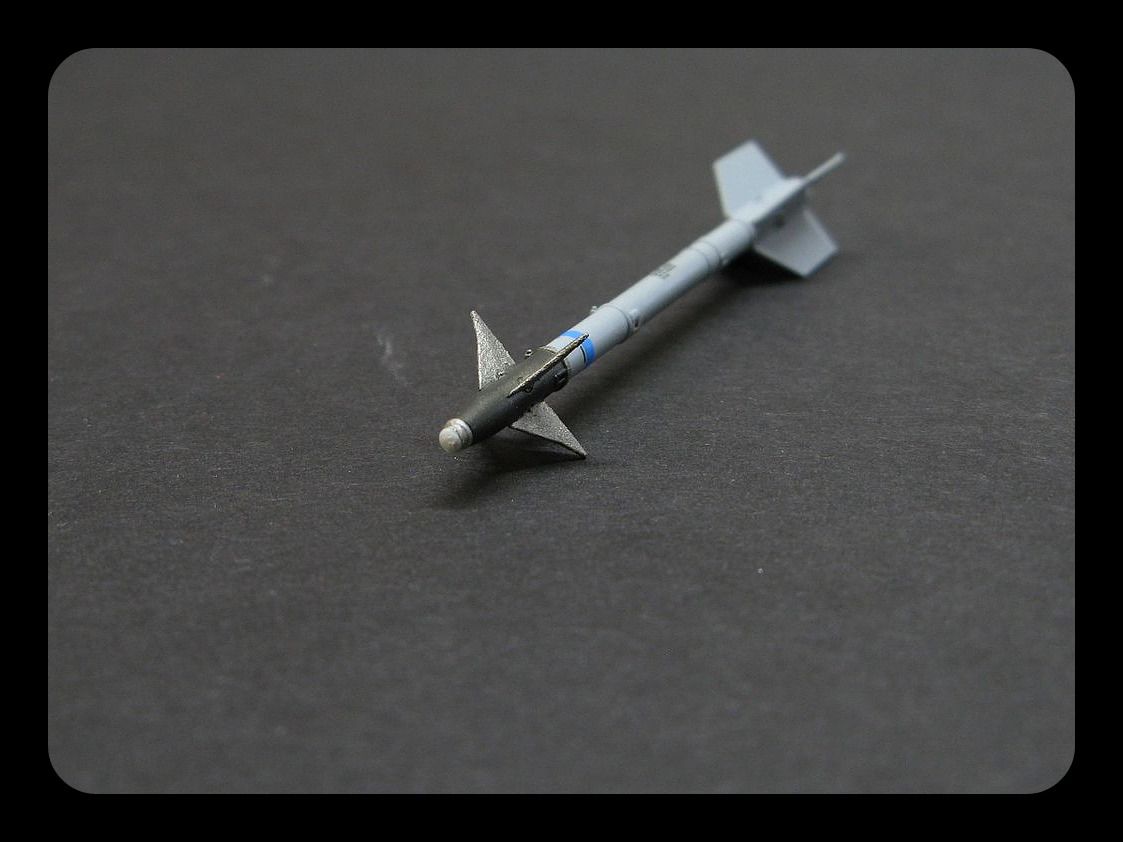

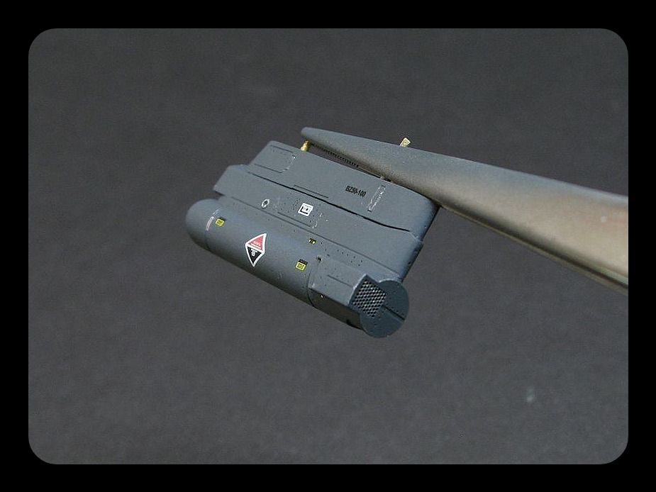

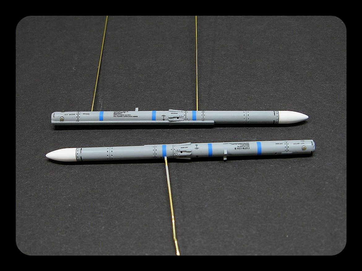

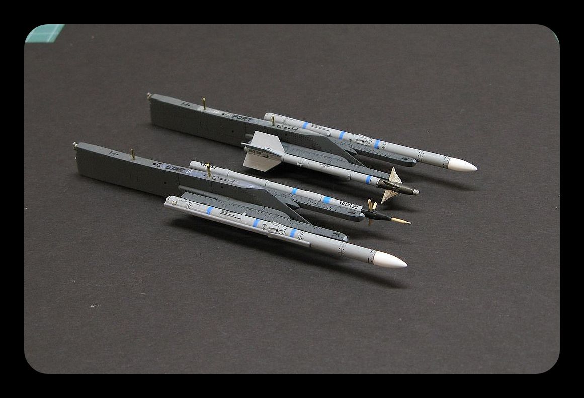

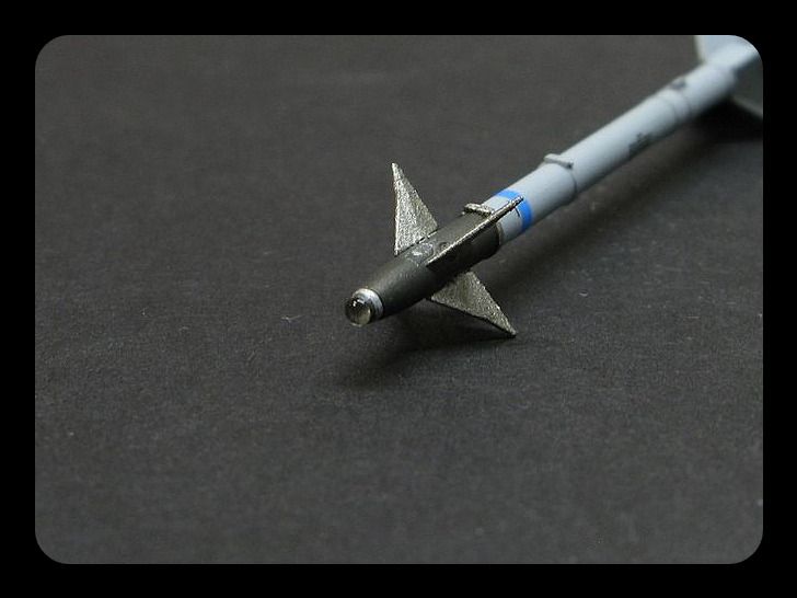

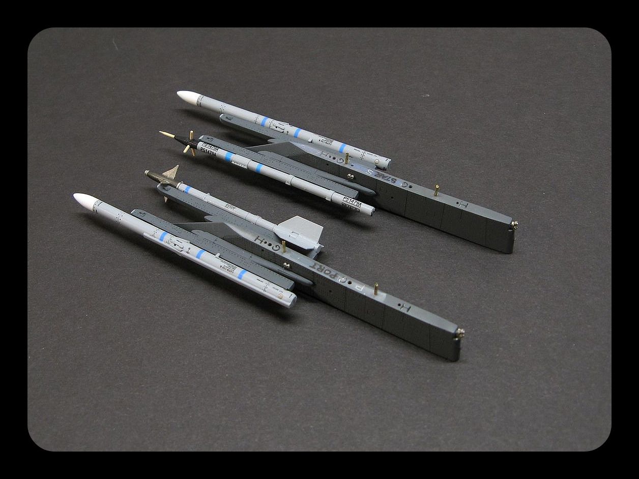

A-10 LOADER Posted December 18, 2025 Author Share Posted December 18, 2025 Finished up the Flight Line Resin missiles and the AFV Club ACMI pod today. For the CATM-9L/M drops of liquid CA were built up to replicate the seeker head. I then painted it with light gray to give it that "milky" look. Two Bob's missile markings and the AFV Club decals for the ACMI pod brought everything to life. Steve Nothing here is glued, it's all held together with brass pins. I still need to "weather" up the missiles and ACMI pod yet for everything to be finished. Quote Link to post Share on other sites
ST0RM Posted December 18, 2025 Share Posted December 18, 2025 Artistry at work! Beautiful, Steve. -Jeff Quote Link to post Share on other sites
A-10 LOADER Posted December 18, 2025 Author Share Posted December 18, 2025 1 hour ago, ST0RM said: Artistry at work! Beautiful, Steve. -Jeff Ahh, very kind of you pal. At least I know you're still here and following along, much appreciated. Steve Quote Link to post Share on other sites

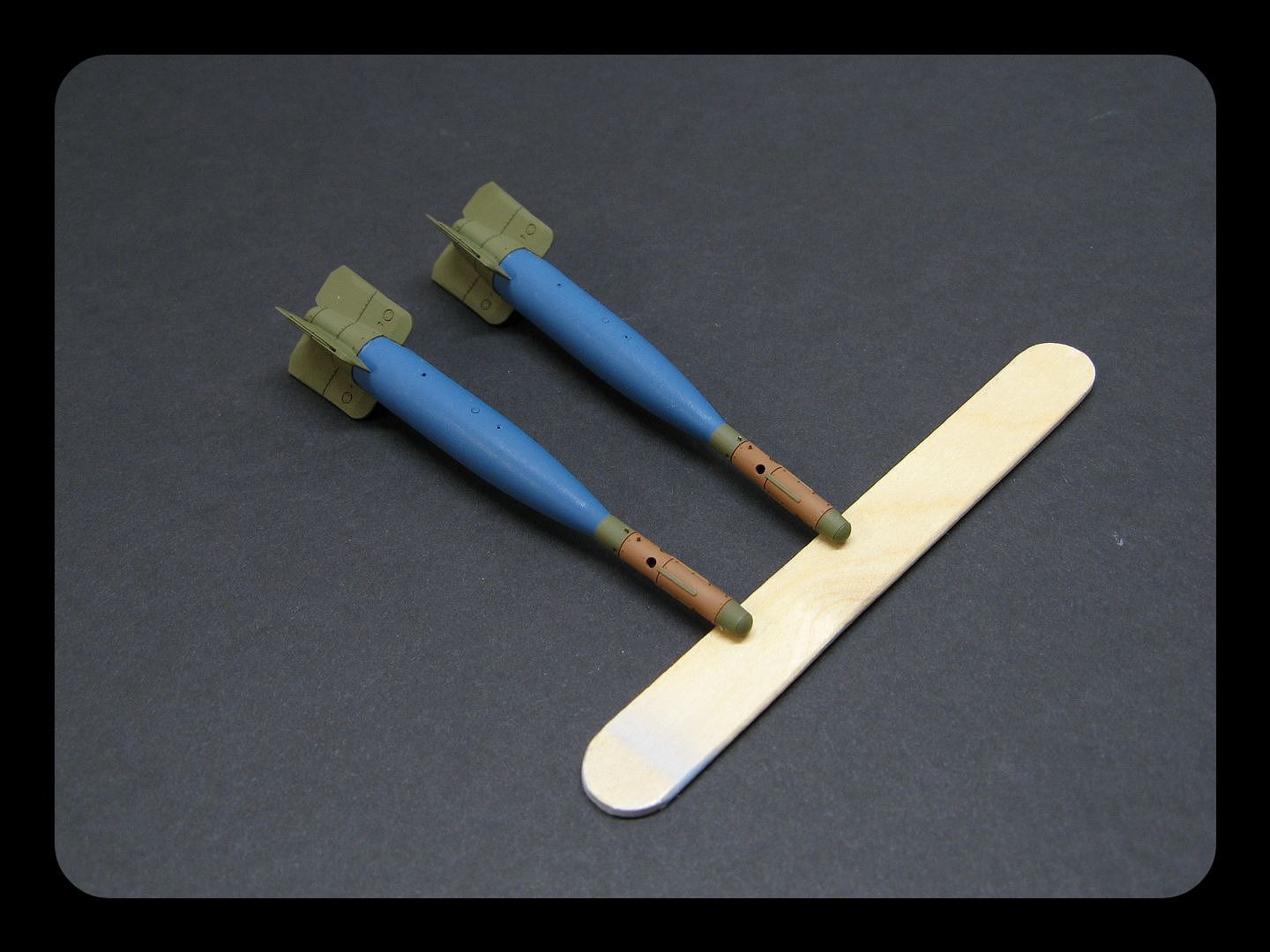

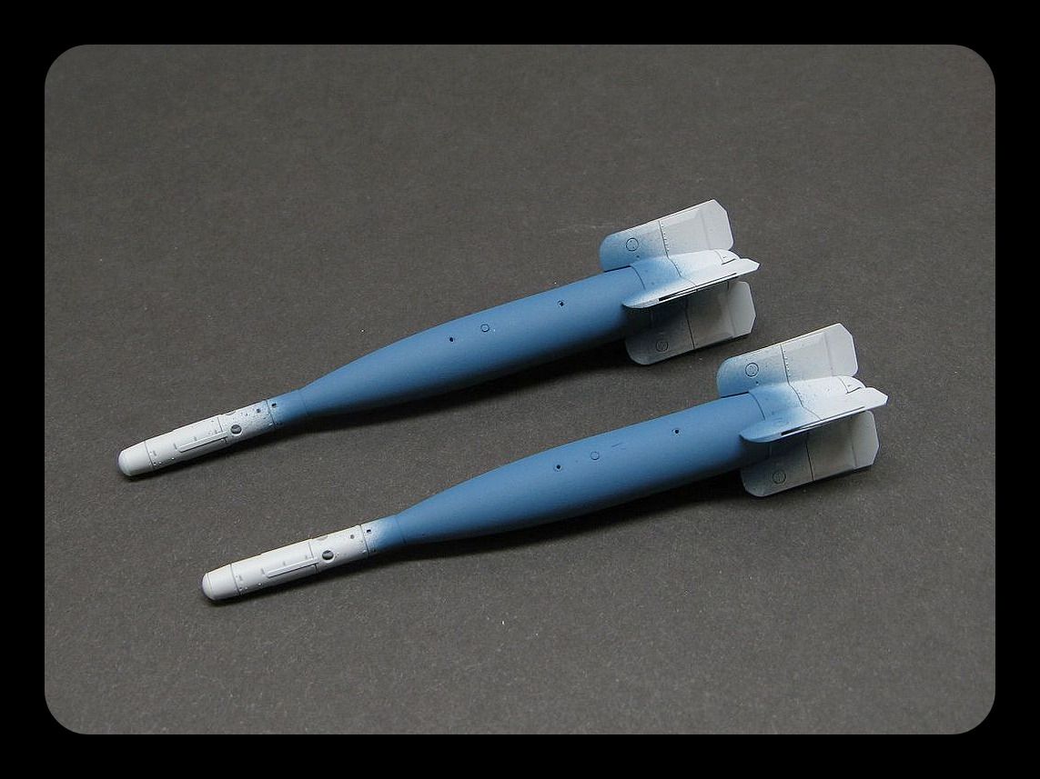

A-10 LOADER Posted December 18, 2025 Author Share Posted December 18, 2025 GBU-24's are all painted and awaiting a gloss coat for the few decals I need to do. Steve Quote Link to post Share on other sites
strikeeagle801 Posted December 18, 2025 Share Posted December 18, 2025 Those look great Steve. What blue did you use for the bodies? I've got Tamiya's 72nd F-14D on the way and I'm going with the Black Bunny decals and a training/test loadout for it. Aaron Quote Link to post Share on other sites
A-10 LOADER Posted December 18, 2025 Author Share Posted December 18, 2025 1 hour ago, strikeeagle801 said: Those look great Steve. What blue did you use for the bodies? I've got Tamiya's 72nd F-14D on the way and I'm going with the Black Bunny decals and a training/test loadout for it. Aaron Thanks Aaron, it's Model Master FS 35109. Thanks for checking in. Quote Link to post Share on other sites

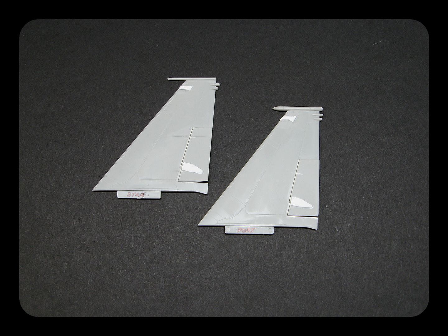

A-10 LOADER Posted December 22, 2025 Author Share Posted December 22, 2025 (edited) Damage from this morning leading me to build up two more GBU's 😡. I only need one with the other one for "just in case". Steve Added some strengthening plates to the tails with .010" plastic. The plates on the rudders were shaped and sanded, using .015" plastic, before gluing them on. Each rudder has two pins so I could turn them slightly to the port side for some visual interest. Edited 4 minutes ago by A-10 LOADER Quote Link to post Share on other sites
