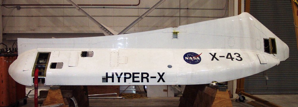

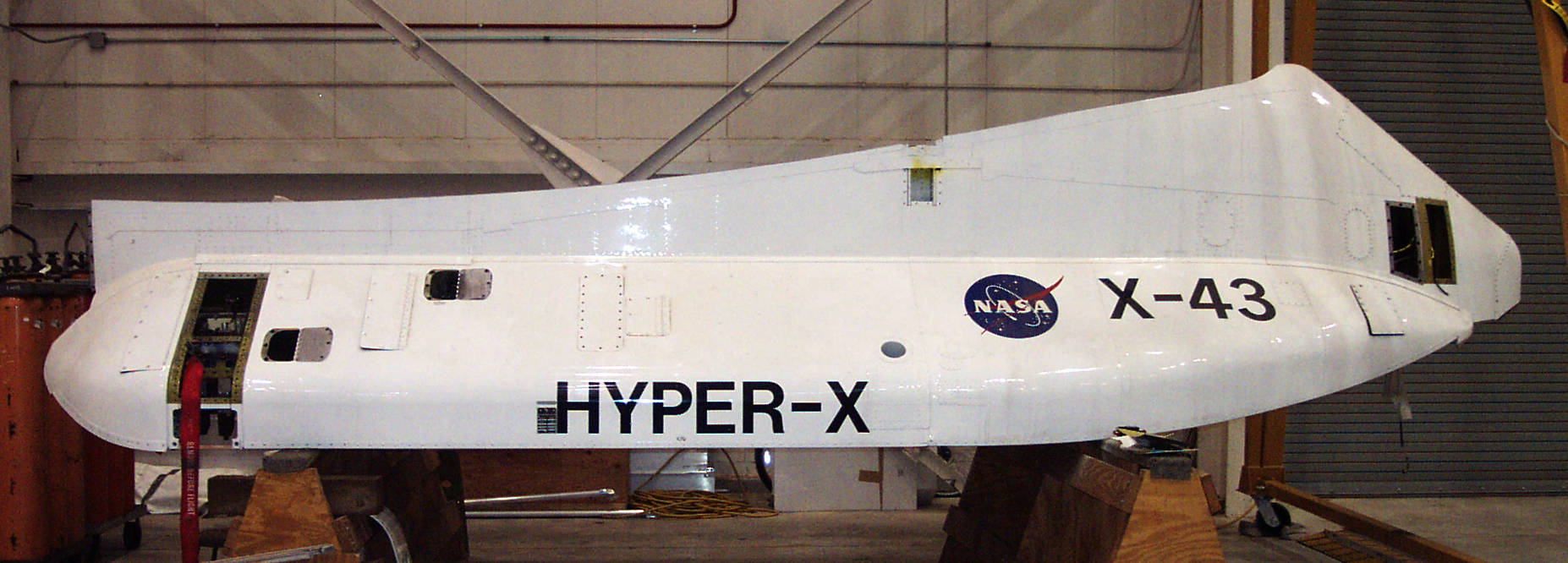

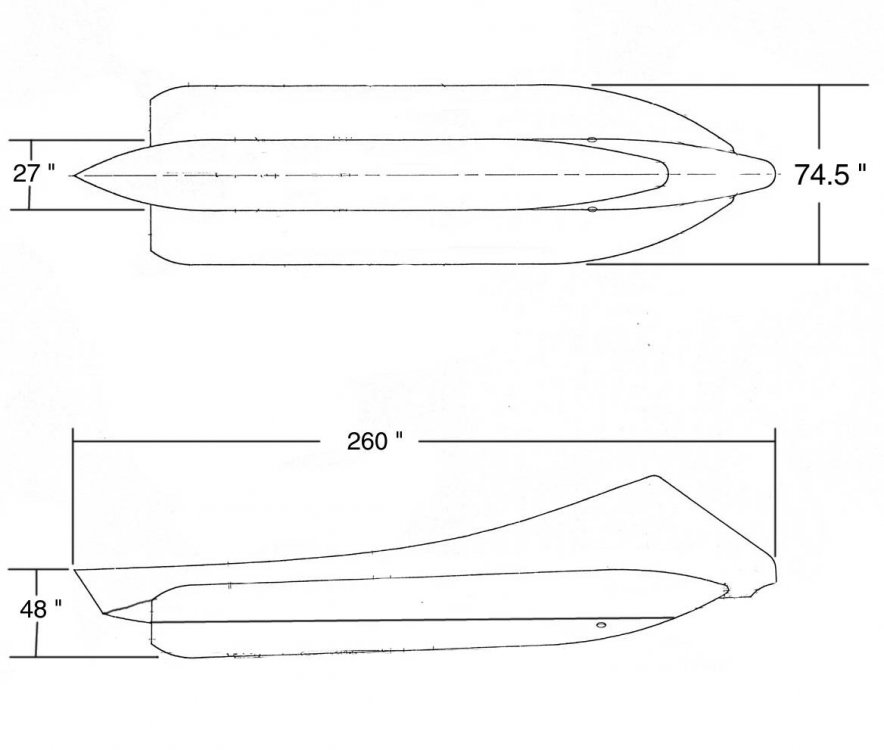

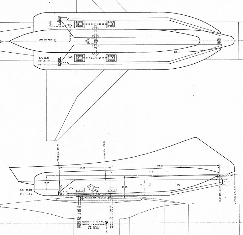

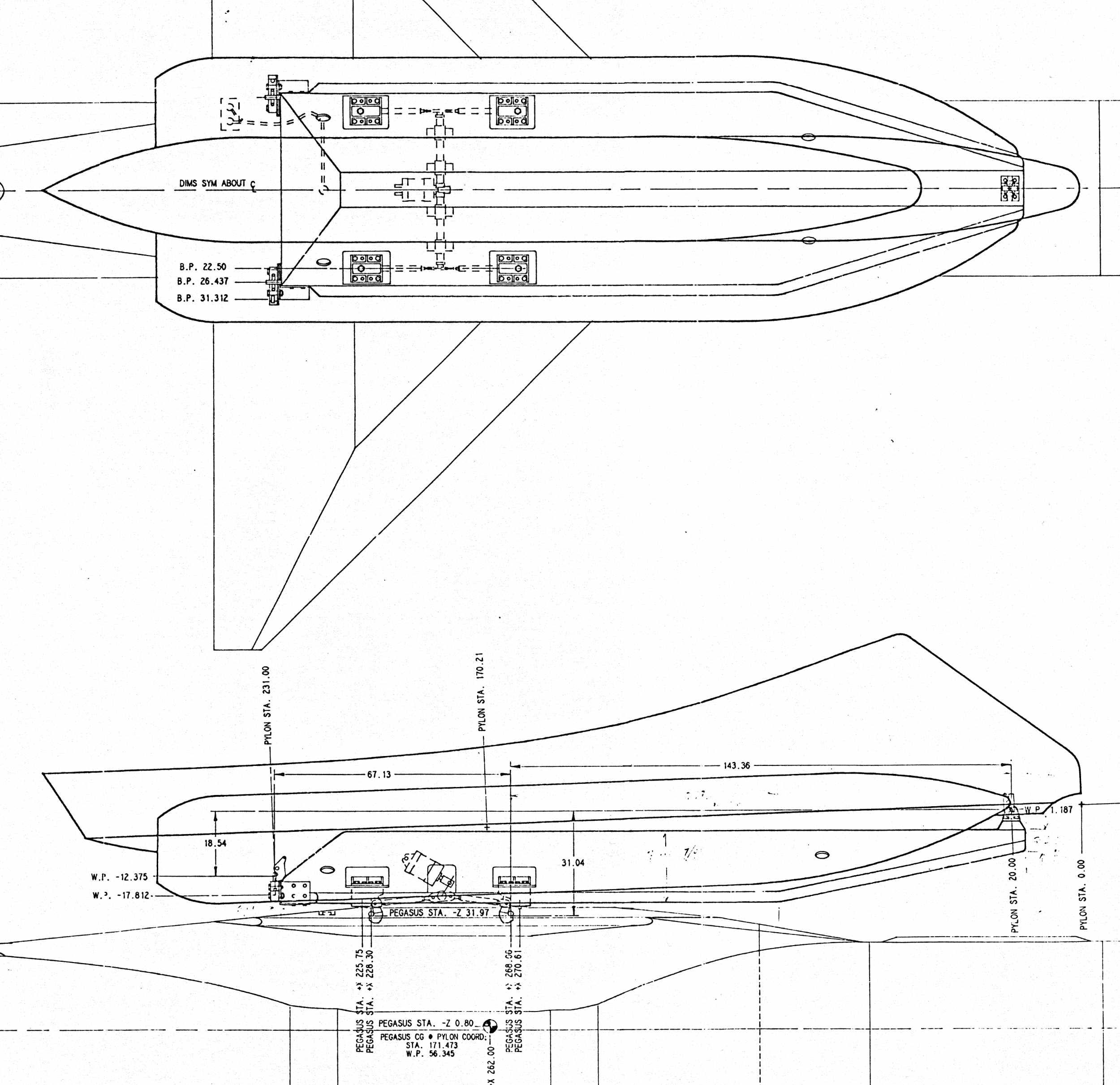

X-Plane Fan Posted October 13, 2025 Share Posted October 13, 2025 While not the Monogram pylon, here are some dimensions and pic for the actual NB-52 pylon. I have plenty of pics of the pylon if you need more. Hope this helps. Quote Link to post Share on other sites
aircal62 Posted October 14, 2025 Author Share Posted October 14, 2025 X Planes fan this is exactly what I was looking for but did not think it existed. Thank you Quote Link to post Share on other sites
