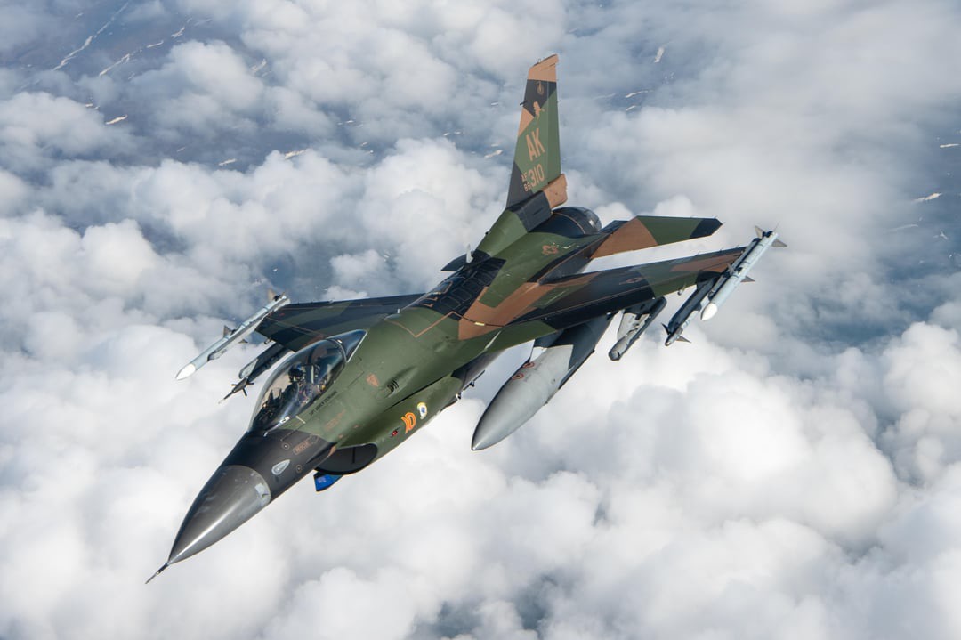

seawinder Posted October 14, 2025 Share Posted October 14, 2025 (edited) Can anybody help with the pod at Station 3? I'm also puzzled by what appear to be double loads at Stations 2 and 10? Thanks! Edited October 14, 2025 by seawinder Quote Link to post Share on other sites
strikeeagle801 Posted October 14, 2025 Share Posted October 14, 2025 CATM-120, CATM-9M, AN/ALQ-188, 370 gallon drop tank, 370 Gallon Drop Tank, ACMI pod, CATM-120. I see no double stores. Aaron Quote Link to post Share on other sites
LDM Posted October 14, 2025 Share Posted October 14, 2025 Angry Kitten AN/ALQ-167 Here's another pic of the 18th AGRS using them: Quote Link to post Share on other sites

Niels Posted October 15, 2025 Share Posted October 15, 2025 7 hours ago, LDM said: Here's another pic of the 18th AGRS using them: Actually 18FIS, they lost the Aggressor designation a couple of years back as they now have a dual role of both aggressor and ADIZ protection flying with live weapons to intercept Chineese and Russian airplanes approaching the US. Quote Link to post Share on other sites
strikeeagle801 Posted October 15, 2025 Share Posted October 15, 2025 11 hours ago, LDM said: Angry Kitten AN/ALQ-167 Here's another pic of the 18th AGRS using them: It's a -188, not a -167. Quote Link to post Share on other sites
GW8345 Posted October 15, 2025 Share Posted October 15, 2025 5 hours ago, strikeeagle801 said: It's a -188, not a -167. If I may; That is an ALQ-167 in the "N" configuration, the -188 has a different (longer) strongback and different nose/tail cones. V/R GW Quote Link to post Share on other sites
strikeeagle801 Posted October 15, 2025 Share Posted October 15, 2025 My apologies. I defer to those who know more than me. I was under the false impression that the Navy used the 167 and that the Air Force used the 188. Aaron Quote Link to post Share on other sites
LDM Posted October 15, 2025 Share Posted October 15, 2025 (edited) On 10/15/2025 at 12:28 AM, Niels said: Actually 18FIS, they lost the Aggressor designation a couple of years back as they now have a dual role of both aggressor and ADIZ protection flying with live weapons to intercept Chineese and Russian airplanes approaching the US. My pic was from 2023, the designation change came in February 2024 On 10/15/2025 at 1:05 PM, strikeeagle801 said: My apologies. I defer to those who know more than me. I was under the false impression that the Navy used the 167 and that the Air Force used the 188. Aaron Generally that was correct. Few years ago the USAF started using the new Angry Kitten variant of the ALQ-167: https://www.ga.com/usaf-flies-with-angry-kitten-jamming-pod. Phase Hangar Resin has them in both 1/48 and 1/32 scale. Edited October 18, 2025 by LDM Fix company Quote Link to post Share on other sites

LDM Posted October 15, 2025 Share Posted October 15, 2025 Sorry, I meant "my pic" as in the one in my post, I can't take credit for it. It was taken by an Airman in a KC-46: https://www.pacaf.af.mil/News/Photos/igphoto/2003286967/ But I might've also been mistaken thinking the OP's picture was more recent, a reverse Google search comes back as 2019, which was before Angry Kitten I believe. Quote Link to post Share on other sites
GW8345 Posted October 15, 2025 Share Posted October 15, 2025 4 hours ago, strikeeagle801 said: My apologies. I defer to those who know more than me. I was under the false impression that the Navy used the 167 and that the Air Force used the 188. Aaron No worries, they do look very similar, a quick way to tell is by the strong-back, the -167 has a short one while the -188 has it going from the nose cone to the tail cone. GW Quote Link to post Share on other sites
seawinder Posted October 16, 2025 Author Share Posted October 16, 2025 18 hours ago, Niels said: Appologies, thought the photo was more recent. Excellent picture btw 🙂👍 I agree -- great photo, thanks! I wonder what shade of gray it's painted. Quote Link to post Share on other sites
Niels Posted October 16, 2025 Share Posted October 16, 2025 4 minutes ago, seawinder said: ....I wonder what shade of gray it's painted. Standard FS36118 over FS36270 for the grey one. They have others in Have Glas V scheme which is FS36170. Quote Link to post Share on other sites
seawinder Posted October 16, 2025 Author Share Posted October 16, 2025 (edited) Thank you Niels! However, looking at the pod in the photo I posted, the top looks much lighter than 36118 -- appears pretty much the same as the fuel tank. According to the instructions in the Bullseye sheet I'll be using, the date is either 2018 or 2019. Is it possible the pod was painted Light Ghost Gray back then? Edited October 16, 2025 by seawinder Quote Link to post Share on other sites
Niels Posted October 17, 2025 Share Posted October 17, 2025 (edited) @seawinder I was refering to the jets, not the stores, but see your question was regarding the store. I agree the pod appear lighter than the jet. You'll have to look it up, but likely more along FS16473-ish or FS36375/36320ish? As for the jets, the current jets the squadron have was only transferred in during 2023. They still have some of the "older" ones in agressor scheme, but the newer ones which you can identify by the "birdslicers" in front of the cockpit are new to the unit. So also for this pic. The one in SEA scheme in the background is 86-0331, formally with the 182FS 149FW Texans ANG. The one in front is 86-0341, I have found another photo of her showing the same replacement canopy which is why I am certain this is 86-0341. Edited October 17, 2025 by Niels Quote Link to post Share on other sites
