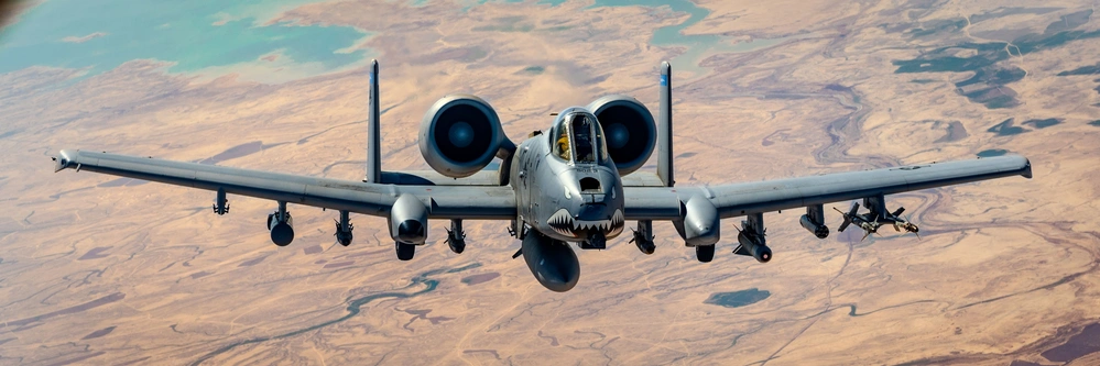

strikeeagle801 Posted November 7, 2025 Share Posted November 7, 2025 I just bought the TwoBobs Inherant Resolve sheet, and looking at his FB account, he has a few A/R shots. They're taken during low-light, and it is hard to make out a lot of details, but the shape of the centerline drop tank is unmistakable, and it is obviously carrying live ordnance. I was under the impression that A-10's only used external tanks for ferry flights. When did this change, and why? Aaron Quote Link to post Share on other sites
LDM Posted November 8, 2025 Share Posted November 8, 2025 (edited) https://www.eglin.af.mil/News/Article-Display/Article/814477/40th-fts-expands-a-10-fuel-limitations-in-combat/ Seems they've been testing it since at least 2013, though I've only seen pics from the last year or so of it being used for real. Here's one of a Flying Tigers A-10 in the CENTCOM area back in February of this year, which was prior to the jets covered on the TwoBobs sheet. Edited November 8, 2025 by LDM Quote Link to post Share on other sites

Waltz41 Posted November 9, 2025 Share Posted November 9, 2025 It's a different tank though from the one that comes with all the kits as far as I know. It's a bit shorter so they can still open the gun bay door. I don't know of anyone who is making this aftermarket yet. Conversion Fuel tank Quote Link to post Share on other sites

LDM Posted November 10, 2025 Share Posted November 10, 2025 Here's a pic from 2016 with a ferry tank underneath: Here's a pic from 2023 with the other style tank. Note the differences in the tail fin shape and the distance from the tip of the tank to the nose gear door: These are the Reskit tanks, which based on the fins appear to be the earlier tanks: These are Phase Hangar 48185 tanks, which although out of stock right now, appear to be the later style tank based on fin configuration: Quote Link to post Share on other sites

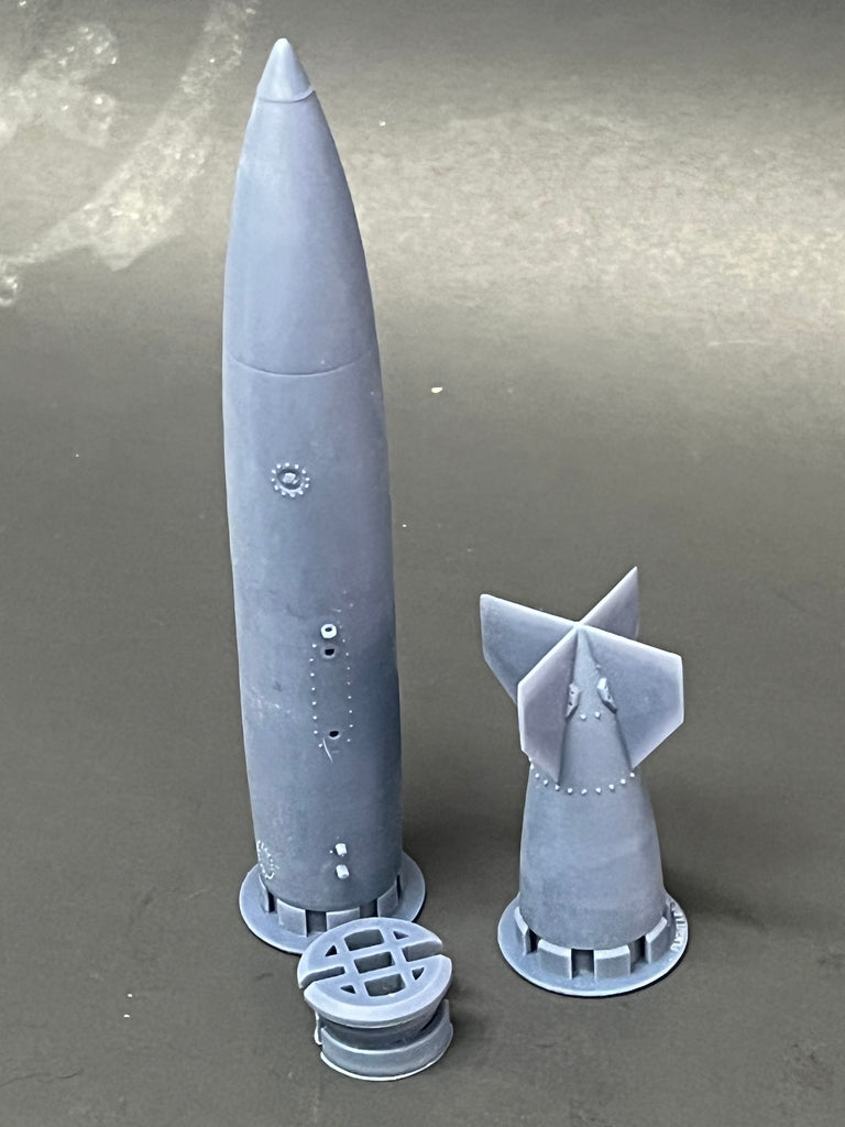

757flyer Posted November 19, 2025 Share Posted November 19, 2025 So would modeling the "newer" style tank be as simple as modifying the rear end of an F-15 tank? Remove the rear upper stub assembly on the F-15 tank and then add four fins? Quote Link to post Share on other sites
thegoodsgt Posted December 9, 2025 Share Posted December 9, 2025 I'm curious, too. Quote Link to post Share on other sites
Hoops Posted December 22, 2025 Share Posted December 22, 2025 Yeah, that's basically all there is to it. That's what I did when I modelled mine in CAD for A-10s in 1/72 scale. The model is available Here Cheers, Hoops Quote Link to post Share on other sites
