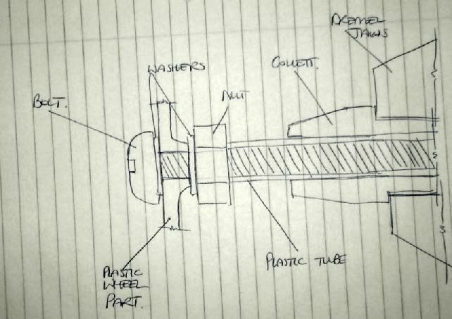

RedStar Posted February 13, 2006 Author Share Posted February 13, 2006 O.K. so I made some good progress today, I got the eight wheel hub devices roughed together. There's some contouring and similar left to do, but that will be easy compared to the 10-16 pieces that went into each small item... I took a couple of pictures, but couldn't get up close enough to get any real detail... I'll post the general views later... I did just post a question about attaching items to a motor tool for milling purposes - it's in the tools & techniques forum - if anyone has any input it's most definitely welcome. I need to figure out how to symmetrically re-contour the inner hub - sort of like what geedubeleyer did in his build. But I can't figure out how to get the hub firmly attached and centered on the dremel attachment. Pictures shortly... Thanks! Paul Quote Link to post Share on other sites
geedubelyer Posted February 13, 2006 Share Posted February 13, 2006 (edited) Hi Paul , Things sound to be going well, I'm looking forward to seeing a couple of pics later. I've also given some thought to your power tool problems. Forgive me for mussing up your thread with a tatty sketch but could you do something like this? : When I used the drill, I mounted the wheel onto a nut & bolt between a pair of washers. This kept the wheel tight as it spun, allowing me to hollow it out. If the bolt is a little thin, perhaps you could use a length of plastic tube to fit the collett better. As an alternative, use a thicker bolt, hollow out the wheel centre to fit and then use a collar on the wheel axle to allow it to fit properly. (The fitting of the wheel centre is likely to be hidden by the backplate.) HTH p.s.. I can edit the post and remove the sketch once you've got the idea, if you like. Edited February 13, 2006 by geedubelyer Quote Link to post Share on other sites
RedStar Posted February 13, 2006 Author Share Posted February 13, 2006 Naw - keep it there, that's exactly what I need to see - although I'm wondering if my dremel has a big enough opening - I may have to switch over to my drill, just will take some playing around - and perhaps a trip to the Home Depot on the way home - with the drawing in tow! That's the kind of stuff that I like to see - once you see my own crazy drawings, you'll understand that you and I think very much alike... For whatever reason, I was struggling to get my head wrapped around how to get that part spinning... Cheers and Thanks! Paul P.S. - I gotta get the next cull going, as I need that lathe/mill! Quote Link to post Share on other sites

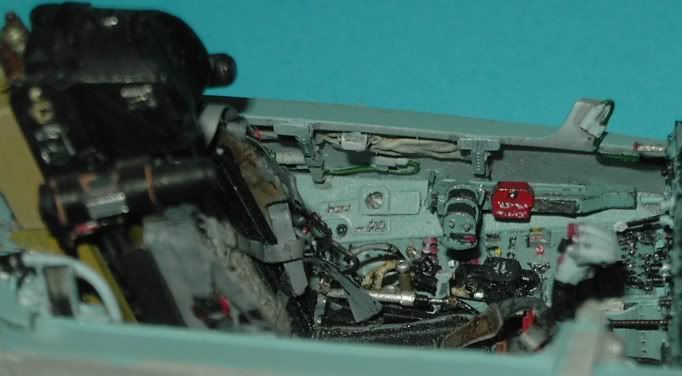

RedStar Posted February 15, 2006 Author Share Posted February 15, 2006 The throttles in the Aires set are a separate part. According to the instruction diagram, they would have you place the throttle slide on the outer angled panel of the port console. That would be incorrect, the throttle slide assembly should be on the port sidewall, above the port console. Nothing horrible, just a mistake in the instructions. Any decent reference shows this very clearly, so if you're paying attention to your references, you'd have probably caught the mistake without anyone telling you. Cheers! Paul Quote Link to post Share on other sites
geedubelyer Posted February 16, 2006 Share Posted February 16, 2006 (edited) Hi Paul, I hope you don't mind me butting in. If you have n't already tried it, you might find that it's worth trying the throttles in the suggested place before you mount them on the sidewall. I think you may be pleasantly surprised. I looked at a number of reference pics but once the throttles are mounted they seem to appear correct. Here's a reminder to show what I mean: . The way that the parts are designed makes them appear fixed to the sidewall once everything is assembled. HTH Edited February 16, 2006 by geedubelyer Quote Link to post Share on other sites
AnthonyWan Posted February 16, 2006 Share Posted February 16, 2006 Holy ****. Is that the Aires cockpit? For a sec, it looked like the picture i have in my book here of the real thing Anthony Quote Link to post Share on other sites
Wasserfall Posted February 16, 2006 Share Posted February 16, 2006 Holy ****. Is that the Aires cockpit? For a sec, it looked like the picture i have in my book here of the real thing :blink: Anthony Don't let him fool you, it is the real SU27 cockpit :D Man i love that pit :D Quote Link to post Share on other sites
