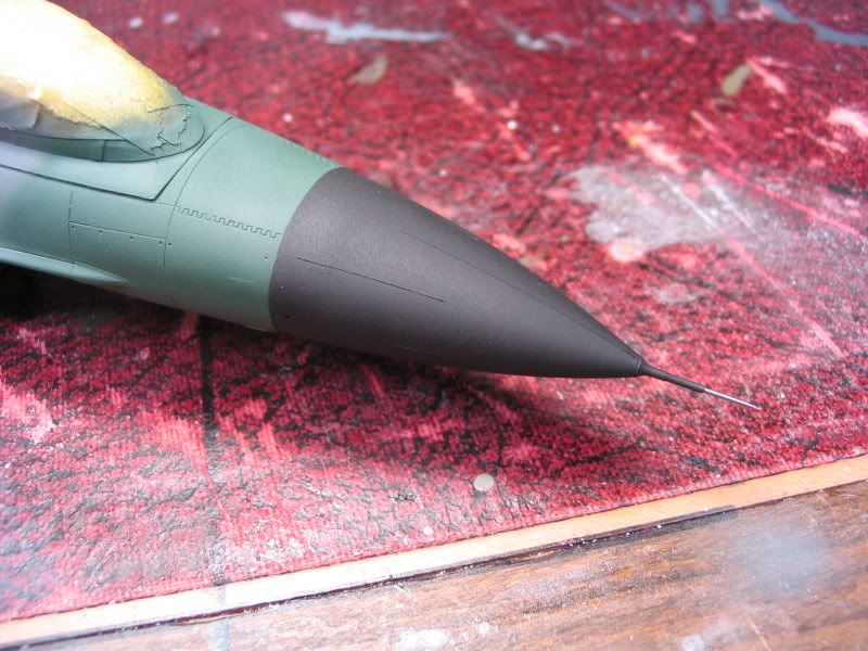

David Walker Posted November 14, 2007 Share Posted November 14, 2007 (edited) That cast one looks great! Here's the Has. with a Fine Molds pitot: Edited November 14, 2007 by David Walker Quote Link to post Share on other sites

doctorpepper Posted November 14, 2007 Share Posted November 14, 2007 the tamiya one looks more correct to me - it's easier to stick a needle on, and call it a pitot tube. the hasegawa one.. would need some blending Quote Link to post Share on other sites
ThePhantomTwo Posted December 8, 2007 Share Posted December 8, 2007 (edited) Am I correct that I'm seeing engraved panel lines around the AOA probes on the Tamiya kit radome?If so,they shouldn't be there,what you see is only the outline of the AOA covers that manages to keep that area cleaner than the rest of the radome. Edited December 8, 2007 by ThePhantomTwo Quote Link to post Share on other sites
jmel Posted December 8, 2007 Share Posted December 8, 2007 Am I correct that I'm seeing engraved panel lines around the AOA probes on the Tamiya kit radome? Yep, they botched it in the 32nd kits, too. Jake Quote Link to post Share on other sites
drhornii Posted December 8, 2007 Author Share Posted December 8, 2007 Am I correct that I'm seeing engraved panel lines around the AOA probes on the Tamiya kit radome?If so,they shouldn't be there,what you see is only the outline of the AOA covers that manages to keep that area cleaner than the rest of the radome. Good eye! Looks like the Hasegawa can be modified by drilling for the AOA probe to go into & mounting holes then painting the area where the cover was. Quote Link to post Share on other sites
