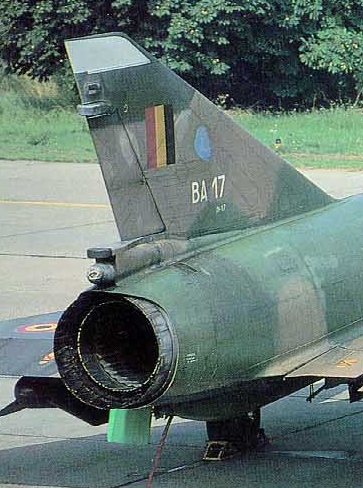

Mirage Elkan, actually the ex. Belgium 5BA fitted with canards.
Peru Mirage M5P.
For the Elkan I used the nose from the box, with a 2mm plug to correct the shorter length:
The tricky part will be to get the unique tail fairing right.
