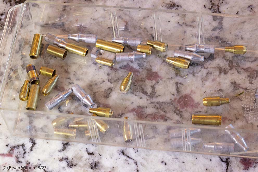

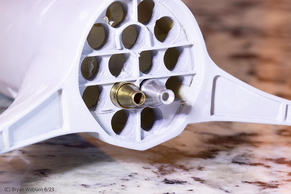

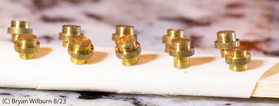

BWDenver Posted August 11, 2023 Author Share Posted August 11, 2023 I decided the bottles needed to be made up of several parts, a casing, the nozzle section and the safety cap. ¼” brass rod stock was turned on my lathe to the correct diameter, dictated by the JATO holder in the kit, then it was hollowed out to accept the burn chamber. The burn chamber had a straight section, a tapered section and finally the exit nozzle. Safety caps were made to top it off. The safety caps are misunderstood by some modelers who have built the kit. They are bright red and are labeled “REMOVE”, and stand out on the Md Grey JATO bottle. I’ve seen a few of these kits displayed with the red cap hollowed out, completely wrong. Then I put the kit on the shelf for “a while” and worked on other things. Quote Link to post Share on other sites

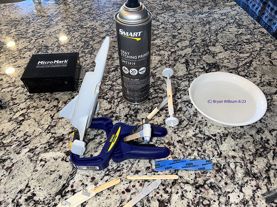

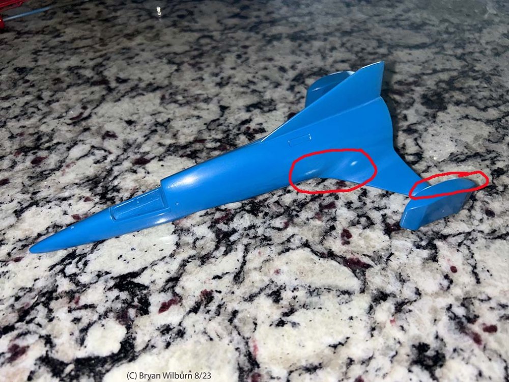

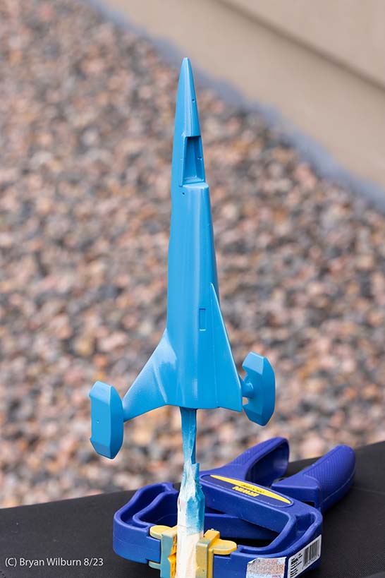

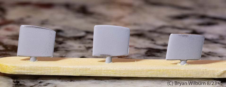

BWDenver Posted August 11, 2023 Author Share Posted August 11, 2023 Early this month (August 2023) I stumbled across the kit in my collection as I was “thinning it”. Not that far from completion I sanded the kit with 800 grit wet/dry paper and epoxied the white metal fin onto the body. The next step was to spray the parts with etching primer. Using popsicle sticks to hold the smaller parts. I drilled a hole in the back of the body to insert a small screw driver to hold the body when spraying it. Then I went about finding a “blue” that was close. Dupli-Color blue engine enamel looked close enough. The spray paint was transferred to a bottle, and sprayed with my Grex airbrush. This stuff dries within a few hours and can be sanded. But the transfer is a bit messy… Some voids were found at the base of the fin and filled with putty, and let dry for 24 hrs. I lightly sanded the surface with 800 grit sanding sticks. And immediately sanded through the blue paint in several spots to the primer. More blue paint and this time I sanded with 2000 grit sanding sticks. And burned through in a couple of places on the rear wheel housings and wing attach area. This process was repeated several more times, spot painting and sanding. I finally got to a consistent surface, and applied Maguire’s Miricle Glaze 100 to the car to polish the paint. We used this stuff to polish out the scratches the canopy on the Army helicopters I flew for 32 years. Great stuff, but you guessed it, I burned through in two places. With that I sprayed what I hoped would be a final coat and its off fishing for several days. Quote Link to post Share on other sites
