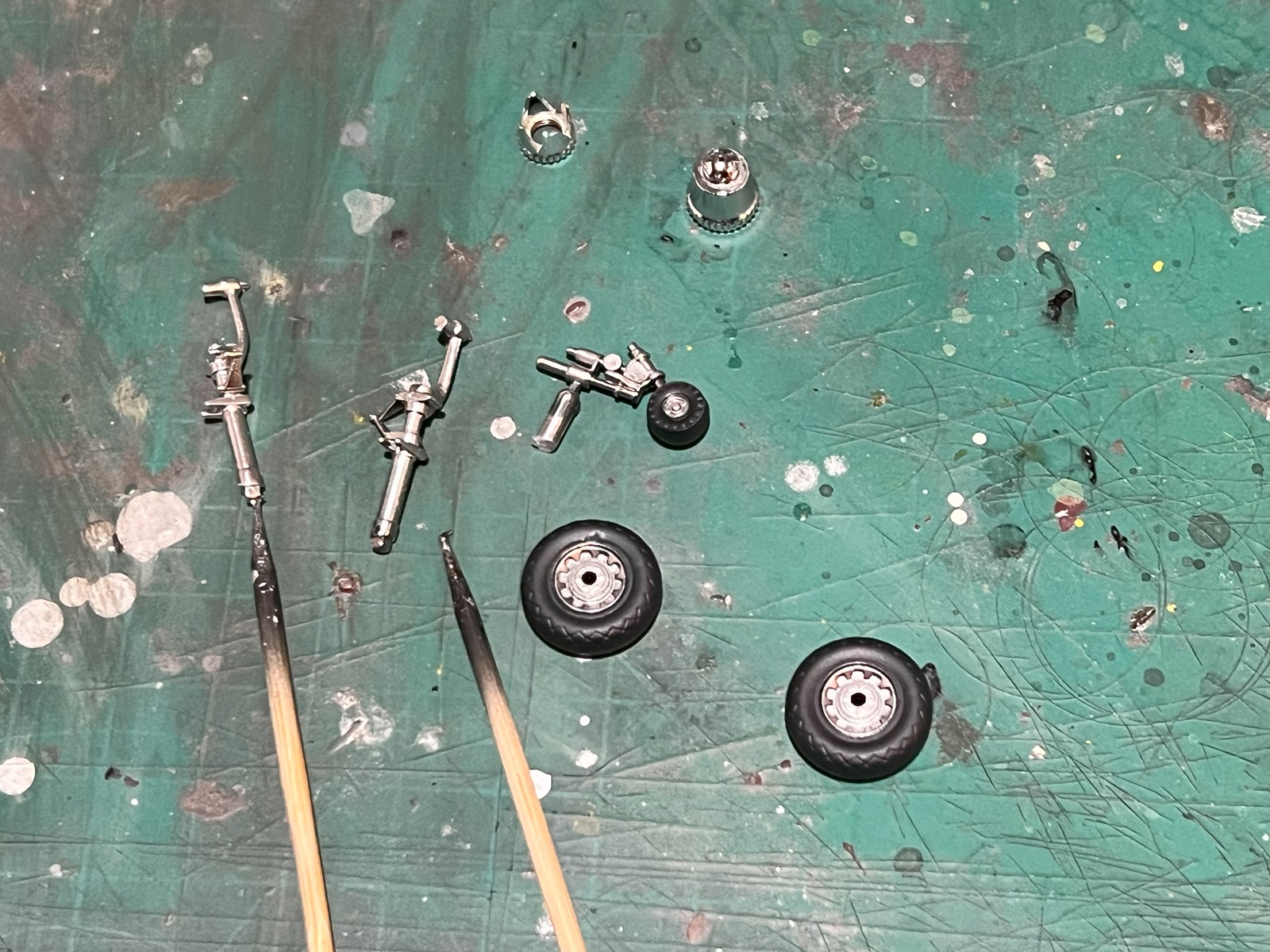

Igave it a wash and check the parts. It's missing 3 of the gear doors and the tail wheel. As I want to use and much original parts as possible, my worry is that if I can clean the clear part, but I will try my best.

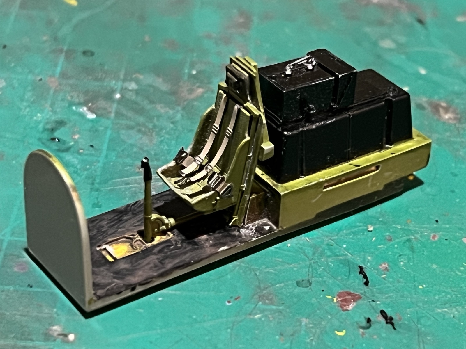

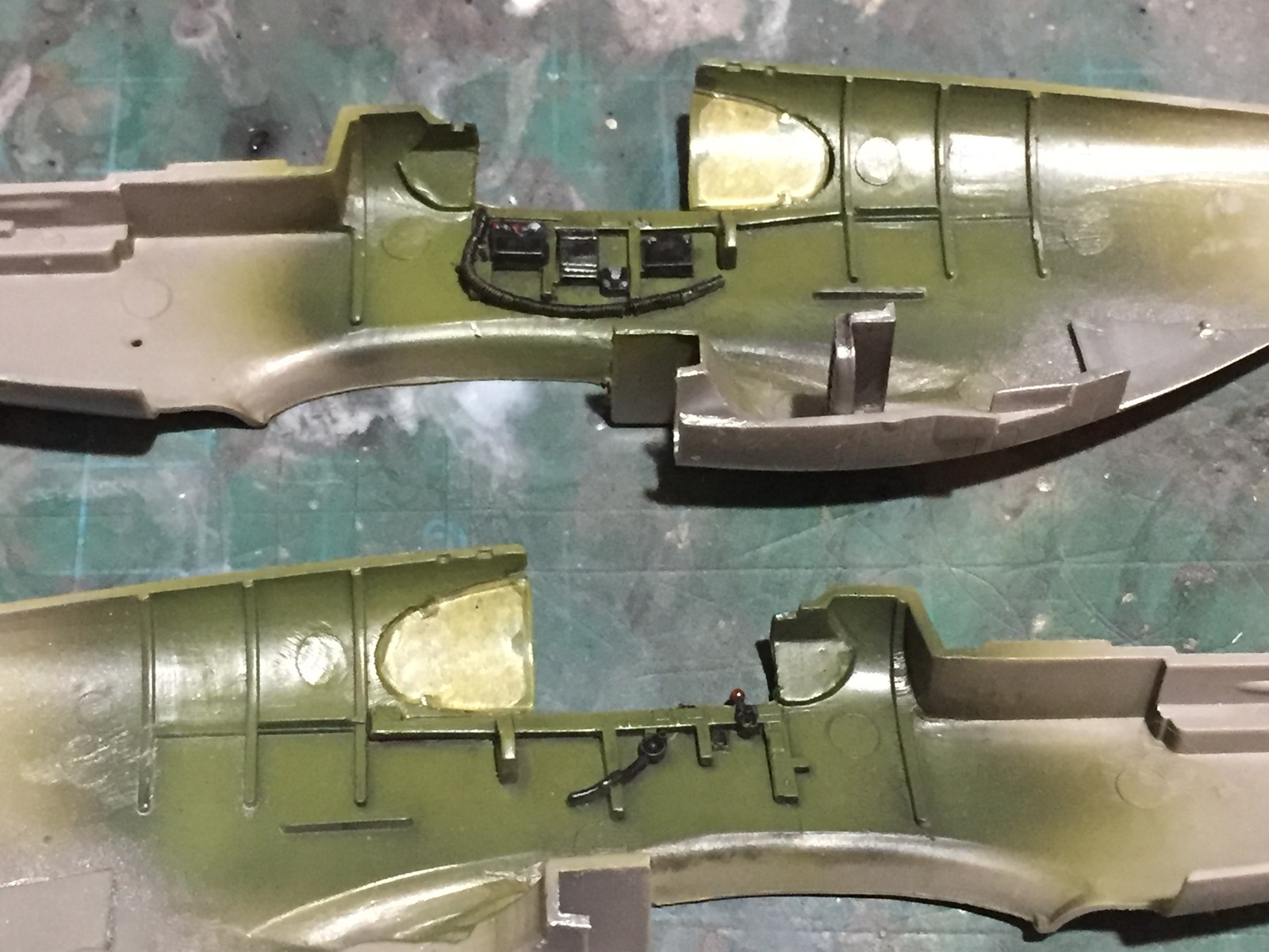

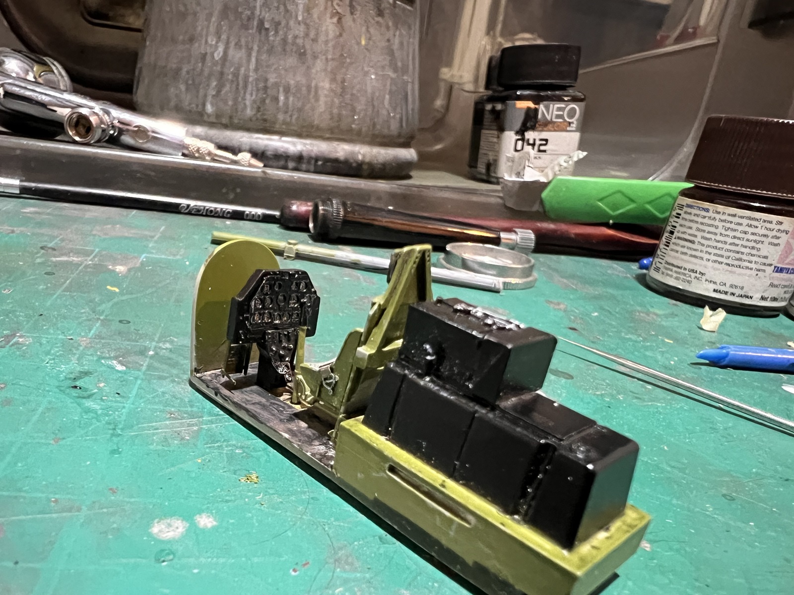

I used Aires cockpit, it took quite some time to dry fit the parts.
The interior was painted with AK's RC028 interior green.
It's slightly lighter that the Gunze C351, as shown in the following pic, another Mustang I am building.
I also have AK's US interior set, there is a "yellow-green", as following on Arma's Mustang, but it looks wield, I later e-painted it with RC028.
The Aires interior parts are painted and lightly weathered.

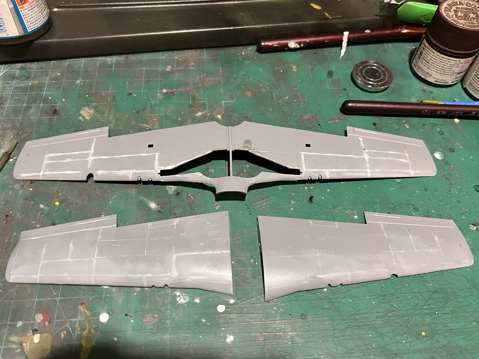

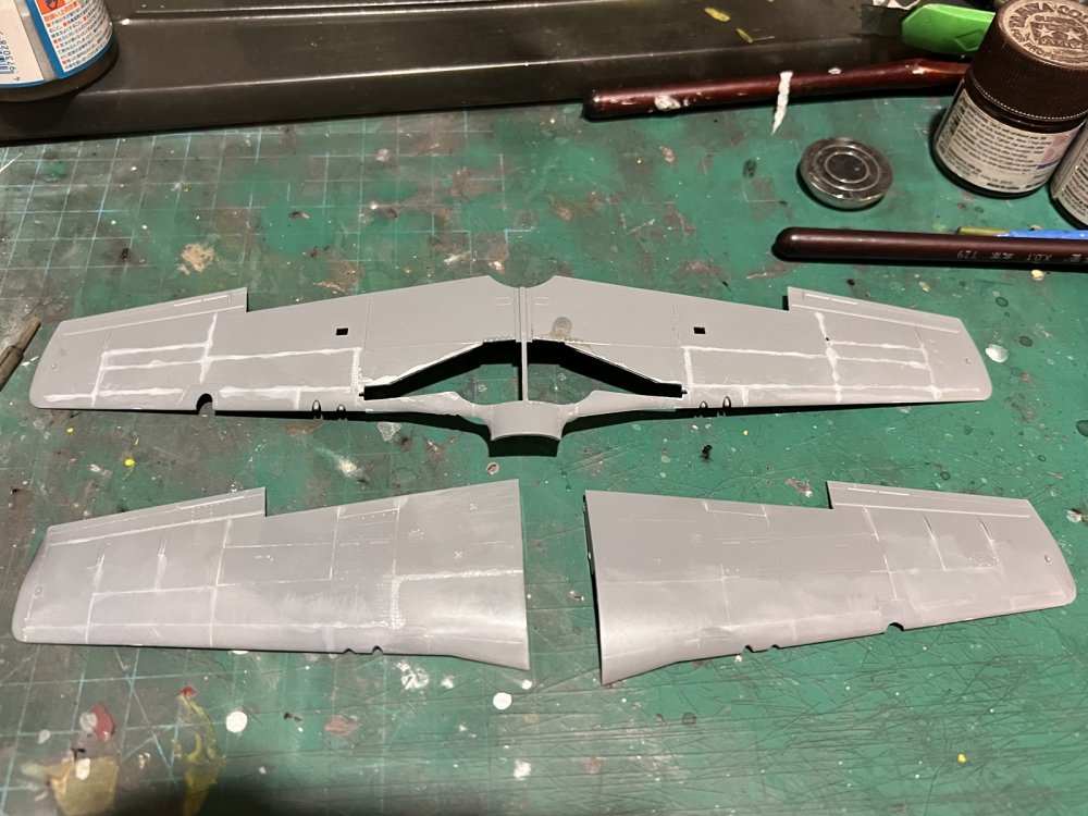

Next is filling the panels on the wings, one is down, two to go,..

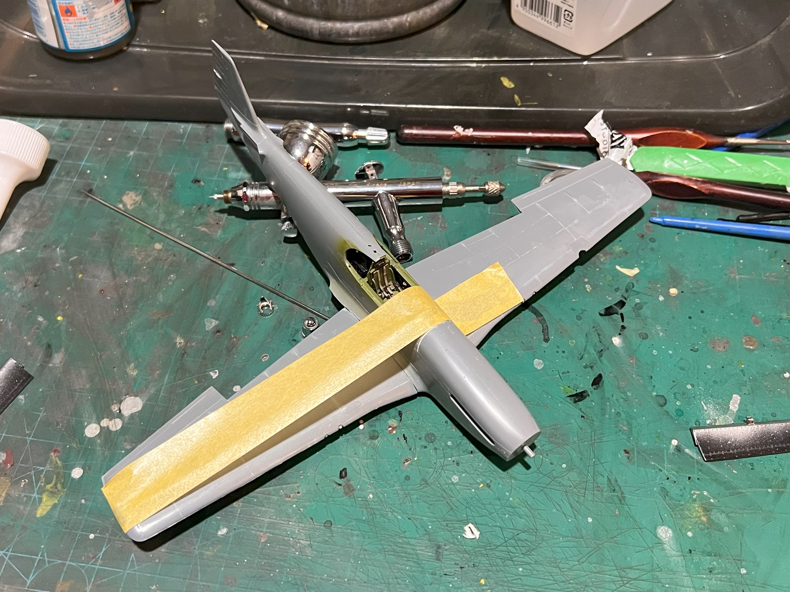

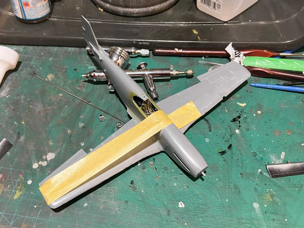

The aires wheel well was a problem. When the wing was glued to the fuselage, the upper part of the wing didn't match the fuselage. I had to open the glued right wing, thinned the wheel well roof and the upper right wing part quite a lot, then glue them back together. It took me days to do the job. Some fixing and sanding is still needed.

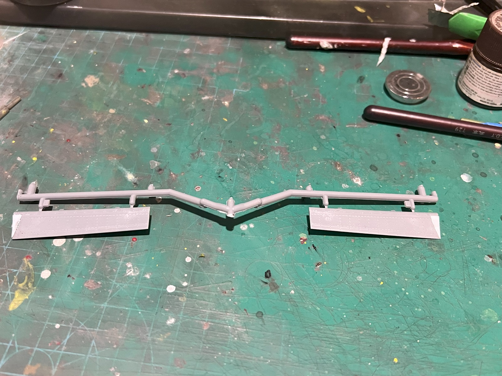

The recess area on the flapis wrong, so it was filled with plastic card and sand smooth.

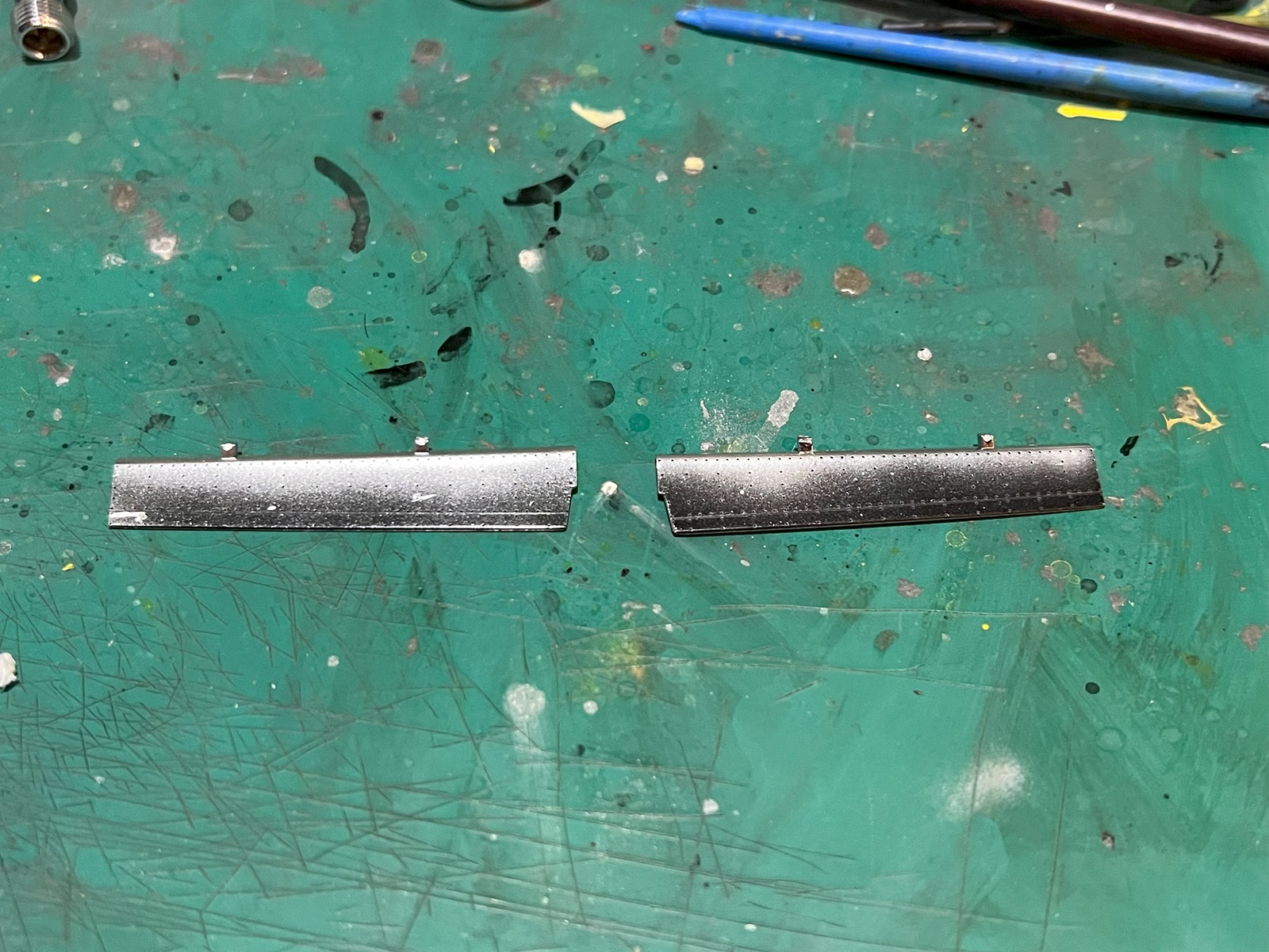

After checking with blace paint , the bare metal area was paimted aluminum.
As well as other small parts...

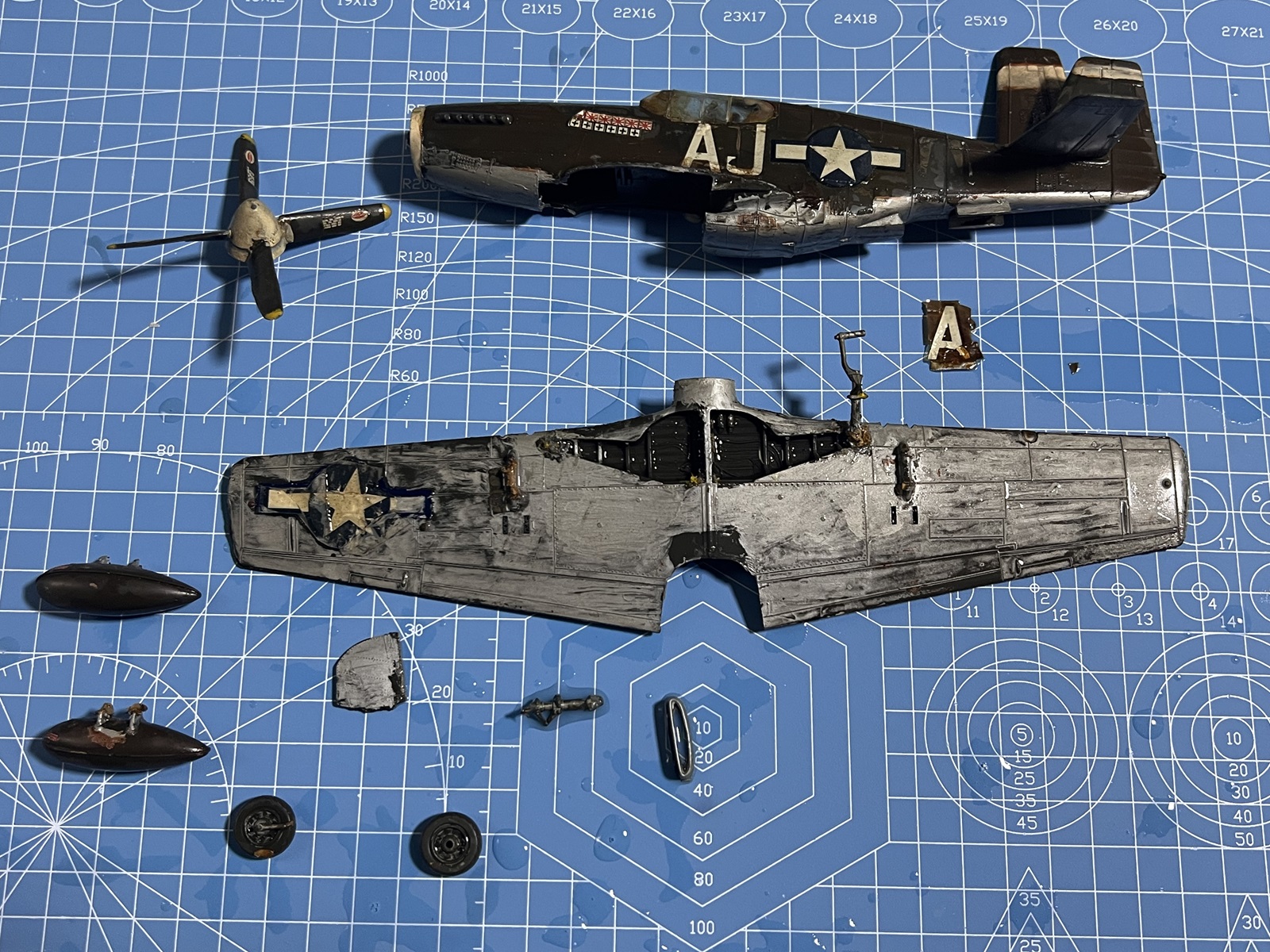

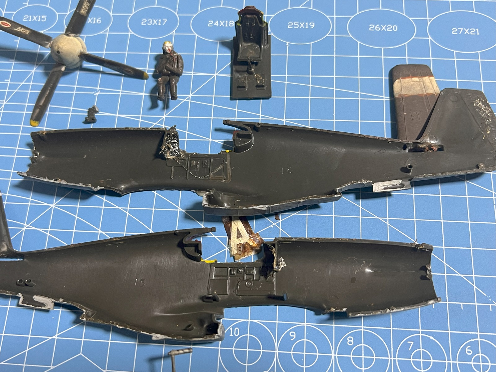

In the mean while, I opened the fusepage of the old kit. I forget what glue I used but luckily they didn't glue the parts to well, not model glue I think.
The cockpit detail is actually better thean I expected, so I decide to keep them. Adding a instrucment panel is mostly enough.

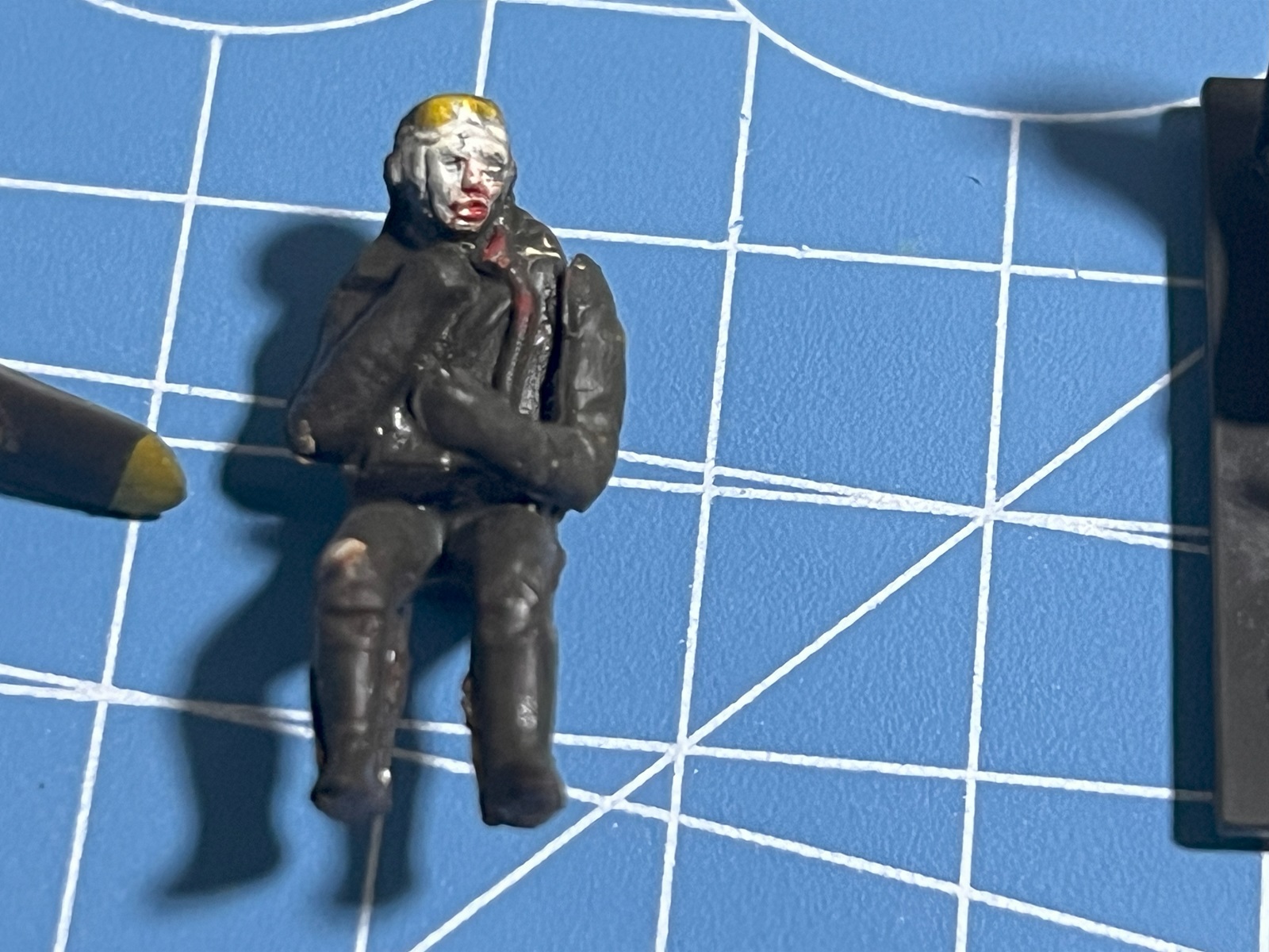

I don't know what Maj.Howard had eaten that day, aka why I painted him like that...

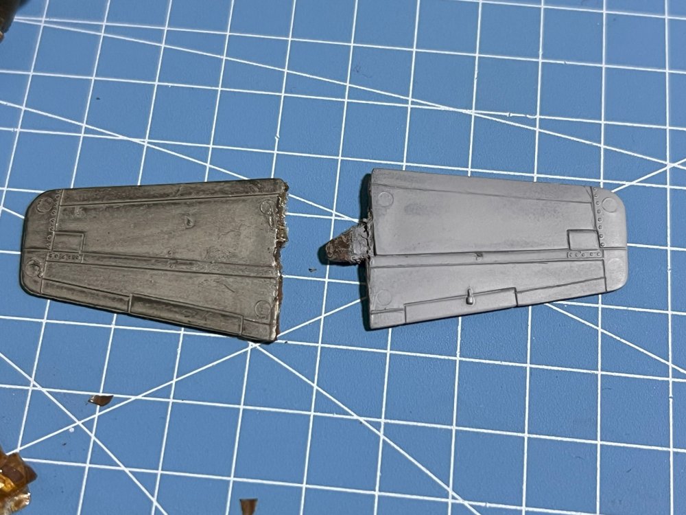

Today I tested rescribing the panel lines. I used the raised ones as templated, it worked OK as the plastic was soft. The piece on the right is the rescribed one,
