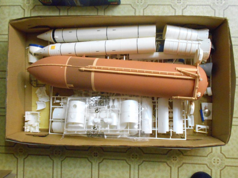

K2Pete Posted March 24, 2022 Share Posted March 24, 2022 I have an unused and started 1/72 External Tank and 2 SRB's if anyone wishes to give this a go. Not for FREE though ... I've had it since I did my Shuttle Cutaway over 10 years ago ... It sure would be fun to see this Artemis come together, both in reality and in scale! Pete Quote Link to post Share on other sites
