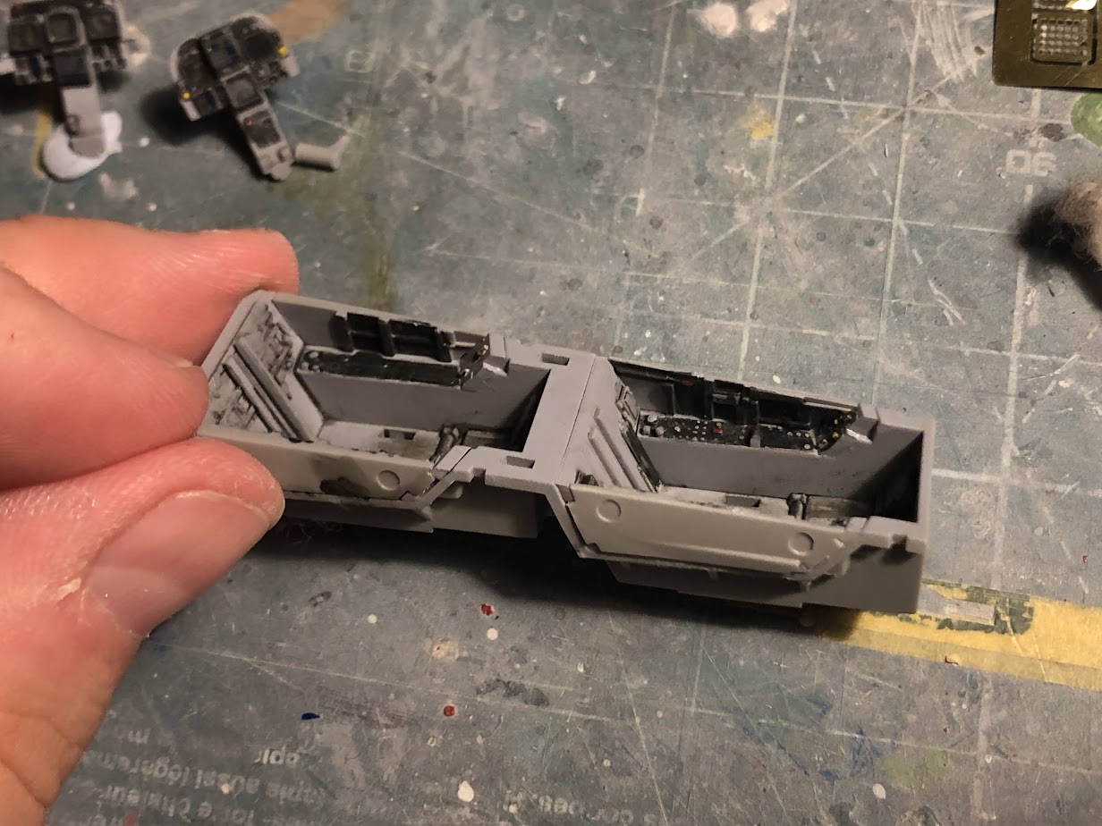

Thadeus Posted August 20, 2022 Author Share Posted August 20, 2022 So... Not a huge leap forward, but a step forward indeed. I was hoping I'd have most of the joints tidied up right now, but today I was just in no mood for modelling. The IP's under paint look pretty nice. I like the raised detail on the aft IP better than on the front IP. But still, it's quite ok. Kind of shame the aft IP still looks a bit skewed. All it needs are some display decals. Since I'm putting the crew in. The tub looks ok too. So, surprisingly, the decal sheet doesn't really cover the display 'on' option. Not a biggie, as the Kinetic F/A-18 A+/B boxing (the one with RCAF markings) has a lot of them. So I chose three, and applied them. Quite unusual for me. Neat. With cockpit tub in place I closed the fuselage. Aft IP and IP cover are just dryfitted, and so are the seats. There seems to still be a minor step on the windscreen. It still isn't glued. But I have to keep it on, as I don't want to damage the hud frame. I also begun testing the crew, here are two spare guys I had. Dryfitted without the seat cushions. They fit pretty good. But with cushions in, they don't fit all that well. Perhaps for a carrier landing diorama? But I'm not doing that. For my new Marine Aviators I had two body options. Both from Hasegawa Hornets (and Super Hornets) I chose the ones on the right. And here they are with some paint slapped on. I really don't know a thing about figure painting. They require a wash and a flat coat still. Probably should've thought about that before I painted the visors. They don't need their feet really. And with some dryfit shots to check the alignment. Nice! After some washes and a flat coat I'll glue them to the seats. I'll have to finish the seats themselves too... And this brings me here. See, the decal sheet is really cool, and quite large. The thing that caught my eye, there are no decals for the instrument panels. This is acceptable though. Same with displays. What is kind of shame, there are no seat placards. I really like them as decals, as in 1/48 they are quite obvious, and sometimes readable. There are also no placards for the gear legs. Again, this is something I'd rather have on stock decal sheet. I get it, there are some things that can be left out. I don't have that many spare seat and gear placards. The thing is there are no slime lights. It'd be kind of nice to have these, say in place of the chaff decals. I'll have to check my spares. Shame, since these are some pretty nice decals. Thanks for stopping by! Quote Link to post Share on other sites
