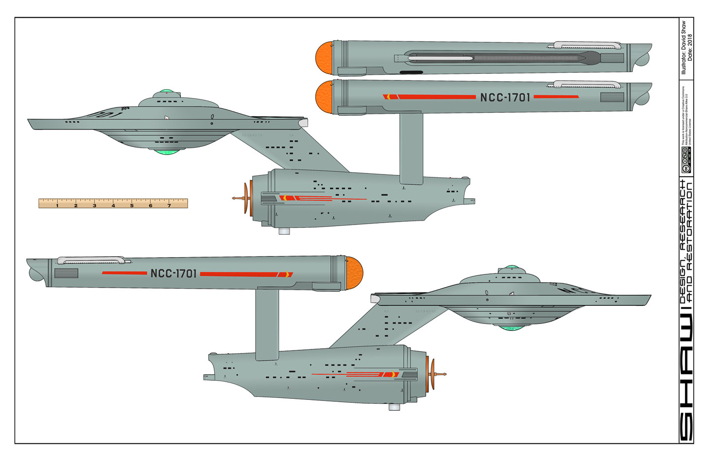

The building of the model started in 2015 and finished in 2019, and I continued to research the model during that time. Here is a color version of a couple views from my 2018 plans...

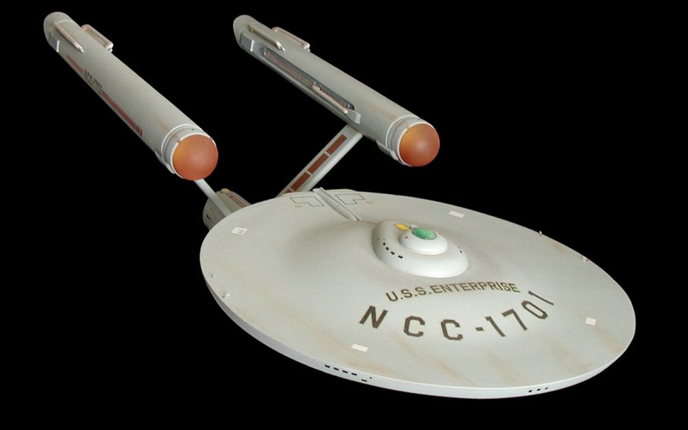

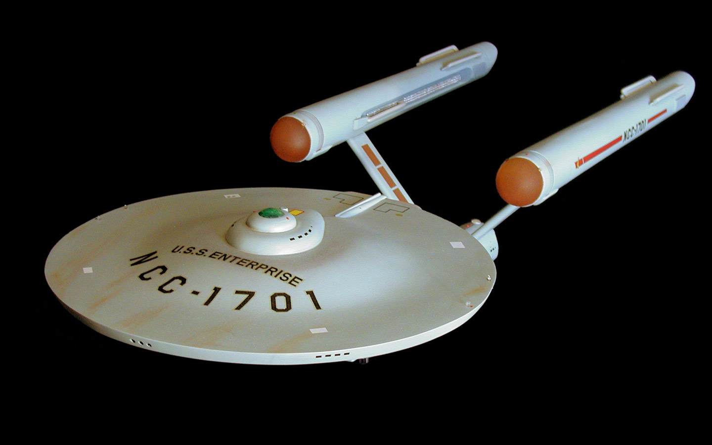

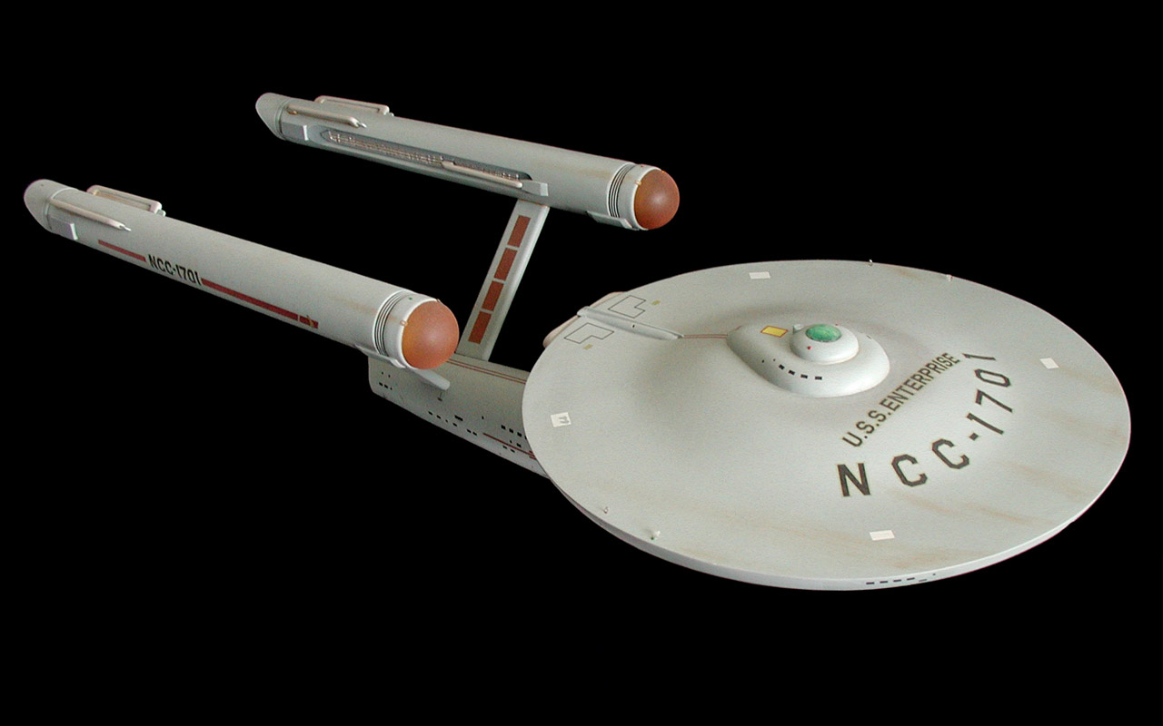

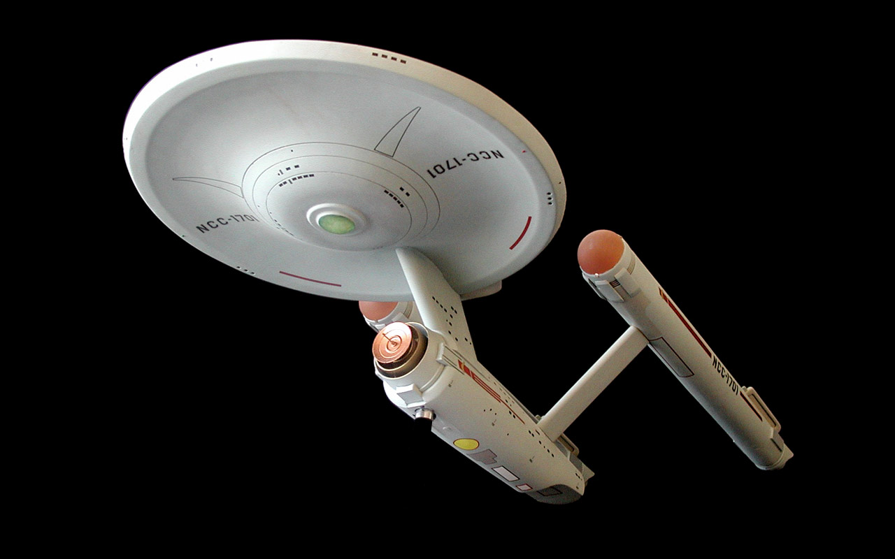

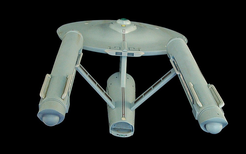

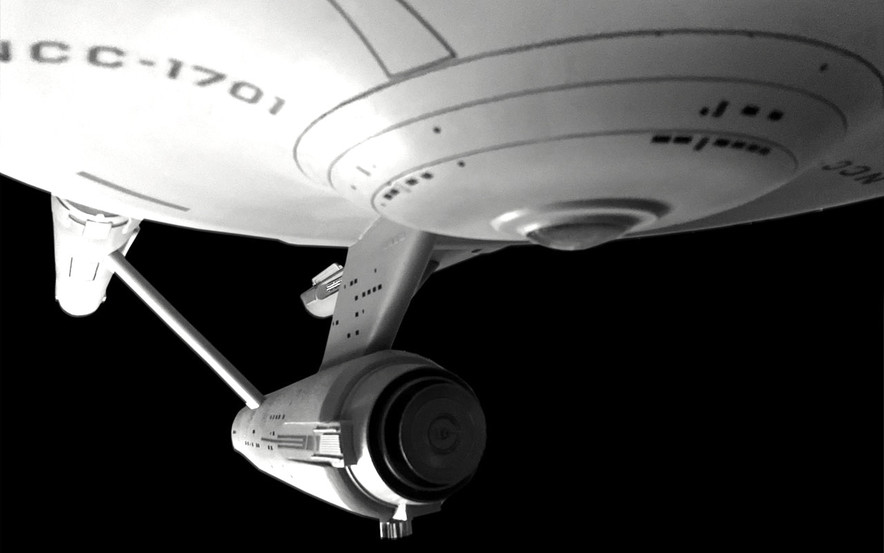

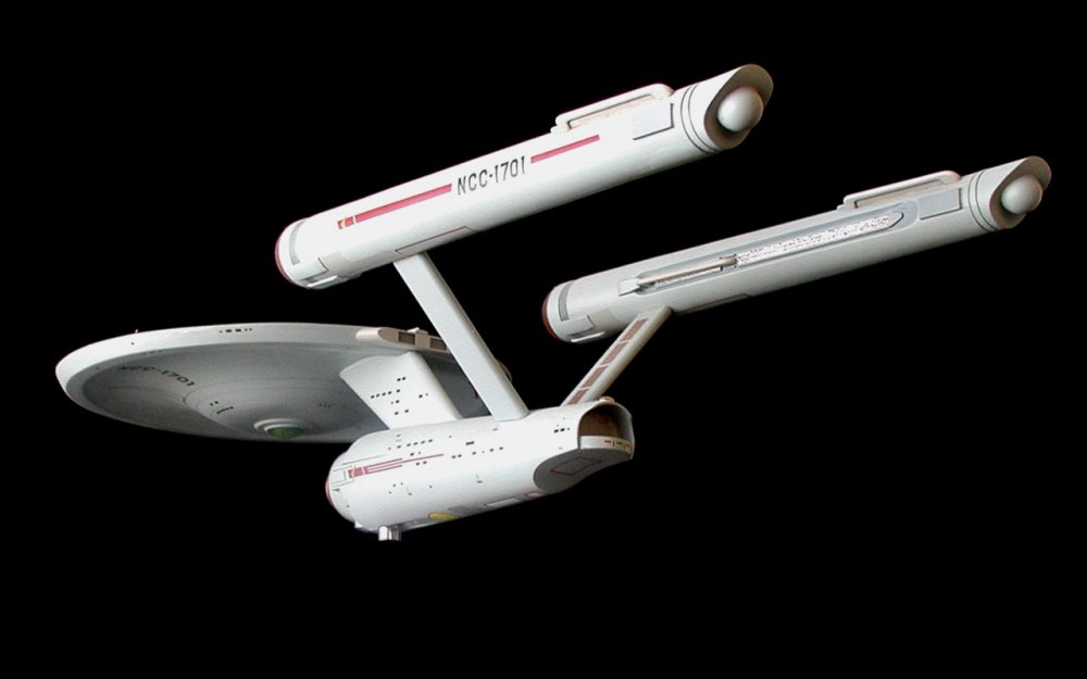

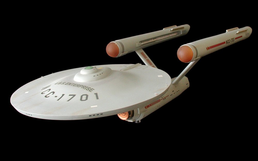

All of that having been said, here are some shots of the model itself...
And some more recent images...

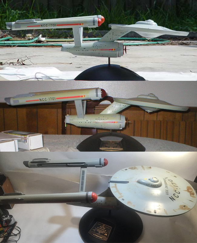

My reservations weren't just me doubting my abilities. By 2007 I had seen a number of people attempt a 1/350 scale version with mixed results. The worst being the Unobtainium models which generally ended up like these...
What changed my mind was watching Thomas Sasser work on a 1/350 scale model in 2007 and Steve Neill working on a half-studio scale model in 2010. Between what I learned from them and a few strategies I had come up with, I figured I might have a chance at building a decent model.

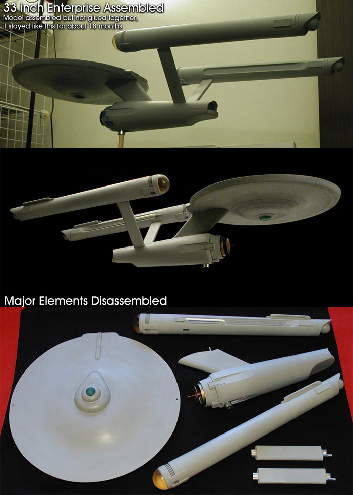

One tool I developed was an alignment box. I used my Phase II Enterprise as a test (it was always going to be harder with the angled nacelle supports), and then I built a larger version designed for the 33 inch model's elements.
I also got sick in 2016 and had to stop model building for a number of years, and I decided in 2017 to just leave the model assembled (but not glued together) until I could get back to it. By the time I had started back on it, the model had been standing holding its own weight for 18 months.
I was pretty sure when I finally glued it together in 2019 that all the parts could support themselves.

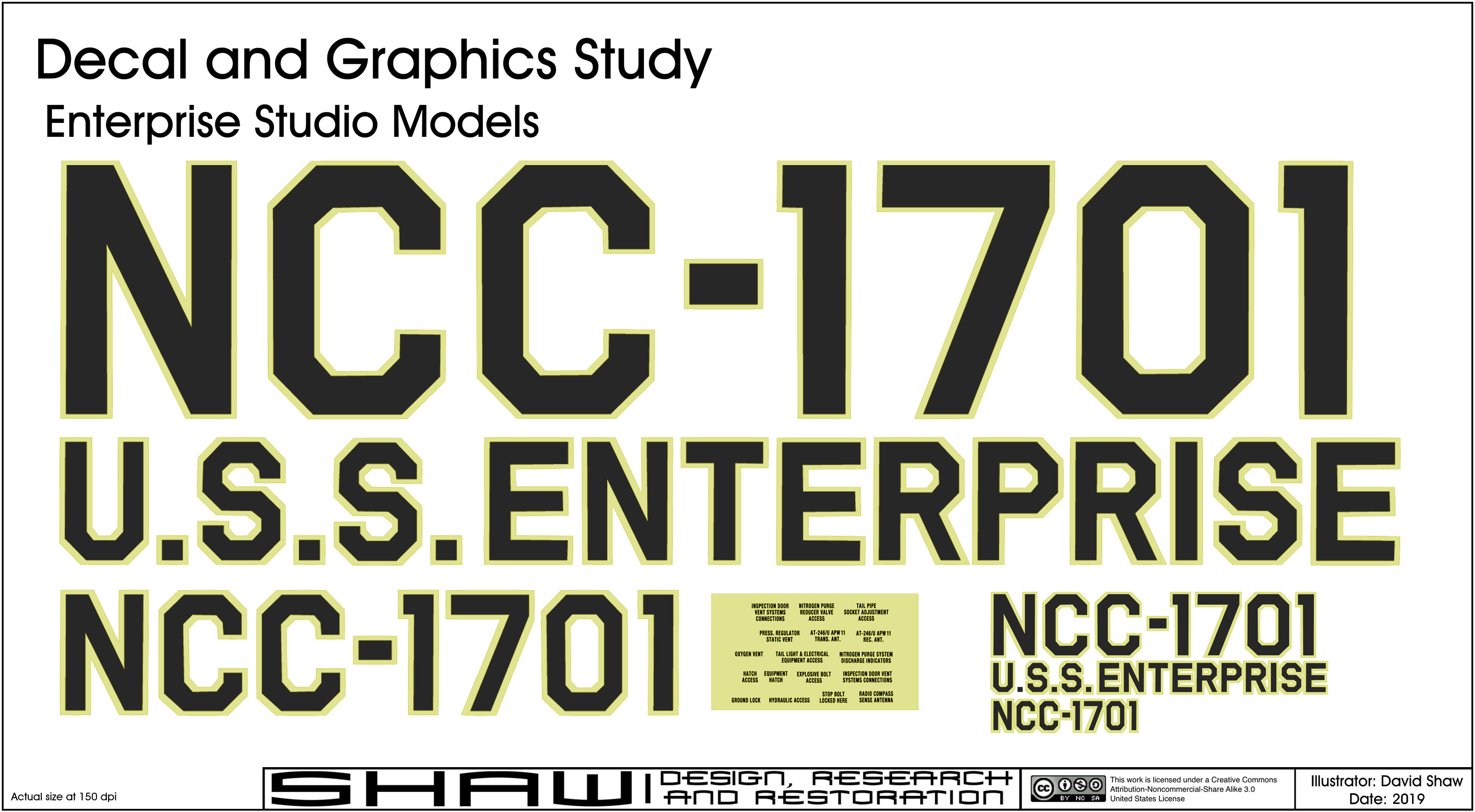

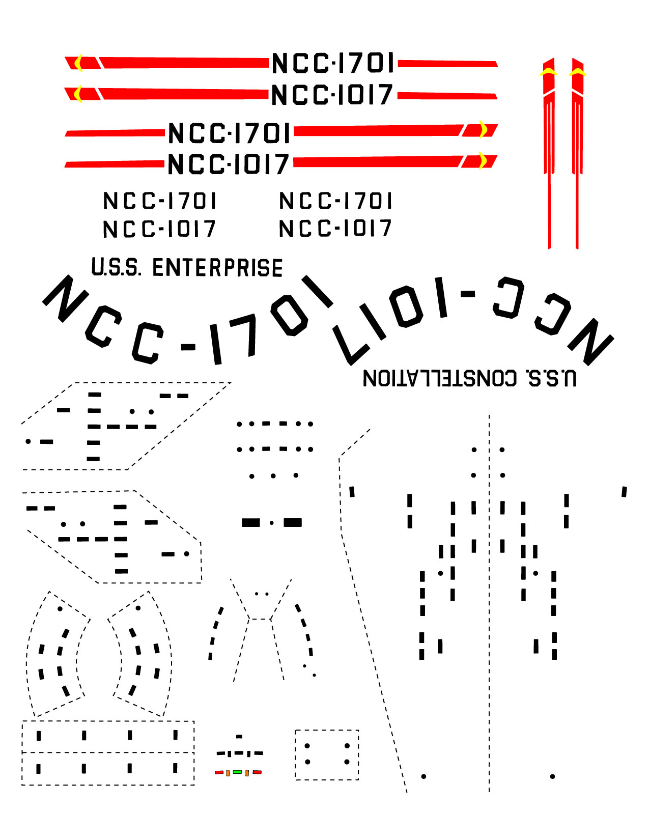

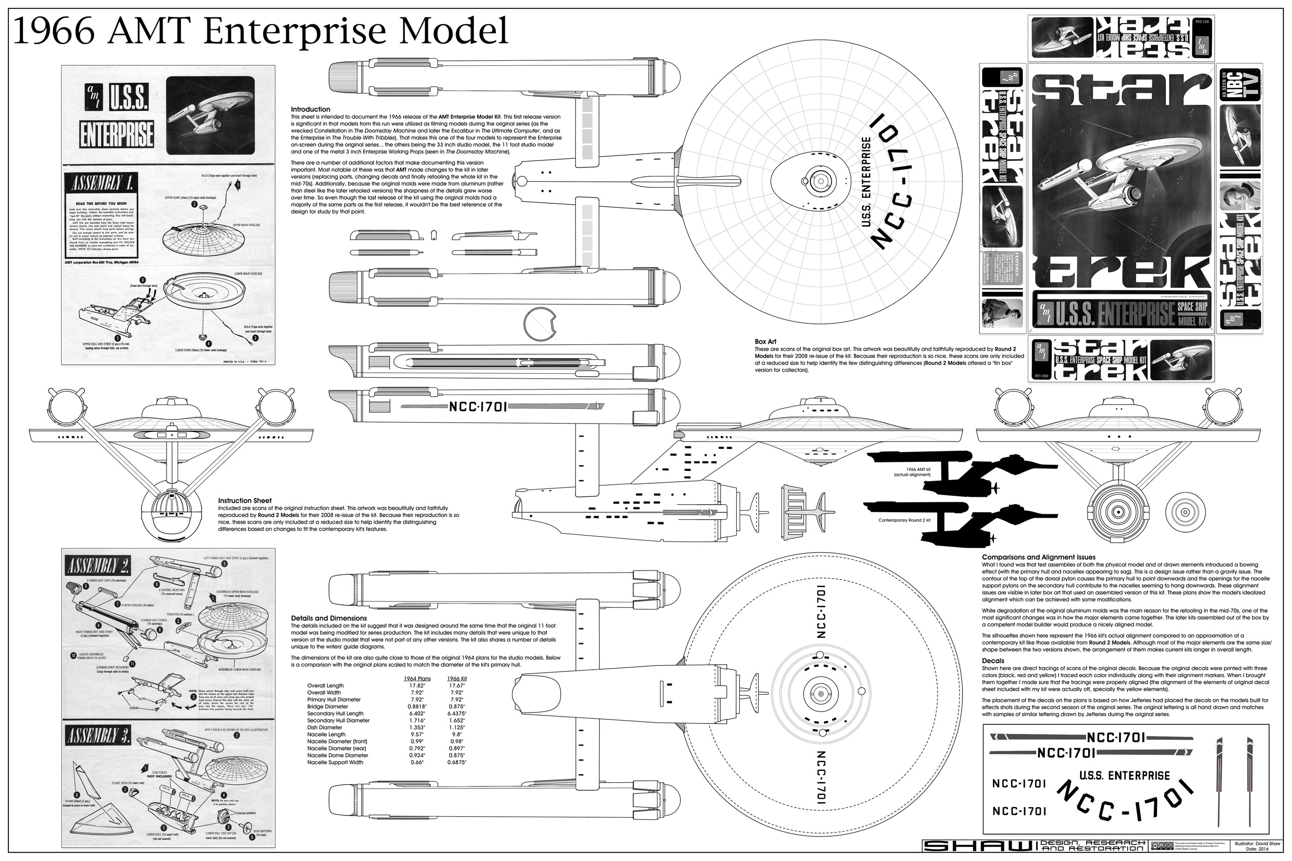

One of the elements I needed to research for this model was the decals used on the original. This included not only finding good shots of the model, but also reference images of the original decal sheet (which included the elements for both the 33 inch and 11 foot models).
The method I decided on was to draw every letter/number rather than using a pre-existing font. My first attempt at this was with my research on the 1966 AMT Enterprise model kit. I traced all the decal elements from the original decal sheet and also made window decals for the model from rubbings I took of the model's surface.
This is the resulting decal graphics...

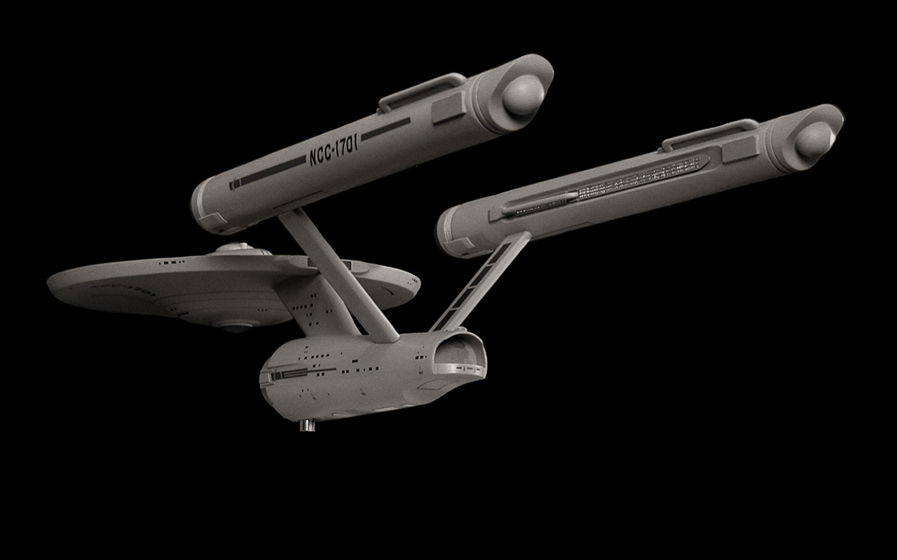

All of this was part of documenting that version of the model because it had been used in the second season of TOS for studio models. These are the plans I reverse engineered for that model...

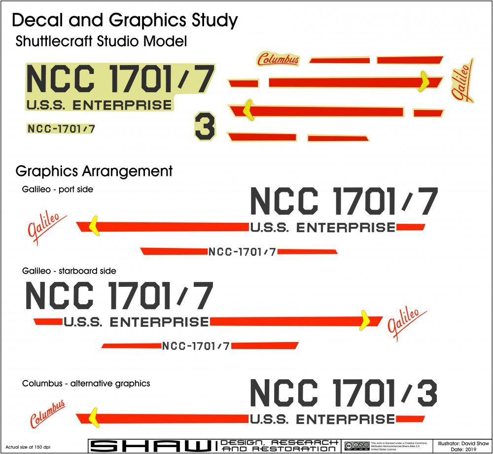

And I also replicated the decals used on the shuttlecraft studio model...

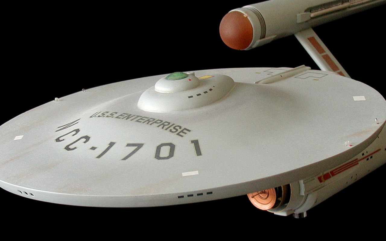

Oh, and here is a picture of my model from yesterday (I was just looking at it and decided to snap this shot)...

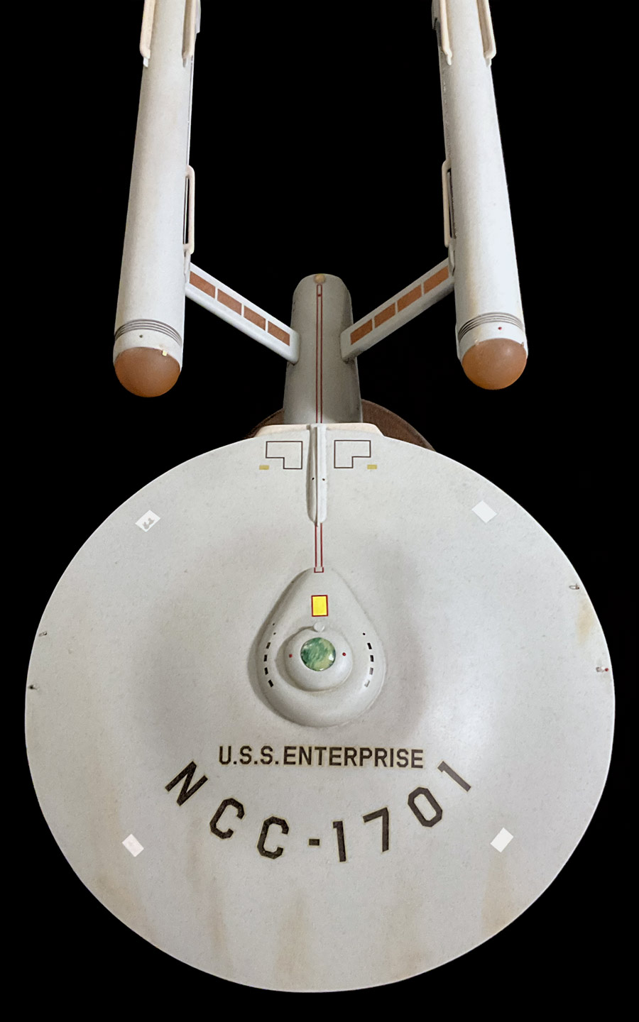

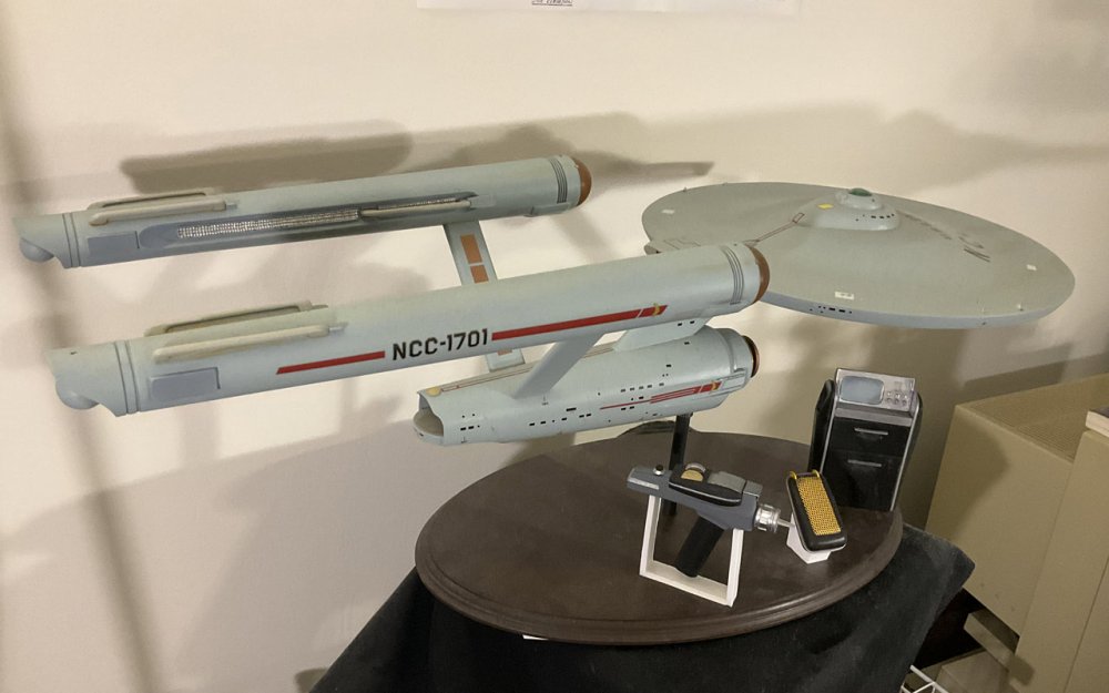

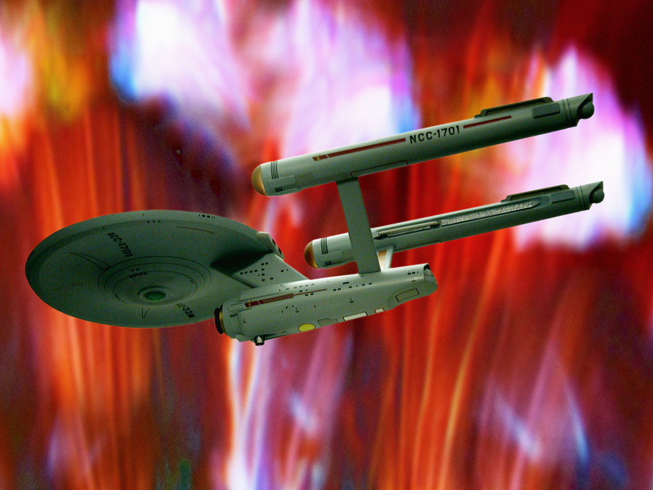

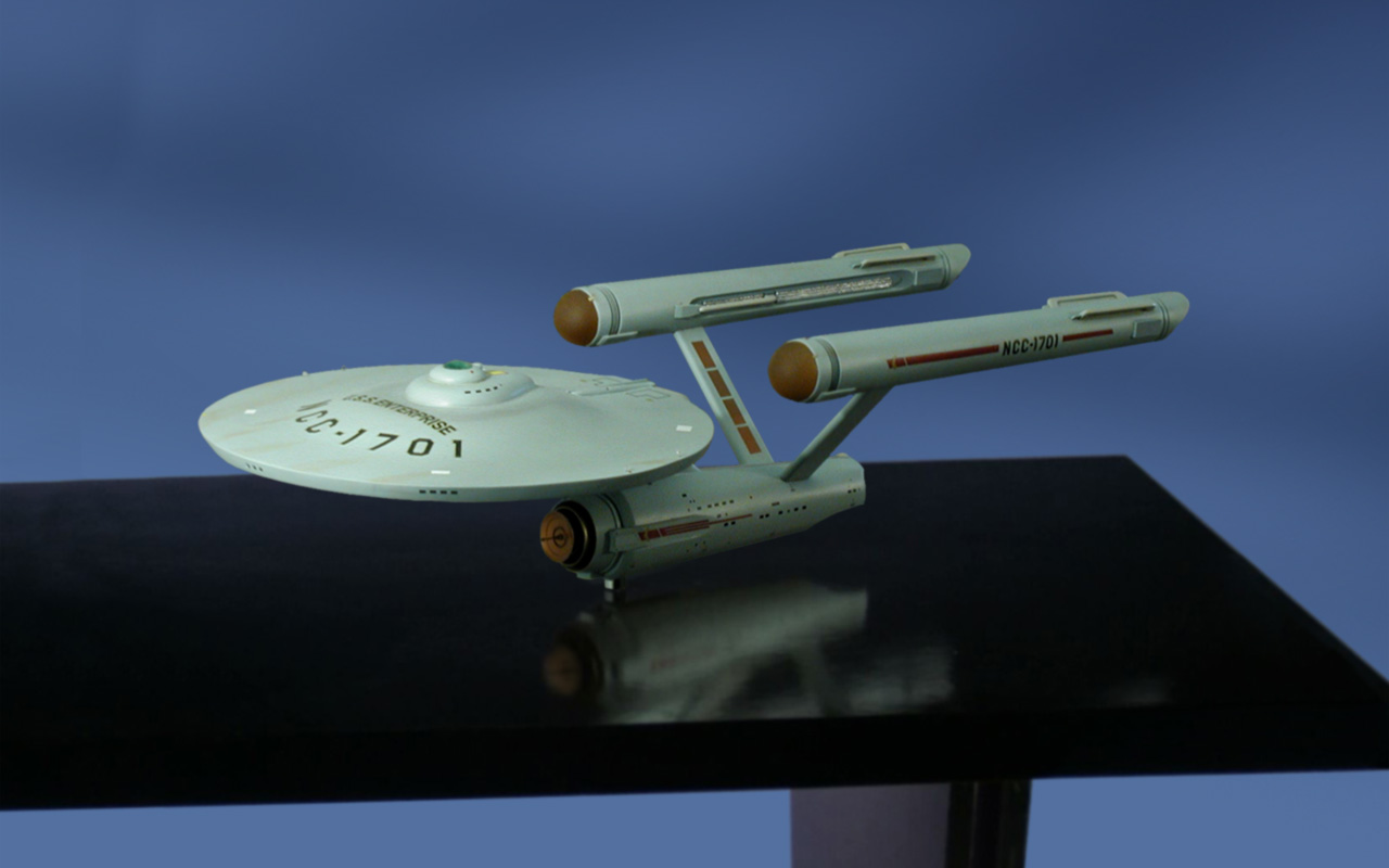

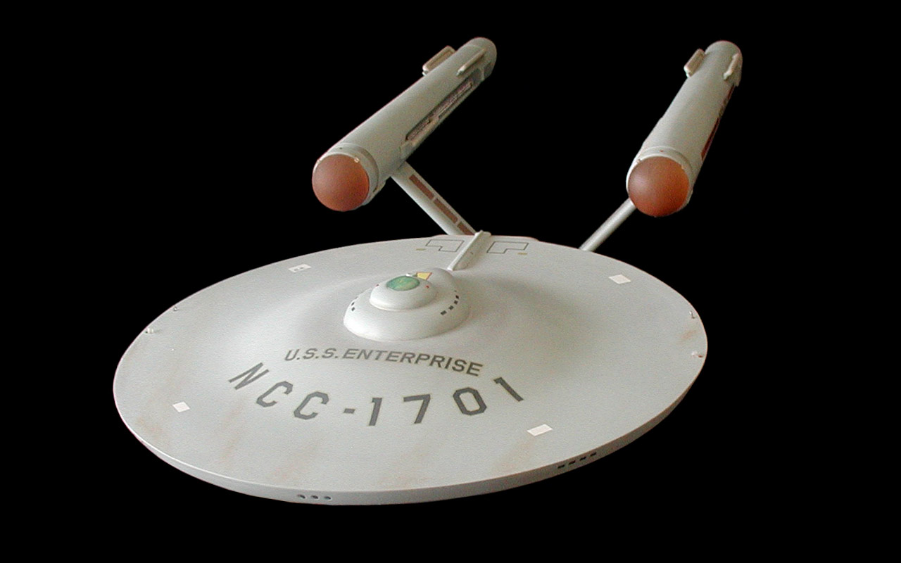

Here is a collection of shots of my model (all taken with day light in my apartment).

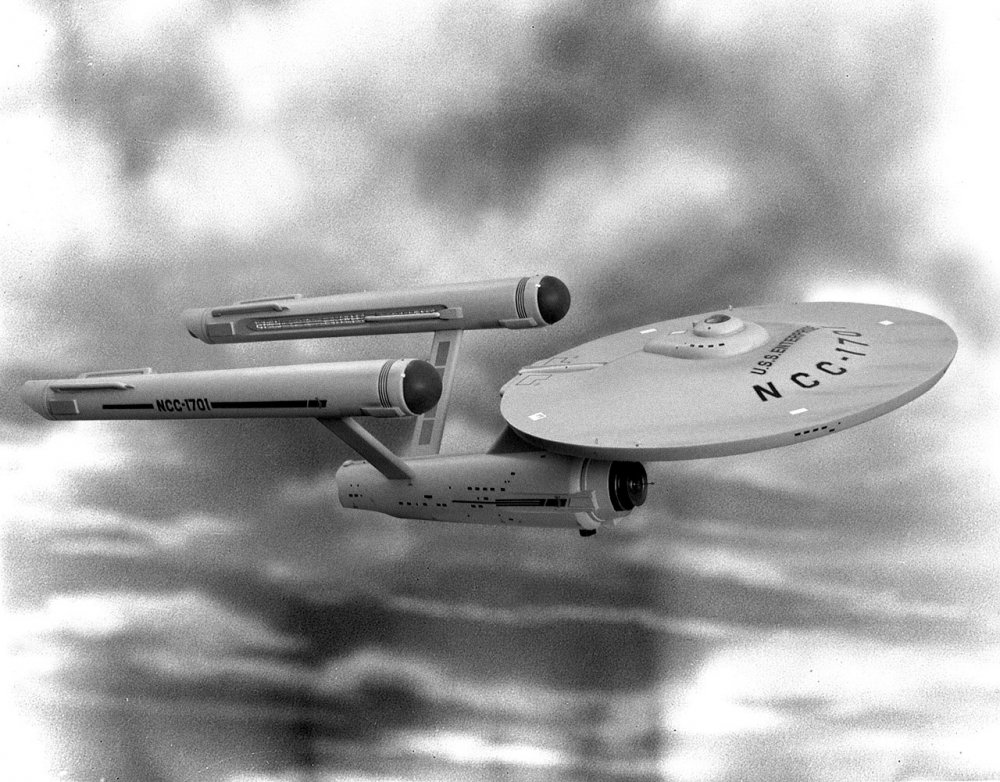

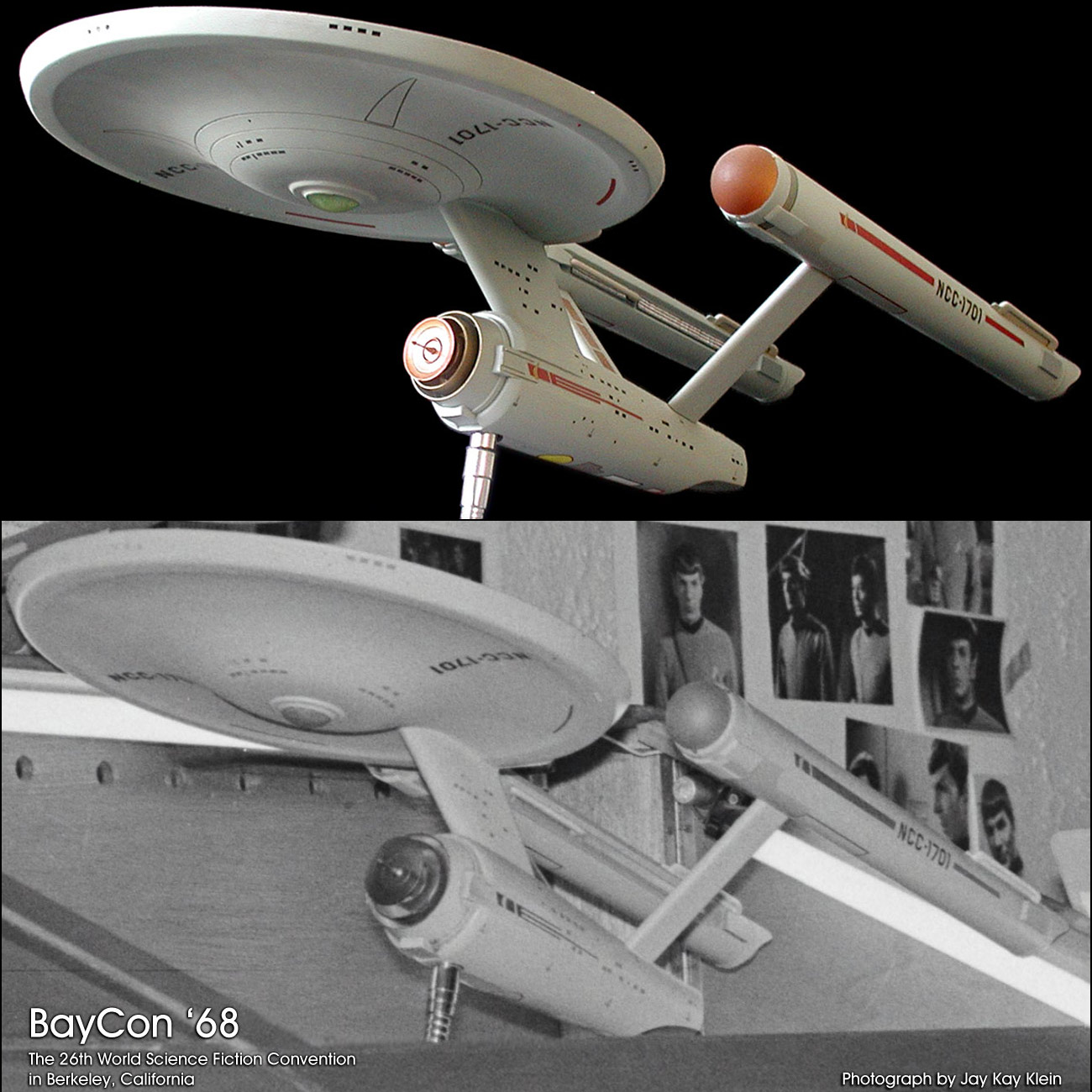

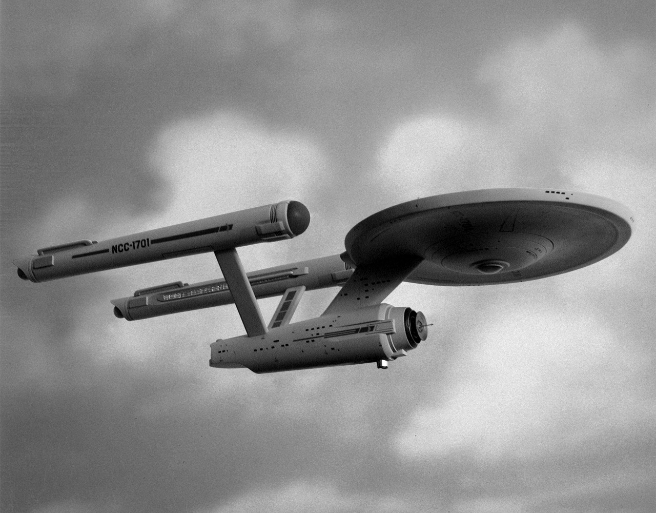

And here is a comparison of my model with an image of the original model taken back in 1968.

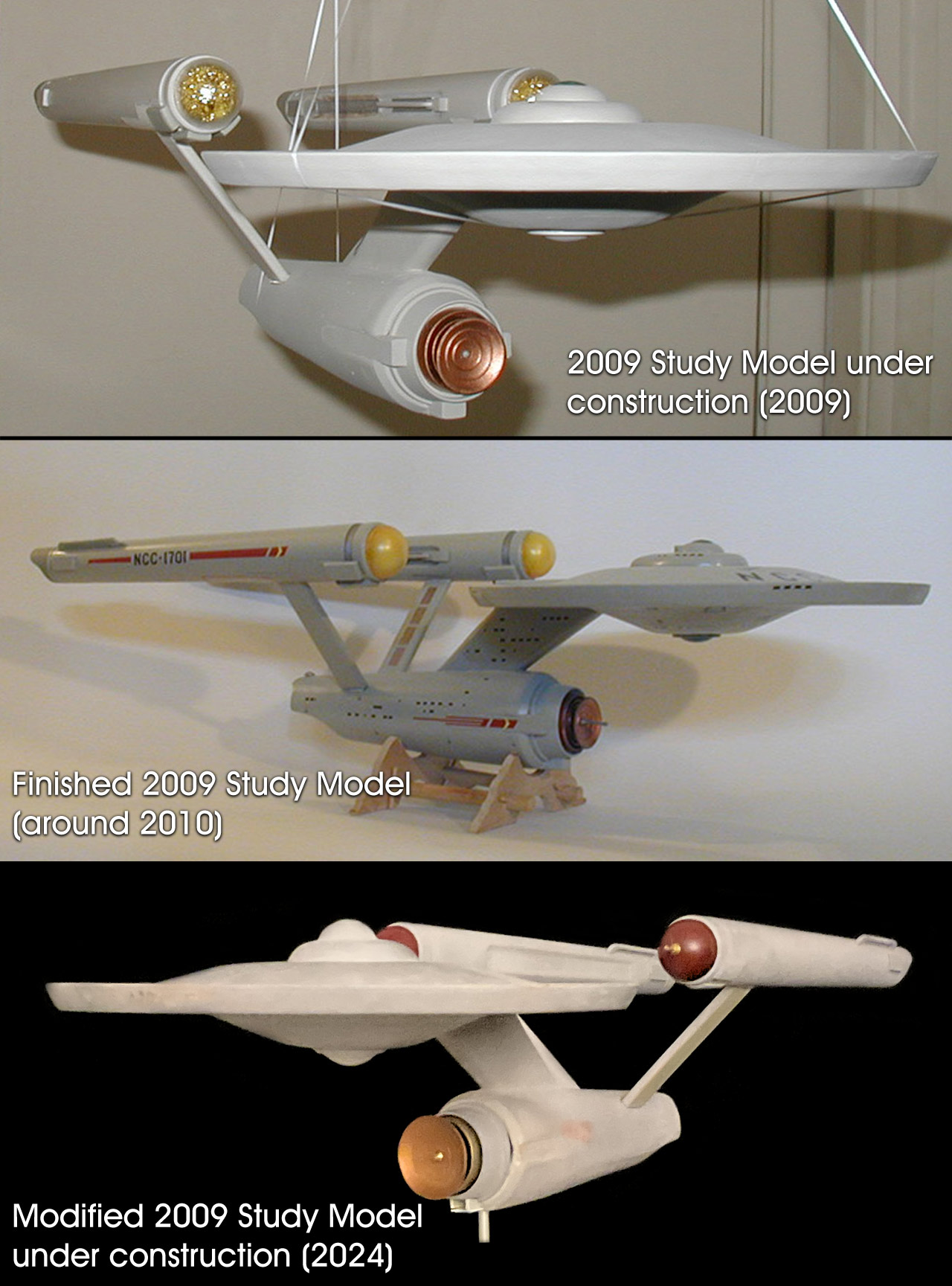

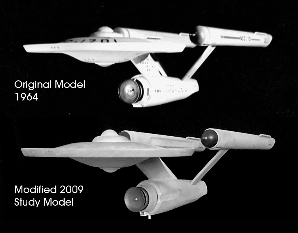

Back in 2019, when I finished this model, I decided that I wanted to (at some future date) modify/upgrade my study models to incorporate many of the details of my final model that were inaccurate or missing on the earlier models.
I started by disassembling my first study model (from 2009). And because I didn't need three models of the same version of the Enterprise, I decided early on to make this one the pilot version.

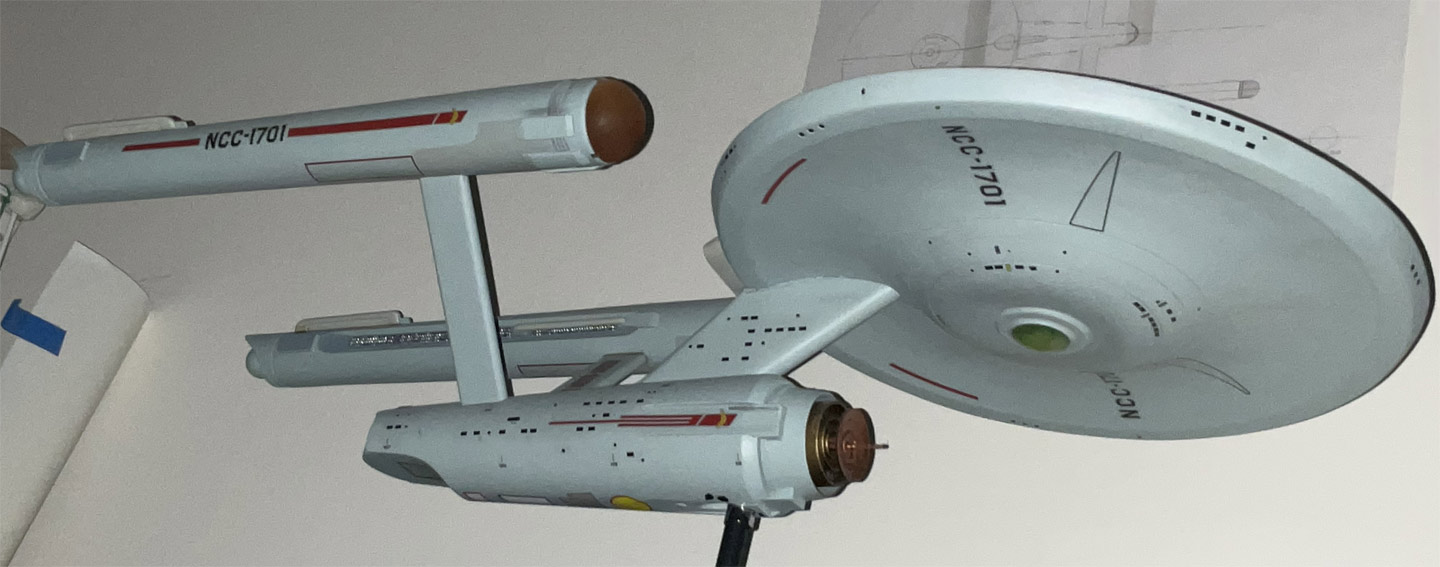

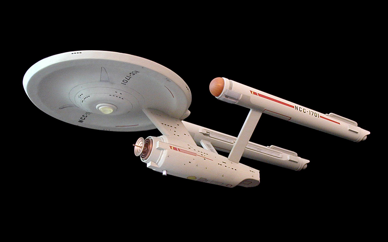

Here is a comparison of my WIP with the original model...
Another shot of the unfinished model (as she is currently)...

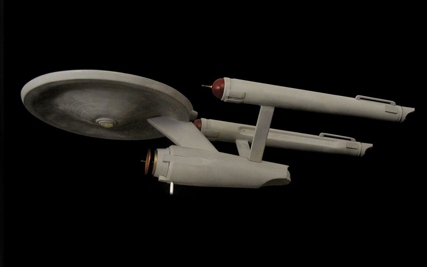

And the model compared with some photos of the model from 2009/2010...

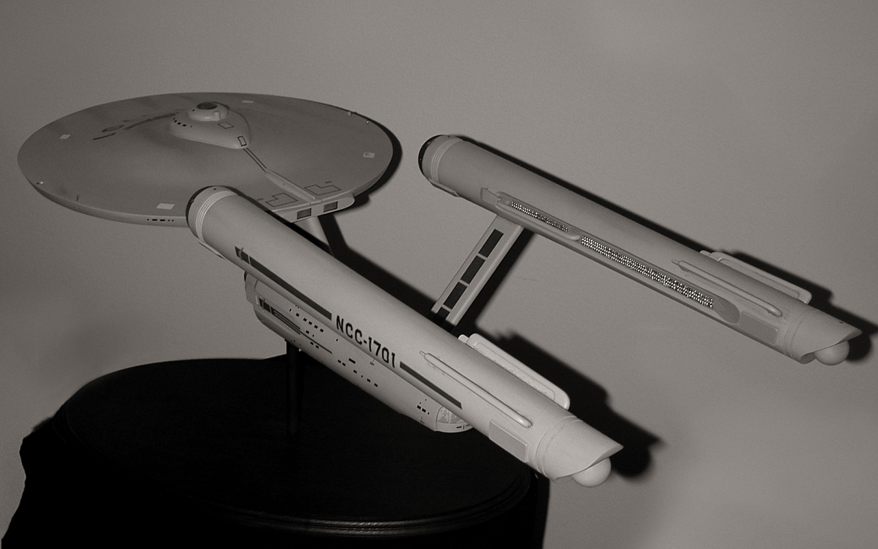

Also, while I haven't started a major disassembly of the 2010 study model, I have swapped out a few of the parts with replacements made for the 2009 study model. Here is the 2010 study model as it stands today...
