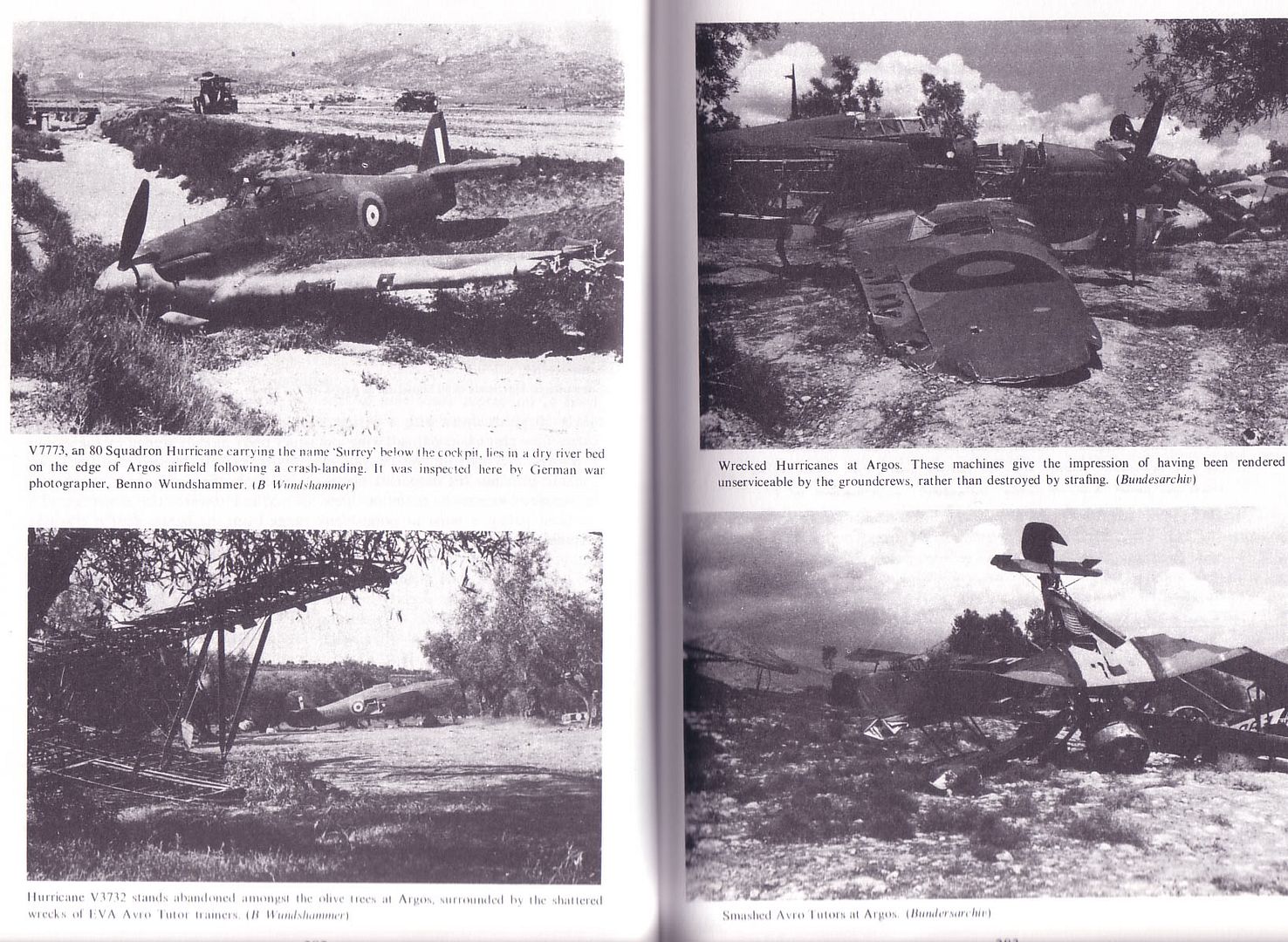

atckyrre Posted October 25, 2006 Share Posted October 25, 2006 (edited) Dahl flew V7826 among others - no codes given. This according to Chris Shores "Air war for Balkan and Greece" Not sure about the timeframe, been a while since I read up on this, but here are a couple of the Hurries used by 80 Sqn. Trop filter, standard camo, though one aicraft in the background appears to be in desert camo and one has got some mid stone overspray in front. Edited October 25, 2006 by atckyrre Quote Link to post Share on other sites
